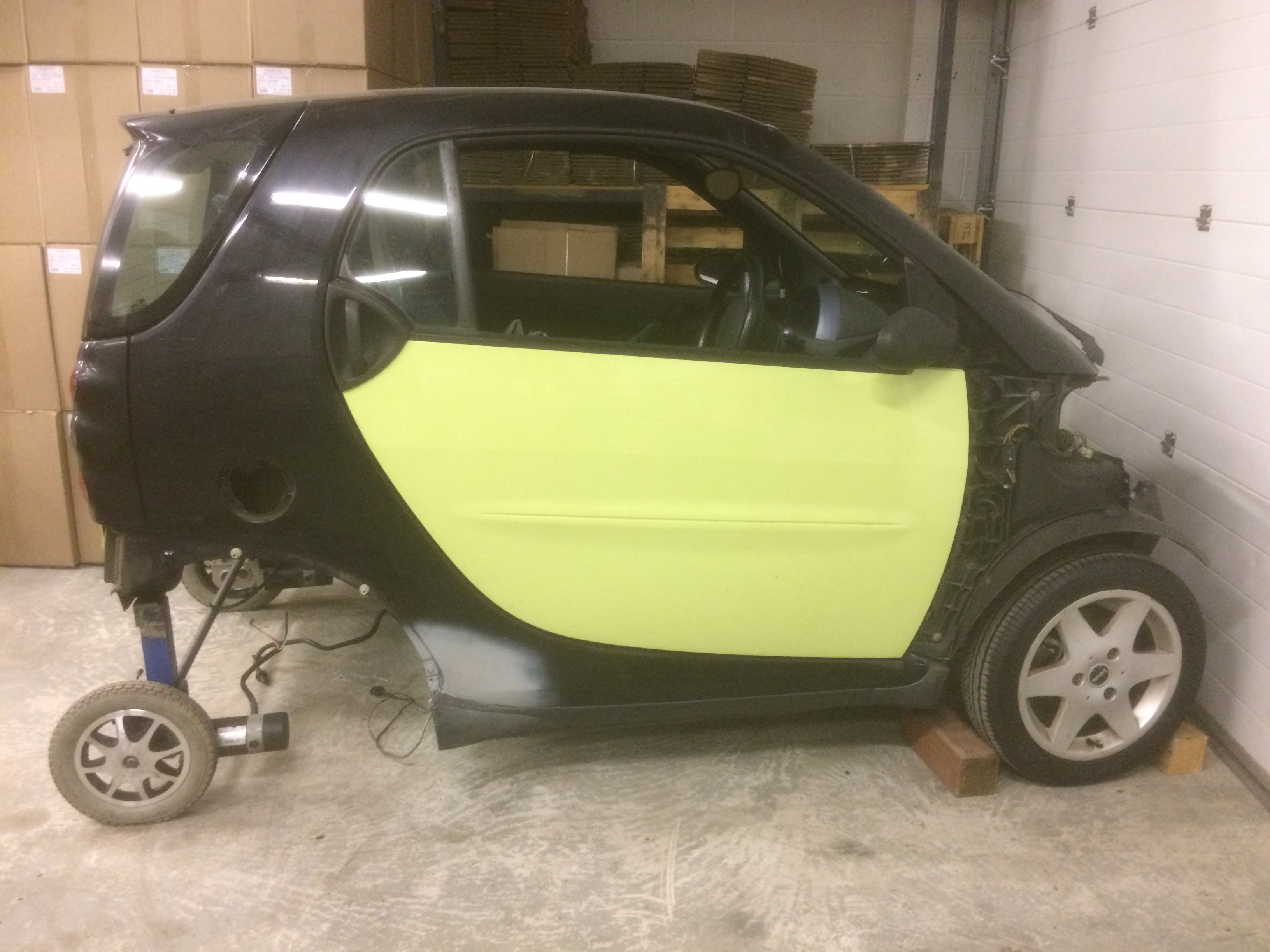

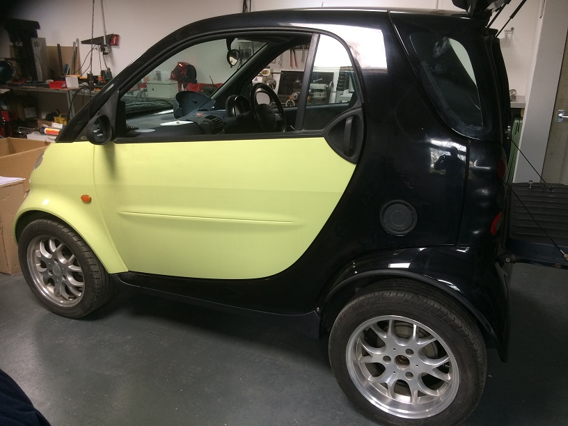

Project Smart in its early days with twin DC power..... all 200 Watts of it, wow.
I bet you were hoping for something much more interesting. However more pics to come of what it has now under the rear
Any paint left Damien ??

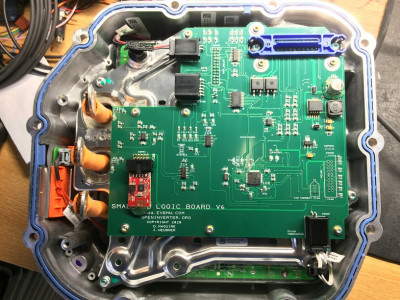

Hi Forum. Finally back after deciding to change from Enova to SDU. The difference is beyond belief, really quick and had to tone down the settings ! Did some 0-60 timed runs with average 4.87 secs Plenty more 'go' available but may kill batteries if I do. Hope you like the pics for reference and for an insight. All thanks to Johannes and Damien for their work too. Peter
Re: Smart 450, Tesla powered.
Peter, great zero to 60! I wonder if you could post your parameters? We have an SDU in a Boxster and it's amazing but could always be improved, especially for full power at launch. I've been comparing SDU parameters from recent projects on this forum to find the optimal settings. BTW, our current settings are pasted below, but these are definitely not final.

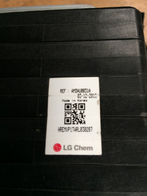

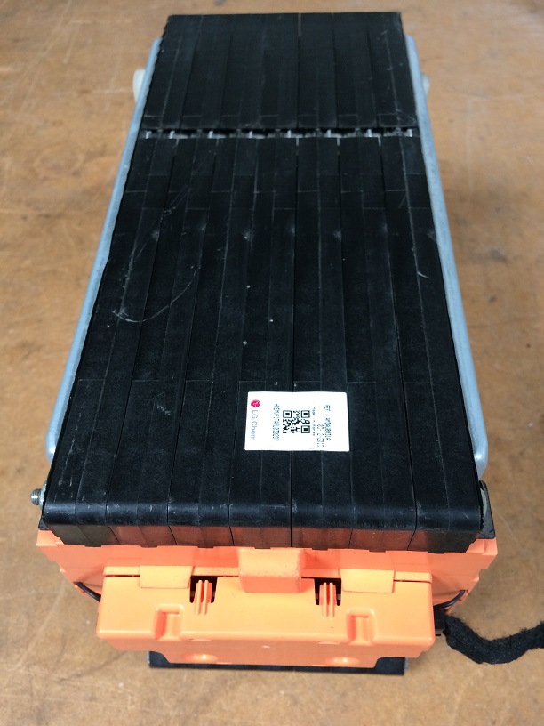

What are those battery modules?

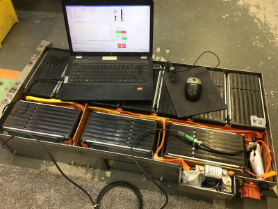

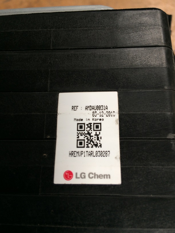

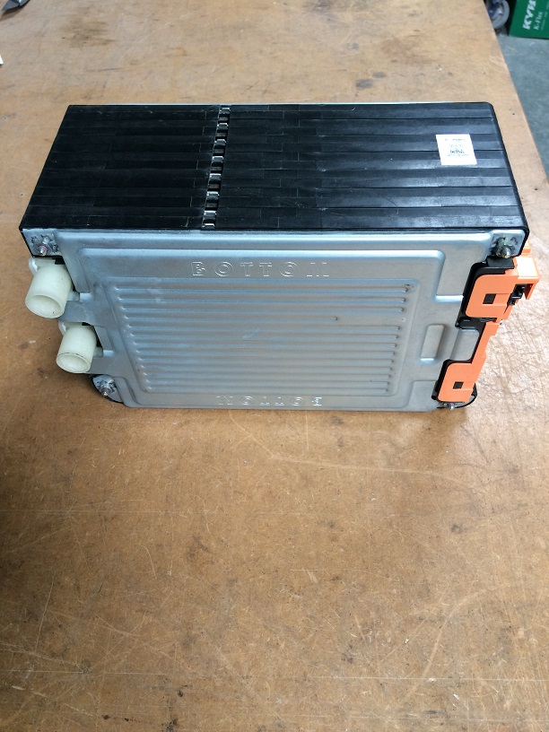

Hi Bigpie. They are LG modules. Rated at 60v 30Ahr. Believe to come from ex-Volvo test vehicles. I will send some pics later Peter

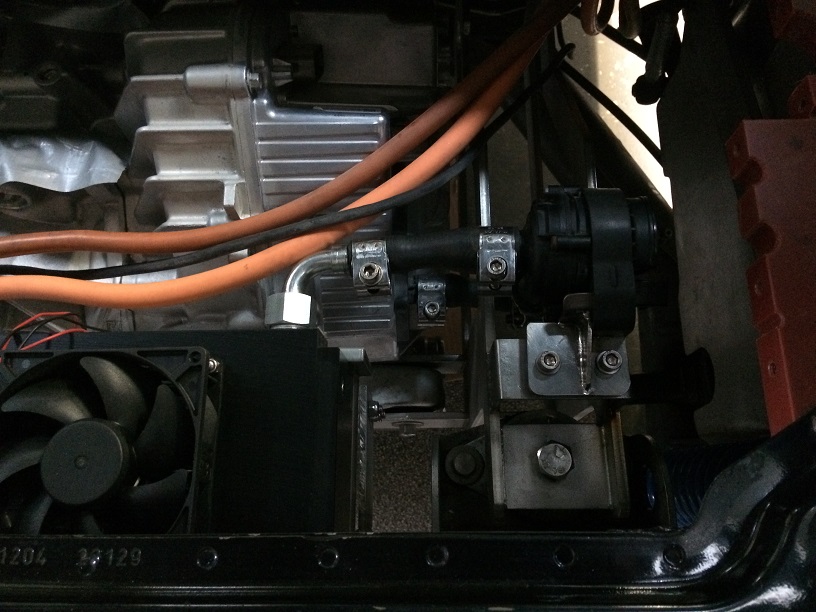

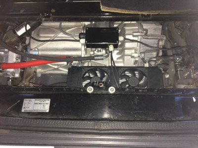

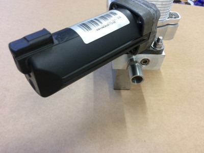

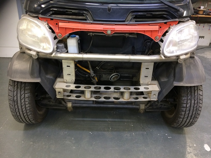

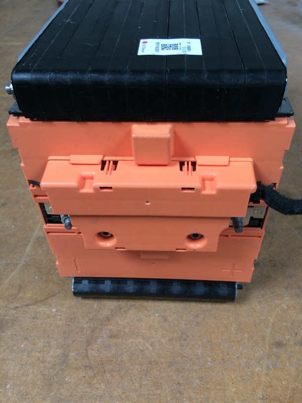

Hi Bigpie. Pics as mentioned. Front facing shows BMS module which is plugged in and can be daisy chained. 16 cells per module. Nominal 60v. I have managed to comms to the BMS but only using the Texas Instruments software and not by Arduino etc which I would like to do. Modules are liquid cooled and have a temp sensor at each end of the module. Peter
Aren’t these bricks from a Volvo XC90 hybrid pack ?
Quite looks like the V60 hybrid modules I got here which are 10s bricks.
Do the BMS slaves look like the ones in this topic ? -> viewtopic.php?f=13&t=885&p=26321#p26321
What hardware are you using to talk to the battery module?
Since my last reply I've spent a few hours reading the datasheets and trying to get the BMS Slave (the thing attached to the battery) to respond but haven't had any luck. I think the best approach would be to buy the official TI interface, but because of stock, this would be an expensive exercise: https://www.mouser.co.uk/ProductDetail/ ... NrUg%3D%3D
I'm comfortable with software, but haven't made much progress with the hardware on this
Hi catphish. I connected directly to the onboard chip of the BMS modules by using 4 wires of an RS232 adaptor cable then using the TI software. Tried to use the software thankfully offered by FJ3422 but couldn’t extract what I thought was the simple cell voltage reading part. Any assistance to be able to comms with the modules via Arduino would be gratefully accepted. I am already using an UNO and CAN shield to interface SDU to a Nextion screen so if I could sort comms to BMS the task would be complete. As to current, pulling 250A is exciting in such a small car but a quick delve into higher doesn’t so far show any deterioration of the capacity. I will be adding another 2 modules in parallel to give 400v so that will require waterproof underwear

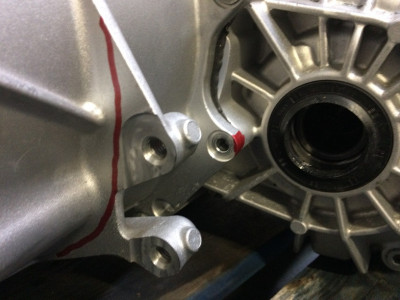

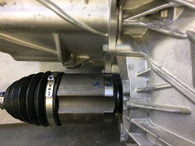

Peter,
I’m trying to also delete the jack shaft and just run two “driver side cv’s” but I’m having issues with the SDU seal.
I just purchased a used oem driver side cv and found that the seal on the drive unit is too large . The front left (USA driver side) cv I have is 40mm diameter where as the seal on the front SDU are 44 mm .
I assume maybe my left seal was incorrectly replaced with larger one by prior owner/ handler of drive unit. So my question for you is did you have the same issue for the jack shaft seal ? If so , what did you do , did you replace it within another oem smaller seal ?
