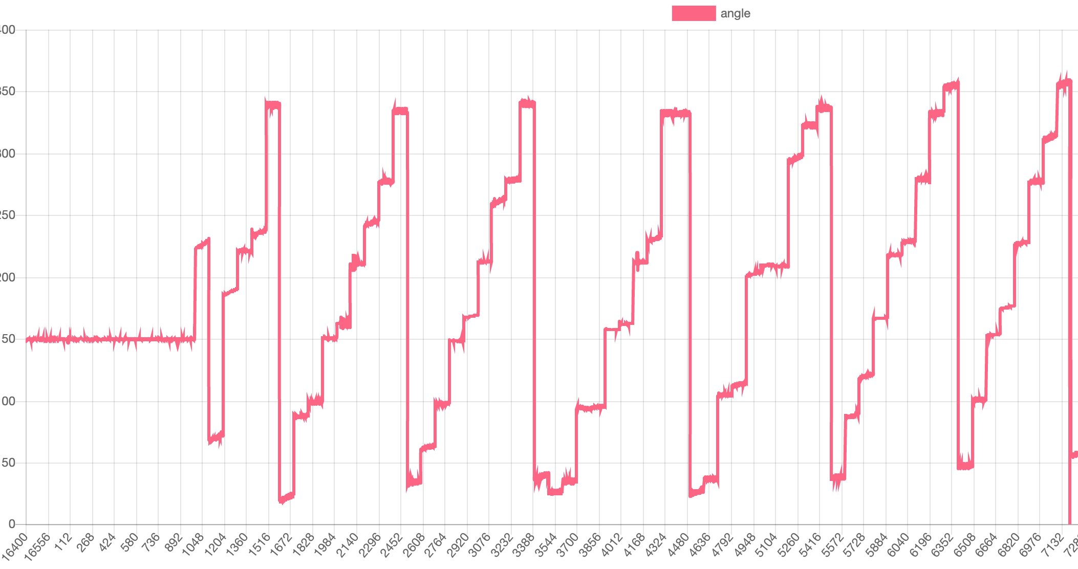

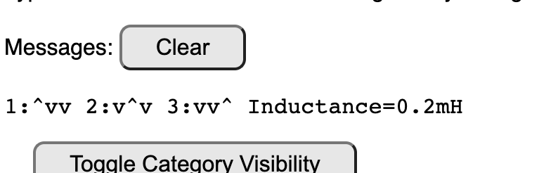

Posts: 1585
Has thanked: 74 times
Been thanked: 299 times
Re: IPM Motor - Auto-setup
Motor doesn't spin in forward test mode though.

Posts: 1801
Has thanked: 102 times
Been thanked: 347 times

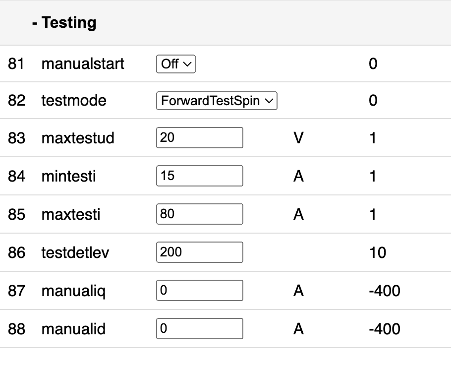

Post by Pete9008 »
:D
Try giving it a bit of positive manualid, say 10-20A?
Edit - that was quick, thought you might get to it over the weekend!
Posts: 1585
While in forward test?
I got a bit curious and took a break from work

Pete9008
Posts: 1801
Post by Pete9008 »
Yep, the manualid value is used in both the forward and bidir tests (seemed the simplest way to allow it to be adjusted to suit the motor, a free motor should be happy with fairly low current but if there is a gearbox on it it will need a lot more to cope with the extra drag).
Bigpie wrote: Fri Jul 14, 2023 2:04 pm I got a bit curious
You and me both!

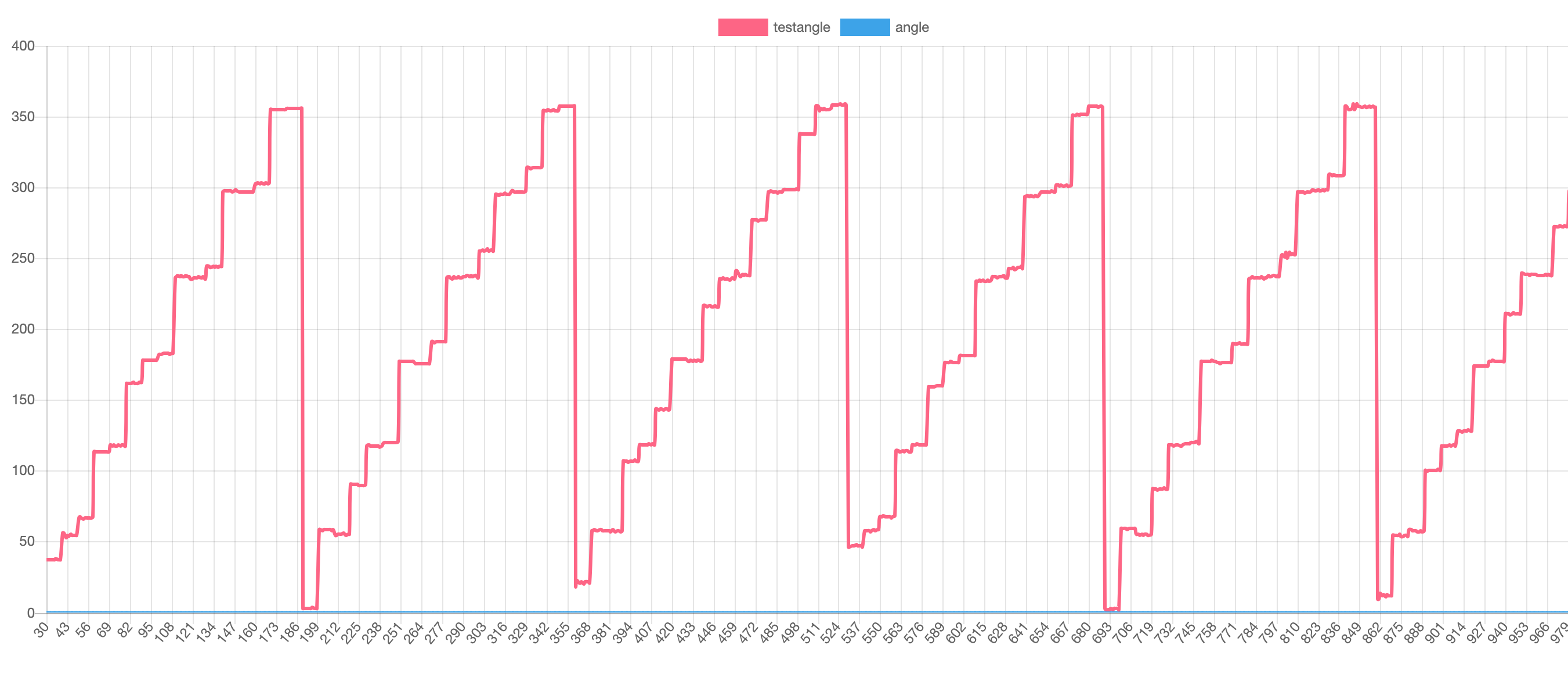

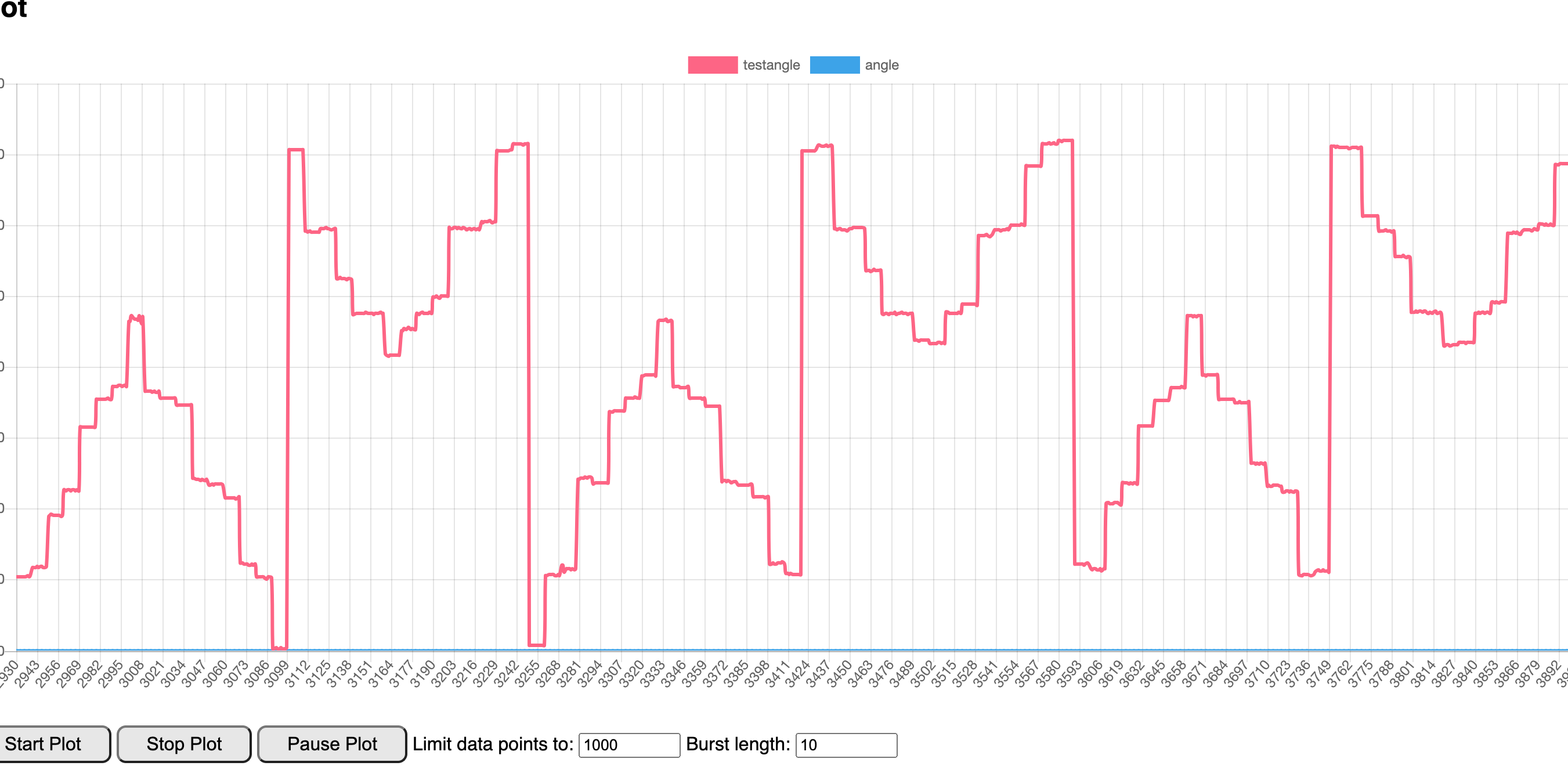

Posts: 1585
This is cool, thanks by the way.
My testangle doesn't seem to be working
Also, my UDC gain sometimes needs to be 6.15 (roughly what id expect), some times 24. only change is powering off and back on :s

Pete9008
Posts: 1801
Post by Pete9008 »
Am I reading that right, testangle looks fine, its angle from the resolver that doesn't seem to be working?
Is the 2nd plot in bidir mode?
Might be worth playing with the burst lengths to see if you can get rid of some of the steps in the plot?
Edit - udc sounds like a software rather than hardware issue but not sure what it could be, do all the other analogue inputs work?
