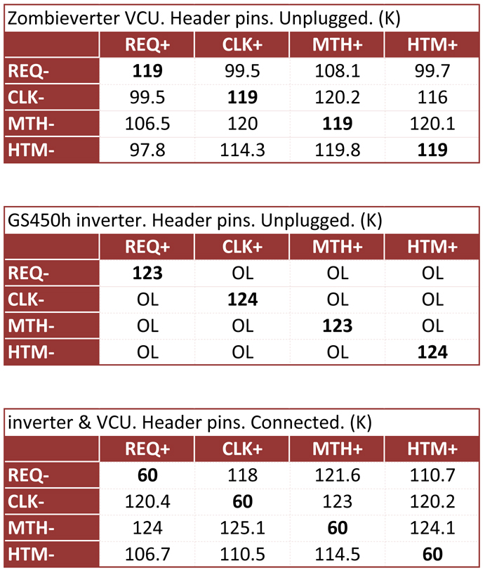

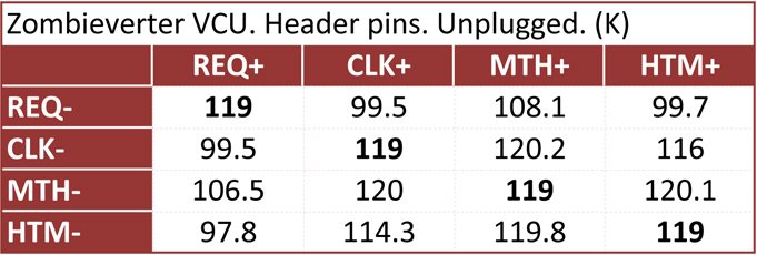

I'm seeing some inconsistent resistance readings across the synchronous serial connections on my Zombieverter. I don’t know what they should be but they look off compared with the ones nkiernan posted recently viewtopic.php?p=49131#p49131.
Here's my readings taken with the connector unplugged and the VCU unpowered.
Can anyone suggest what might be wrong? I don’t know how to diagnose this problem. I got my board during the chip shortage and had to add several components so these may be faulty or badly soldered. Everything powers up OK except the inverter and all the spot values look OK too.
REQ & HTM and REQ & CLK look particularly low and when I first put the probes on the reading is in the mid 80s and takes over a minute to climb and stabilise.
Thanks.

I'm not sure what to suggest for diagnosing, but just to confirm, are you having the same issue I was having where inverter does not power up and will not spin motors even when VCU has switched 12V relay power to the inverter and HV is seen at inverter also (no inverter whine)? I thought you had the VCU spinning the transmission previously?
Not sure these values are a big issue. When you have VCU connected to inverter, with nothing powered up, are you getting approx 60R between each comms pair? That could be more important?

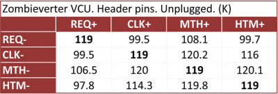

So far nothing has worked. The readings between each comms pair look OK. The reading across different pairs are far less consistent than yours. Today’s readings are:
