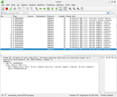

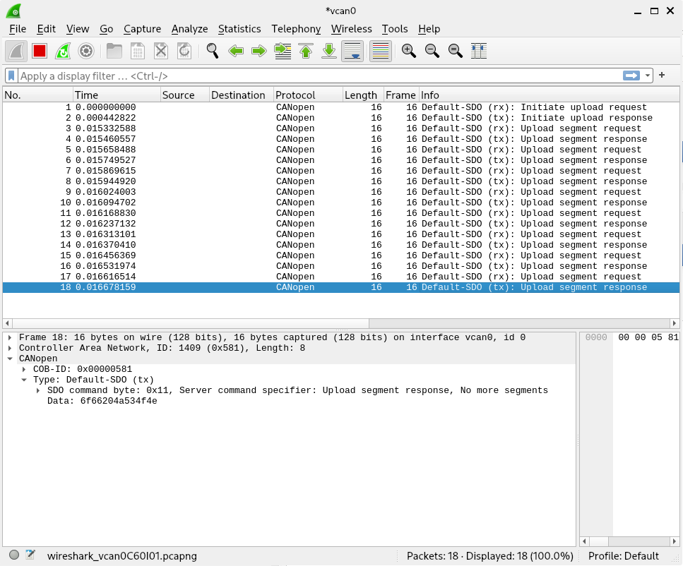

Great. Looks prettier in Wireshark :)

Works on the template :)
debian@beaglebone:~$ python3 candownload.py
   "canspeed": {"unit":"0=125k, 1=250k, 2=500k, 3=800k, 4=1M","value":2.00,"isparam":true,"minimum":0.00,"maximum":4.00,"default":2.00,"category":"Communication","i":0},
   "canperiod": {"unit":"0=100ms, 1=10ms","value":0.00,"isparam":true,"minimum":0.00,"maximum":1.00,"default":0.00,"category":"Communication","i":1},
   "testparam": {"unit":"Hz","value":0.00,"isparam":true,"minimum":-100.00,"maximum":1000.00,"default":0.00,"category":"Testing","i":2},
   "opmode": {"unit":"0=Off, 1=Run","value":0.00,"isparam":false},
   "version": {"unit":"4=1.00.R-name","value":4.00,"isparam":false},
   "lasterr": {"unit":"0=NONE, 1=TESTERROR,","value":0.00,"isparam":false},
   "testain": {"unit":"dig","value":121.00,"isparam":false},
   "cpuload": {"unit":"%","value":0.00,"isparam":false},
   "serial": {"unit":"","value":"87215032","isparam":false}
On the first reply I always specify a size of 64k as I don't know in advance how long the JSON string will be. Seems to work anyway.
