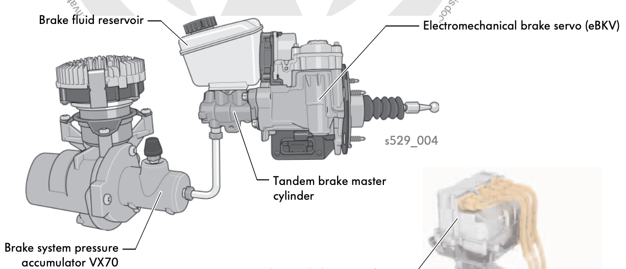

Pressure Accumulator "Smart Actuator" - There is also a brake accumulator module that ties into the 2nd port on the Brake Master Cyl. Some cars have this, others do not. I'm trying to find out what VCDS coding is responsible for this.
Seems it's there to allow to drop some pressure allowing a greater deadzone to aid regen.
I view this as more of an adjustable volume accumulator.
The Module is referred to as Vx70 in documentation
The main IBooster is referred to as the EBKV in documentation.
Module designation is J539 or NX6 in any wiring schematic.
It's Module 23 in all the ODIS/VCDS software.

MAS10353-IDE00634,Brake press. accum. current-Vehicle electrical system current,0.0, A
MAS10353-MAS10347,Brake press. accum. current-max. veh. elec. sys. current during last pressurization,3.0, A
MAS10354-MAS10348,Sensor signals for break press. accum.-Act. volume,490.20, mm³
MAS10354-MAS10349,Sensor signals for break press. accum.-System volume,4656.4, mm³
MAS10354-MAS10350,Sensor signals for break press. accum.-Target volume,469.6, mm³
MAS10354-MAS10351,Sensor signals for break press. accum.-Maximum volume,0.00, mm³
MAS10354-MAS10352,Sensor signals for break press. accum.-Resting volume,0.00, mm³
