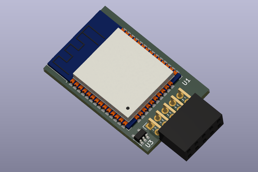

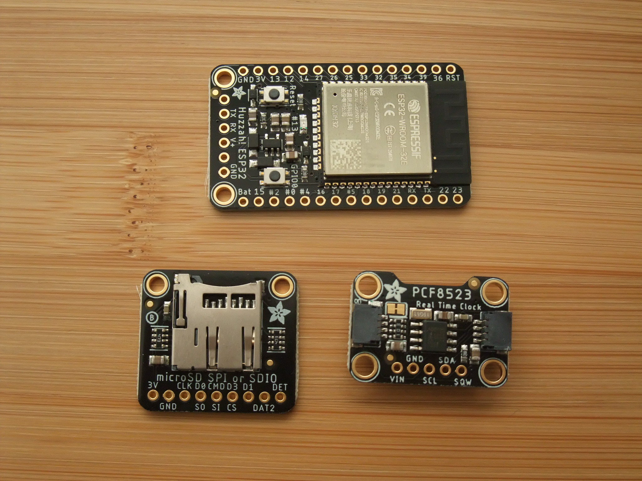

The initial plan is to put something together based on dev boards:
That's an ESP32 board, a SD card breakout and a RTC module. The Real Time Clock is to allow time stamping of recorded files to make it easier to identify which one is which.

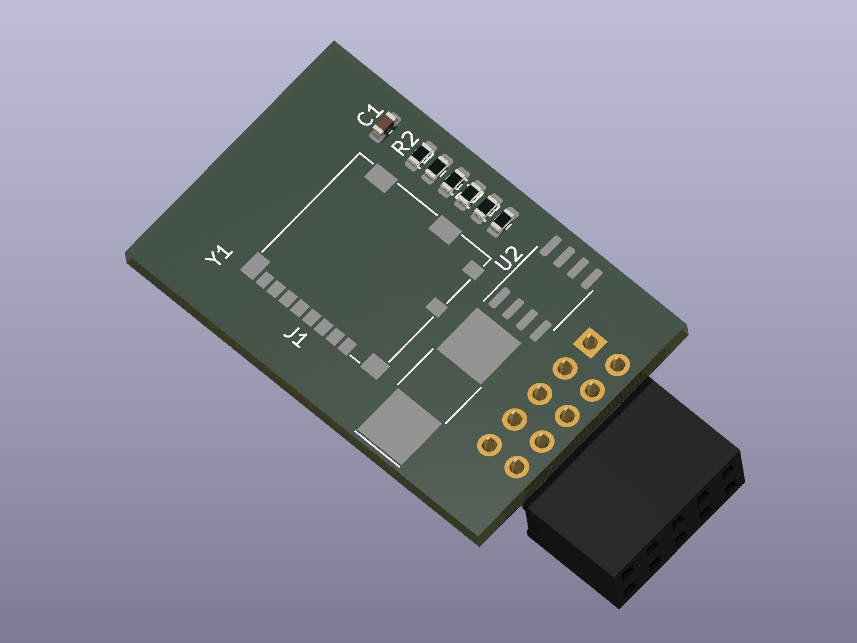

If it all works it will hopefully get put on a PCB, something like this with the ESP32 module on the top and the SD card and RTC on the underside so that it can be used in place of the current module if needed:
So, on to the questions:
There are two github repositories that I'm aware of, Johannes' latest and greatest https://github.com/jsphuebner/esp8266-web-interface and 0xBedz's ESP32 port https://github.com/Bedz01/esp32-web-interface-port which only supports PlatformIO builds and doesn't include the SWD based device programming functionality.
I'm inclined to start with Johannes as it has more recent changes, supports both Arduino and PlatforIO builds and also appears to use a more recent version of the graph plotting library and use 0xBedz's as a reference for the changes needed to move to the ESP32. If anyone has a better idea please let me know?
Johannes' build also supports both Arduino and PlatformIO based builds. Arduino is simpler to use but PlatformIO offers additional debug options if needed. Any advise on which to go with?
Finally is there anything else that we should be thinking about on this?
Edit - Another question. The logger will generate large amounts of data, far too much to process with a spreadsheet. There are a few open source data analysis packages which might do it - does anyone have any experience or recommendations here? The other option is a custom app? Final though is make it possible to import the logs into the simulator, could the simulator then be tuned to match the logs to improve the accuracy of future simulations? Are there any other options?

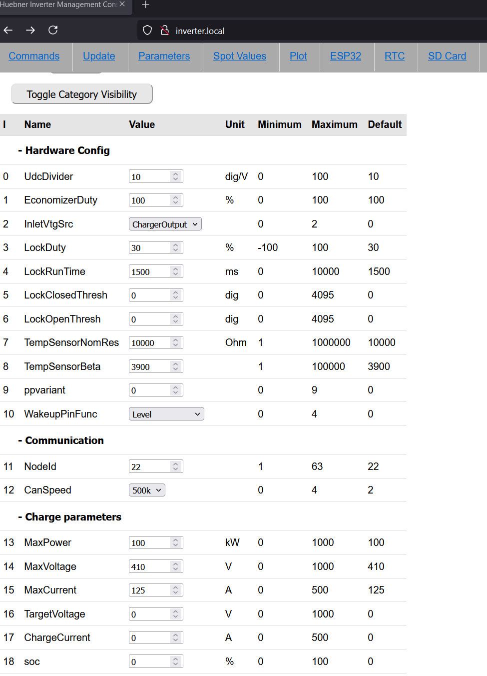

Edit - Connects to the inverter and pulls out the parameters, plots graphs and gauges correctly :) Not tried the firmware updates yet but really am going to quit while I'm ahead now!
Edit2 - Now it's working I realise why it took me a while to get the inverter moved to UART2. I was assuming that when I got it moved correctly all activity on UART0 would stop, but it didn't. On ESP reset the following debug data is still written out on UART0:

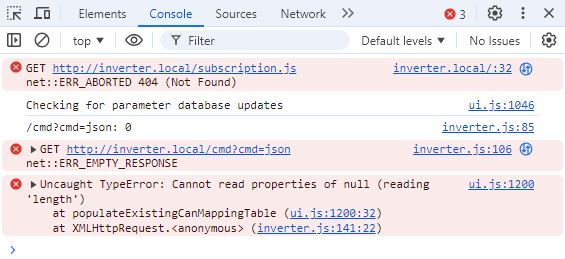

[   298][E][WiFiSTA.cpp:317] begin(): connect failed! 0x300a
[   314][E][WiFiClient.cpp:335] setOption(): fail on fd -1, errno: 9, "Bad file number"
and then when opening the gauges window (which appears to work fine) this:
[226041][E][WebServer.cpp:647] _handleRequest(): request handler not found
[226400][E][WebServer.cpp:647] _handleRequest(): request handler not found
[226488][E][WebServer.cpp:647] _handleRequest(): request handler not found
[226743][E][WebServer.cpp:647] _handleRequest(): request handler not found
No idea whether this is common to the ESP8266 too but thought it worth mentioning.

Test platform now working. External RTC is used to initialise the on chip clock on boot and that is then used for timestamping (actually a better solution as accessing the external rtc would have slowed down the file writes).
Also noticed while testing that the card write speed seemed to be slowing down as it filled up. It was still achieving 600kBps but should have been better. Bit of digging suggested that a larger block write would improve things so upped write buffer from 1k to 16k. It's now managing 5MBps :)
Need to tidy up the test app and use it to test a few other bits and pieces like file naming but once that's done it can be pushed into the web interface.
Not too sure what to do about clearing space on the card. Essentially if it fills up there will be continual interruptions to the logging as it stops to delete old files. At the moment thinking the simplest way is to clear say 2GB worth of space on the card at boot up (by deleting the oldest files, should give a few hours worth of logging) which is relatively easy to do and should cover most scenarios.

Nice :-)
Nothing wrong with relying on the user to keep an eye on free space etc (especially if there'll be a 'start logging' button)
