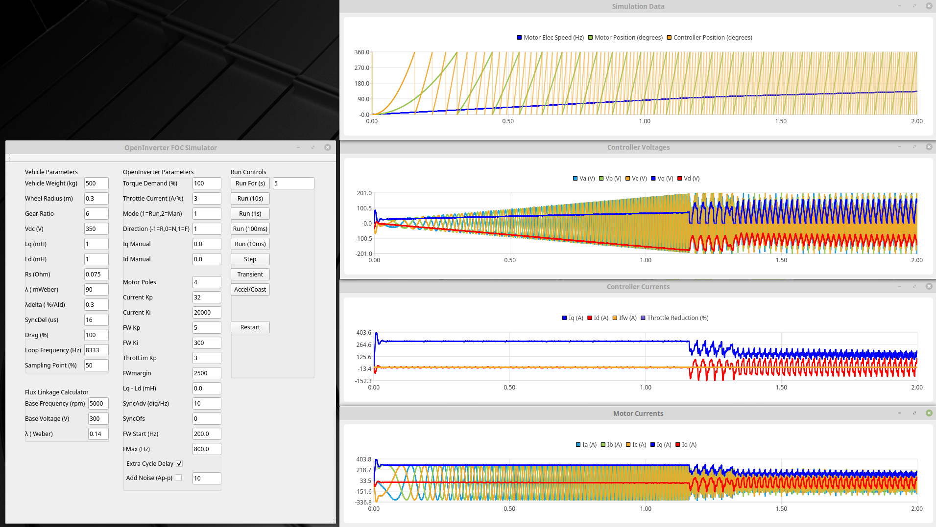

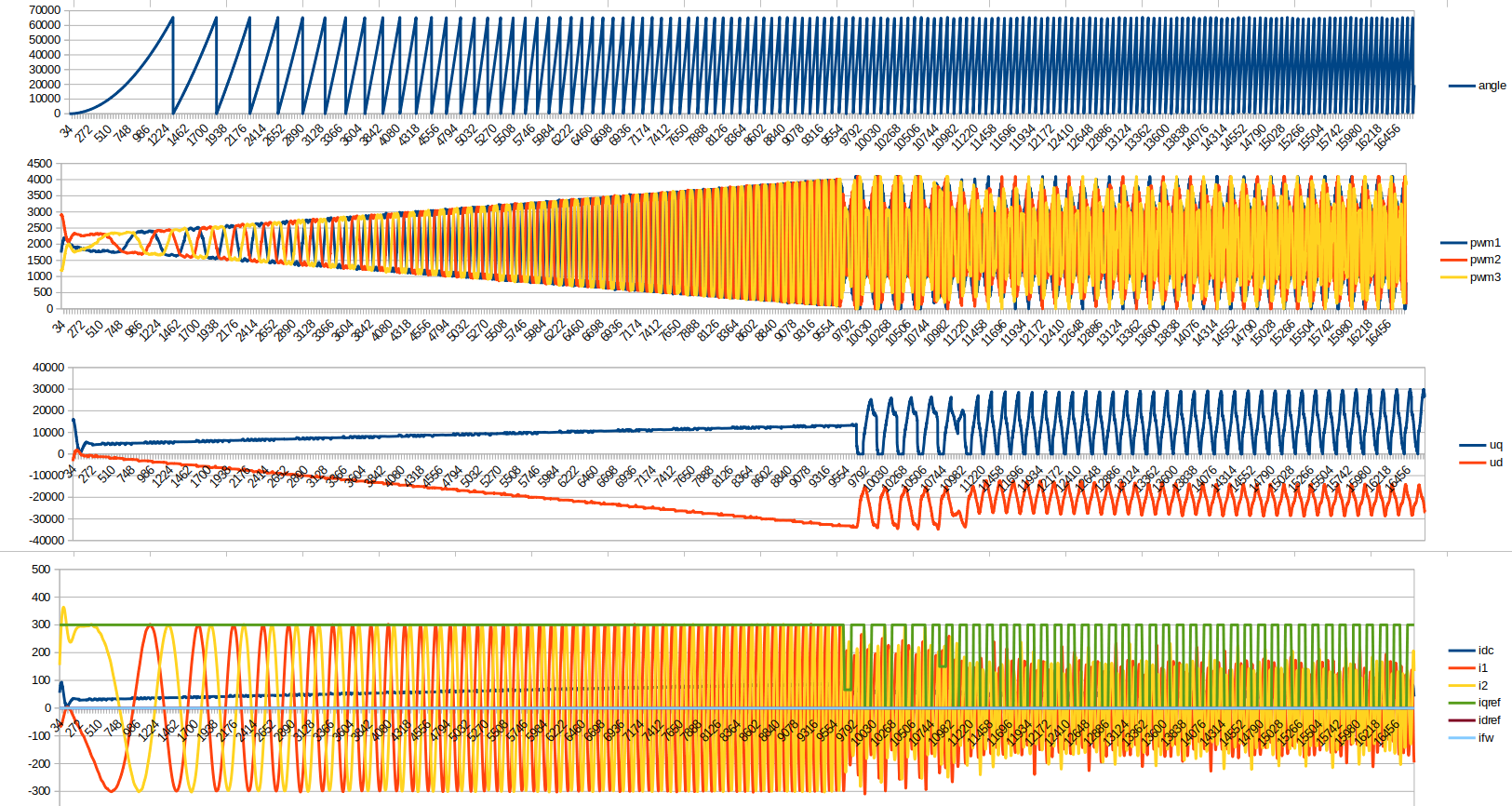

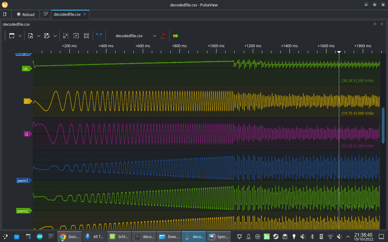

Couple of plots showing captured data. Note, this is not via a SD card, the OpenInverter logging code is running inside the simulator which is saving the data (that would normally be sent out the serial port to the ESP32) directly to hard disk. It doesn't test the ESP32 side but does check that the data is being correctly compressed by the OpenInverter code and then decoded by the decoding app.
The test run in the simulator that created the log file:
And the result of decoding the logged file to a csv and graphing in a spreadsheet:
Fairly happy with that :)
The voltages are just the raw values used within the OpenInverter firmware, it should be possible to pull the battery voltage out of the params and scale it but I haven't bothered yet. Also the Iq and Id values are not shown as they need to be calculated from the angle and the phase currents i1 and i2 (will probably do this within the decode app eventually).
What this has shown is that a spreadsheet is not going to be any use at all for processing. The above is only 2 seconds of data (around 264000 measurement points) but must have taken around 10minutes to graph in the spreadsheet!

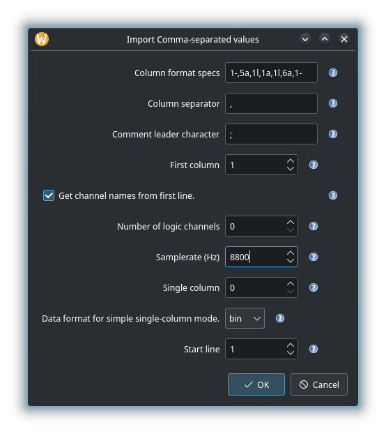

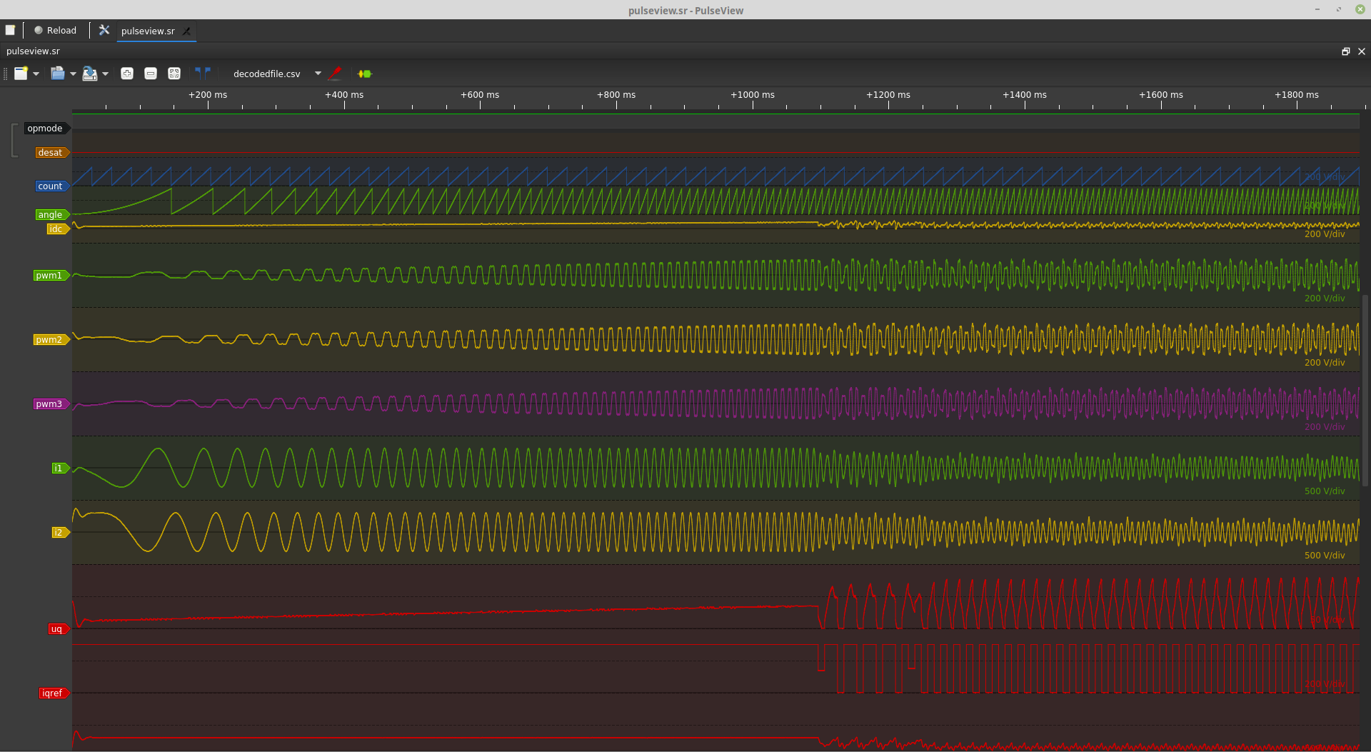

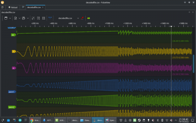

Actually, that was far too easy. Pulseview has a csv import.
Column format string: 1-,5a,1l,1a,1l,6a,- (ignore the first column - can set the samplerate assuming it's fixed, or you can input a timestamp (in seconds), 5 analog columns, 1 logic, 1 ana, 1 logic, 6 ana, ignore last column)

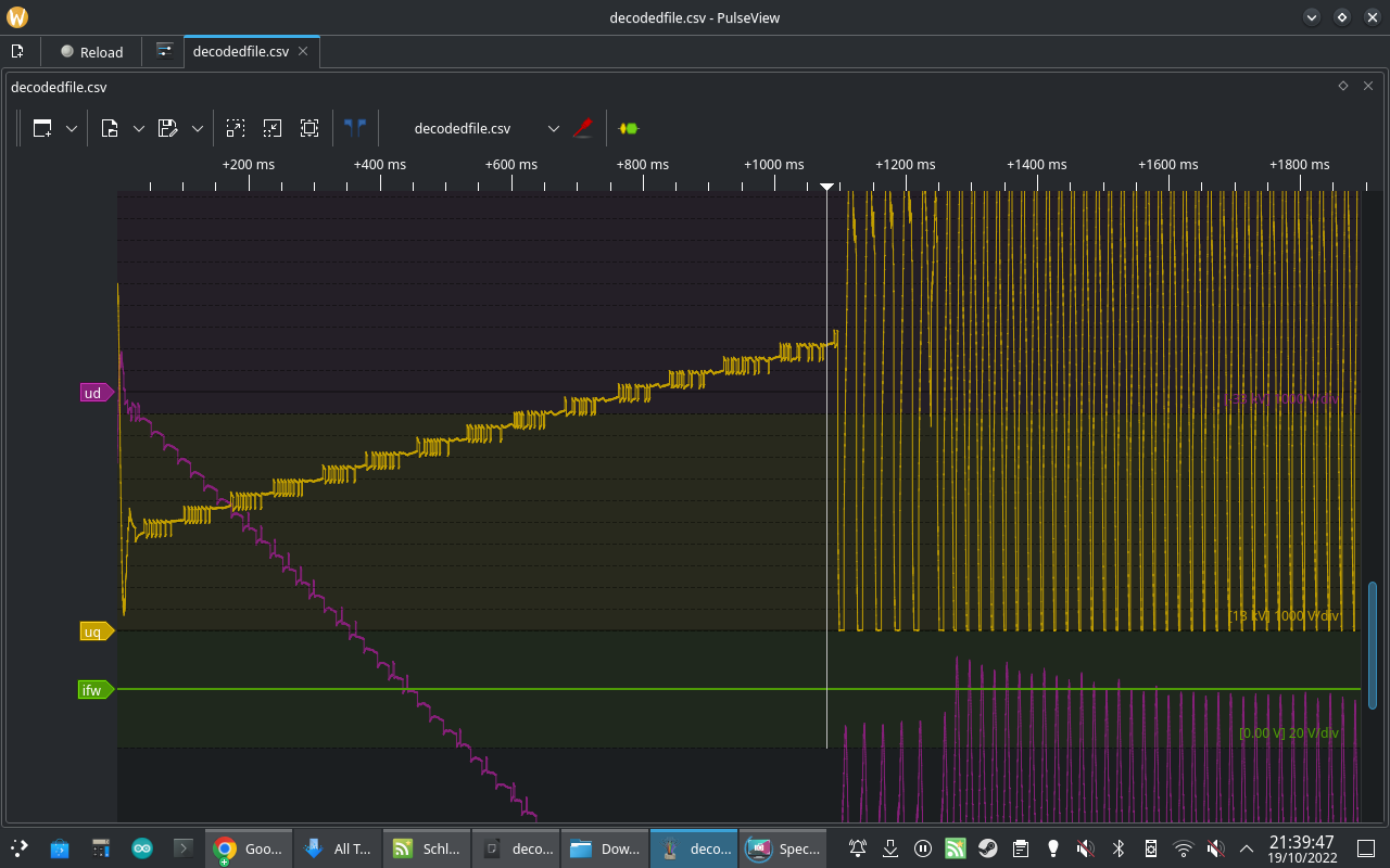

Only 2 secs of data, but opens in a blink of an eye! Need to set axis scales (more work needed here - 'Angle' would be nice to convert to degrees, a few of the variables are larger than Pulseview imagined, so need to increase the range of divisors available. Should be an easy patch). But scrolling and zooming is nice and quick, get a readout of the (approximate) values on mouseover.
Are we getting overflow on ud and uq? Or is that something weird but real happening?

Wow, nice!
Looks like I need to get it installed. Is pulseview part of sigrok or something different?
Not sure on the overflow, it should clip rather than overflow (tbh I didnt look too closely at the data, just ran the simulation with defaults params so I know the loops would have been going unstable at higher speeds). It might just be the space vector modulation, it allows uq and ud to go a little higher than expected. It's also possible that it's overflowing in the logging code, I'll have a look.

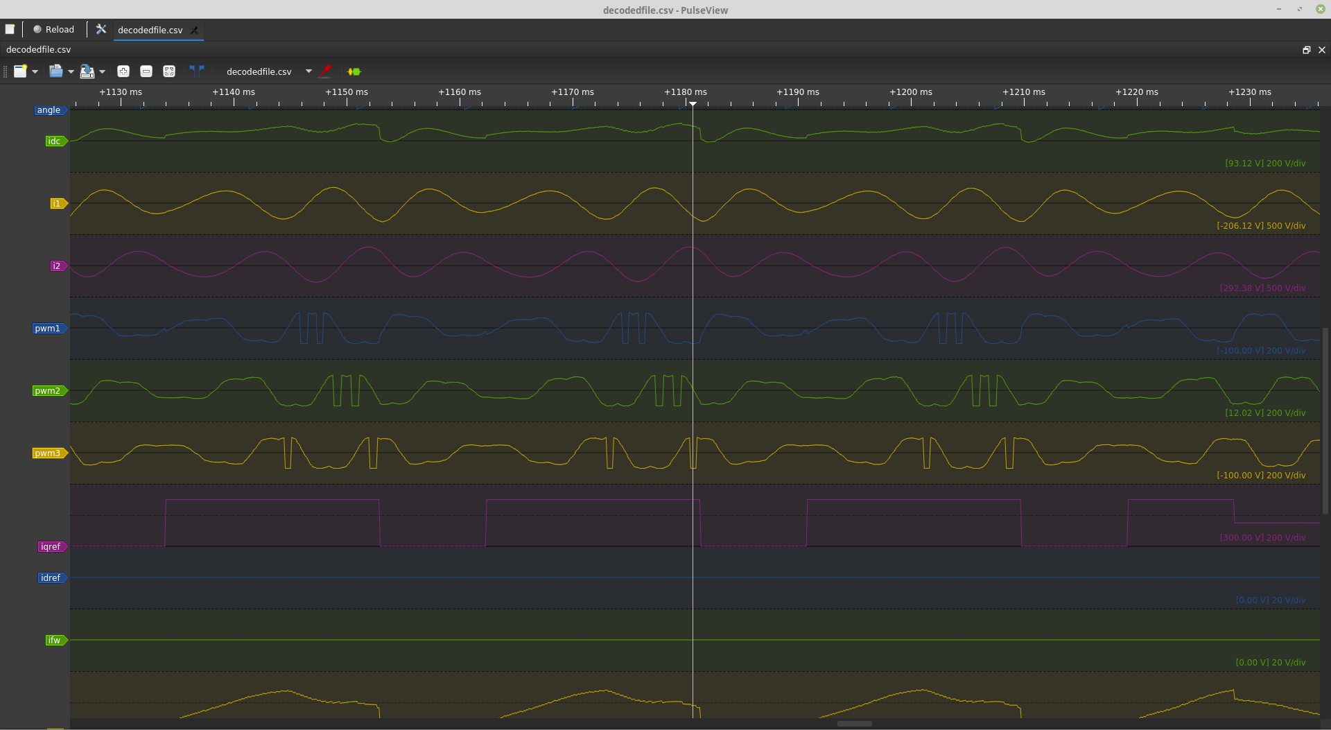

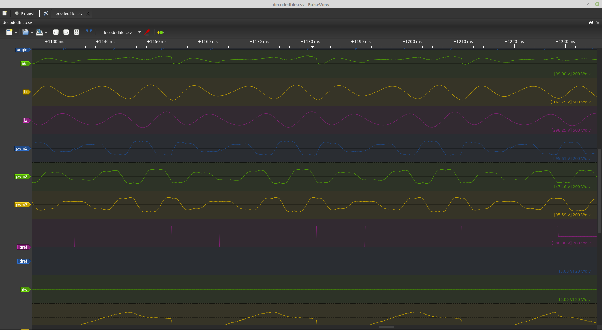

mjc506 wrote: Wed Oct 19, 2022 8:42 pm Are we getting overflow on ud and uq? Or is that something weird but real happening?
You were right on the overflow, the PWM can go over by one bit. Before:
And after fixing:
The change needed is in foc.cpp on line 154. Need to change
else if (DutyCycles[i] > maxPulse)
         DutyCycles[i] = FP_FROMINT(2);
to
         DutyCycles[i] = (FP_FROMINT(2)-1);
Think there is still potential for overflow on these lines too, not sure whether they are the cause of the above test being true (it should never be)?
   s32fp ua = (cos * ud - sin * uq) >> CST_DIGITS;
   s32fp ub = (cos * uq + sin * ud) >> CST_DIGITS;
Johannes did suggest a change for these previously which I need to find and include too.
Edit - here is the suggested fix viewtopic.php?p=44583#p44583, removed the -1 above and tried this instead and still get the overflow. @johu - probably safest to include both fixes going forward?

Think that's about it for now :)
The column format spec is now "1a,5a,1l,1a,1l,6a,1-,2a". It still needs the frequency adding. The message count is now included on screen as a sawtooth waveform; it should be visually pretty clear if there is a discontinuity there caused my missing/corrupted messages.
The stm source is updated in github to fix the bugs mentioned above and the decoding app now formats everything as described in the above posts. It also calculates iq and id and includes them in the csv. It will need a LOT of tidying up at some point, and probably a gui adding to allow filenames to be selected, but it will do for now. It's not worth creating a github repo for this code, it's just one qt file, so will just include it here instead:

Please don't look too closely at the code, I know it's untidy and could probably be better structured, implemented, commented, etc., but it will do for now (especially if it gets ported to a pulseview importer)
Big thanks to mjc506 for suggesting pulseview, it looks ideal for this :)
Edit - Ohh, and here is the latest format csv in case anyone wants it for testing.
decodedfile.csv
(1.63 MiB) Downloaded 48 times
Edit2 - just had a look at the pulseview .sr file. It has one metadata file which contains details of the waveforms displayed (can't see any units or graph scaling data though) and then a binary file containing the data for each waveform. The waveform appears to be stored as sequential 32-bit floats, one for each measurement point, so should be fairly easy to create. Also worth noting is that the .sr file is around a third the size of the .csv file!
Edit3 - for reference https://sigrok.org/wiki/File_format:Sigrok/v2

Awesome, fantastic work :-)
Ah, apologies, might have been the WIP v3 sigrok format that had units and scaling. Or I'm imagining things! Your app fixes the scaling though, and having 'V' floating around isn't the end of the world really. (Just name each 'channel' as "IDC (Amps)" or something worst case :) )
It doesn't look toooooo hard to create an SR file? I think the metadata file includes the size of the binary one, so a bit of counting etc, but the savings in file size might be worth while...
Edit:
Ah, apparently it's the libsigrok "device" that includes units, scaling etc. Doesn't look like PulseView pays any attention (yet) though, certainly to units. It's either Time, Logic, or Volts haha. The Sigrok wiki claims there is 'an easy API' for new devices/input modules... I'm yet to understand the csv one yet hahah

The .sr file looks like the best way to go as it avoids the need to remember configuration strings and set the frequency. Creating the files should be pretty easy, not sure how to do the zip in a platform independent way though?
For now what we've got is perfectly usable. It's also a lot better, and took a lot less time, than I had expected, pulseview works really well for this :)
The only downside is it makes the graphing on the simulator seem pretty crude by comparison ;)
Edit - there is one other thing that might be worth adding, at the moment it only works with foc builds. It would make sense to add sine support too but I don't have a clue whether there is a real need and if so what fields would be useful to log?

Does seem to be the route of least resistance. I'm certainly no expert, but my first thought would be lib7zip or similar. Far too powerful, but open and multiplatform.
They've put a lot of effort into showing many many points while keeping things quick! I understand none of that code haha
I've only ever used sine for lightbulb tests to be honest. Not sure what'd be useful, but seems fairly straight forward to add in later if needed?

TBH I was expecting the graphing side to be a bit of a nightmare. Going back a few years there was a project at work that needed fast graphing of large datasets, I lost track of how much time we spent on it and how many different commercial libraries we tried before finding a solution. I reckon that pulseview is possibly faster than the one we ended up paying for! Very relieved that just works so thanks again for suggesting and trying it :)
The sine support would be easy to add, just a new structure definition and function to fill it. Unless anyone expresses an interest will leave it for now though.
Looking forward to trying it on real data!
