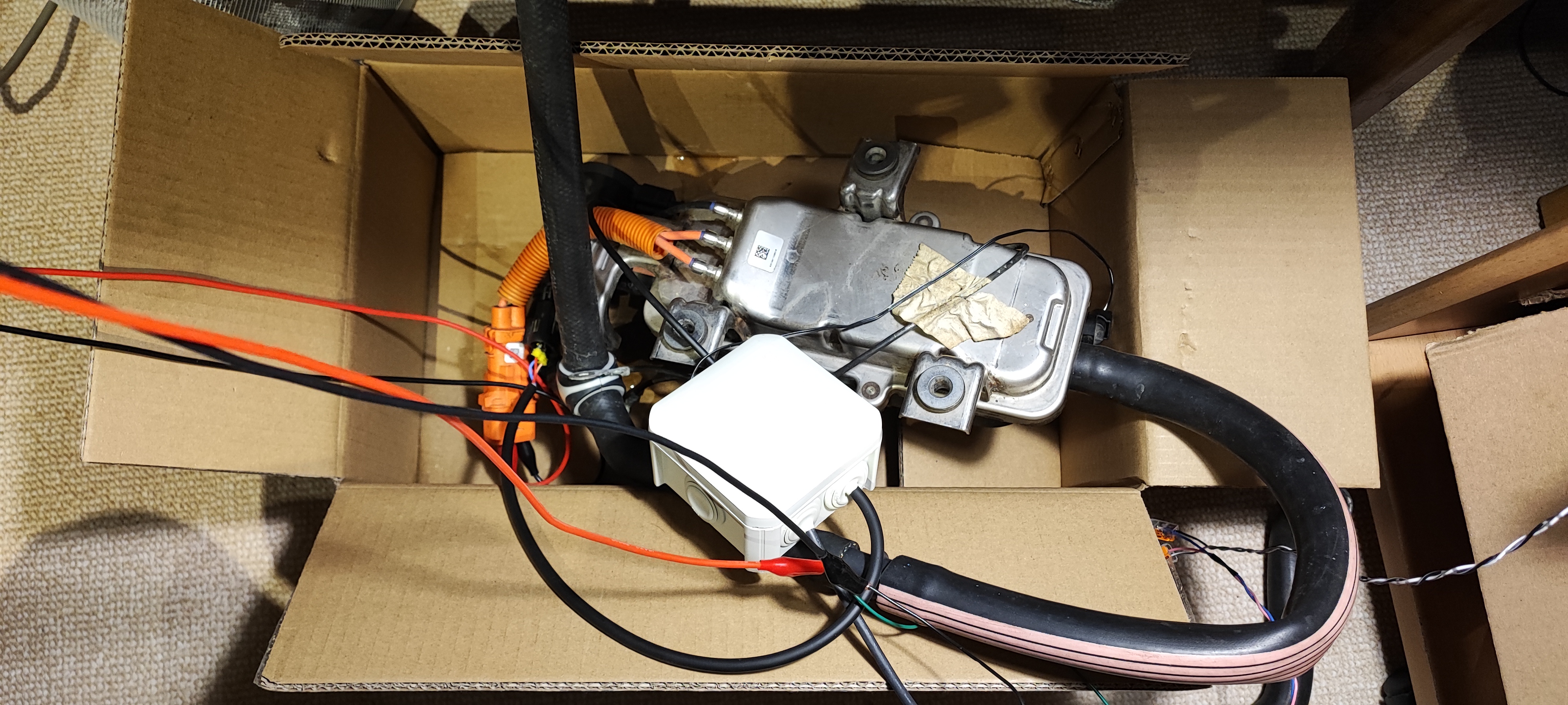

Does anyone have this Eberspacher heater (type 22851153) response messages from this 5kW heater? I'm able to wake heater up as it start to send response messages, when sending more command and keep alive messages it keep sending messages but most bytes are zeros - input current does not rise and no heat. Tried few slightly different messages scheme I found, also stm32-vcu one. Damien have same heater installed, so should work - or perhaps he have it only for the show??

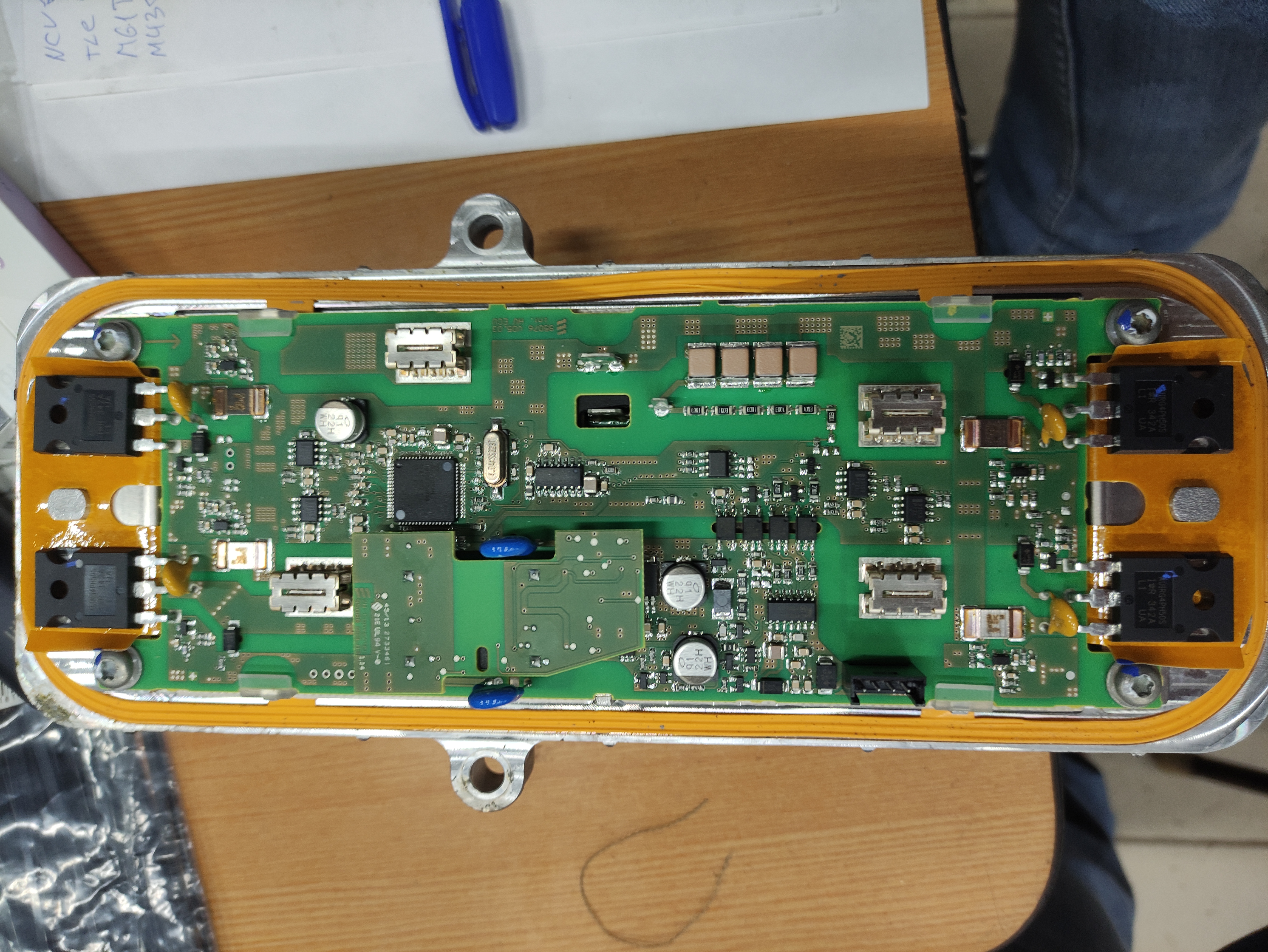

I read these heaters fails, maybe I got bad one? Is there any way to confirm? Of course I installed this under the battery, so almost impossible to remove.
Really soon I need to get some different heater as its getting colder... Maybe CAN controlled Mitsubishi could be one?
I send wakeup 0x100 only once and rest messages listed on https://openinverter.org/wiki/Chevrolet ... ter_Heater are sent one message at a time in a loop every 10ms each (tried 5ms too), so all messages are send every 100ms (or 50ms if message send every 5ms).
I did try ZombieVerter heater messages with same results.
Here is what heater will send back in HEX:

0x1047809D byte 2 seems to be some kind of counter, it will rise slowly higher, nothing else changes.
If I do not send keepalive message 0x621 after wakeup, heater will send this message six times and go back to sleep, as predicted:

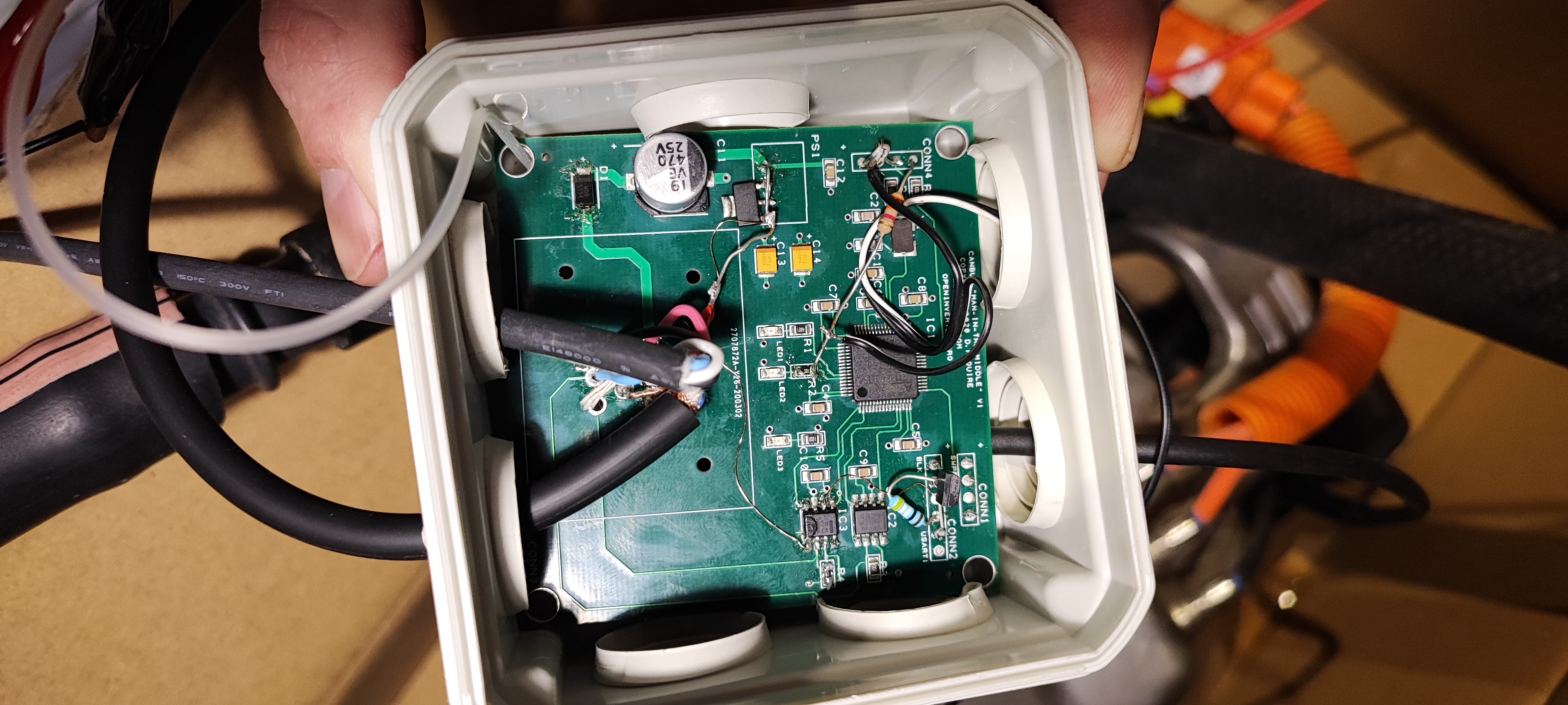

Hello everyone!
I have been trying to run two liquid heaters from Chevrolet volt 1 for a long time. I found one startup instruction and two projects for a microcontroller on github. I use CAN Hacker to send commands via SWCAN, this is a USB-CAN device. I send commands the first time after powering on the heater and it responds to me. If I don't communicate, it falls asleep and I have to turn off and on the 12V heater power. I know I can wake it up with an hv signal to the CAN bus, but I don't need to wake him up right now. For high-voltage power supply, I use a 350-400 V, 2 A power supply. Yes, it doesn't have enough power to work, but I will see an overcurrent if it starts. I really need advice on what I'm doing wrong, why the heater does not start to consume current when giving commands. I used the following code to run:

Timings were from 30ms to 100ms between each message.

I made small SWCAN board connected to DUE and playing with it.

I was able to get my Volt heater heating up with the instruction given here . Special thanks to Thyristor for posting the CAN log.
My first test setup was somewhat hacky with temporary wiring so after the successful test, I pursued to make the final connections and wiring.
Unfortunately I was not able to source the correct HV-connector so I decided to replace the 2-pole connector on the heater with some solar panel connectors.
I am quite sure I got the (+) and (-) pole right, but as the OEM connector is now detached and next step is to connect HV, I started hesitating and would like to double check...
So, can someone please confirm. When looking at the heater housing, one of the HV wires is coming from the center and one from the side. Is the center one the HV(+), i.e. pole A on the 2-pole connector?
