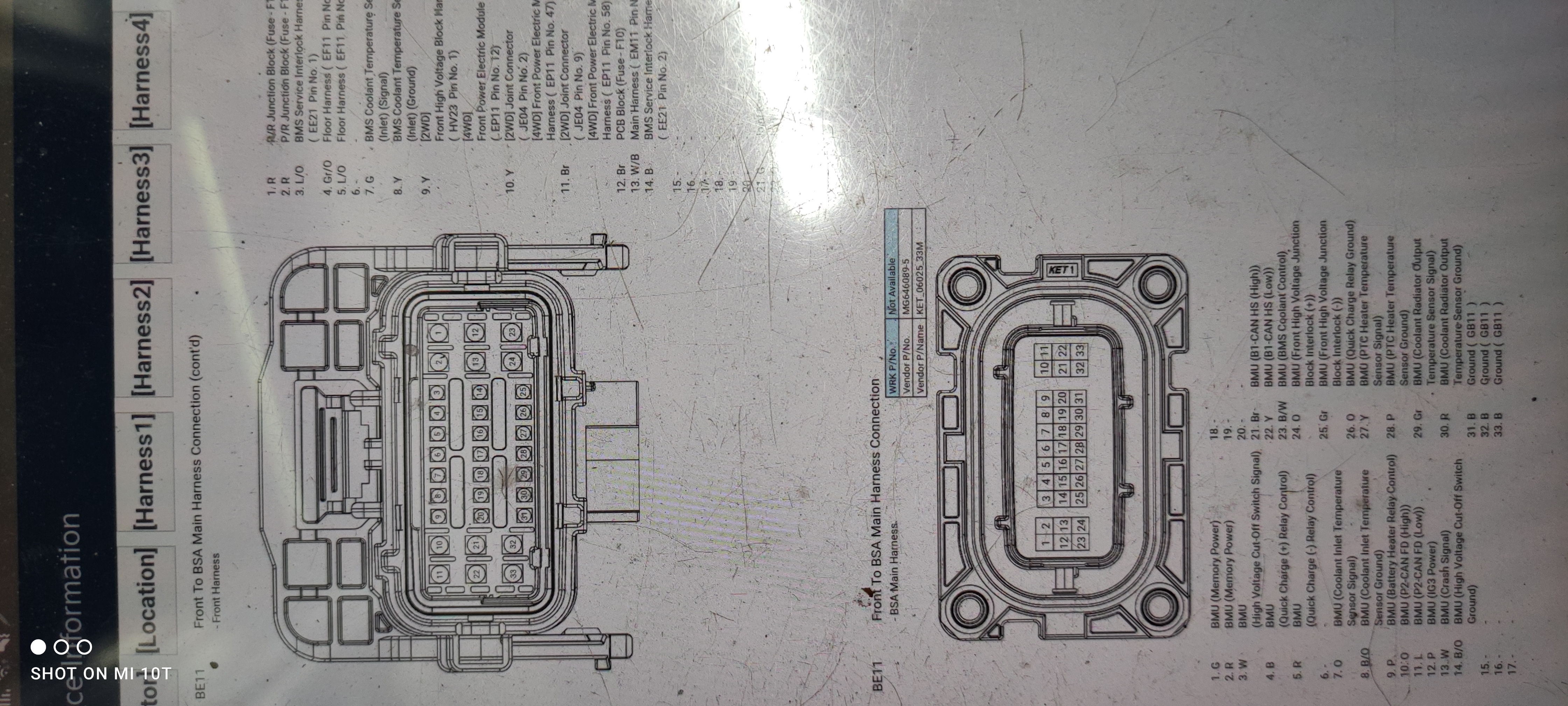

powercontrol wrote: Fri Jul 21, 2023 6:29 am Hello Royboy, any luck by checking my EB11 wiring sheet?
I am unable to get any life out of mine either.
At least looking at the Ioniq 5 "BMU extension connector" external wires, my pin 13 is brown, and my 11 is brown and 10 is yellow (10 and 11 twisted together). According to the Hyundai docs, the BMU has 4 connectors, two with 24 pins, two with 20.
projectgus wrote: Tue Sep 13, 2022 5:04 am the pinout (Kona connector number EB11) is:
| 11 10 |   9  8  *  *  5  4  3 |  2  1 |
|  * 21 |   *  *  *  *  *  * 14 | 13 12 |
| 33  * |  31 30 29 28 27 26  * |  *  * |
EDIT: ASCII art seems to only work in some browsers, so here's a screenshot of the ASCII art!
(This might be mirrored left-to-right for you, I wrote it down based on the harness connector. My car is still mostly intact so I haven't verified it.)
Here are my (unverified) notes on the external connector pinout:
  • 1 & 2 - Memory Power 12V (powered all times, 15A BMS fuse)
  • 12 - "IG3" relay power 12V (on when vehicle is "on", 10A fuse)
  • 10 & 11 - P-CAN High & Low (powertrain CAN, main control channel for BMS)
Inside the battery pack, most of these connections run directly from this external connector to the main BMU module connector.
BTW, if you're in EU or some other places then you can pay 15 Euro to Hyundai Global Service Way then you can access the exact schematic diagrams, connector pinouts, etc for the Ioniq including schematics for inside the battery pack. The above is from notes I took while looking there.
Looking from the outside, at the back of the BMS extension connector, the pins are 180 degrees opposite your diagram for the Ioniq 5. At least I think so anyway. I connected the pins in the list above, as well as all black wires to ground (also tied the battery chassis to battery ground), and tried different bus speeds, with and without termination, but don't get CAN traffic. I also tried all the other twisted pairs of wires coming out the connector just in case too.
I am in the US and signed up for https://www.hyundaitechinfo.com/default.aspx ($40 for a week) and cannot find a schematic or pinout for this connector ( they refer to it as the "BMU extension connector" ), only the connectors on the internal BMS. My next step is to open the battery and trace those out the the external connector.

Interesting, cgalpin. The Ioniq 5 has the 600V traction pack and related HV systems, doesn't it? So it's possible it doesn't share a legacy with the Kona, earlier Ioniq, etc. Although at the same time I'd be surprised if it's completely different.
For the Kona pack, if all the 12V is attached and the CAN is terminated properly then I think it starts sending messages pretty much immediately.

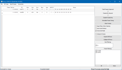

I got a new can board and verified it's working on a known setup - a gen1 nissan leaf pack I have.
But still no luck getting any messages from the ioniq 5 bms. I have traced all the wires on connector C of my BMU other than the "SDU_ Wake Up", looped all the interlocks, and tried both CAN pairs with and without termination, but nothing. The best I have gotten is seeing car scanner send messages to try figure out how to connect to it (without any luck).

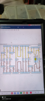

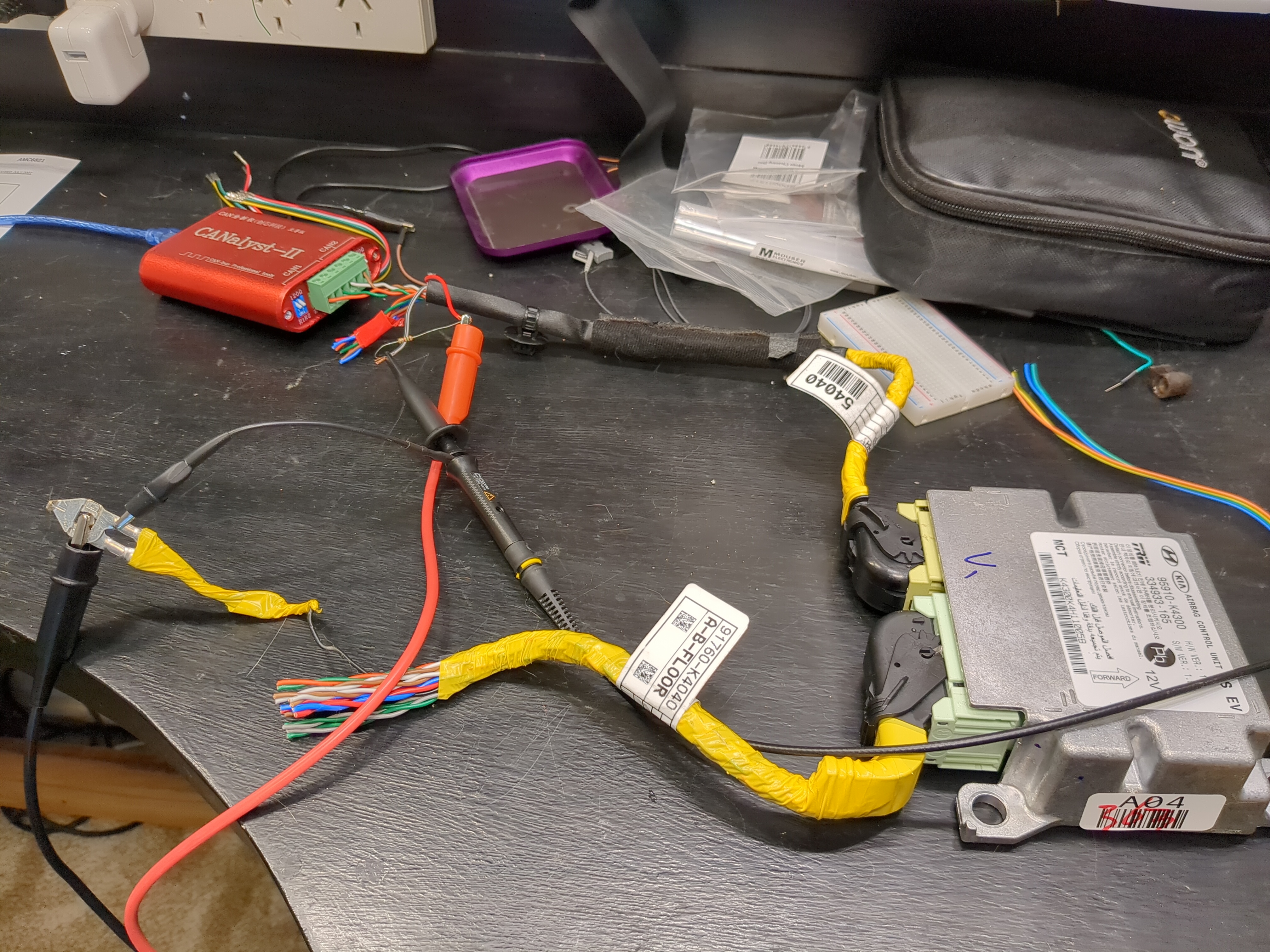

@elco was private messaging me about the Kona battery pack and brought up the crash SRS signal (pin 13, white and black.) I'd been ignoring this signal but it seems likely that it might need to be valid in order for the BMS to close contactors.
(@maciek16c I don't know if the Santa Fe PHEV has this same input? If you got yours working without it then maybe it's not needed after all.)

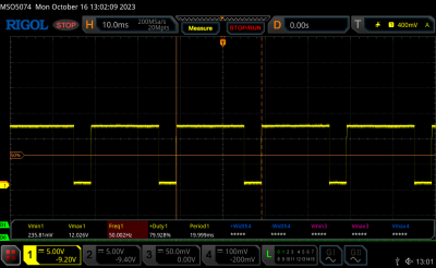

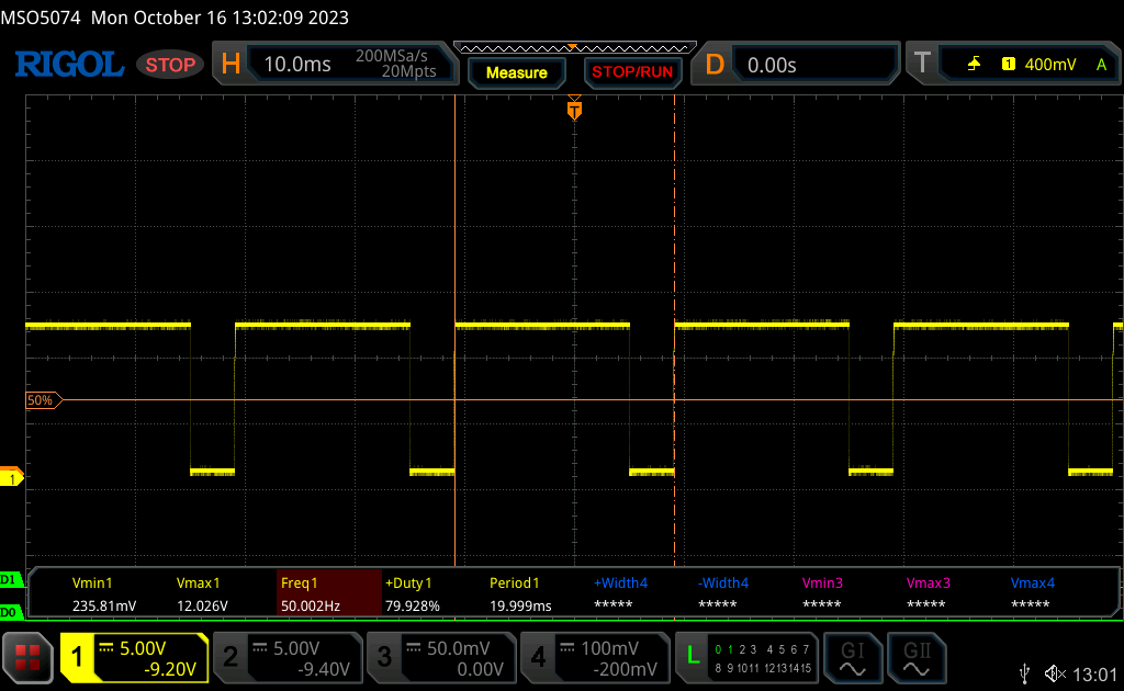

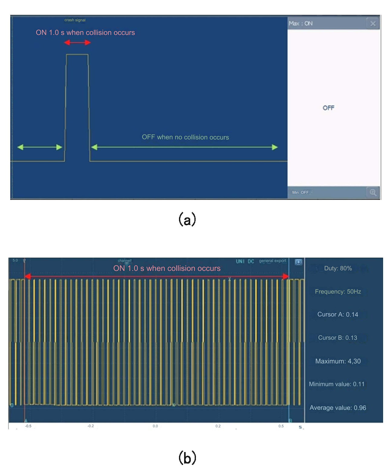

I have a SRSCM (also known as ACU - Airbag Control Unit) here so I powered it up on the bench with nothing else connected and looked at the "Crash Signal" output:
It's 50Hz 80% duty cycle PWM signal. The output from the SRSCM is open drain and needs to be pulled up at the receiver (I expect the battery pack will pull this up, but it might not as this signal is also wired to the BCM.) EDIT: On my Kona pack this signal is pulled up to ~12V at the battery end.
80% may be a "crash" duty cycle, as the ECU has nothing else connected to it in this test. However, digging around a bit more I found this Korean patent issued to GIT Auto (who supply Hyundai) which includes a diagram showing a high duty cycle 50Hz PWM signal (could be 80%) that switches to a 20% PWM signal for 1 second in order to signal a crash:
(Google Translate of the diagram.)
So 80% might mean "no crash". Or the BMS might be happy to not see any signal here...
Have also posted the CAN log for the SRSCM bench test.

Santa Fe has the same SRS input on pin 13. It wasn't needed to close contactors but maybe bigger (full EV) battery needs it?

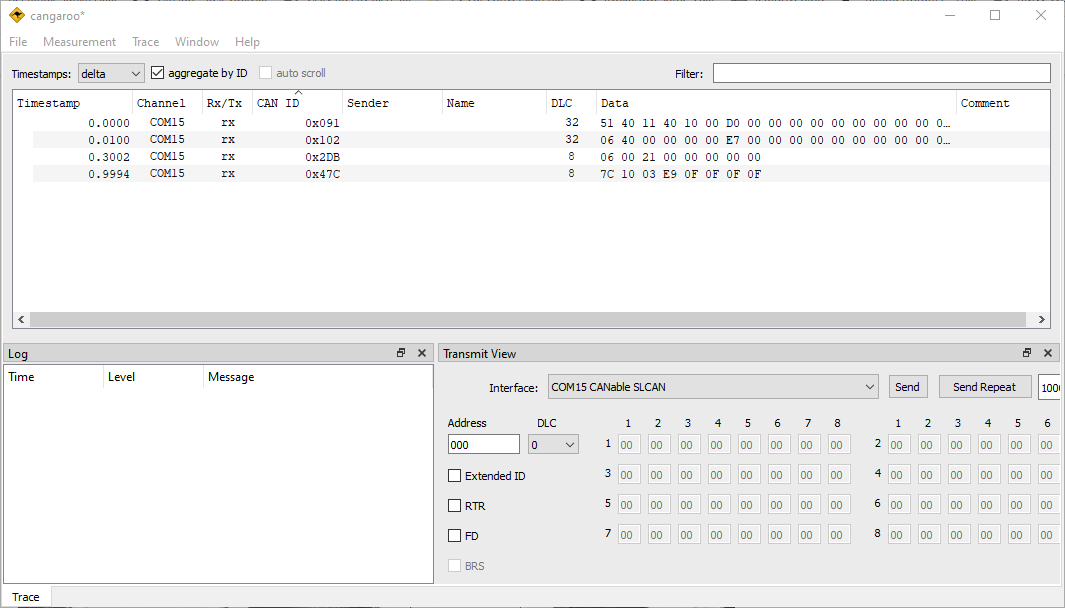

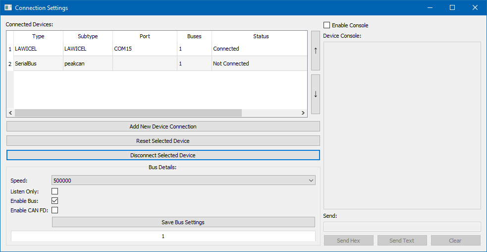

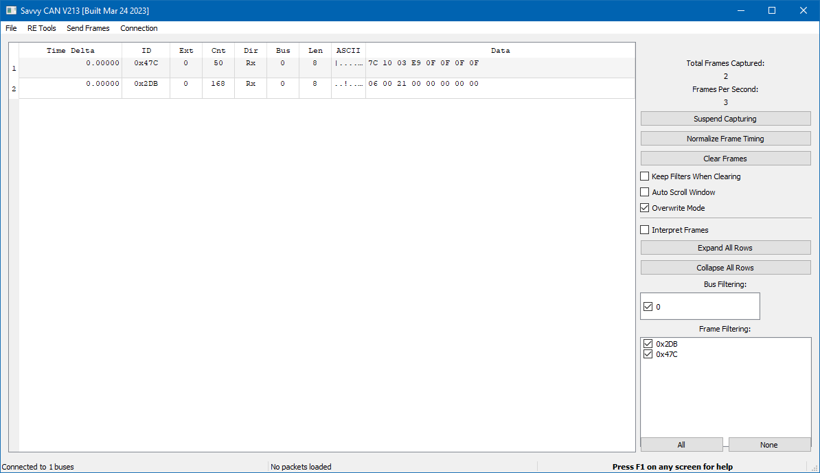

@cgalpin There could be problem with Savvycan CanFd support. It has to be enabled in connection window but it's only shown when supported canfd interface is selected (using qtserialbus so peak can and few others):
https://github.com/collin80/SavvyCAN/bl ... 19-L401C19
I have Canable v2 and savvycan sees only frames <= 8 Bytes long because it isn't possible to enable canfd in connection window.
Cangaroo shows all frames correctly
I used Toyota Yaris IV iBooster for testing

Yes I believe you are correct. In fact when I got my new CANDue I did notice a difference in serial log output using the CAN-FD connectors and Collin even explained it could be due to CAN-FD messages but I guess I didn't understand :). What I now believe was happening was it was seeing CAN-FD messages but it can't handle them and they never made it to the UI!
I am still not clear on the status of CAN-FD support in SavvyCAN but i'll try find out.

SavvyCAN partially supports can-fd but there are some functions missing and when i try using frame analyzer it crashes. I had to load log from other application to see 32 byte frames. Canable works for me, but when using slcan firmware timestamps in savvycan are missing.

Just noticed this. Sorry @projectgus for the continued derailment of this thread. I could start a new one for the Ioniq 5 battery and continue there if you'd like, but can't move the existing messages over myself.
