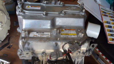

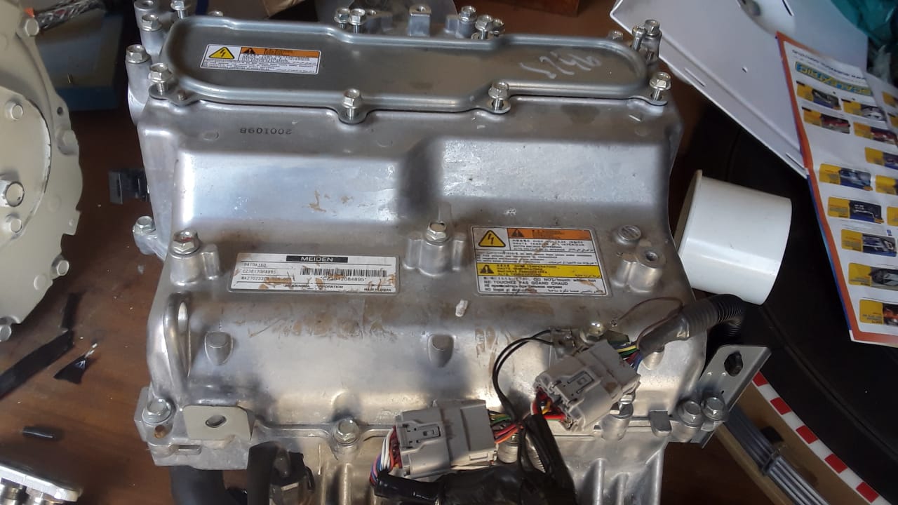

I have purchased the generator and inverter and the throttle. i now need a VCU board to make the inverter control the motor.
I know Tom Cheesewright used the zombieverter board to control Prius inverter with generator motor.
Will the Zombieverter board work with the Mitsubishi generator and mitsubishi inverter?
As i don't know Arduino or any programming - is there any simple controller i can buy?
Much appreciate any help i can get.

Tom (and Jamie) used the Prius inverter plus the Damian board with the front generator, but it's not really to be recommended as I believe the peak power Jamie got was only 42kw and it's rated for 60k in OEM form.
As for turn key solution without deep programming the zombie is your best bet.
Otherwise it will be time to learn Arduino

Zombie board will only work with OEM inverter motor pairs, e.g. Outlander rear motor and rear inverter or outlander front motor(s) and inverter, Toyota motor and inverter.
Looks like you have the front inverter and generator, a zombie board will control it. You might get more from the motor with the OEM control than I manage with the prius inverter, it would be good to know if it does. Based on my experience with the single motor to my gearbox, I wouldn't recommend starting a project with it.
I have the other motor and gearbox spare if you are wanting to go the route of using both.
Where about's are you? You can have a drive of the beetle for a feel for what the motor can do..

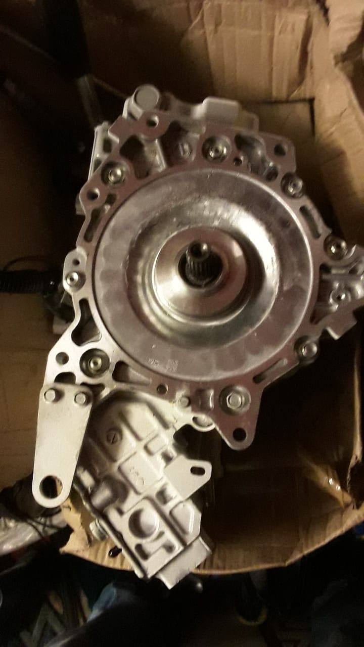

@ rstevens81- I intend using the generator in a Tuk Tuk. Will it be enough power to move a Tuk Tuk that normally uses a 200cc engine.
@ Bigpie - how much do you want for the other motor and gearbox spare?
- Posts: 1595
- Has thanked: 75 times
- Been thanked: 305 times
Re: Mitsubishi Outlander generator motor and inverter
Itll be awesome in a tuktuk.
You can have gearbox and motor for £100 to put towards my motor upgrade unless you have a motor you want to trade

Sounds like a good idea. How heavy is it? i bought the generator and inverter in the UK and brought it back with me to South Africa.
Hoping it's not too heavy to fit in my luggage - we planning on coming to visit outlaws in UK around November

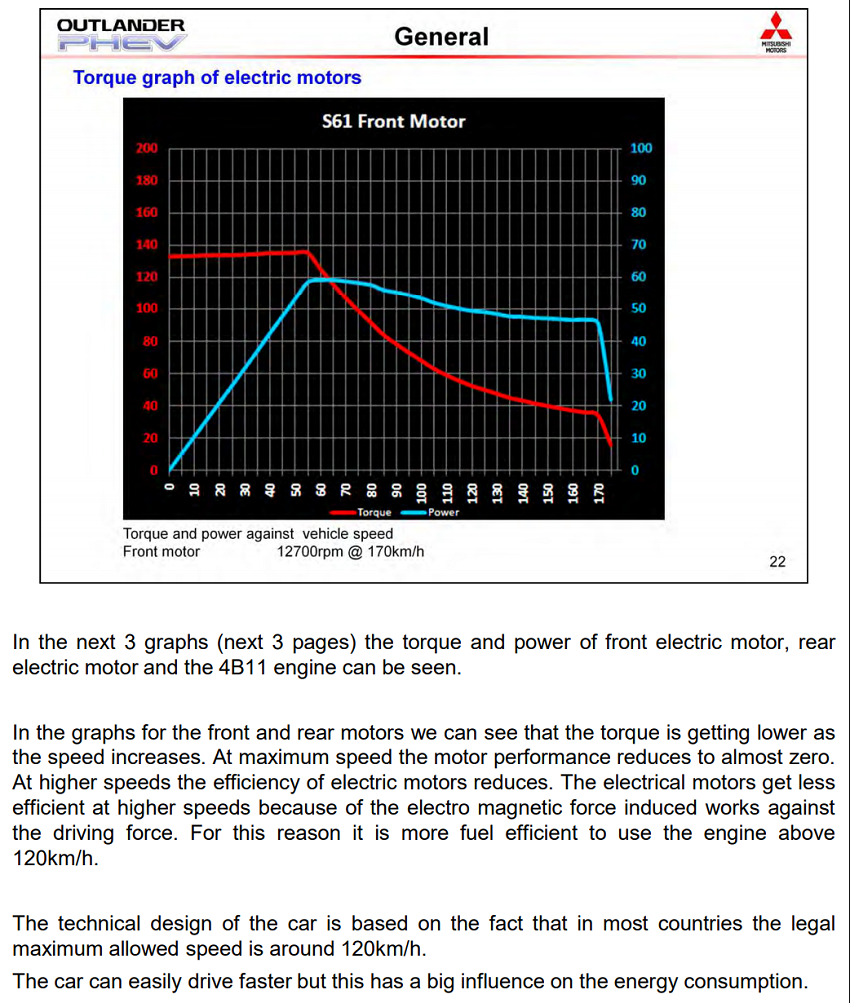

That would be insane in a tuk tuk, should be plenty if the gearing is low enough, to the extent that wheelies could actually be a problem .
Here's a graph of the front motor stolen from Google with maths since we know power and torque you can calculate rpm.

I am getting a bit confused. Is zombieverter and arduino two different things? I thought that i have to buy a zombieverter and arduino is the program that controls it. And i don't know one thing about arduino.
Zombieverter (by Damian) is a VCU that will control the inverter, this is what you want if your not programmer saavy.
Arduino IDE is a programming language that can be used to program little hobbiest boards (originally they were Arduino boards such as Arduino mega,Arduino due etc, but now many boards) these can be used to work with can bus with additional chips but since your not from that background I wouldn't recommend it as you'll need to quite a bit of learning and experiments.

Motor is sane weight as generator. Gearbox is probably 50kg.
Zombie VCU is an external board, used with OEM control mechanisms and so only intended for motor inverter pairs. No tuning and configuration configuration required. This is probably your best bet as you have the inverter and motor from the outlander.
Myself and tom have mixed prius inverter with Outlander motors, and a replacement logic board that goes inside the inverter and takes direct control, so any motor can be used, but needs tuning and configuration.
