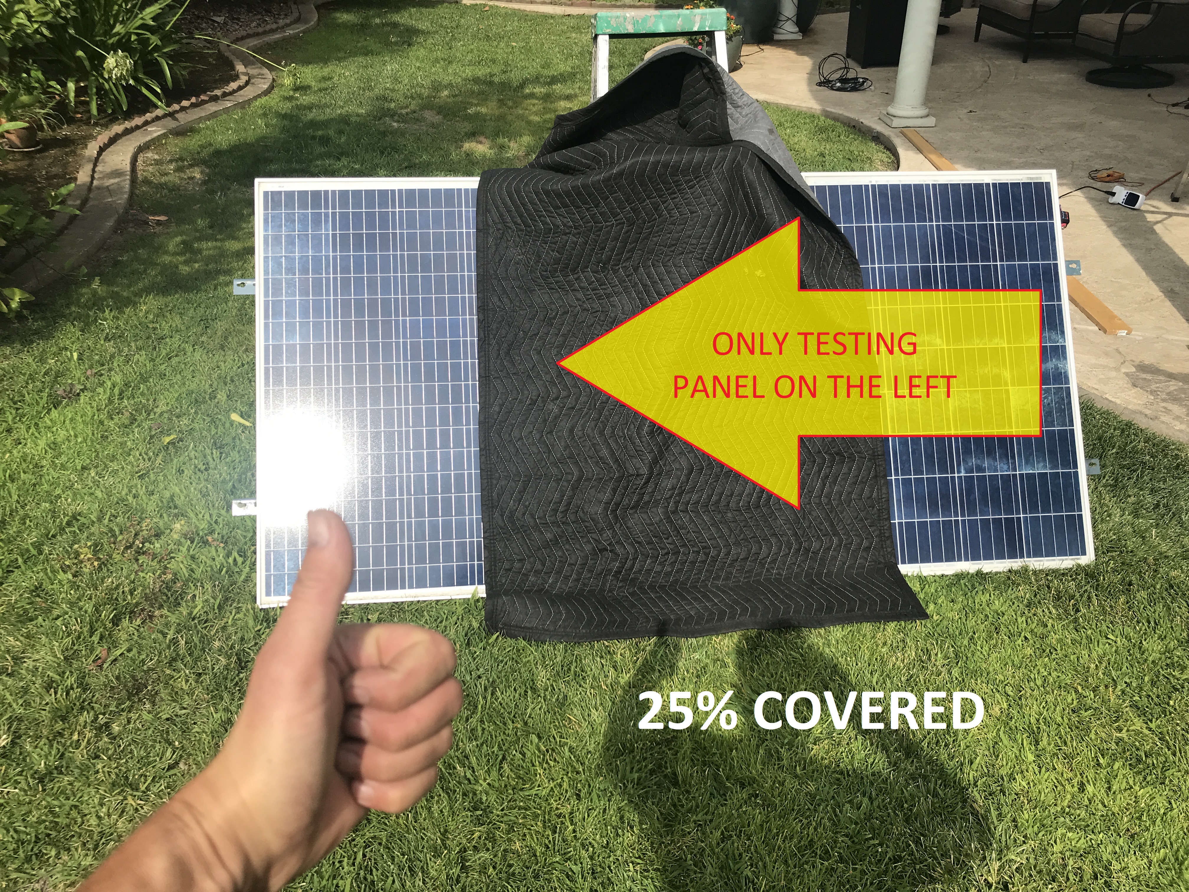

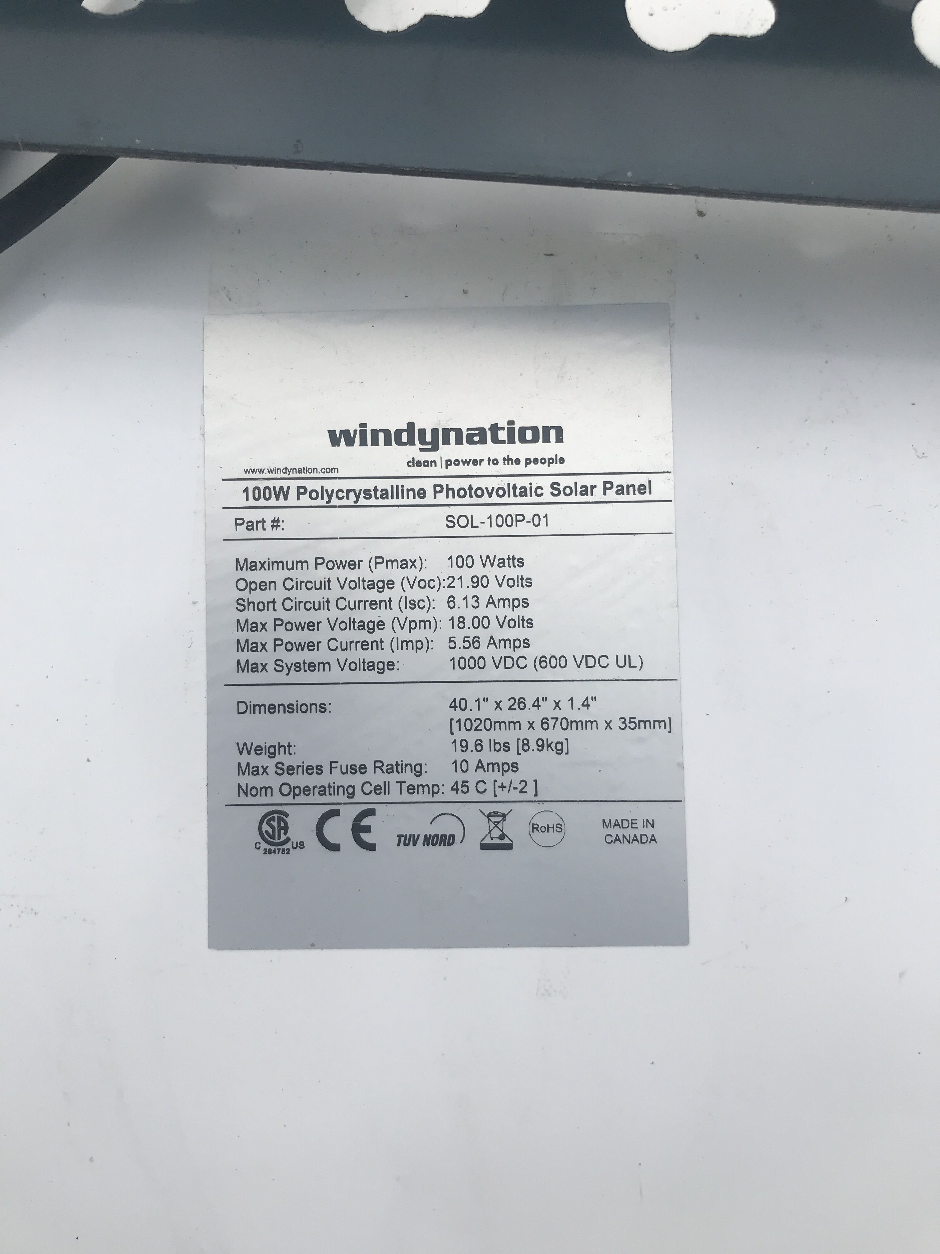

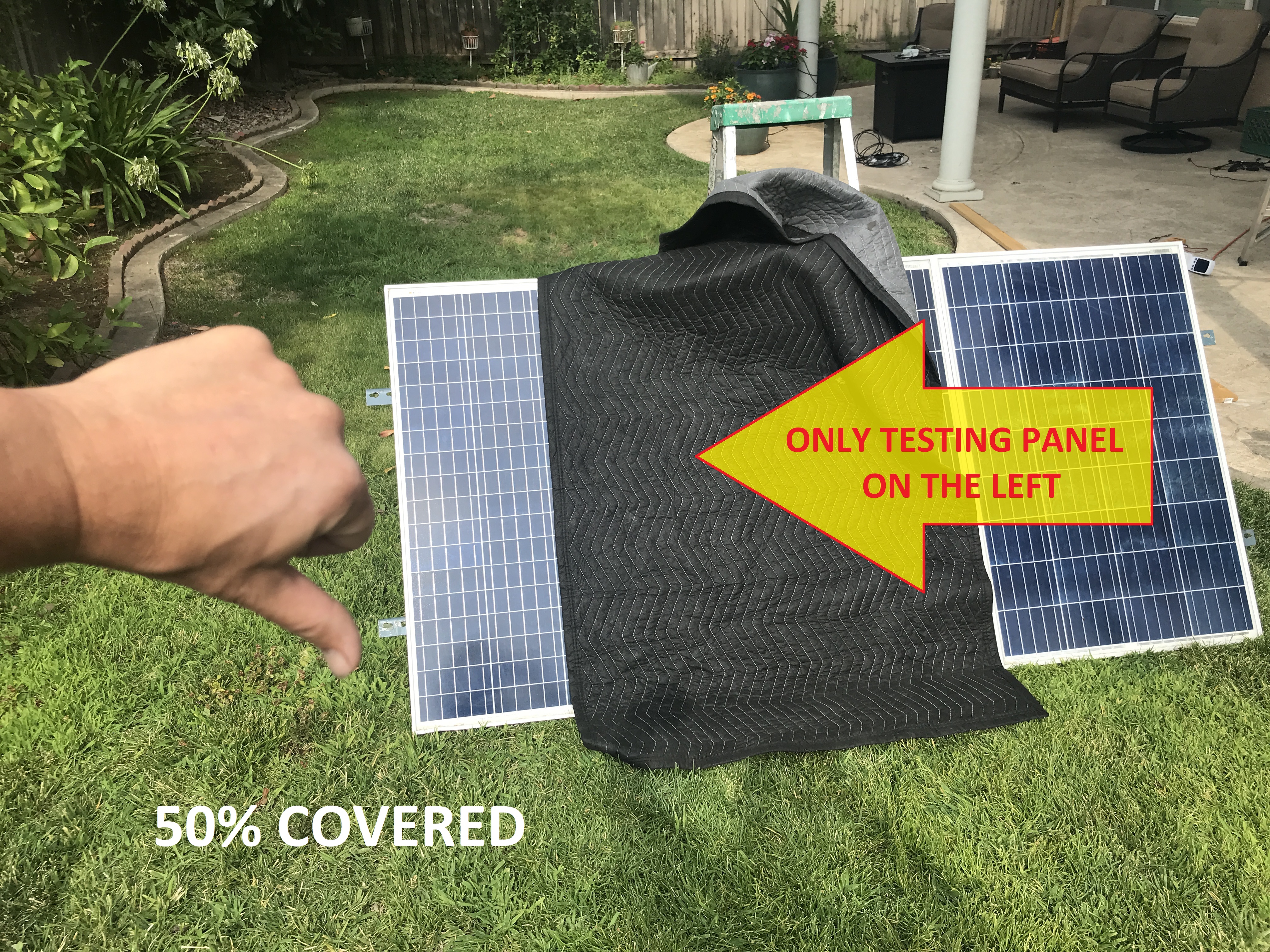

Re: Newb Asks: How does shade effect solar power generation?
I decided to do this because my Windy Nation 100 watt solar panels were grossly under performing, here I only have the single panel on the left plugged in, the other two are not even hooked up for this experiment
Test: 25% covered
Result: the rest of the cells work, they generate power
Test: 25% covered

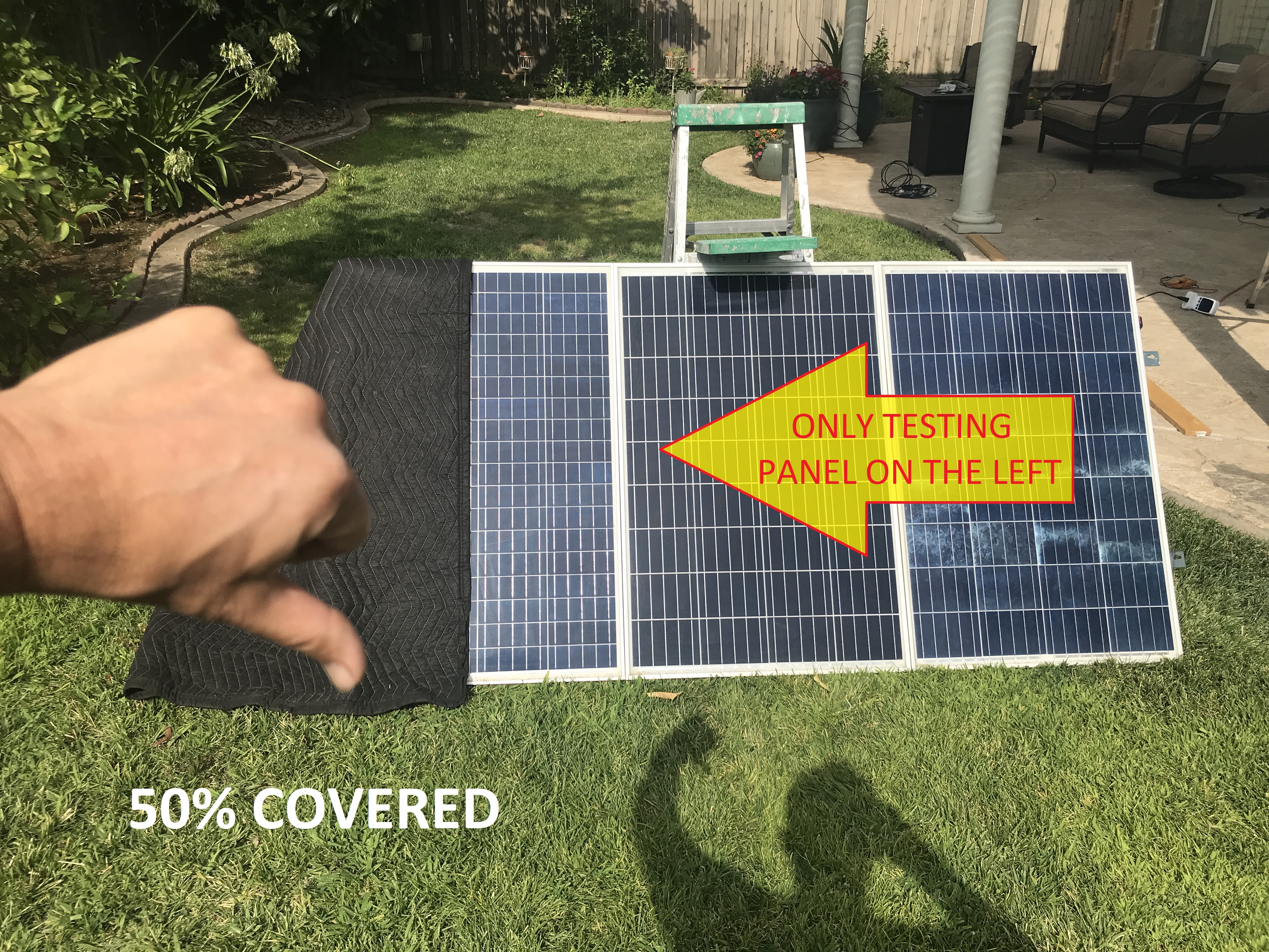

only the panel on the left is hooked up to the inverter the two on the right are not even connected for this test
Test: 50% covered
Result: the rest of the cells do NOT work, they do not generate any power
Test: 50% covered

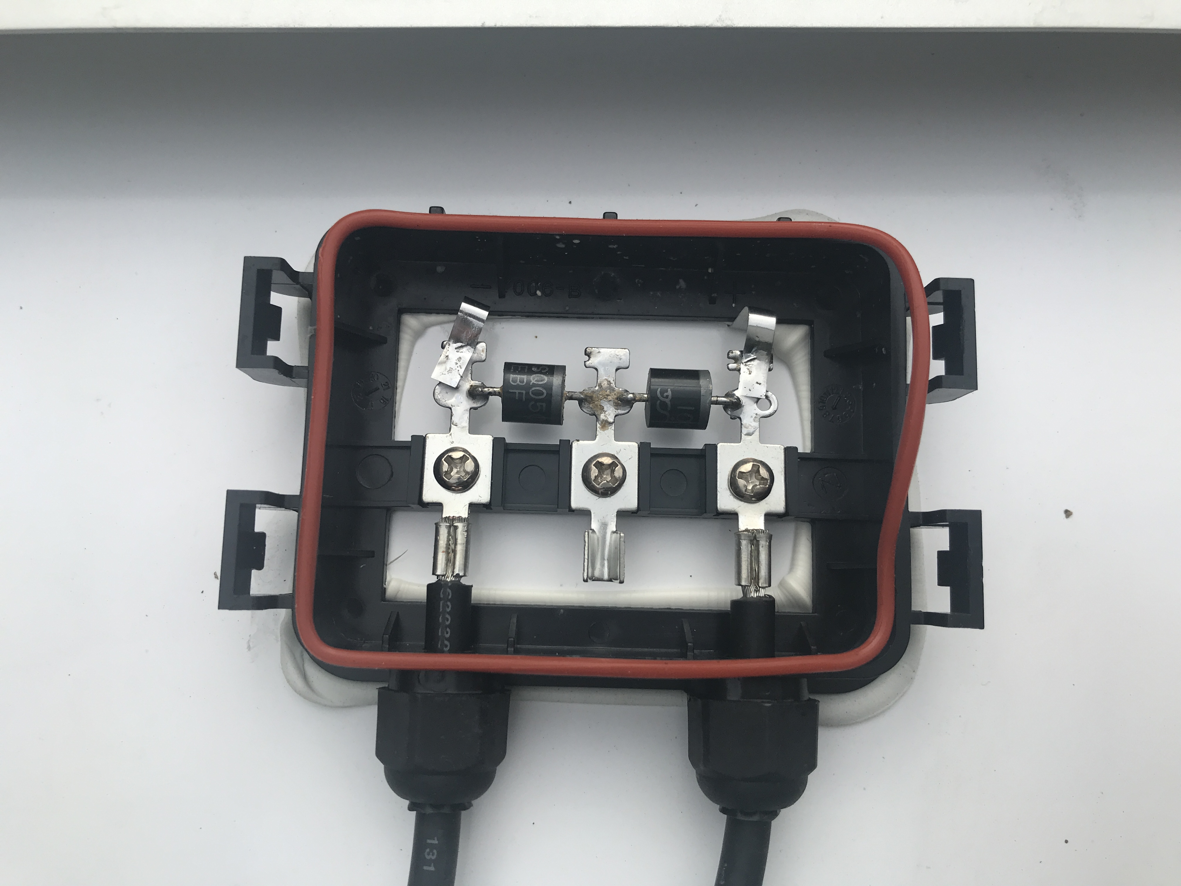

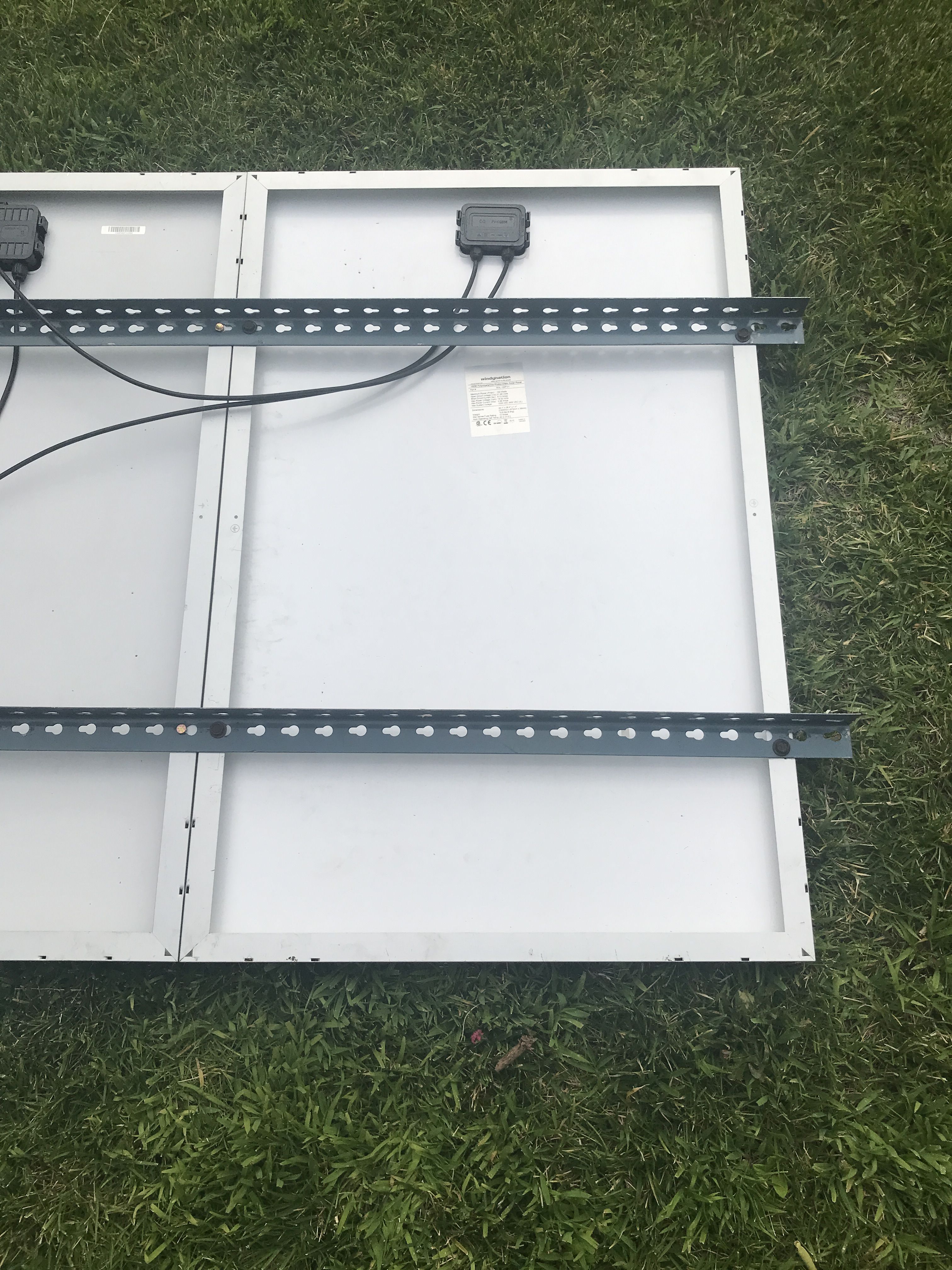

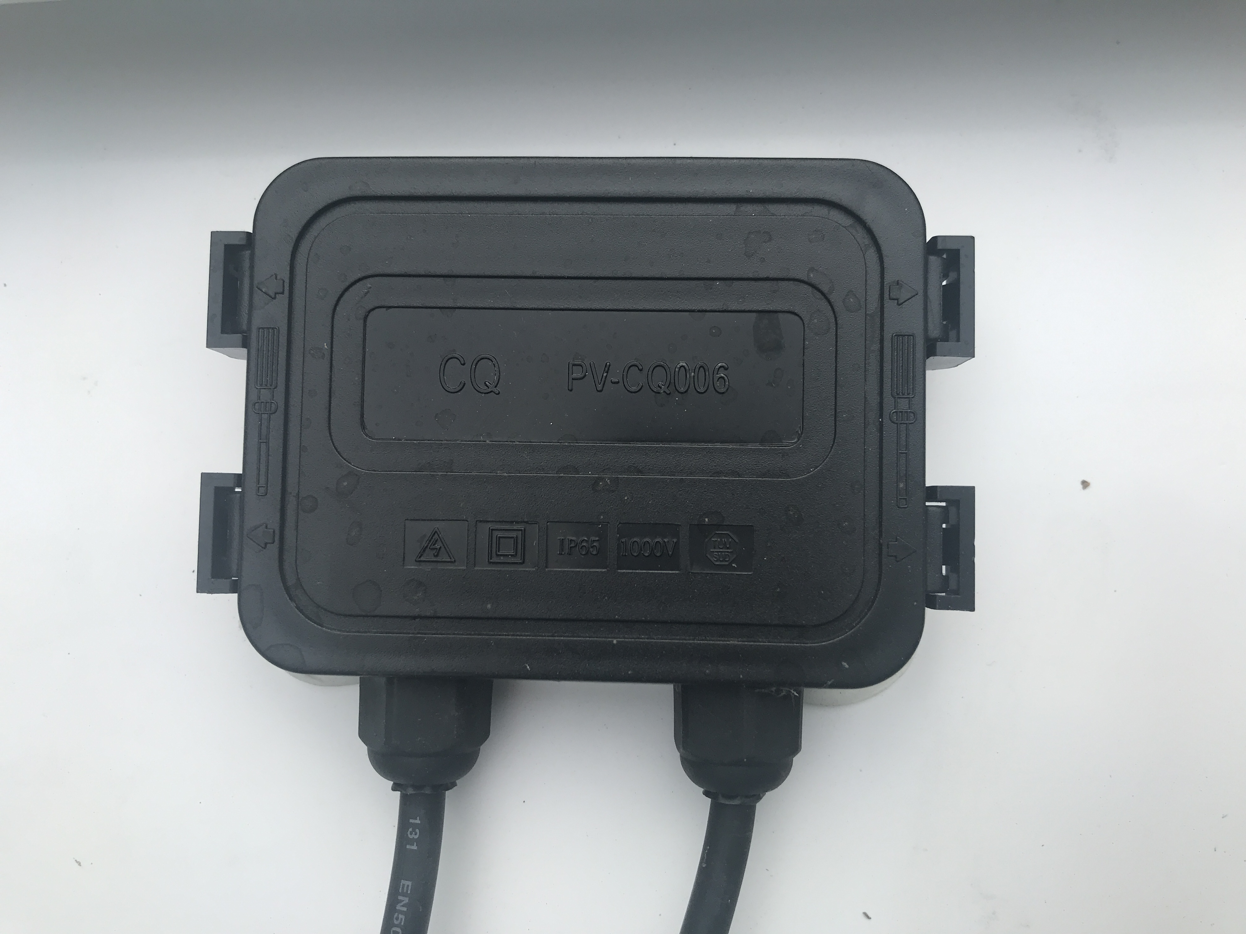

here is what the back side of this Polycrystalline WindyNation (pronounced: cheap) 100 watt 12 volt solar panel looks like

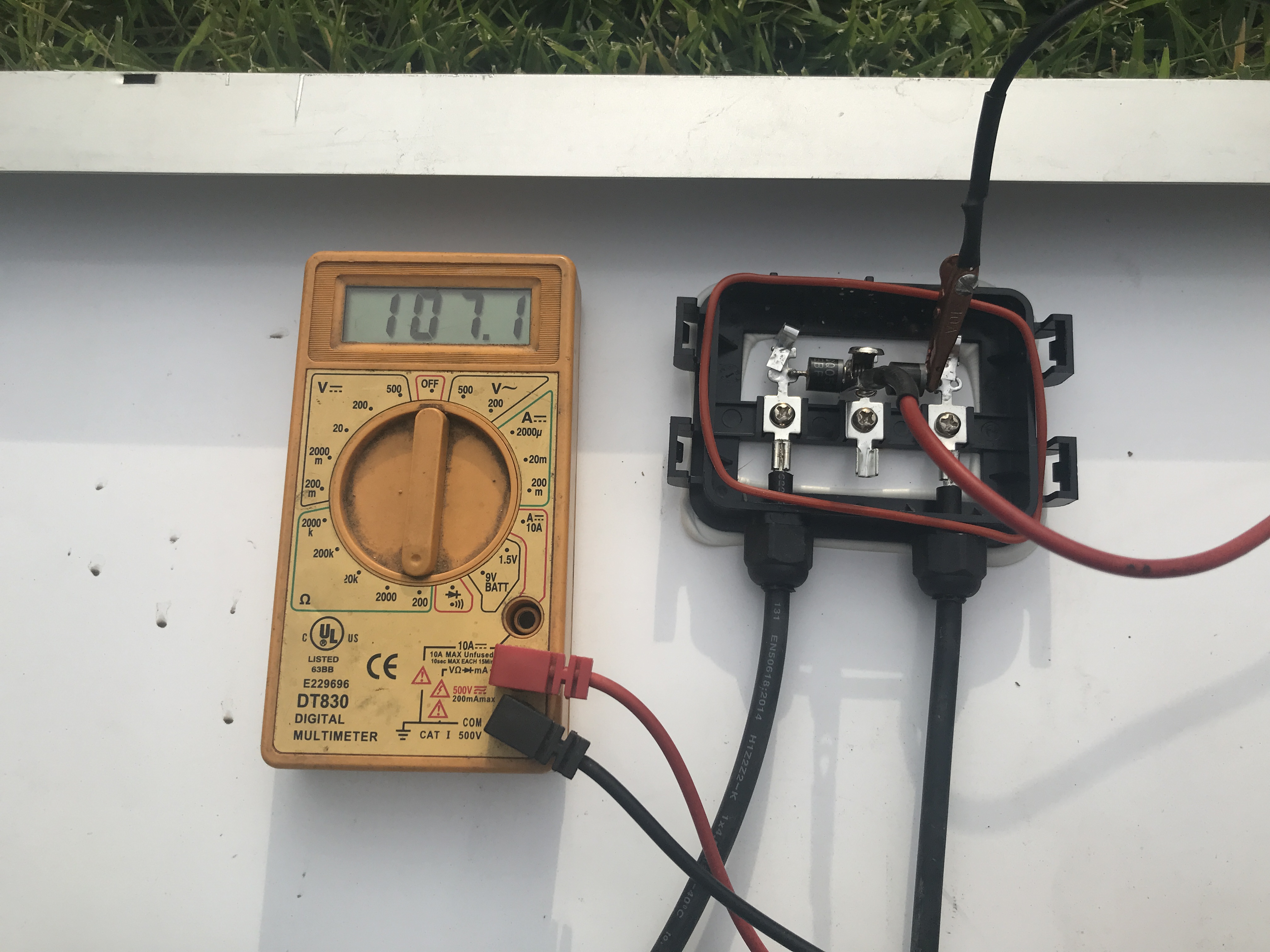

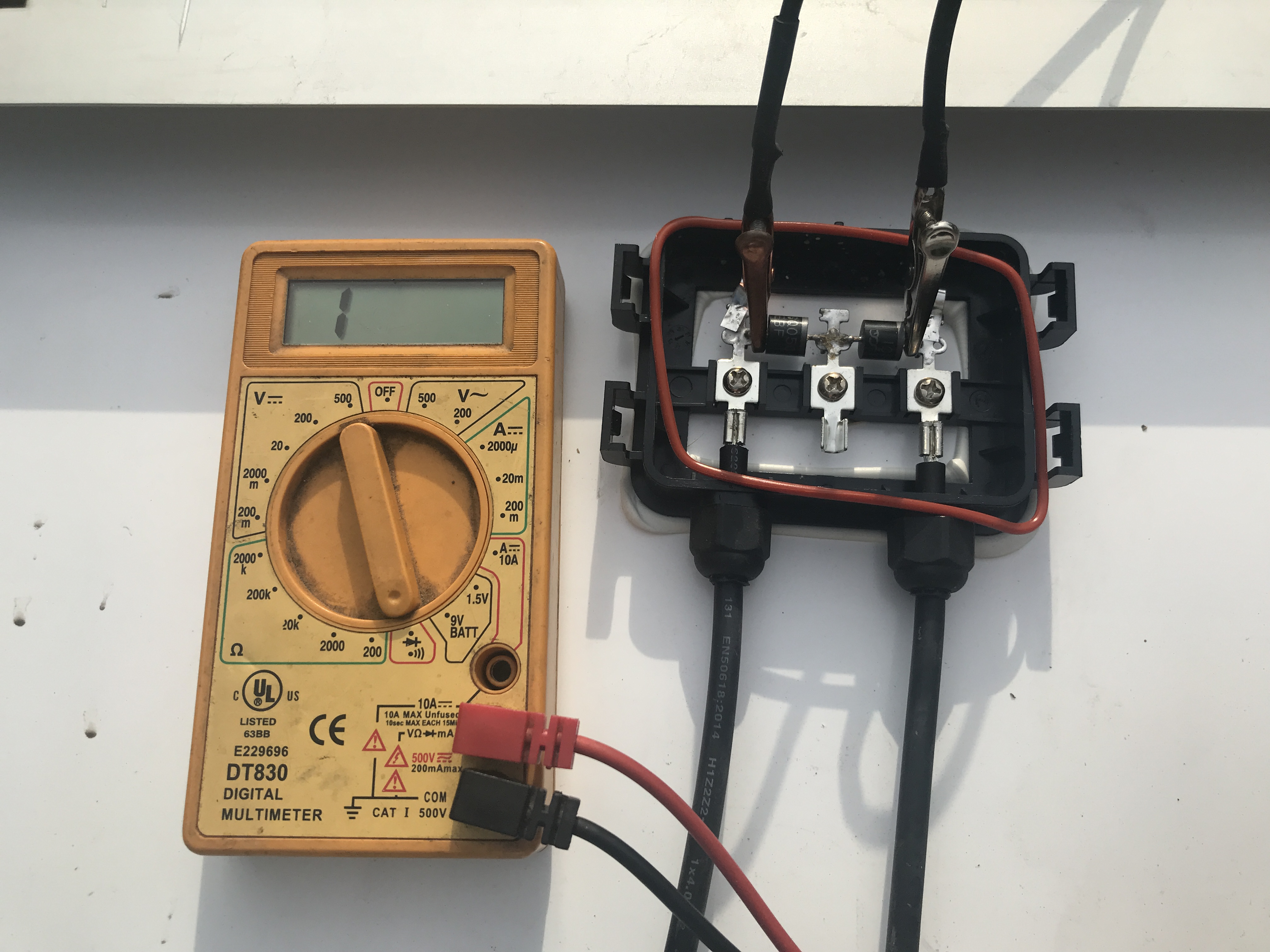

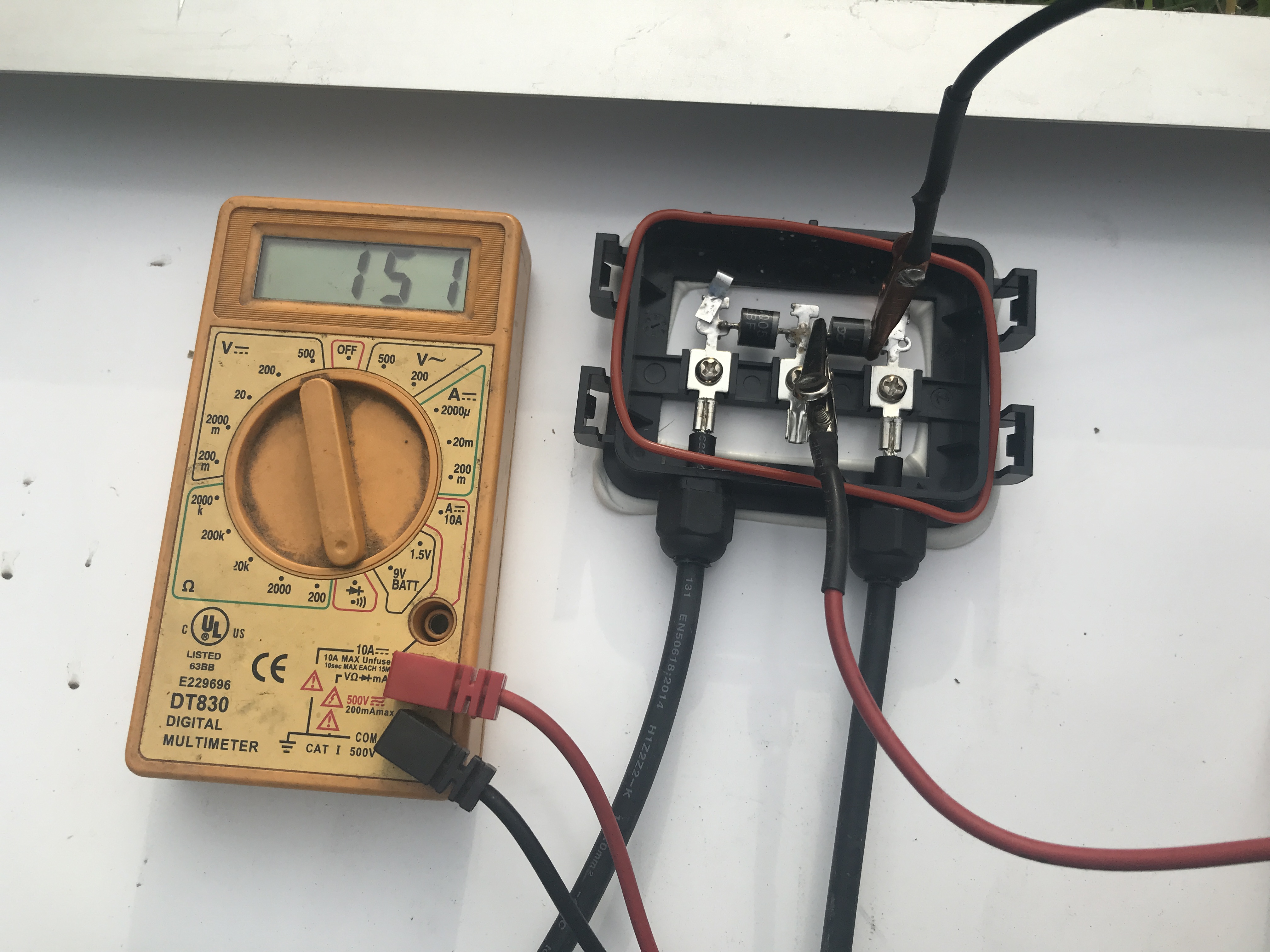

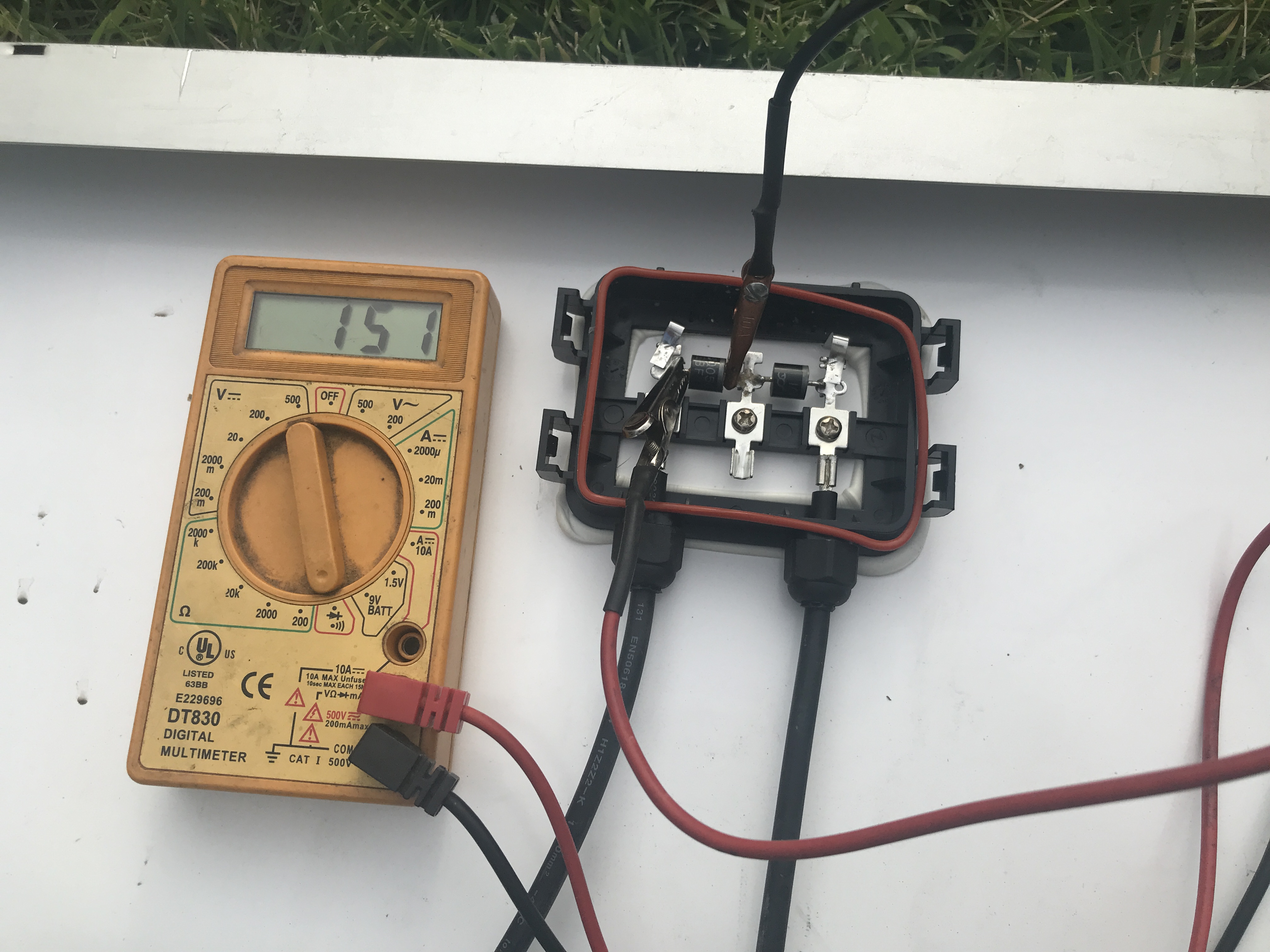

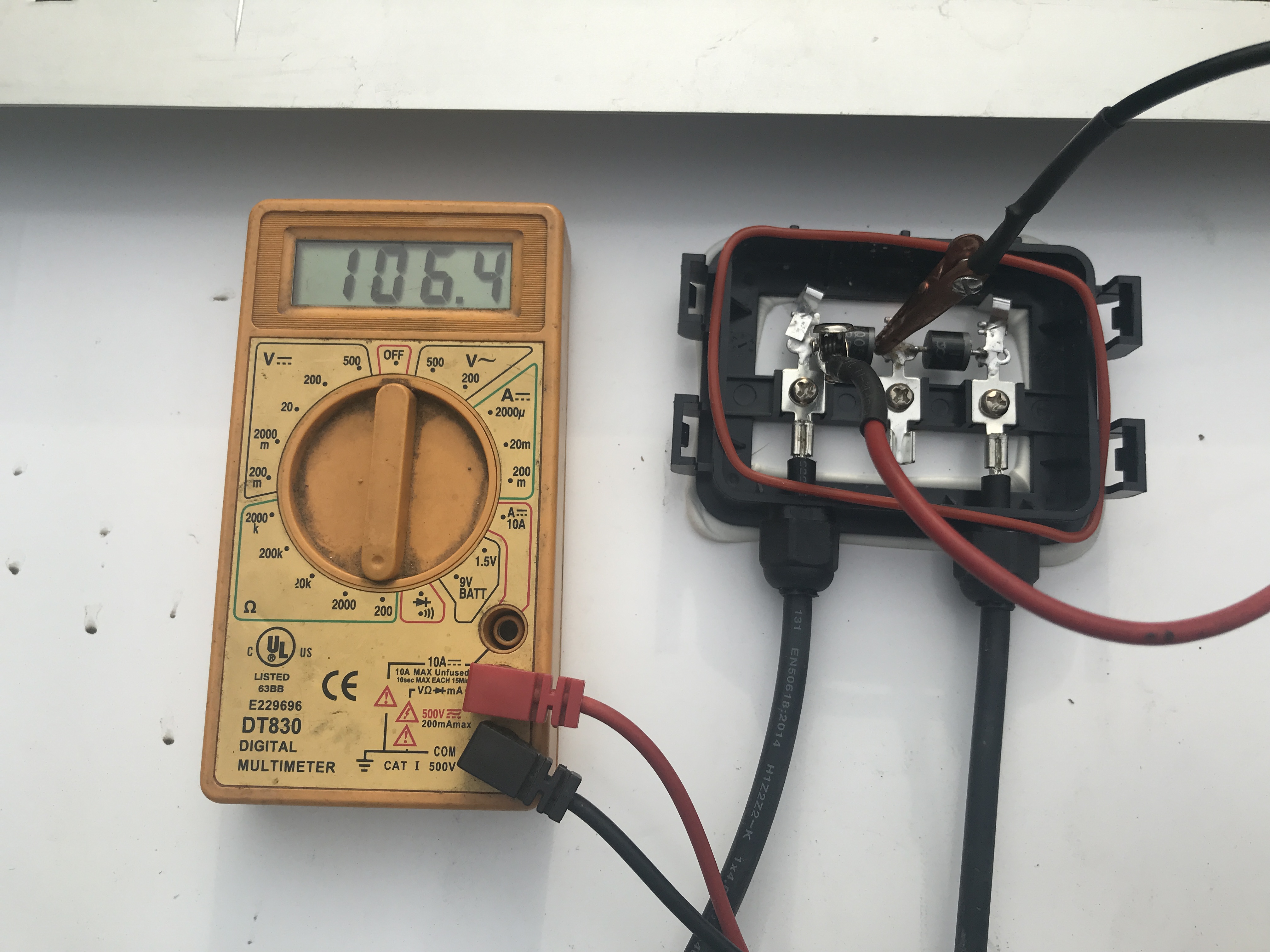

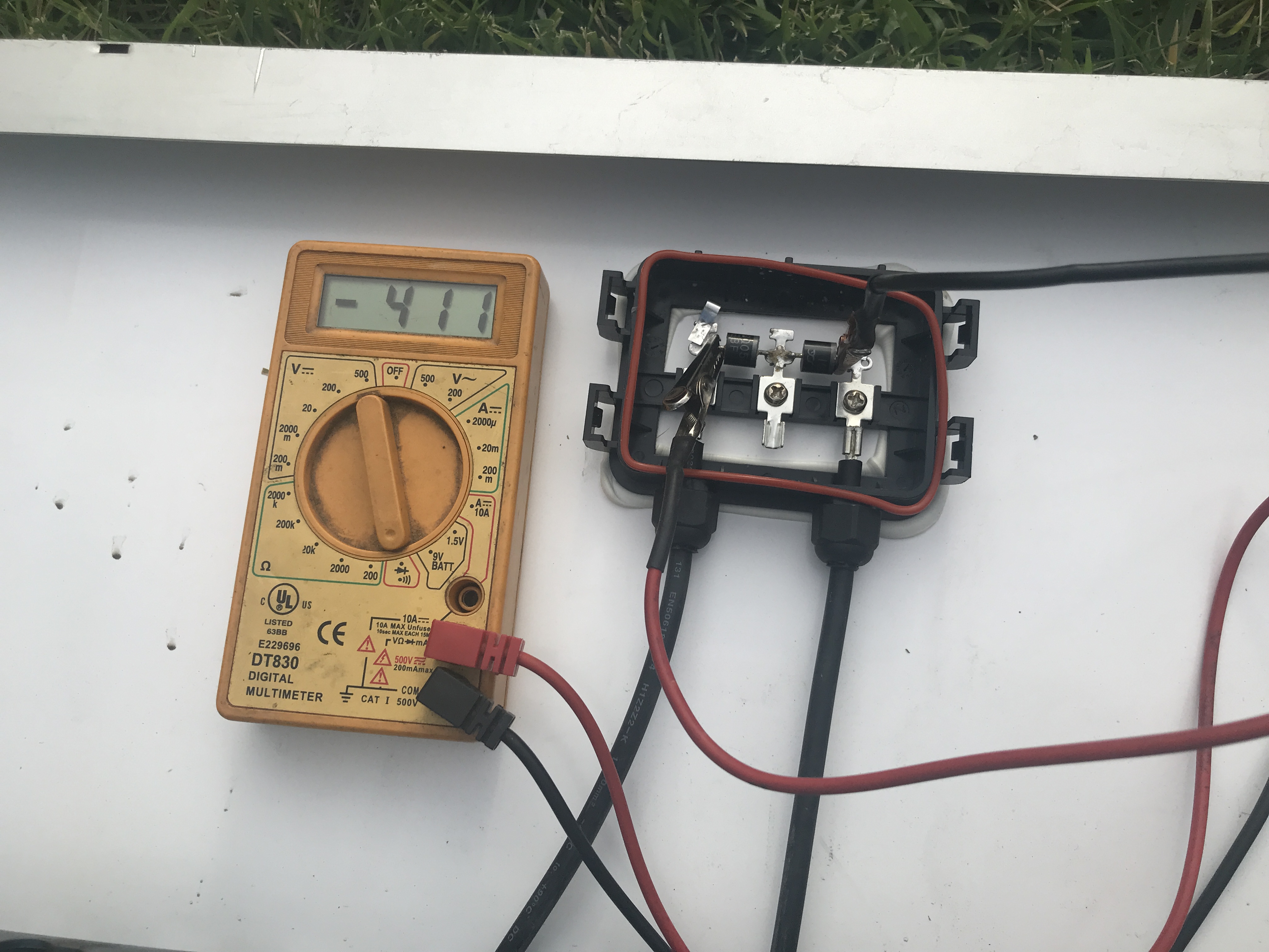

and here I am pretending like I know what I am doing, this is on the continuity setting
I honestly don't get why this value is negative below when I measure across both diodes simultaneously

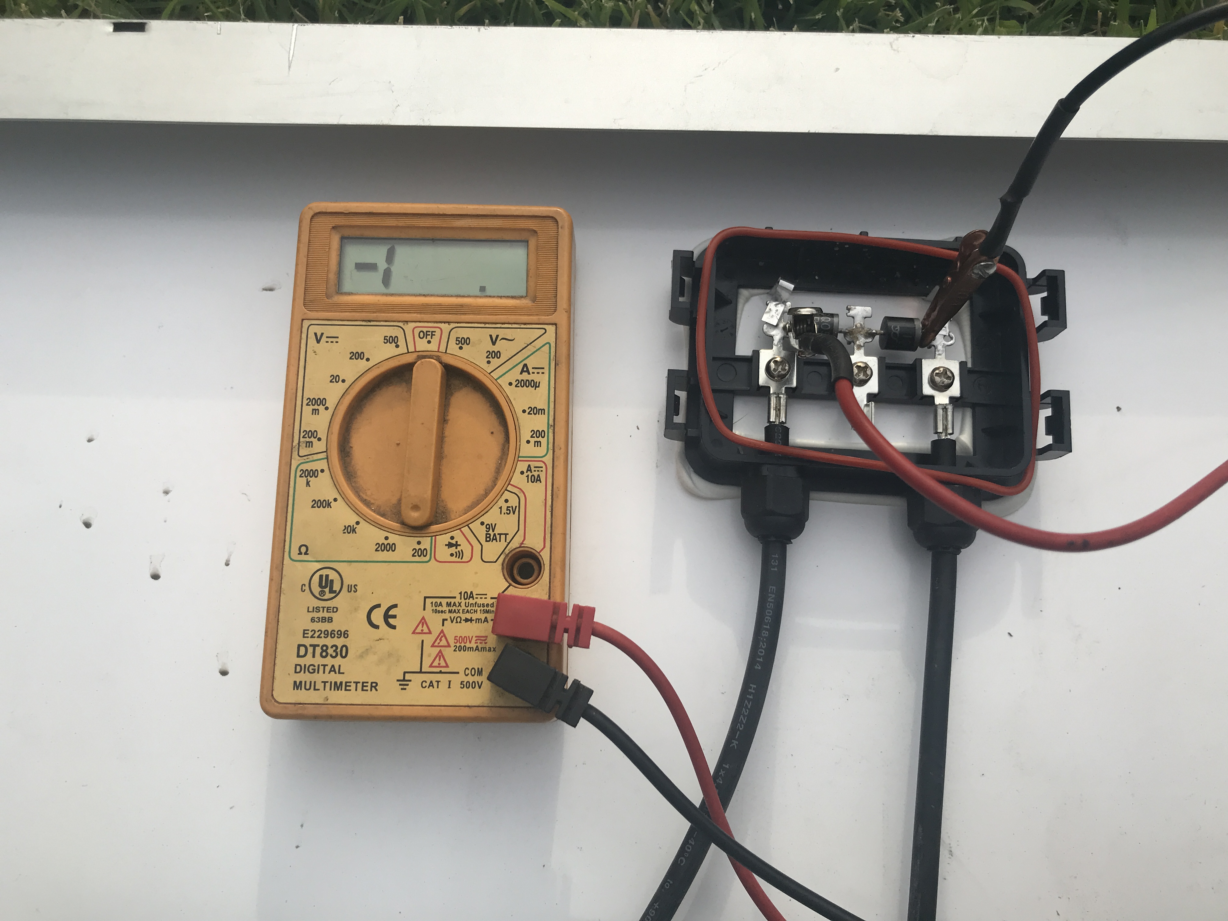

and here I am just measuring OHM aka resistance
- Gregski
- Posts: 2294
- Has thanked: 336 times
- Been thanked: 460 times

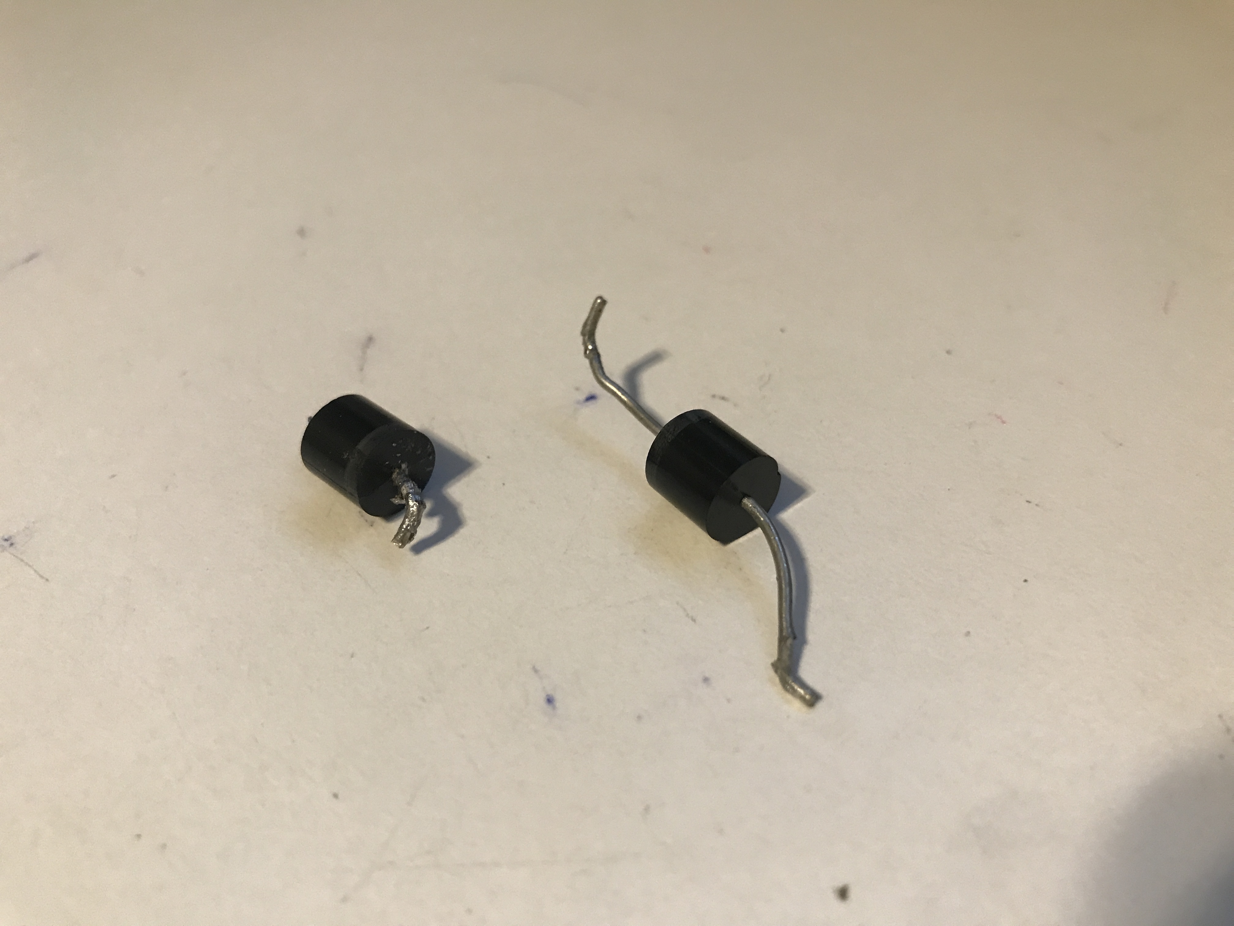

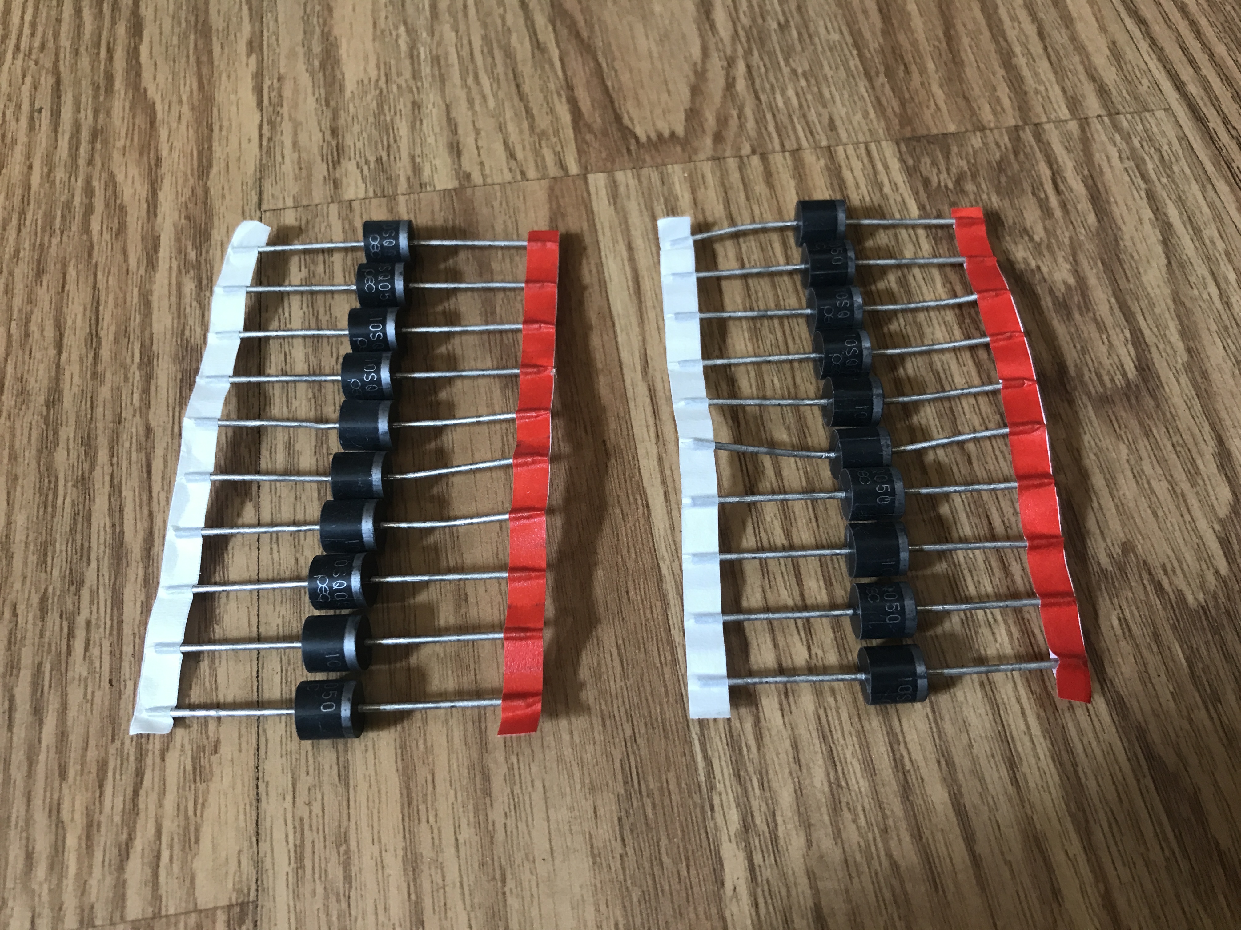

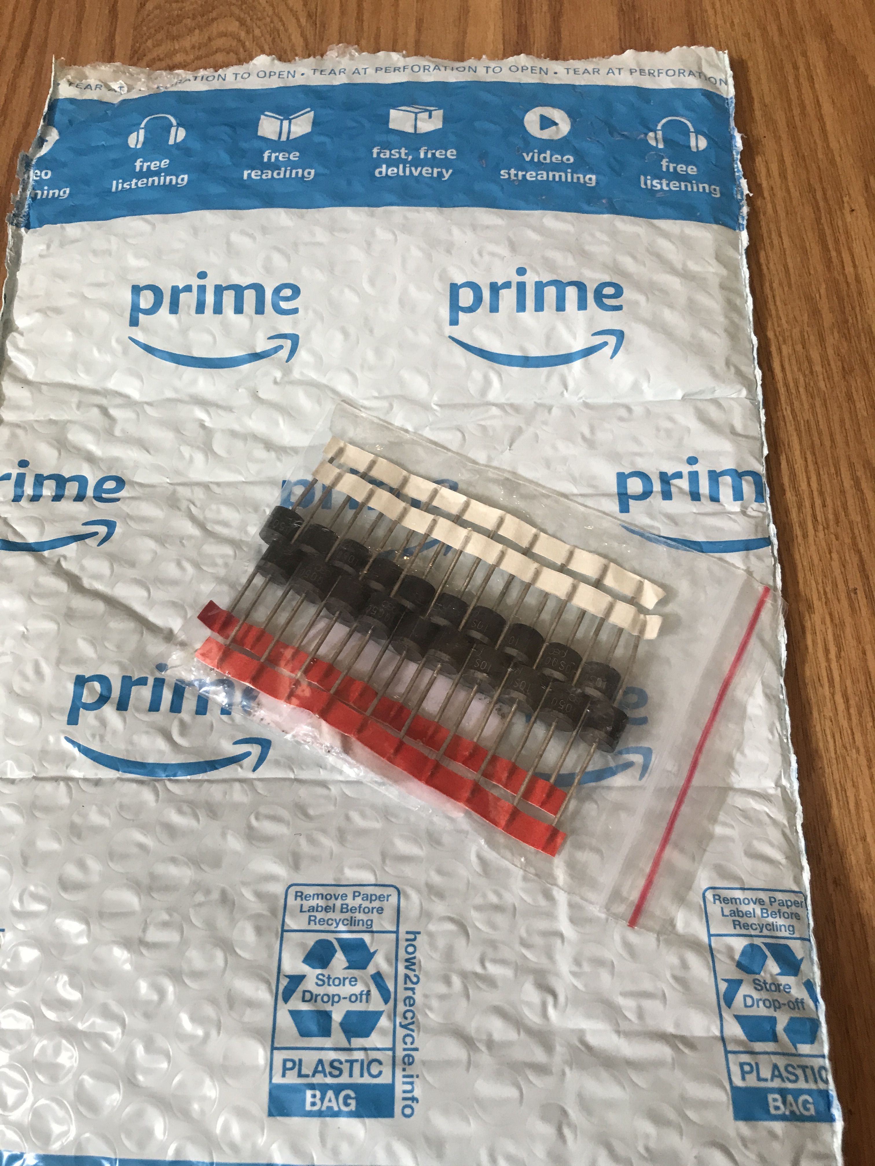

so it appears as though the one different solar panel aka the good one has diodes requiring only 150 millivolts to open up the check valve if you will to bypass shady cells where as the other two matching ones aka the bad ones have diodes requiring upwards of 550 millivolts to open their check valves
so I yanked those Schottky diodes as they are called I think what makes them special is they react much quicker than "regular" diodes and also don't run as hot, correct me if I am way off on that
and I bought some new ones on AMAZON
