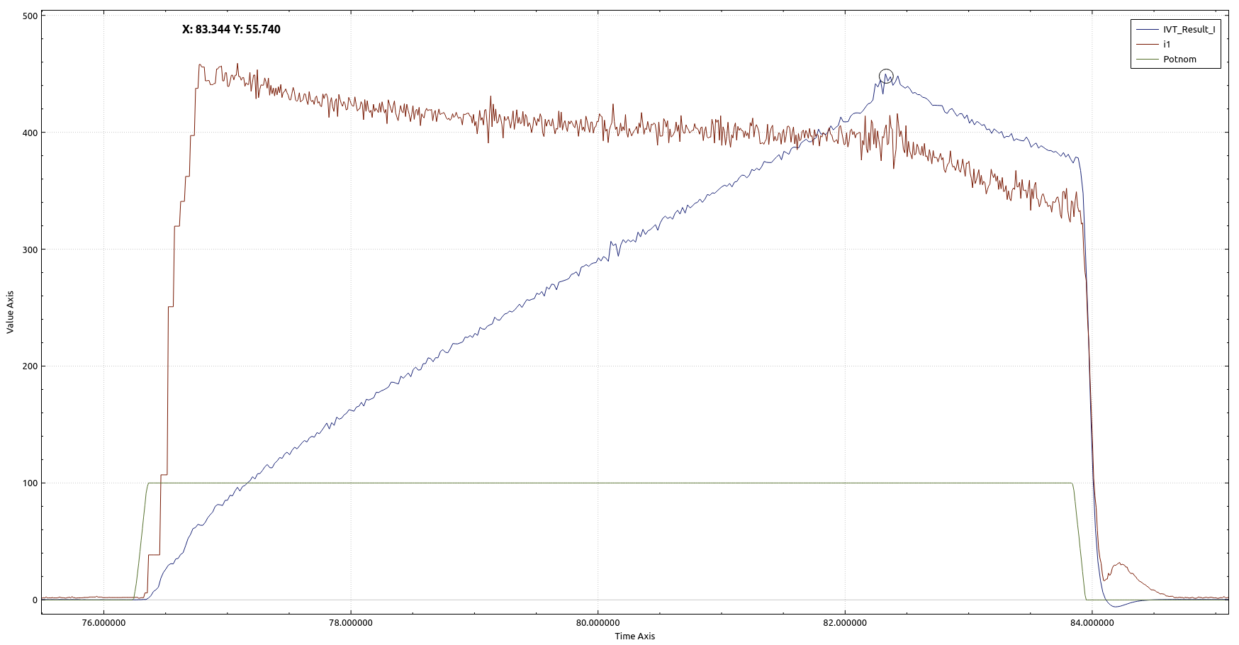

Re: Tuning the small drive unit with charts
One more test, this time allowing myself 450A. This is probably the final one as I don't want to push my car any harder for now.
Pack voltage: 310V
fslipmax: 3
boost: 2800
fweak: 250
AC current: 440A falling to 390A
DC Current: 0A rising to 440A
Temperature: 26C rising to 57C
0-60: 6.2s
Two important things to note about this configuration:
1) This is based on a very specific battery voltage: 310V, falling to 295V at peak power draw. Running it at other voltages may cause problems. It would probably be worth re-calibrating with udcnom configured.
2) fslipconstmax is set to 3. This means that power falls off above 60mph. Personally that works for me, but anyone who wants to push top speeds would want to configure fslipconstmax higher (between 4 and 6).

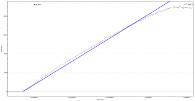

After a few days of driving my car with these settings, I have a couple of thoughts. Firstly, I'm happy, it's really nice to drive, capable but smooth.
However there's an interesting contradiction here. The charts clearly show that AC current *decreases* with speed, however it's very clear that torque actually increases with speed. This confuses me a lot. For the exact same slip, and slightly reducing stator current, why does torque increase with speed?
To get consistent torque, it seems I'll need to push the low speed current even higher, but I'd quite like to understand what's going on here!
- catphish
- Posts: 955
- Location: Dorset, UK
- Has thanked: 94 times
- Been thanked: 179 times

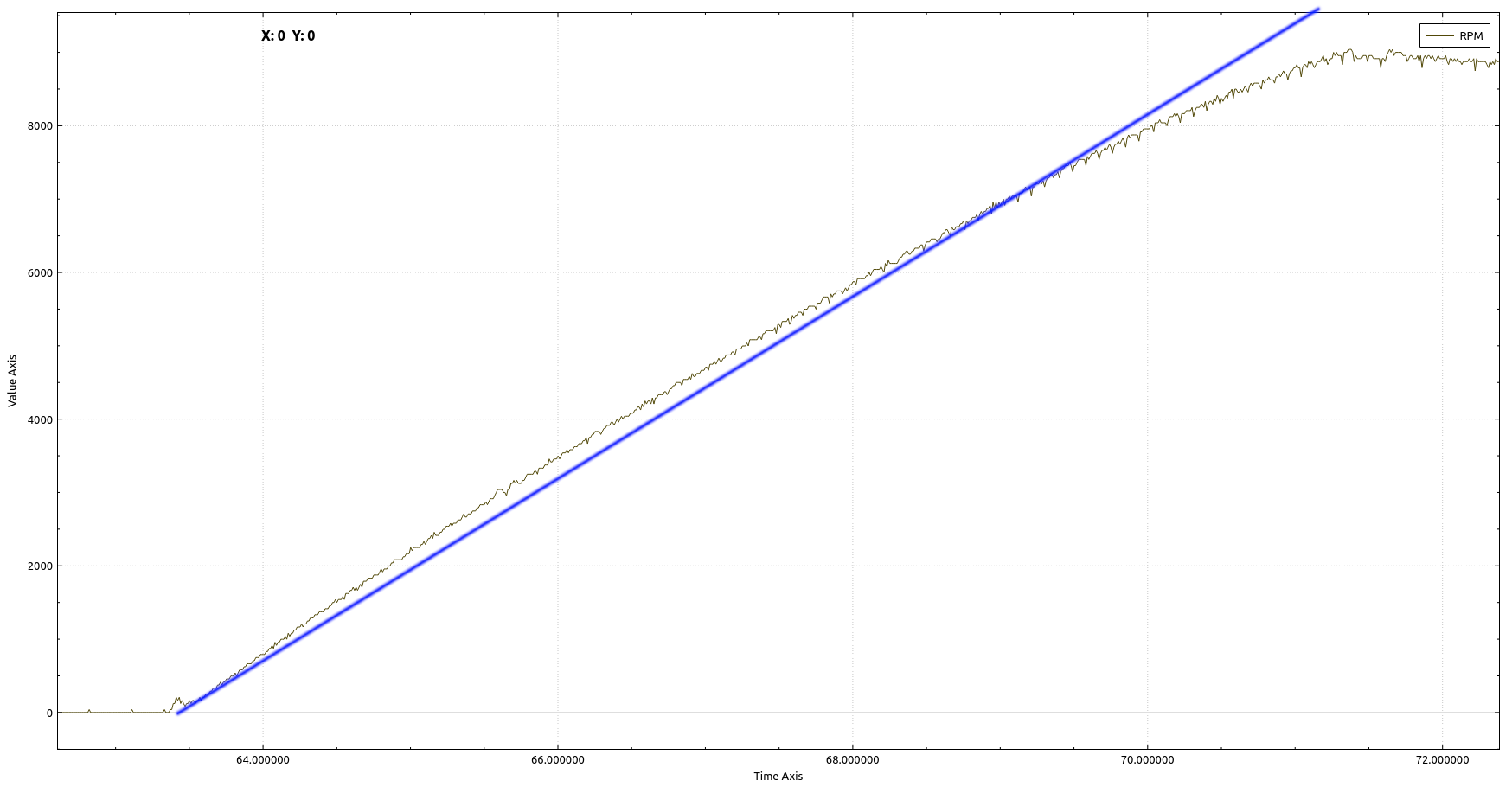

I looked at the actual speed data and it turns out I was wrong.
I guess humans aren't very good at measuring acceleration!
The acceleration is almost linear, reducing slightly with speed, exactly as it should!

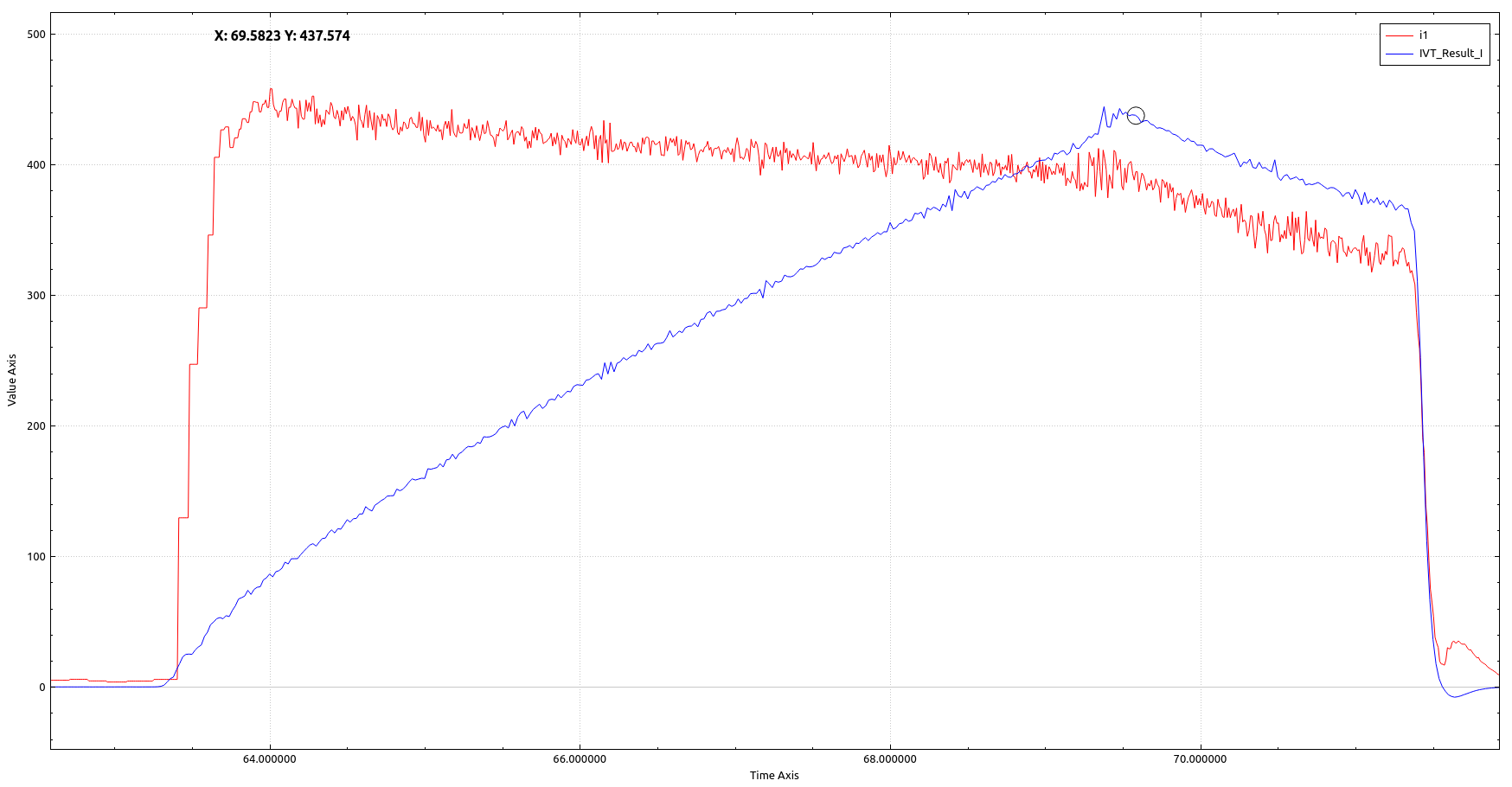

Small update, after driving for a while I got irritated with variations in battery voltage (state of charge) causing big changes in performance, so I've now re-tuned with udcnom set. The results are essentially identical to the previous ones but hopefully they are now more consistent.
udcnom: 300 (300V nominal battery voltage, 80 series cells)
boost: 2900 (this is adjusted to give a mostly flat current curve from 0rpm)
fweak: 250 (this vaue has the most impact and ends up setting the peak DC current)
fslipmax: 3 (not proven but this low value seems more efficient)
idcmax: 600 (I'm tuning for 450A peak, but I set this a little higher so that I can tune up to that level without bouncing off the limiter)
0-60: 6.75s
AC current: 420A to 386A
DC current: 0A to 430A
Inverter temperature: 23C to 50C
I plan to squeeze a little more out of it and finish bringing the peak currents up to my ideal of 450A but this isn't far off.
I also spent some time playing with idckp to see if I could make use of the DC current limiter rather than avoiding it. Unfortunately I was not able to achieve smooth results with this, so I will instead persist with avoiding the limits.

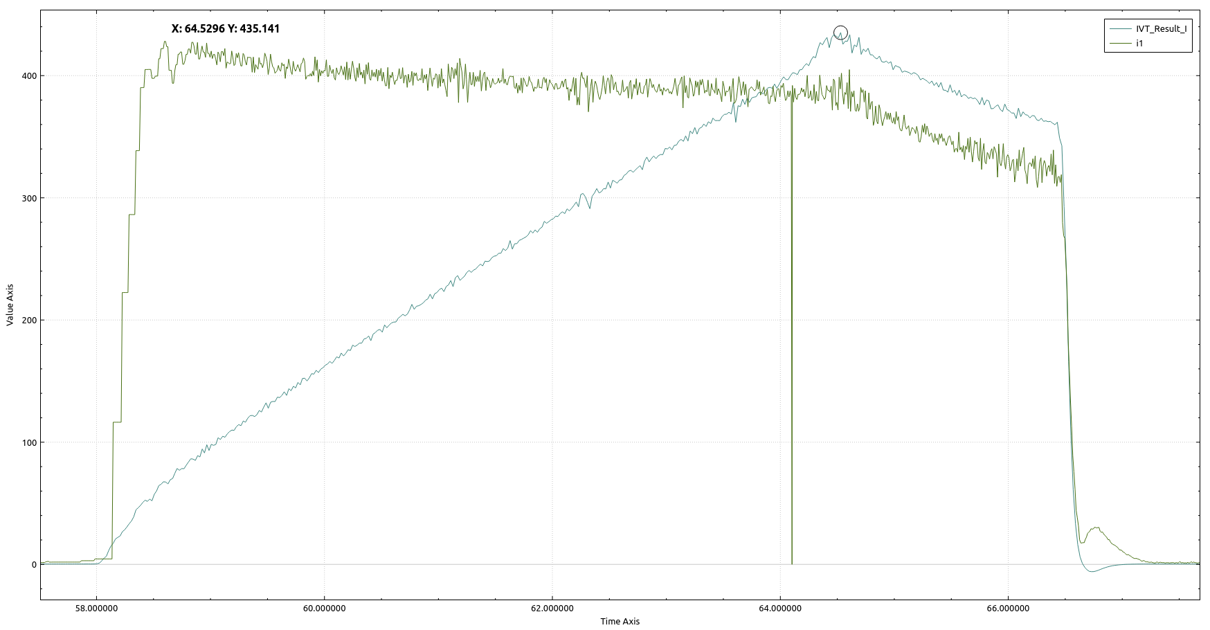

I'm sure this thread is getting boring now, but I have more more configuration. Building on the previous configuration, I have increased boost to 3200. This increases the startup current to 450A and increases acceleration but doesn't have much impact on peak DC current. Both now peak at 450A (my self imposed limit).
udcnom: 300
boost: 3200
fweak: 250
fslipmax: 3
idcmax: 600
0-60: 6.1s
AC current: 450A to 390A
DC current: 0A to 450A
Inverter temperature: 28C to 64C
Not too much more testing to do on this now, but I might repeat with identical current and fslipmax=3.5 to see if this has a positive or negative impact.

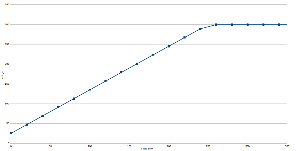

The idea of varying fweak with RPM doesn't make sense to me. Allow me to explain why.
The way this works is that boost specifies the voltage at 0RPM, and fweak specifies the speed at which the voltage is full battery voltage. When combined, this creates a graph that looks like this:
In this example boost is 25V and fweak is 250Hz. That means voltage starts at 25V and reaches 300V (or whatever your battery voltage is) at 250Hz.
What this means is that if you want to change the voltage at high RPM, you adjust fweak, and if you want to adjust the voltage at low RPM, you adjust boost, and there is always a straight line between the two.
If you were wanting a higher voltage (equivalent to lower fweak) at lower RPM, then all you have to do is increase boost
It might be useful to have a third point on this voltage curve, but probably not necessary unless you're really rune tuning. I hope this all makes sense!
