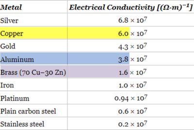

Posted: Fri Aug 25, 2023 12:46 am
by asavage
Metals Conductivity Chart
Brass machines well (well, depending on the lead content) and is widely available but is a not a great choice for a conductor. Aluminum is a better conductor choice, if the environment is suitable. Copper conducts well but corrodes easily, which is why it's often tin-plated in corrosive environments (and why most terminal lugs are plated).
Iron, steel, and stainless steel are very poor choices for a conductor of any significant current.

I use brass for end terminals simply because you can solder a hex nut to the brass lug side. This than allows for singlehandedly attaching the bolt - a must be for safe assembly in HV enviroment.
I agree aluminum is a better conductor. But it requires TIG welding and or thicker terminals to offset its softness in case of threads.
The most commonly used aluminum alloy for electrical conductors is 1350.
If higher mechanical strength is required with good electrical conductivity, the 6101 alloy is chosen.
Myself i used 6082 alloy which is not as good conductor as it is a better construction material.
