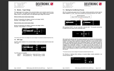

Have been able to get the "exact" NTC used in the battery modules based on Deutronics HV charger manual. The NTCs are of 2 variant 100k/4.4 and 10k/3.4

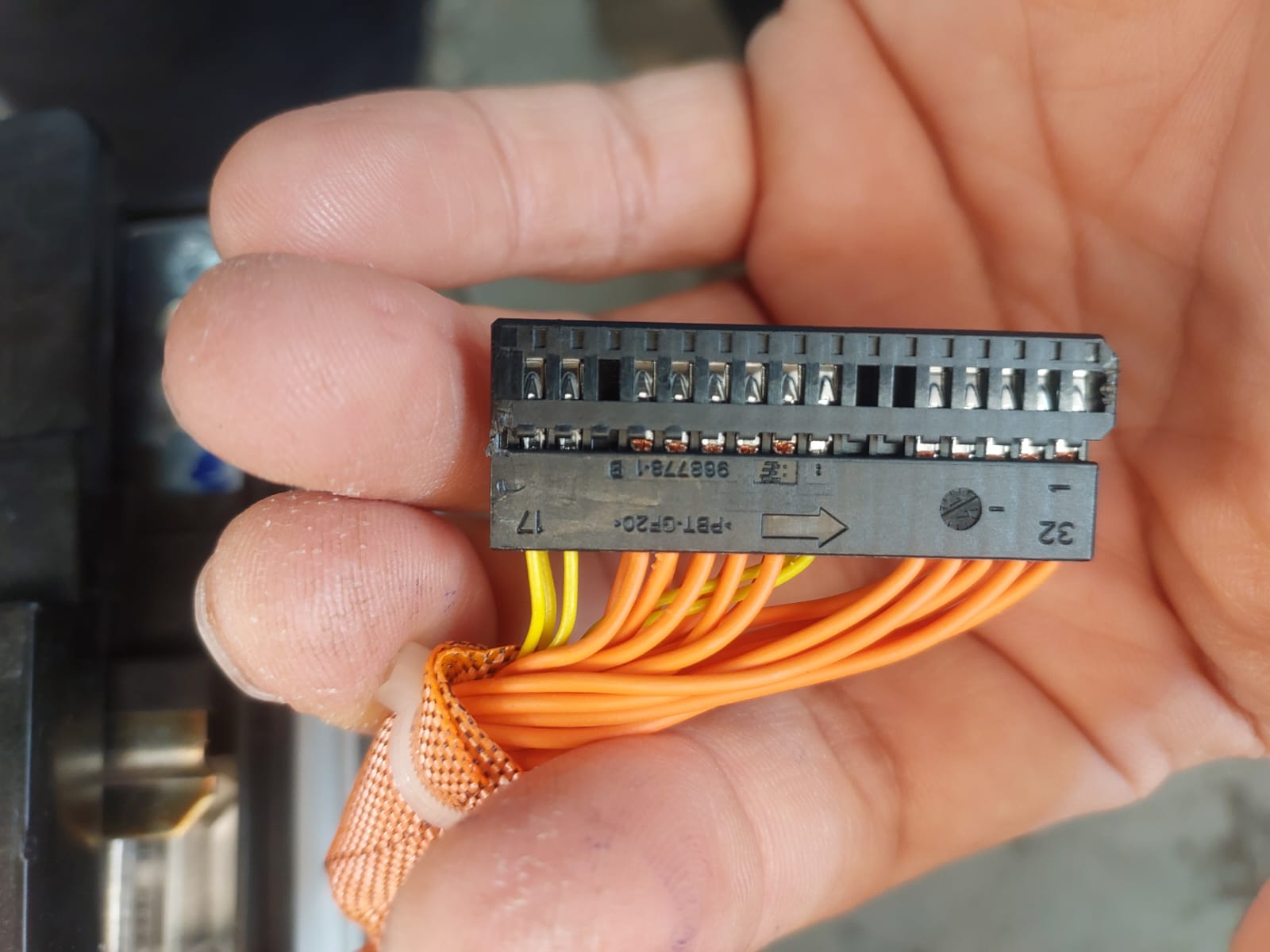

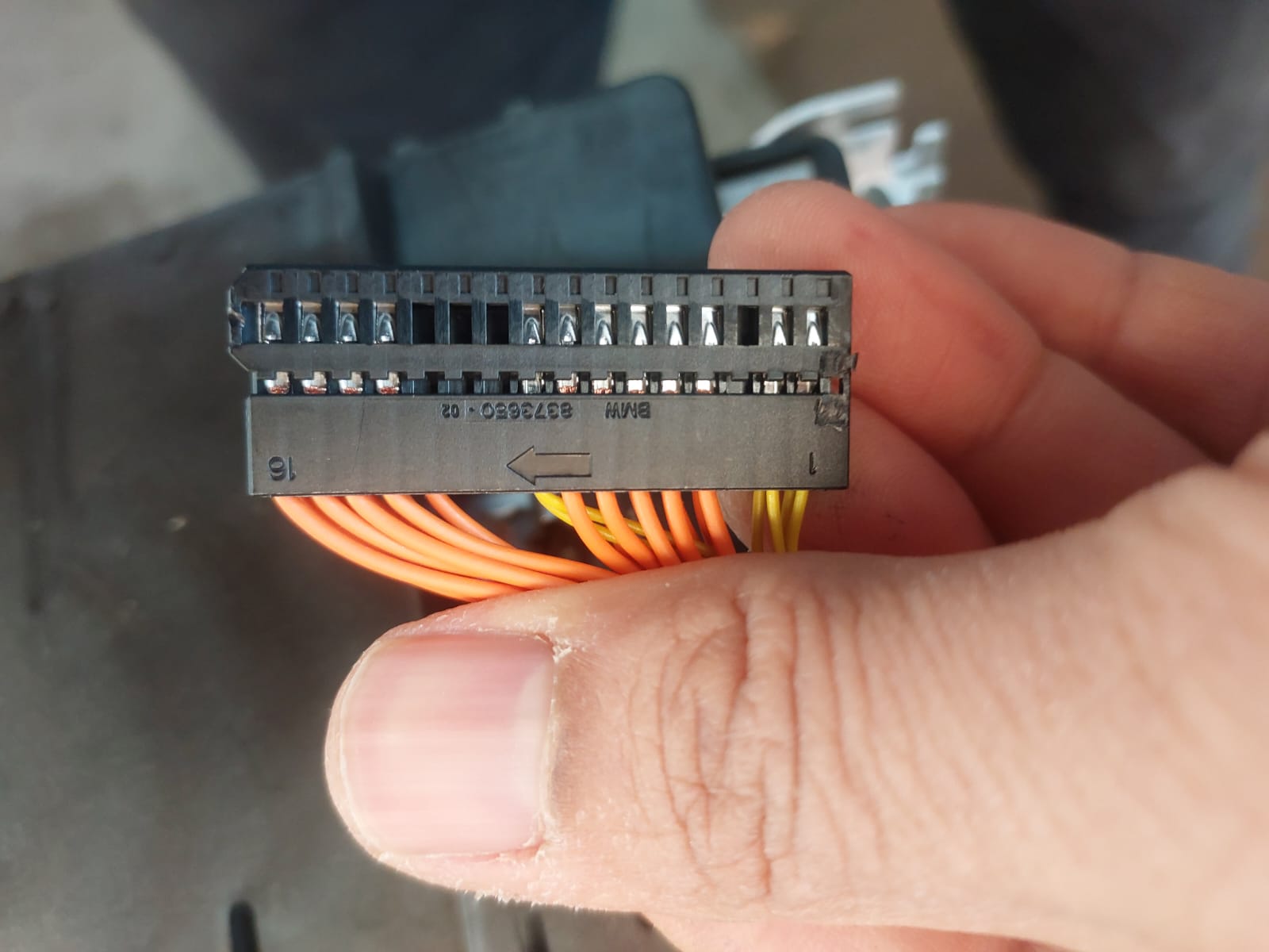

Hello,
I have same issue with a G30 530e (SP06), i got this reading from Cell Module 2 checked at the connector at room temperature about 25 C,
Temp Sensor 1 90.8 K ohm (Pin 2 - 18)
Temp Sensor 2 1.2 M ohm (Pin 9 - 25)
Temp Sensor 3 91.6 K ohm (Pin 1 - 17)
Did someone here know if it is possible to change only the Temperature Sensor?

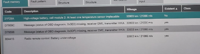

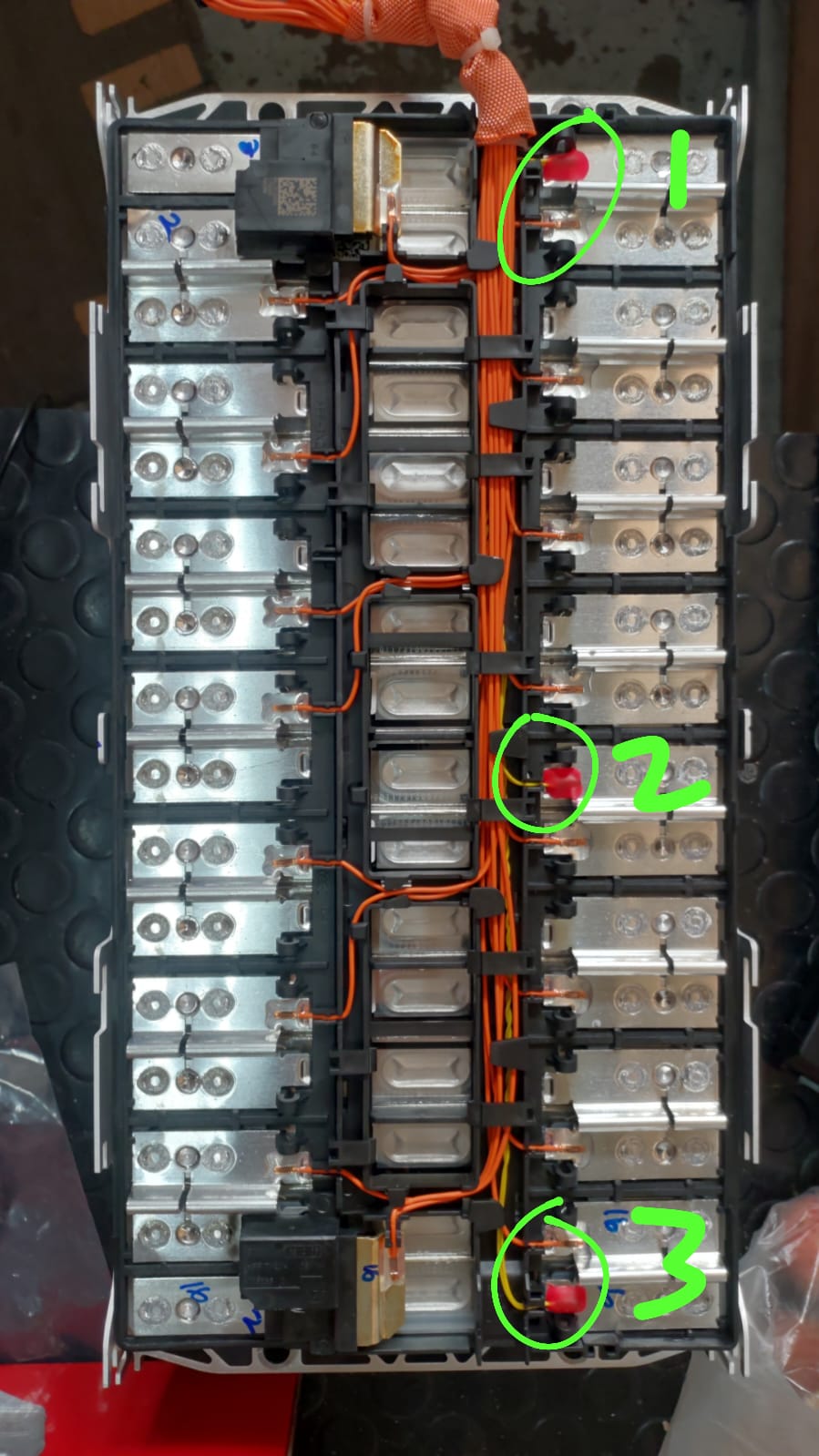

I think only cell module 5 is okay. The temperature sensor reading should be around 80kΩ to 92Ω but less than 100Ω for this particular sensors and any anything above it indicates a failure of the sensor. Module 2 (T2 is bad), Module 3 (T2 & T3 bad), module 4 (T3 is bad). Did you check this with a diagnostic tool to tell you the faulty sensors?
Re: BMW hybrid battery module temperature sensor
As per scan Cell Mod 2. Is it possible to change the Temp sensor? Desolder the red glue and get a Temp sensor?fatfash wrote: ↑Wed Dec 06, 2023 9:13 am I think only cell module 5 is okay. The temperature sensor reading should be around 80kΩ to 92Ω but less than 100Ω for this particular sensors and any anything above it indicates a failure of the sensor. Module 2 (T2 is bad), Module 3 (T2 & T3 bad), module 4 (T3 is bad). Did you check this with a diagnostic tool to tell you the faulty sensors?
Yes, you can change it.There is a procedure you have to follow to do this with BMW repair kit that includes the sensor. You can get the procedure from the ISTA you are using under " Repair Manuals and Technical Data / 61 General vehicle electrical system / 61 27 High-voltage battery unit individual component /"
But in BMW Pasrt Catalogue ther eis no sensor available, says complete battery cellfatfash wrote: ↑Wed Dec 06, 2023 5:24 pm Yes, you can change it.There is a procedure you have to follow to do this with BMW repair kit that includes the sensor. You can get the procedure from the ISTA you are using under " Repair Manuals and Technical Data / 61 General vehicle electrical system / 61 27 High-voltage battery unit individual component /"
use this part number "61 27 8 849 422". A google search of this will show you what it looks like.
Great. WIll order same. Do i need some sort of calibration after this fix?
No calibration needed. Just follow the procedure of installing the replacement sensor and you should be good.
