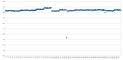

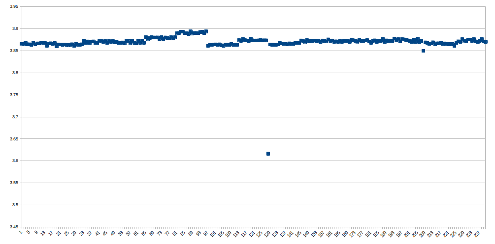

Re: VX220 with Tesla SDU
Car has now passed its MOT and has been on the road, yay!
Unfortunately I have one new problem, one of my cell voltages is way off from the others. I don't know if it's a bad cell or a bad BMS module, but in order to investigate I'm going to have to remove the rear clamshell from the car again

Cell taps are a constant source of trouble in DIY. I also have 100mV delta that doesn't actually exist between two adjacent cells. Sometimes it jumps to the correct value where you can see they are balanced and then it jumps to the large delta again.

Thanks! I'm confident I can fix this, it's just going to be a big hassle (at least a day's work), because of how tightly everything is packed in this car.
In order to investigate, I need to remove the seats, parcel shelf, rear wheel arch liners, rear clamshell, and finally battery box lid. I can then swap the slave BMS board on the bad module. Fingers crossed this solves the problem.
If it doesn't, I'll have to remove the bad battery module from the battery box. Luckily I have a spare, but getting the modules out of the box isn't a fun process, particularly with the box in the car!
On the subject of driving, the car is now very smooth off the line and extremely nice and consistent to drive up to approx 55-60 mph. At this point, torque feels a little jittery.
By my calculations, fweak is at 52mph (probably approx 55mph on my speedo), so something is causing hesitation at around fweak. I could be hitting a derate (as it's at peak power at this point). I'll get some logging on it next week once I've dealt with the battery issue.

Congrats on passing the MOT. Dont forget to give your friendly neighborhood petrol station a wave as you pass by
If you remember I also had a bad cell and no matter if I swapped the BMS module or tested the cell connections neither solved it so hope you dont have the same issue. My weird cell reported 3.1v even though it was at 3.8v !!
