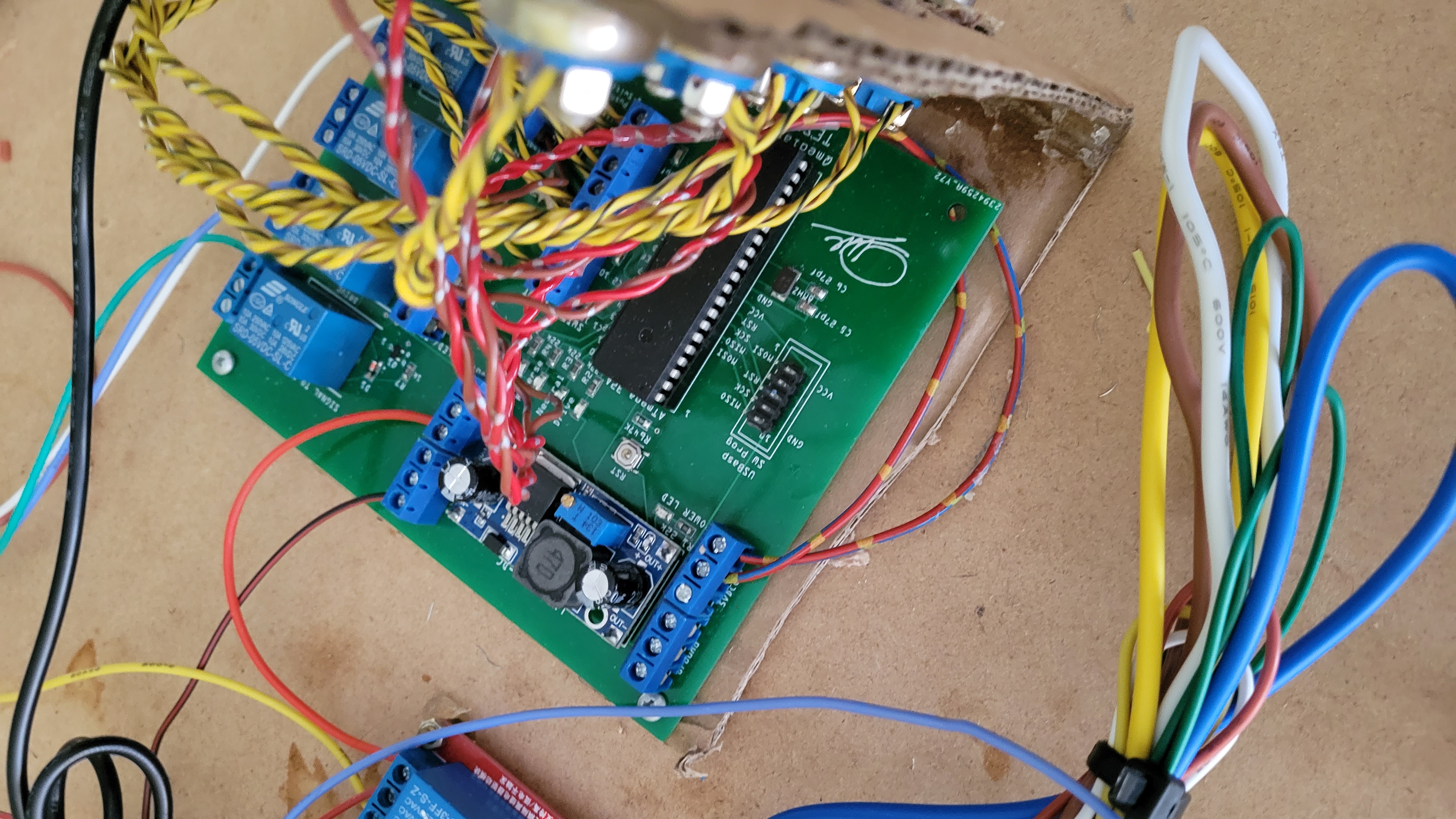

My SDU logic board after precharge the main contact will not close precharge is ok . But the main relay not closing. Using sdu drop in logic board V6. Please someone advise can I close the main contact manually with a external switch?

On the topic: is the relay driver given 3.3V? I.e. the left pin IC9 should be 3.3V when the inverter is in run mode. If so, check if the DC switch output (Pin 3 of the main connector) is pulled to ground, i.e. with a small light bulb. If so, check your wiring and relay.

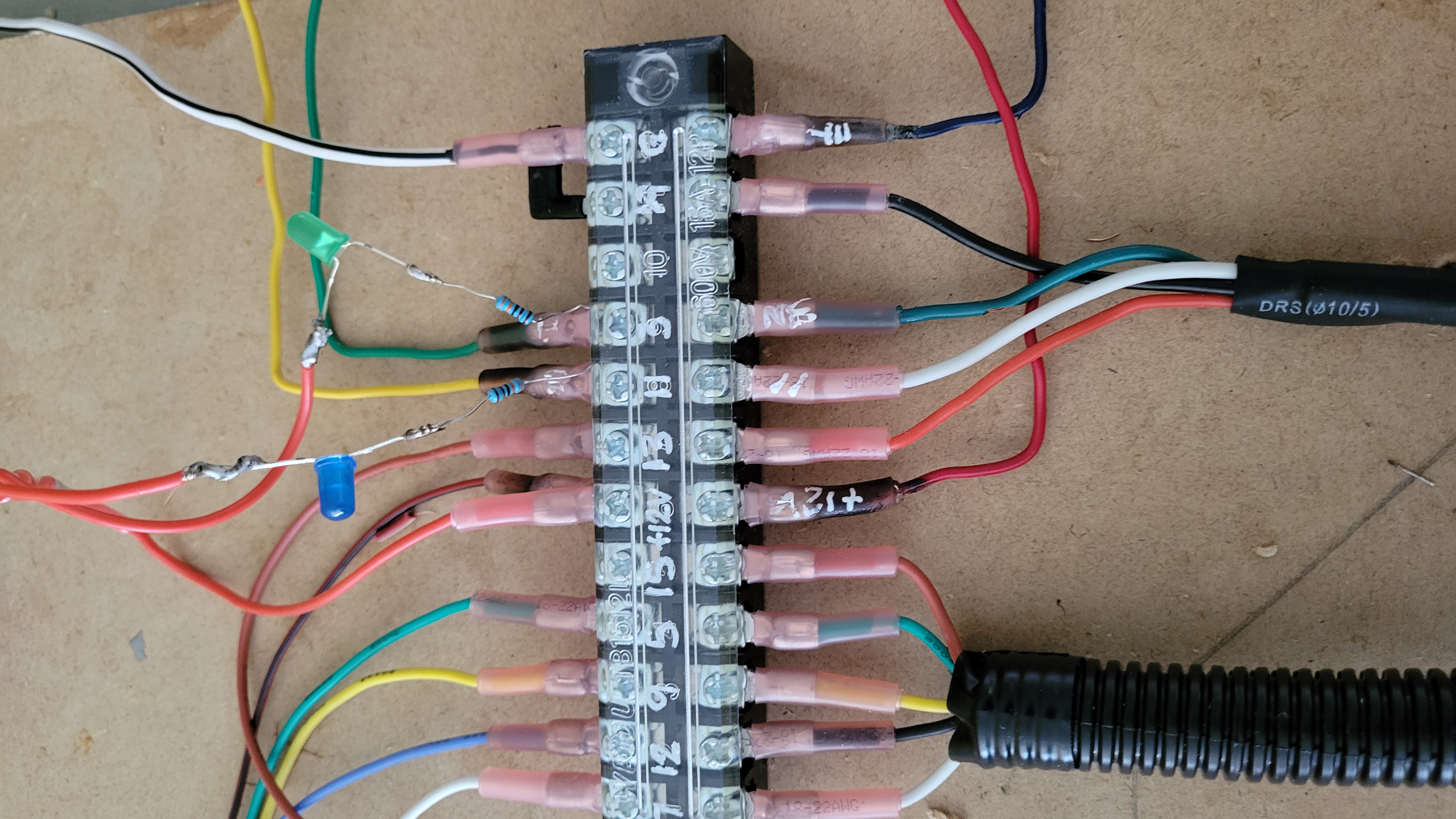

Re: Tesla SDU main contactor not closing
Yes I have led set on pin 11 and 3 pin 11 lights up for a few seconds then turns off but led on pin 3 no light.
Please advise
PS I am using 344 vdc
My udc is 1.59 can't be !?
Please advise
pin 11 will switch off after 5s if udcsw/2 volts have not been reached, i.e. udc < udcsw/2
Something is wrong with your HV wiring/fuse/contactor or, less likely, voltage sense.

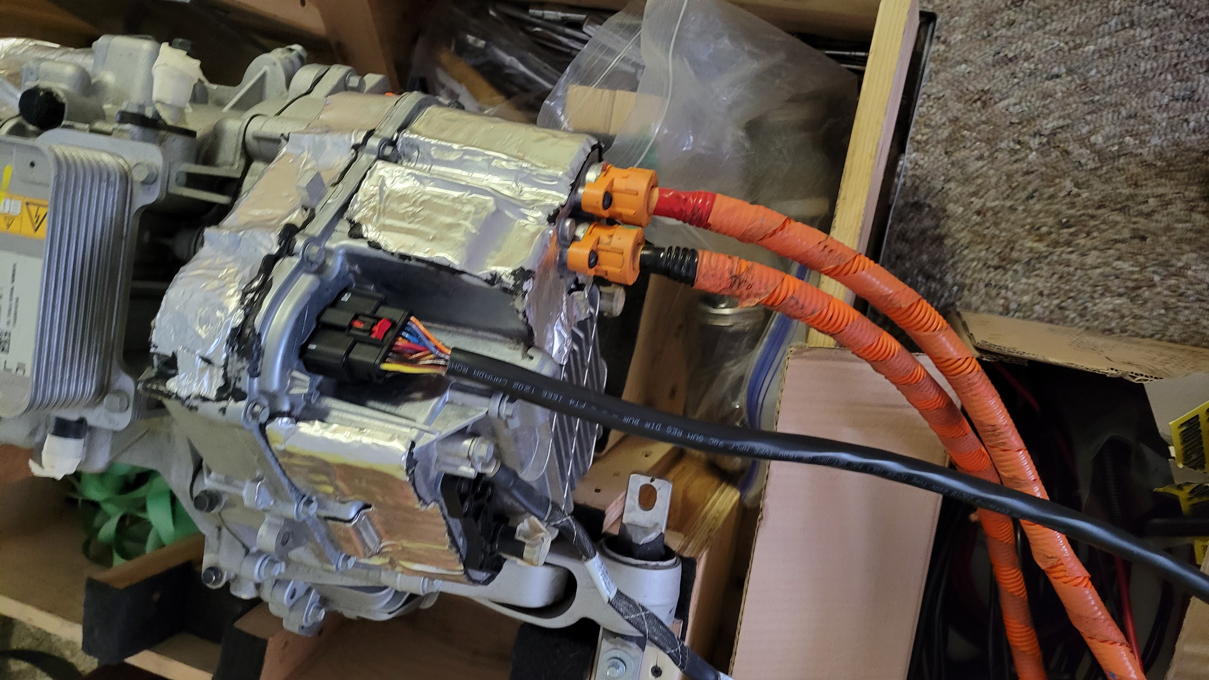

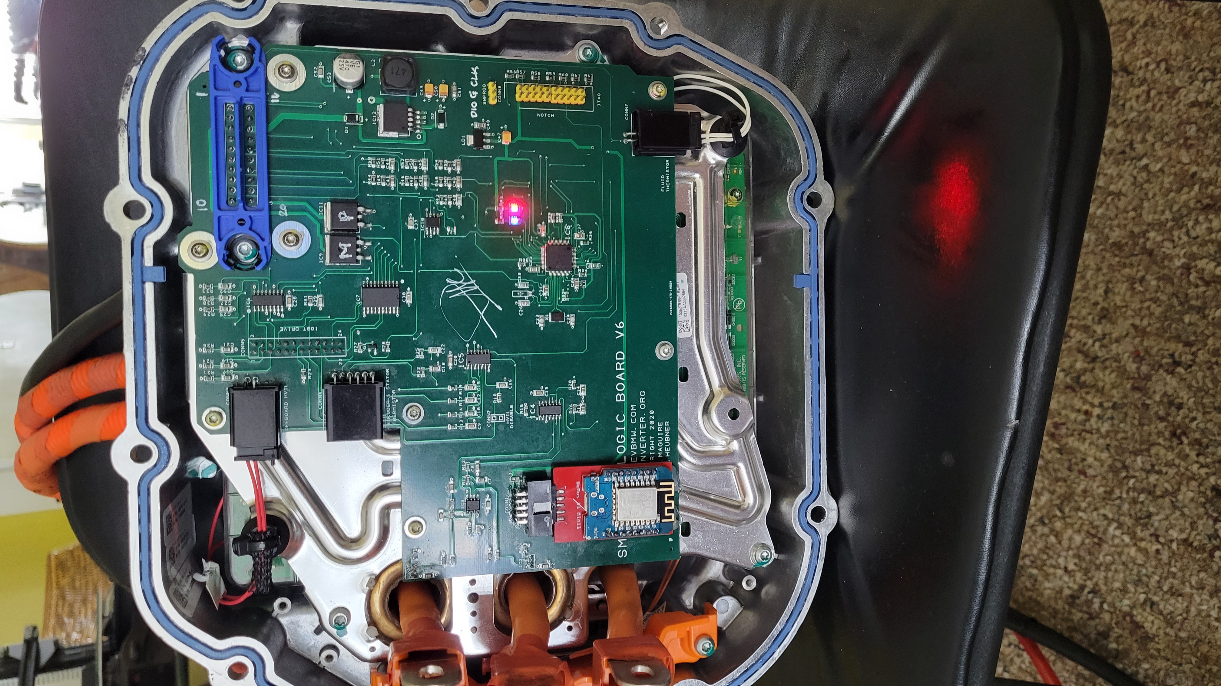

Thanks Isaac96 take care looks like another inverter will look for one on Ebay

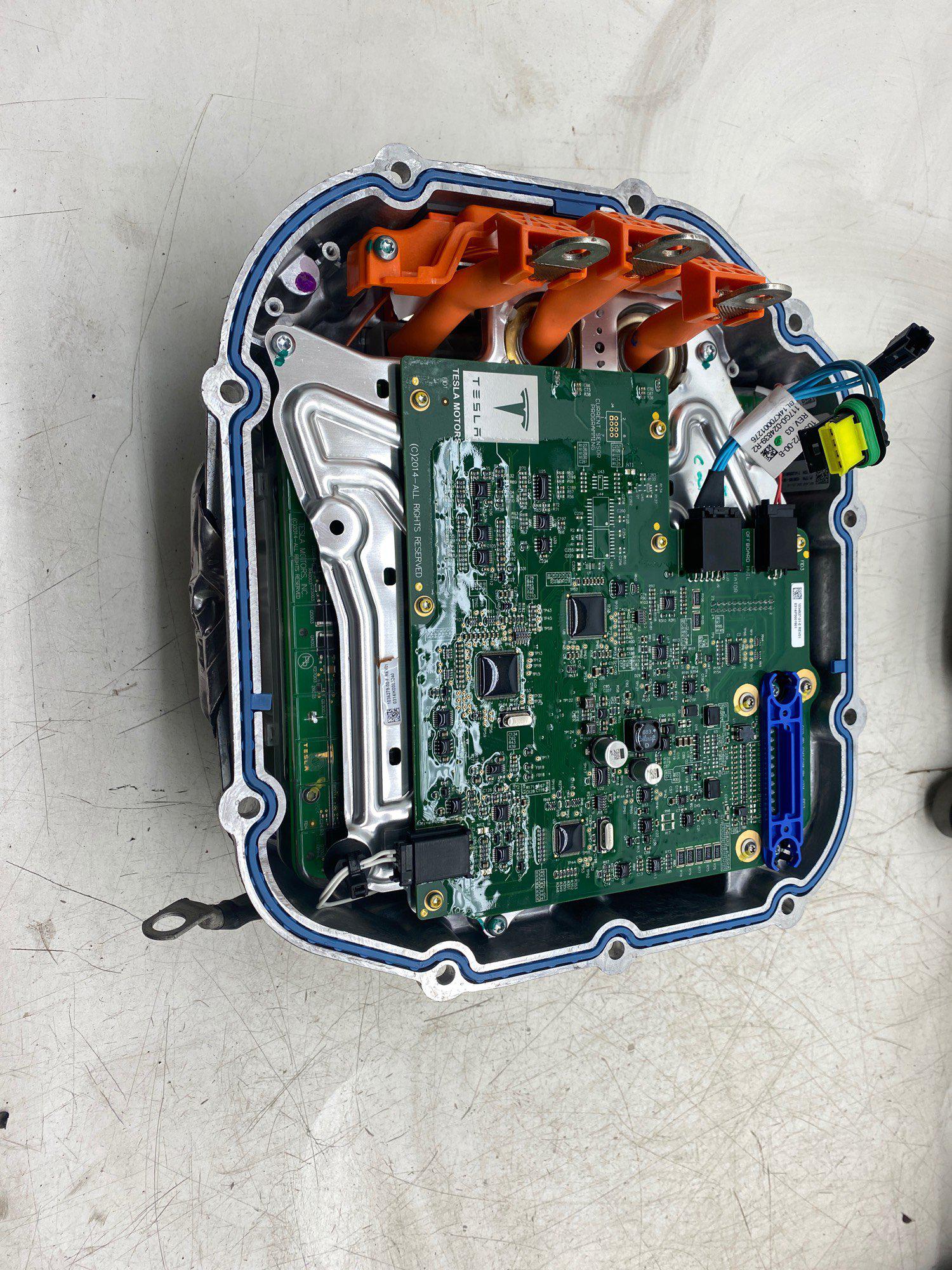

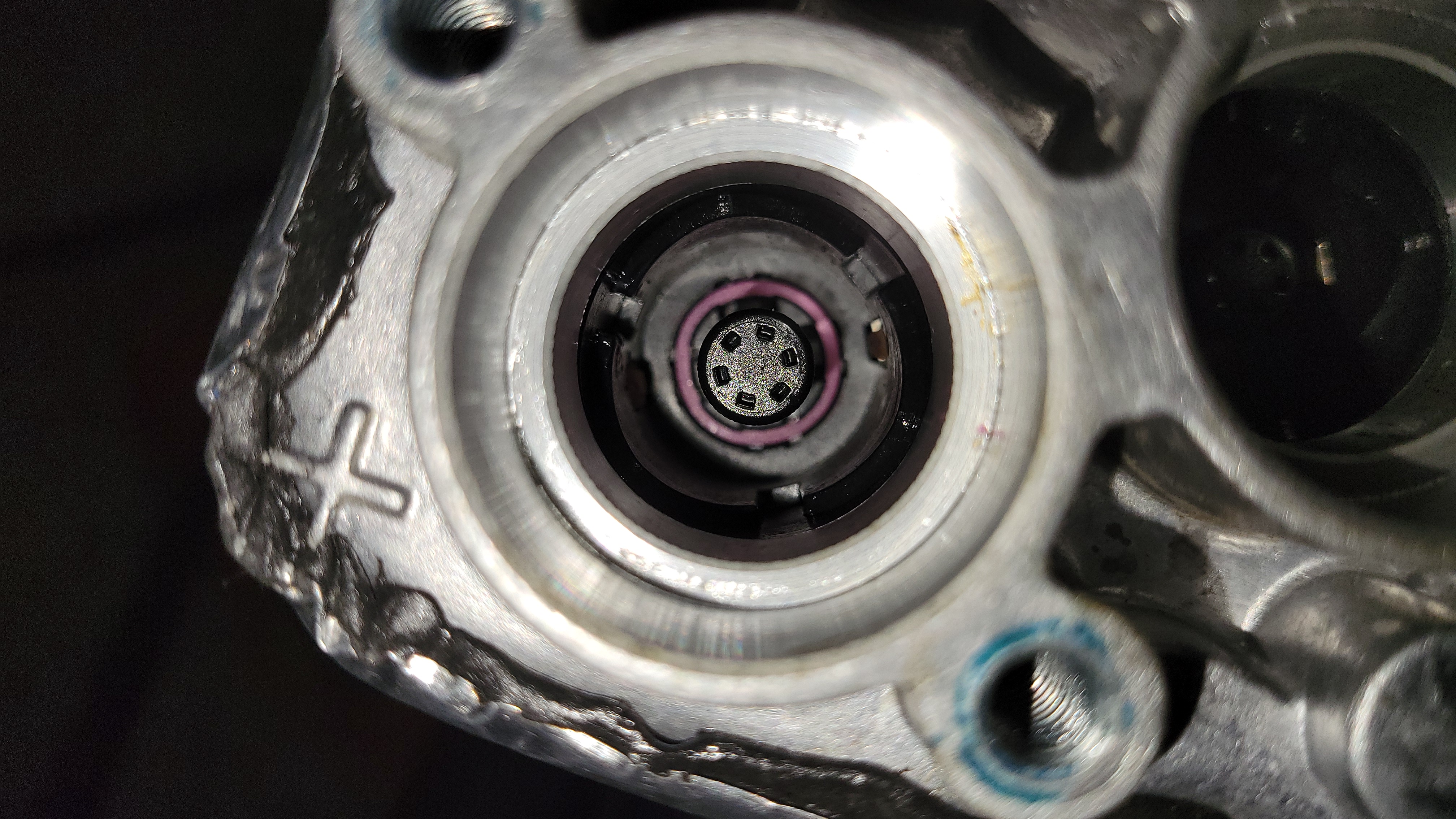

Here are the pictures of the inside of the inverter input HV
Any thing abnormal?
UDC=1.78V now
Any thing abnormal?
UDC=1.78V now
- qmedia2651
- Posts: 56
- Joined: Tue Oct 06, 2020 4:13 am
- Location: Orlando Florida, USA

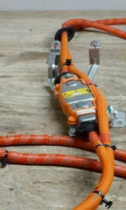

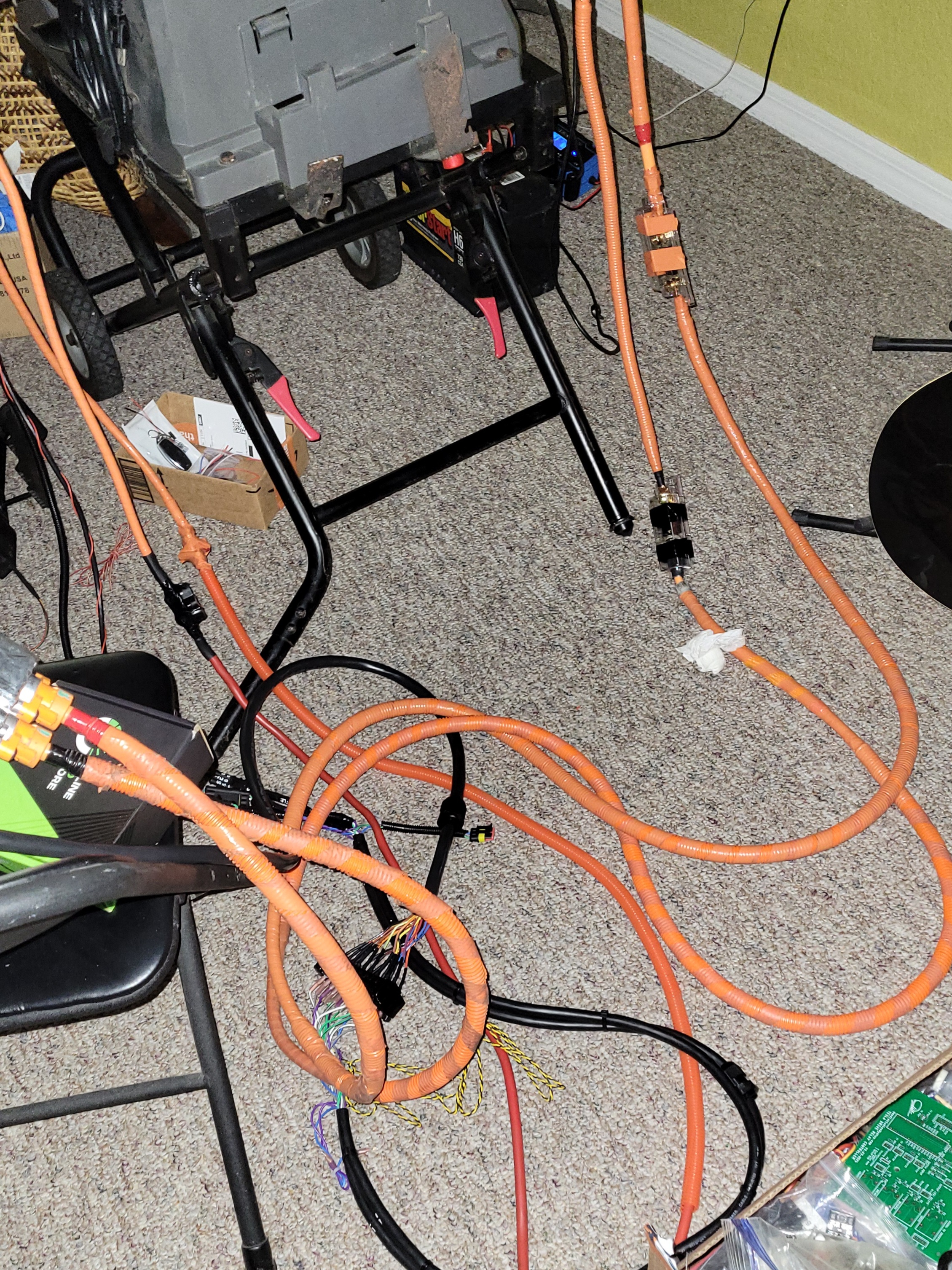

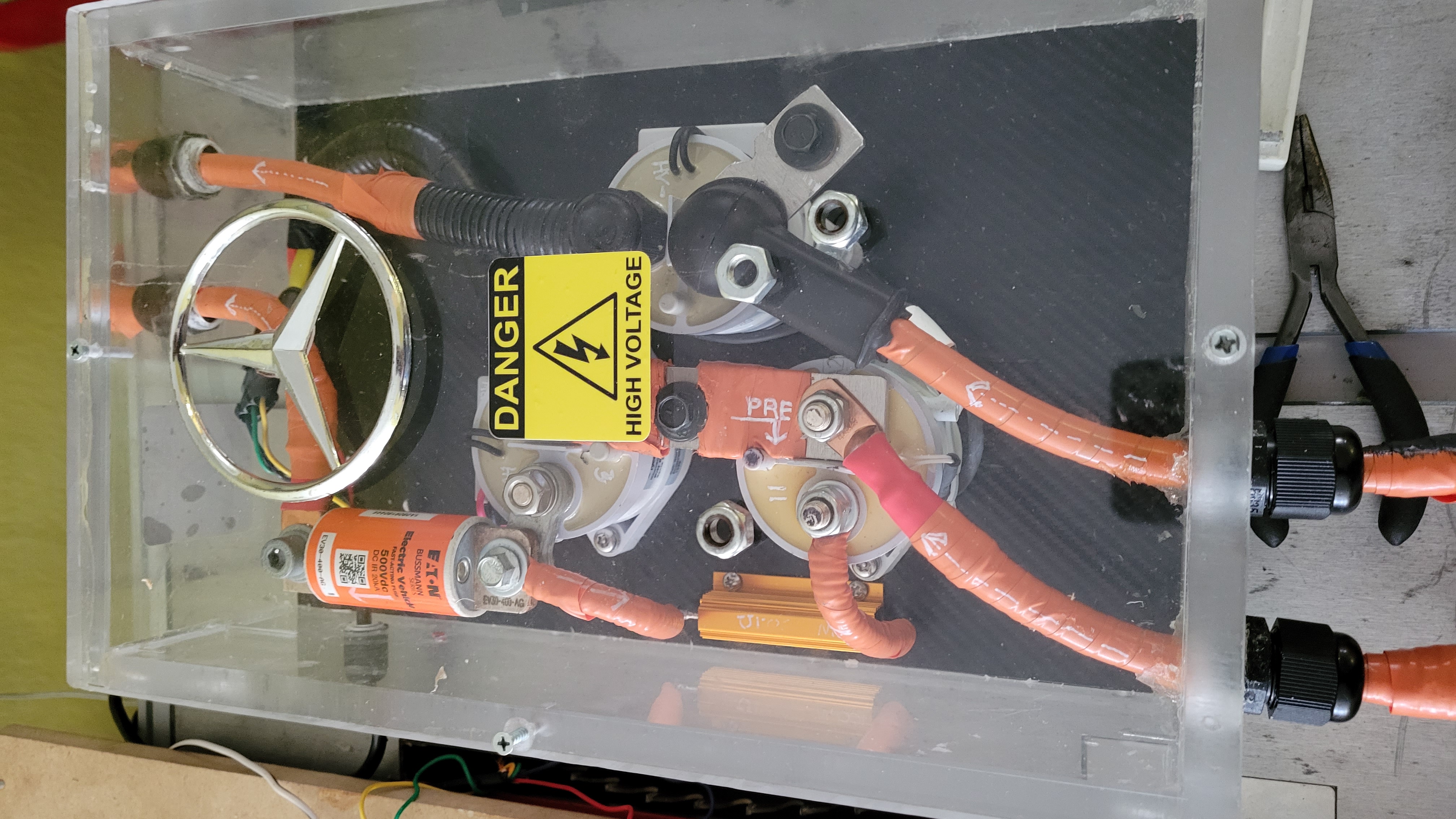

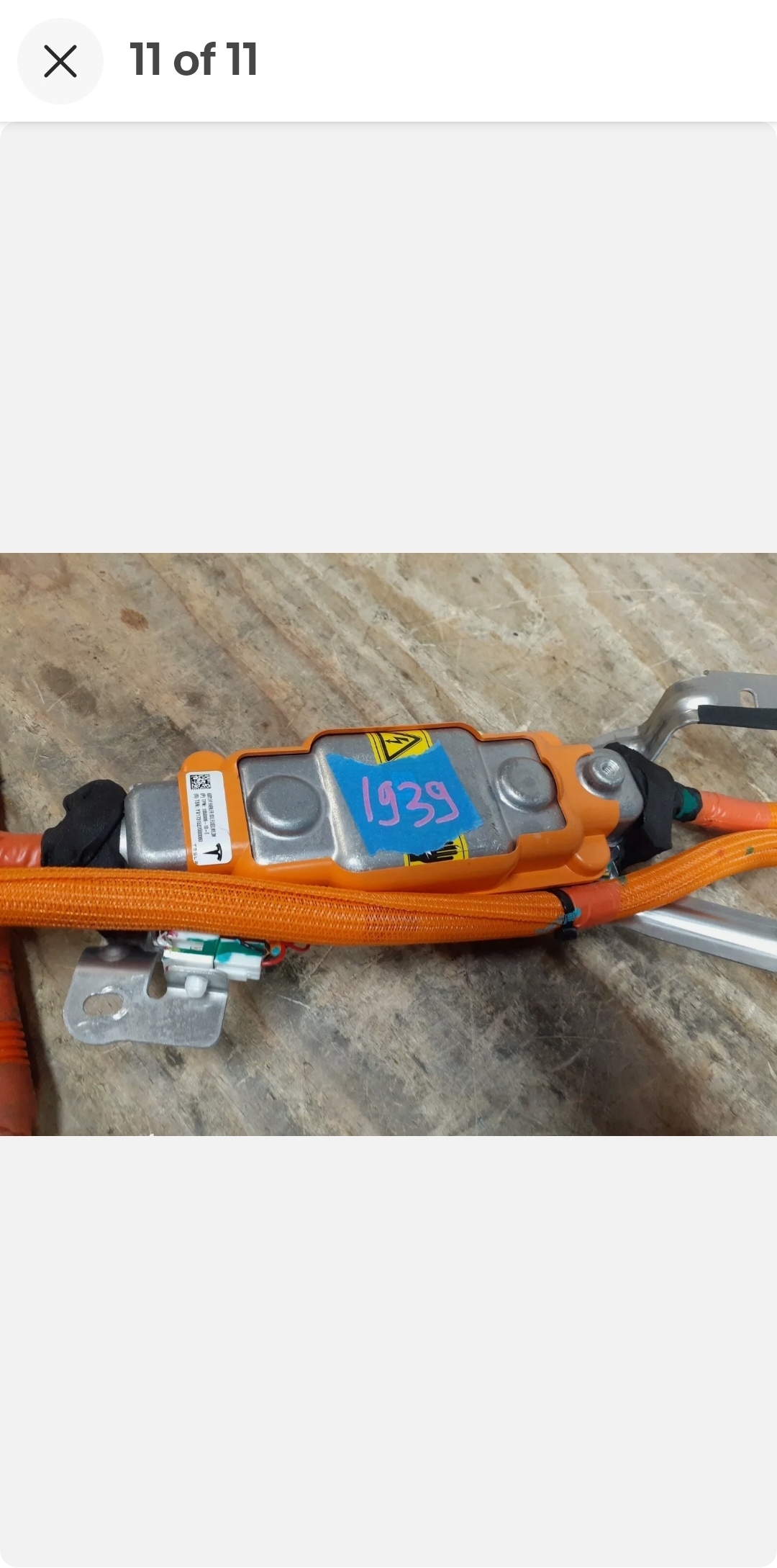

I see that the SDU HV cables have a small box connected to the + HV cable.
My cable doesn't have that I have my own HV Box and fuse. CAN THAT BE A PROBLEM WITH THE INVERTER.
See picture
See picture
- qmedia2651
- Posts: 56
- Posts: 656
No, you don't need that box. Connectors look fine too. Looks like it's the inverter then.
If you have contactors on do you get voltage at the inverter end of the cables?

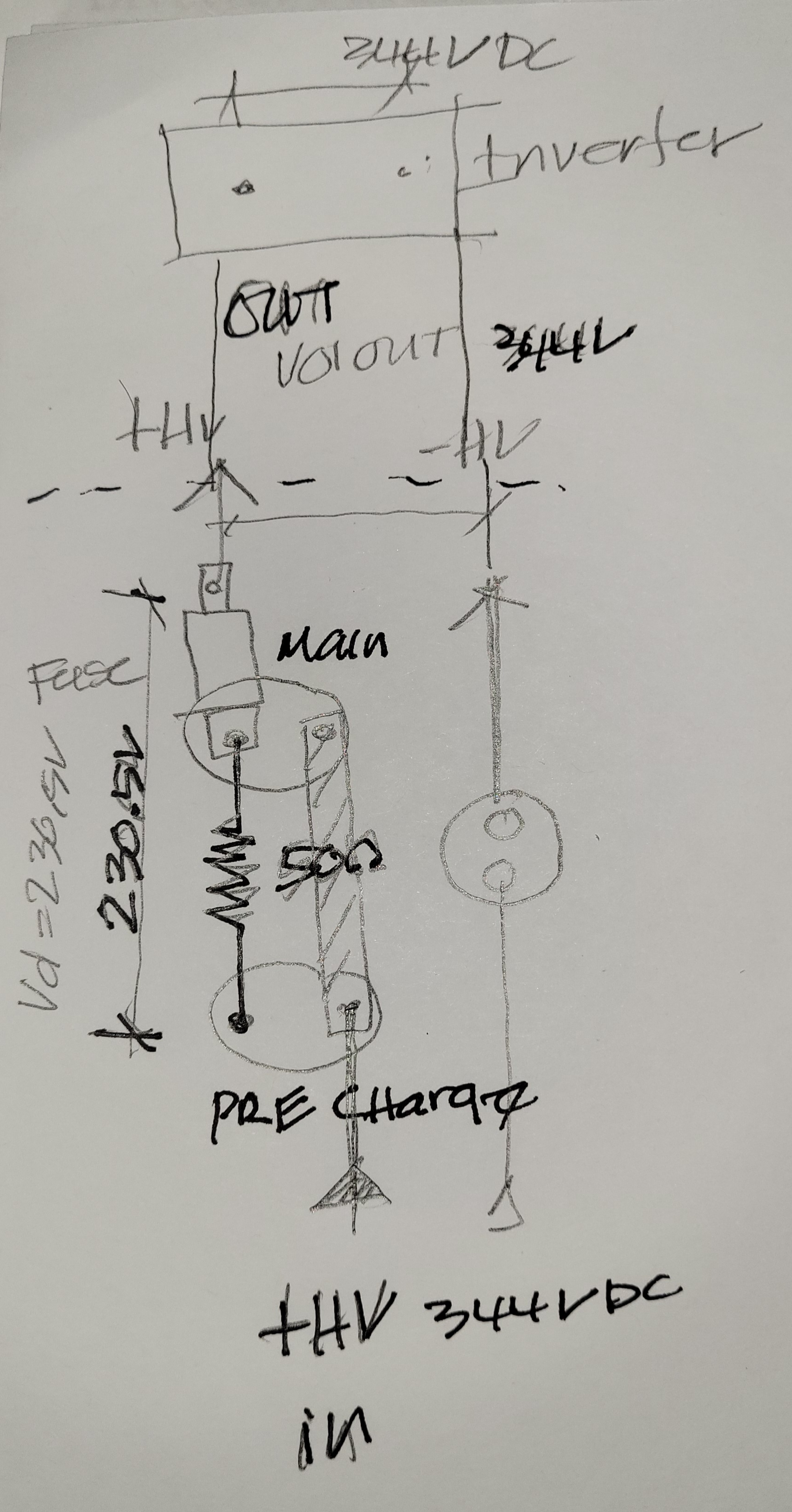

- qmedia2651
- Posts: 56

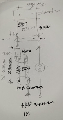

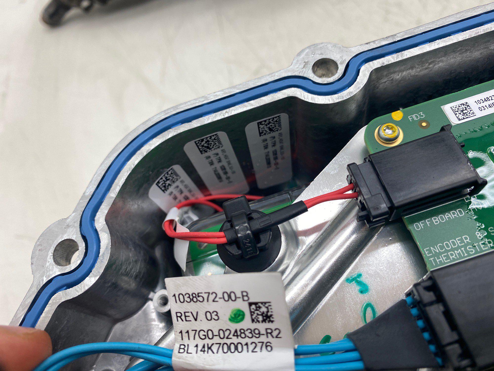

Yes I do 344v
In the pic correction Vd is 230mv not 230.5v.
Input voltage =output voltage = 344vdc
Therfore this proves that the capacitors are changing .
After checking all voltage and continuity of IGBT conn 5
And continuity from pin 1 to R31 to Pin 11 on the STM32
My conclusion is that the 24 pin IBGT conn 5 ,pins are not connecting to the inverter pins.
Need part number for 24 IGBT conn 5 it's not on the bill of materials list.
Any one out there please advise
- qmedia2651
- Posts: 56
Looks like my IGBT Connection 5 is bad any one knows the info for this connection model number ect ..........

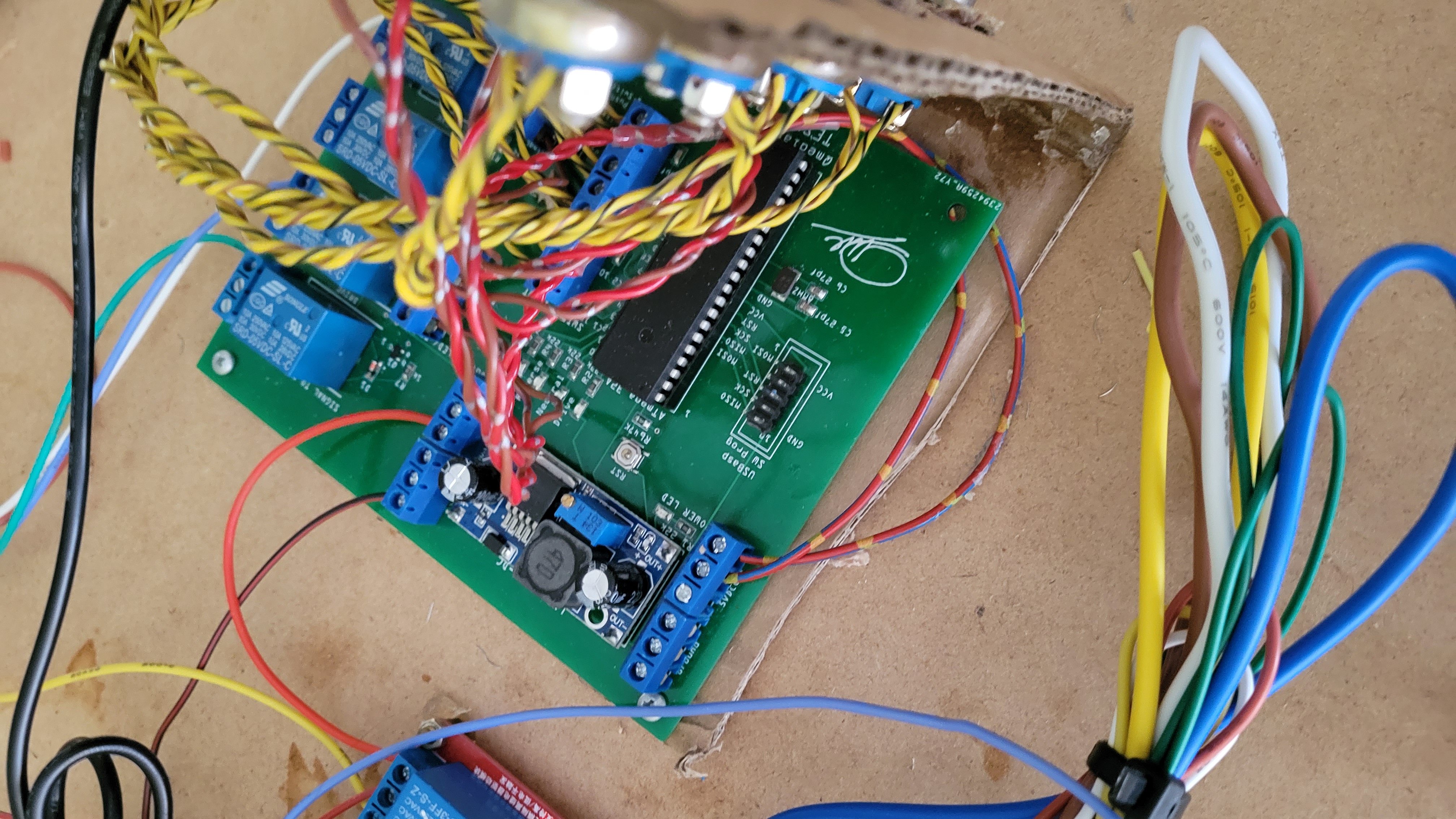

Today I put in a new logic board from JLCPCB supplied with Damien's Gerber file they sent me 5 populated boards.
And found same results as with the former one .
CONCLUSION BAD INVERTER. WELL SHIT HAPPENS.
LOOKING FOR A SDU INVERTER.
I hope the Gerber files are good.
