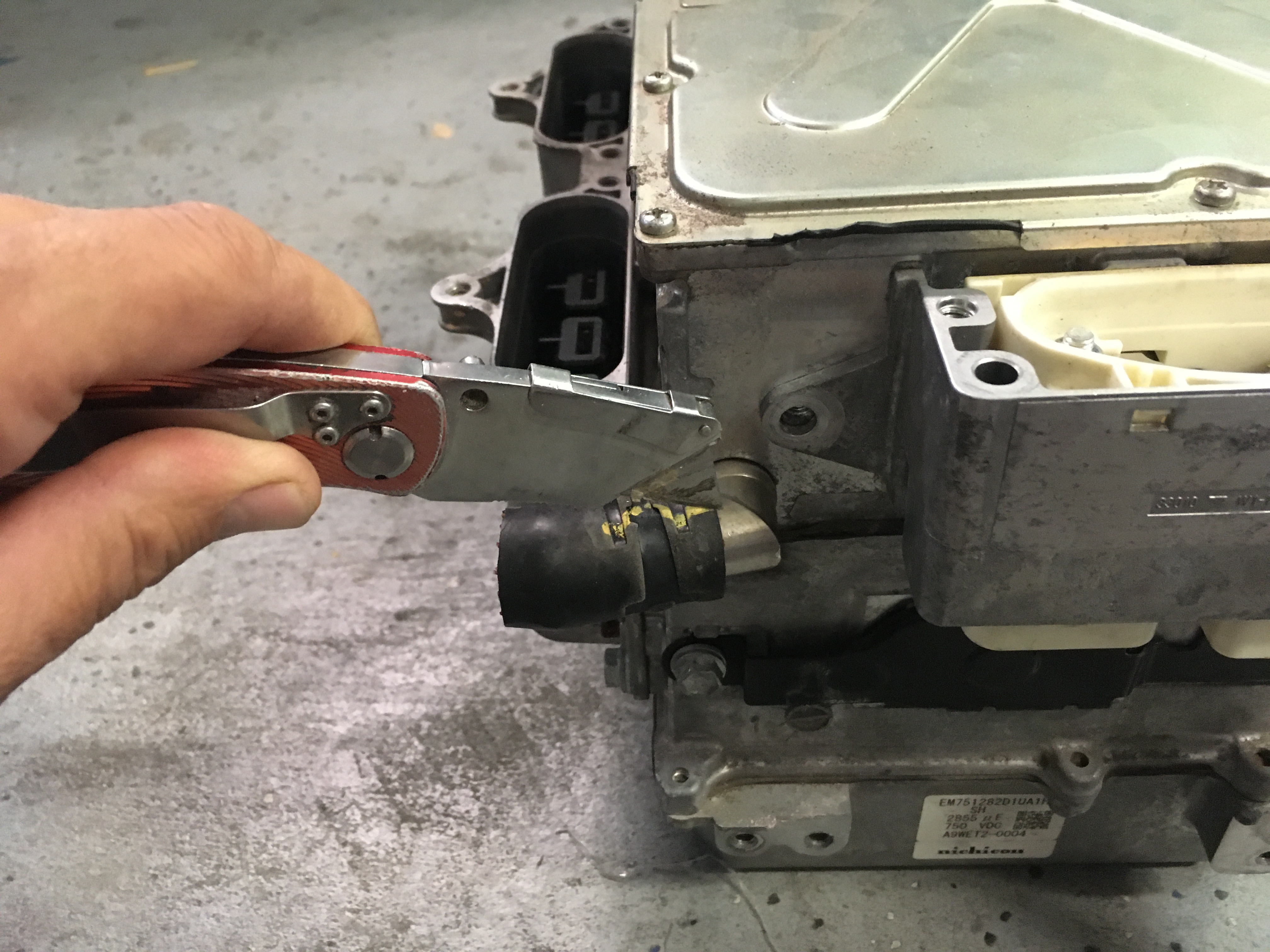

Post by Gregski »

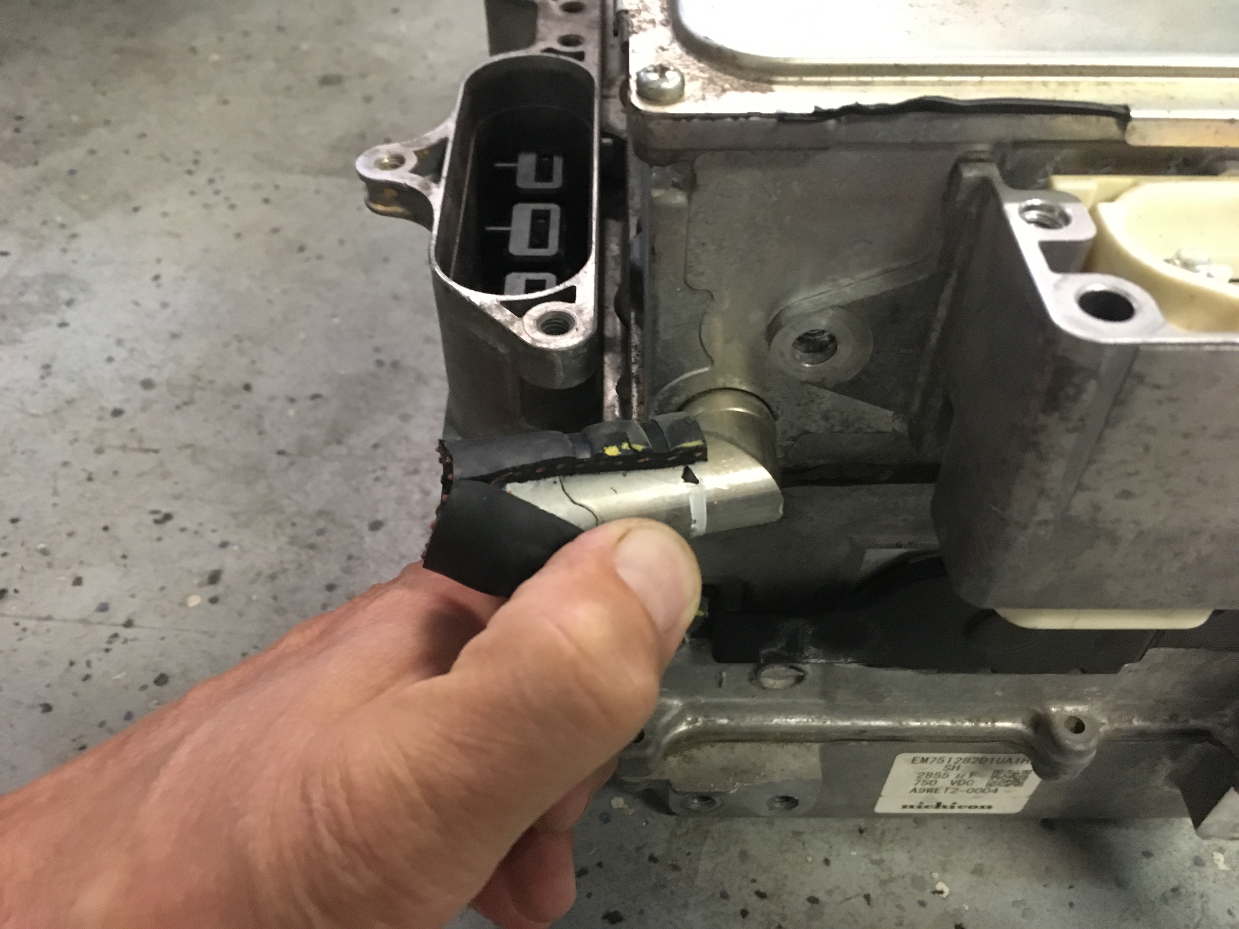

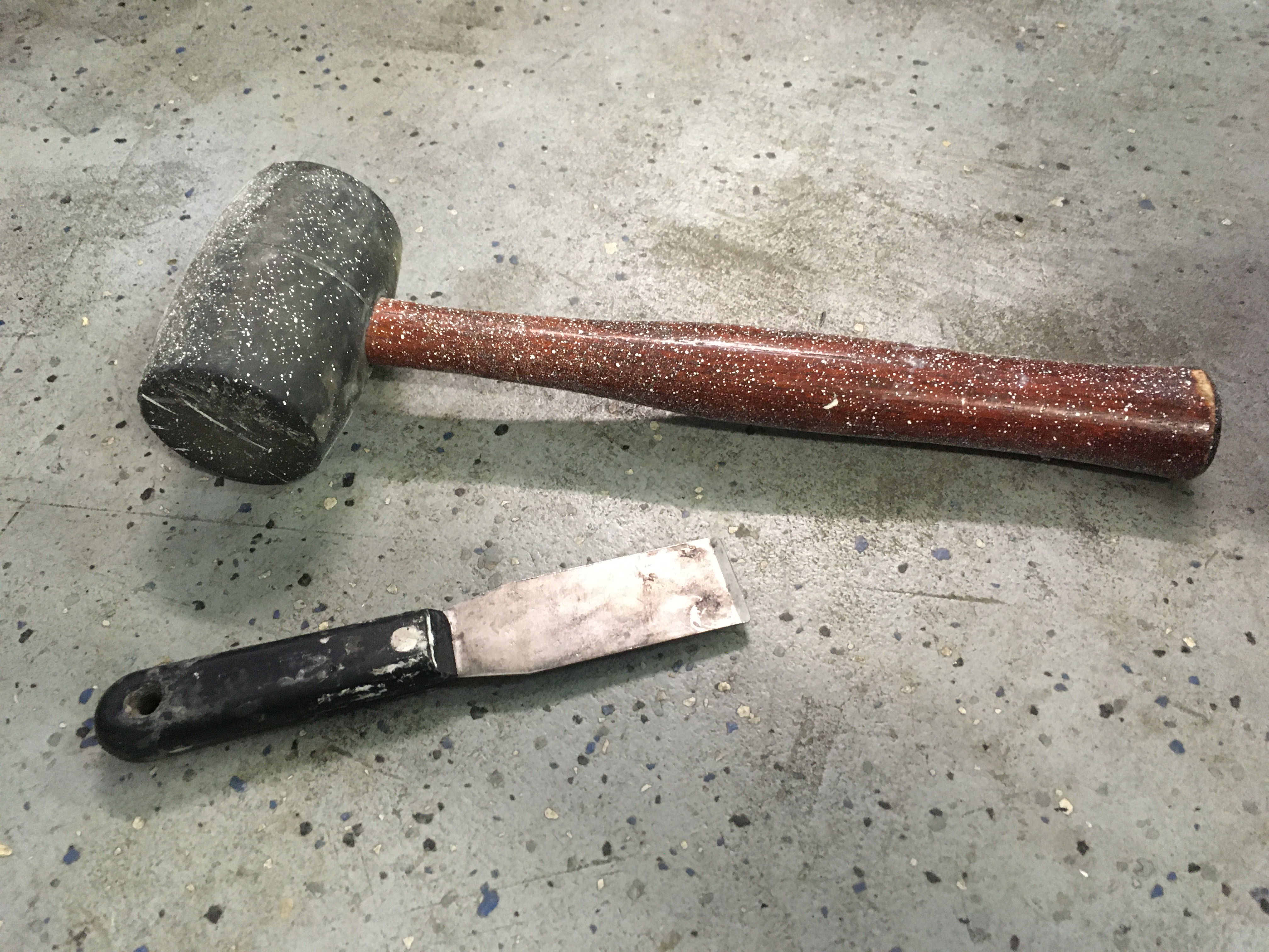

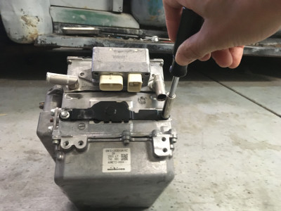

Top Tip: for liberating old stubborn rubber hoses from metal hose ends, cut them length wise with a sharp box cutter blade and split them open
Gregski
Posts: 2272
Has thanked: 327 times
Been thanked: 450 times
Post by Gregski »
my ground breaking progress continued
Gregski
Posts: 2272

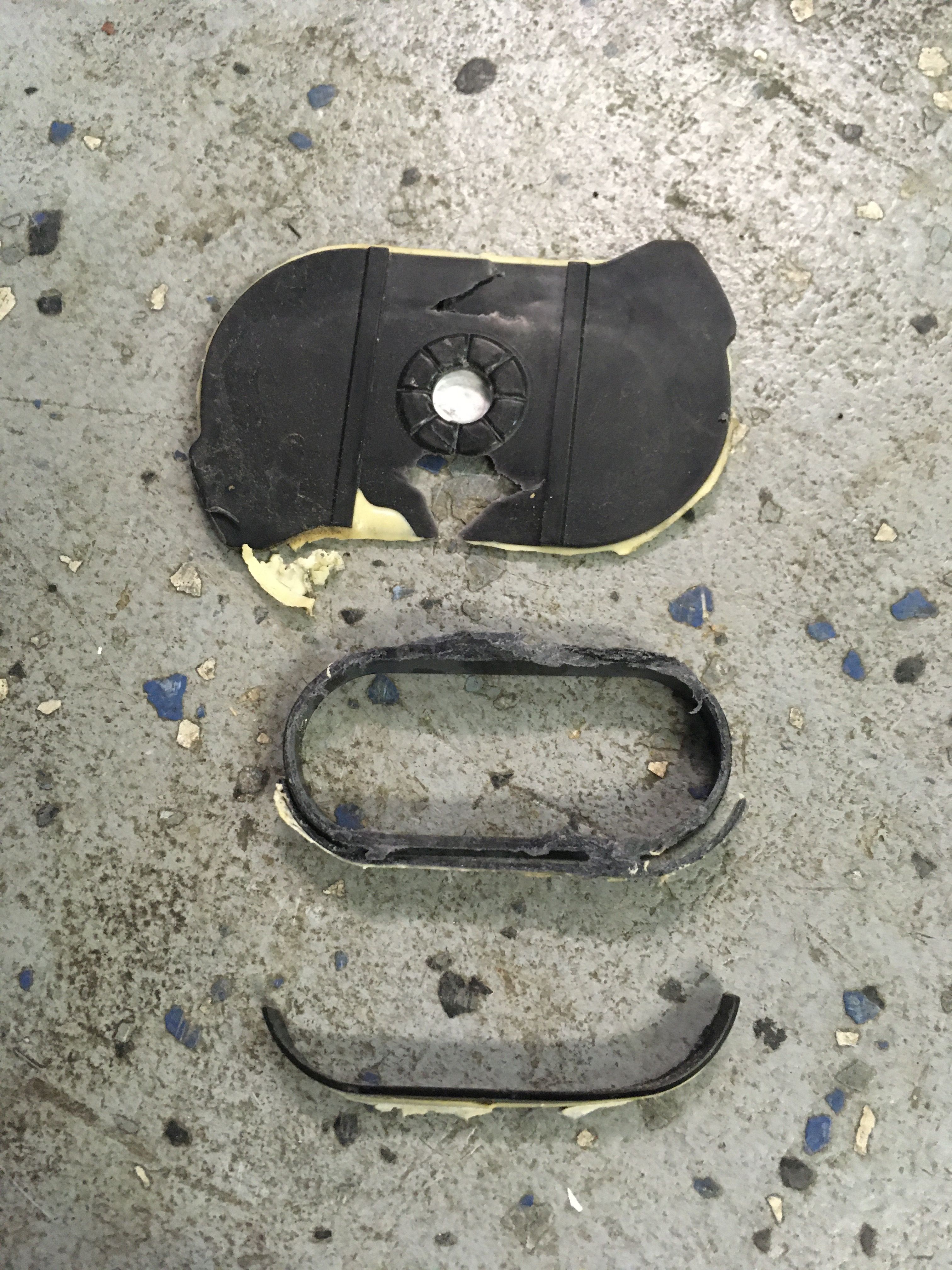

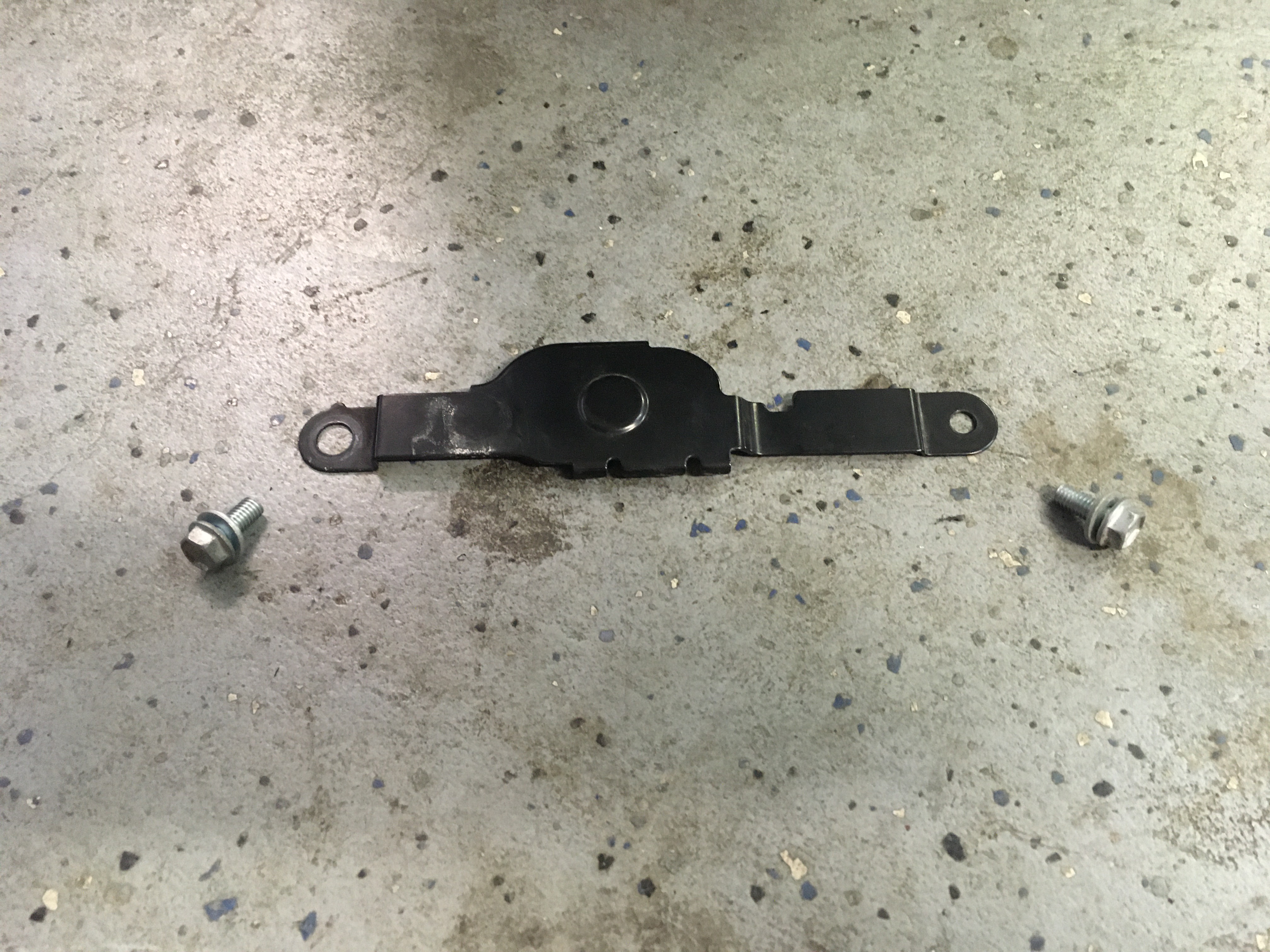

Post by Gregski »

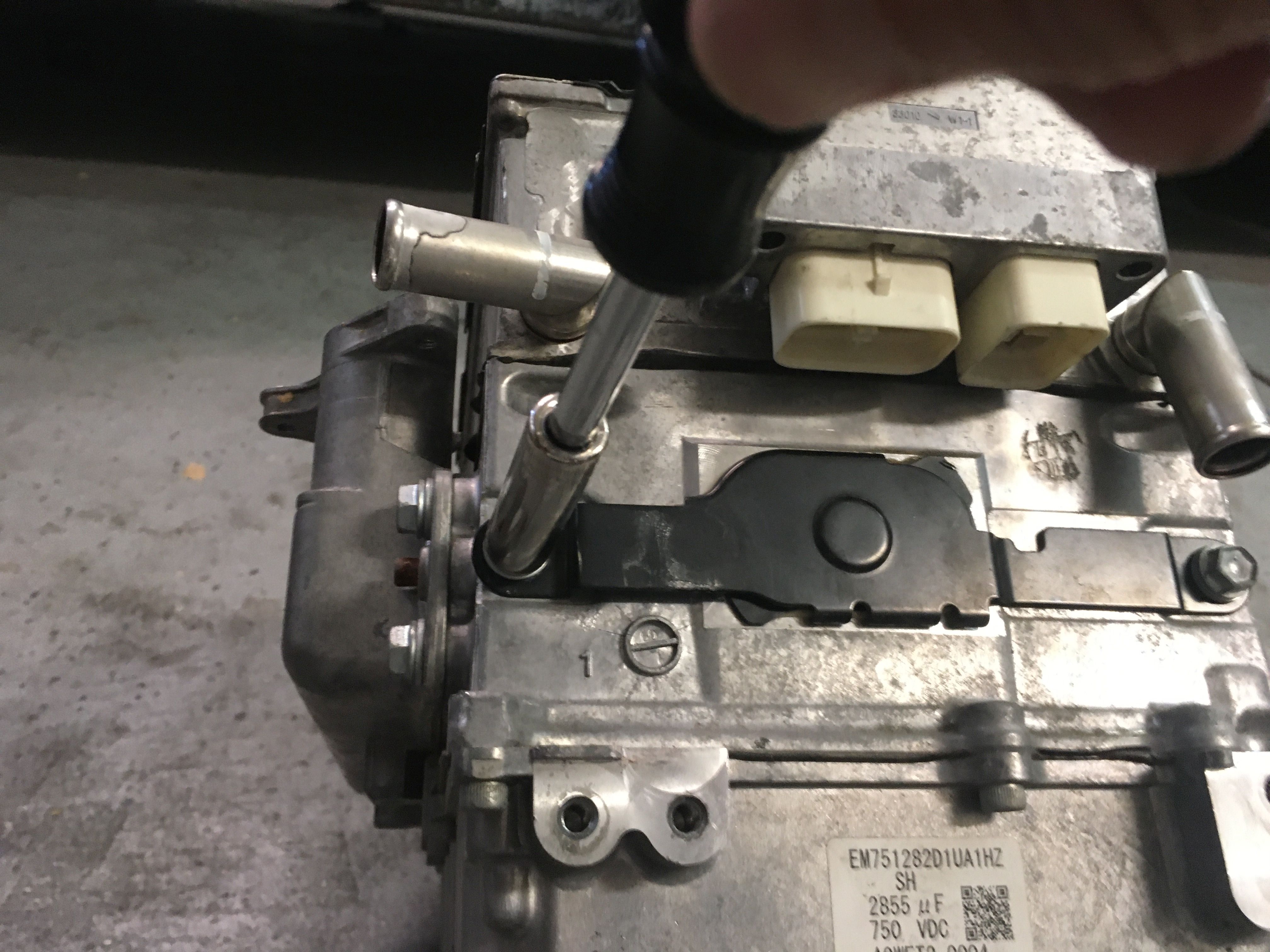

and removing the glued on plastic underneath that black metal strip required my level of precision

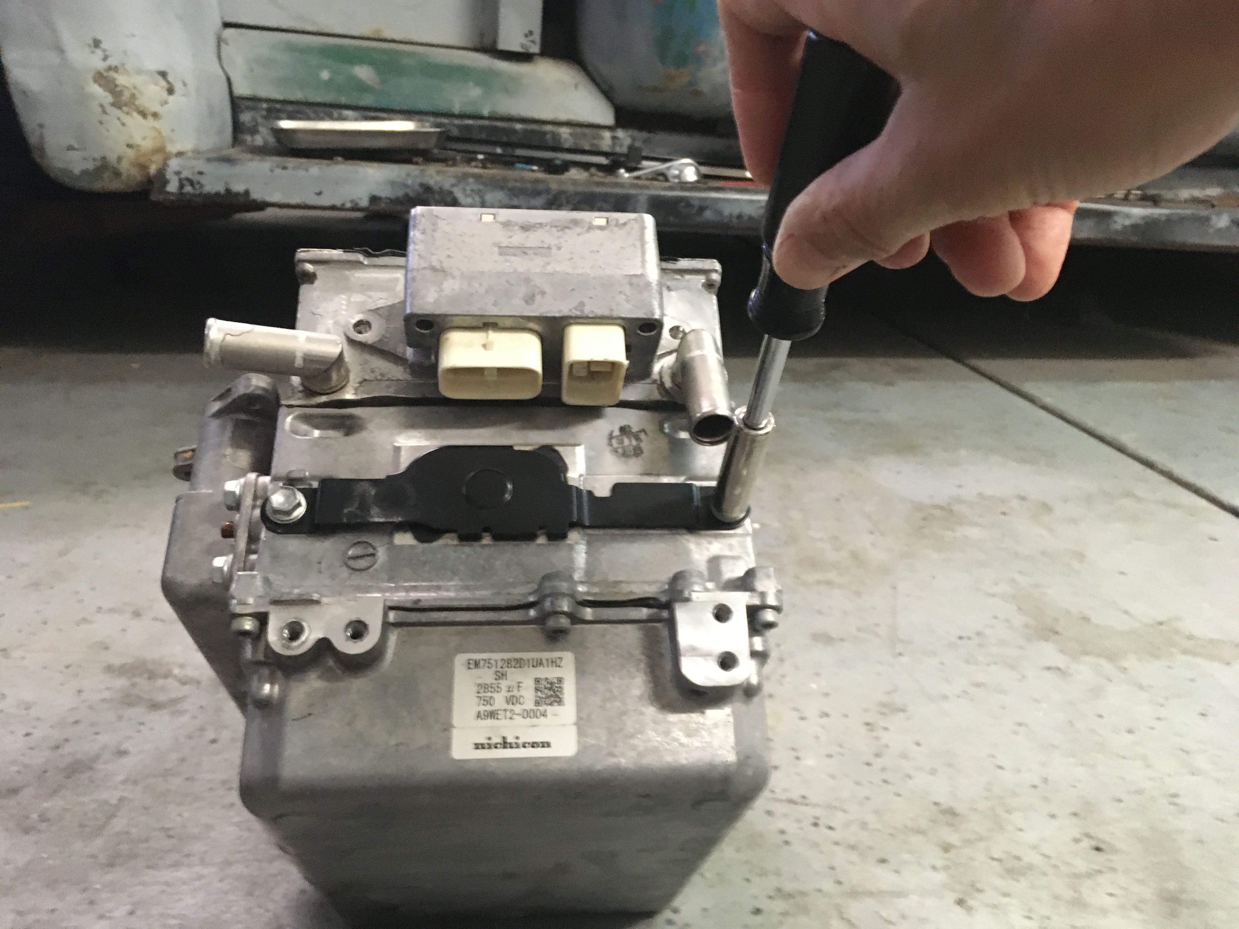

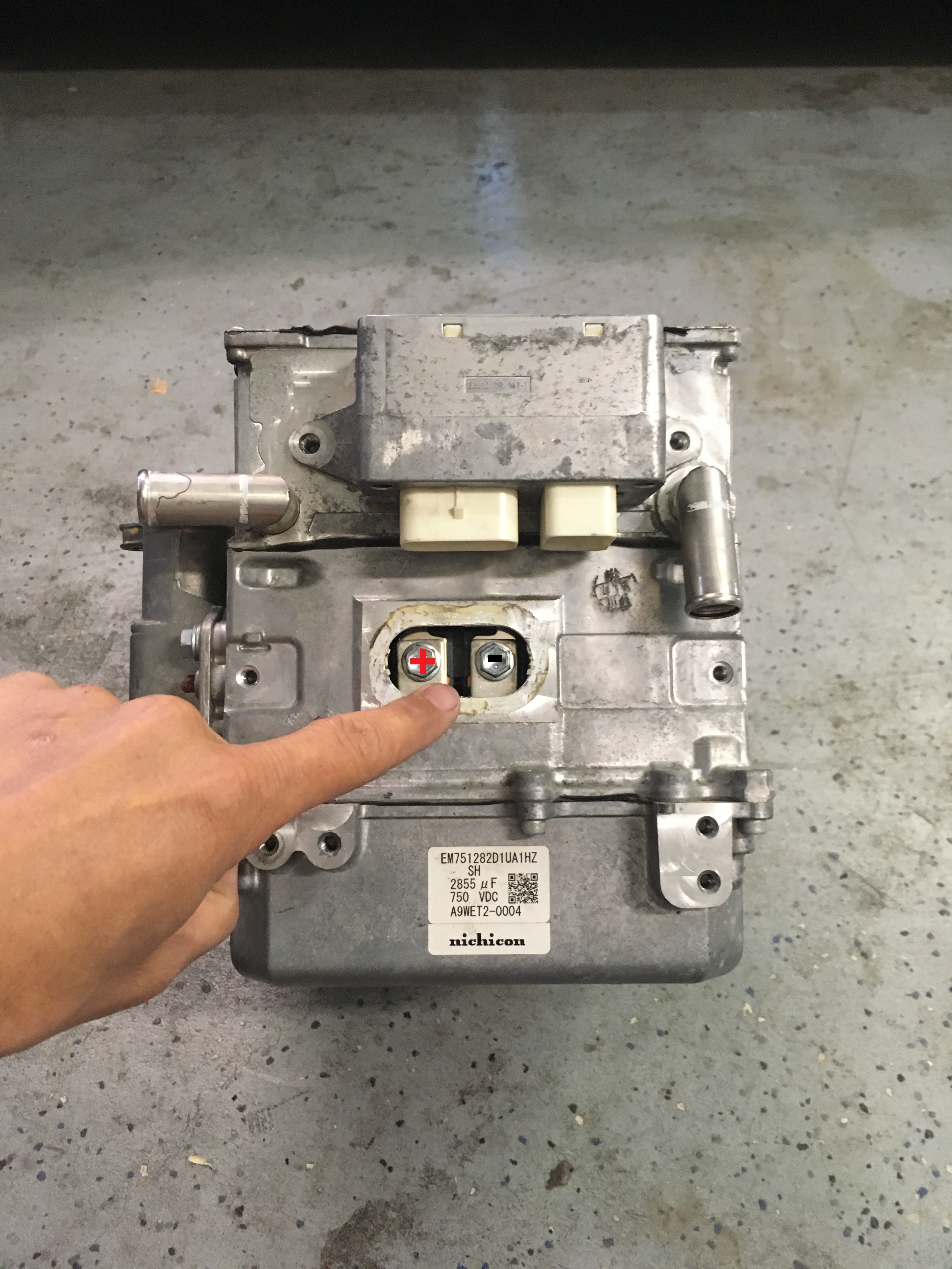

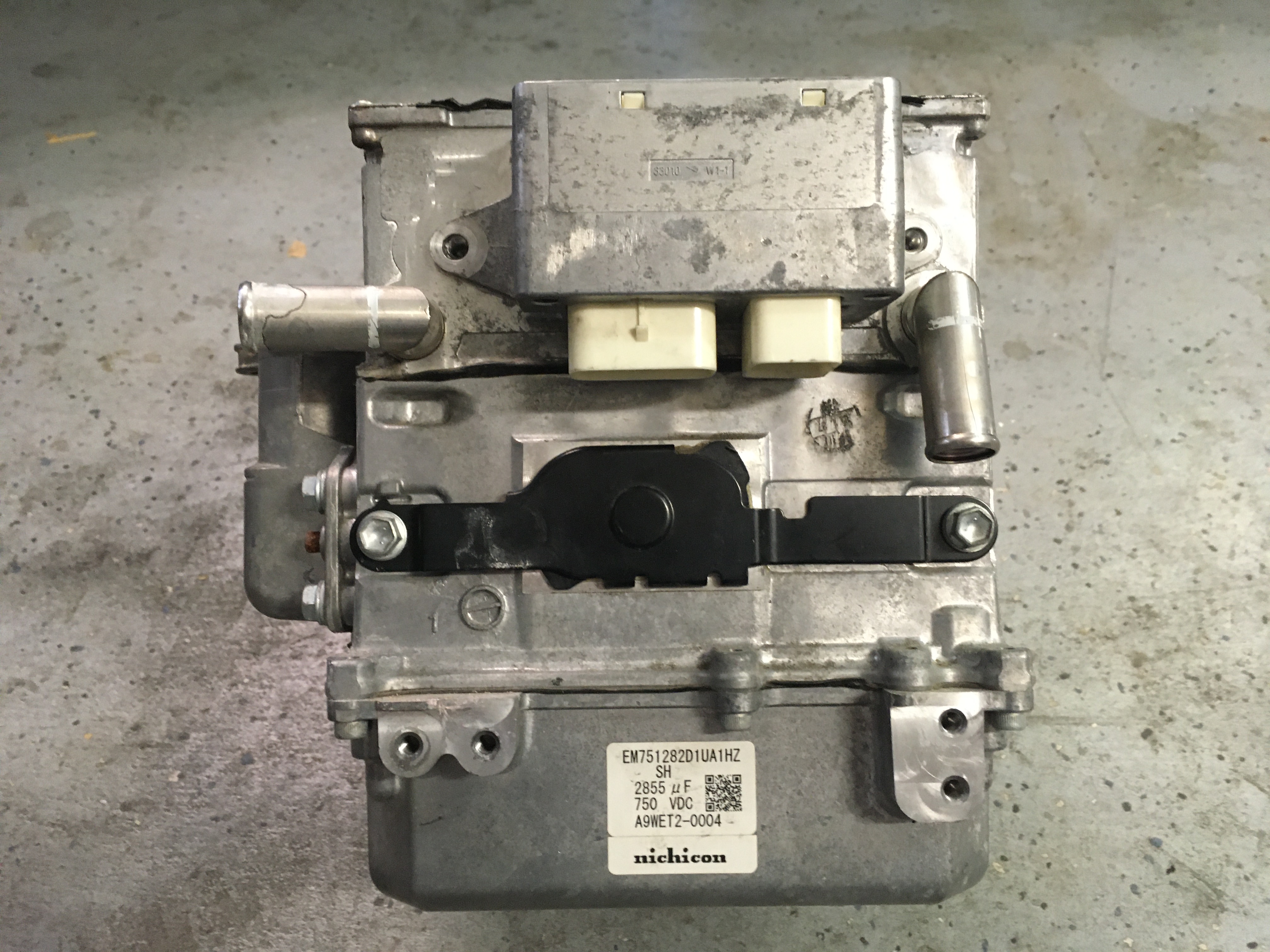

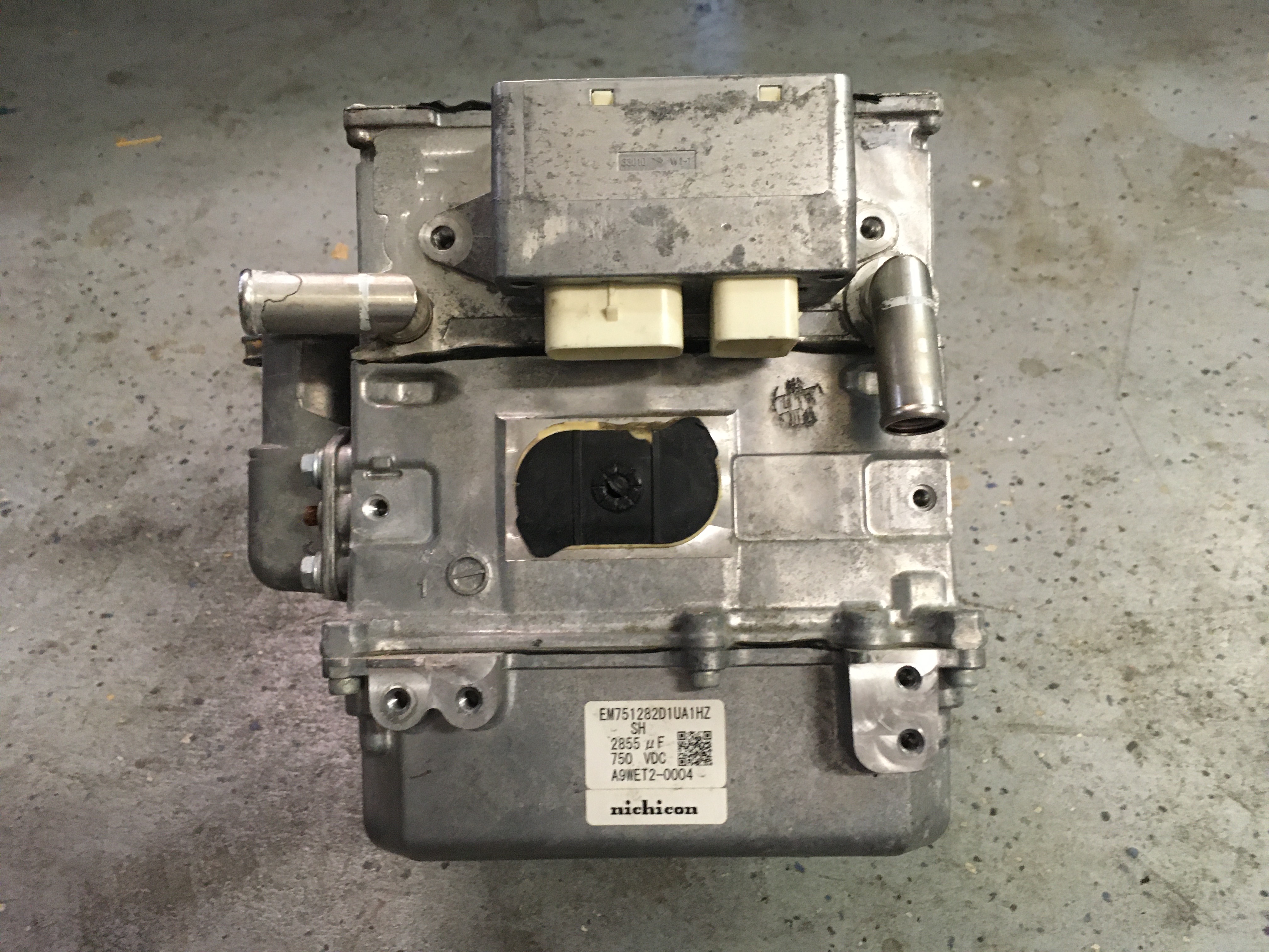

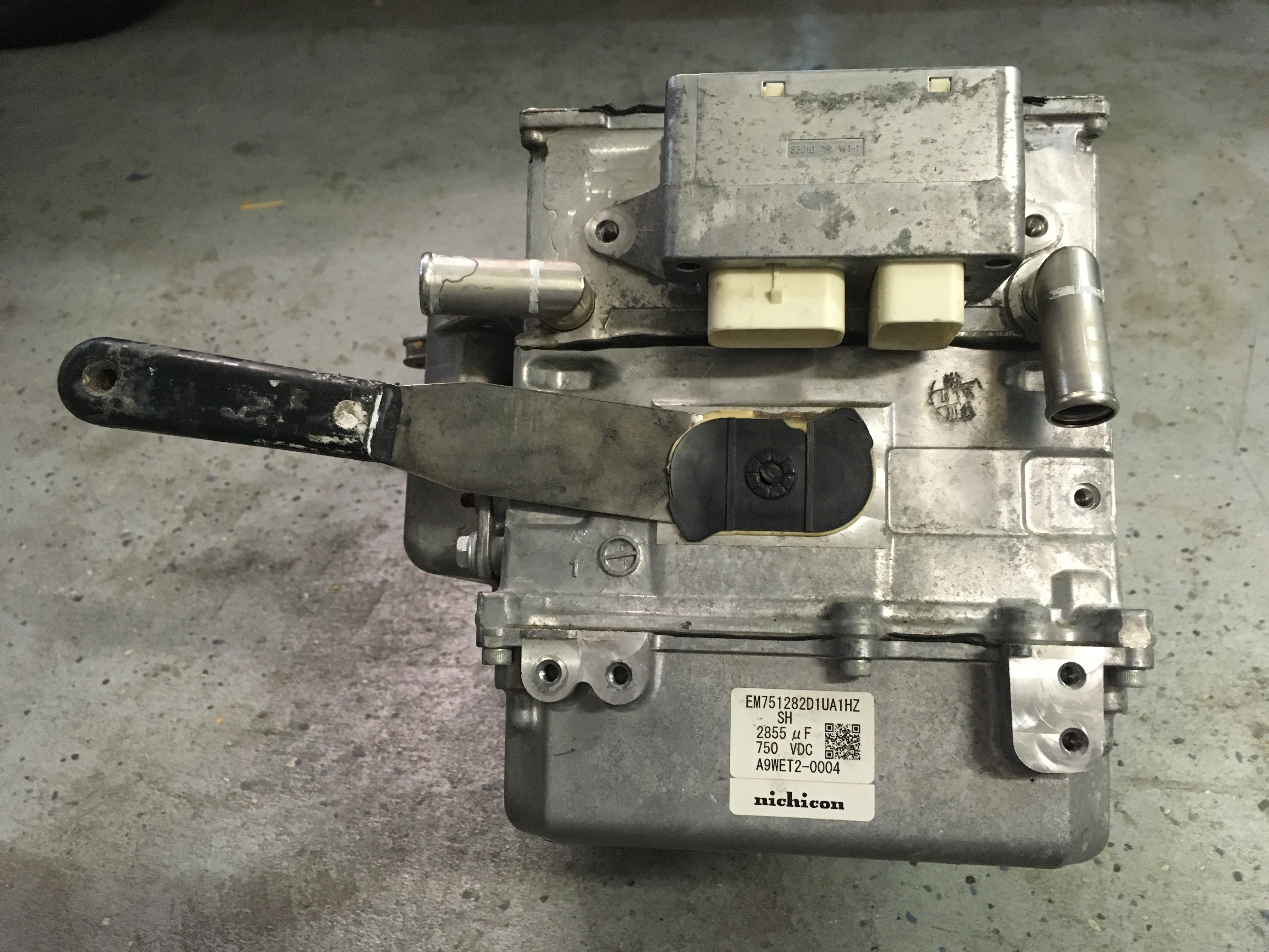

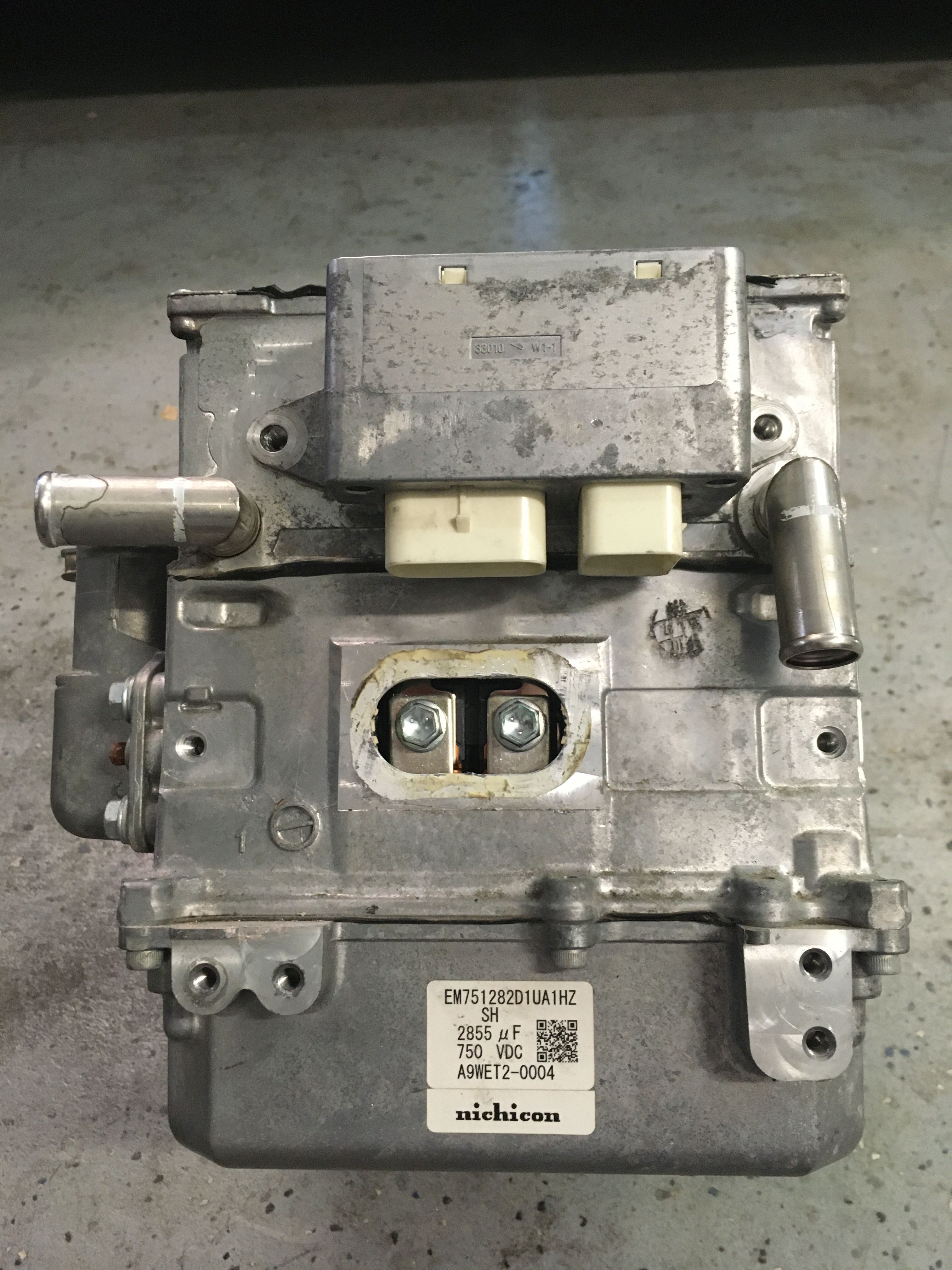

Post by Gregski »
I decided to labelize ("Add" and "Subtract") these bus bar thingies as Damien likes to flip the Inverter upside down from time to time to make things interesting in his videos, this is where we will connect our electron hoses later on

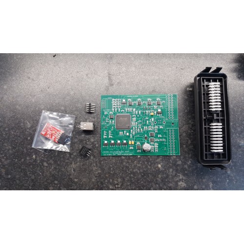

can you guess who this is from? I'll give you a hint, have you ever heard of the Gnome Cat?
Gregski
Posts: 2272

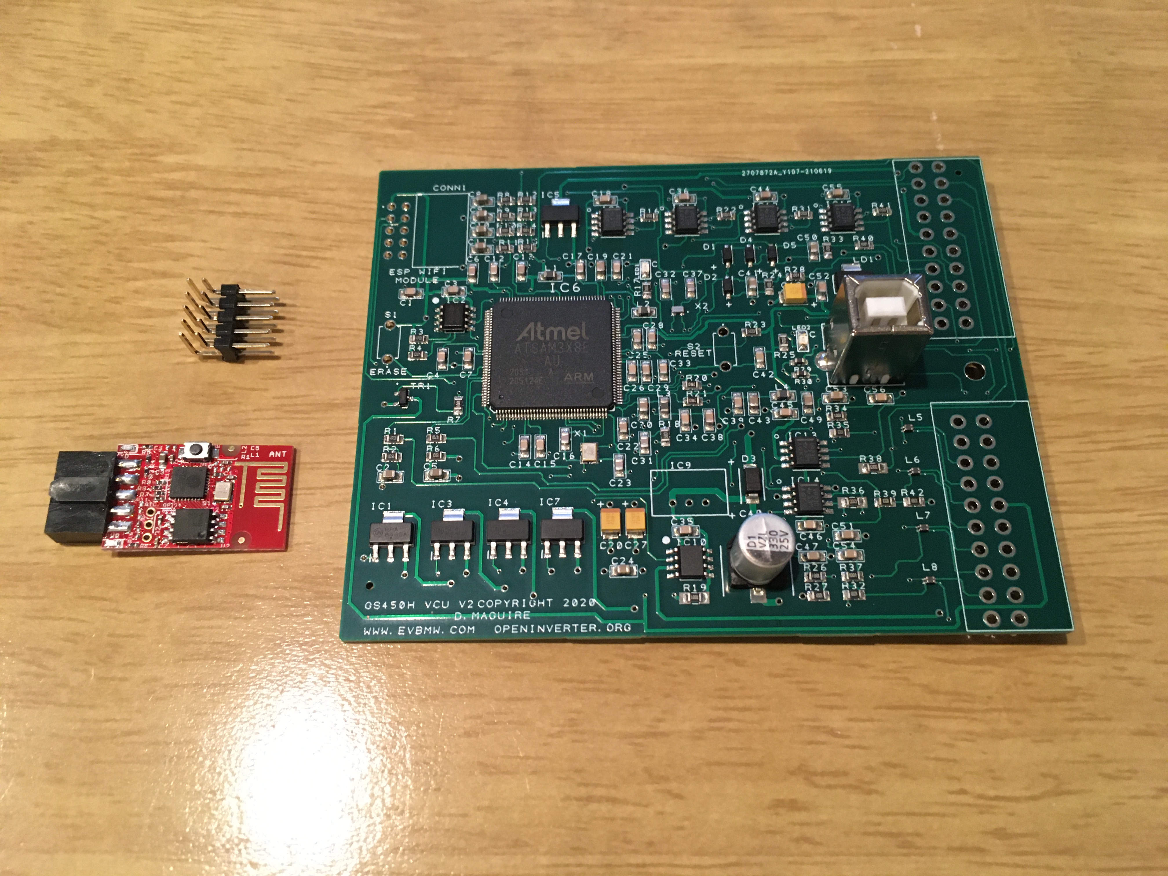

Post by Gregski »

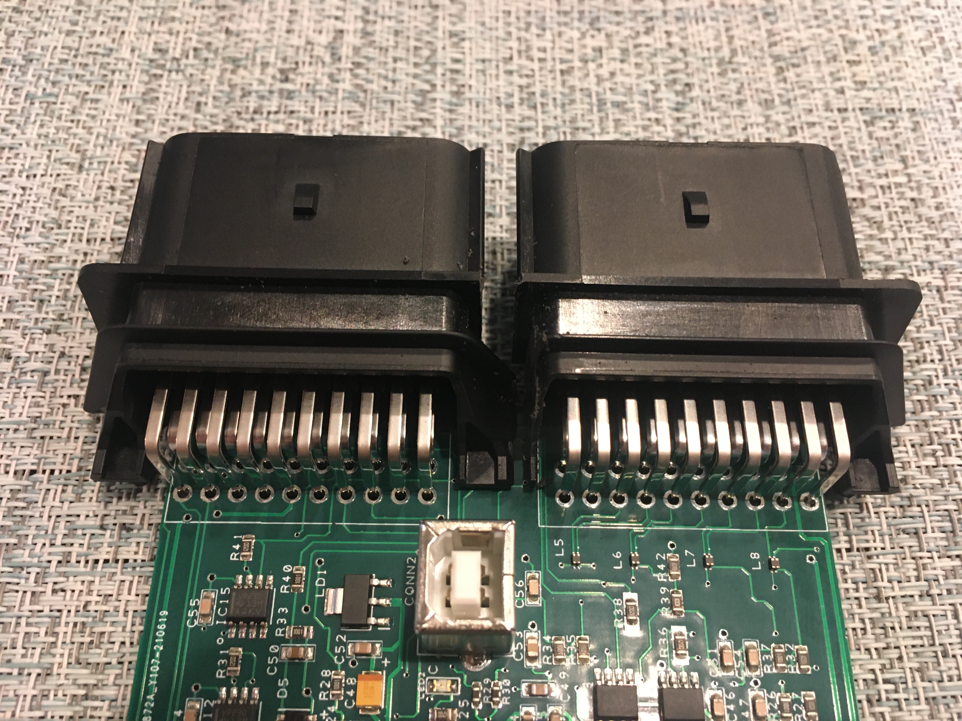

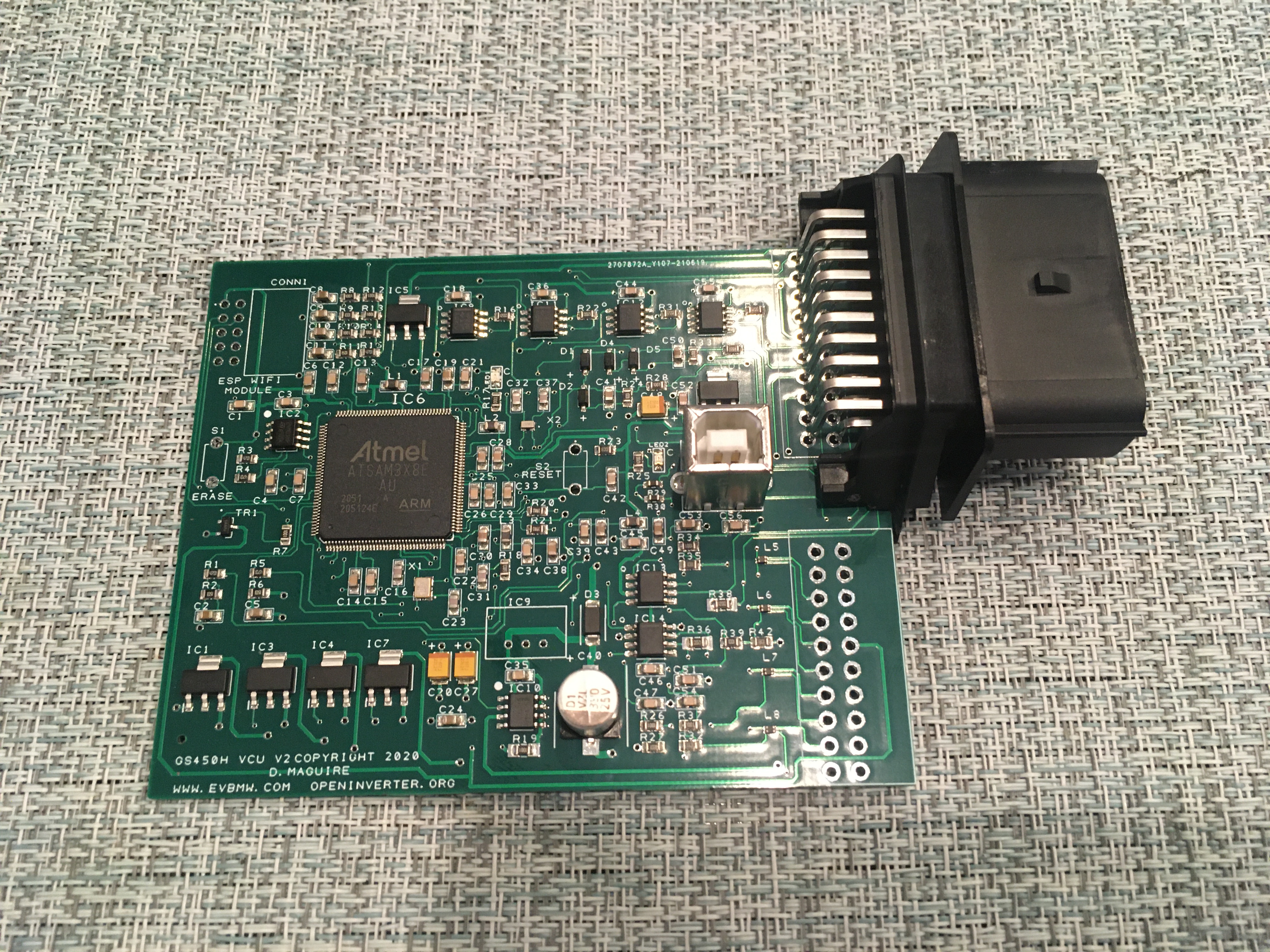

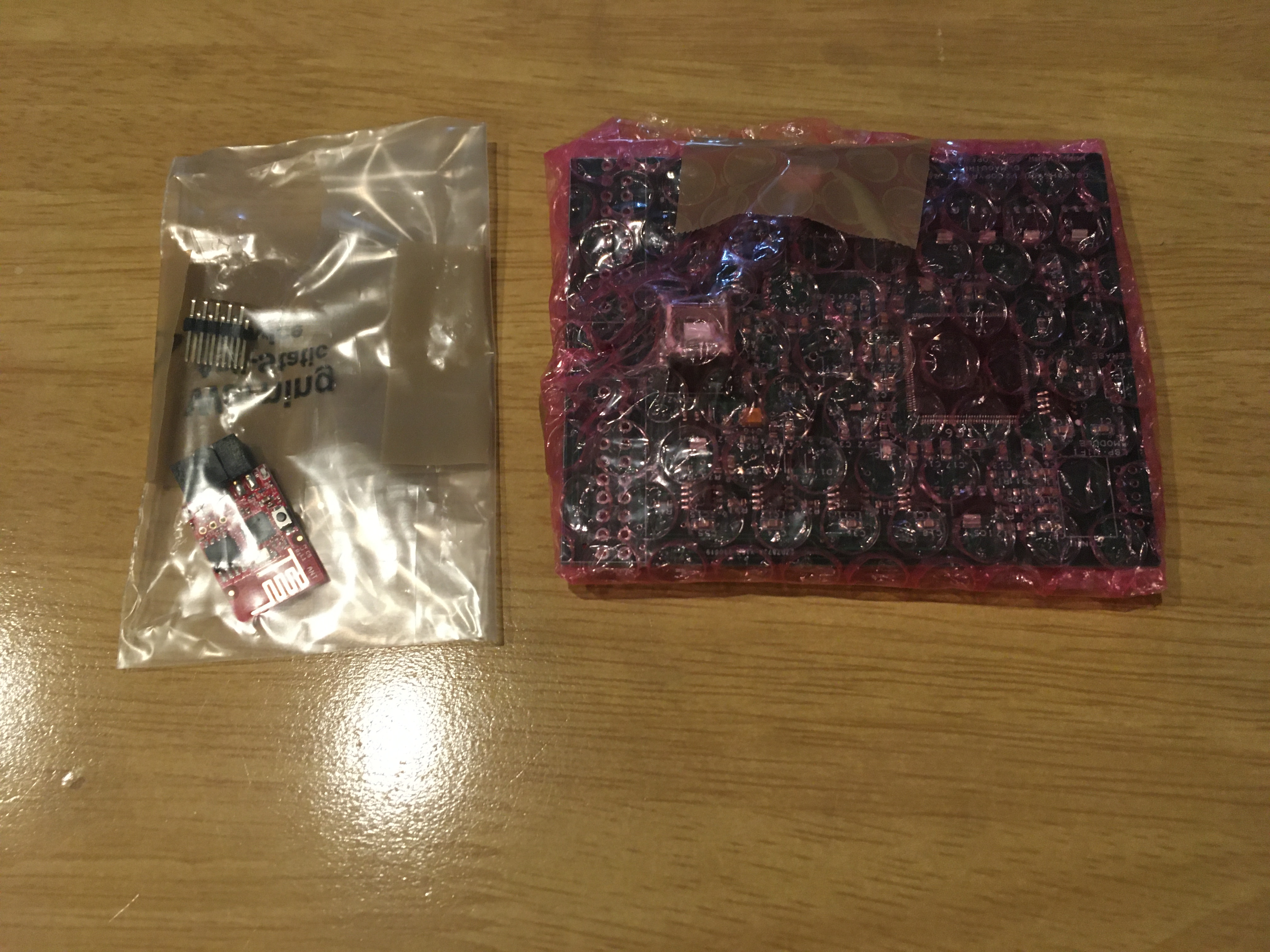

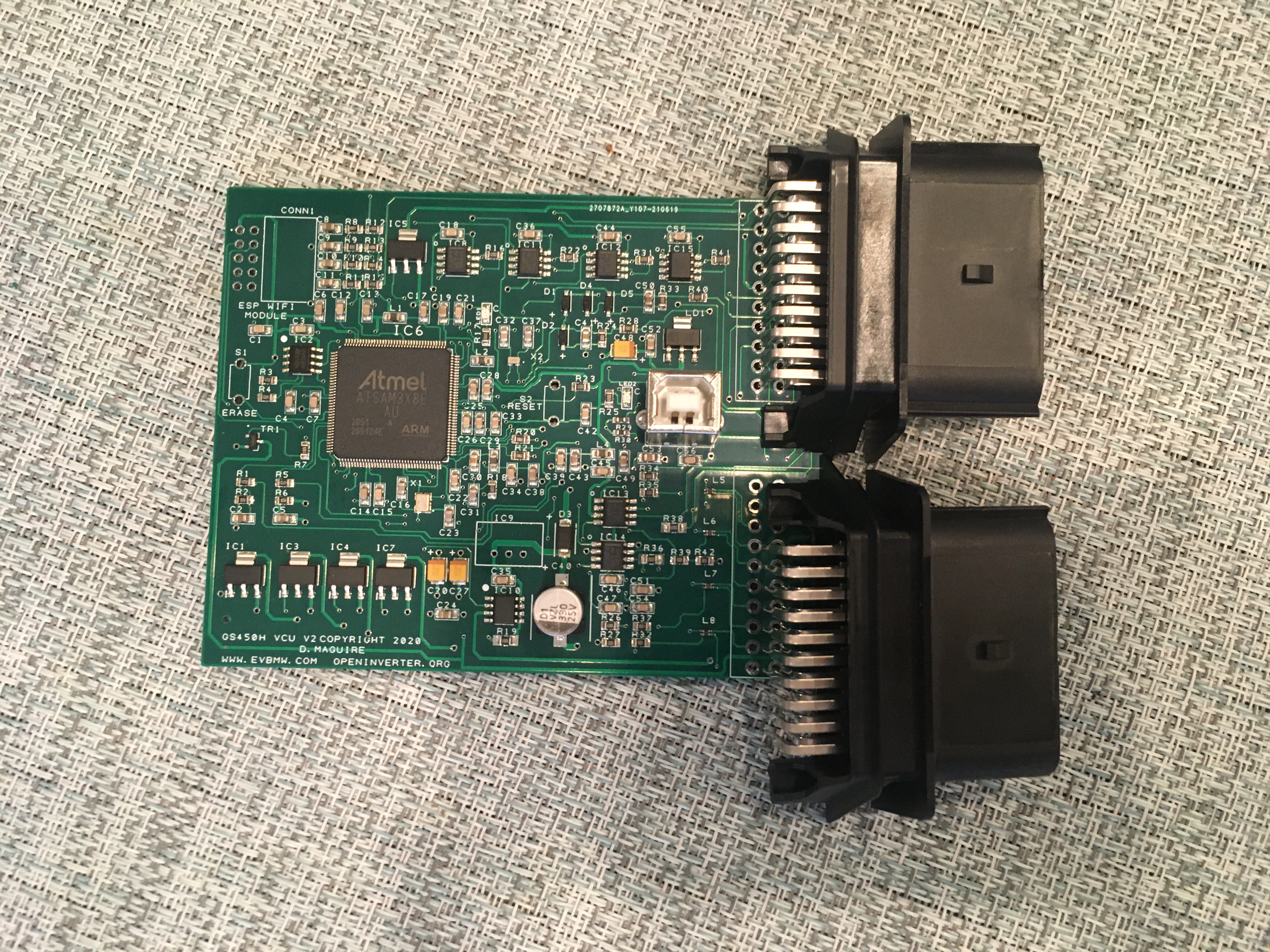

So this is what I was expecting... the pic is a bit misleading as it pictures the 40 pin connector header thingie, yet on his website it states "Enclosure and connectors NOT supplied." again absolutely no complaint here just an observation and a clarification for anyone following along, that's all.
Gregski
Posts: 2272

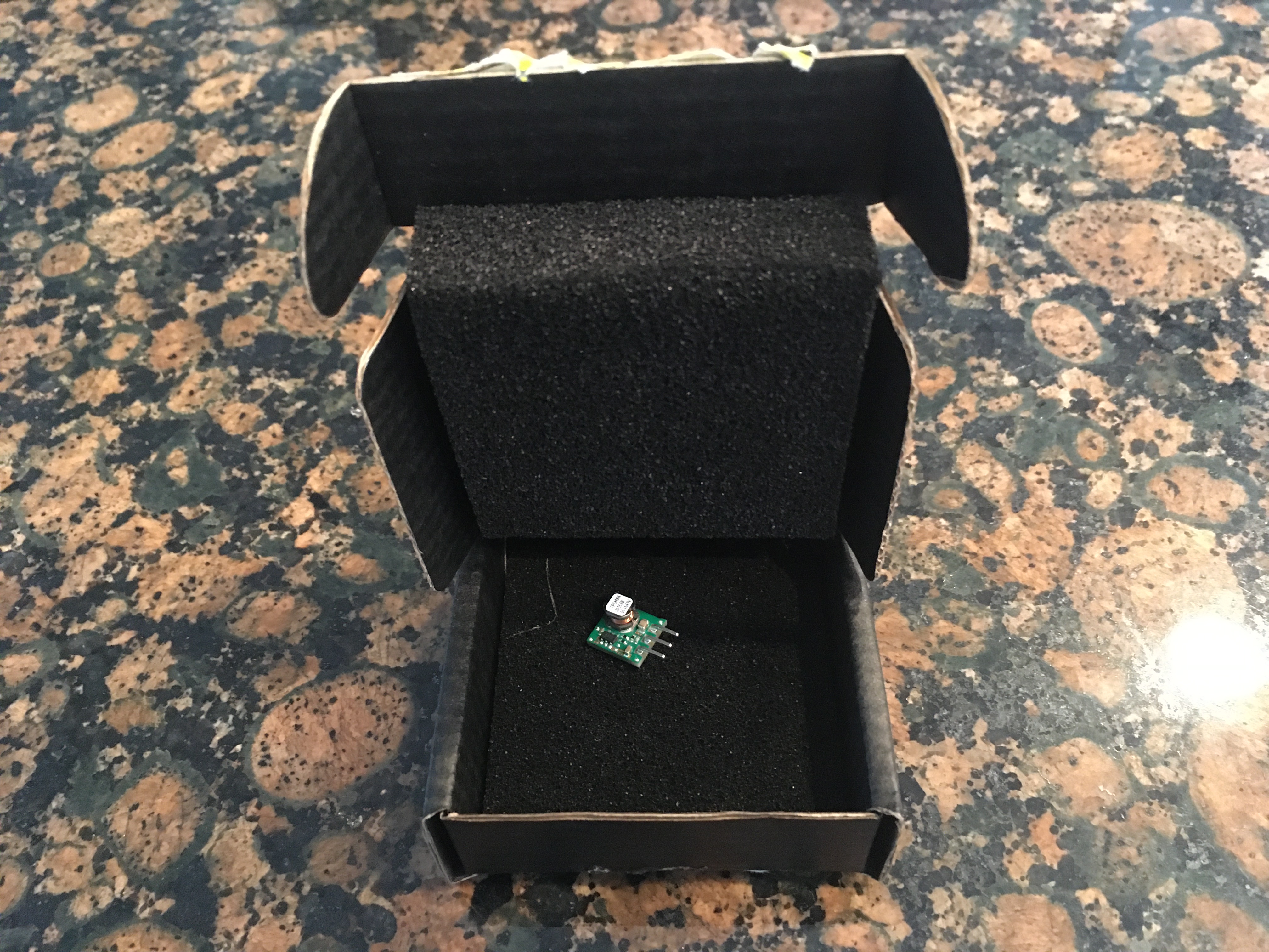

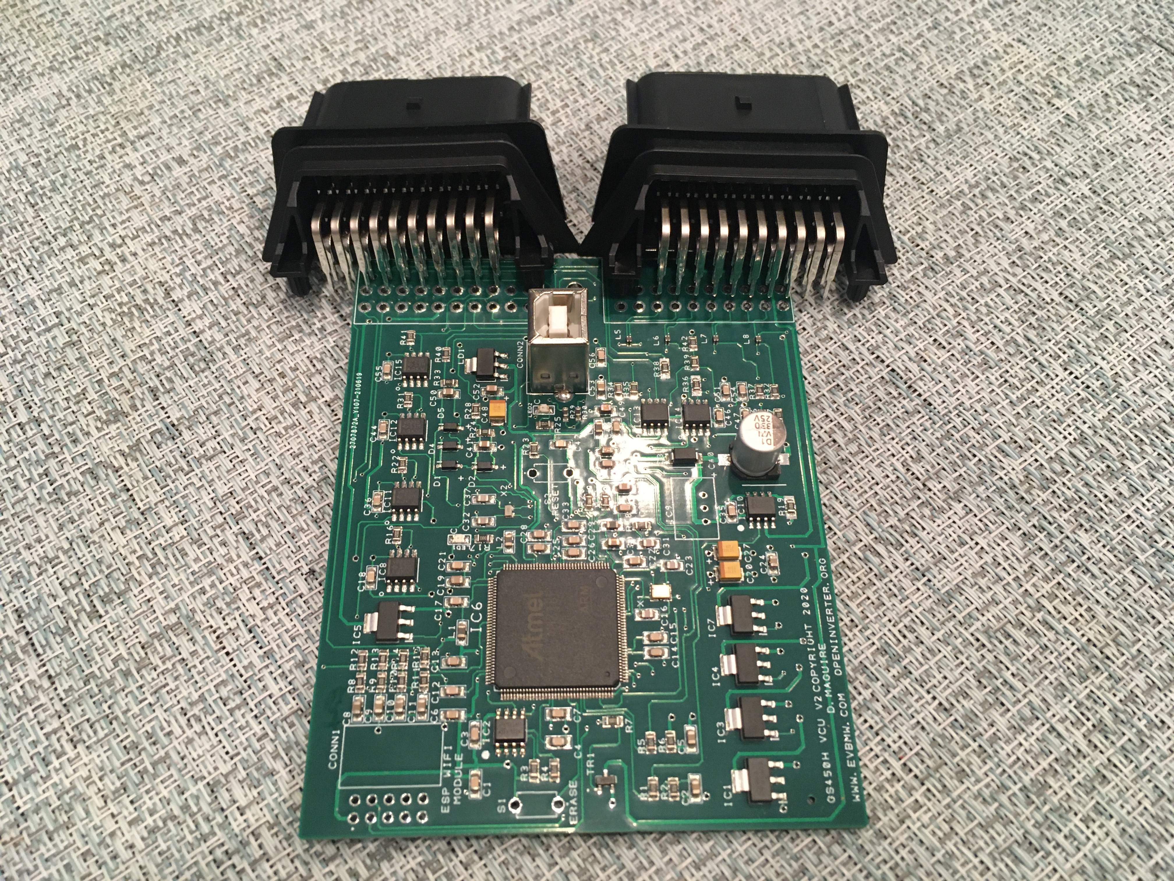

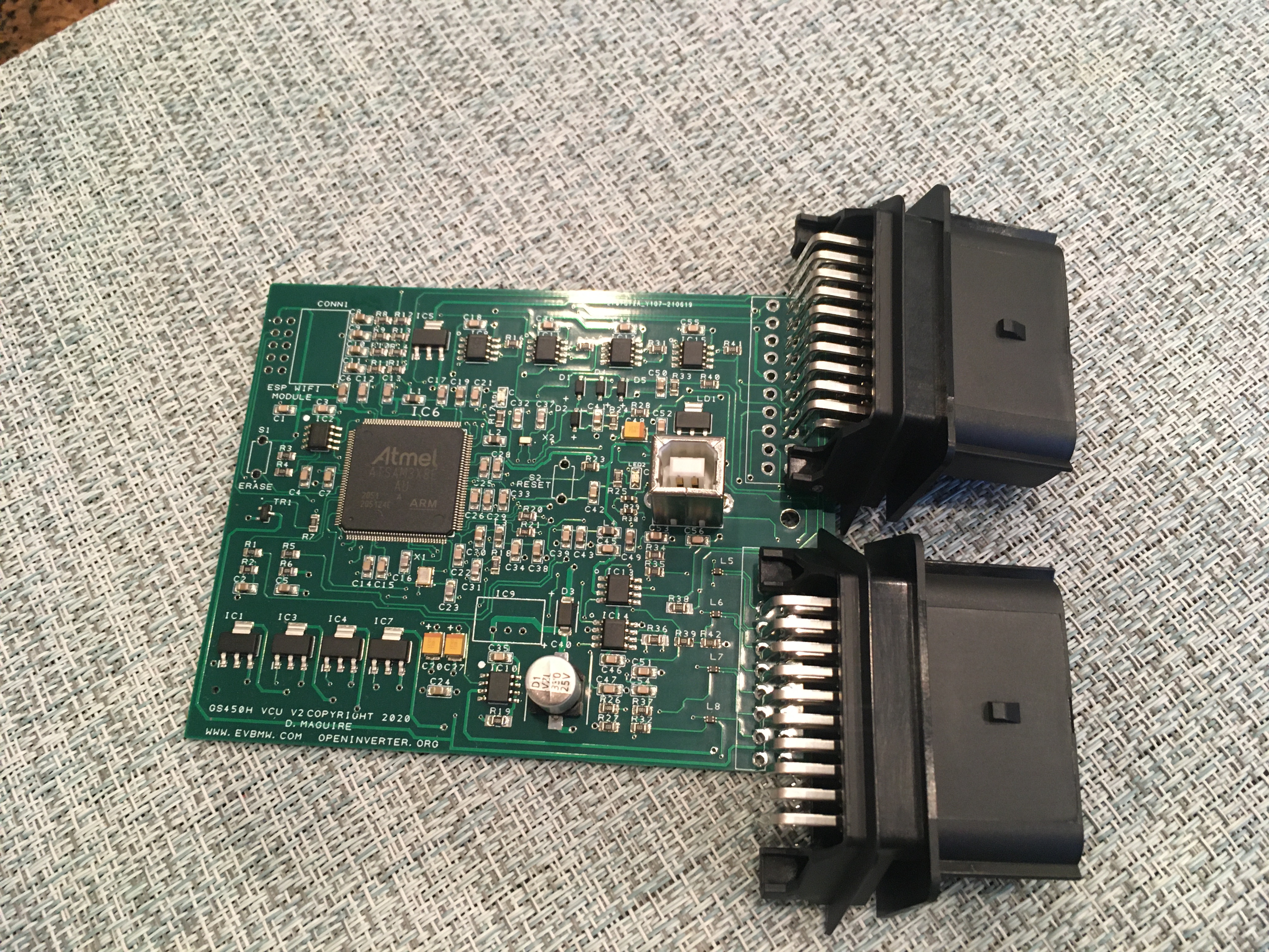

Post by Gregski »

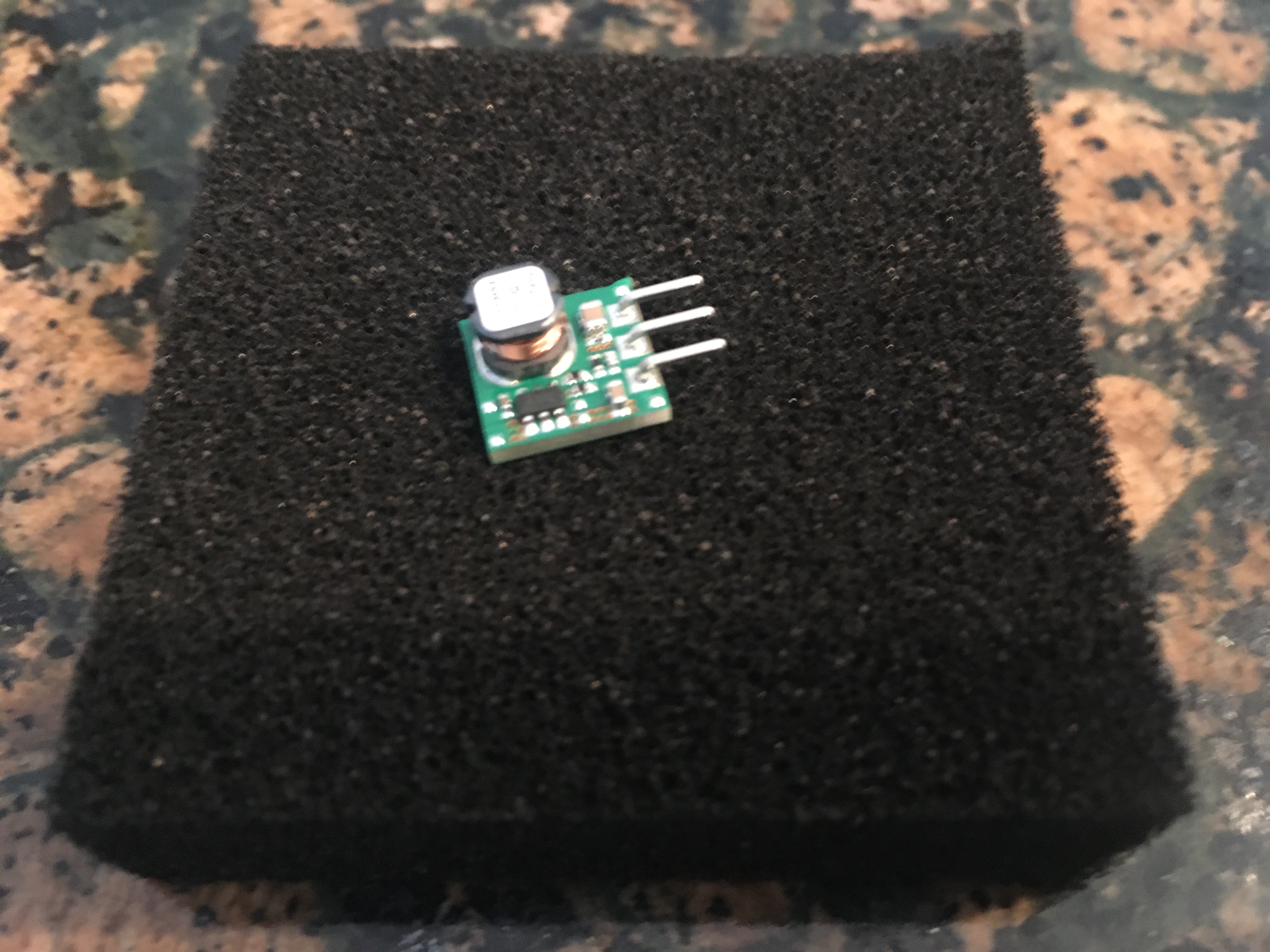

and this is what I got...
I do realize there is a parts/components shortage, this is more of an "observe and report" than a rant or a complaint, I am truly grateful to have gotten anything at all considering the circumstances, I am also very happy to see that he already soldered on the USB port for me
Missing is only the small black 5 volt switch mode regulator
FYI the shipping from Ireland to California took exactly precisely 2 weeks to the day

Post by Gregski »

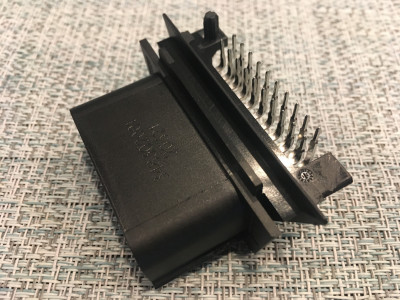

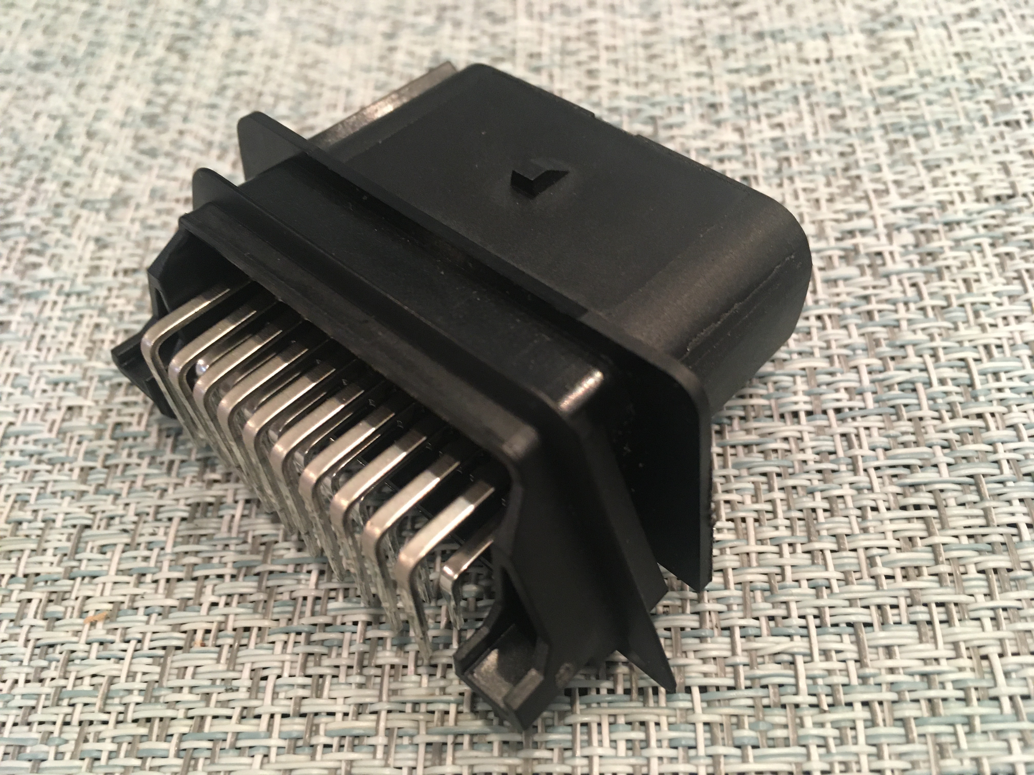

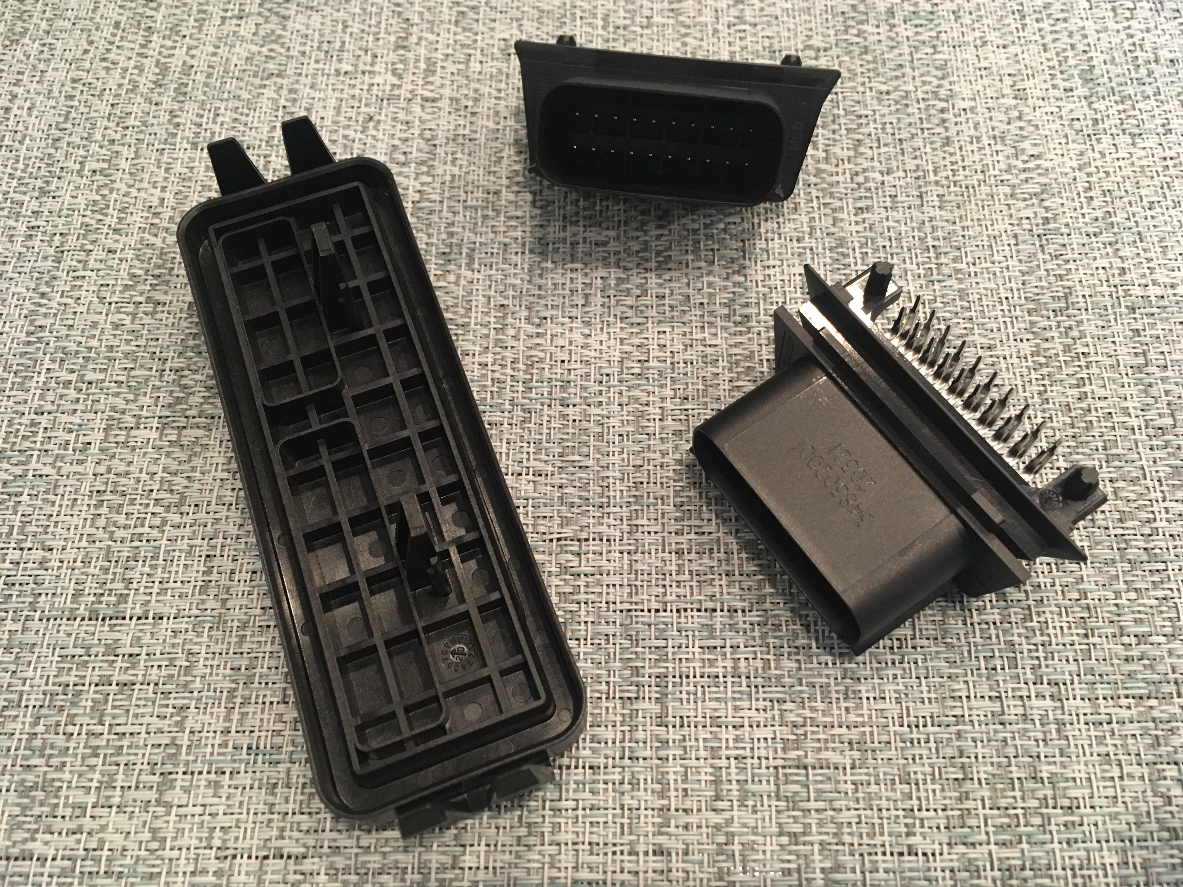

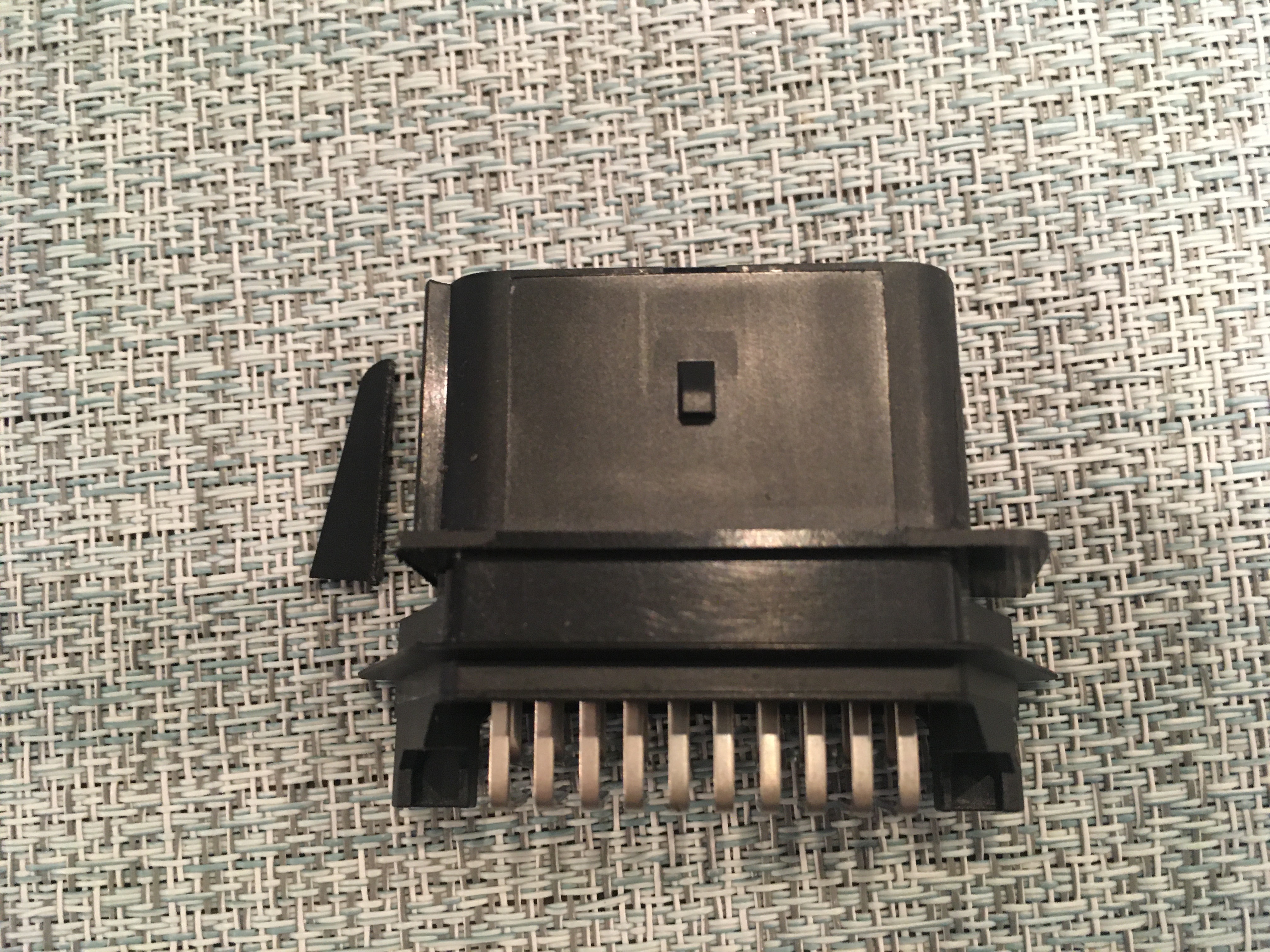

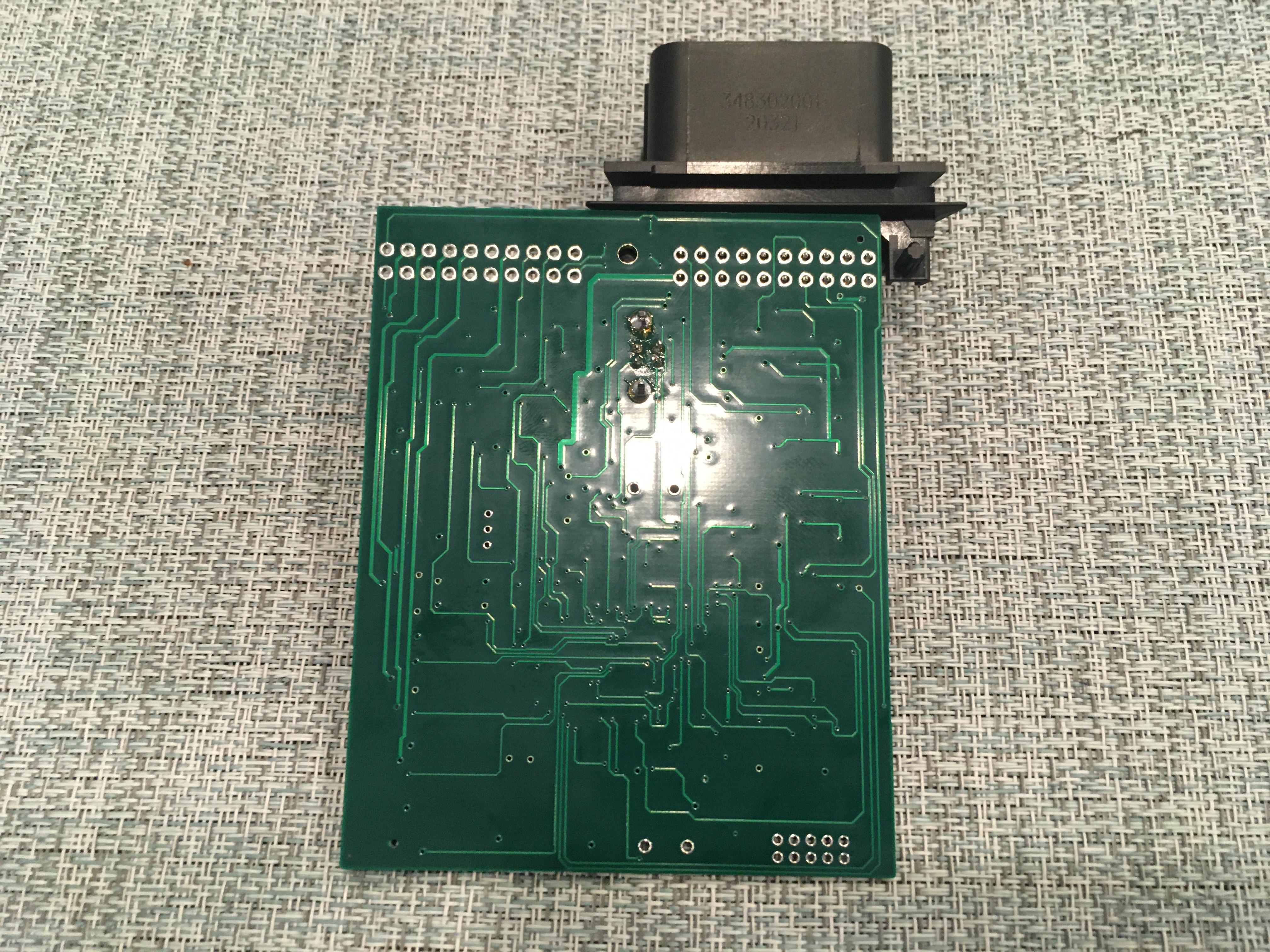

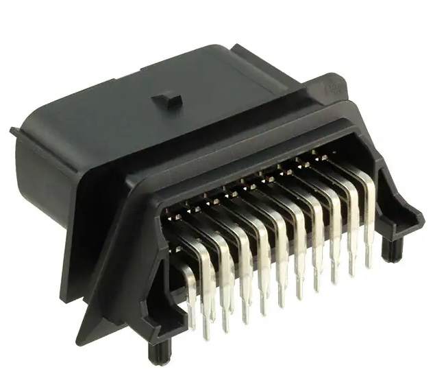

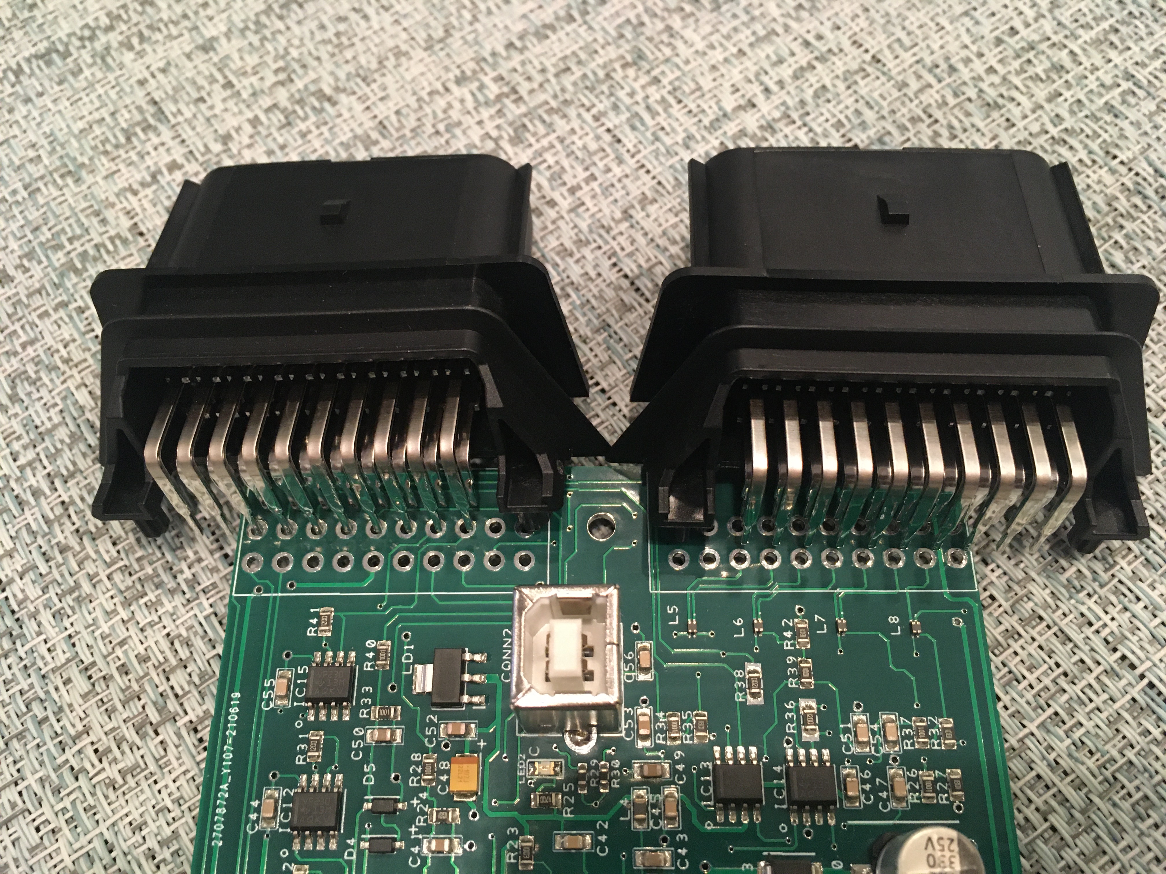

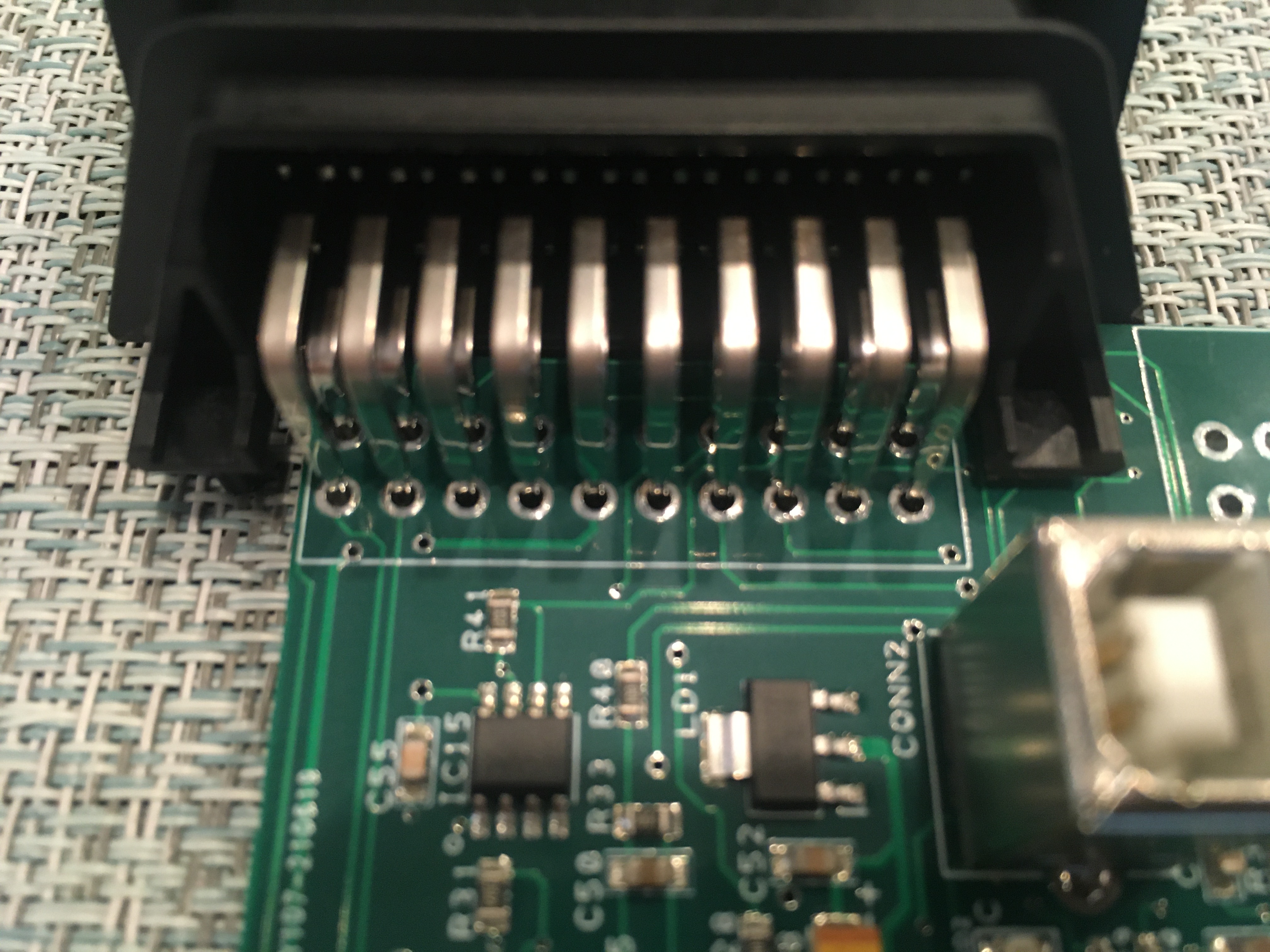

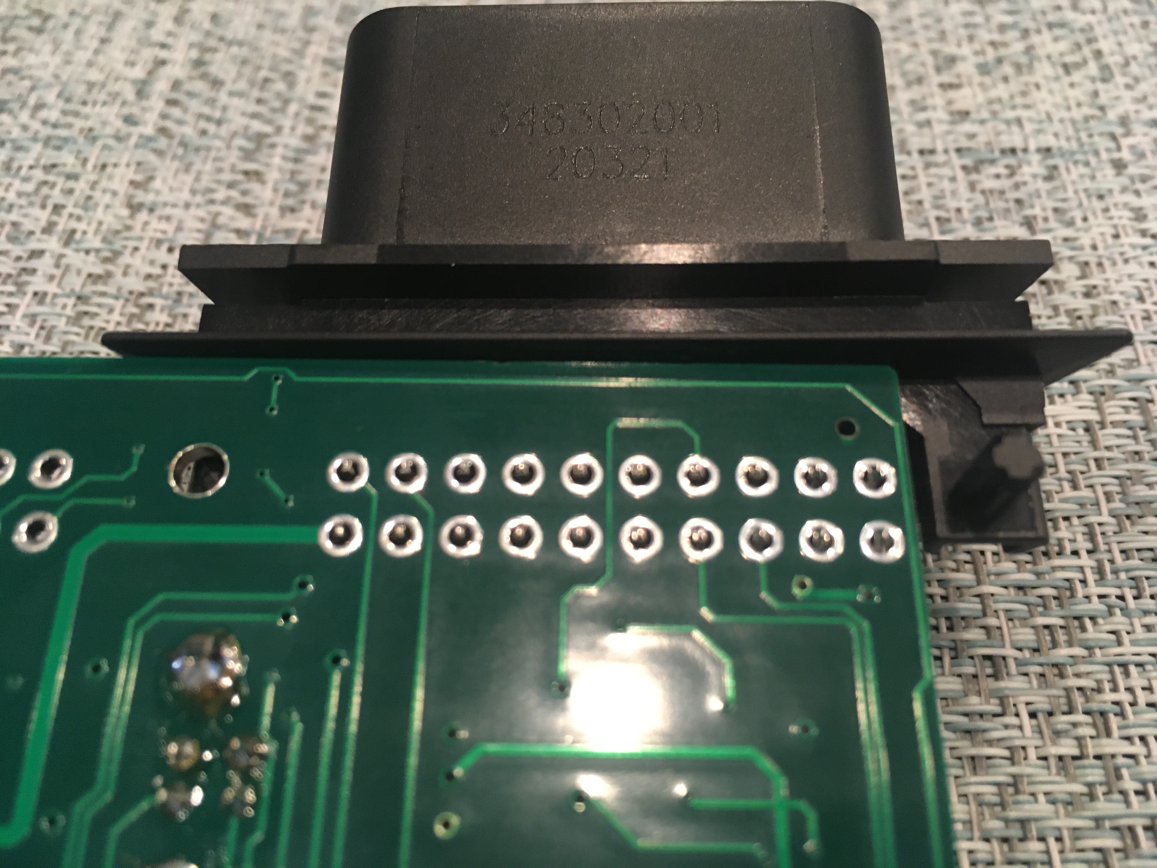

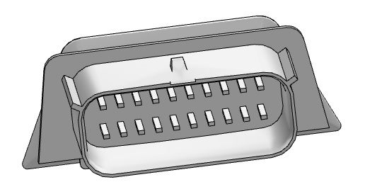

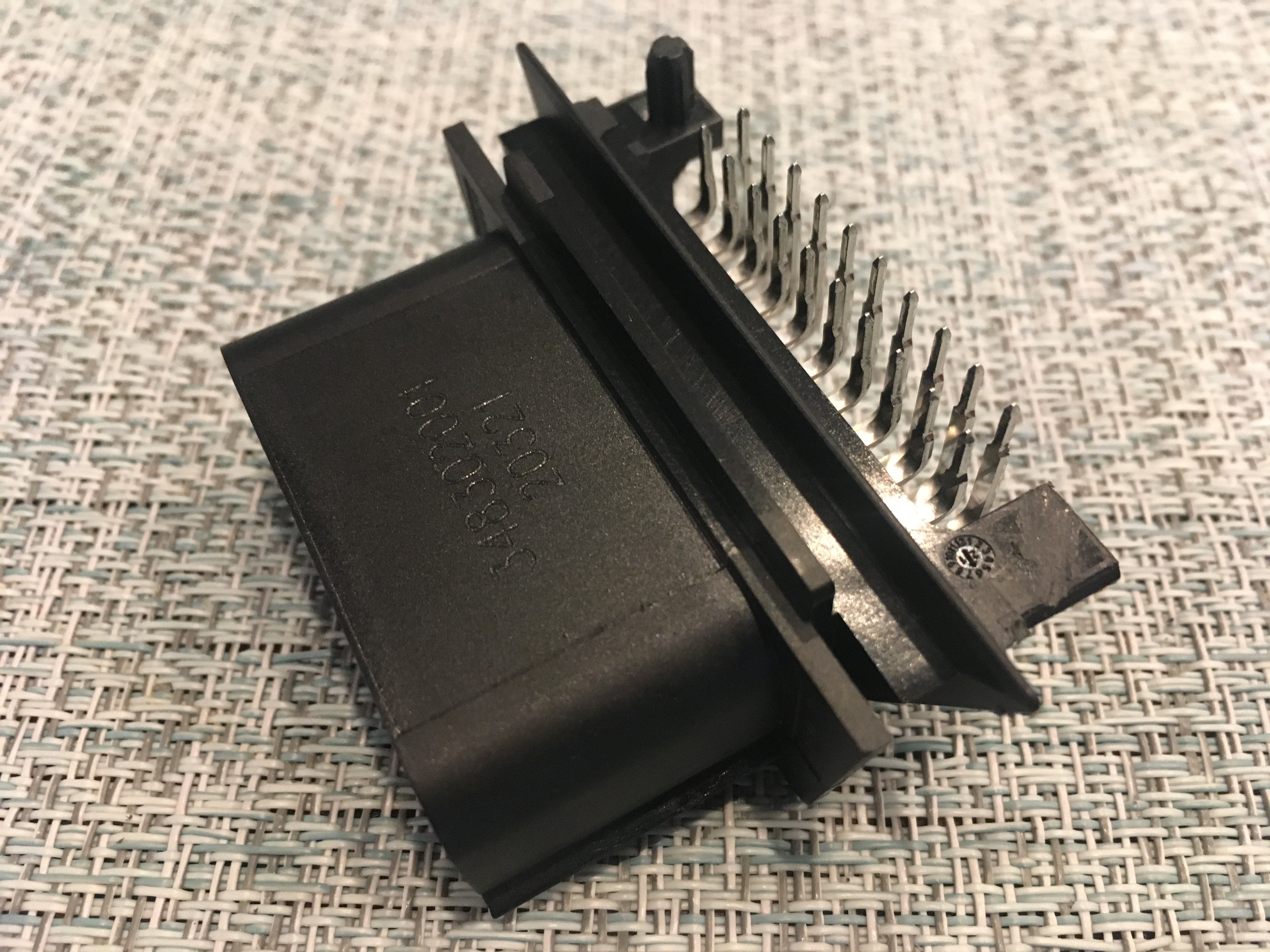

with the electronics parts shortage, I had to find an alternative to the Cinch 40 pin connector and I gotta admit I now know way more about connector pitches and number of pins and pin positions and rows than I care to admit, ha ha
Meet "Mo" short for Molex, part number 348302001 this is that original 40 pin header's long lost cousin, on it's mother's side, so it still takes the same 33472-2001 plugs believe it or not

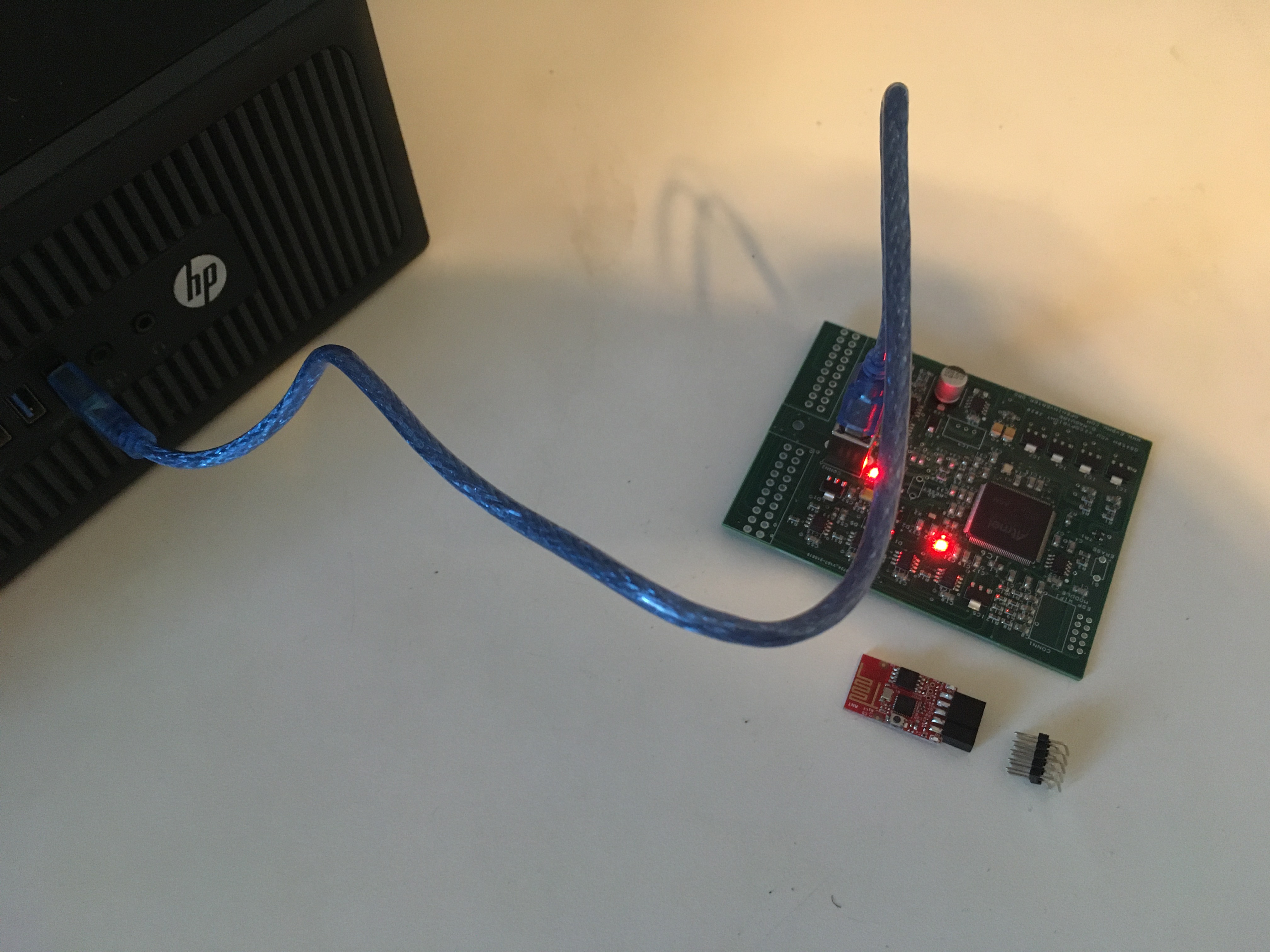

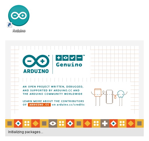

Post by Gregski »

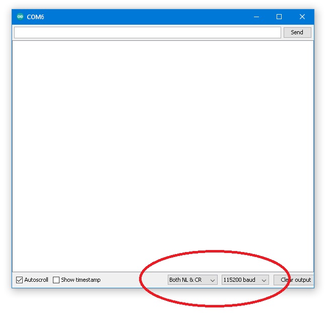

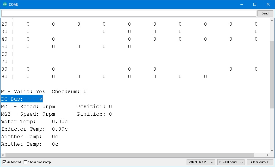

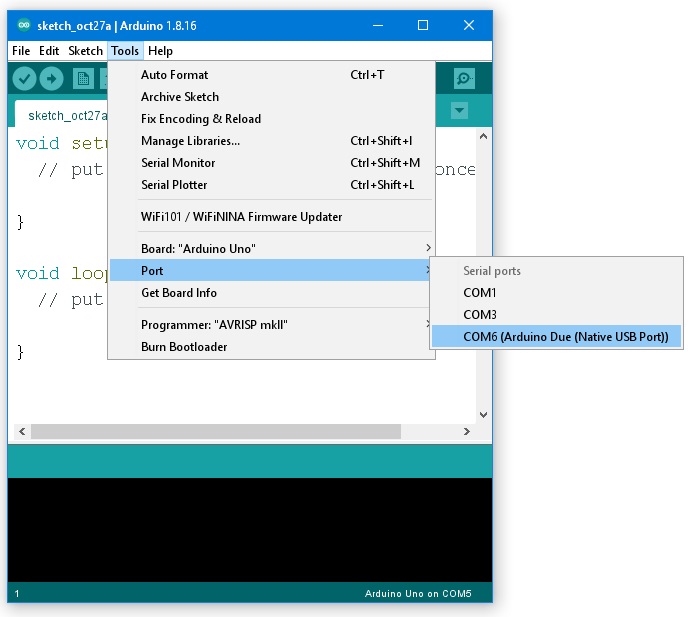

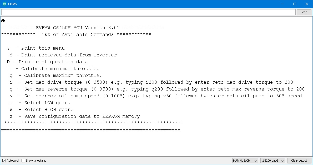

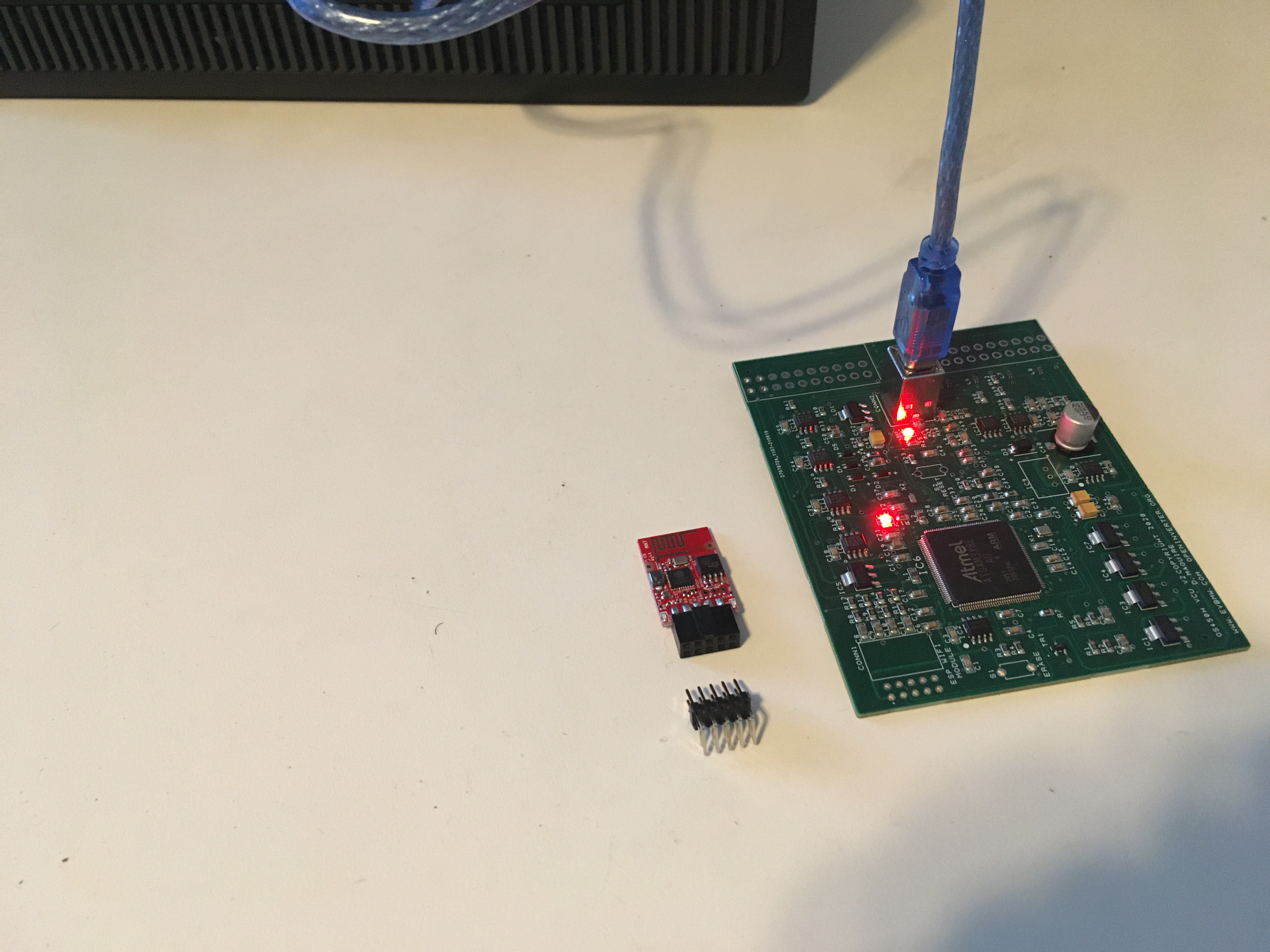

and I am pleased to report that with zero effort on my part, meaning having soldered nothing to the board myself, as you can see the WiFi adapter is just laying along side of the PCB we can talk to the VCU via a USB cable and the Arduino free software called IDE, which stands for a fancy text editor on steroids and a compiler, Integrated Development Environment
you are welcome to Google Arduino or watch me try to ride that Bronco in a companion thread called Any Isabellenhütte IVT-S Ninjas on here?
Gregski
Posts: 2272

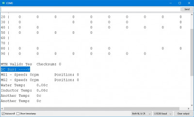

Post by Gregski »

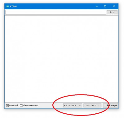

Essentially we are simply using the free Arduino IDE software as a Terminal Emulation program to serially talk to our VCU since some companies decided to no longer include a perfectly good Terminal Emulation software in their Windows Operating System [yes I'm looking at you Microsoft]
so yeah it's as easy as point and shoot, just make sure your Arduino software knows which COM port to look for the VCU on like so
and then dial in your Baud rate (pronounced: how many symbols we can send per second)

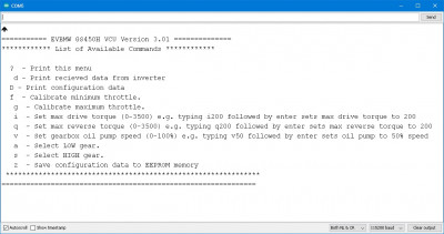

and if we type ? and hit enter we get the Menu
the menu is case sensitive so lower case d gives us the received data from the inverter

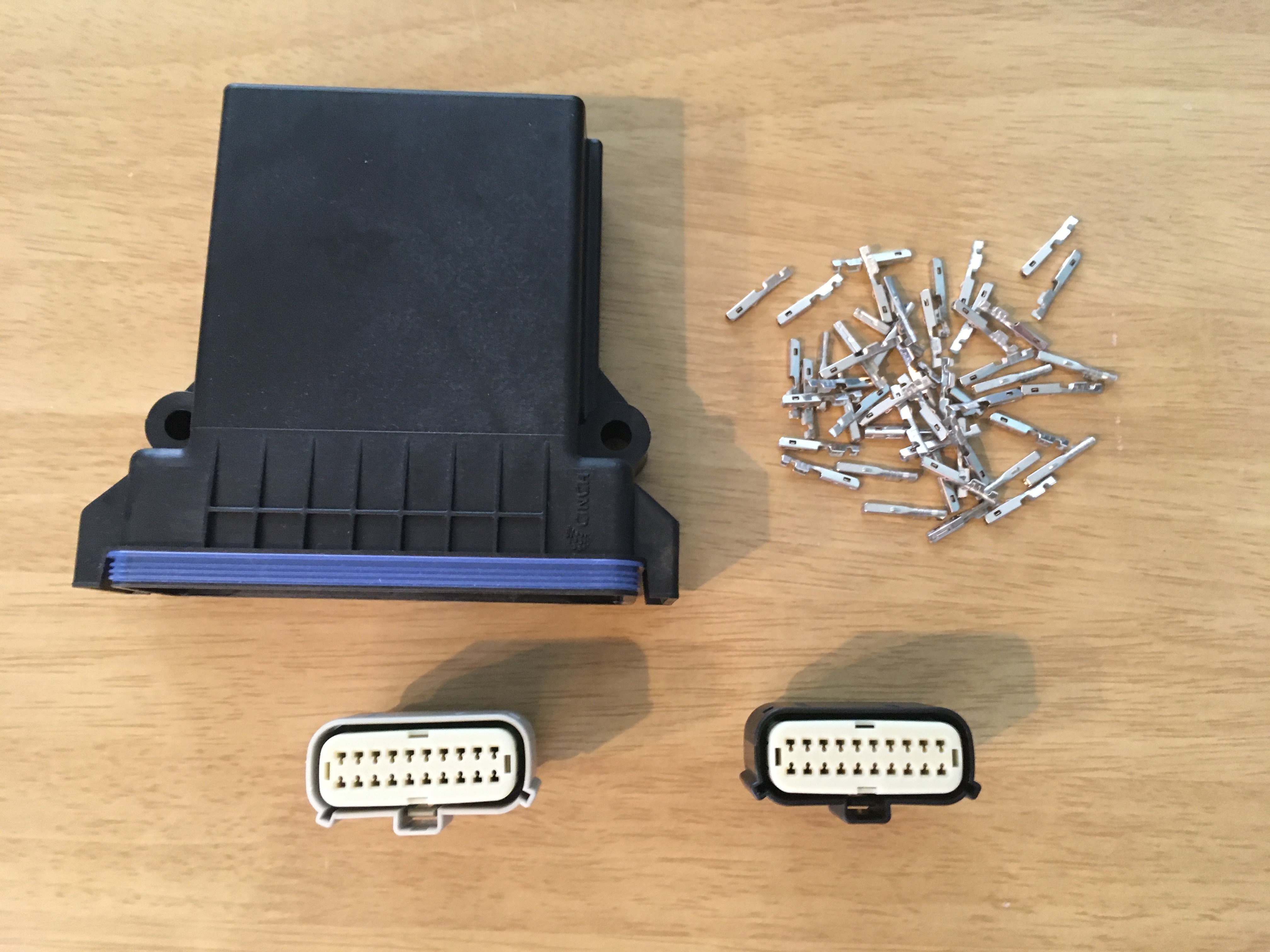

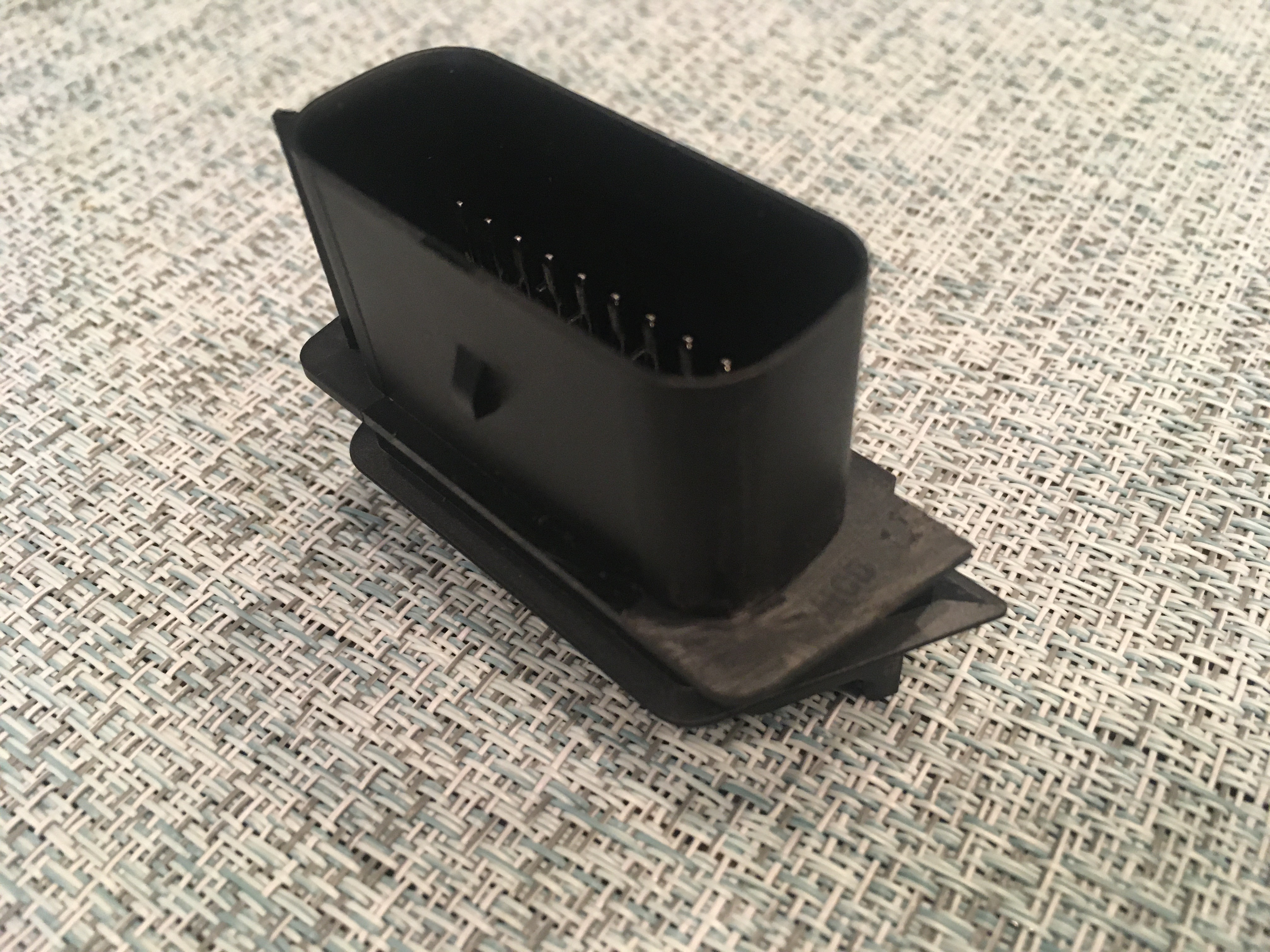

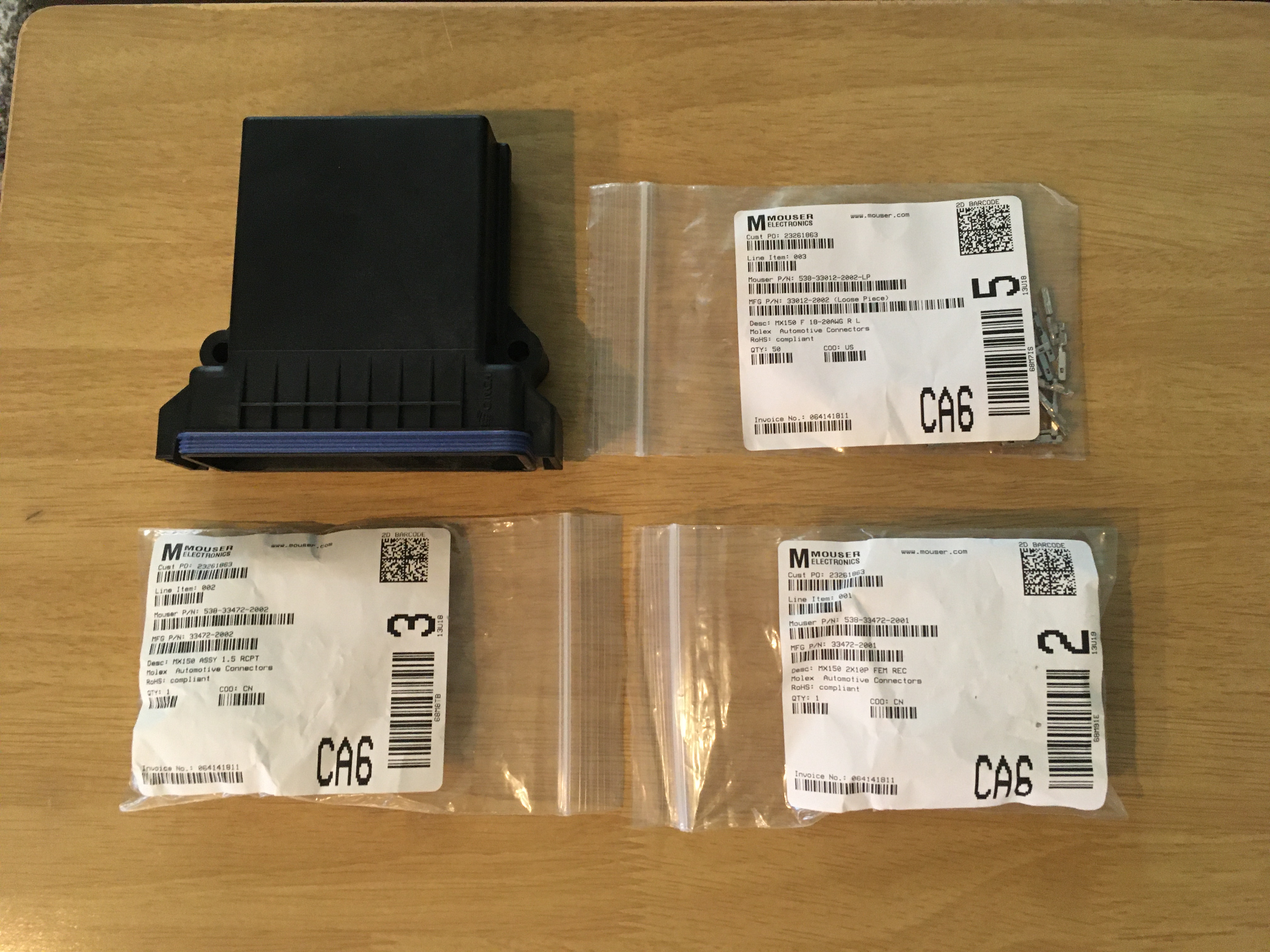

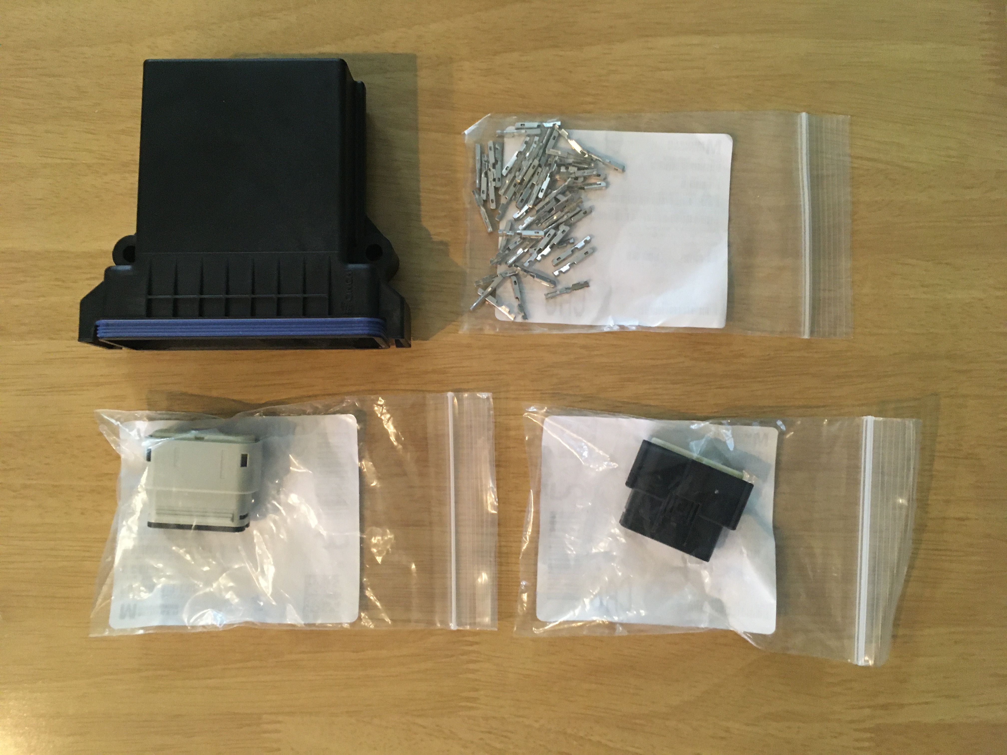

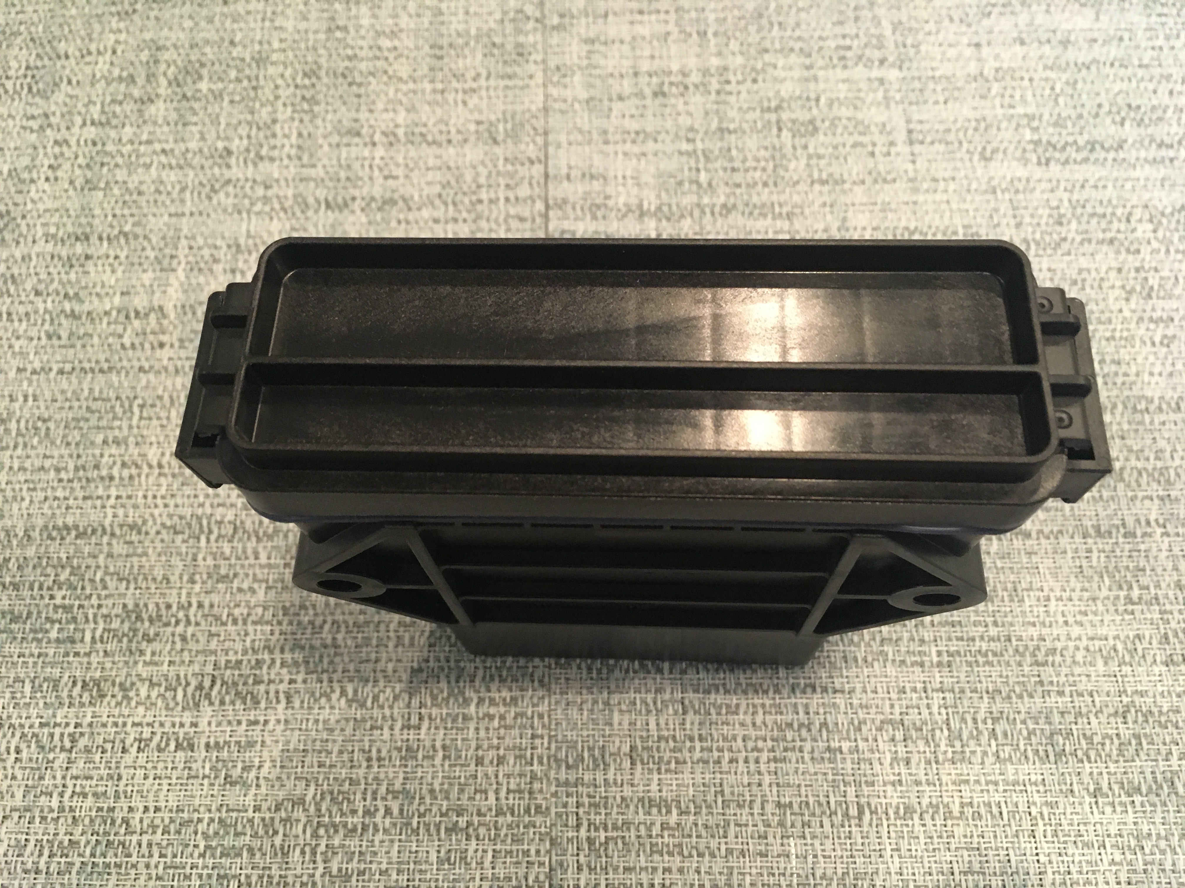

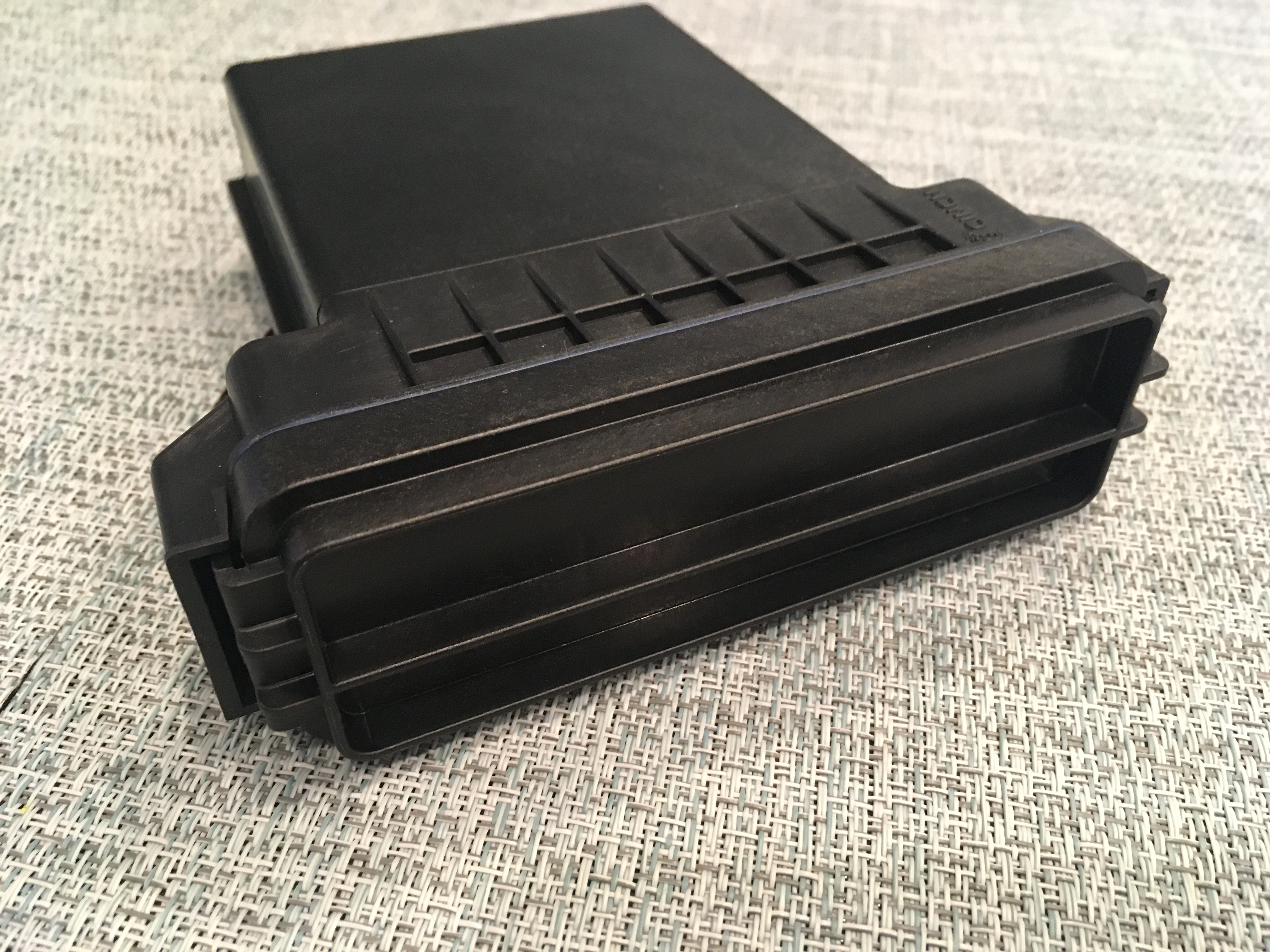

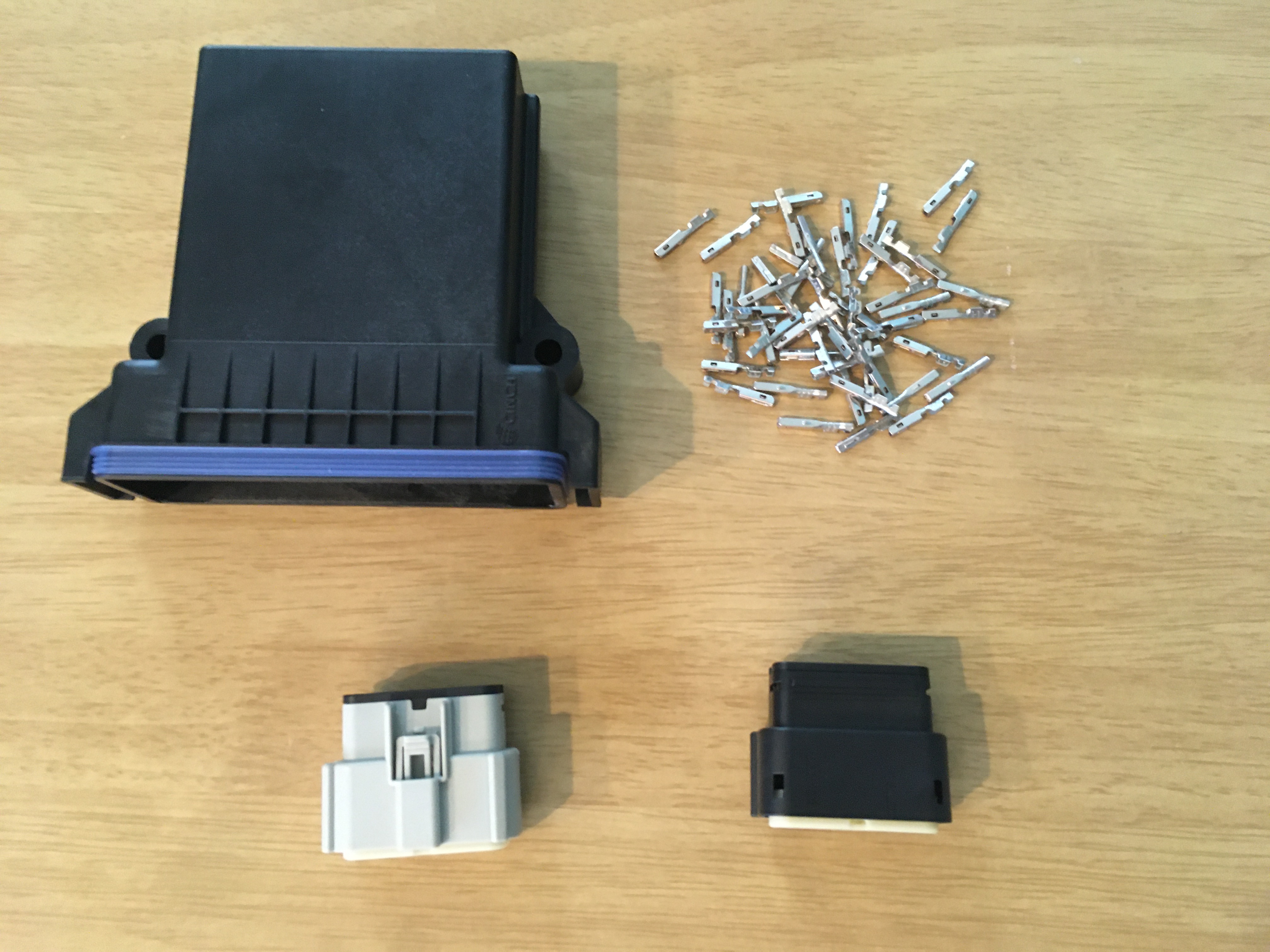

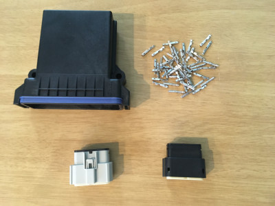

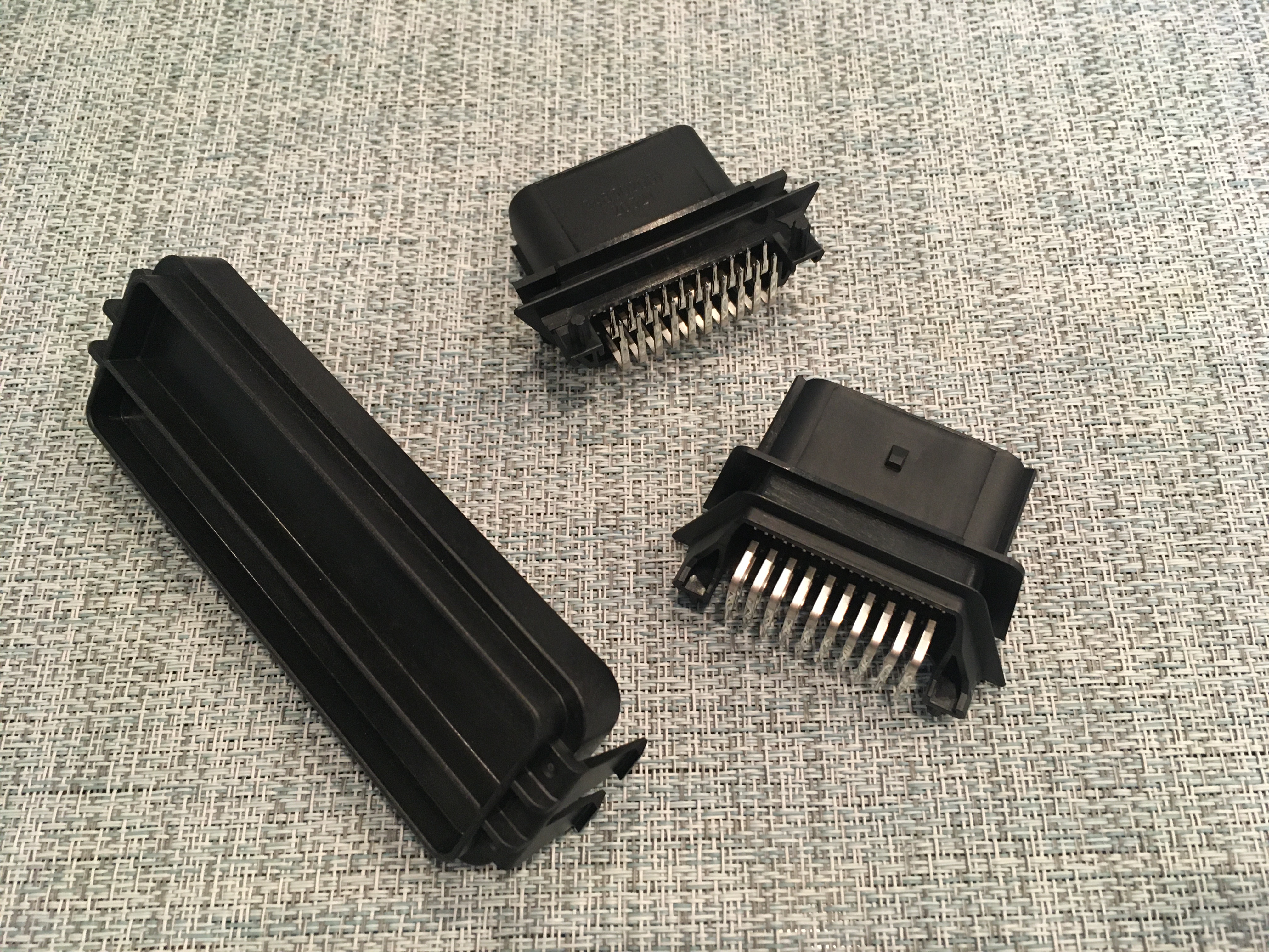

and here are the other components I bought to complete the VCU build, an enclosure and two plugulators
Gregski
Posts: 2272
Post by Gregski »
Do Not Do This! do not put the cover on until the end, as it takes an Act of Congress to remove it, ha ha

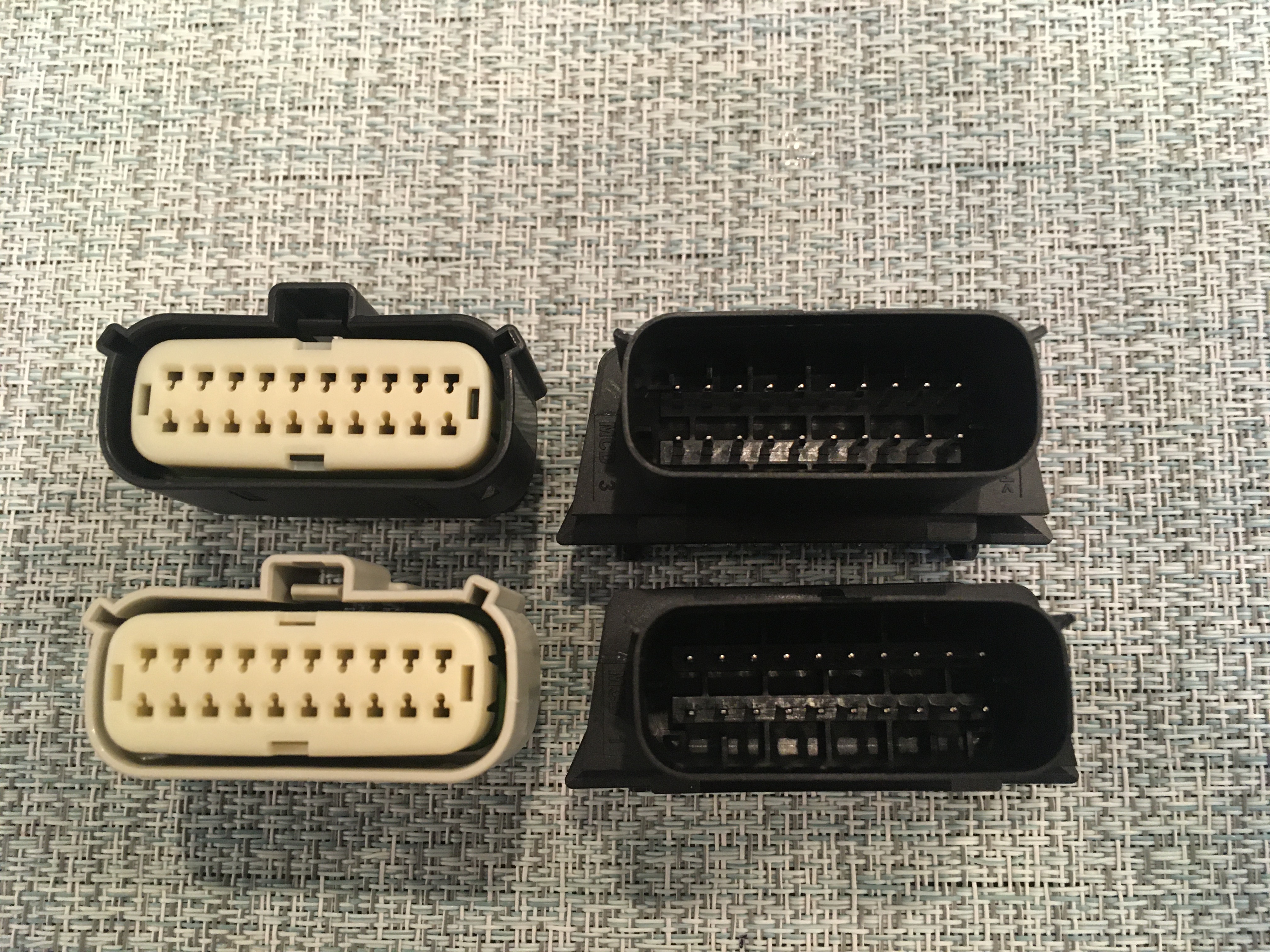

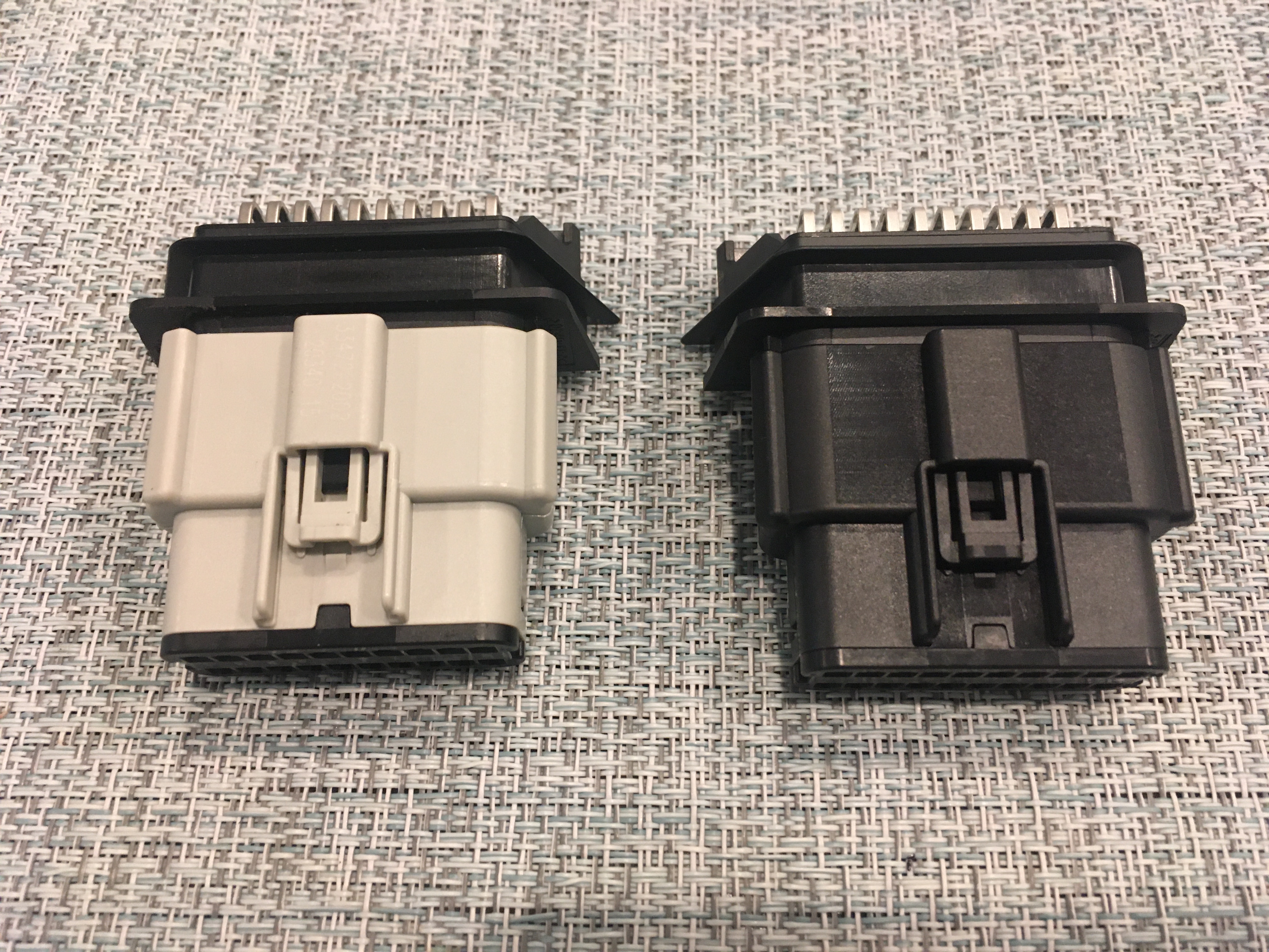

Gregski
Posts: 2272

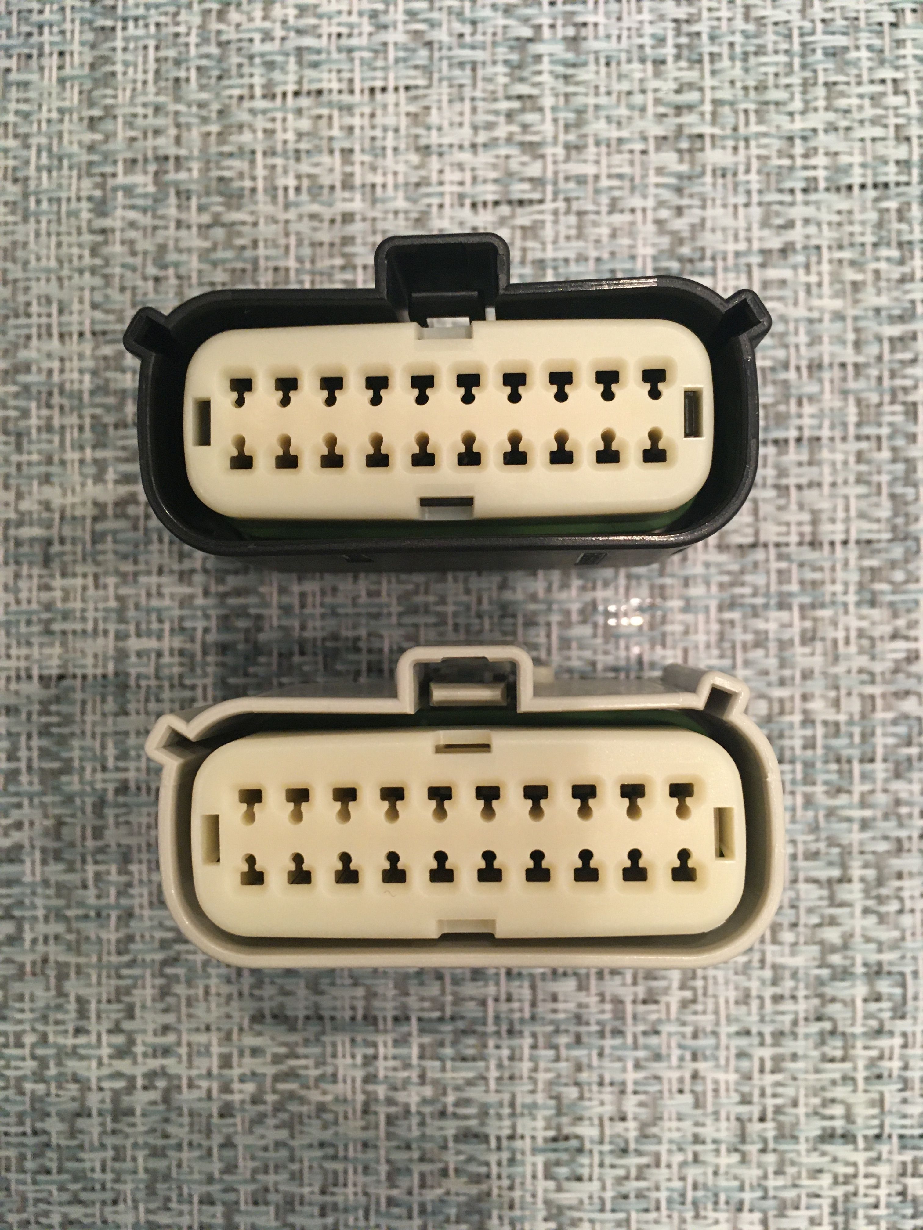

Post by Gregski »

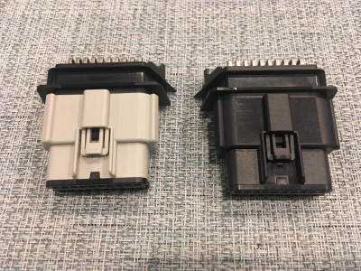

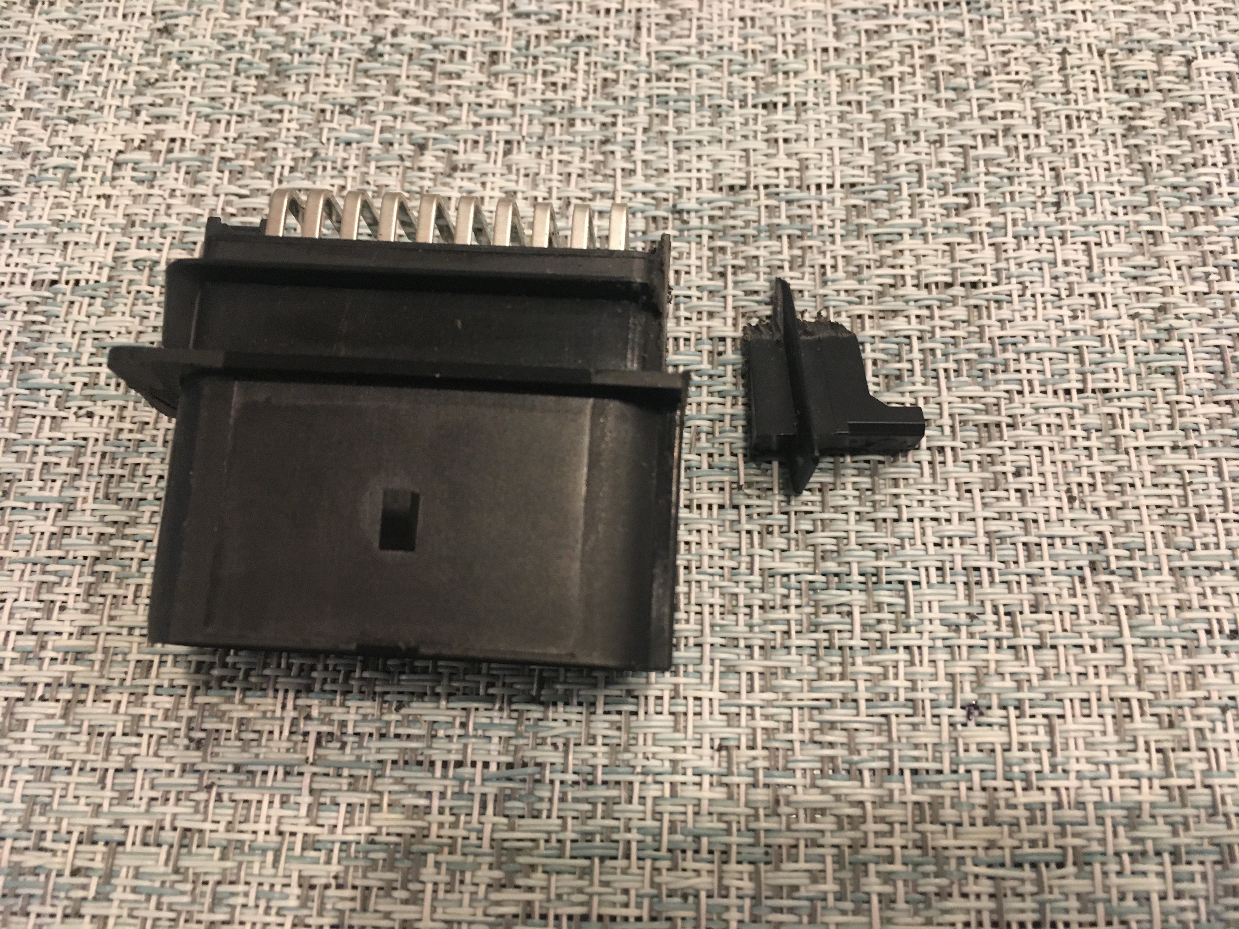

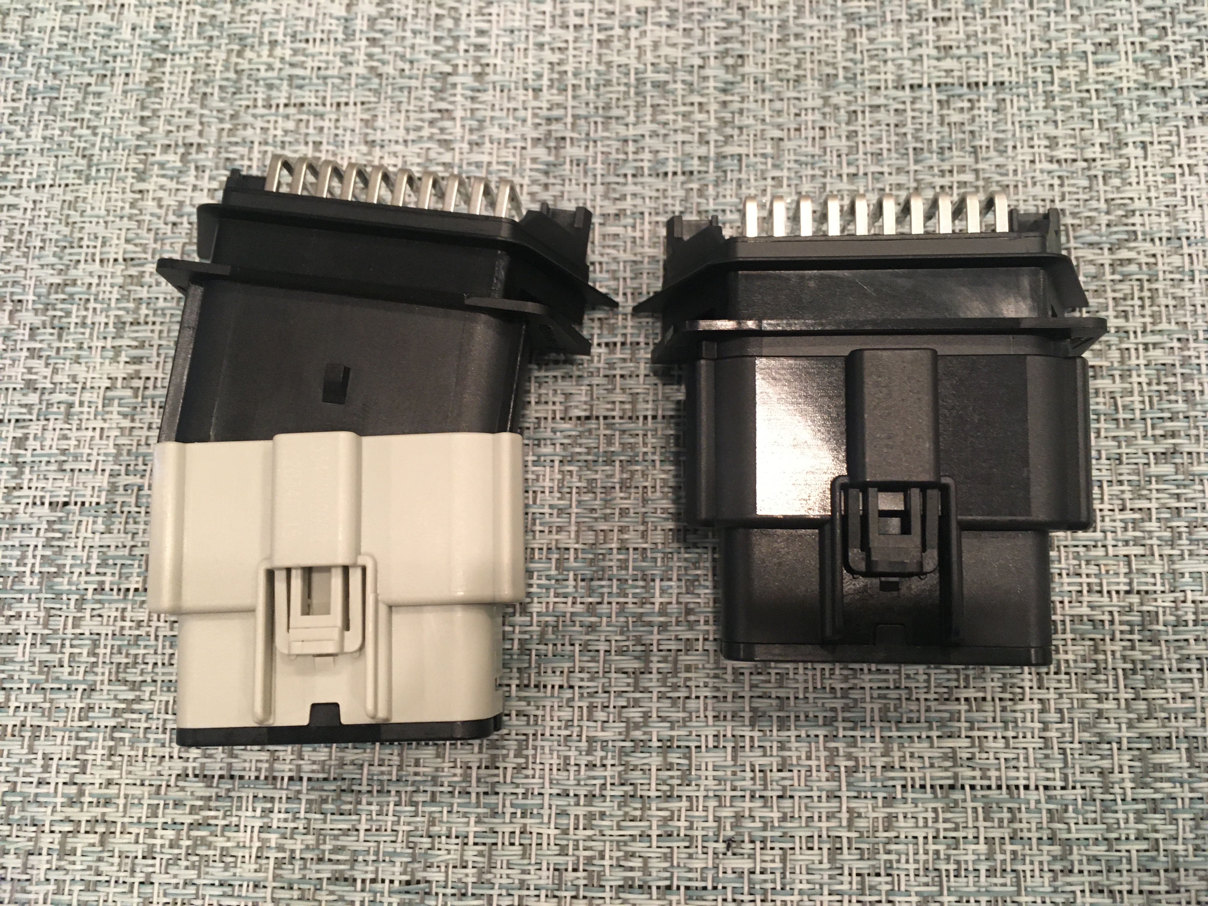

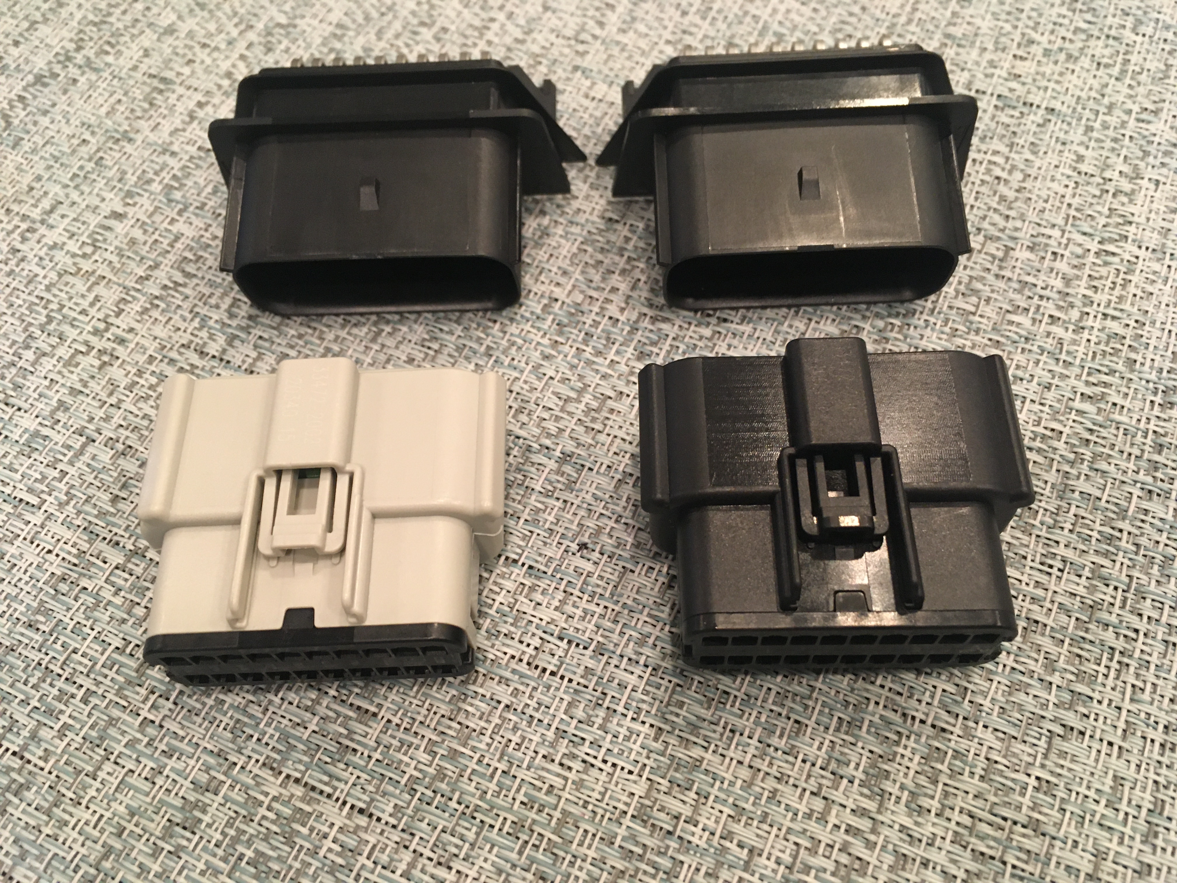

so the first thing I checked was the plugulators, and quickly realized HUSTON We Have A Problem
the gray plug seems to be keyed slightly different and won't go over the 20 pin connector, the black one matches it perfectly

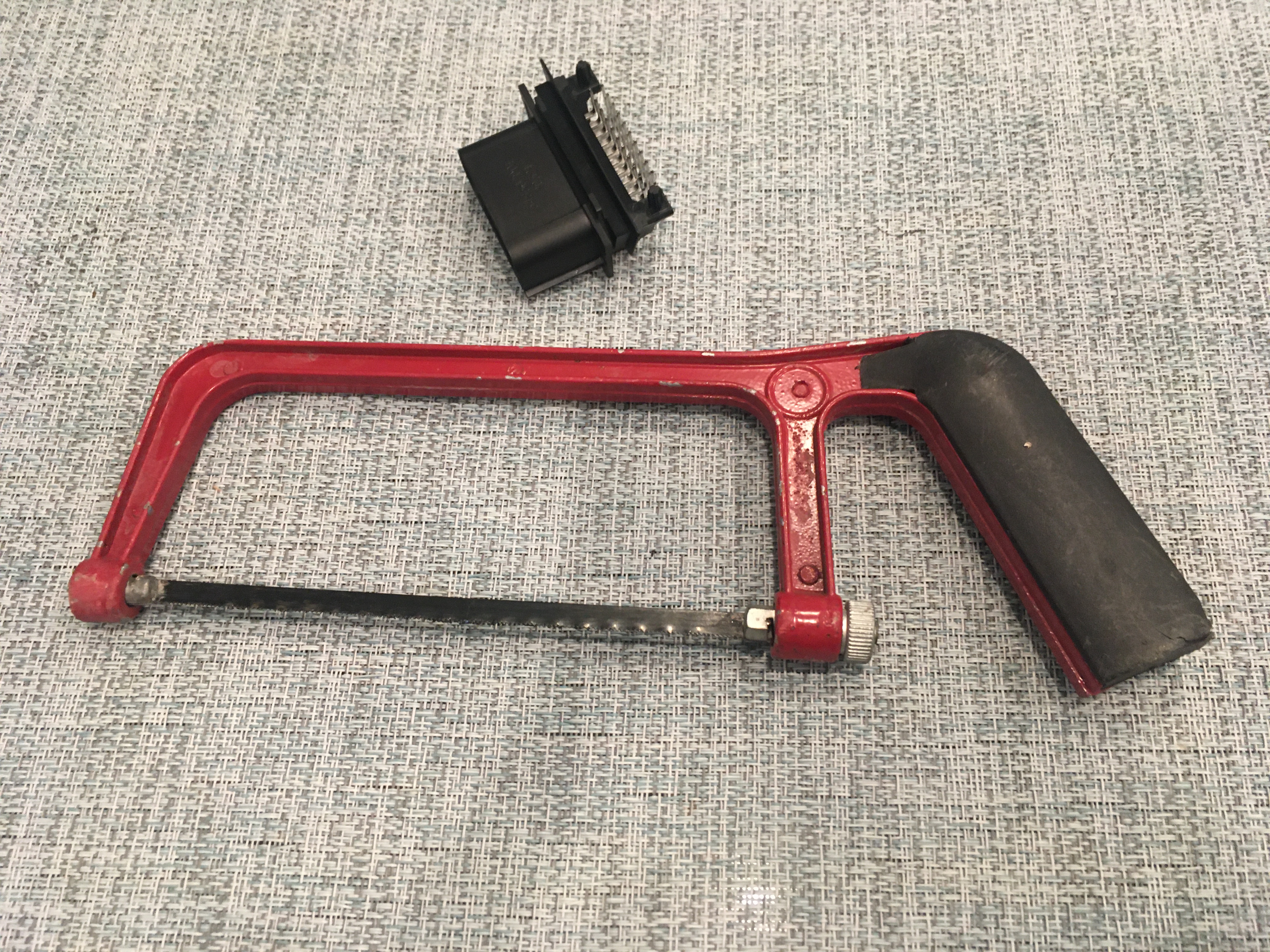

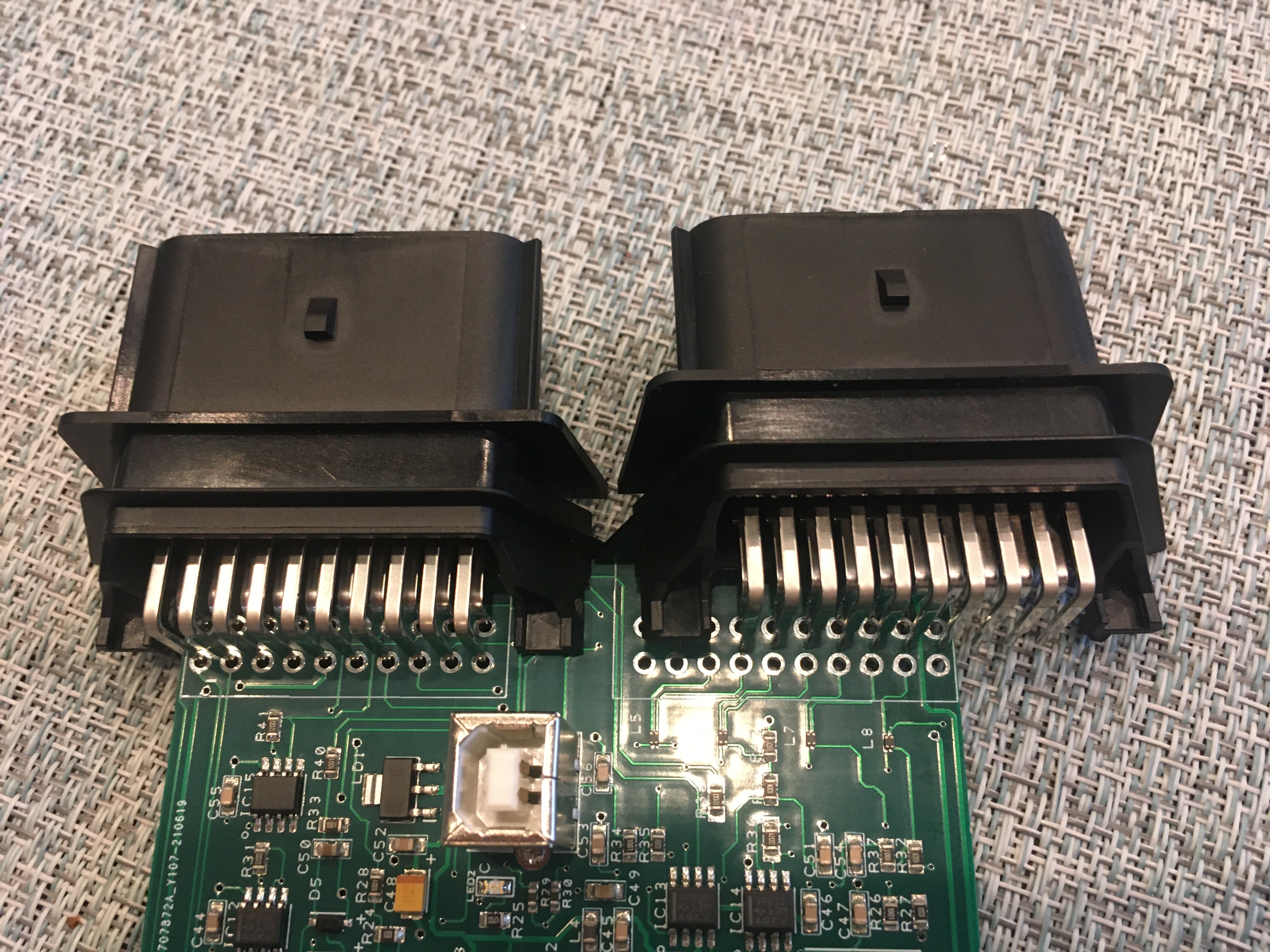

Gregski
Posts: 2272
Post by Gregski »
What to do? What to do?
Well we could order another black plug, but then it would be hard to tell them apart and we risk plugging them into the wrong connectors!
five minutes later...
Gregski
Posts: 2272

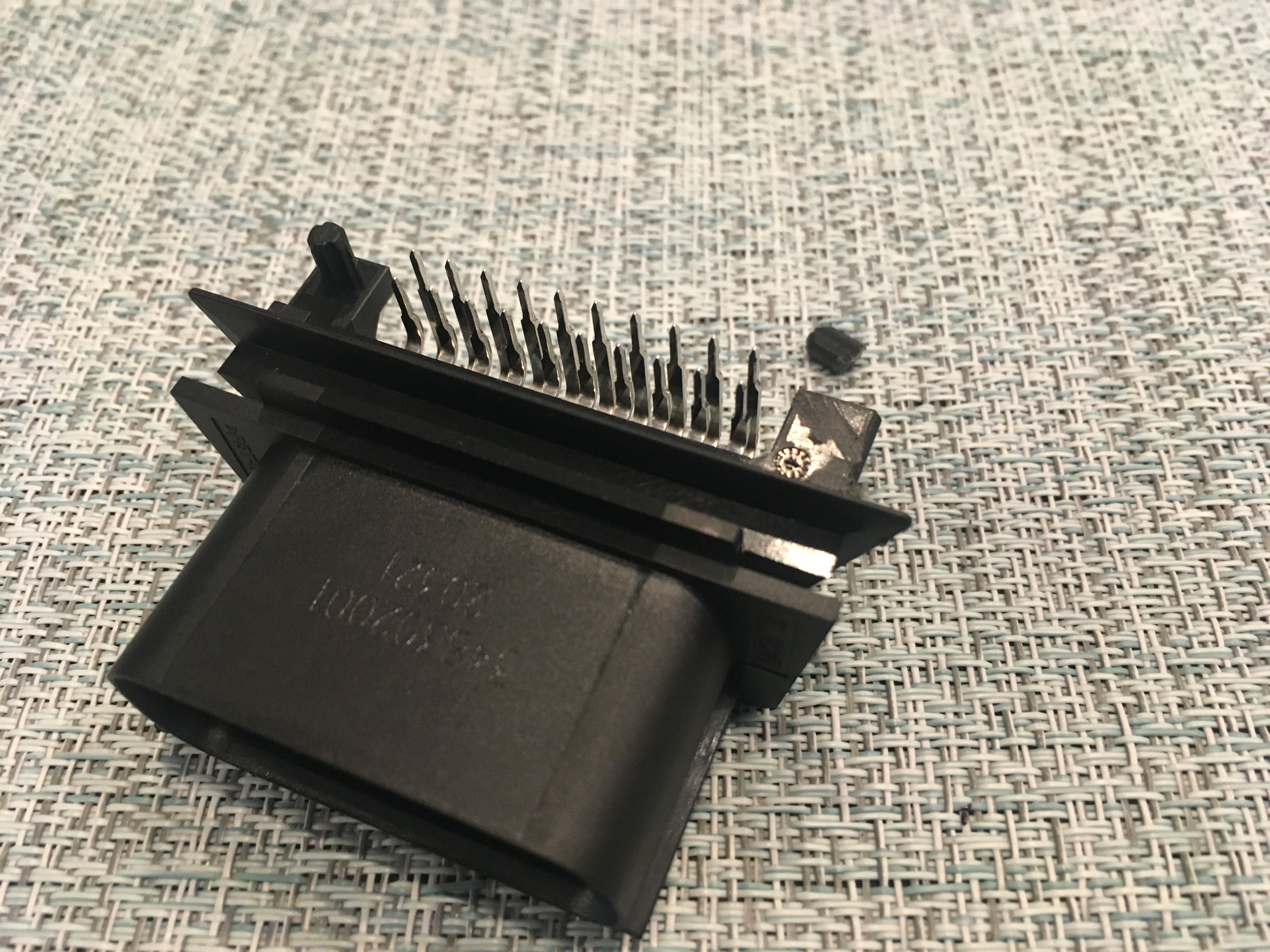

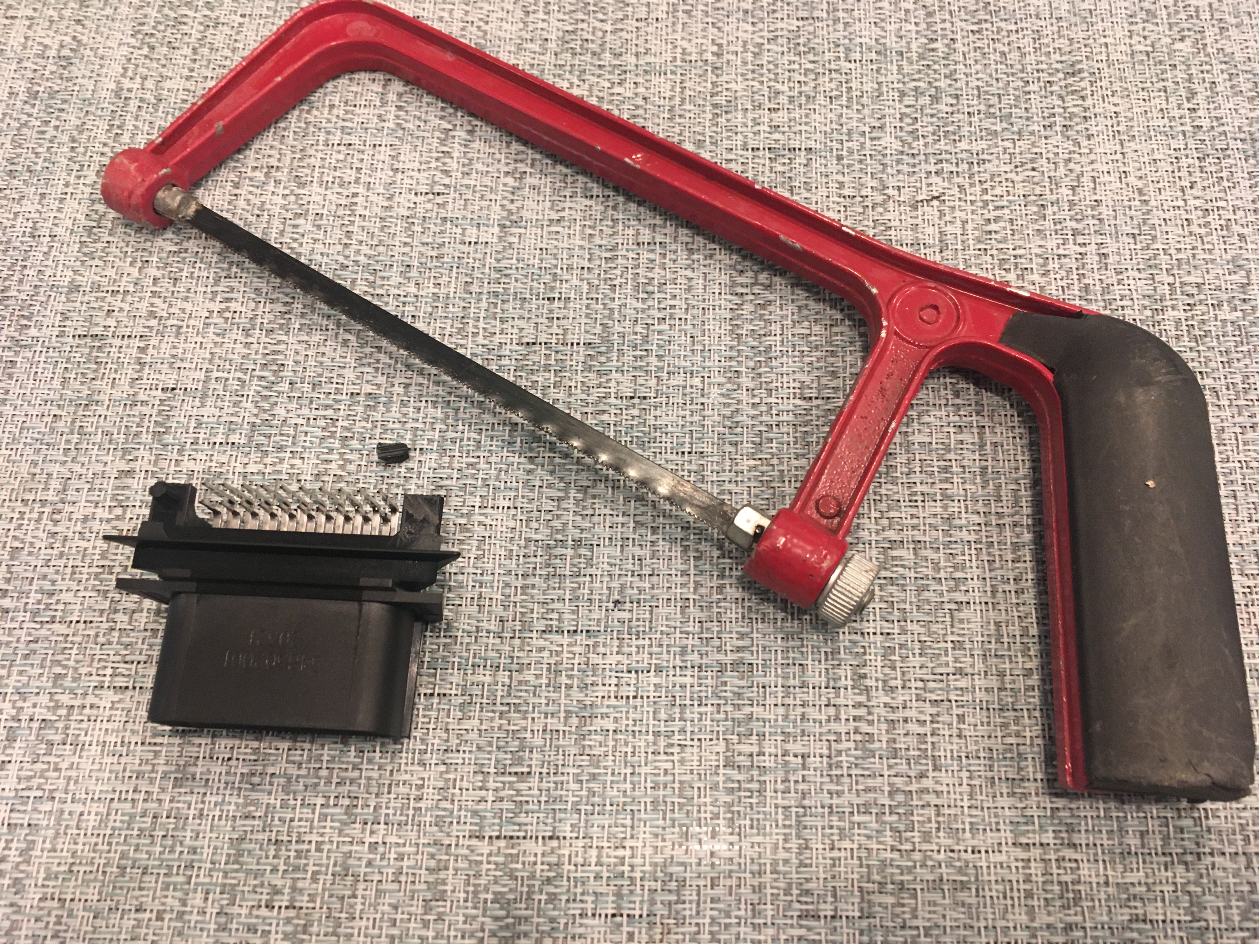

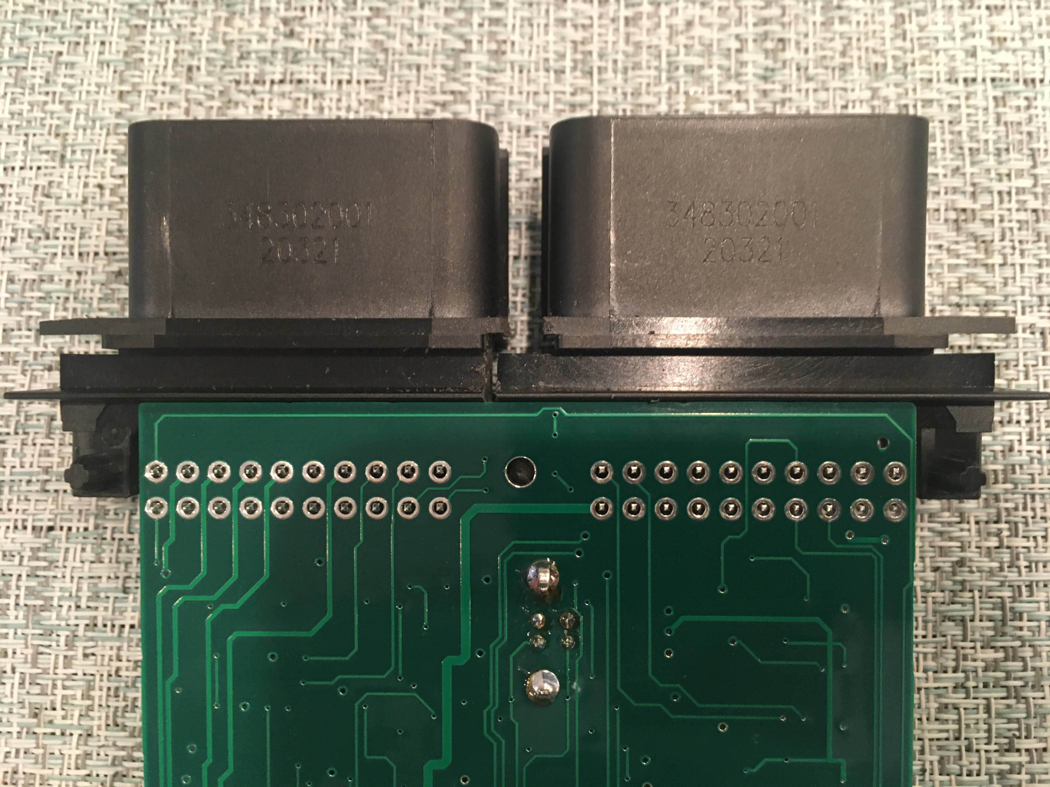

Post by Gregski »

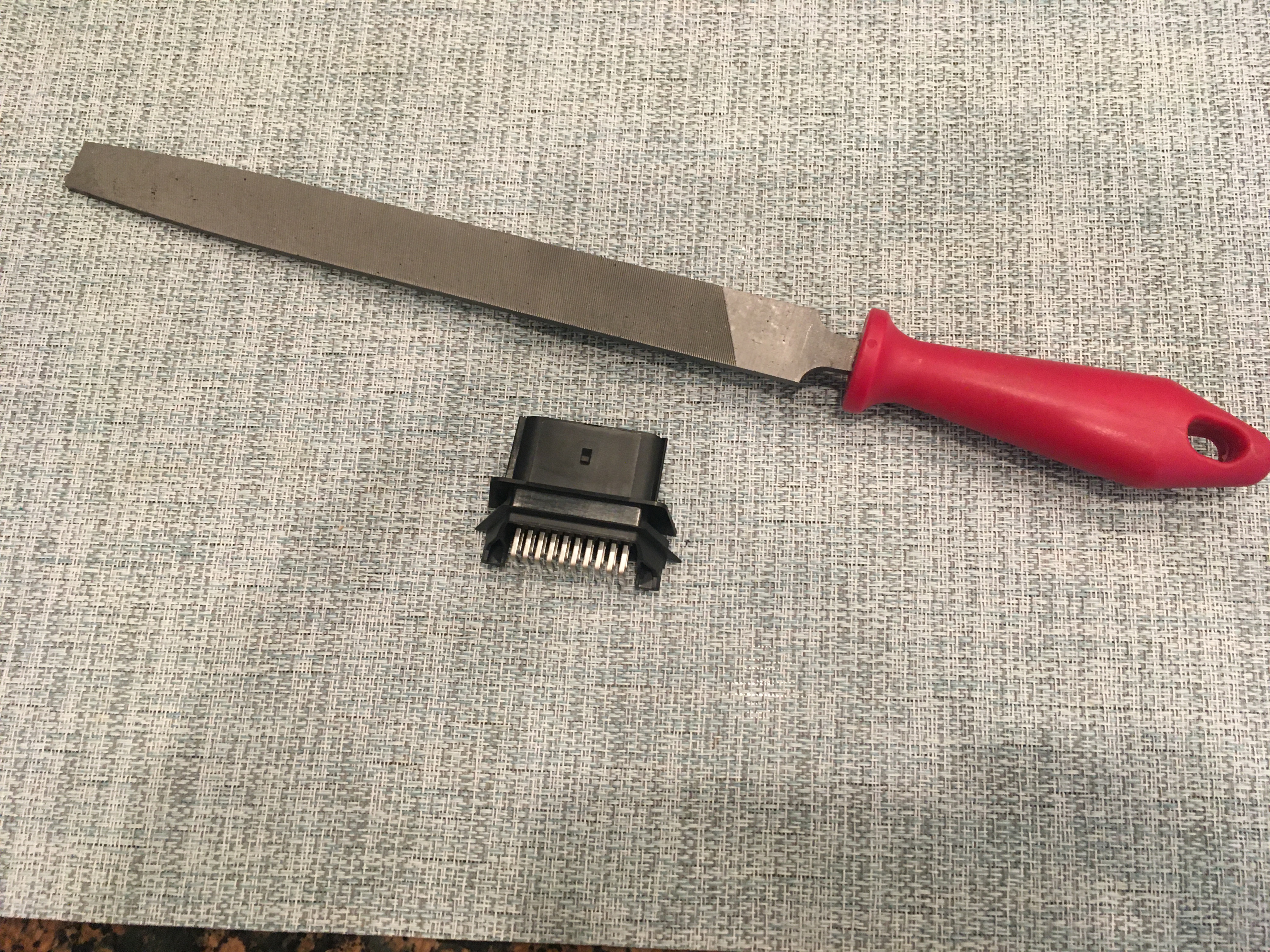

next the twins needed a little attitude adjustment
Gregski
Posts: 2272

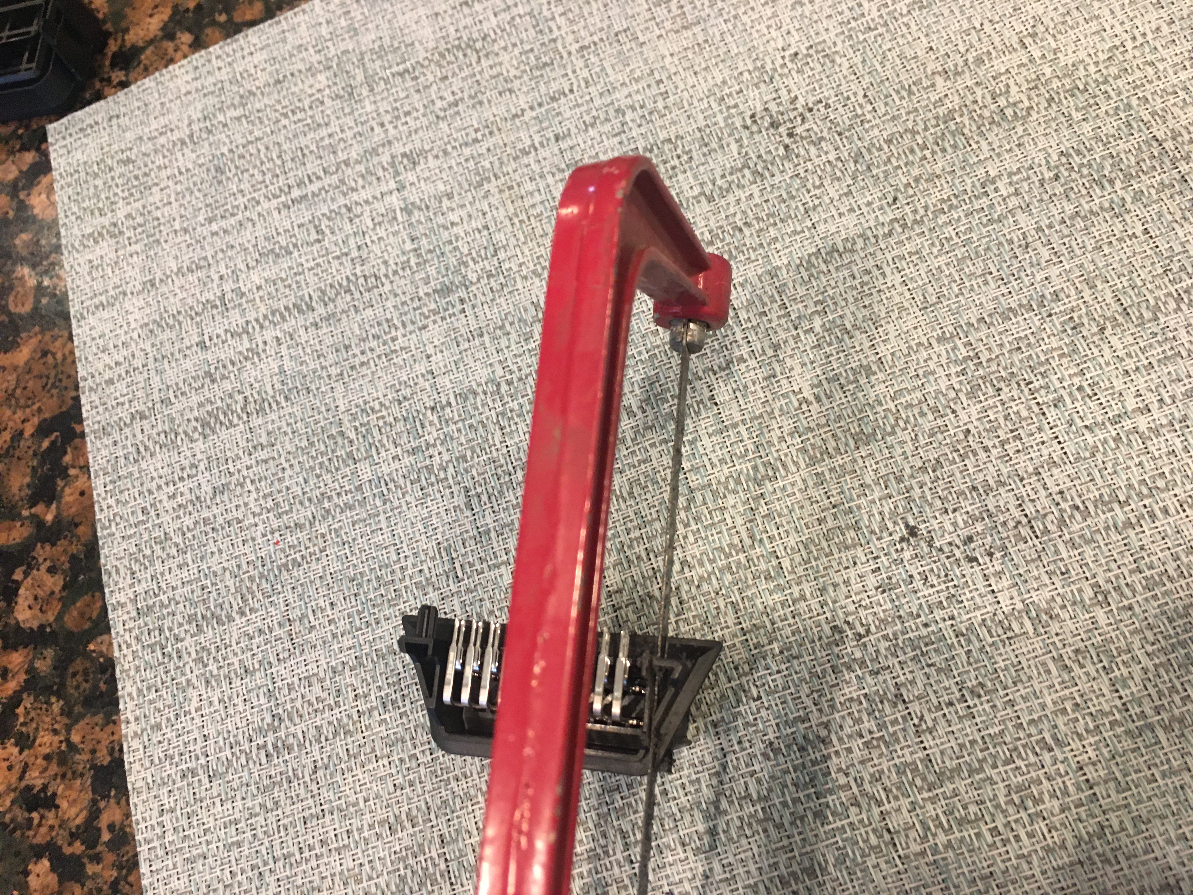

Post by Gregski »
fitment by a 1,000 cuts
Gregski
Posts: 2272
Post by Gregski »
no peg, no problem
the pins aligned perfectly no tweaking necessary
Gregski
Posts: 2272
Post by Gregski »

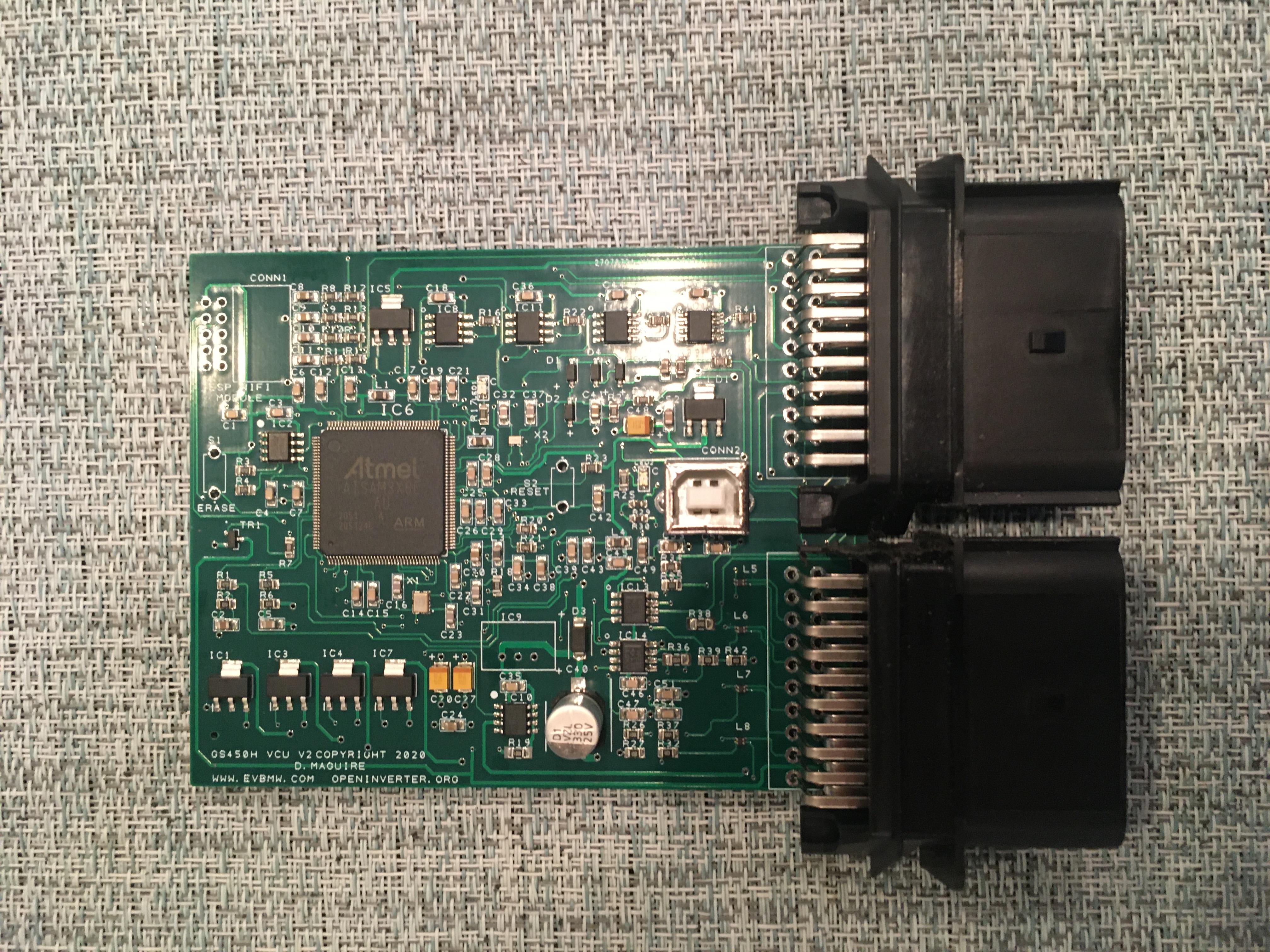

wait what? your brother want's to join too
Gregski
Posts: 2272
Post by Gregski »
10 minutes later...
Gregski
Posts: 2272
Post by Gregski »
let's try that on for size... that looks gooder
