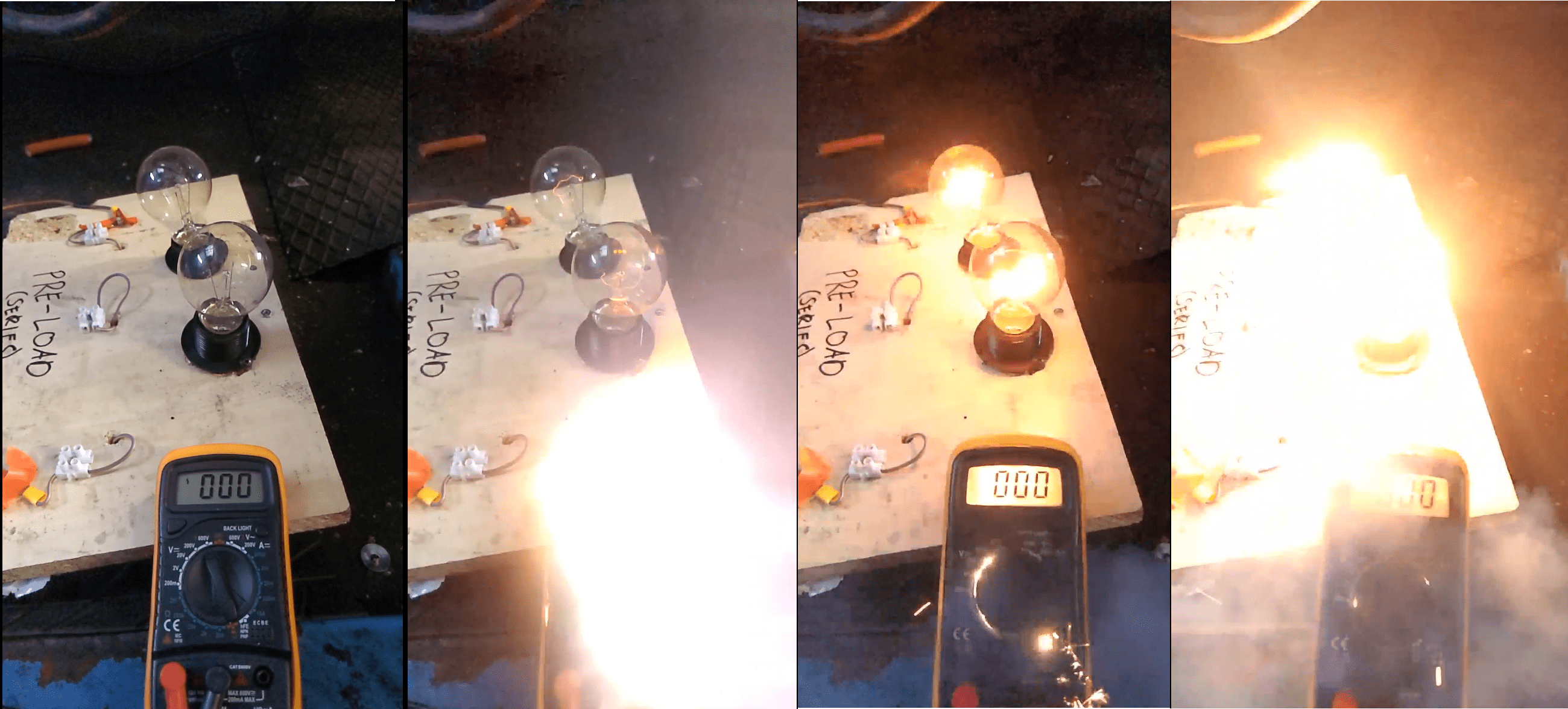

Main thing here is safety, safety, safety...
I have multiple real..l cheap ones for 12volt stuff, but for 300 V @ 5000 amps potential fault current, I use trusted Flukes. Good meters like Flukes have a real HRC fuse installed internally to protect the user.
Sometimes you can get them on Ebay at a reasonable price, but I don't know how you check authenticity before you get it.
