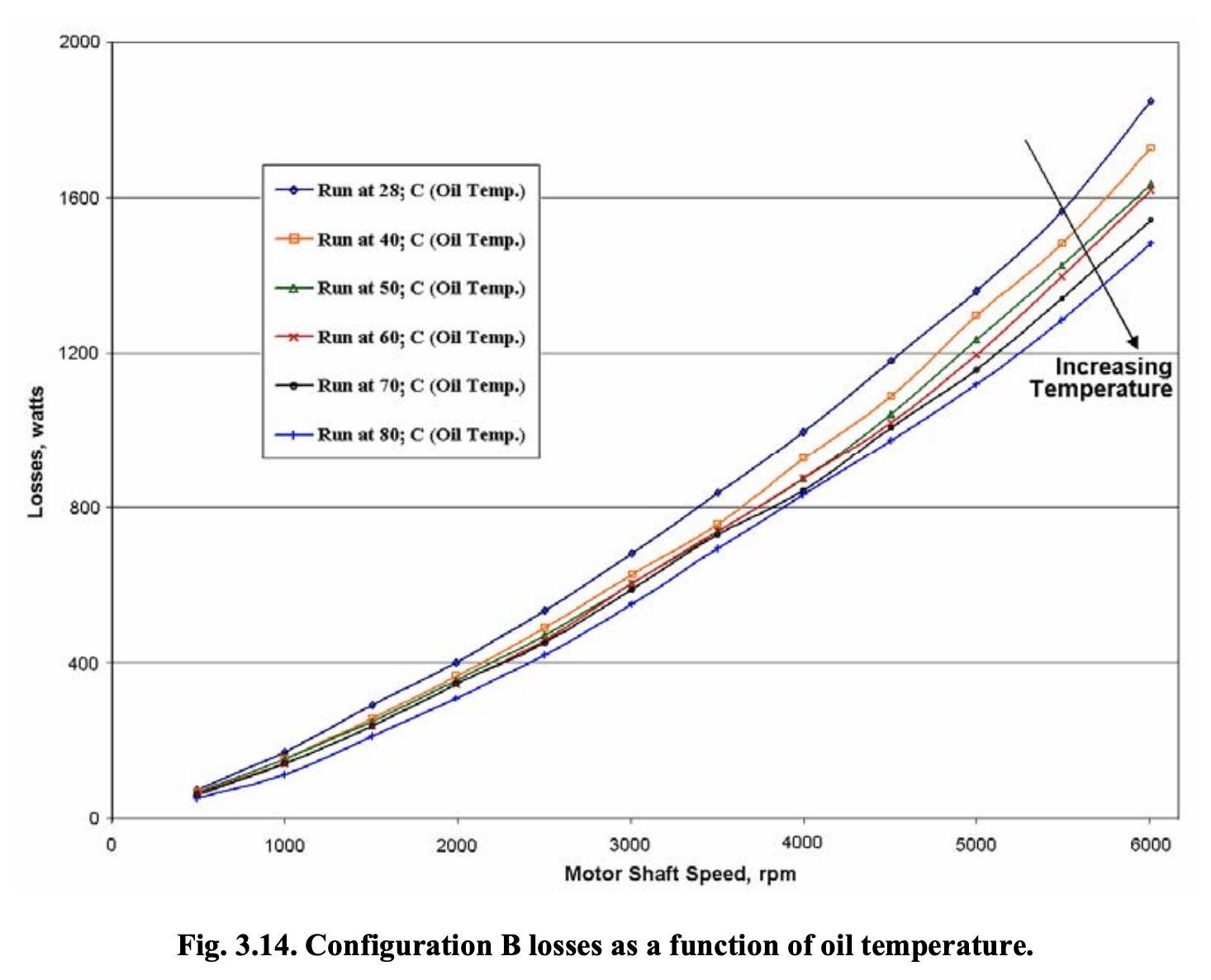

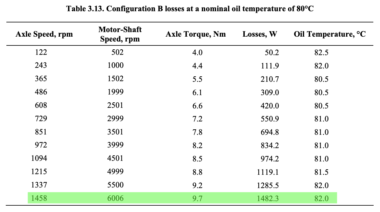

Science against an MGR Lubrication Oil circulation scheme
The highest oil temps recorded under the most severe testing that ORNL conducted as sited in the report linked above by ZooKeeper were in the 80ºC range.
Bottom line is that there seems to be no science supporting the need for and MGR oil circulation scheme, so long as a high quality lubricant is used, and regular PM schedules are followed. It would probably be a good idea to install a probe to monitor gear oil temperature when in operation.
references:
https://en.wikipedia.org/wiki/Pensky%E2 ... d-cup_test
So any GL-5 synthetic high performance gear oil will be rated with a viscosity degradation temperature in excess of 120ºC and a thermal flash point (PMCC) @ 200ºC. The standardization of the methods for determination of performance specifications for API GL-5 Lubricants are defined in the most recent version of ASTM D7450 if you want to get scientific about the analysis. Bottom line is that there seems to be no science supporting the need for and MGR oil circulation scheme, so long as a high quality lubricant is used, and regular PM schedules are followed. It would probably be a good idea to install a probe to monitor gear oil temperature when in operation.
references:

Re: Science against an MGR Lubrication Oil circulation scheme
However, the rotor temps were over 200*C and an MGR/Q211 does not have cooling loops like a Prius has. So for an EV drive, I would submit that testing is needed to establish actual fluid temperatures during operation.Bassmobile wrote: ↑Sun Sep 20, 2020 6:21 pm The highest oil temps recorded under the most severe testing that ORNL conducted as sited in the report linked above by ZooKeeper were in the 80ºC range.

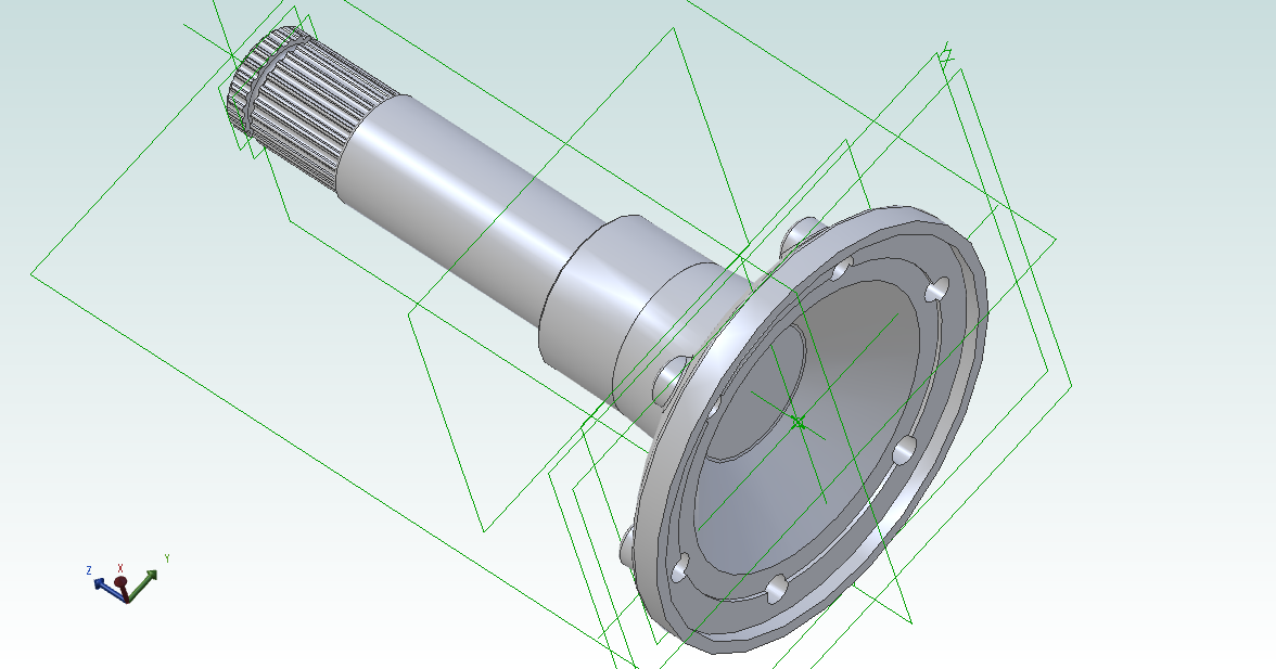

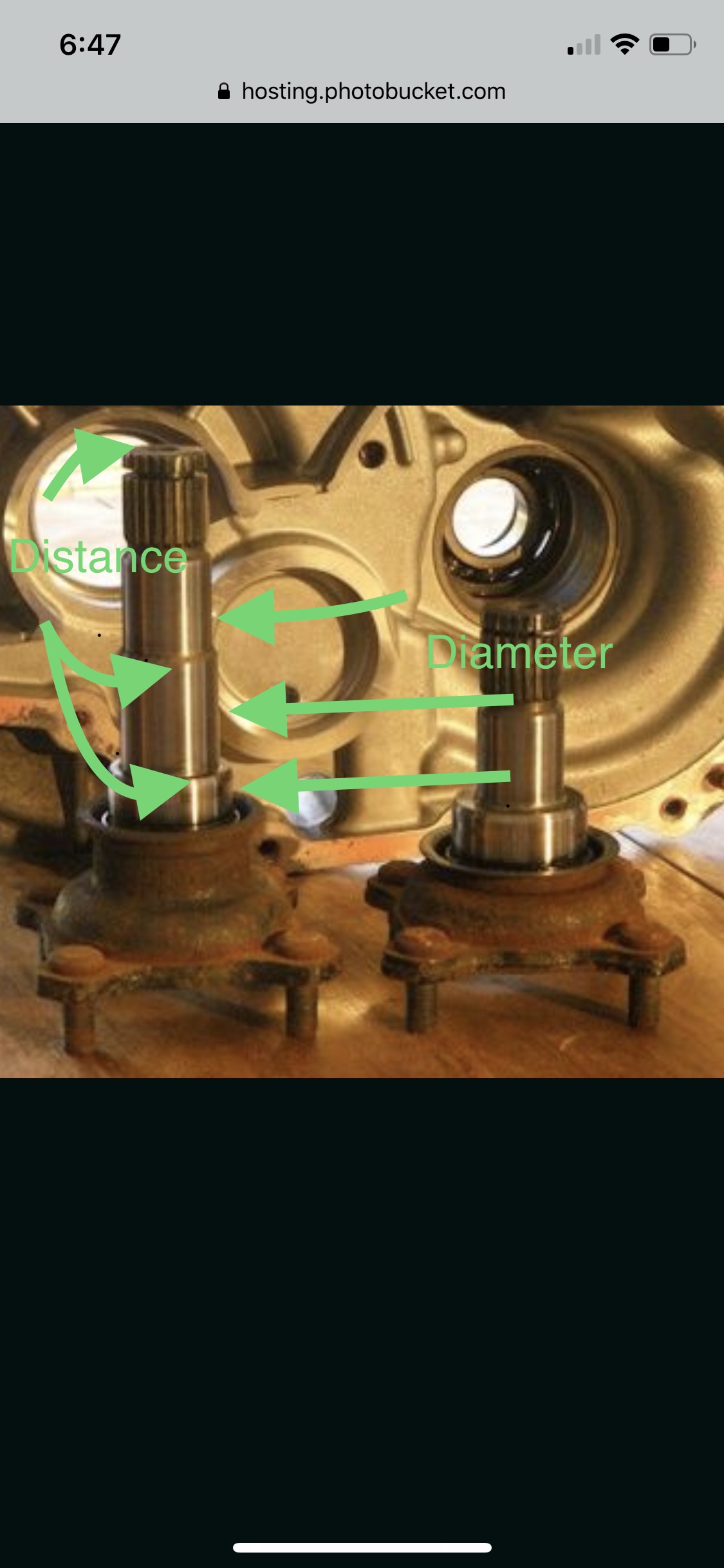

Wonder if I could get some assistance with a couple dimensions for the RS axle stub shaft? (The long one) I’m just finishing up my adapters but I didnt have a stock right side to measure. Primarily looking for the diameters of the steps after the spline. First one should be 27mm dia. Also need the offset from the very end of the splines to the diameter changes. Greatly appreciated!

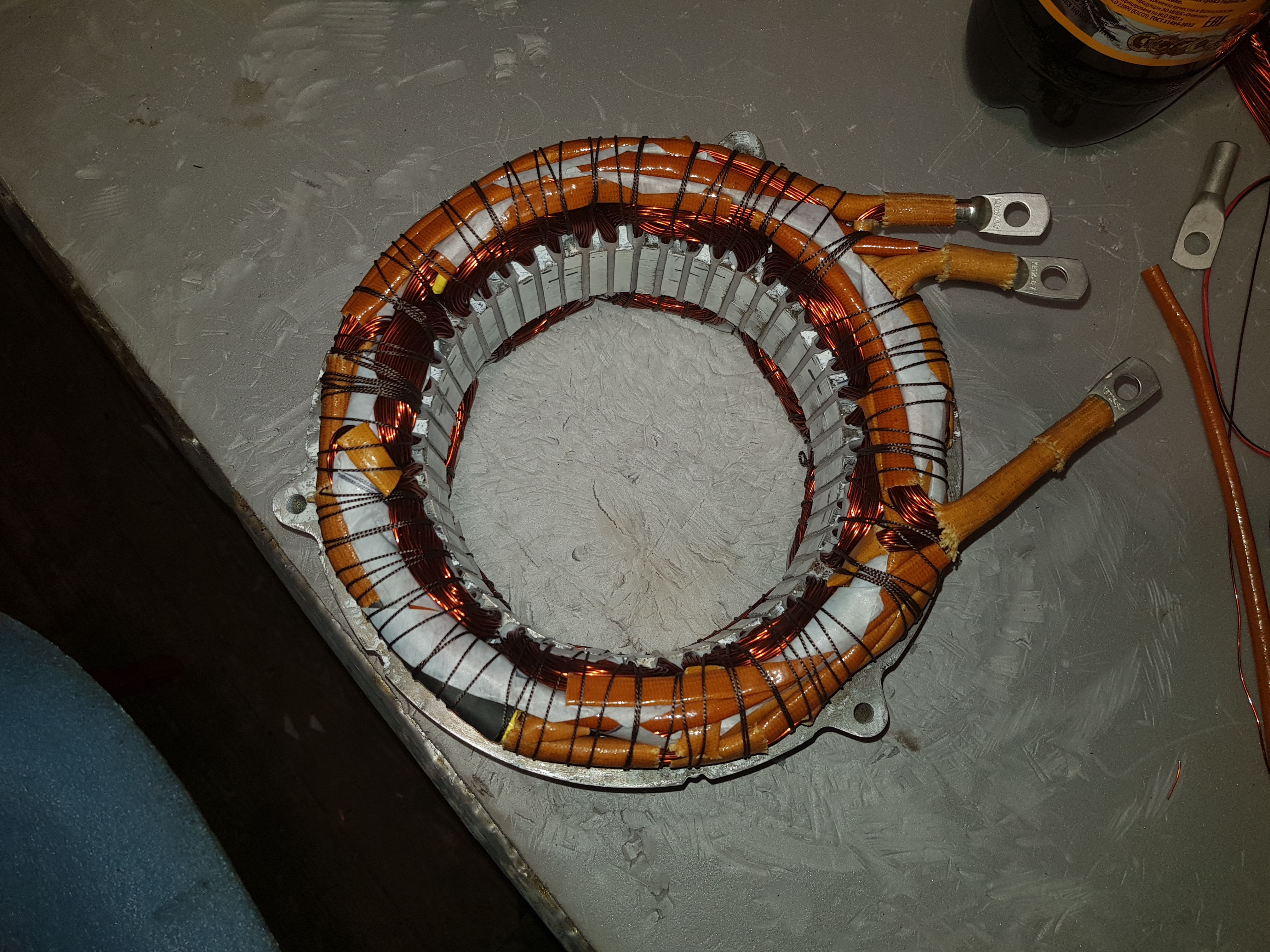

I`ve rewinded MGR from 42 to 10 turns and got 60 rpm/V. With 150V now give arround 9000 rpm.
Initially it was 12 rpm/V.
My project is Electro-Tigra https://electrotransport.ru/ussr/index. ... 5.0#topmsg
Re: Toyota MGR Rear Traction Transaxle
Did you take any photos of this process? I've rewound ebike motors but not considered anything as big as this.

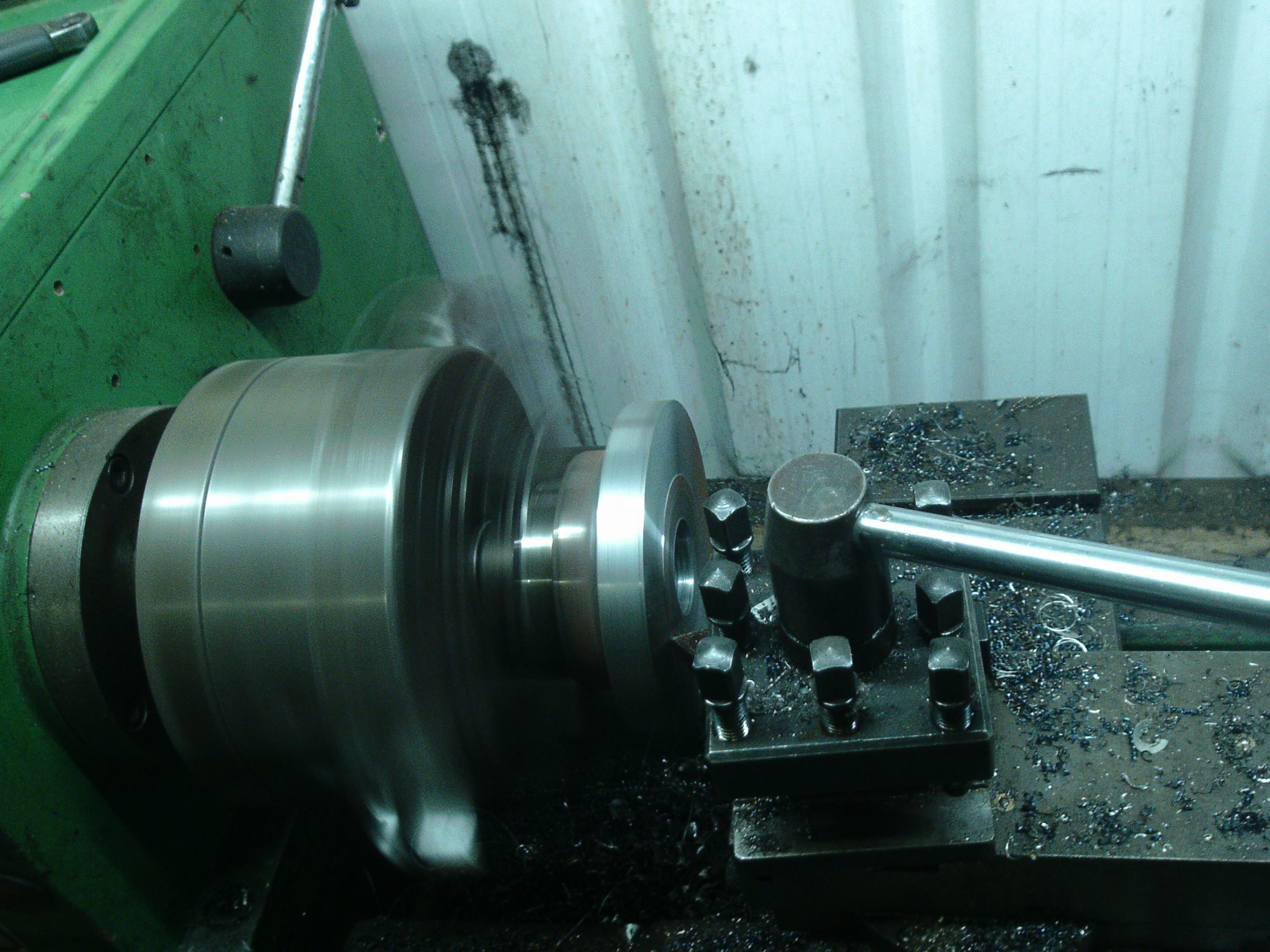

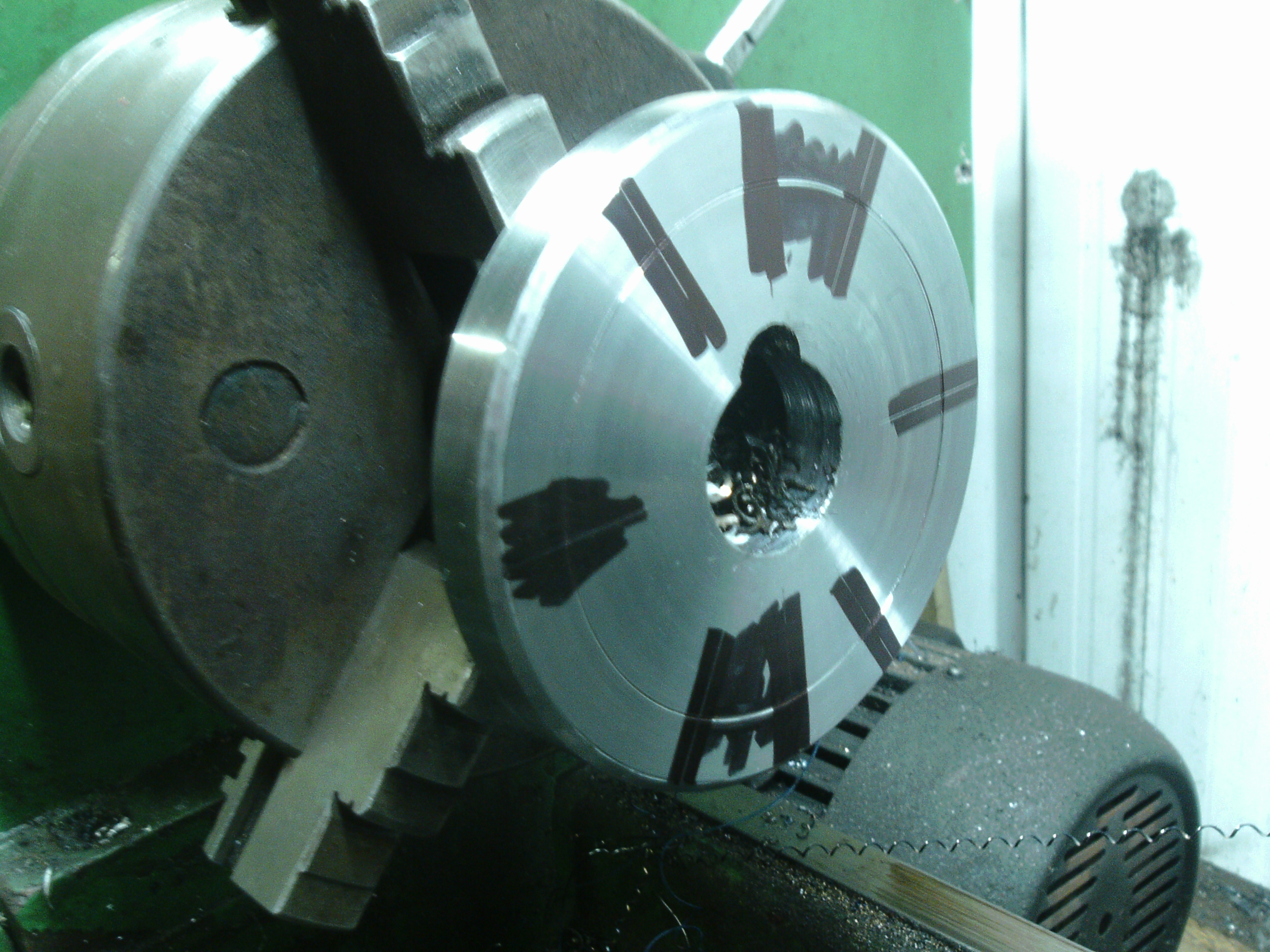

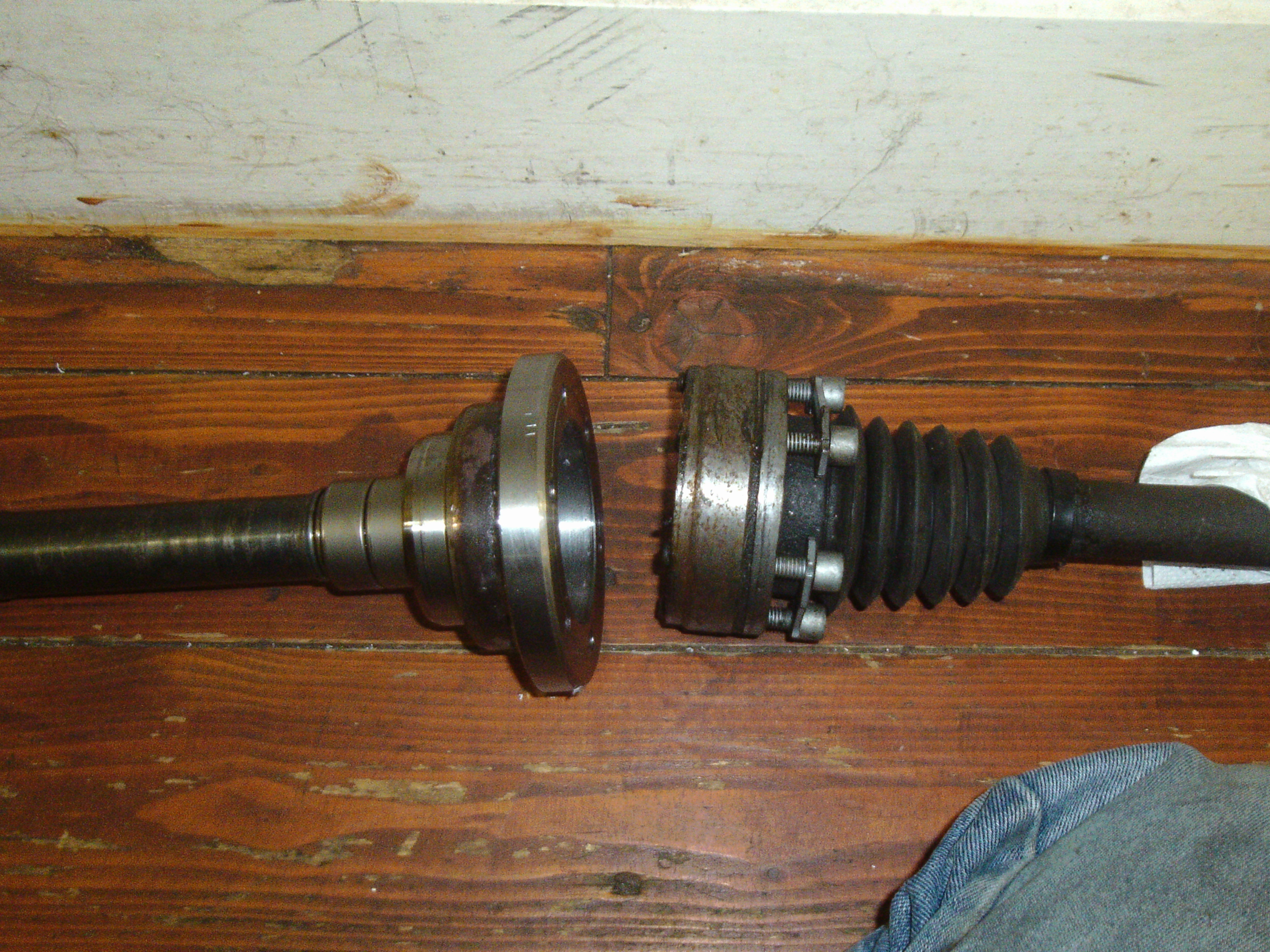

I was trying to design an adapter plate wich could be bolted to MGR output flange on one end and to BMW CV housing on the other end. Almost immidietly realised that it is impossible, or adapter plate must be thic and over complicated.
So I see two ways: cut MGR flange and weld BMW flange to it. Not cheap procedure but the most tidy one. The other option is cheap, yet rely on your welding skill, and this is to make as Damied did - cut schafts in the middle and weld them using metal sleeves.
I'm now going Damien's way.

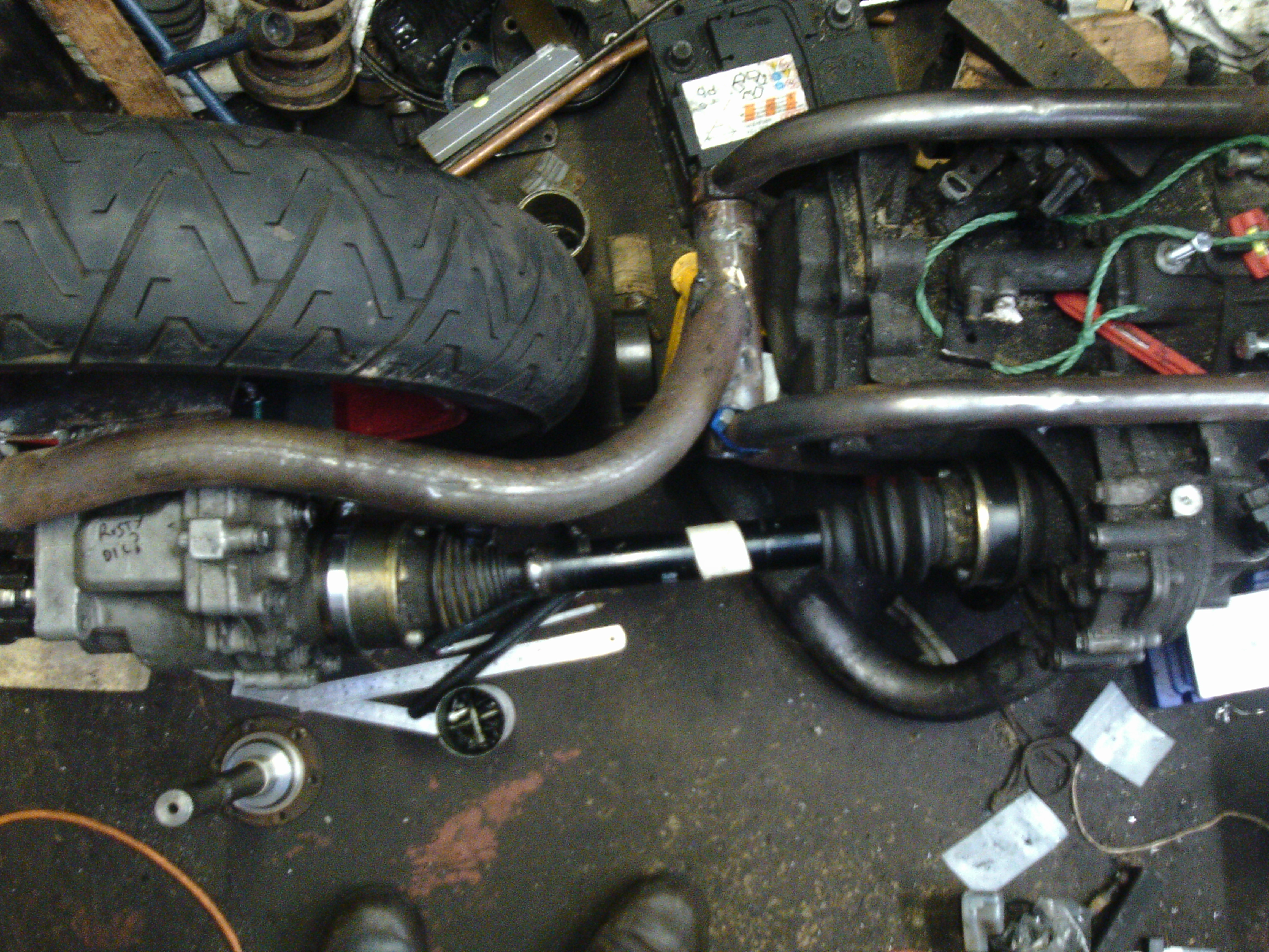

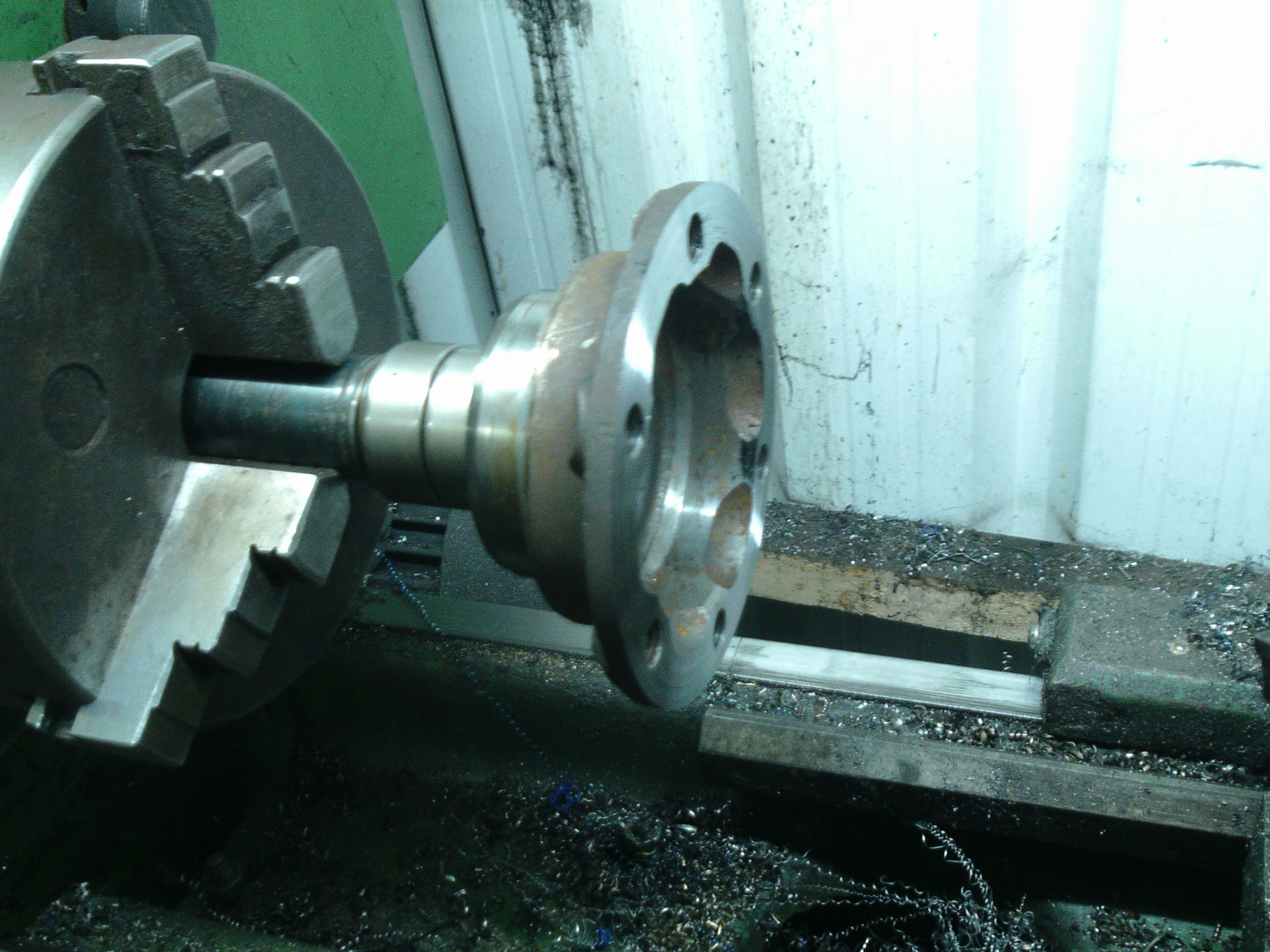

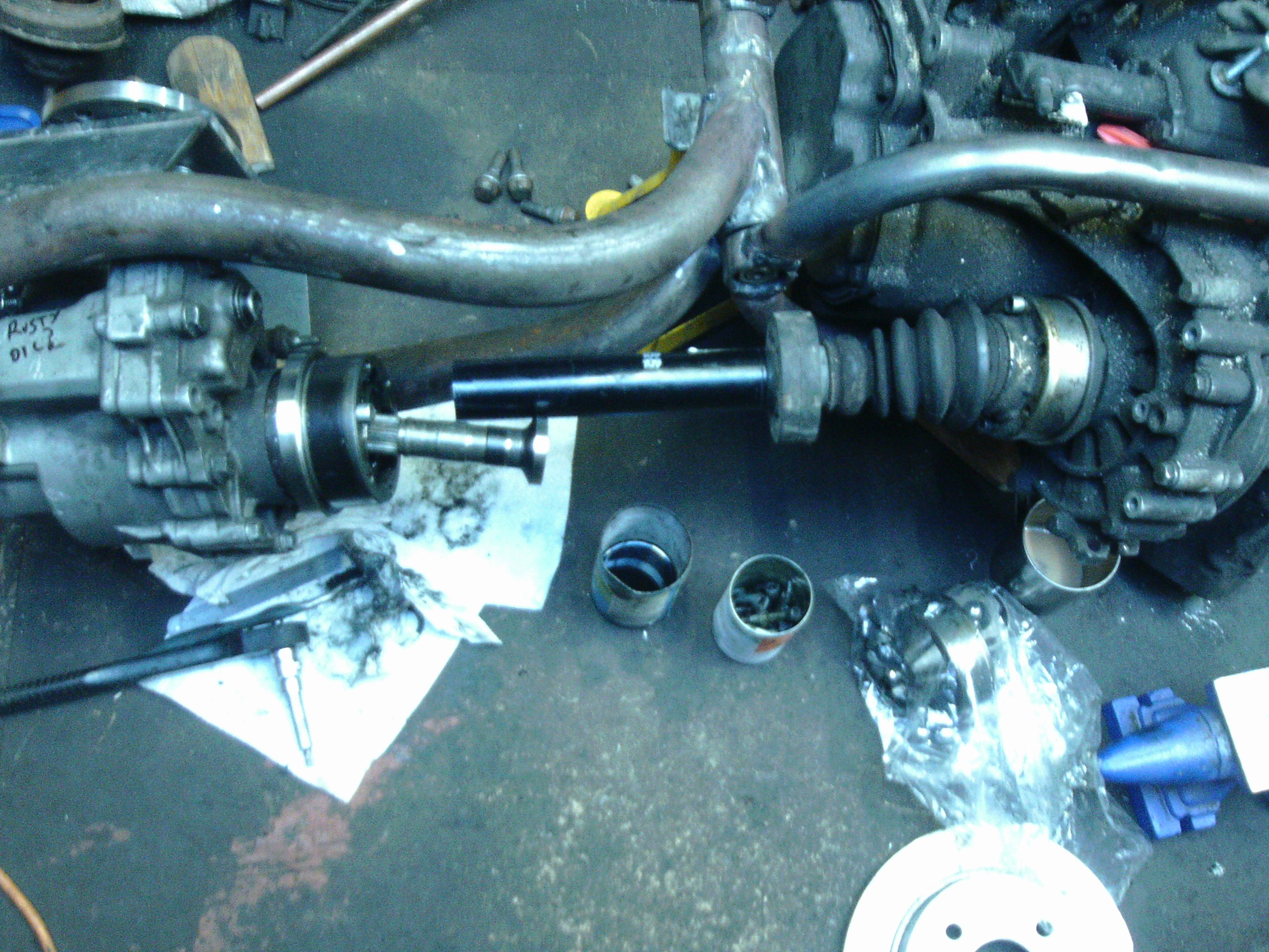

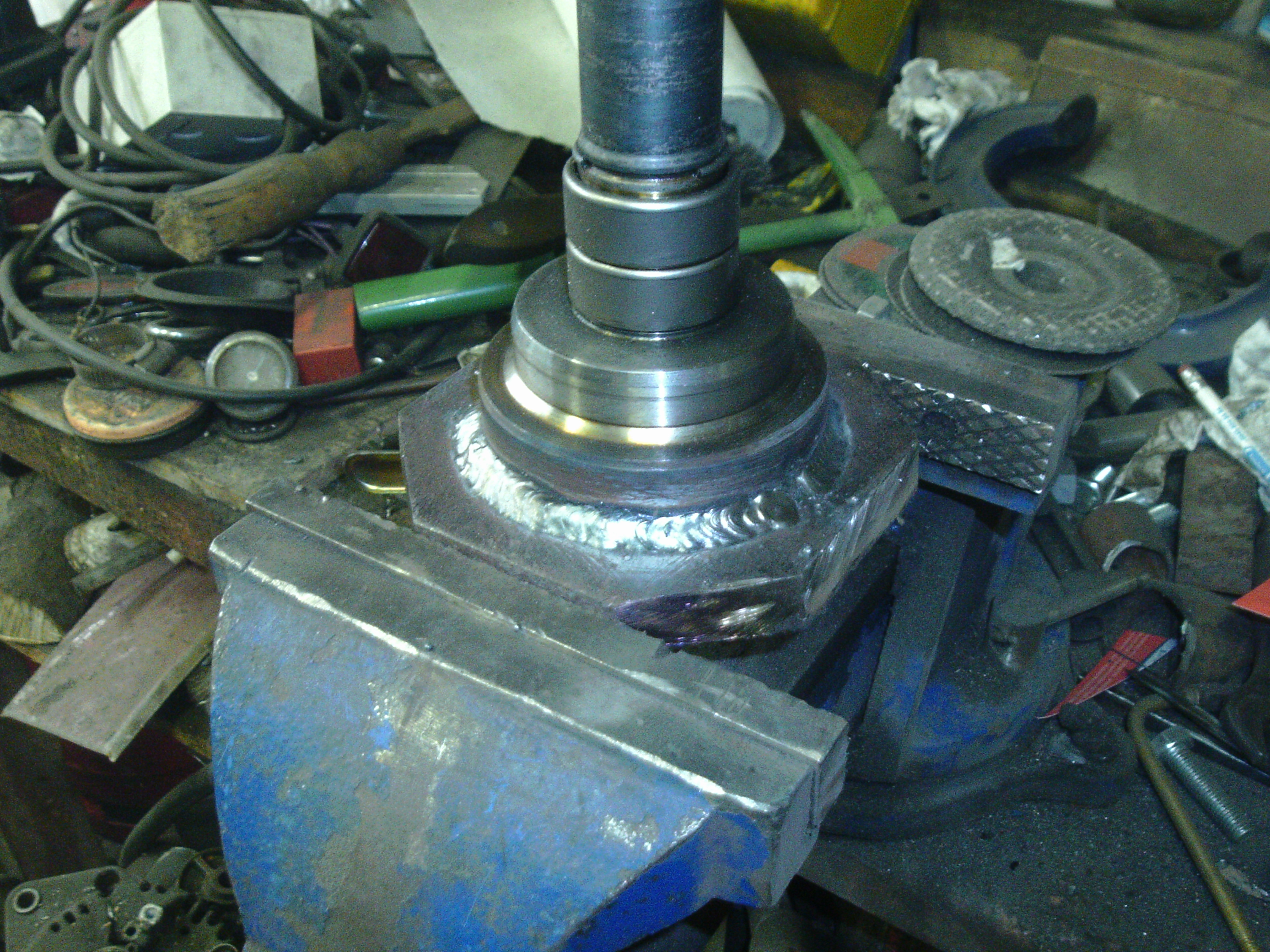

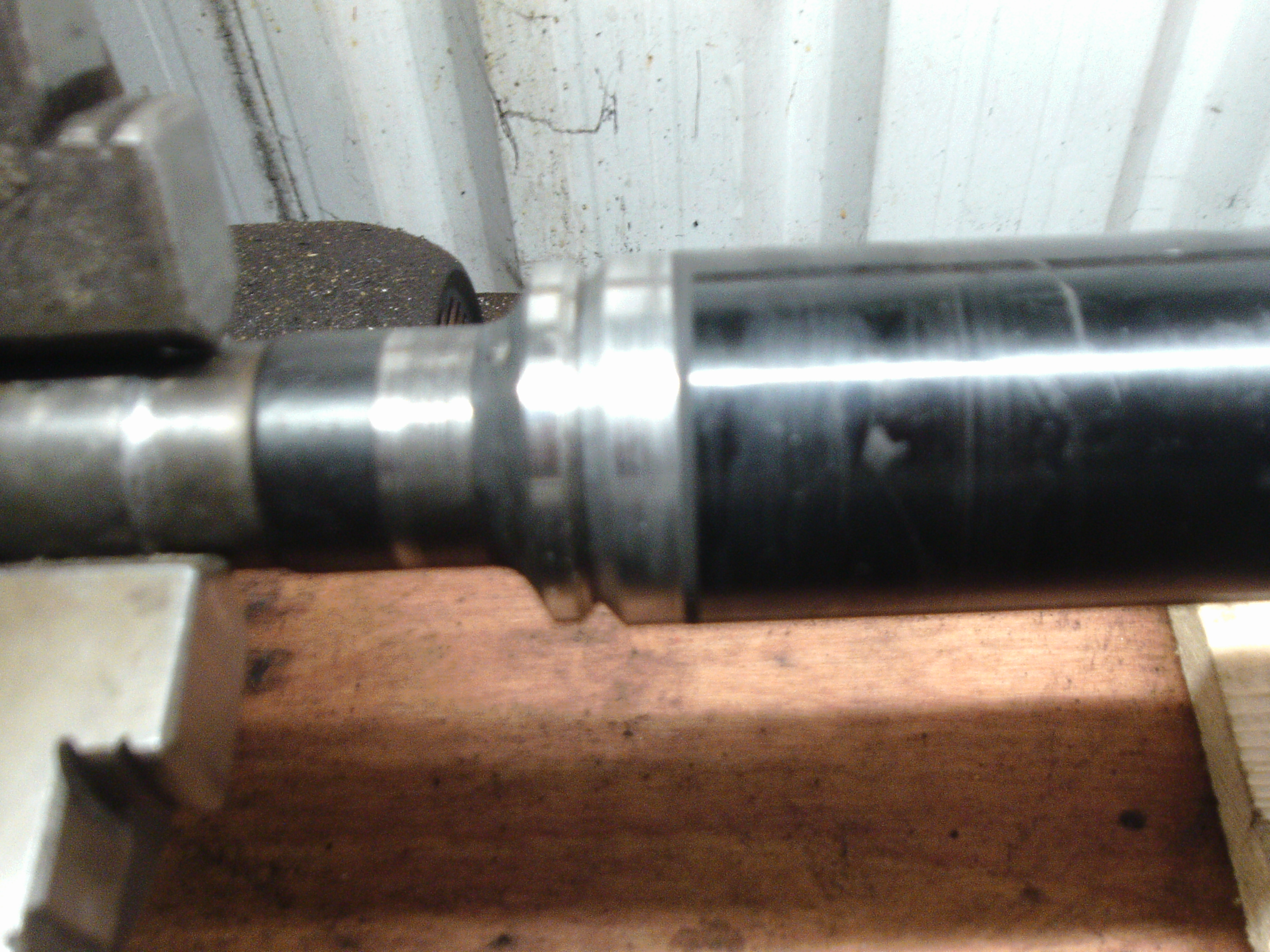

This sort of thing is not beyond the hobbyist if you have access to a lathe.
You could weld a plate to the MGR flange and then turn it to the dimensions of the BMW CV joint so it would just bolt on.
I did this for the last bike project I made using VW CV joints and it worked very well.
I've also welded a shaft for the same project with a little bit more finesse than Damien probably only because I've got a lathe in my tool kit
I did buy high tensile rods for this job.
The modified flange is in the left of the photo.
Modified flange and shaft. Been in constant daily use for 4 years.

What is the PCD of the BMW flange?konstantin8818 wrote: ↑Fri Nov 06, 2020 4:24 pm I was trying to design an adapter plate wich could be bolted to MGR output flange on one end and to BMW CV housing on the other end. Almost immidietly realised that it is impossible, or adapter plate must be thic and over complicated.
Here is how I did to adapt MGR to small VW flange. Maybe you can do something similar?
viewtopic.php?f=11&t=912#p14765
viewtopic.php?f=11&t=912#p16959
- konstantin8818
- Posts: 287
- Location: Minsk, Belarus
- Been thanked: 5 times
It's 80,1mm.
Unfortunately for now I haven't got my own lathe. Flange I've designed was pretty similar to yours. Lathe operator said it would be expensive one. To cut MGR flange and weld BMW one to it would be cheaper, yet the most cheap way was to buy two drive schafts from Lexus and to make two sleeves.

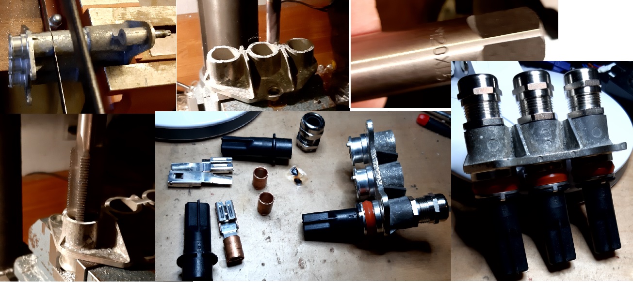

Short picture series showing how you can shorten and reuse the power plug. The copper tubes is made from 12mm water pipe and fit perfect when crimped with 35mm2 jars on my YKQ-70 crimp tool, I advise on of those, low cost and fine quality, I would not like to make EV cables without a hydraulic Crimping Tool.
I have used EMC Grounding Glands size M20x1.5mm that can handle the 14mm shielded 35mm2 cable I use in my build.
- TheSilverBuick
- Posts: 187
- Has thanked: 3 times
You're the second person I've seen this week use copper pipe to make crimped cable ends. Nice!
Look closely how factory cable ends are made. Those being sold at electronics shops. They are also pressed from pipes.TheSilverBuick wrote: ↑Thu Nov 12, 2020 7:48 pm You're the second person I've seen this week use copper pipe to make crimped cable ends. Nice!

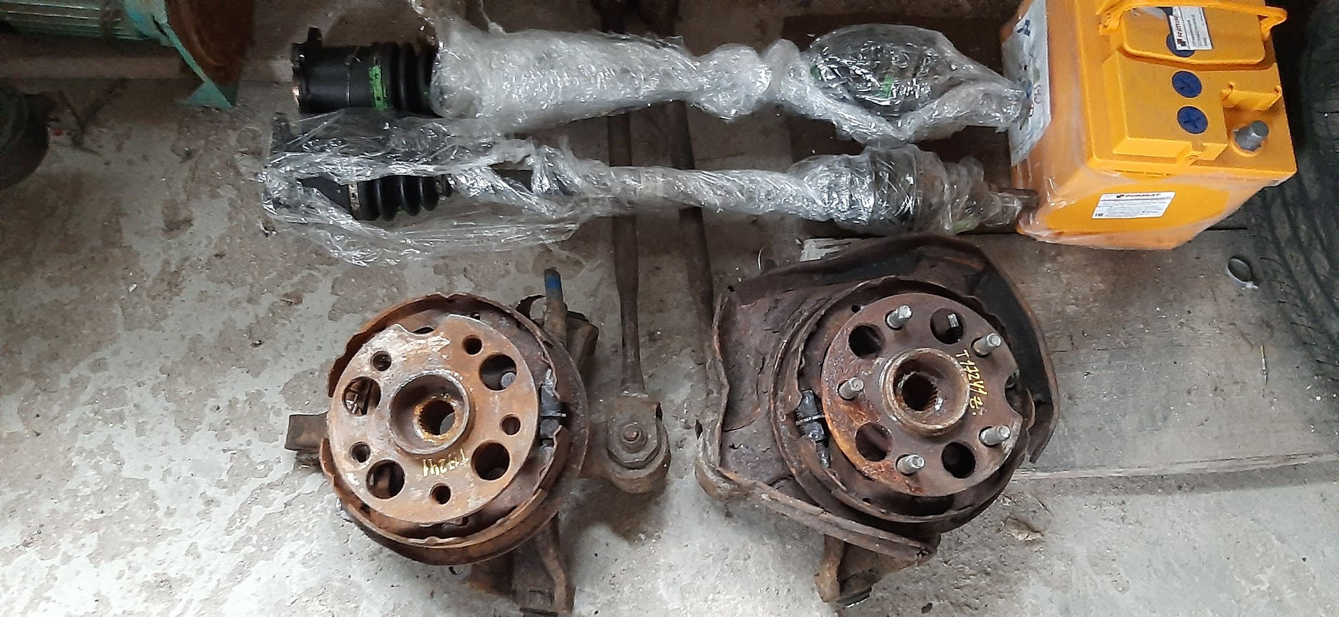

Off topic: desided not to cut drive schafts, but bought two hub assemblys from RX400h. They are designed almost perfectly to be fitted to long travel buggy suspension Also have seen another Lexus MGR on sale for 30 bucks, can't resist to buy it AWD is closer then it looks...

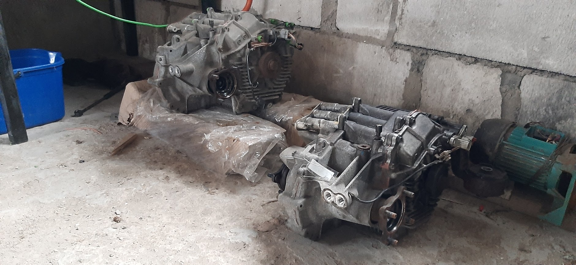

Interestin observation: I've connected my second MGR to inverter without changing any parameter and it spins
It jitters but doesn't run away. So that means for MGR you can start syncofs tuning from 22000 and just tune it a little for motor to run smoothly.
Video is in Russian, but there is nothing, you guys don't know
Yes, interesting. I tried SO near 22k and could not get good results, ended up about 1/2 of that at 10975.konstantin8818 wrote: ↑Tue Nov 17, 2020 5:08 pm Interestin observation: I've connected my second MGR to inverter without changing any parameter and it spins
