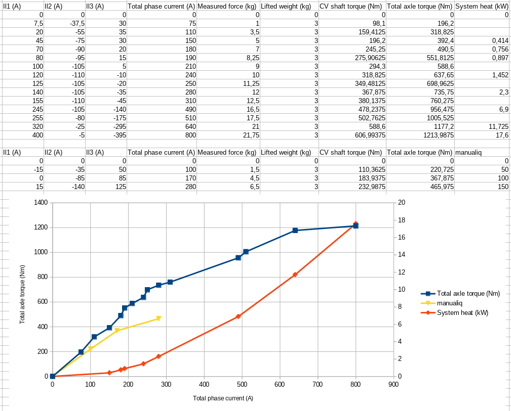

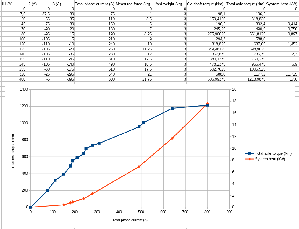

I reached overcurrent at ocurlim=650 and I think I'm not going to increase the limit.
When adding this final data point it looks like the torque curve flattens at 1200Nm and feeding more than 700A of phase current will only make more heat.
Now the question is, if the hundreds of amps used for -Id were instead added to Iq, would there be more torque? Based on my understanding, there should be. I have noticed the -Id/Iq ratio in this test has been roughly 1:1. For example at the 640A 1177Nm data point looks like the split was roughly Iq=250A Id=-250A. Any thoughts on this? I guess I'll try something in manual mode, but for normal mode the code to modify looks to be in FOC::Mtpa().

Thats quite impressive. In fact at higher loads the reluctance torque created by -id outruns the magnetic torque created by iq. So you won't see more torque by shifting current over to iq.
That said, FOC::Mtpa() uses some hard coded values for the MTPA formula, I think they are from a Prius motor. I did some calculating samples in a spread sheet and found the resulting id and iq did not change very much when varying the inductance values. But if you want to tweak more that is indeed the right place. More specifically the constants fluxLinkage, lqminusldSquaredBs10 and lqminusld

No need for any of that theory shmeory. I measured some data points and it was easy to make a conclusion. It was quite uncomfortable to use manual mode as I had to slowly ramp up the current by typing numbers with my frozen fingers in order to not disturb the system and cause loud bangs.

So if I interpret correct, MTPA gives you 367 Nm @ 280A and pure iq gives you 232 Nm @ 280A ? Now can the constants be somehow adjusted from that?

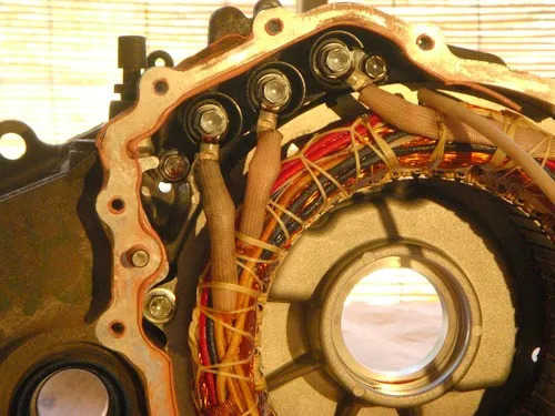

Has anyone popped onto this forum with experience on rewinding motors?
Here's a photo from earlier in this thread. You can see there seem to be two wires coming from each terminal, the simple explanation being it's delta wound. That means there might be a chance of making it suitable for even higher voltage, which would be the most useless modification, unless you want to use it as a wind turbine generator or something.
As I understand it, rewinding a stator like this goes like this:
There's actually a downside to rewinding also: You lose as much torque per current as you increase speed per voltage. Thus, it could be that a boost converter is actually the ideal solution, and Toyota was right all along.
- Cut one end of the wires off with a grinder flush with the stator core,
- tap the rest out of the stator with a suitably sized metal rod and a hammer,
- figure out how the coils were wound so that you can redo it in the same way but different
- Add new insulating sheet around where the coils go
- Make the new coils
- Remember to add a temperature sensor somewhere in the coils
- Tie the new coils in place using some kind of temperature resistant non-conductive fiber stuff, I mean... string
- Coat it with some kind of temperature resistant non-conductive resin to keep it all in place

Re: Toyota MGR Rear Traction Transaxle
Here are a few more photos of a rewind in progress, to save people from hunting back through the thread like I just did: viewtopic.php?p=19577#p19577

Wait a minute, why are there 12 wires coming out of the stator in the dismantling photo and what are those additional crimped connections? Is it wye wound after all, with two parallel windings?
