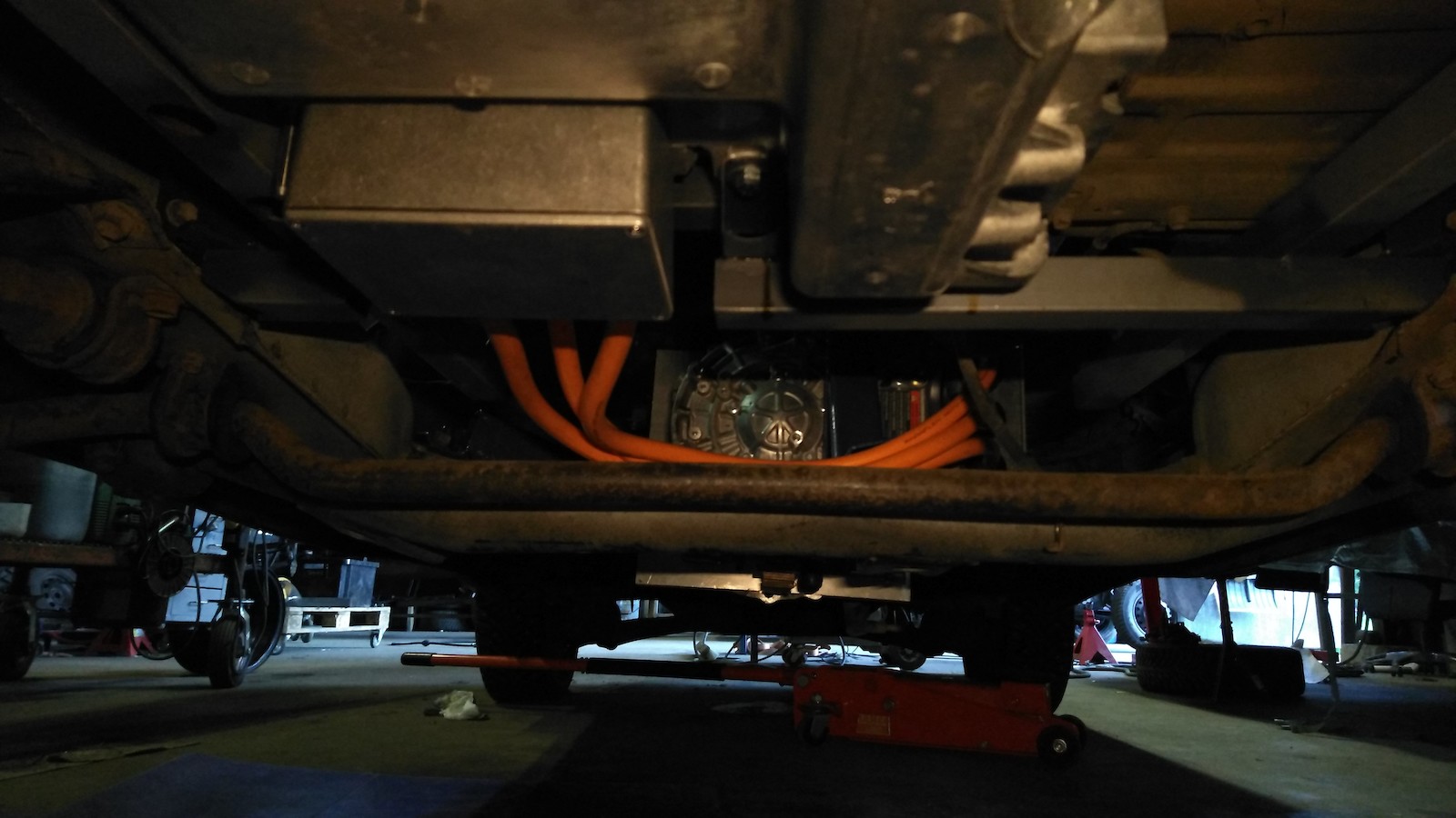

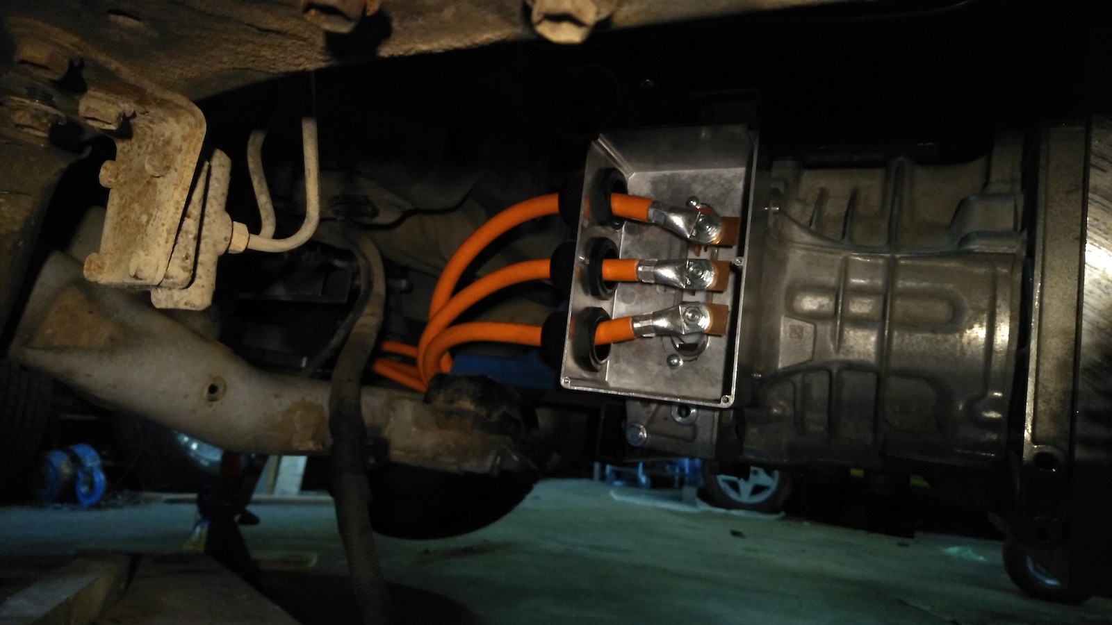

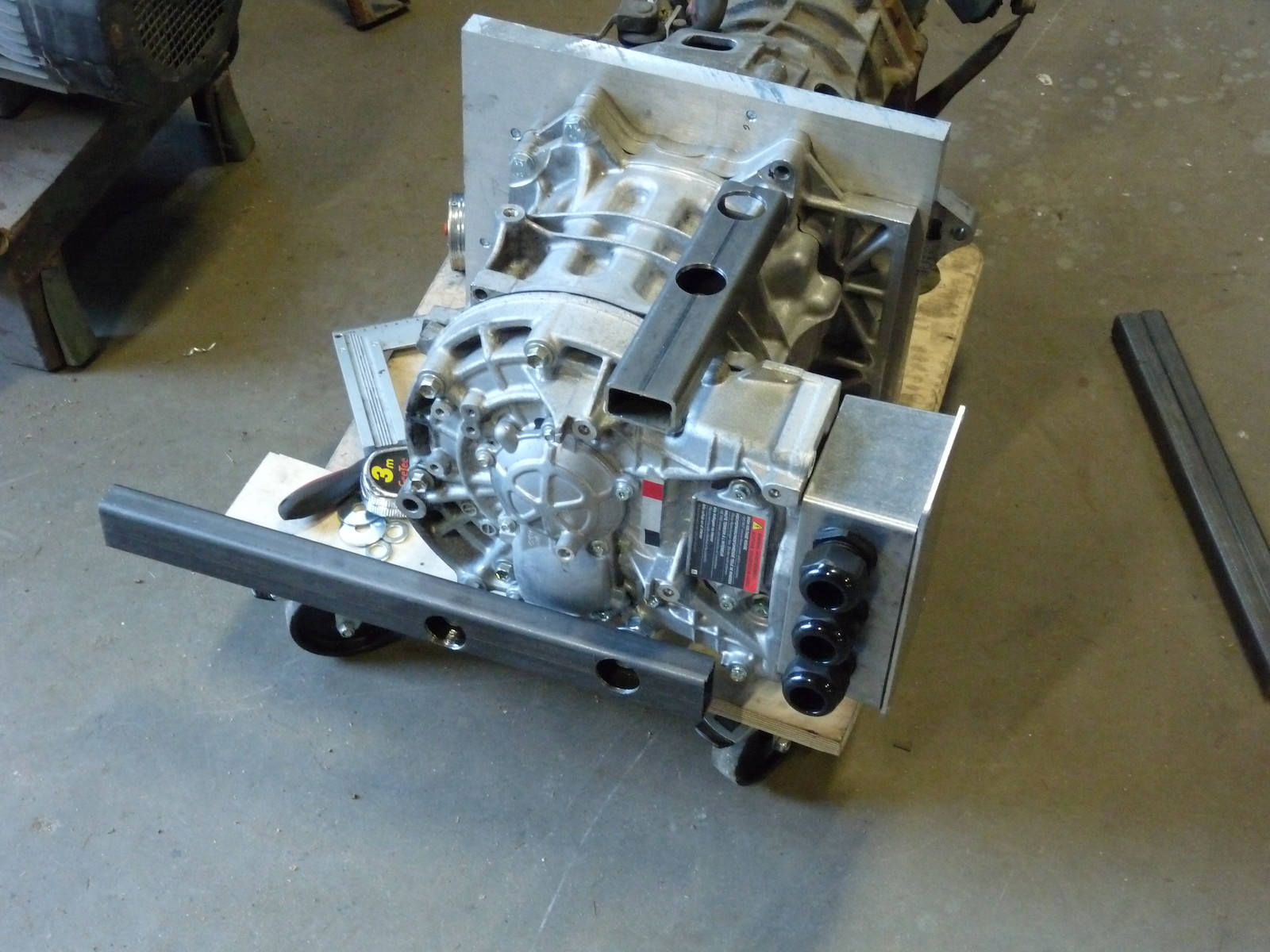

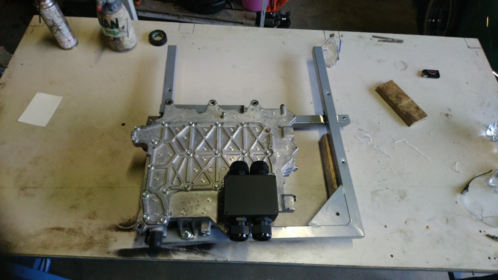

Re: Mounting motor/inverter/PDM separately...
Post by celeron55 »
I did that in mine. Note that I did add some cable protector and proper cable mounts and I would recommend a ground sleeve/mesh for the motor phase cables for EMI reasons, it's on my late to-do list. As for the PDM, it has cables already, just cover the extra holes you aren't using.

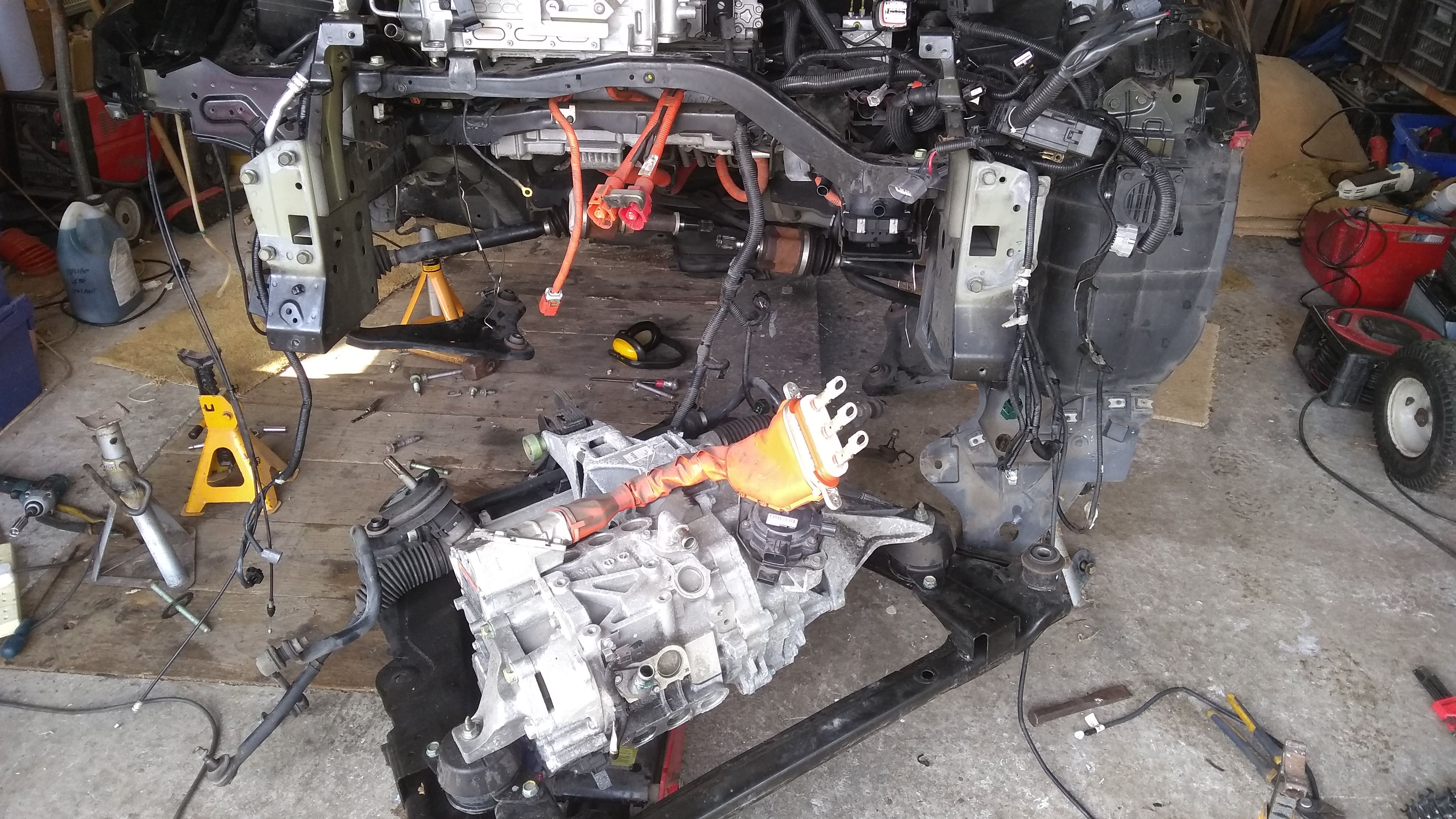

Alibro
Posts: 864
Location: Northern Ireland
Has thanked: 274 times
Been thanked: 154 times
Post by Alibro »
This my the motor removed from the donor Leaf and you can see the Inverter lead on the top.
