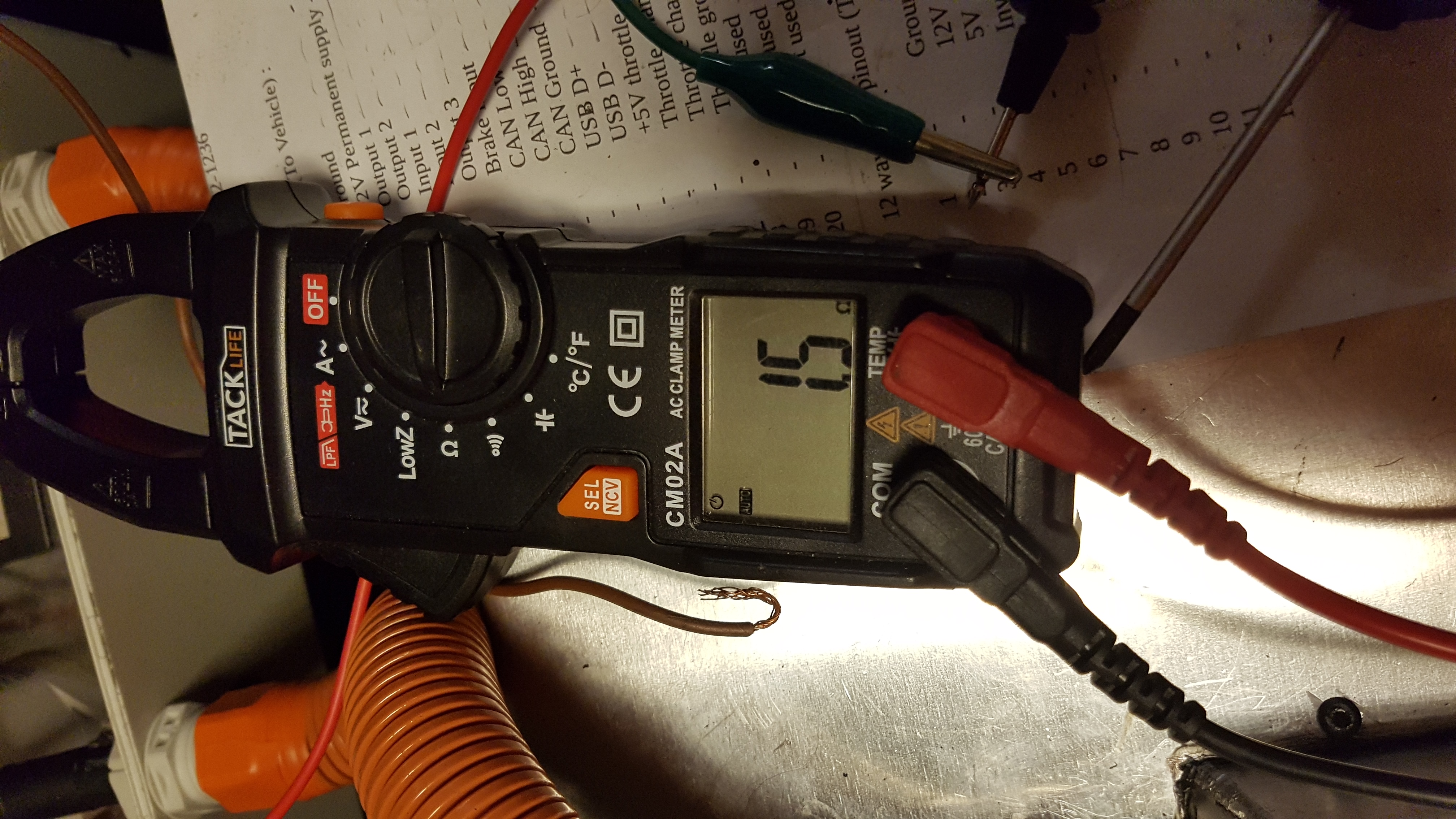

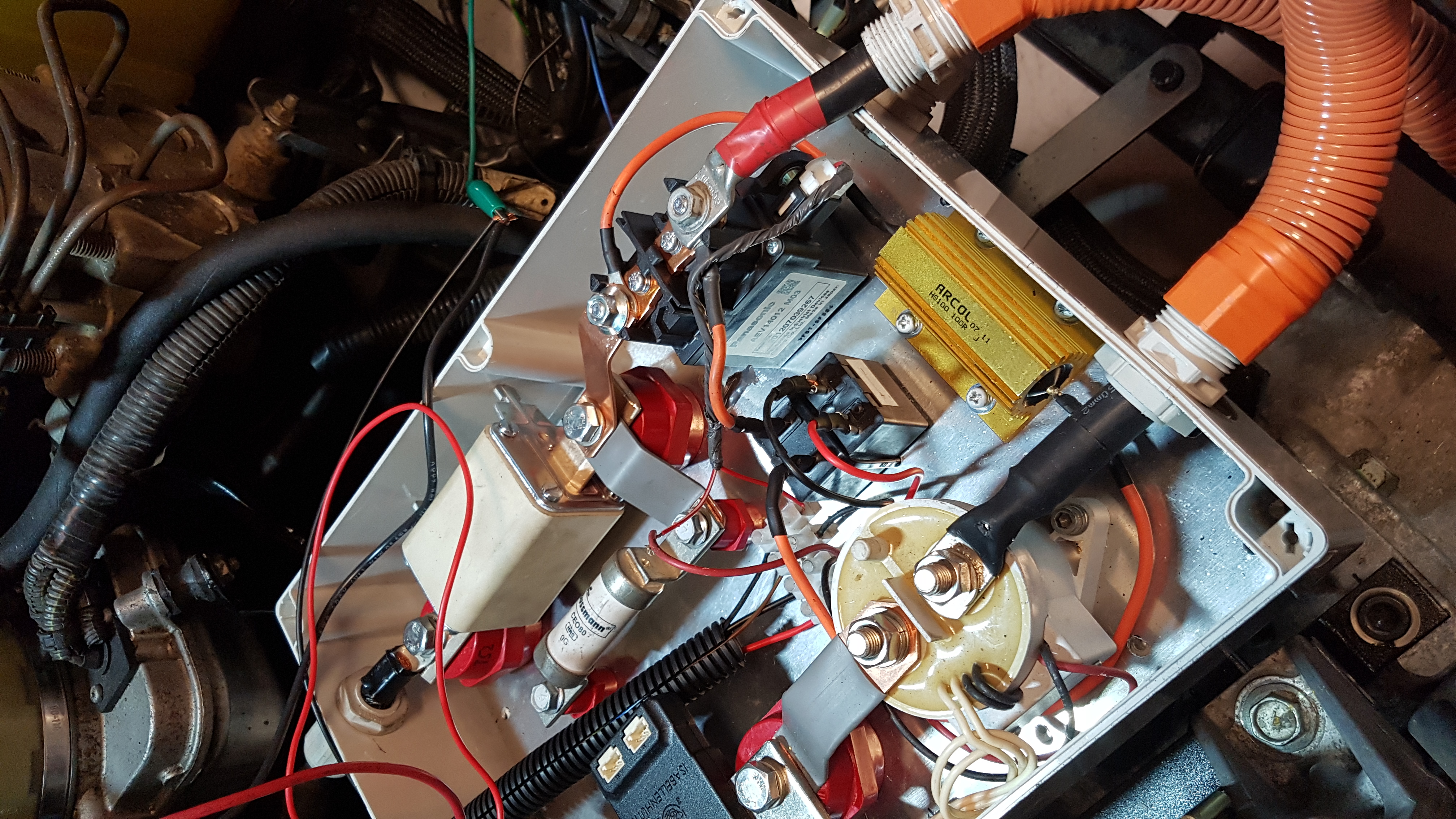

Cookie6000 wrote: Mon Aug 24, 2020 7:01 pm Just checked all three. Neg and precharge energised sit at 0 ohms. Positive... 1.5 ohms :? Not energised, Postive also exhibits variable value changes. Smoking gun?
If the positive contactor has welded closed then you will get very odd behaviour.
Can you confirm you are measuring these without anything connected to at least one of the contactor terminals? No HV connected as well? We need to ensure that you are measuring the contactor only.
If possible I would also suggest you verify the results with another meter. Very unlikely you have a meter or lead fault but it does happen and it's easier to check the results than buy a new contactor.
I also suggest you measure the value of the precharge resistor and check that the terminals on it are solid (these resistors can be damaged during soldering).
Final thought... are the inverter and motor cases securely attached to chassis ground?
I measured the contactor both in and out. When in the HVJB it measured 1.5 ohm. When I energised on the bench on its own, 0.3 ohm. Similar on another multimeter.
I swapped the suspect kilovac for the 120A Pansonic AEV14012 just which was removed from the Gen 1 Leaf charger just for this test. I changed the HV presets to 350V, connected it all up and we are back to normal and motor spinning ;)
I checked the pre charge resistor the other day and it was good from a terminal and resistance point of view. I have a good earth strap to the motor which in turn is bolted to the frame holding the inverter. I may add another strap to the base of the inverter just to be sure. On this basis, would we be right to assume it's the contactor?

Cookie6000 wrote: Mon Aug 24, 2020 9:41 pm I measured the contactor both in and out. When in the HVJB it measured 1.5 ohm. When I energised on the bench on its own, 0.3 ohm. Similar on another multimeter.
Hard to explain the difference between measurements inside and outside the HVJB. One possibility is that you had something else connected to the contactor terminal, or internal damage is impacted by movement.
It is difficult to measure low resistance accurately with cheap multimeters. It's always worth swapping the probes around to see if the readings change (this can also indicate whether you have something else influencing the measurements like an intrinsic diode or bias voltage).
Cookie6000 wrote: Mon Aug 24, 2020 9:41 pm I swapped the suspect kilovac for the 120A Pansonic AEV14012 just which was removed from the Gen 1 Leaf charger just for this test. I changed the HV presets to 350V, connected it all up and we are back to normal and motor spinning ;)
That is good news :)

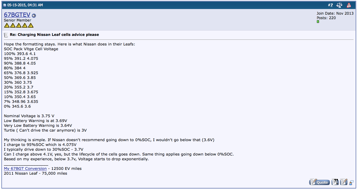

We may need to get a bit clever with the HV preset in the future. When in Turtle mode the Leaf is at 3V per celI (288V pack voltage) and if you want to charge when at that level then a HV preset at ~280V would seem appropriate.
Cookie6000 wrote: Mon Aug 24, 2020 9:41 pm I checked the pre charge resistor the other day and it was good from a terminal and resistance point of view. I have a good earth strap to the motor which in turn is bolted to the frame holding the inverter. I may add another strap to the base of the inverter just to be sure.
That all sounds good :)
Cookie6000 wrote: Mon Aug 24, 2020 9:41 pm On this basis, would we be right to assume it's the contactor?
It looks like a strong contender. What's the history of the contactor? Is it a new part from a reputable source?
Yeah, I tried the contactor with another multimeter (a little better this one ) energised it and it read 7.3 ohms. I gave it a knock off the bench, tried it again, 3.8 ohm :D
Cool. That's a great piece of info to have. Done 8-)
Used and it was one of two I bought from ebay. The ones that always are there and that orginate from Isreal. Arber got a few too from the same guys and he reckons they are all ex military kit.
Since the VCU is no longer a suspect in this investigation I may as well leave it there to concentrate on VCU centric detail but if there is anything else on this I'll put it over on my own build thread with a link to this page.
