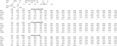

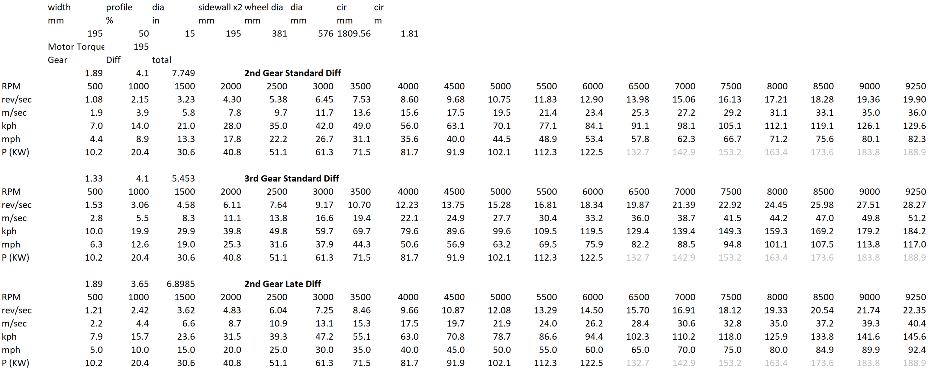

As you can see I have gone full bonkers and working out motor powers at different gears diffs!
Luckily I am using a Prius inverter so it should allow me to rev as high as I want! Assuming field weakening (hoping I don't get issues like the Lexus mgr, although not likely)
A permanent magnet motor should in theory give a fixed torque till field weakening, so assuming I can match 195nm that the OEM inverter and motor produce then I can continue this till the point of field weakening?
Edit corrected excel table
Also I realise the fixed torque till field weakening is a simplifcation an neglects that fw is always present to allow for .Reluctance torque

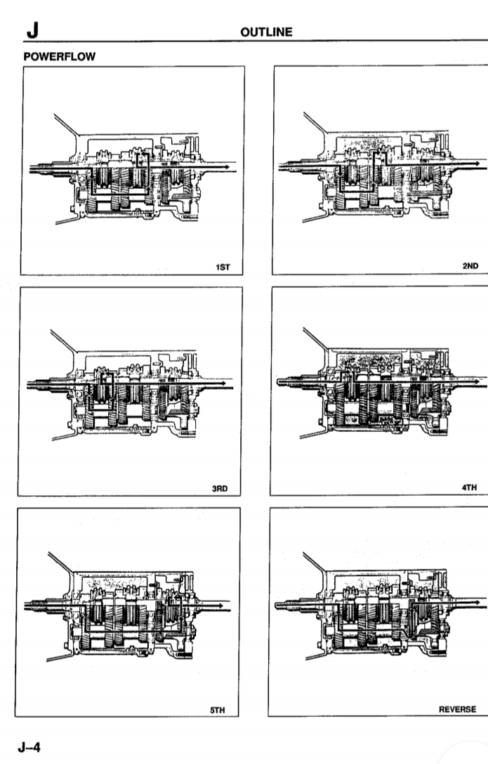

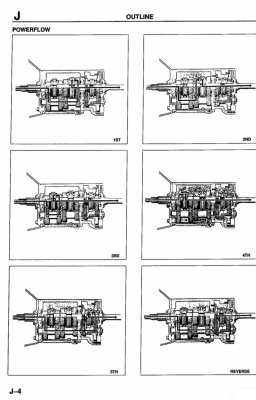

It looks like I'm going to go with a 3 speed dog-leg arrangement,
5th and reverse look like an easy gear to remove (aft section of gearbox), 1 st can be removed, 2nd & 3rd are needed, 4th doesn't actually cause any mechanical losses as it's 1:1.
Probably just put a microswitch on the clutch pedal to disable regen.
I'll add a fwd/reverse switch in the ashtray as I don't smoke it's not a major loss
Tell the better half to only drive it in 3rd to prevent confusion. Now to phone up the local scrappies to find out if they have some gearboxes
