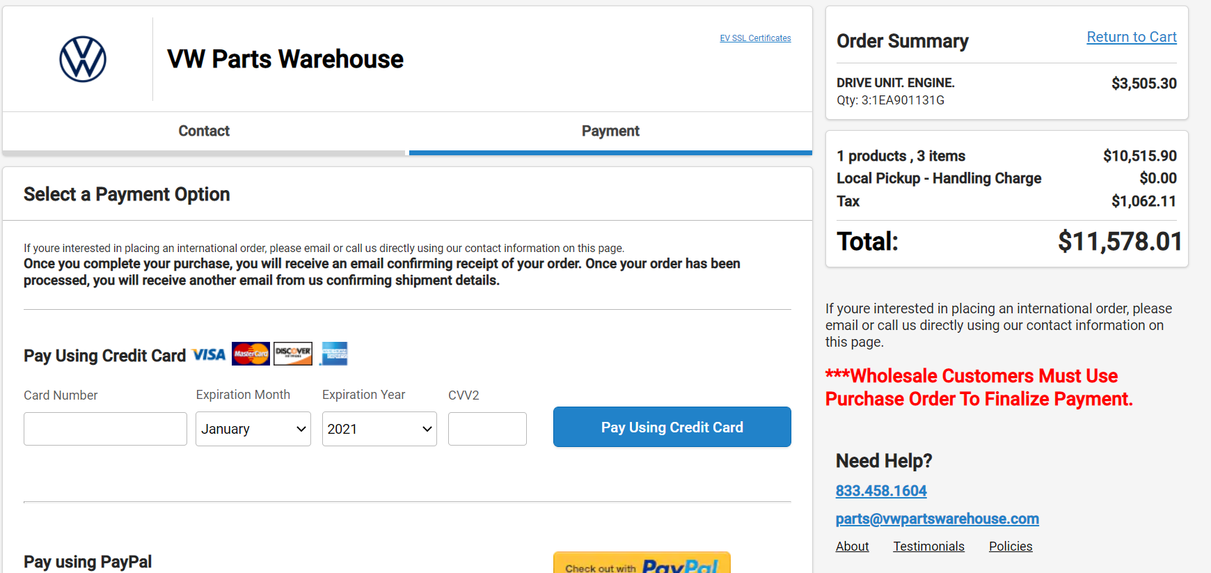

So we can just go to VW parts stores and buy brand new drive units. This is awesome!SuperV8 wrote: ↑Thu Jul 15, 2021 8:13 am ID3 & ID4 They have slight variation in HV batteries, some the same, some different part numbers/prices but the motors are identical.
ID3, ID4 & Enyaq, Q4 Etron:
Electric drive (includes motor & inverter) = 1EA901131G £2,637.72 PR:N23 (125kw 310Nm)
(motor not currently available separately)
Inverter = 1EA907121C £1090
ID4, Enyaq & Q4 Etron also has Electric drive 1EA901131F = £3,982.50 PR:N06 (150kw 310Nm)
Interestingly Same inverter = 1EA907121C £1090
https://www.vwpartswarehouse.com/p/Volk ... 1131G.html
- Posts: 3265
- Has thanked: 80 times
- Been thanked: 234 times
Re: MEB motor and inverter (ID.3, ID.4, Eniaq, etc.)
Not so fast. I am sure you need VIN from actual ID4 to access those parts.Isaac96 wrote: ↑Thu Jul 15, 2021 1:37 pm
- Posts: 656
I checked! Apparently not, they prefer a VIN 'to ensure correct fitment' but there's no issue throughout the order process. I won't actually purchase one (or three) but I got this far.

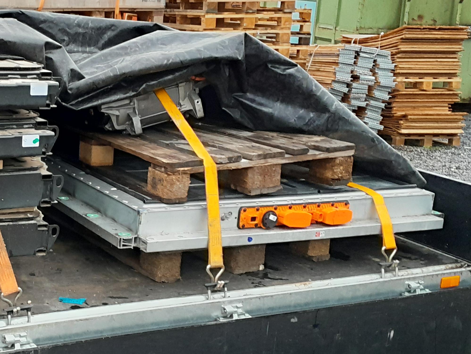

I'm getting an id.3 battery soon, and asked for a price for the propulsion parts, charger, charge port, wiring, etc.
are there any other parts of interest to also take from the car?
- Posts: 5791
- Has thanked: 157 times
- Been thanked: 1026 times
I guess anything electric. Like compressor, PTC heater. But of course the motor is most exciting (pun intended)

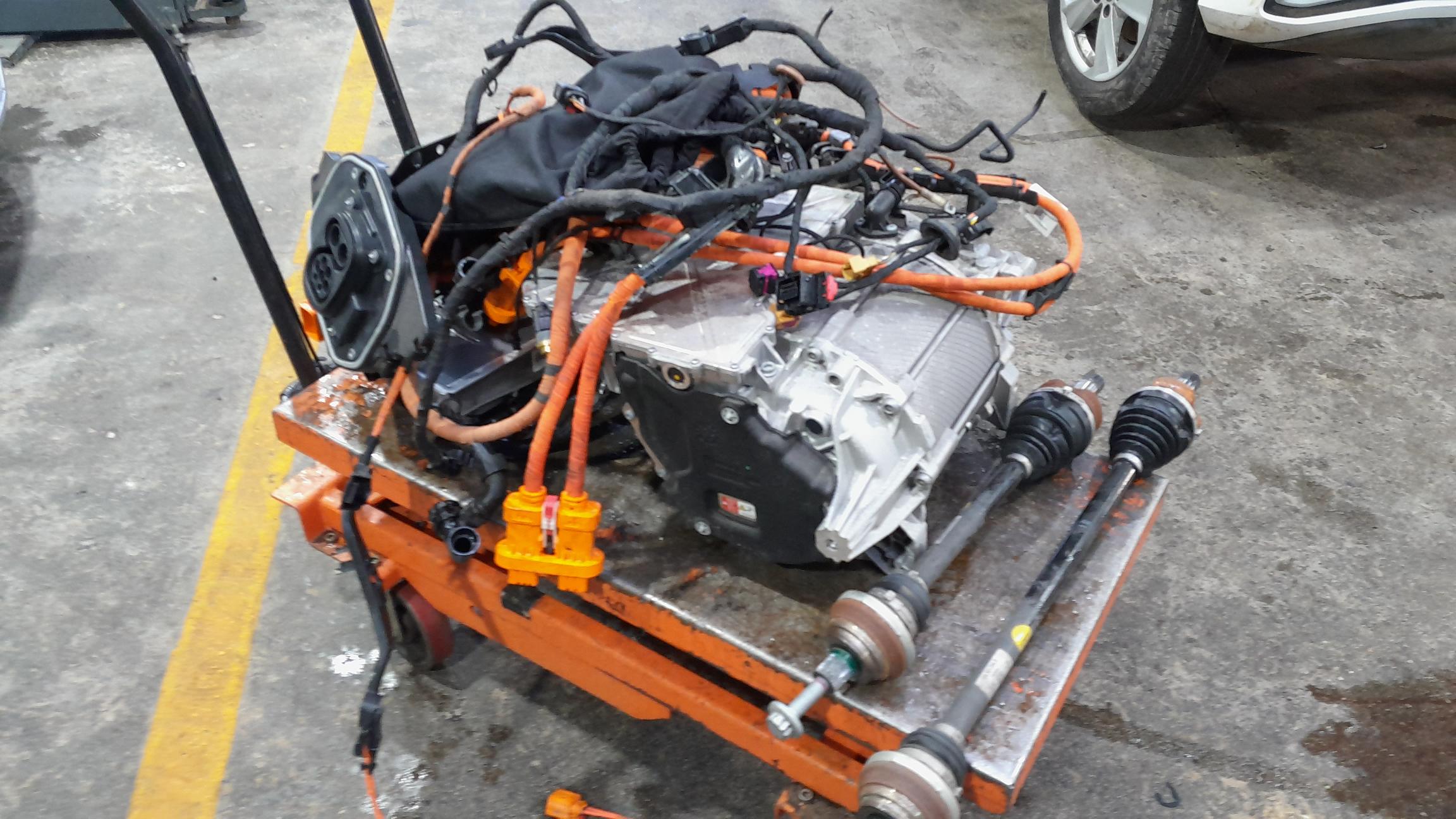

I think I have the most important parts.
no separate charge port module.
the 11 kW charger is with Tom de Bree already
- Posts: 5791
Oh nice, do you plan to work on it yourself?
I like to lie to myself and say 'yes'...
But I don't have the skills or the time, so probably best to send it to someone who can
would be great if I could use the drivetrain in boats, or others in cars (for boats, reverse must be as fast as forward)

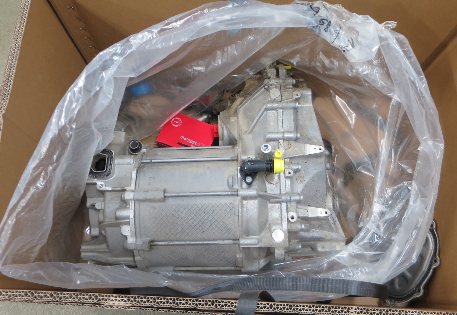

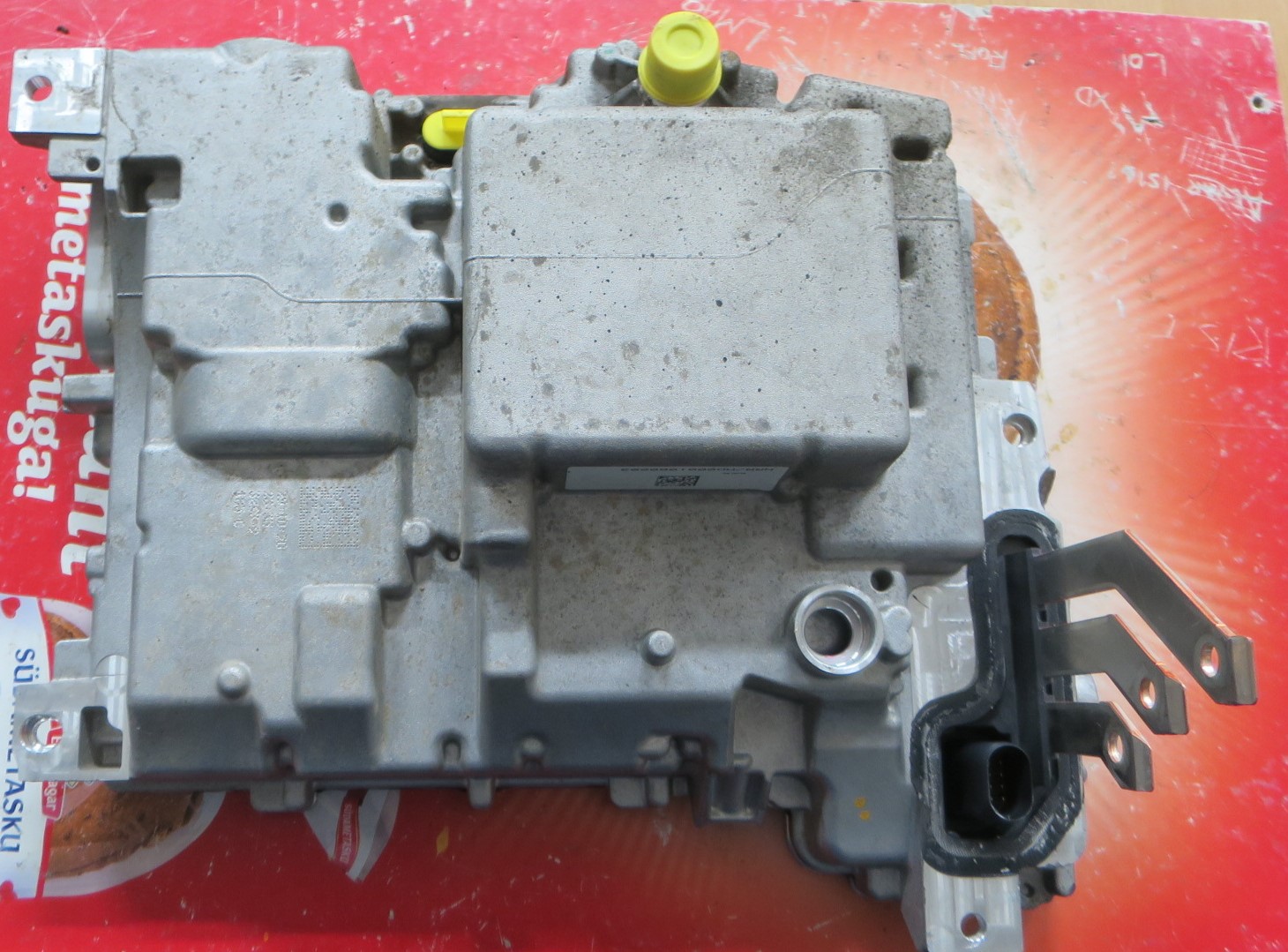

At my workplace in our Vocational school we have been donated MEB motor and inverter. Motor should be fine but inverter is not working. What solution would you recommend to get this motor turning? I know about openinverter prius inverters that can make any motor to turn but that motor should be capable of 150kW and if I understand correctly prius inverter is not. Should we try to get new original inverter? But they are not running yet outside the original car.
update: From the munro teardown video I understand that the motor coolant flows thru the inverter to the motor stator. I have to check is there long enough pipe on the motor coolant input to connect a hose there. Also my colleague said that resolver wires are also connected when inverter bolts on, nice design, isn't it?
Is the powerstage broken or not? Find out how to "fire" the powerstage is step one. What type of motor is it? Encoder type?
Johu can guide you better.
As Mr. Munro shows us the MEB inverter is nicely separated into a logic and a power PCB. It would be awesome to find the CAN commands for running the stock inverter. Otherwise it would be awesome if we could make a drop in logic PCB for it.
If you have a surplus inverter I'll happily take it and give it a shot.
I'll try to find out about the power stage. VW dealer men were very interested so they dismantled it a lot of screws as you saw from Munro video. It'is synchronous motor. Encoder is a usual resolver I believe.EV_Builder wrote: ↑Sun Jan 29, 2023 4:30 pm Is the powerstage broken or not? Find out how to "fire" the powerstage is step one. What type of motor is it? Encoder type?
Johu this inverter is not left over, I need to get this motor running so we can build with our students somekind of vehicle to have fun and learn on the way about EV-s. I searched they ask already over 600€ for this inverter in breaking yards. We have already built one electric buggy witch is equipped with last century technology.

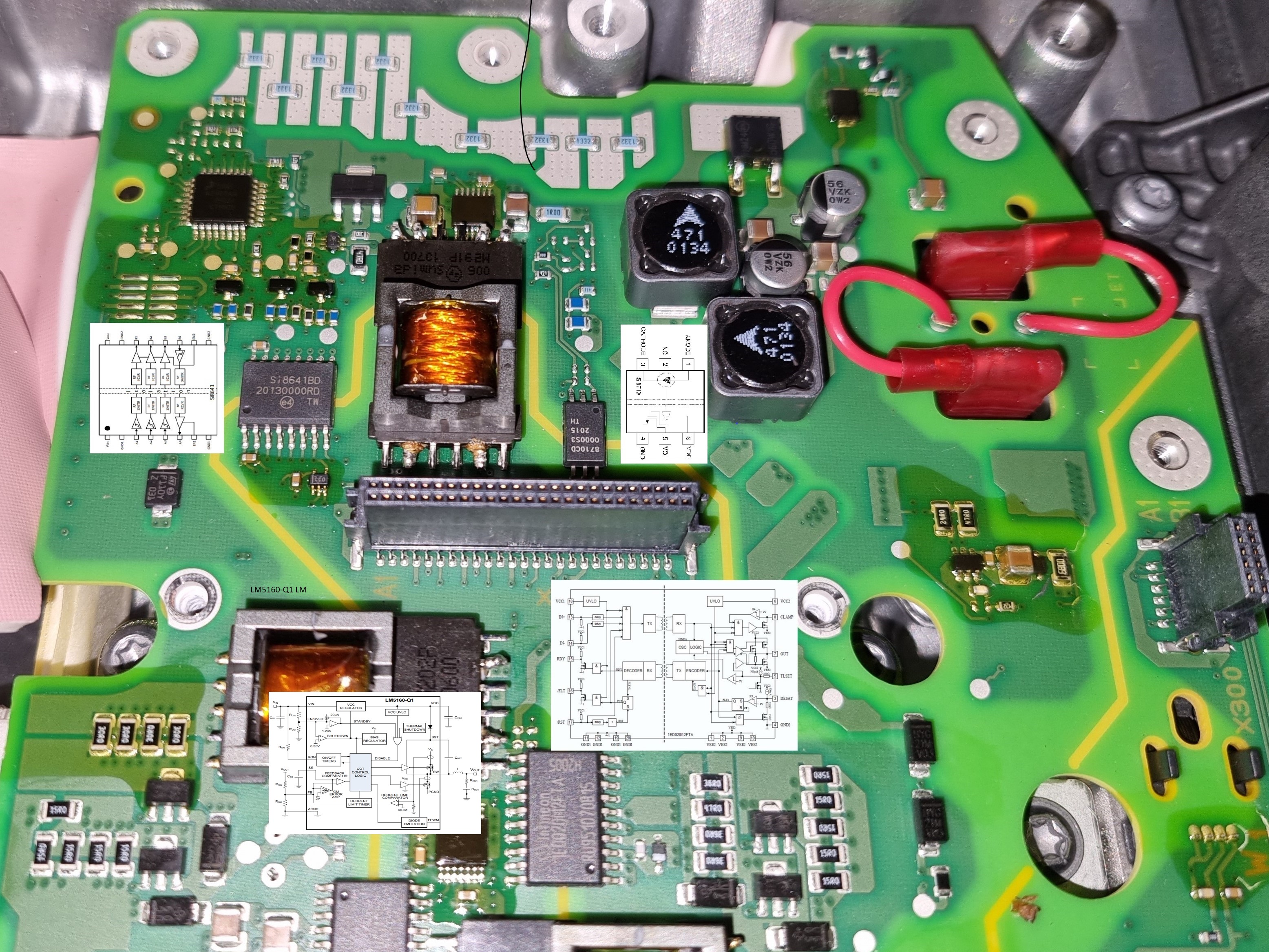

Hello,
Has a MEB motor with inverter that is installed in a Smart roadster.
After a break from trying to control an ID.3 Inverter, I now have a handle on it again.
The first attempt was to listen to the CAN traffic to the inverter, but it was overwhelming. So it has shut down.
Now the strategy is to control the power module's IGBTs with the openinverter.org Brain Board Rev 3 and to use the control board's circuits for Resolver and current measurement.
Have now measured the 50 pin connector between the control board and the power board with its galvanic transfers and which IC circuits are on the board.
The next step will be to find the signals from the resolver and the current measurement also the DC converters that feed the control board.
Picture of the power board with IC circuits. Is there anyone doing something similar?
