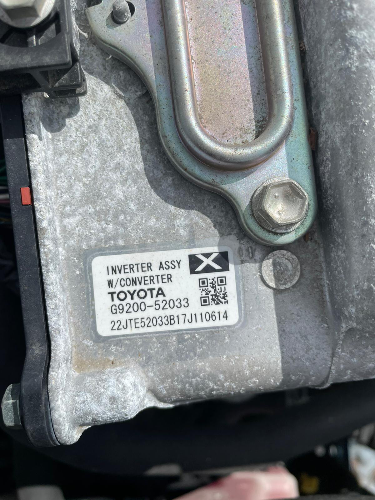

So our starting point was to blindly buy what looked like a cheap motor, a Meiden Y61 which is rated as 60 or 70kW (depending on source) and 400V AC. A lot hours on the the internet and watching of youtube revealed that it is from a Mitsubishi Outlander.
We set about trying to find an inverter which was in-expensive. We soon realised that the combination of cheap motor and inverter are difficult to come buy, it seems you get one cheaper and the one to control it costs more.
We went down the route of looking at industrial inverters and upgrading components, but the upgrades were as expensive if not more than an off the shelf industrial inverter which would have cost in the region of £5k.
It wasnt until we contacted EVBreakers and was inquiring about full drivetrains that they put us onto Damiens site EVBMW which lead us here. What a find!
So, from the information we have read here, we have purchased a Toyota Auris/Yaris inverter from EVBreakers along with data and power cables for £180 including delivery.
We believe that we can purchase Damien's controller board (https://www.evbmw.com/index.php/evbmw-w ... -board-kit) to get this working.
We are a collaboration of people working together remotely to provide a market for our fuel cells which we will gladly teach anybody (so long as you agree to terms of use). We are coming at this EV conversion with no prior knowledge other than what we can carry across from our paid jobs and past experiences, but we aim to be as open as possible so other new comers can learn from our mistakes.
Will post more as we move on, and if anybody is interested in getting involved please do!

We received our Auris/Yaris inverter board from Damien, and Alexandre Lemaire tested it and documented his test procedure (attached file)
- testing card.pdf
- (3.69 MiB) Downloaded 115 times
