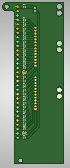

What way would the 0x401 CAN voltages map to the actual BMS boards? Row by row, or 24 values of the 32 down column 1 for module 1 BMS, then remainder of column 1 and onto column 2 for module 2, etc.
Measured all the voltages from the BMS pads and results seem ok (although low SOC overall), so want to map which ones relate to the low (red) and dummy (green) readings in 0x401.
Did wonder if the raw SPI data would have the same odd messages or if its just in the CAN conversion

At the SPI port there are always 6 values ​​from one module in a row

you can watch the SPI by using a logig analyser like this https://www.ebay.de/itm/162891933380 and Saleae Logig software. Yue can reach the pins on the underside of the opened HV controler

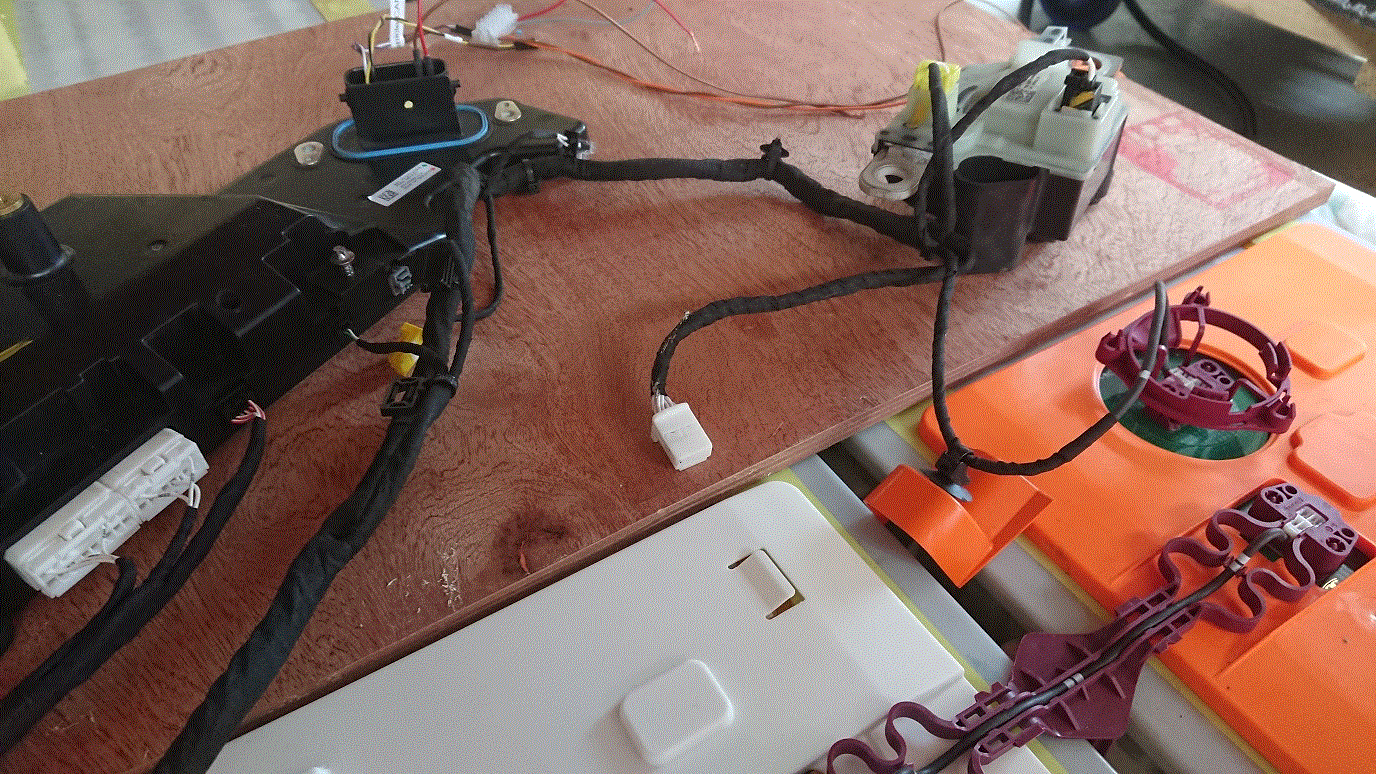

Bit of an update on the CAN logging cell voltages on the Vehicle CAN bus via 0x401. Previously I hadn't all the penthouse components connected up and the CAN logs were getting spammed with 0x70A error messages, and a number of cell blocks were missing from the logs, while other cell blocks head really low near zero readings that didn't tie up with actual measured voltages.
With Fredd90's help, I've now stopped the 0x70A spamming (most HV controller connectors, shunt and HV- and HV+ contactors have to be connected) and have some new logs. I've now got cell voltages for all 32 cell blocks (96 values) and they appear to look sensible and tie in with measured voltages.
I also found my issue with the random near zero cell readings, my own mess up. When saving the CAN logs from Savvycan and opening in excel, excel automatically removed the preceding '0's' from the hex values, distorting the true values. Correcting these by adding back in the '0' in front gives the correct values.
The second byte seems to be a 'valid' value identifier. Previously this was '2A' for valid values or '15' for generic nonsense values. Now I have a third value in the second byte, '1A'. What I noticed when filtering by '2A', I get readings for all 32 cell blocks, but only a single reading for the 32nd block and one of these was zero's like fredd90 is seeing (see image below and yellow highlighted data)
Filtering the second byte to '1A' however now shows only voltages for that last 32nd block and these look to be ok, so that means I appear to be able to read all 96 cell voltages.
Next I'll put something together in Arduino to pull out more of the relevant data to the serial monitor to save messing in excel.

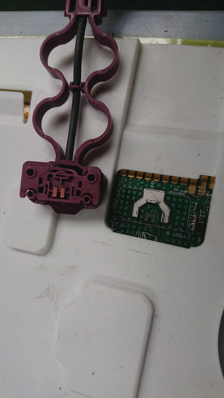

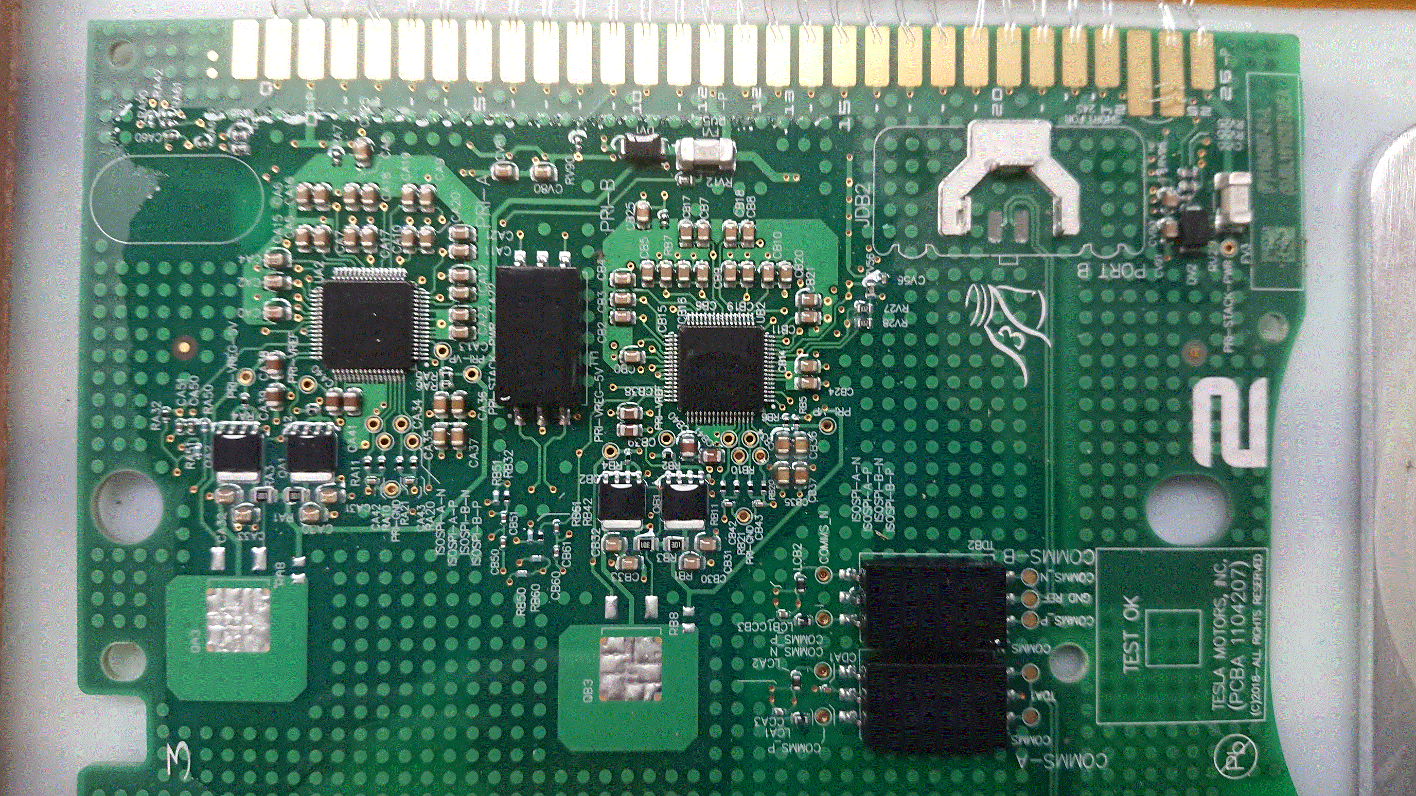

Still waiting on the SPI analyzer to arrive. Now the 0x70A spamming can be stopped, I did some more CAN captures on individual modules. What I did notice was that using the BMS plug in the round plastic ring, that normally fits to module 1, on each module separately gives a consistent stream of voltage data on 0x401 for each of the eight cell blocks for the modules.
Using the BMS plug in the plastic ring that normally fits module 4 (positive side) on both module 4 and module 3 gave sparse voltage readings and doesn't look to be transmitting all the data as good as in the test above (damaged wiring!?).
However, both tests still show voltage 3 of cell block 31 as 0V and narrowed down to module 4. Checking again at each of the pads along the BMS board shows correct voltages coming from the battery to the BMS board for all 3 voltages of all 8 cell blocks (24 values), just the BMS board only appears to be reading 23 values (maybe incorrectly reading the 23).
Looking a little closer at the module 4 BMS board and then comparing to the other three, I noticed what looks like a burnt section near the middle (circled in the photo below):
The BMS board on module 2 has a similar layout (1 and 3 are slightly different) so for comparison:
So maybe the module 4 BMS has a small failure affecting that last reading, although strange it appears 23 of the 24 values look to be working. And maybe the BMS connector in the plastic ring that normally fits to this BMS board having sparse data transfer is linked. I wondered if a crashed car setting of the pyro fuse for example may have some knock-on effect to the BMS board on the positive side of the battery (module 4) and maybe also the BMS wiring from that board. If this could be the case, there may be different levels of damage and explain fredd90's issue also. Maybe its the High Voltage Controller that gets the knock-on effect, and could be that this is where the problem lies, not the module 4 BMS.
I will try find some replacement BMS boards to test, and take a closer look at that burnt area on the board to see if there's something to repair.

Yup, you're right. Each CAN message has three voltages and three status outputs, each 2 bits.
0 (00) = should only happen if things are really dead. Otherwise you'd get one of the below three
1 (01) = this cell reading is bad
2 (10) = this cell reading is OK
3 (11) = Cell is currently bypassed (balancing?)
So, I don't have much to add except to say that there is the potential of an output of binary 11 or 3 and it does have a meaning.

Short update.
Thanks to a forum member I got hold of a spare BMS board, but before I got into removing the old BMS and starting the diagnosis of missing cell voltages, the breakers I got the battery pack at kindly agreed to replace the four modules with another set. Running the same tests on the new modules now showed up all 96 cell voltages as expected. Couldn't finish the BMS board testing as I had to return the items, so assumption is still that the BMS board was at fault.
Some Arduino work and I can now connect to either CAN bus from the HV controller and read the key CAN ID's discussed earlier.
New pack is sitting at 382.2V and everything looks in order, but interestingly the data in 0x292 which shows some info on SOC still shows the data from the previous four modules and a low SOC %. Looks like this is saved in the HV controller and must need a call from the car possibly to update for the latest info / new pack.

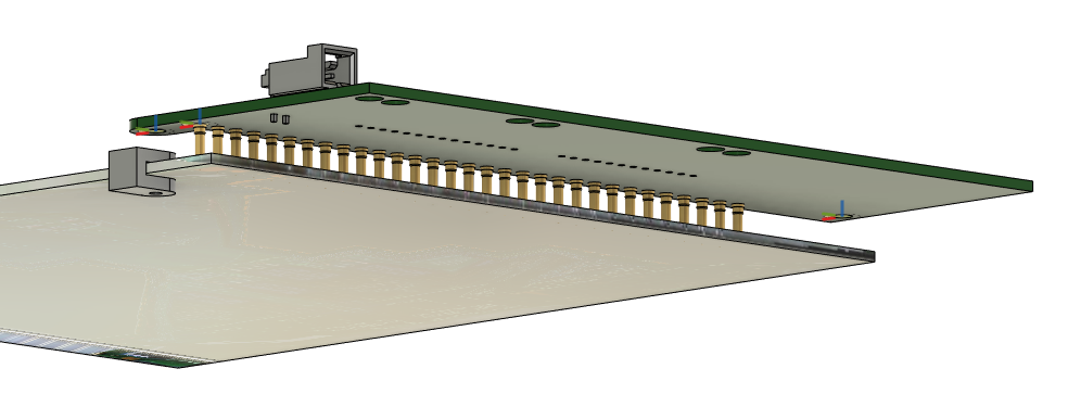

I also have these cell tap boards for anyone interested. They use pogo pings to touch onto the battery BMS boards without damaging any of the existing connections. I used them when I used the Orion BMS, but would rather get the Tesla penthouse fully functional.
