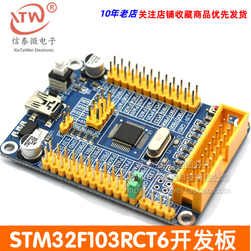

I bought a 2 submodule STM32F103RCT6, ARM; Flash: 256 KB; 72MGc; SRAM: 48KB. I think it will go

Re: STM32 woes
Yes that's probably the 256k variant. I will certainly replace the static addresses and page sizes with a dynamic one.

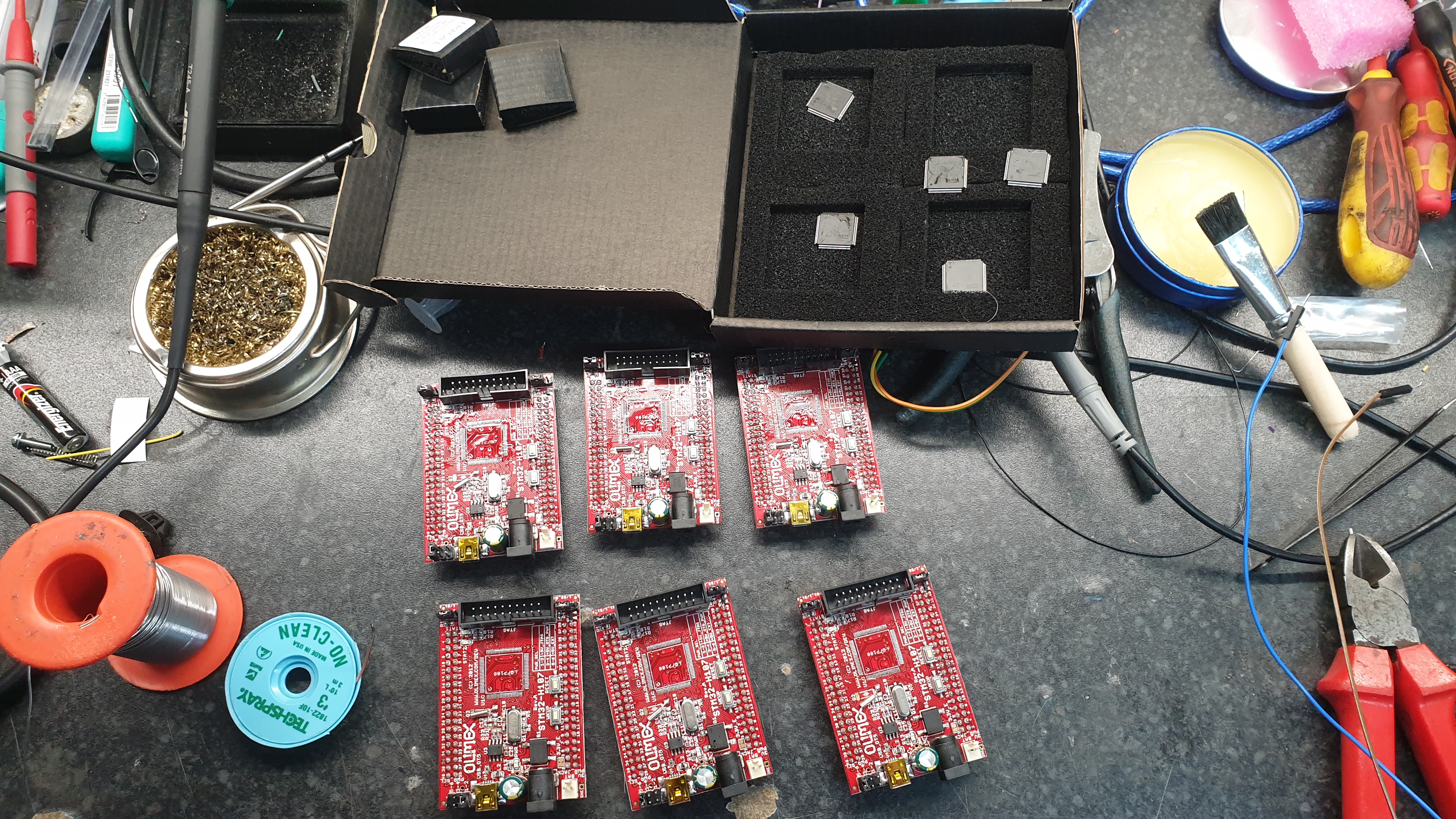

Re: STM32 woes
It's getting harder. Now JLCPCB do not stock ANY LQFP64 variant of the STM32 anymore. Neither does mouser, digikey or any other big name suppliers. I found some at an obscure Hong Kong distributor (https://www.win-source.net/stmicroelect ... bt7tr.html) and will have a local company solder them onto the otherwise populated boards. Might need to raise prices a bit.
