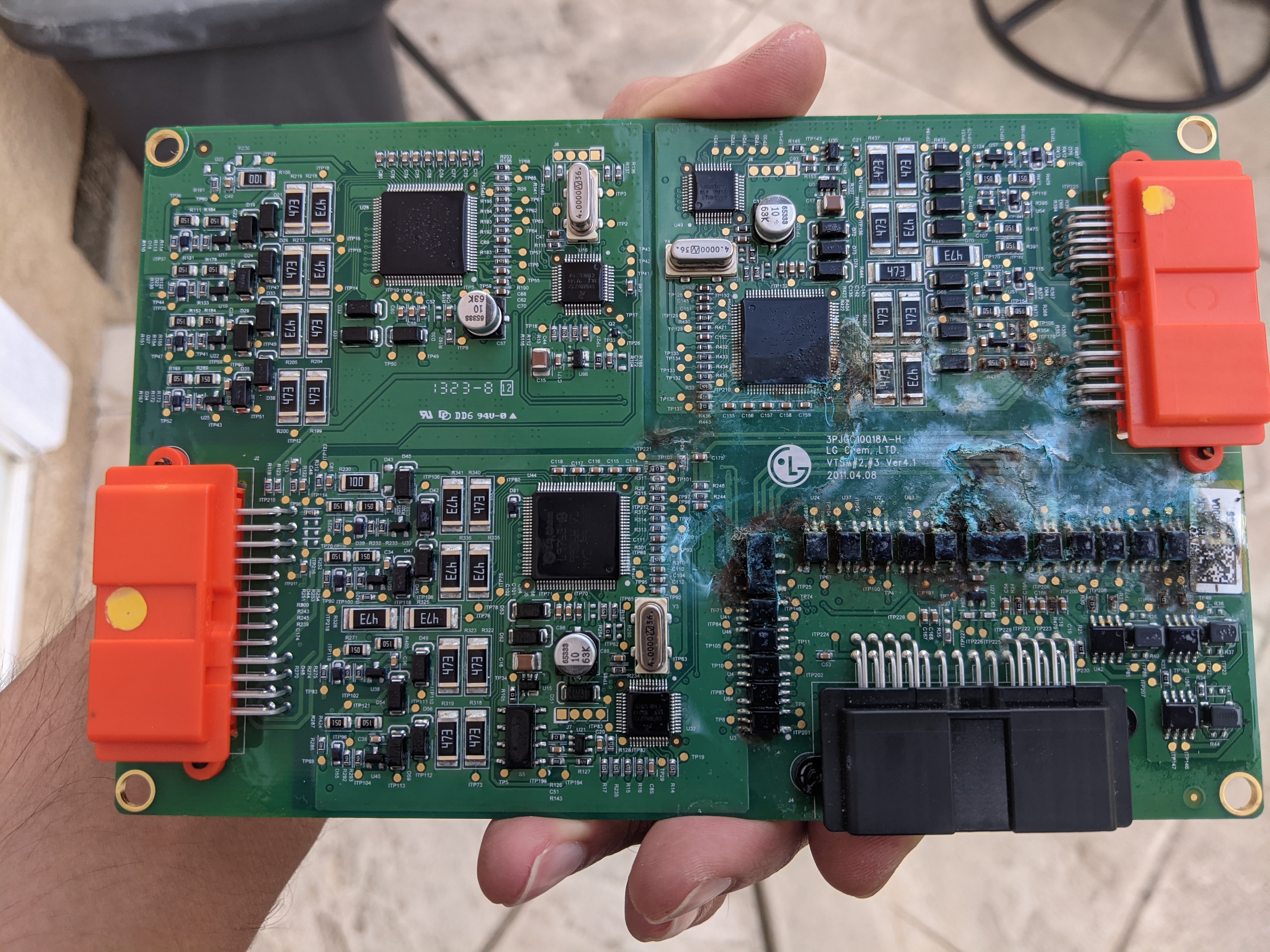

Dang... I was worried about that. I noticed that one of the slaves has a dirt ring on it as if some water was on there at some point... I'm worried that I may have gotten damaged while it was sitting at the junk yard. Is there a way where I can individually check each BMS? Something like compare the battery section voltage with the voltage reported from the individual BMS slave?

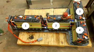

Per the attached image, when I disconnected pack 1, I got the following

Pack 3 as it only shows 8 cells but the module is monitoring more.

Nice! Now the question is how to fix it? I suppose I could try finding a bms slave somewhere? I found one on ebay, but its part number is 22911432 and mine is 22880273. I highly doubt it's a good idea to mix and match like that...
I suspect opening up that BMS to see if anything is obviously broken is also a lost cause.

I had to replace 2 slave modules with similar corrosion. One of these days I plan on potting a set.
Posts: 5789
Has thanked: 157 times
Been thanked: 1023 times
Re: SimpBMS Reading from Chevy Volt Gen 1
Seen that a lot in BMS context. I left one test system in the shed and there was a bit of water ingress. Looked similar. Water + high voltage + PCB.

johu wrote: Mon Apr 05, 2021 5:19 pm Seen that a lot in BMS context. I left one test system in the shed and there was a bit of water ingress. Looked similar. Water + high voltage + PCB.
Yeah... Looks like that's what happened here. Bummer.

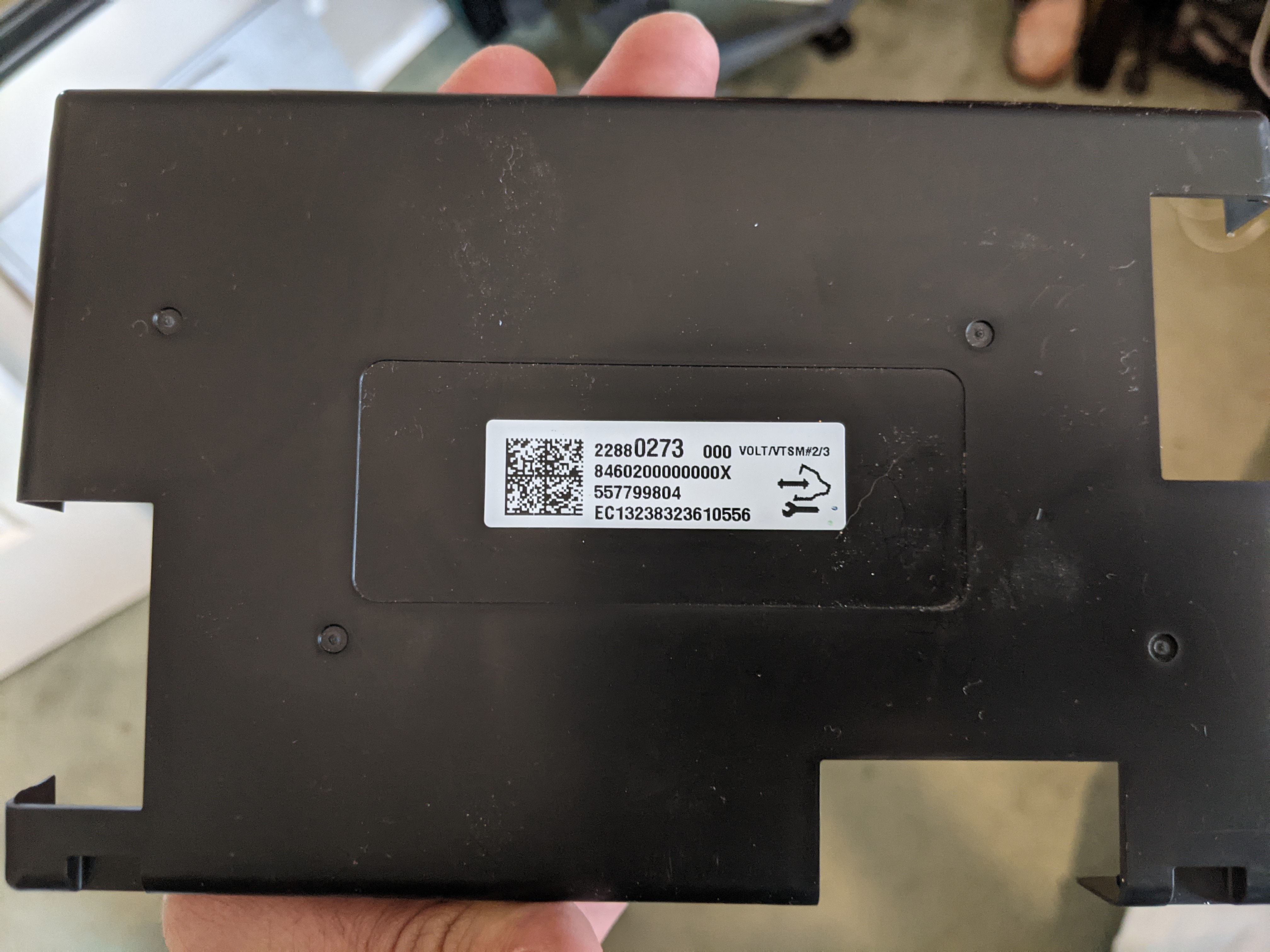

Oh nice! Ok, I'll keep an eye out for that. I found a set that has 3 of the 4 boards available, but they have a different part number of 22911432, and mine is 22880273. I assume it wouldn't be a great idea to mix and match, right?

Actually, the seller did have all four of the 2291 part numbers. Should I just go for it?

For those keeping tabs, I managed to find the BMS modules listed on Ebay. I got them in, installed them, and things look good! Reads all 96 cells, and output the same voltage that I read with a multimeter. The only thing is that the print out skips module 8, which I am guessing is why it says "series faul"? Any advice?

 Temp 1: 13.30
Module #14  21.27V  Cell-85: 3.55V  Cell-86: 3.54V  Cell-87: 3.55V  Cell-88: 3.55V  Cell-89: 3.54V  Cell-90: 3.54V
 Temp 1: 11.65
Module #15  21.26V  Cell-91: 3.54V  Cell-92: 3.54V  Cell-93: 3.54V  Cell-94: 3.54V  Cell-95: 3.54V  Cell-96: 3.55V
 Temp 1: 16.80
CANbus   0.00mA  0% SOC -240000.00mAh
   !!! Series Cells Fault !!!
Posts: 1308
Location: Bristol
Has thanked: 103 times
Been thanked: 216 times
Check your settings in the battery settings, is it set to 96 cells in series and 1 parallel string?
bobbyj_408
Posts: 88
Joined: Fri Nov 06, 2020 4:56 am
Post by bobbyj_408 »
tom91 wrote: Sun Apr 18, 2021 12:10 pm Check your settings in the battery settings, is it set to 96 cells in series and 1 parallel string?
Ahh, looks like it wasn't! Below is what I have. I'll update this and let you know how it goes.
settings.Pstrings = 1; // strings in parallel used to divide voltage of pack
settings.Scells = 12;//Cells in series
