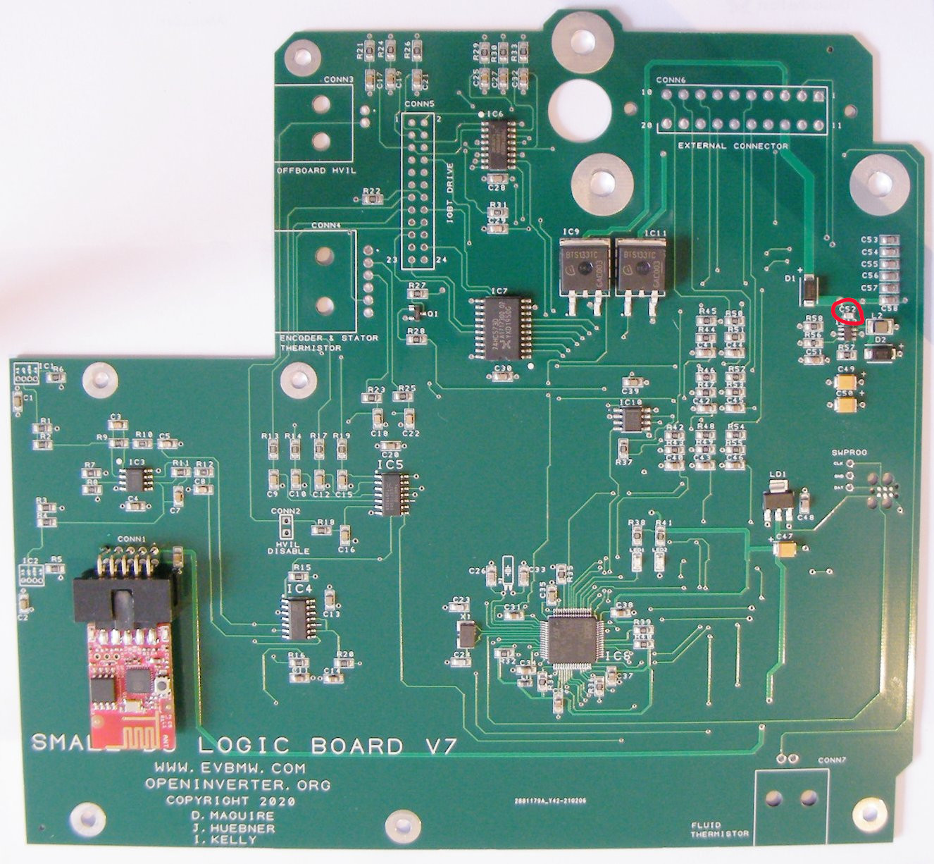

If you received a V7 Tesla SDU board from the last batch, there is one capacitor with a wrong value. Apparently it doesn't affect functionality despite being way out of spec. I very much recommend replacing it.
See attachment. Replace C52 (currently 22pF) by a capacitor between 10 and 100 nF.
There is a total of 5 boards circulating.
Sorry about this and let me know if I can cheer you up with some compensation.

Well that's another screwup on my part... sorry! LDU has a 22nf part in design and BOM so that should be fine.
-Isaac
