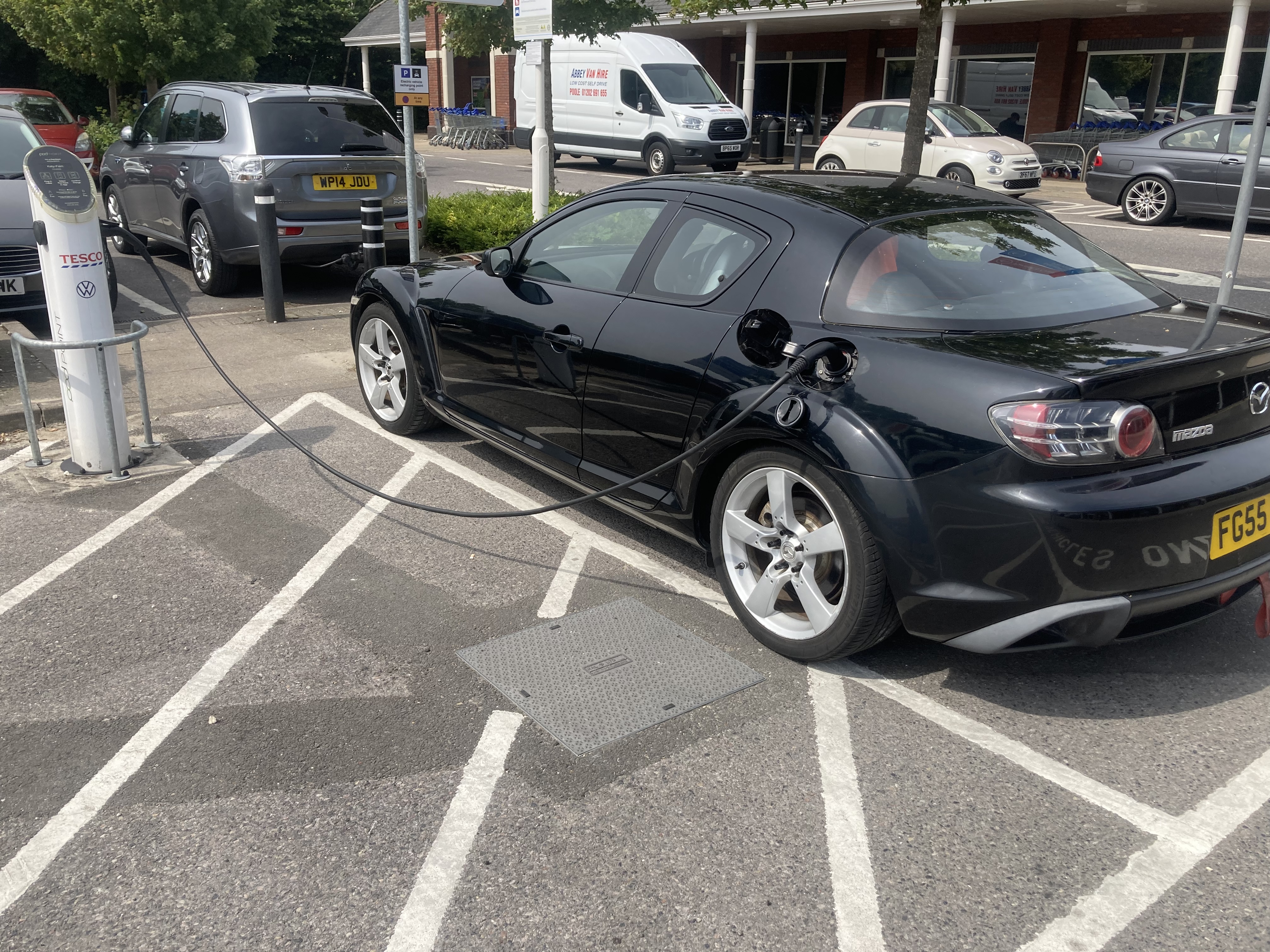

Ok so turns out range is more like 40miles the way I drive, unfortunately I ran out of charge and stupidly tried limping the few miles home, eventually had to stop and get a friend to give me a tow :( hopefully I’ve not done major damage to the battery but I did have some cells go under minimum voltage, and ended up with a large delta, it charged up ok without any sign of the modules getting over hot, I’m just scared I’ve wrecked if and now charging whenever I can, to this end I decided to install the type2 socket I had so I can use public charging points, albeit only with my tiny 3.3kw obc.
Tested with some free electricity from my local Tesco supermarket
Posts: 898
Has thanked: 291 times
Been thanked: 177 times
Re: Budget RX8 build Prius gen2 DC
Post by MattsAwesomeStuff »
550Wh/mile.
Not great efficiency, no. However, you were going 80mph, so, you're well up into the cubed power draw dominating your power reqs.

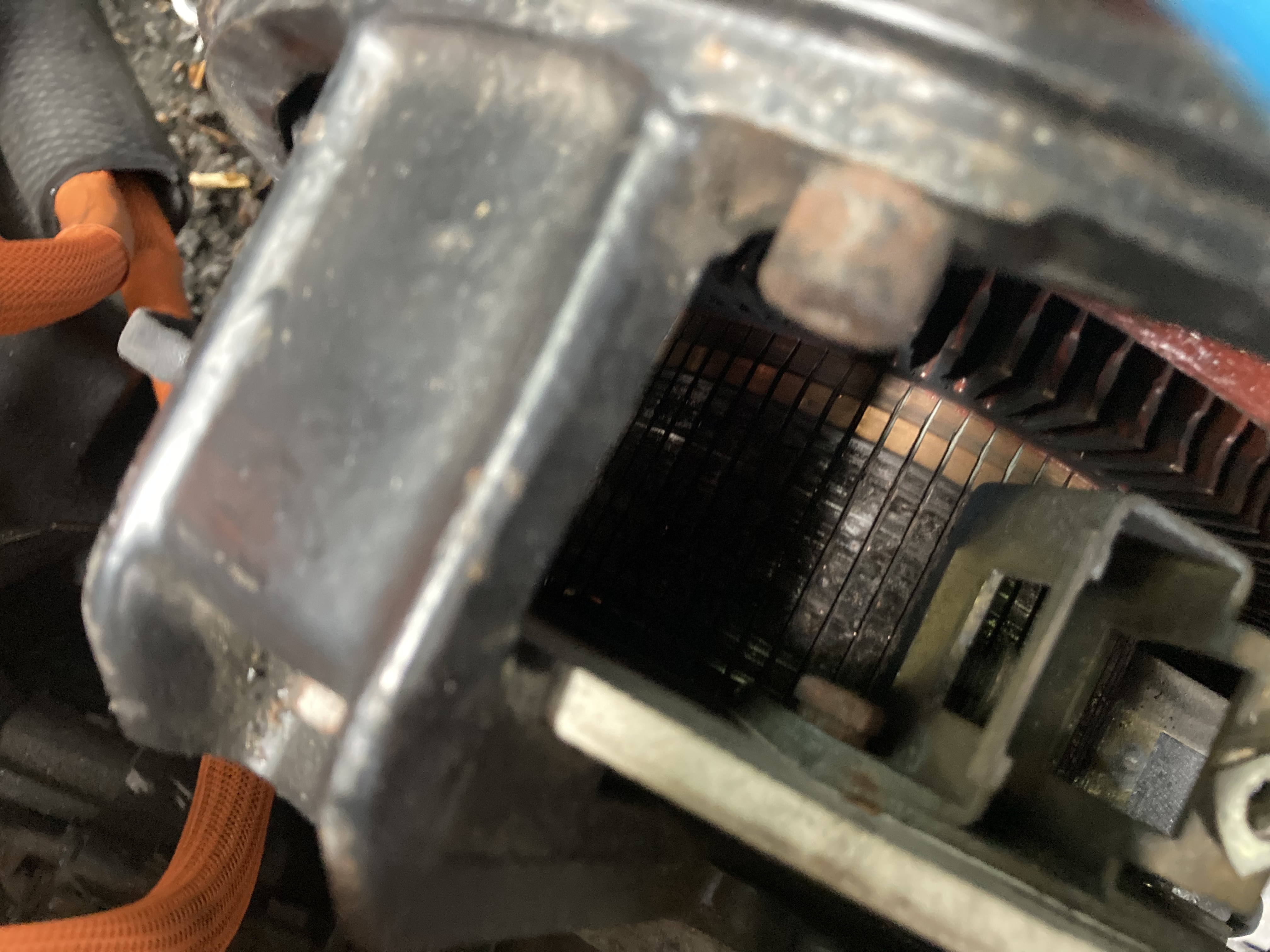

Well I guess my motor doesn’t like 1000 amps and 200 volts after all.
Tbh feeling pretty shit about the whole thing and considering pulling the whole thing apart and selling what’s left rather than throwing motor time and money at it to convert to AC
Posts: 3265
Has thanked: 80 times
Been thanked: 234 times
Ev8 wrote: Wed Jul 28, 2021 11:24 am Well I guess my motor doesn’t like 1000 amps and 200 volts after all.
Thats the problem of all DC motors.
No need to give up as now you have HV in the car allready.
You can get Nissan Leaf motor and put it to your gearbox.
Even with 200Vdc it should give plenty of power at low speed. If you go to 400V you will burn out rubber.
Your Inverter works. You just need to make it 3phase again.

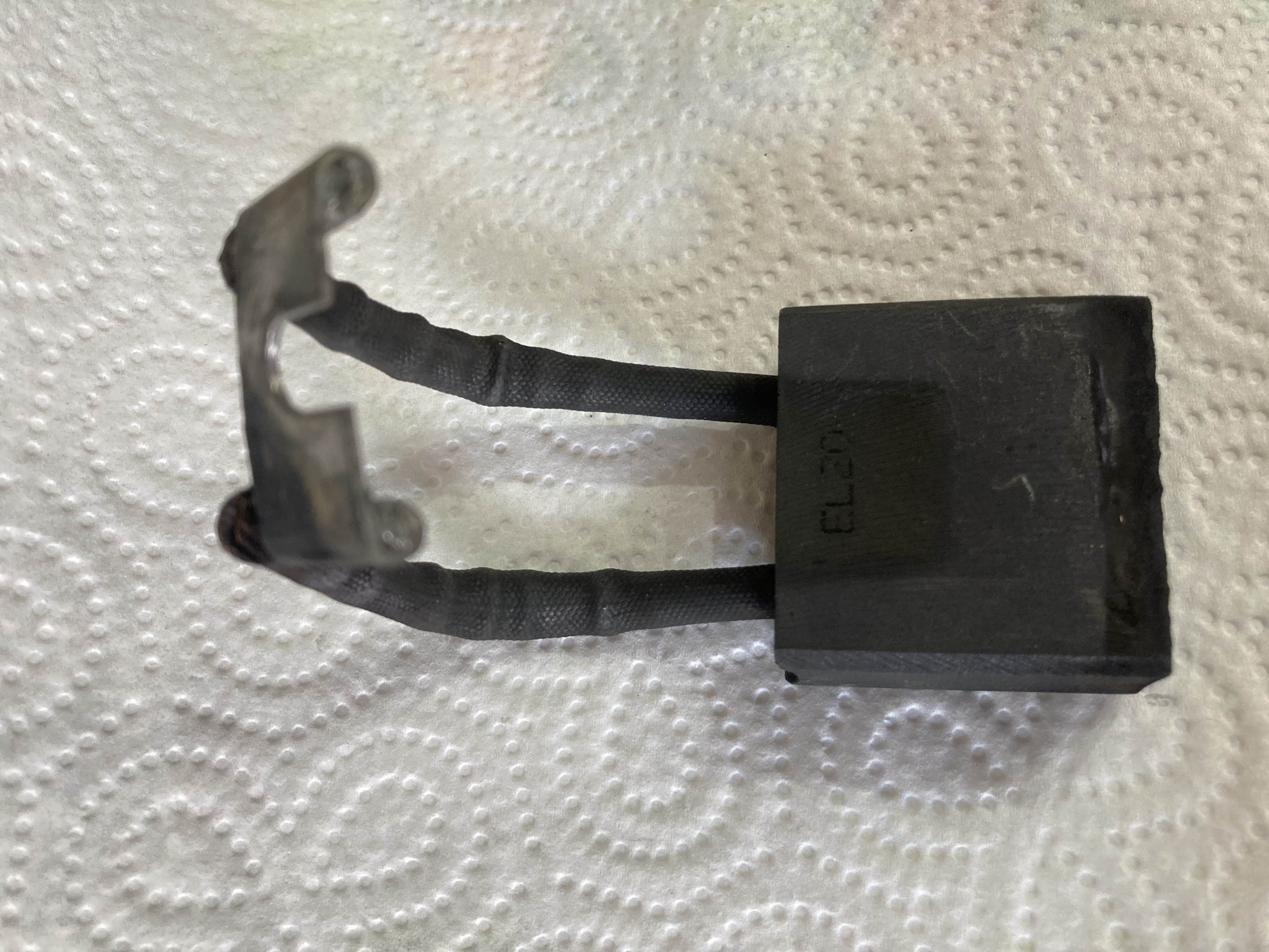

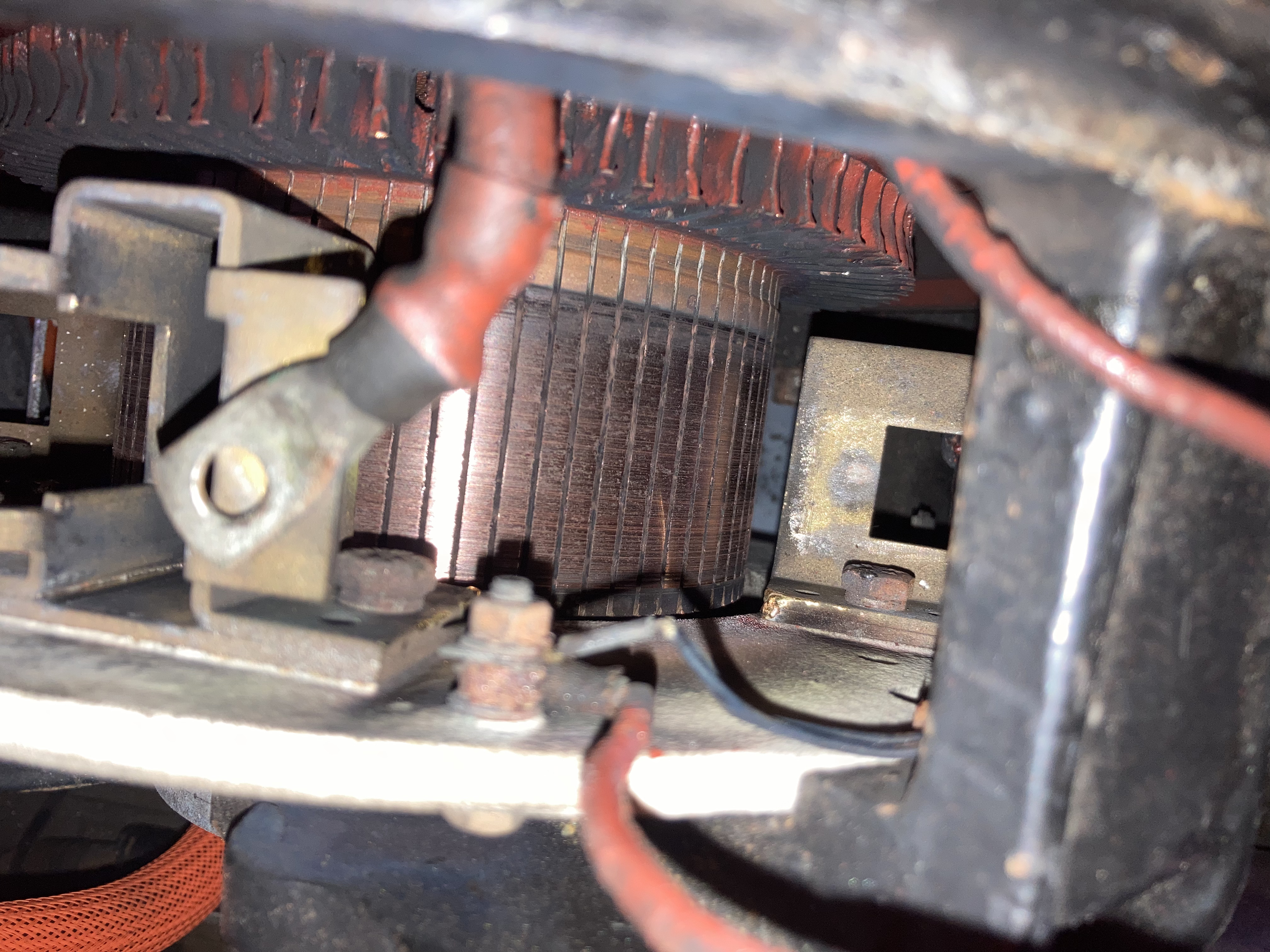

I have temporary resurrected the dc motor, after cleaning the commutator with a couple of blocks I made that slot in in place of the brushes with 800grit paper on the ends, turns out it was mostly carbon and not much damage. Resurfaced the brushes and repaired the brush retainers with new springs, also found and replaced a crimp on one of the wires feeding the brushes that had burnt off!
I’ve re run in the brushes and added about 10 degrees of advance, also adjusted software to be much more conservative, read less fun, but it’ll keep the car on the road while I work on my next motor arrangement
