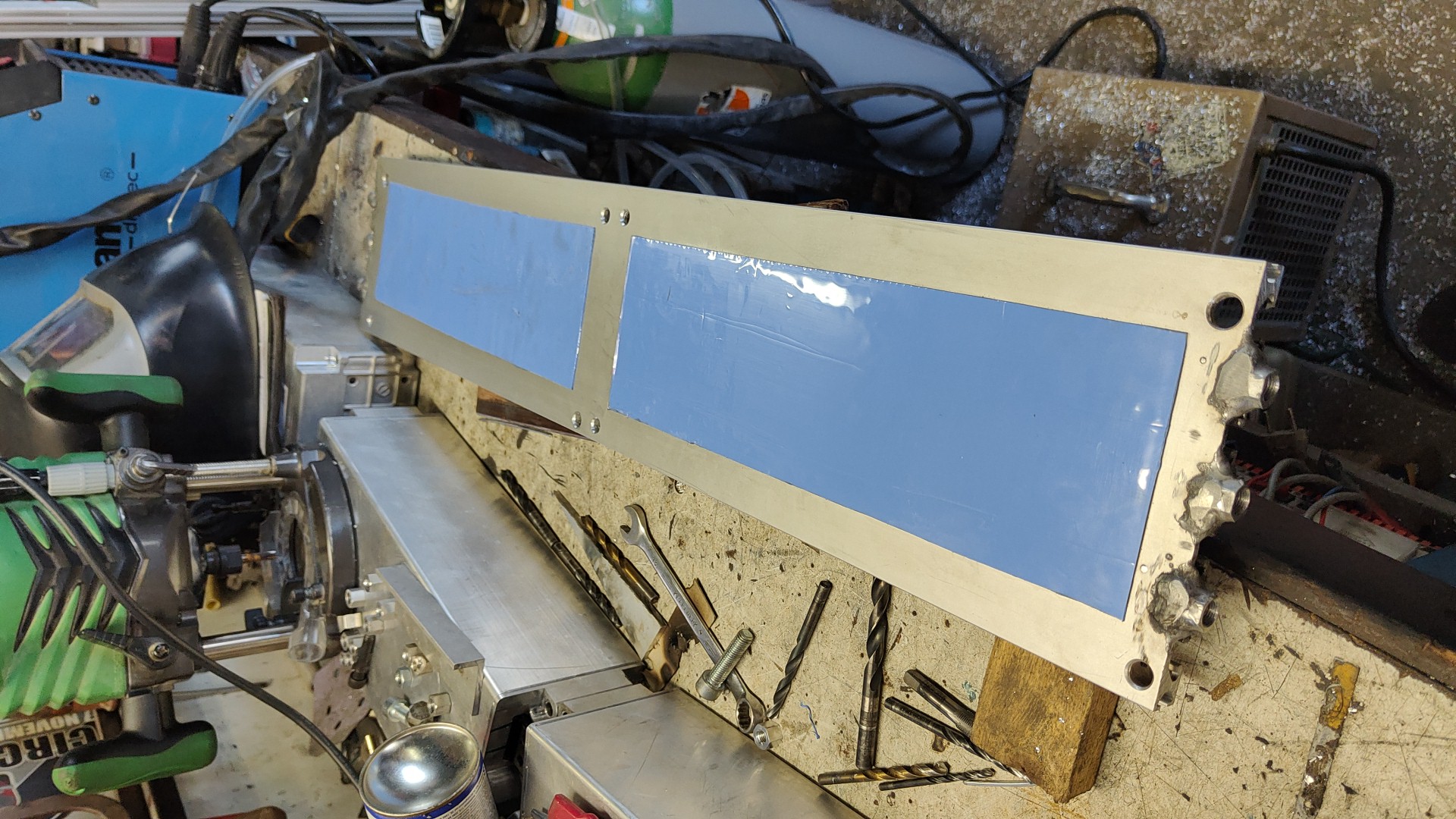

I do not know what works for you mechanically, but for uniform temperature along the cooling element, I would make a Y-pipe to connect the inlet to the two outer extrusion cavities and then route the coolant with another Y-pipe to the center and back. This way the cold inlet flow will "mix" with the hot return flow and result in a very small temperature gradient along the element.

Yeah I think I need to experiment with it.
The coolest option is one side in 3x en other side 3x out.
This tunnel pack will be 2x5 modules and a smaller plate of 2 at the front. 12 modules total. Good for 33.6kwh.
"I finished" the smaller plate and refined the construction process...
P.s. not my best welding while experimenting with the settings, but it's water tight.

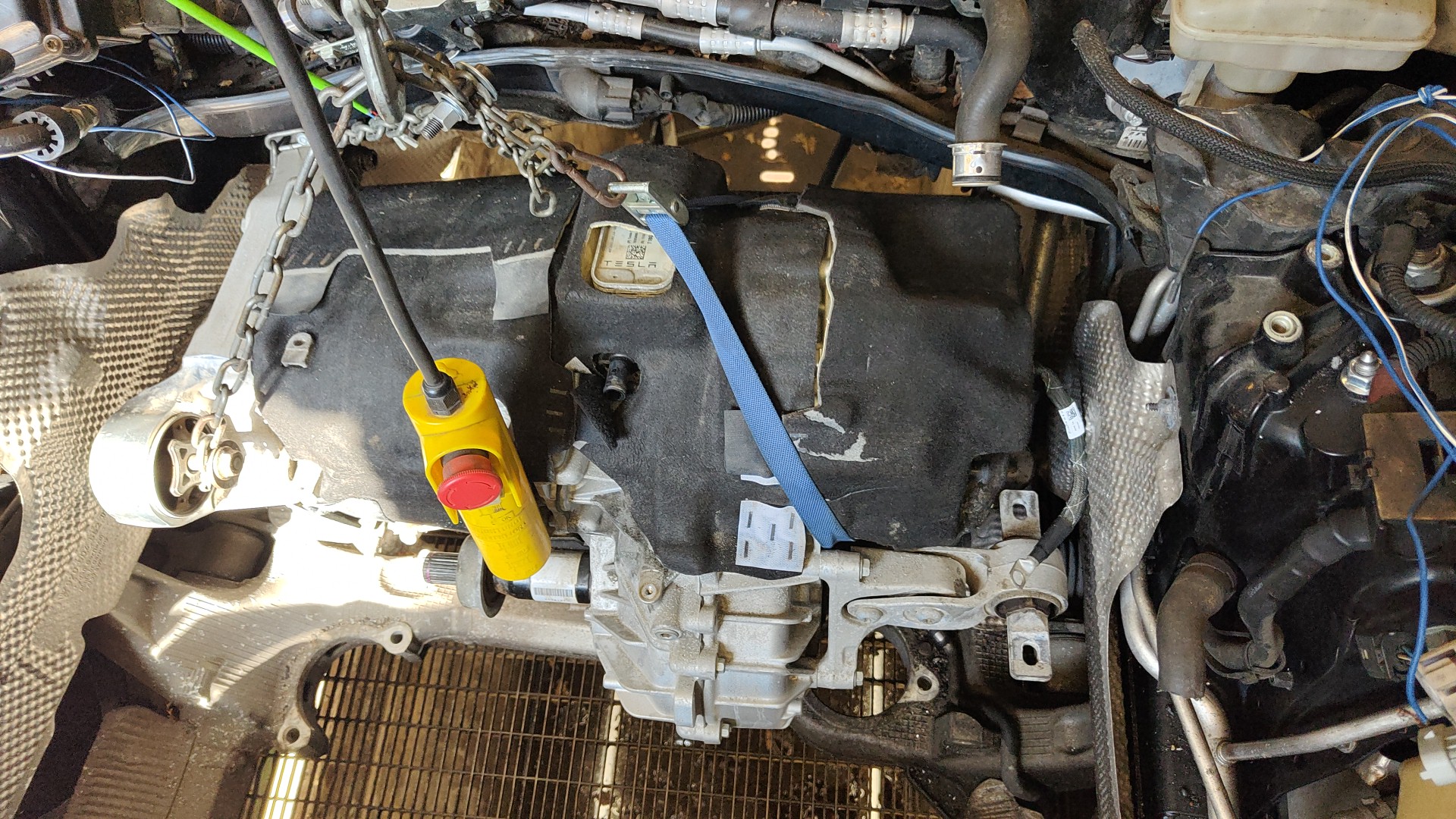

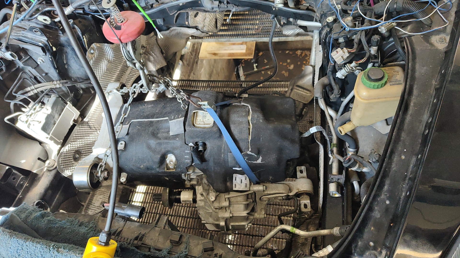

In orde to know the space I have in the tunnel for the pack. I bit the bullit and bought a front engine too.
Will they say YES to each other?!?

Big puzzel; yesterday cut of some foam to get an idea about size and fitments. To ditch the AWD or not ditch it.
Would one SDU be capable anyway todo 120km/h continuously?
