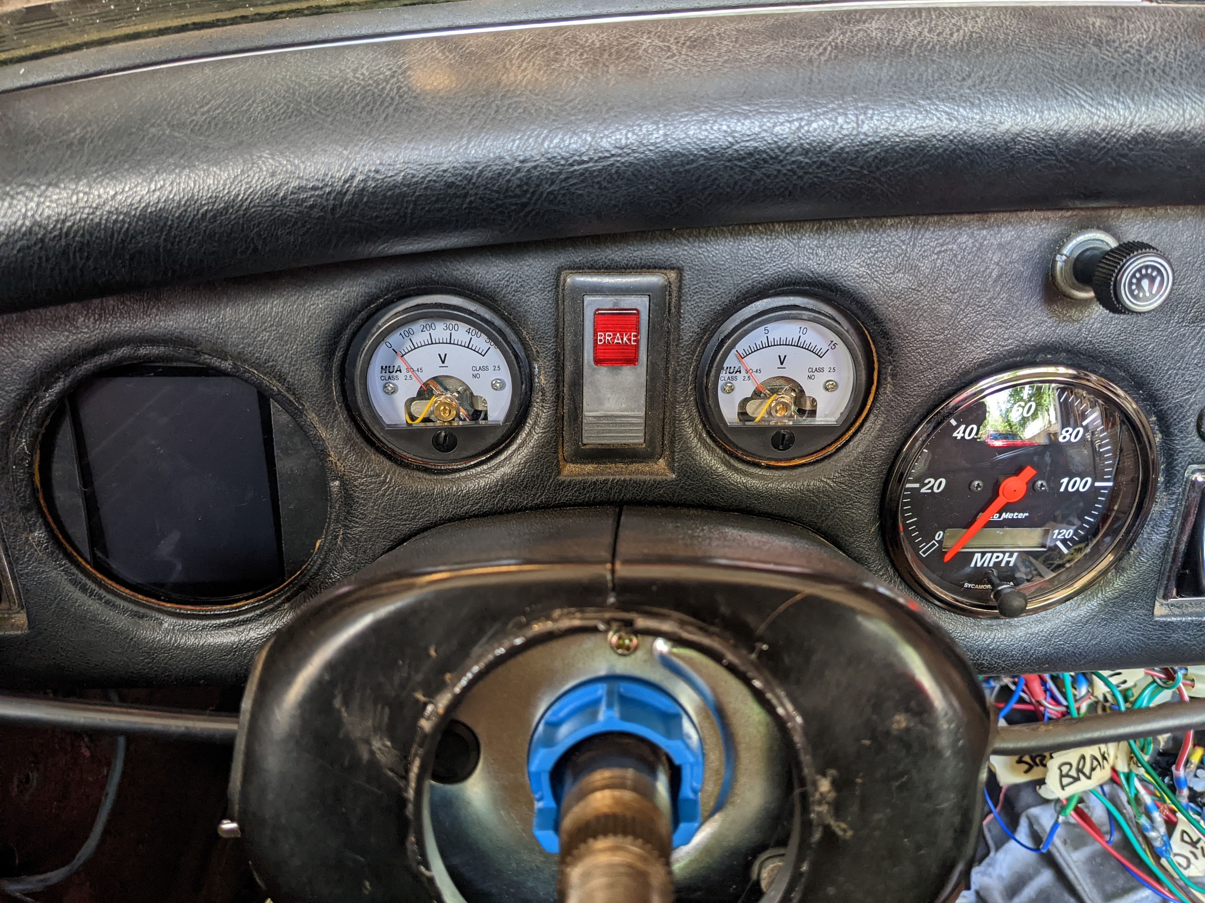

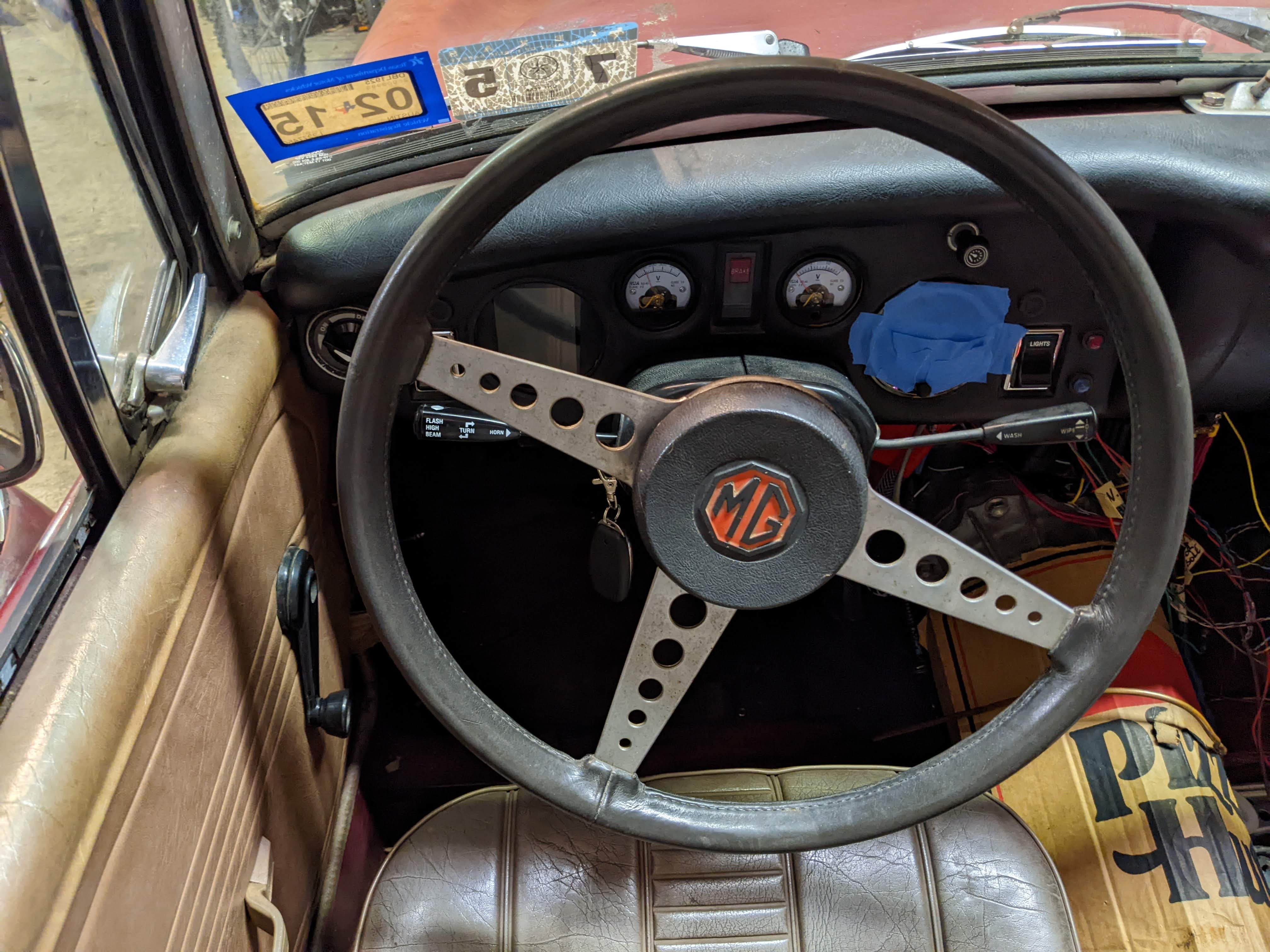

Re: 1979 MG Midget with GS450h and custom battery pack

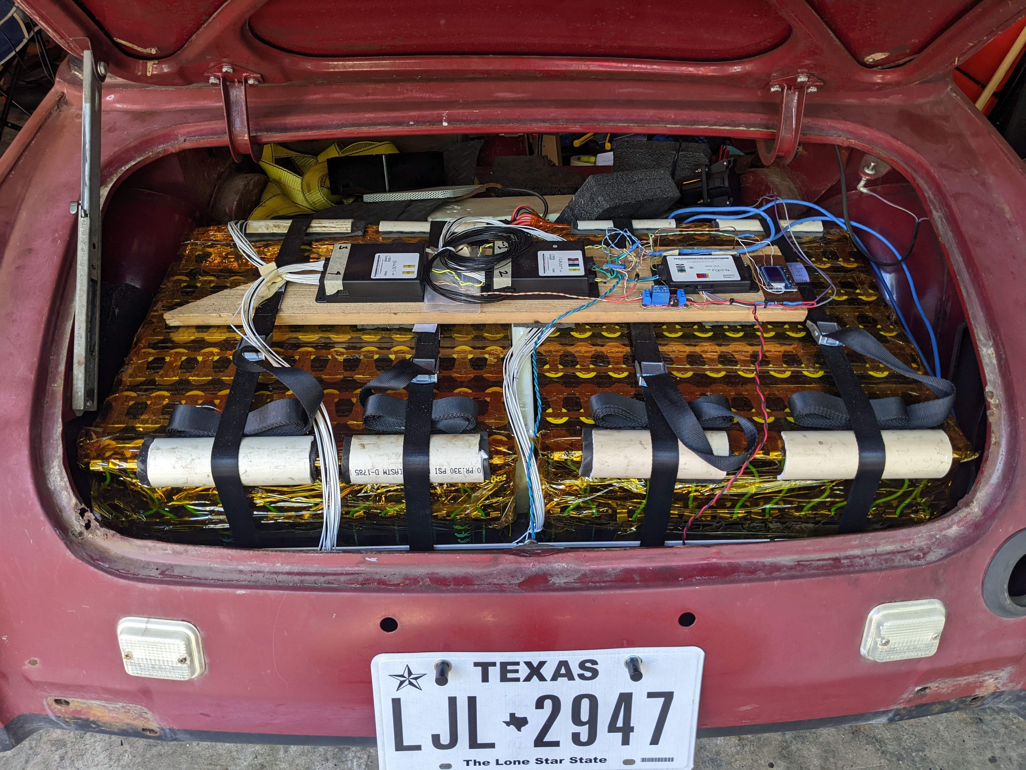

A quick update. Dash is back in with new gauges and all lights working. Turn signals, headlights, hazards, parking, license plate, etc. all good to go. Next steps is center console and some relays to force driver to put system in Park and depress brake to place in Drive. Reverse will be called up by pushing the windshield washer function on the right stalk. Pics attached. Gauges from left to right: Thunderstruck/Dilithium BMS display screen, 500v meter, 15v meter, AutoMeter electronic speedo coming right off the pulse pin of the 450h trans.
Video tour to come after console is built.

Can I ask, does the regen work with your inverter and VCU board. If so, how does the GS inverter know what voltage to use to charge your battery?
Do you have the program the VCU with your specific battery data or does the inverter just magically know?
- ggeter
- Posts: 133
- Location: Houston, TX
- Has thanked: 4 times
- Been thanked: 15 times
Regen works great. But, I did not change anything in the code on Damien's VCU board. When I let off the throttle, the torque absorbed by MG2 just routes power back through the inveter to the batteries. And the voltmeter doesn't show a spike. I may be doing it wrong, but I can push 50+ amps to the batteries when coasting from 40mph.

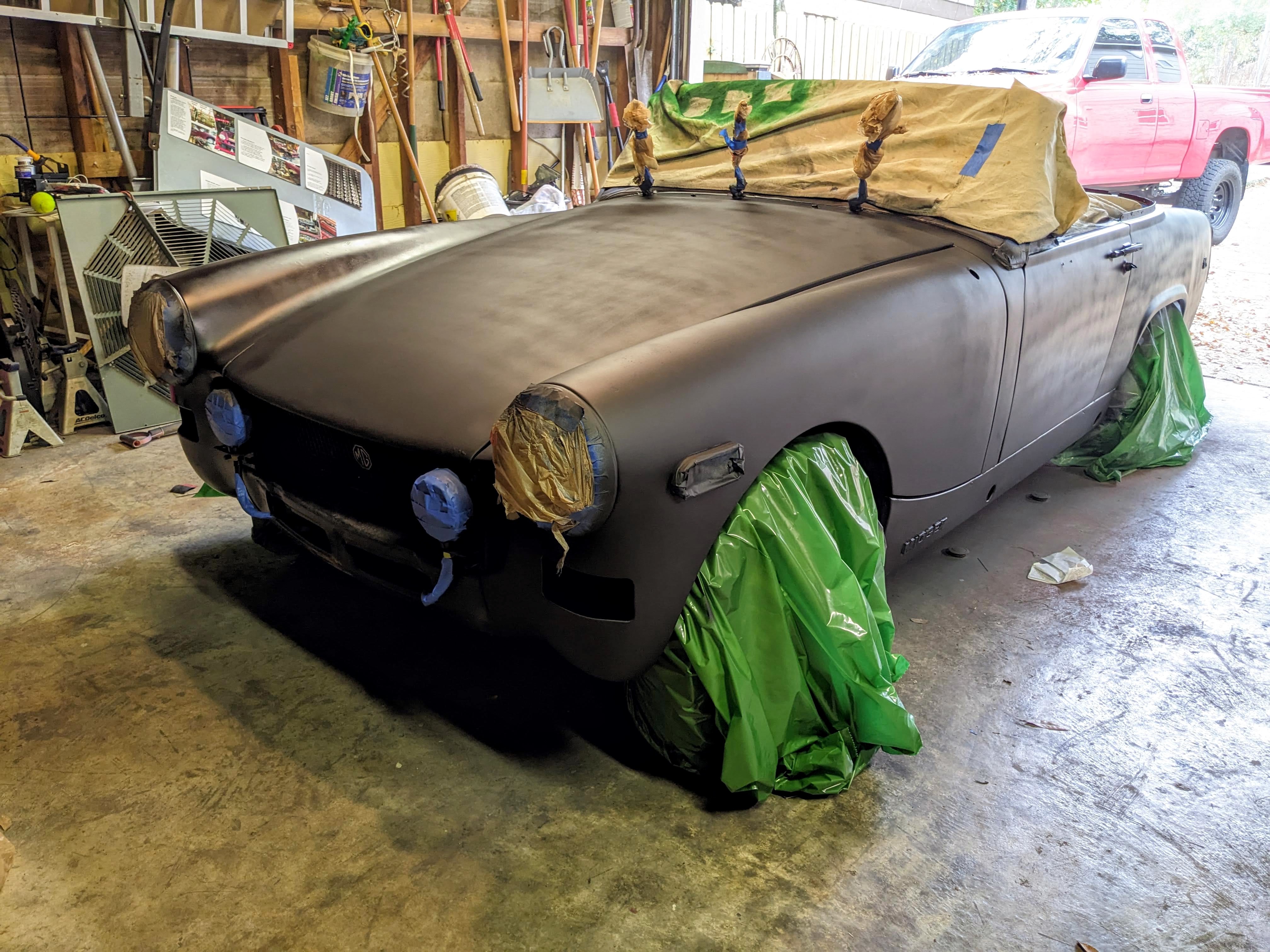

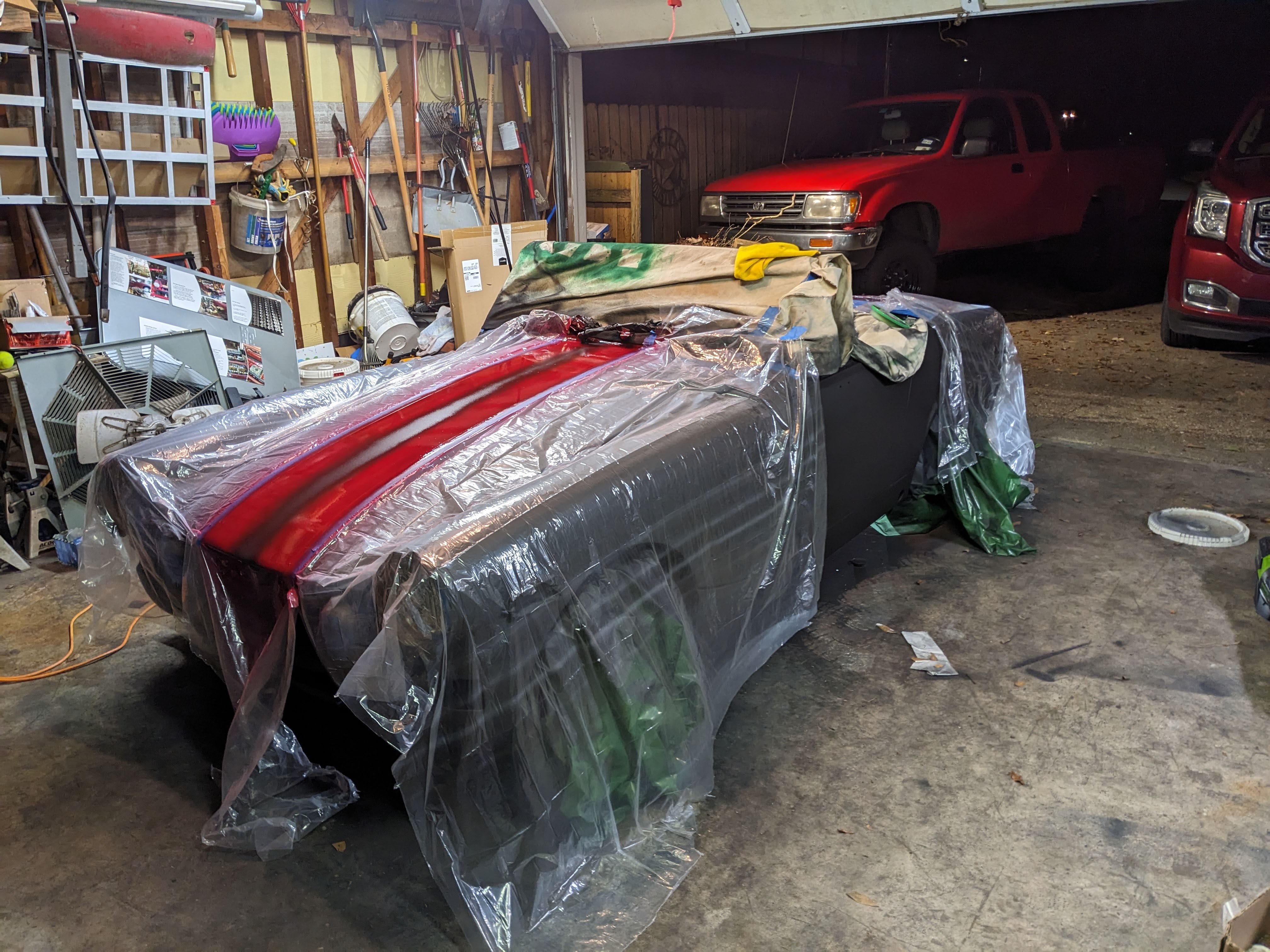

NEW PICS --
Rust-o-leum paint job complete. Officially 2 full years since I started work on the car.
Love it. Looking sharp!
omg, LOVE the paint! If you're ever in Austin and want to talk about the GS450h set up, give me a shout.
Love this paint job. Looks amazing!
Yes, you wire directly into the inverter with whatever volts you have without using the boost side of the inverter.
