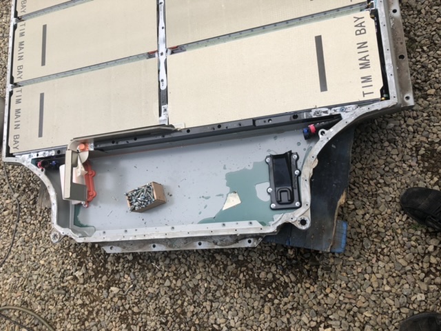

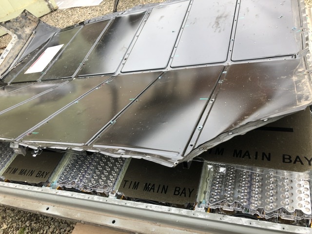

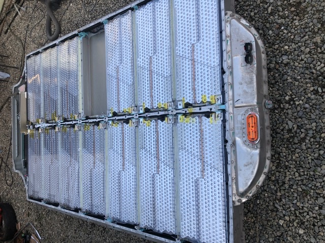

Got the pack open and removed all the modules over the weekend
Firstly removed the fire-resistant cover to expose the bolts
Unbolted, pryed-up and removed the end cover, where the 2 extra modules for an 85-pack would be
Drained elon elixir by firing air in one end and coolant came out the other. Then unbolted the rest and peeled up the cover to expose the modules Noticed the top module us only a 5s not a 6s like all of the other modules, after some Googling it appears all 75-packs made after sometime in 2017 are like this, cant think why. Going to reuse as many as i can of the original rails which pretty much bolt up to the modules to mount them in place, then weld those to a battery box.
If anyone knows the screw bit name at the end of the pack covering the contactors then it would be appreciated.

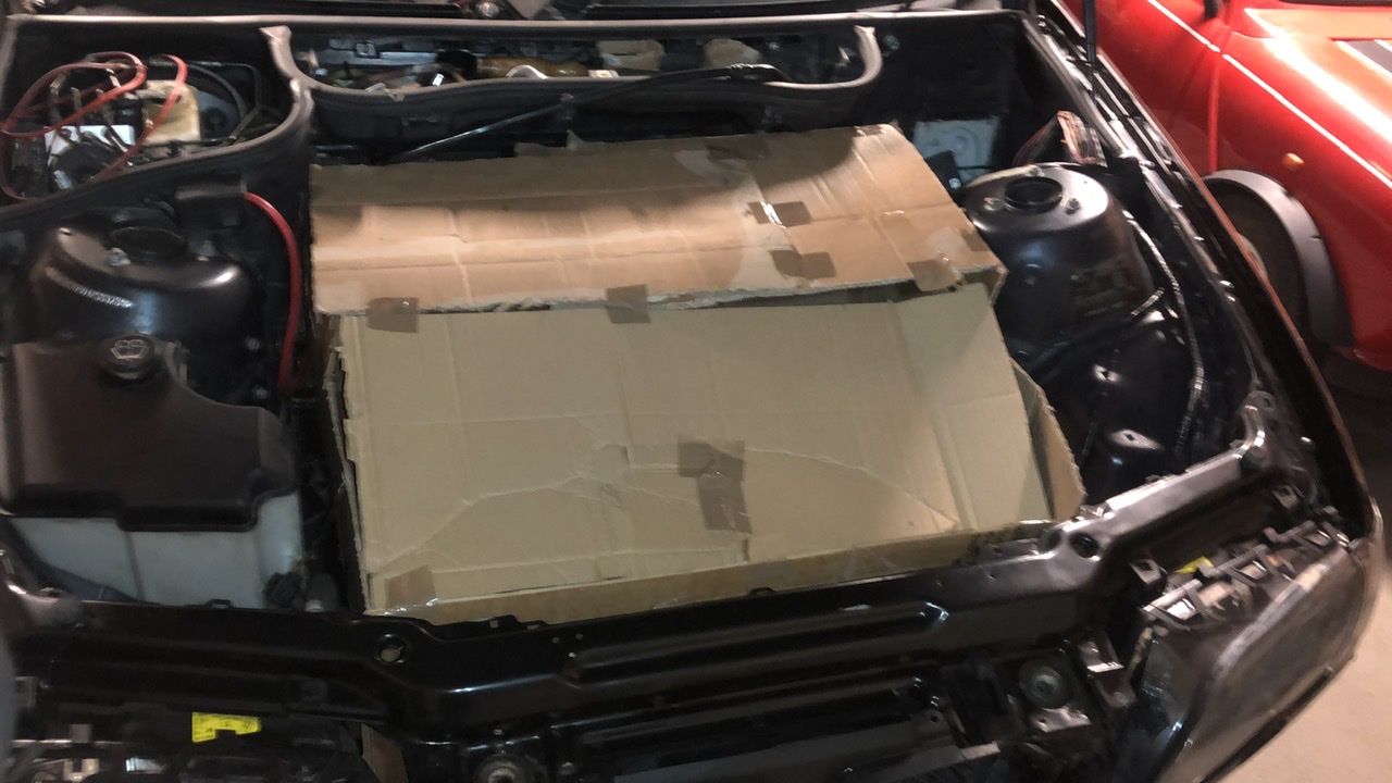

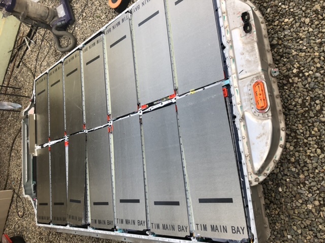

Spent some time doing professional CAD - think I can only fit 3 modules under the boot at the back, but fortunately 11 fit under the bonnet so I get a full 75kWh, weight distribution will be a bit upset but shouldn’t be too bad
Also took apart the back of the Tesla pack and retrieved the contractors, 23ohm precharge resistor, Main BMS board and pyrofuse (which was at the front)

Hoping to get at least 210mi of motorway range, and with some efficiency mods I’ll do later on, 230+Mi
And most certainly cardboard aided design, only the best for me
Re: E46 Touring Project Engine Delete
I'm interested in your battery layout... in the engine bay are you basically fitting a stack of 6 and a stack of 5 transverse? I'm planning a wagon project and had been thinking an i3 battery pack but am now rethinking the tesla modules!
- Posts: 219
- Location: West Midlands, UK
- Been thanked: 11 times
Nearly but not quite as simple, fortunately the chassis rails in the E46 are *just* big enough for a module plus some space each side for coolant hoses or bus bars.
Under the chassis rails I have 1 upright on its side and 2 flat on top of each other. Leaves enough space for a radiator up front too.
Then above the chassis rails I have a stack of 4 towards the back and a stack of 3 towards the front, making 10 under the bonnet, then another 4 where the spare tyre was, stacked upright on the side.

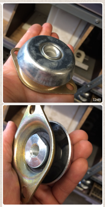

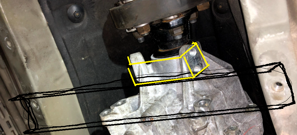

Sure:
Piece of U steal and to the gearbox you use a piece of flat 6mm steel.
You bend the 6mm steel to re-use the threaded holes.
Now you get a centre point.
The U piece van be like 3/4mm thick depending on the hight of the U.
Now what i cant see very well is if it lines up, but i do see another hole on the pic so that would basicly mean throwing another piece from the lower one to the upper hole (like a broken X).
Now the trick. In between the two you mount a rubber foot damper / anti vibration.
like:

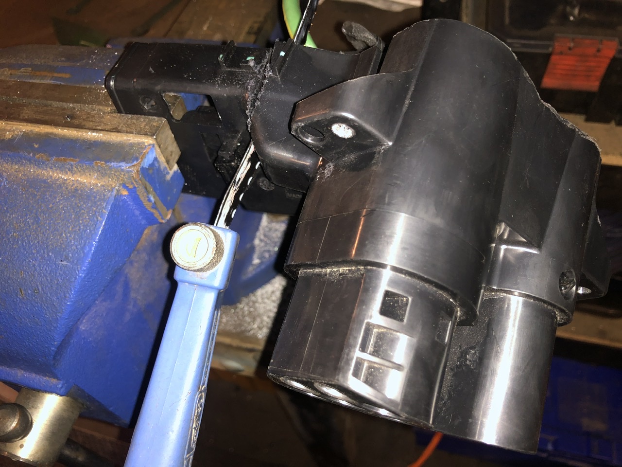

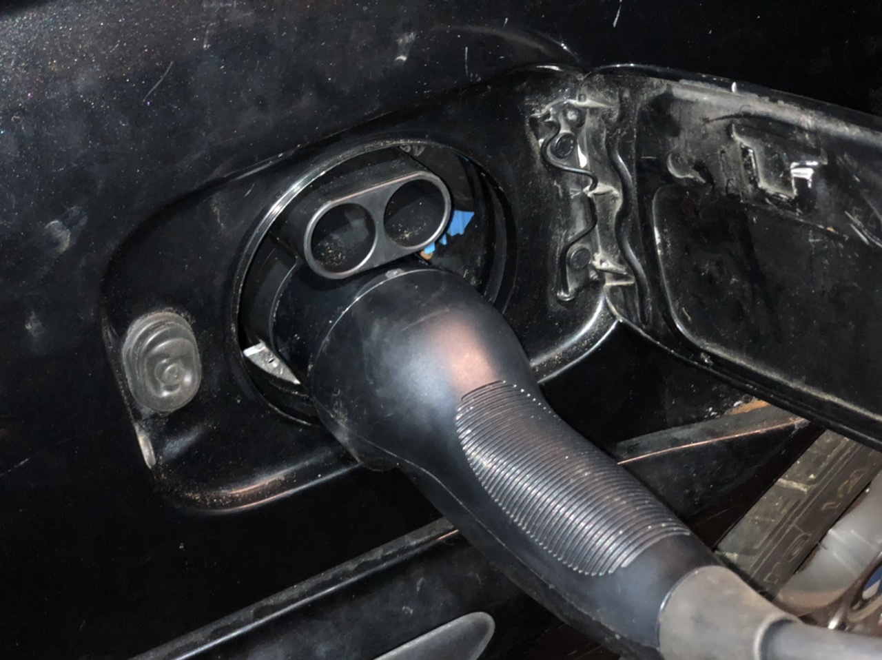

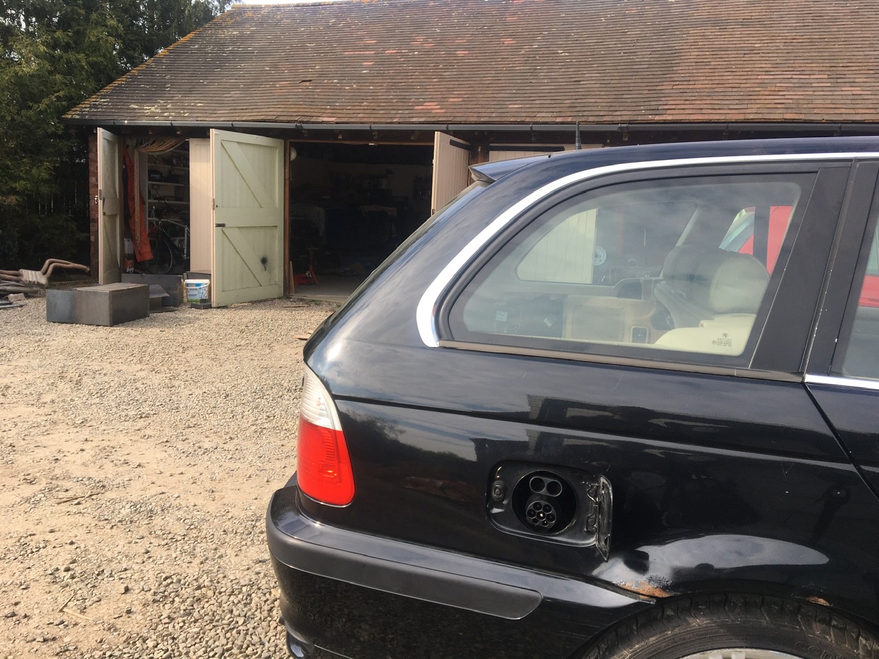

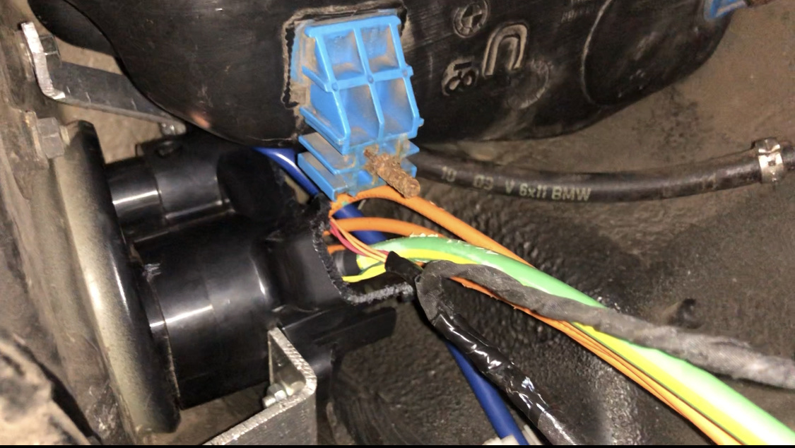

Almost got her running recently but one of my resolver connectors wasn’t properly wired and I broke it trying to re-wire it.
So in the mean time I have fitted the model 3 CCS charging port where the original fuel filler was using some aluminium brackets.
In there nice and sturdy, had to grind away a lot of the plastic and temporarily remove the DC pins, but functional for now
Super impressed you got that in! My el cheapo aliexpress version was a struggle on the Goose.
- Posts: 219
Thanks, thought I’d have to permanently remove the rear washer tank but it just about fitted with it, still to add CCS DC pins but will do that closer to when there’s a CCS controller out

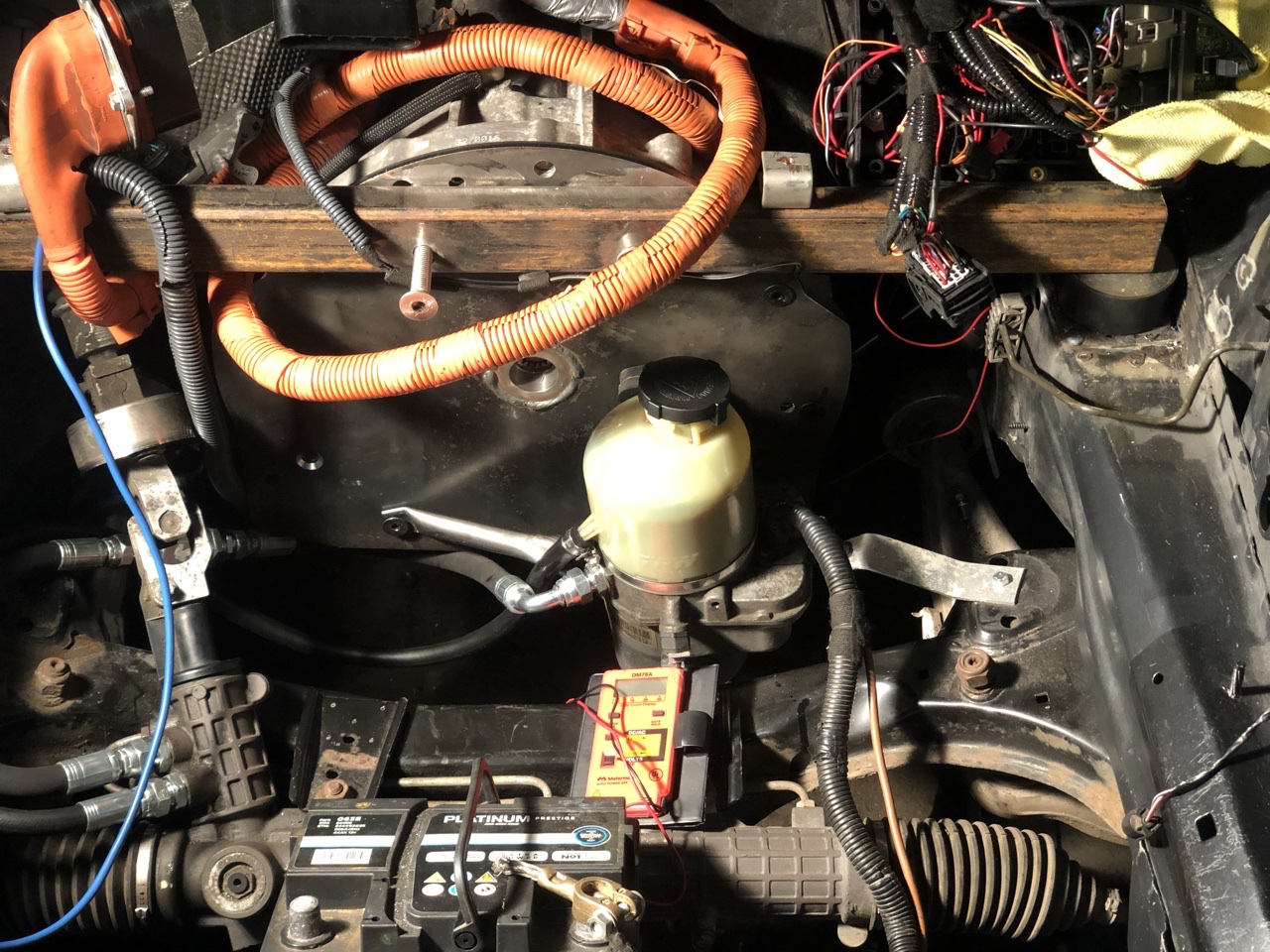

Fitted my Power steering pump now, wasn’t where I wanted it to go as it didn’t quite fit but this isn’t a permanent solution, within a year or so it will be replaced with an EPS column compatible with Openpilot which I also plan on retrofitting
Hoses made by pirtek and costed £80 ish, because they had to put in a valve restrictor as they didn’t know how restrictive the restrictor in the e46 steering hoses are, suppose it means I can change between light and heavy/sporty steering

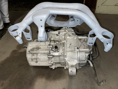

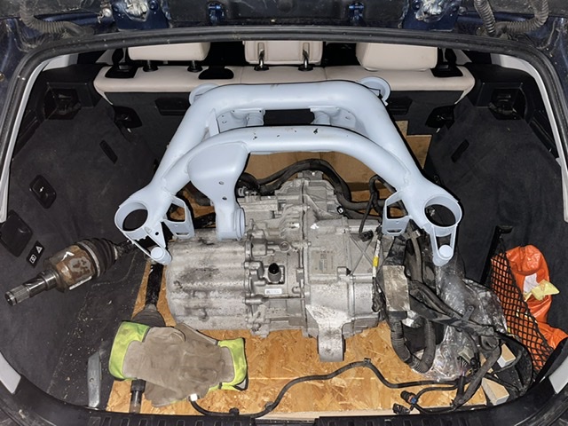

Tesla Small Rear Drive unit arrived today, bought for £1550 + vat, including original HV cable and driveshafts, has 8k miles.
Here’s some pics of it lined up against the original E46 Subframe it will eventually rest in
