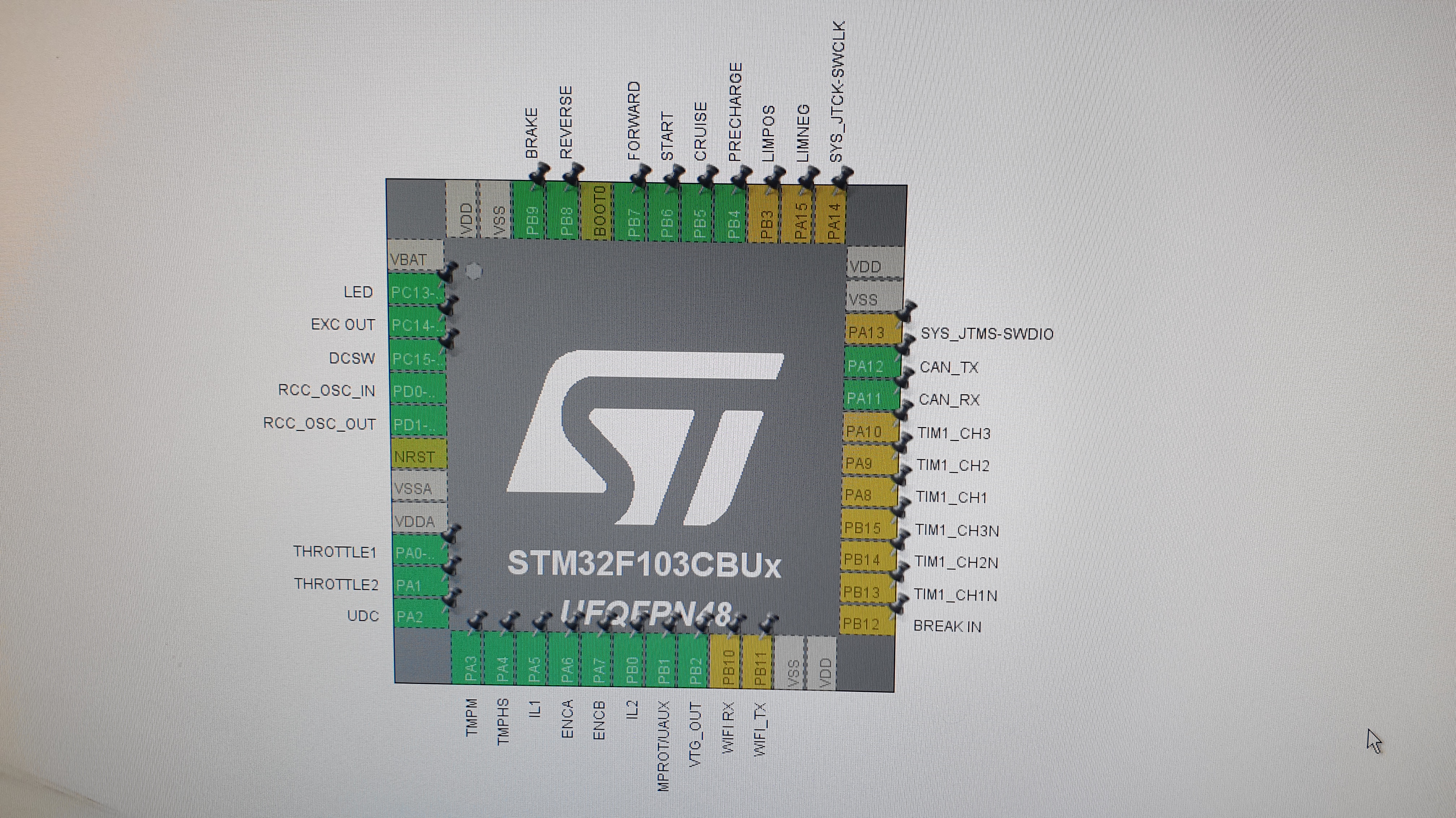

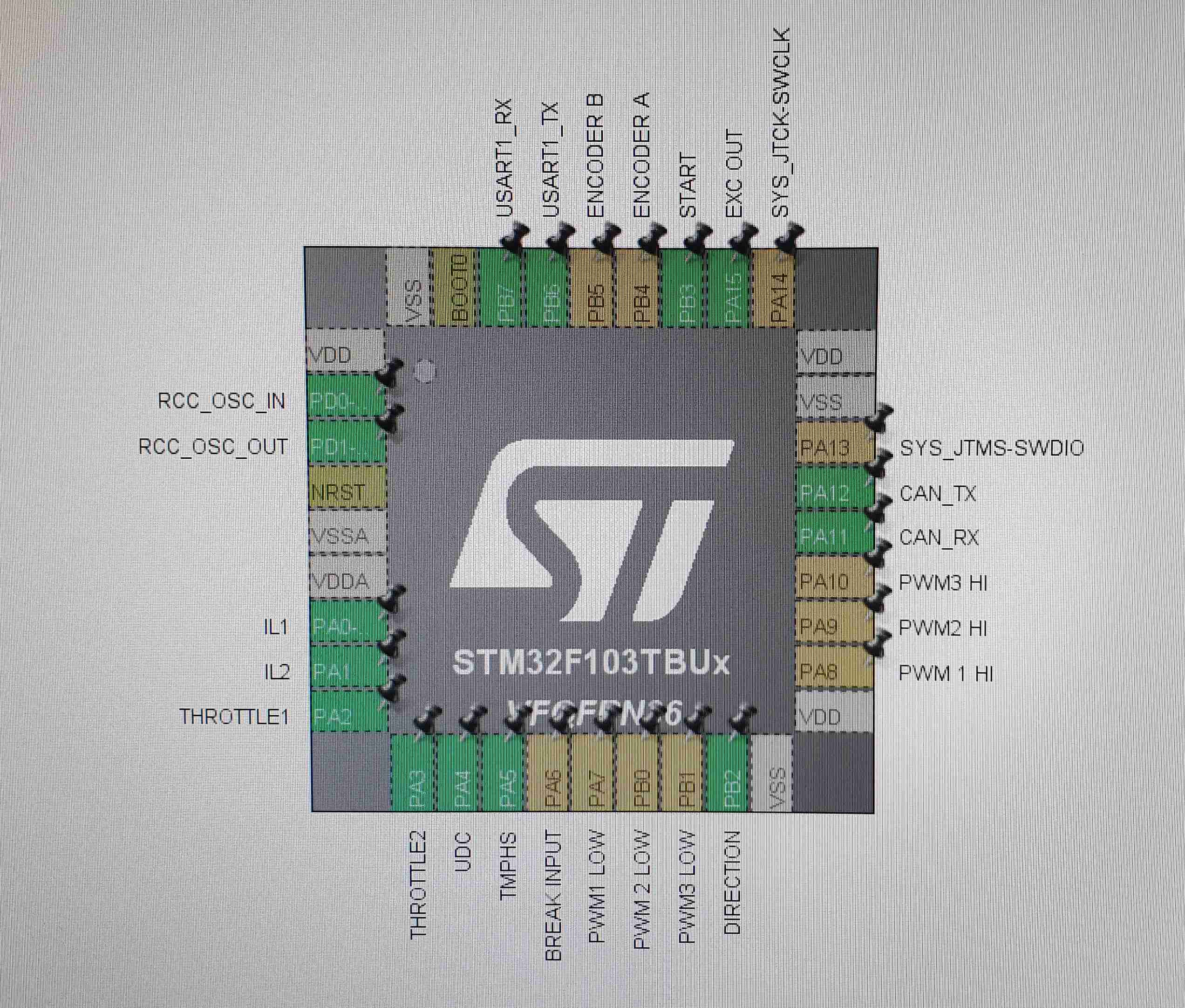

New crazy idea taking shape. I'll let the picture explain:)

Ok that aint gonna work. 48 pin it is:)

If you use CAN you can remove start, brake input, throttle1 & 2 and direction. But I guess you already thought of this.
What are you trying to do?

Issue was: no ADC channels left for resolver
