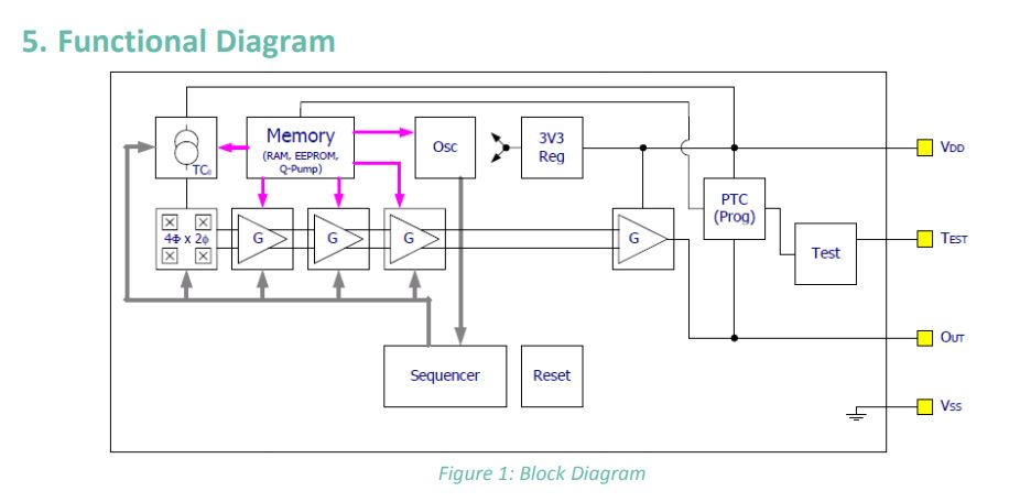

Ok found the page about the current sensors.
viewtopic.php?f=10&t=77&start=25
With the type number: https://www.mouser.ie/ProductDetail/Mel ... DN4jl%2Fc=
Now for the material (aka SNOT) i have no clue what todo?
Would just house hold sealant work?
I don't want to use something rigid i guess?

I discovered/experienced that when heating up the sensors they easily let go from the snot.
So i think that by far the fastest and cheapest (if you value your own time) way of doing this swap is by just heating up the sensor wires with the iron and see the snot get gelly then do the other and then gently remove them with the board.
Solder the new sensors to the newboard (check the height of the sensor on the old board) and "kit/bond/glue" them in again.
10min. Job if you have the parts.

Well the sensor is programmable...
Default seems tobe 50mv/mT do we know the actual value in the Tesla unit / our application?
