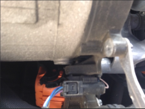

Ok, motor appears to have electrical connection at the aft end presumably for resolver.

Re: SmartED using Prius Gen3 Inverter
Yes that looks familiar, similar to ED2 motor. Can you find out the part number of that connector? I need to know for another project.
I believe the Smart ED motors are the same as the original Fiat 500e and also used in the Peugeot 508 hybrid. The Resolver is apparently a Tyco unit.

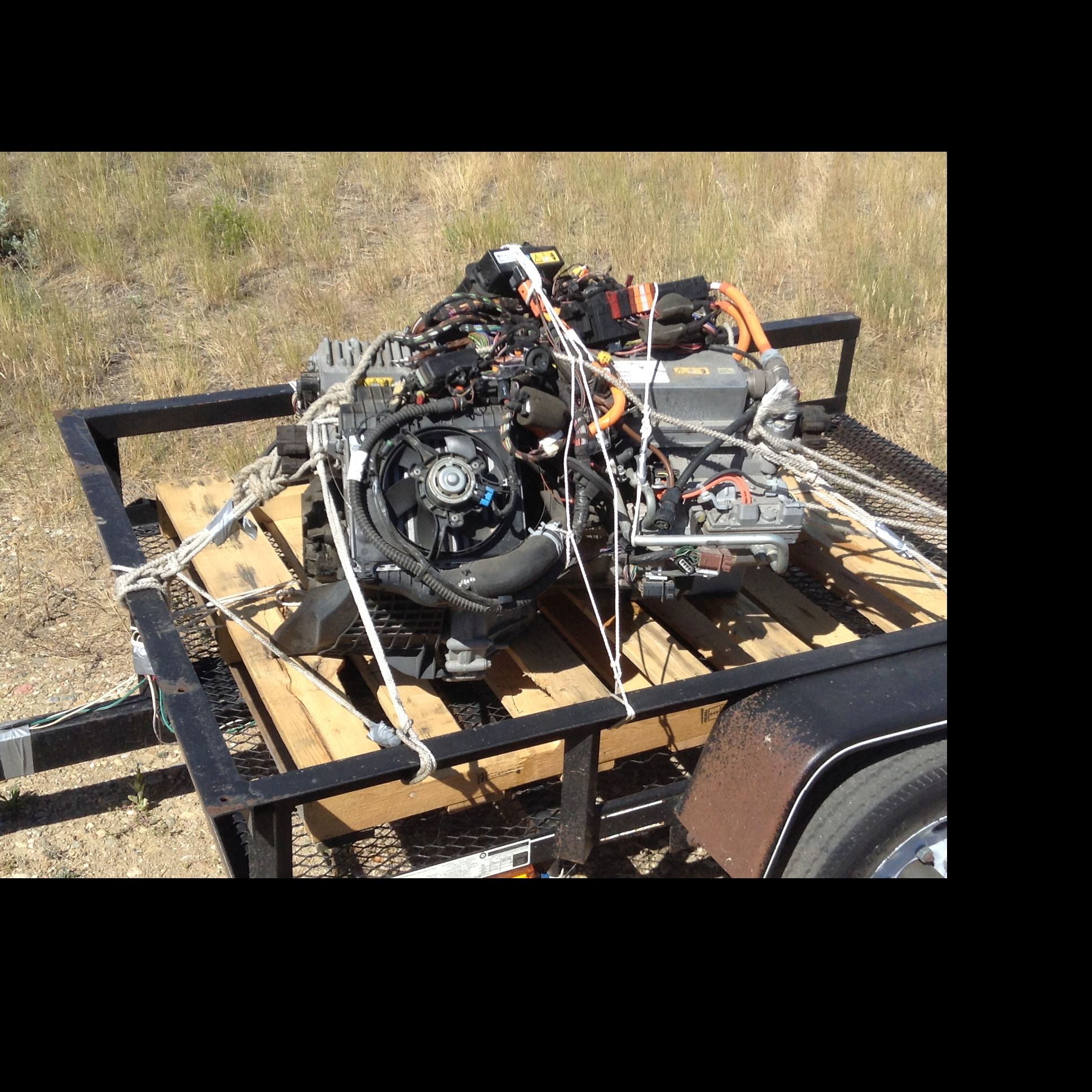

[/img]
Yes, that's the beast allright. In true Tesla fashion they are attaching the inverter directly to the aft end of the motor.
My prius gen3 inverter is due friday and yesterday I ordered an ED3 motor plus the EVBMW board so I'm committed to the latest technology.
So no one succeeded in getting the old motor to run? If they did the ballyhoo would be overflowing fer sure. [sadface]
Thanks much, now I know what is in this rat's nest:
I'm not aware of anyone getting it running, but I haven't done much research.
It looks like you've got the lot with that haul. Is that the battery pack under there as well?

No battery pack and no dash unit, but all sorts of other oddness in the pile.
