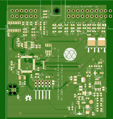

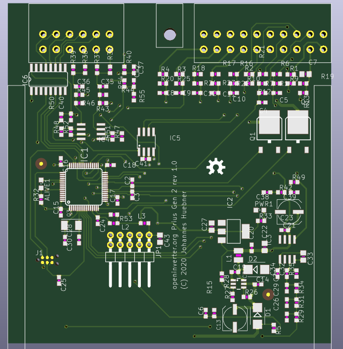

Done :)
Some changes in pin assignment:
  1. GIVA - to level shifter 1
  2. MIVA - another input to level shifter 1
  3. GIWA - to level shifter 2
  4. MIVA - another input to level shifter 2
  5. VH - udc input
  6. MIVT - tmphs input
  7. MFIV - desat input
  8. CPWM - PWM2_N for charging
  9. MUU - PWM1
  10. MVU - PWM2
  11. MWU - PWM3
  12. GINV and GCNV and GND - ground everything here
  1. Encoder channel B/Resolver S3
  2. GND/Resolver center point S1S4
  3. Encoder channel A or single channel input/Resolver S2
  4. Resover excitation R1
  5. Resover excitation R2
  6. 5V output
  7. Throttle Input (0-3.3V)
  8. 2nd Throttle Input (0-3.3V)
  9. Start input (12V)
  10. Brake Input (12V)
  11. Forward (12V)
  12. Reverse (12V)
  13. Motor Temperature Input -
  14. Motor Temperature Input +
  15. DC contactor output
  16. Precharge Output
  17. CANL
  18. CANH
  19. GND
  20. 12V
I use the TDA2822 in bridge mode now, meaning it can do true bipolar output -> Can generate 9V p-p from 5V supply rail. And that means I could remove the boost converter. I also removed the over current comparator since the Prius HW takes care of that. ABZ encoder is no longer supported, don't know of anyone who ever used it.

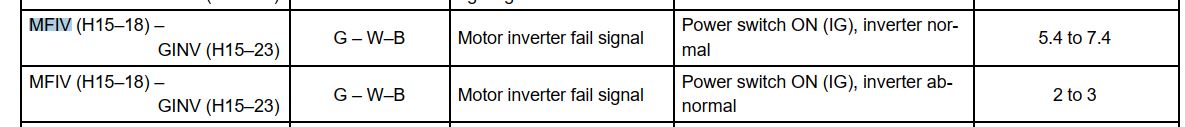

The only unknown is the "MFIV" fault output from the inverter. Don't know yet what it outputs as "good" and "bad". Right now I'm assuming it outputs 12V for bad and 0V for good.

johu wrote: Thu Apr 30, 2020 7:06 pm The only unknown is the "MFIV" fault output from the inverter. Don't know yet what it outputs as "good" and "bad". Right now I'm assuming it outputs 12V for bad and 0V for good.
From the Prius manual...
Been thanked: 1918 times
SciroccoEV wrote: Thu Apr 30, 2020 7:35 pm From the Prius manual...
So it means
normal - 5.4V to 7.4V
abnormal - 2V to 3V
In other word <3V abnormal ?
Not a very nice logic level...

johu wrote: Thu Apr 30, 2020 8:15 pm In other word <3V abnormal ?
I've found that the stated voltages don't necessarily match up with reality on the bench.
Perhaps they do when feeding impedance of the OEM ECU.

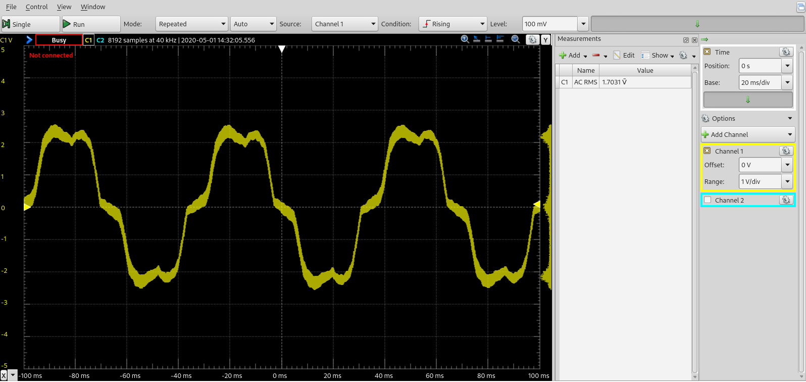

Did a little testing on my inverter, with just 24V DC voltage. So 25mV per A of phase current is confirmed - measured 64A RMS with the clamp meter and getting 1.7V RMS on the sensor output. You can see it's not quite sinusoidal, I think thats because the inverter behaves weird at low sine amplitudes. Still hoping higher voltages to mitigate this.
MFIV signal is 7.2V indeed but I couldn't provoke over current with my worn out lead batteries ;)

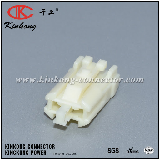

I am about to order some parts. Can anyone tell me the part number of the 2-pole "inverter 12V power supply connector" (next to 32-pin signal plug):

Sorry, looked from connecter I have with reference 11717. No luck, will check tomorrow again if no on can come to rescue

Ah but you mean for the HV DC bus? I meant the little 12V input.

It's not exactly an expensive connector to replace, I'd just buy a matching plug and socket.

SciroccoEV wrote: Fri May 01, 2020 6:57 pm It's not exactly an expensive connector to replace, I'd just buy a matching plug and socket.
My first thought exactly :) Why bother with OEM when you can replace it with any aftermarket. I consider I'm lucky to have piece of OEM harness with sealant.
Anyway I've got number 11717 on my connector, so google shows it correctly: 90980-11717

Order at JLCPCB placed :)
I have made some small changes: solder jumpers for optional encoder pull-up resistors (thanks Damien) and corrected inverter fault detection.
EDIT: and I created a logo 8-)
