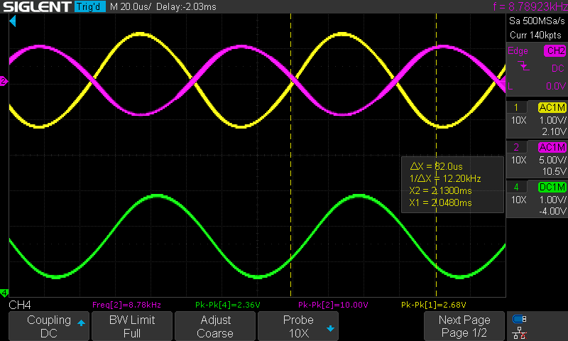

The sample is actually scheduled from the trailing edge of the cyan trace. This measures as 82 uSec. Which is a shift from the 40 uSec used at 4.4kHz. I hope there is enough time for the injected conversion to complete before the resolver code reads the value on the rising edge of the cyan trace.
Fixing up the filter has improved the output from the resolver markedly though.
I've mounted the resolver in my motor but it just produces garbage data until I fix the timing. The ADC is very noisy on the V1 board too (as previously noted). I measured 250mV ripple on the VDDA pin without a functioning gate driver PSU. :-|

Not very fruitful day. Hey ho. Some combination of removing U22 and replacing with an LD1117 and U6 (for good luck) and joining up the unconnected holes with 2.5^2 copper has quietened things up nicely.
Some very clean signals going to/coming from the resolver:
Cyan is main control loop with the dotted line being the sample delay. Yellow is the sine and green the cosine signals with purple being the exciter.
Zooming out a bit things still look good:
Every cycle is identical and the hit-one-miss-one sampling looks like it should deliver a stable answer for a static motor.
The signals heading into the ADC look good to me. Biasing is correct and the amplitude is fine (e.g. sine 2.40V pk-pk and cosine 1.04V pk-pk):
Obviously a software problem right!? Apart from fixing the exact timing the sample is taken I've not changed any of the non-initialisation resolver code at all. Need to sleep on it and go again tomorrow.

Face palm. Assumptions will make an ass of you and me...
When operating at a fixed 4.4kHz control loop and exciter loop the time between the falling edge of the exciter and the peak of the exciter sine wave is 40 uSec. On the rising edge it is assumed to be symetrical at 40 uSec. This falls apart when the exciter is running at 8.8kHz and the control loop at 4.4kHz. The falling edge needs to wait 85 uSec before sampling but the rising edge only 28 uSec. In other words 1/2 a wavelength less.
Fix that and I stop getting garbage data. Here's a plot of the angle as I walk an uncalibrated nut round the resolver ring then hold it steady:
