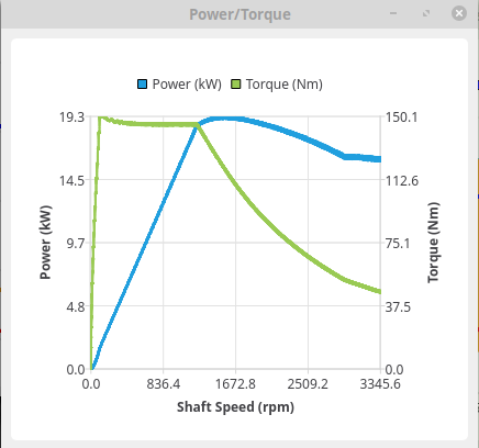

Power/Torque
This plot is fairly self explanatory. Use a time x-axis if trying to correlate against other plots and a speed axis if you would like a traditional power/torque plot. The plot is calculated from the shaft power of the motor, the electrical power going into the motor is not calculated but will be slightly higher (resistive winding losses). Magnetic and mechanical losses are not allowed for.

Important note - when changing the param_prj.h file in the IPMMotorSim directory of the simulator only change the parameters that are also present in the gui. Changing other parameters, such as pinswaps and syncoffs values can seriously affect performance of the simulator (in a bad way).
Thanks to bexander for finding this bug :)
Edit - and apologies to Ev8, I think this may have been the cause of your problem, sorry I didn't figure it out sooner :(
Edit2 - in the next simulator release I'll change it so that any parameters that could disrupt the simulation are overridden on program start. Doing that would allow the standard car param file to be used unchanged. Until then just make sure syncoffs is set to zero in the param_prj.h file
Posted: Mon Jan 09, 2023 9:03 pm
by Pete9008
OK - above bug now fixed and the new code is on github (https://github.com/Pete9008/IPMMotorSim).
Changes are:
  • Should be able to change any parameters in the param_prj.h file now without breaking the simulator (let me know if not)
  • The resolver pole pairs is now not used and the motor pole pairs is used for everything.
  • Bug on motor pole pairs fixed, van now change at any time.
  • Operating point plot can now be selected to show either Volts or Amps
  • Can now choose whether to display the phase currents and voltages on the plots (turning them off makes rendering the plots around 30% faster)
  • Edit - And cleared around 2/3 of the build warnings (rest are due to OI firmware fixed point macros so have been left)
Going to update the instructions above now and then if I don't run out of time have a go at copying them on to the wiki. - Done
