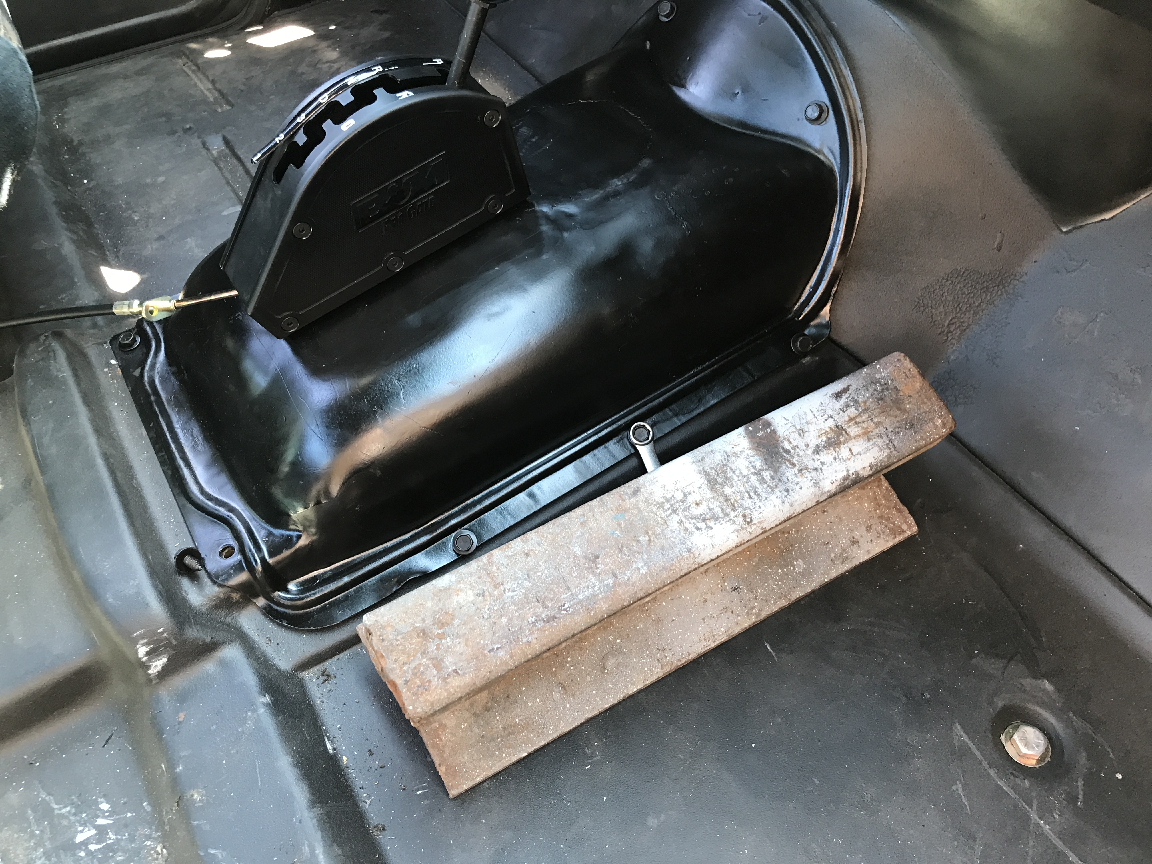

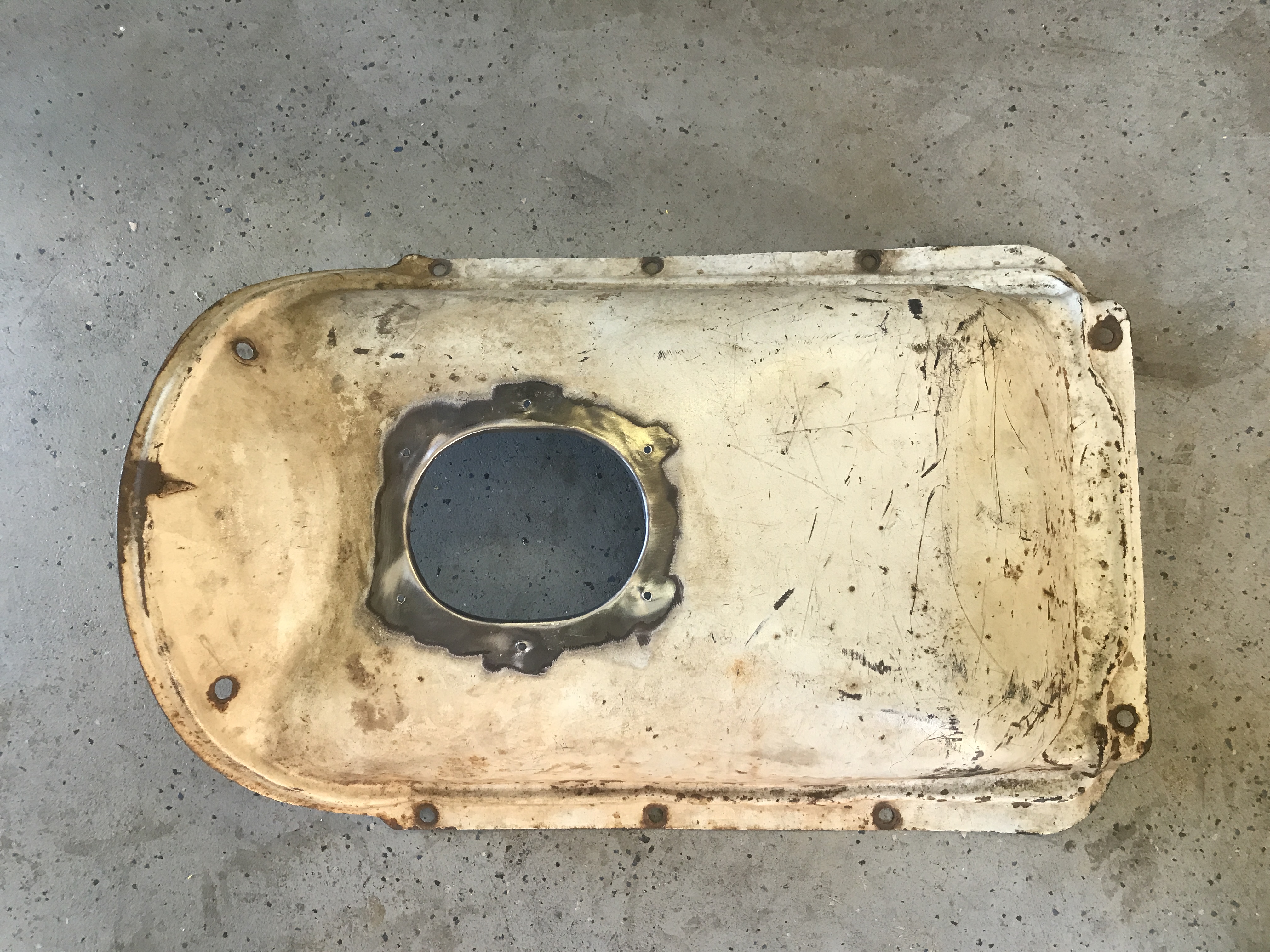

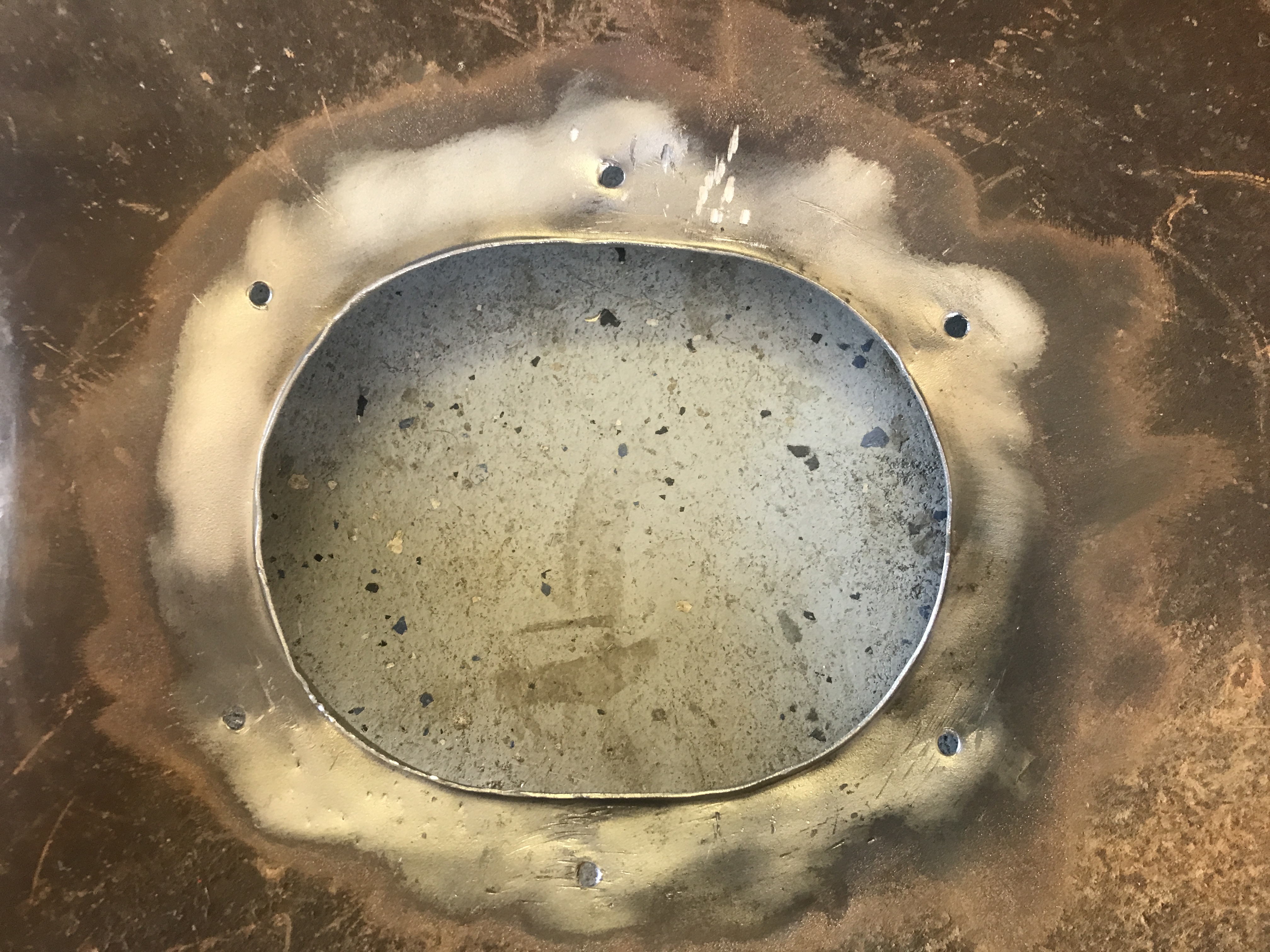

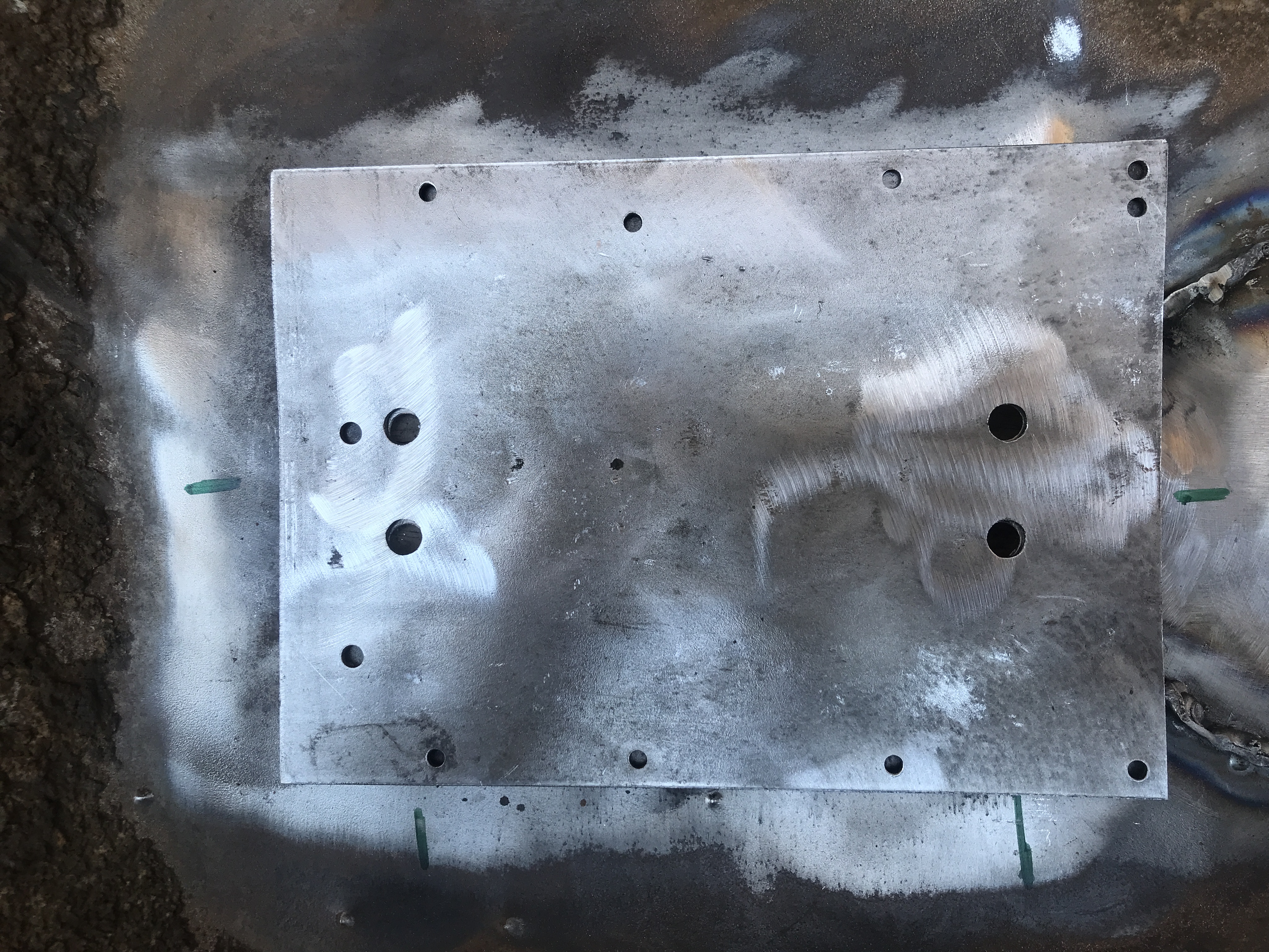

Post by Gregski »
OK, that's a tad more better
Gregski
Posts: 3157
Has thanked: 629 times
Been thanked: 1607 times

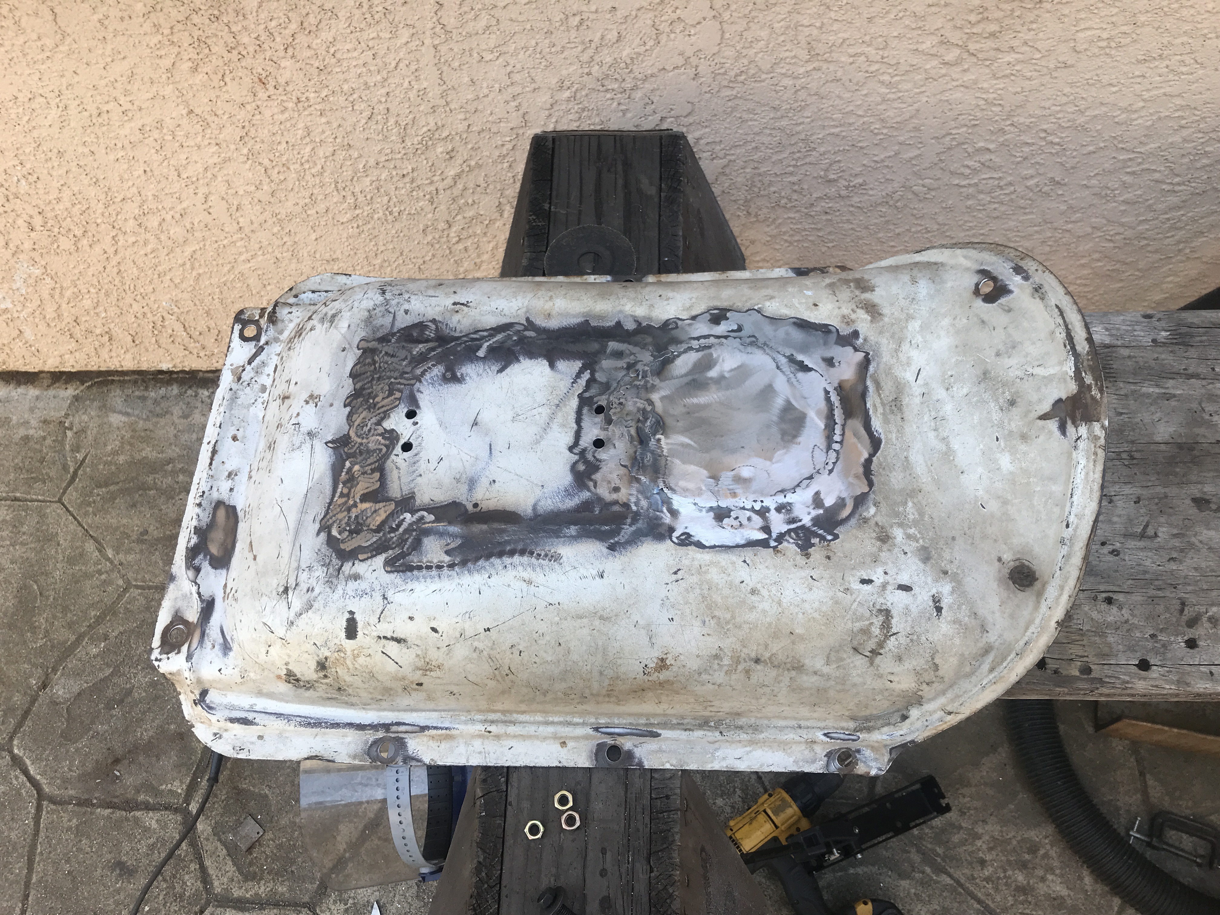

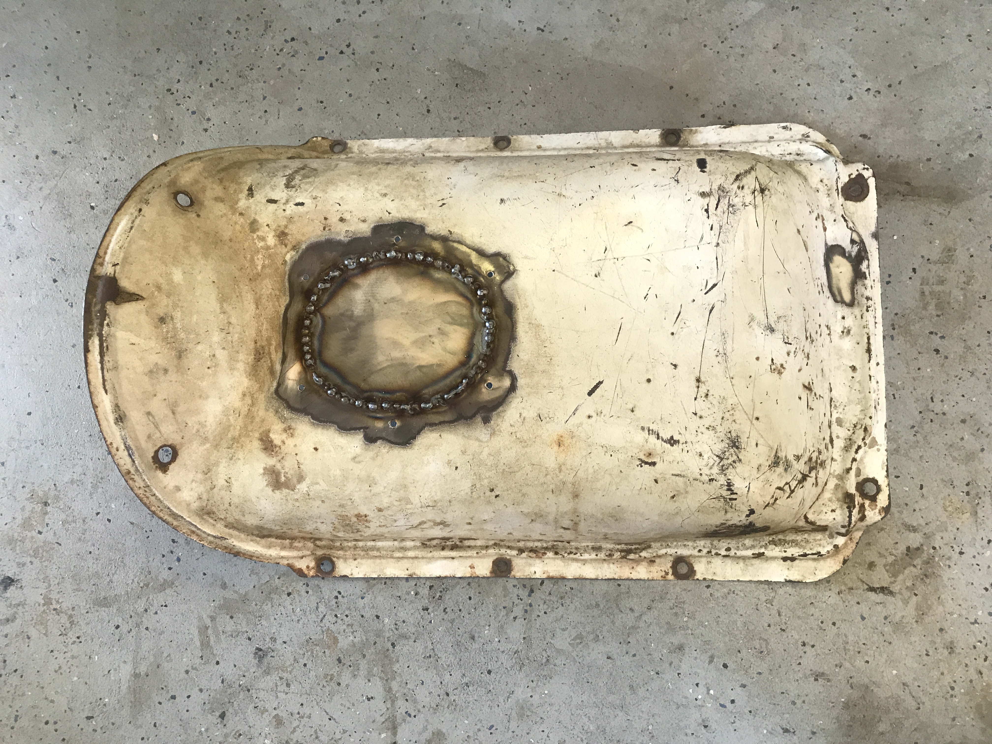

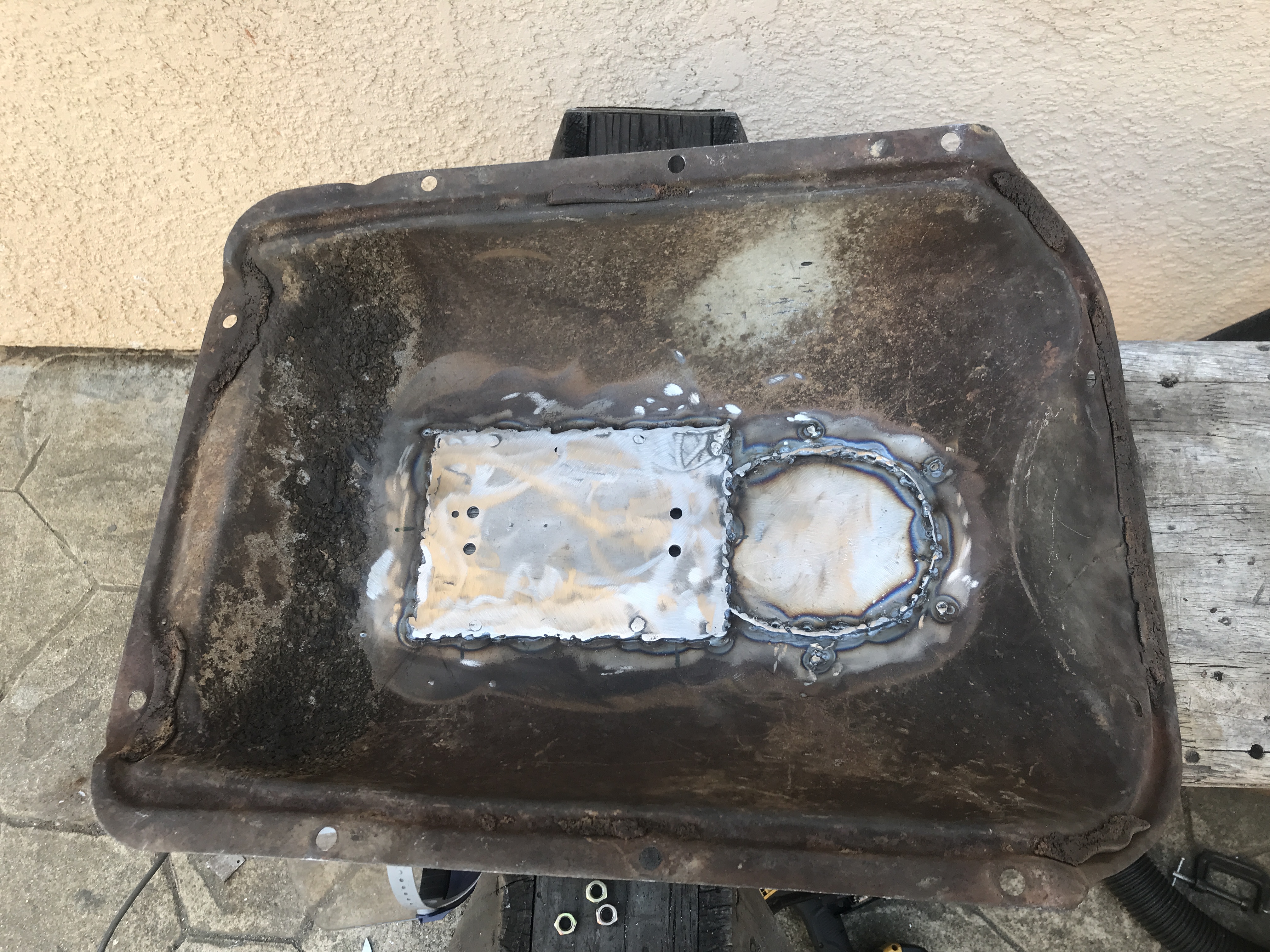

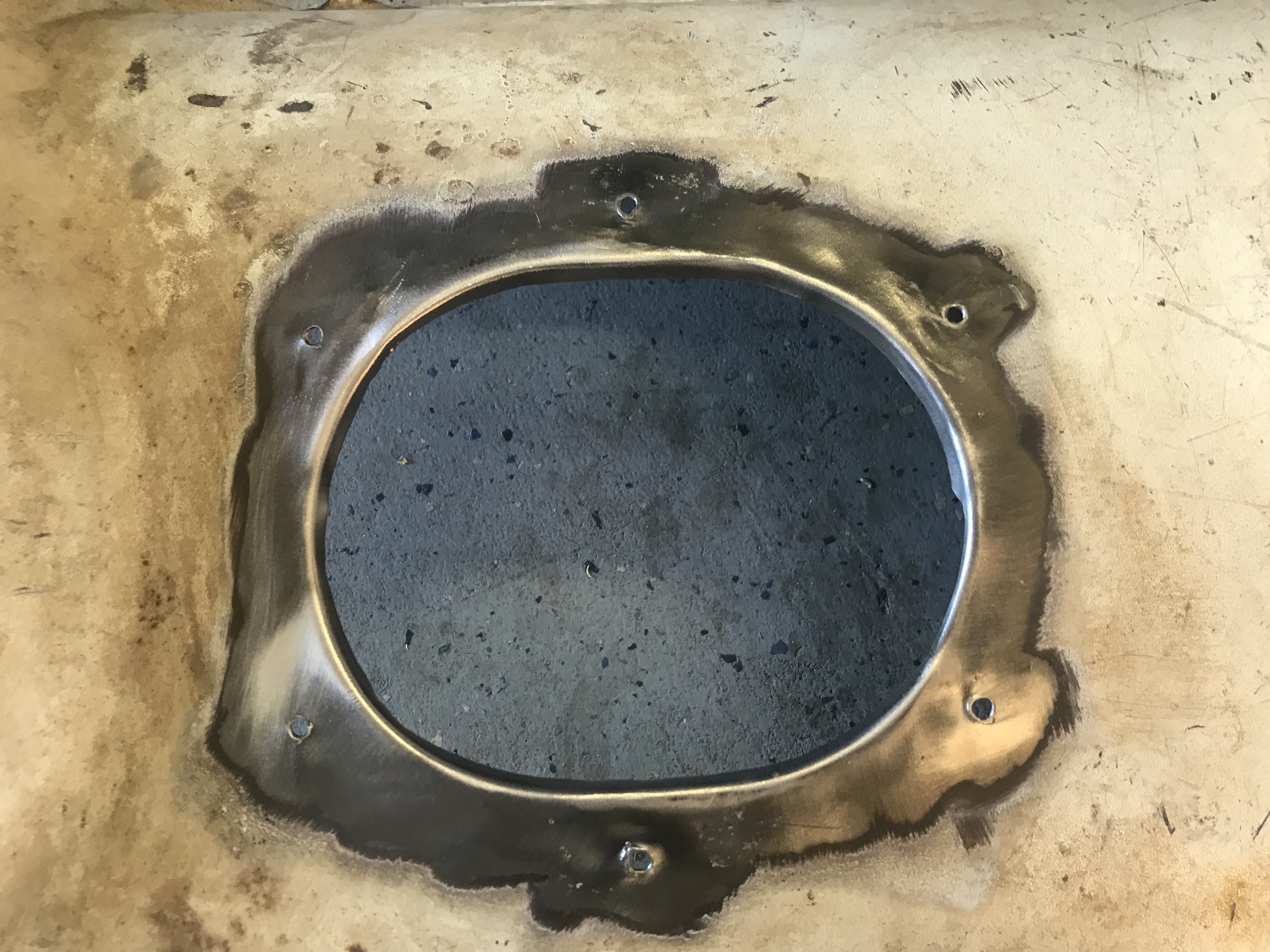

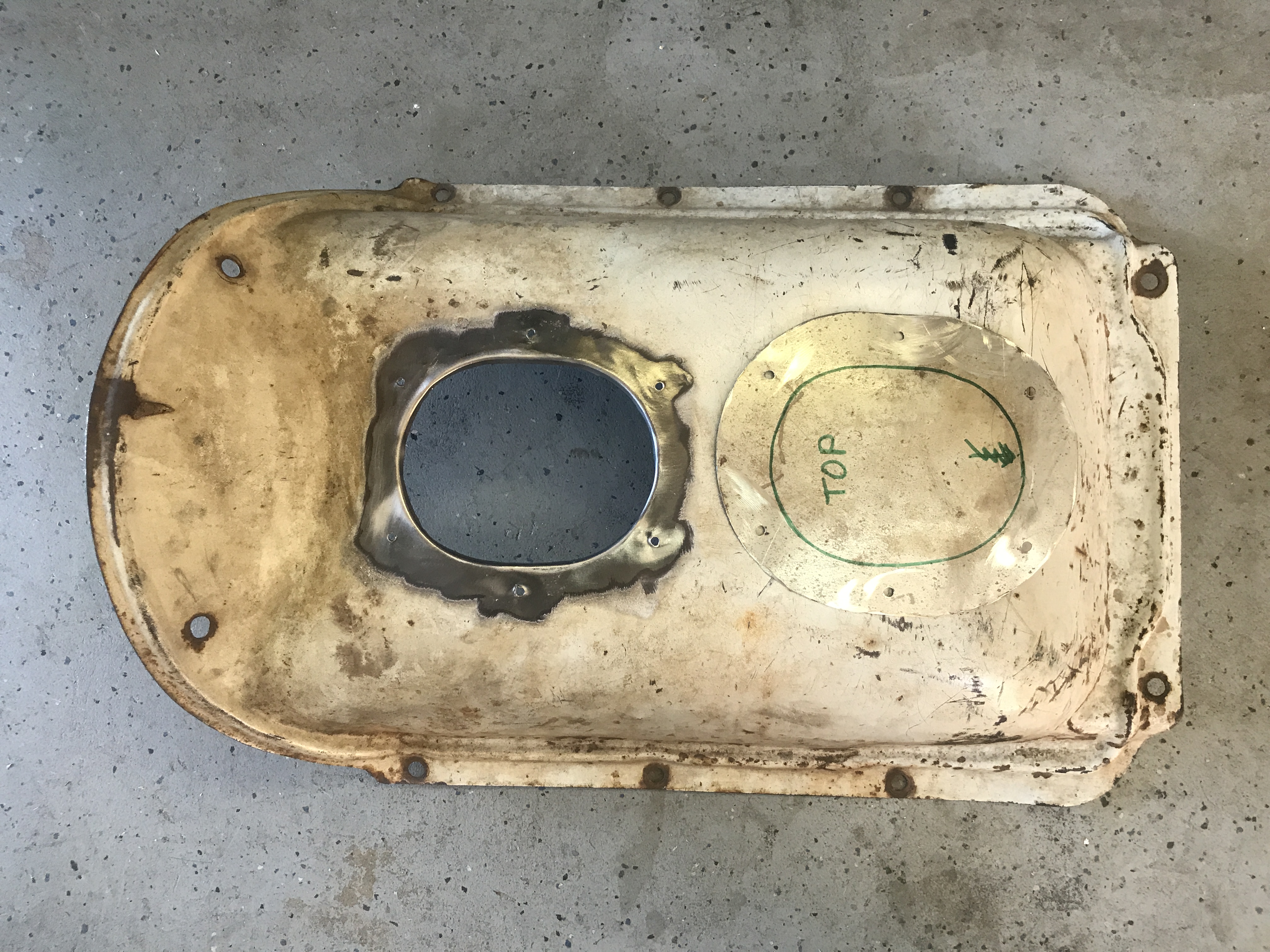

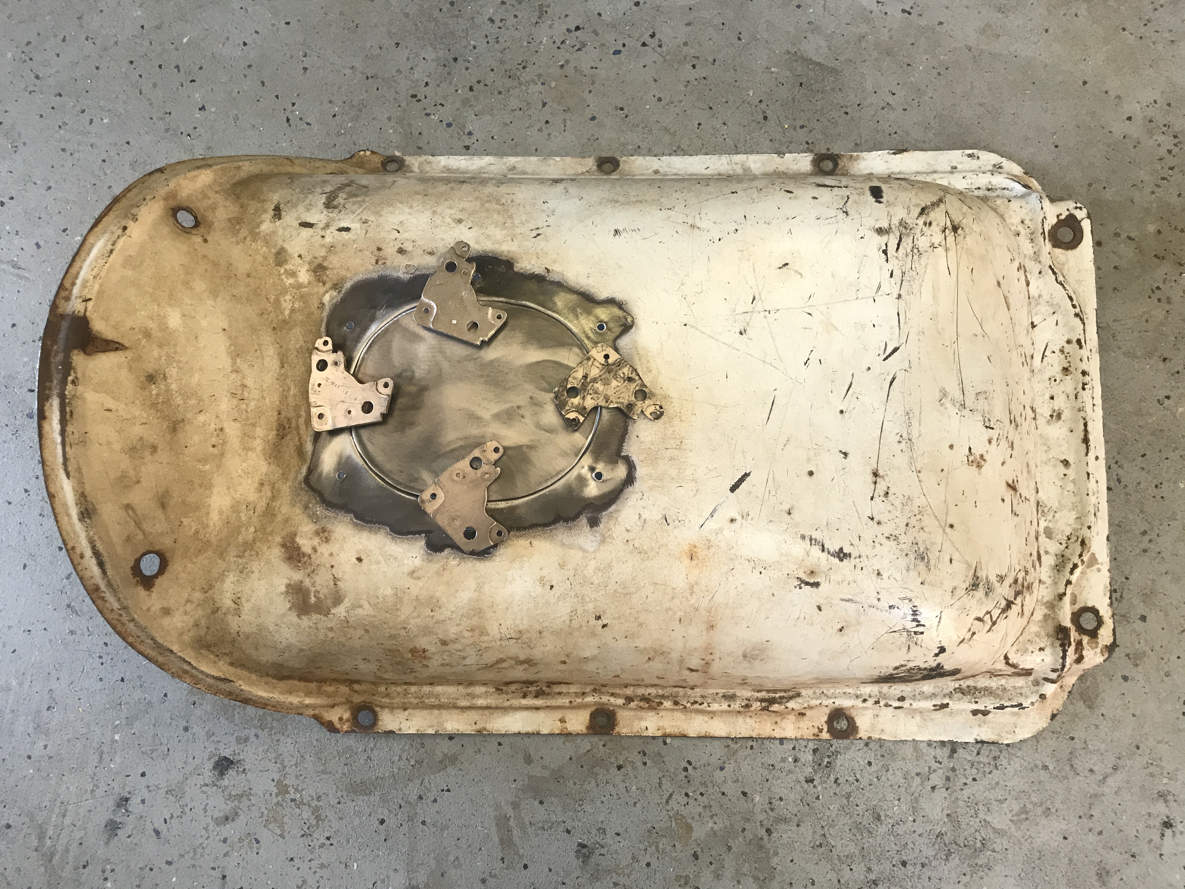

Post by Gregski »

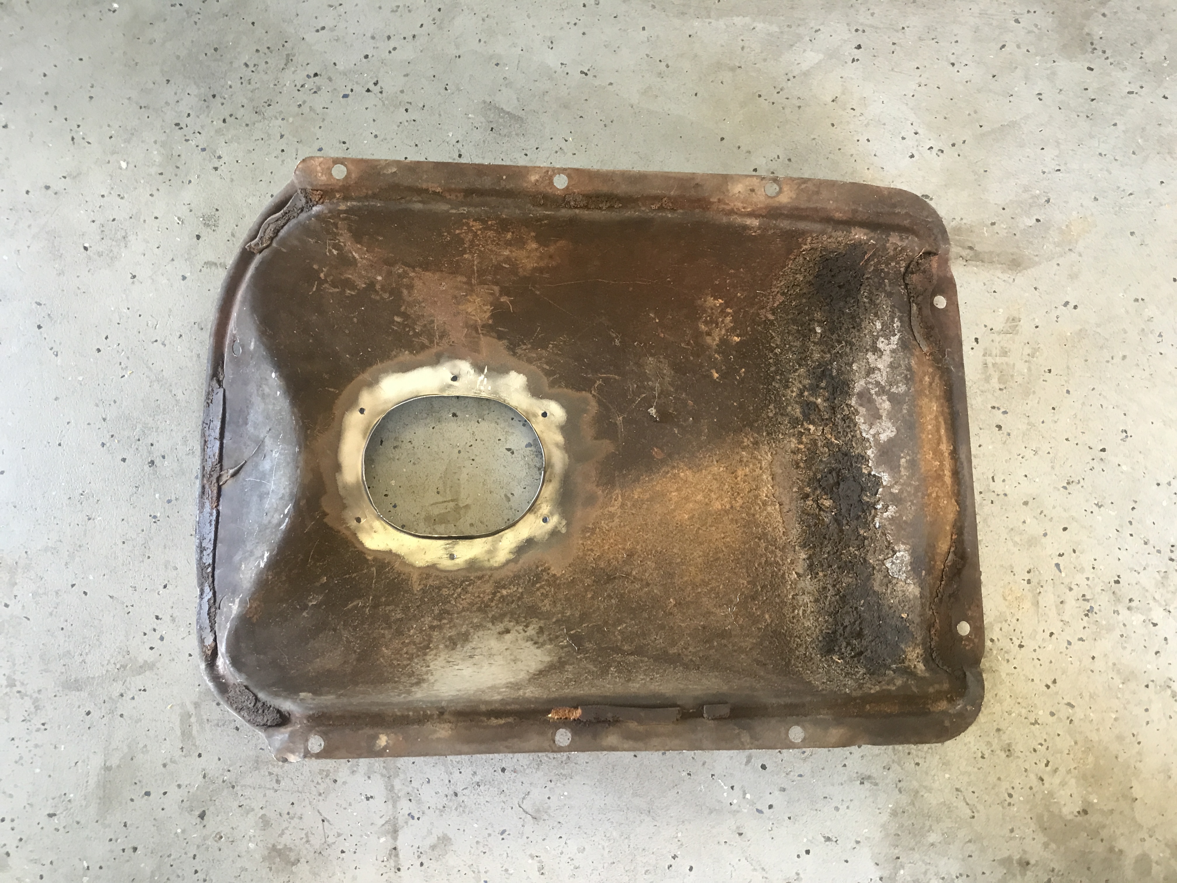

I'm a simple man, I see a hole, and I fill it !

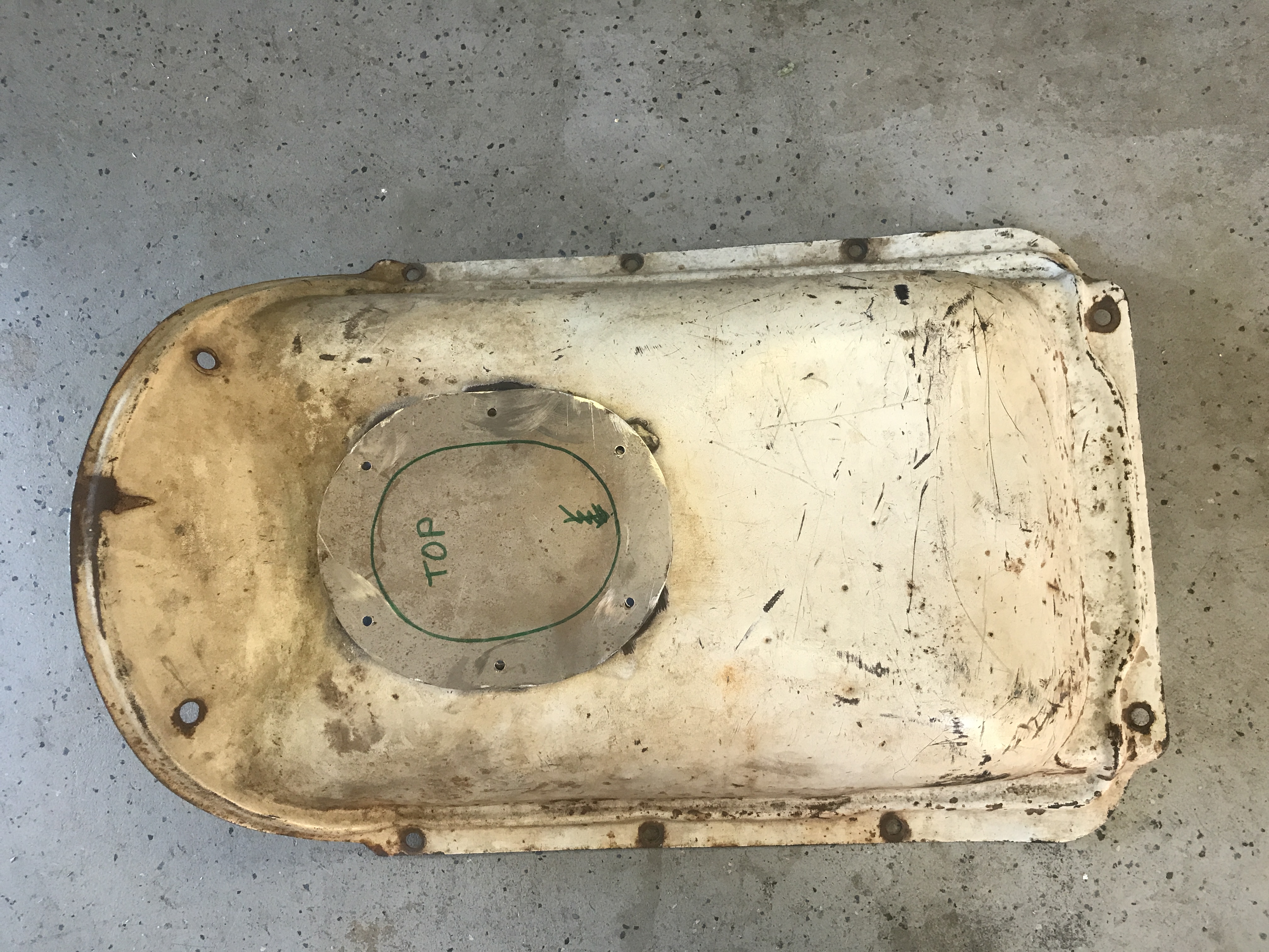

Post by Gregski »
I should have taken this next pic from across the street
Gregski
Posts: 3157

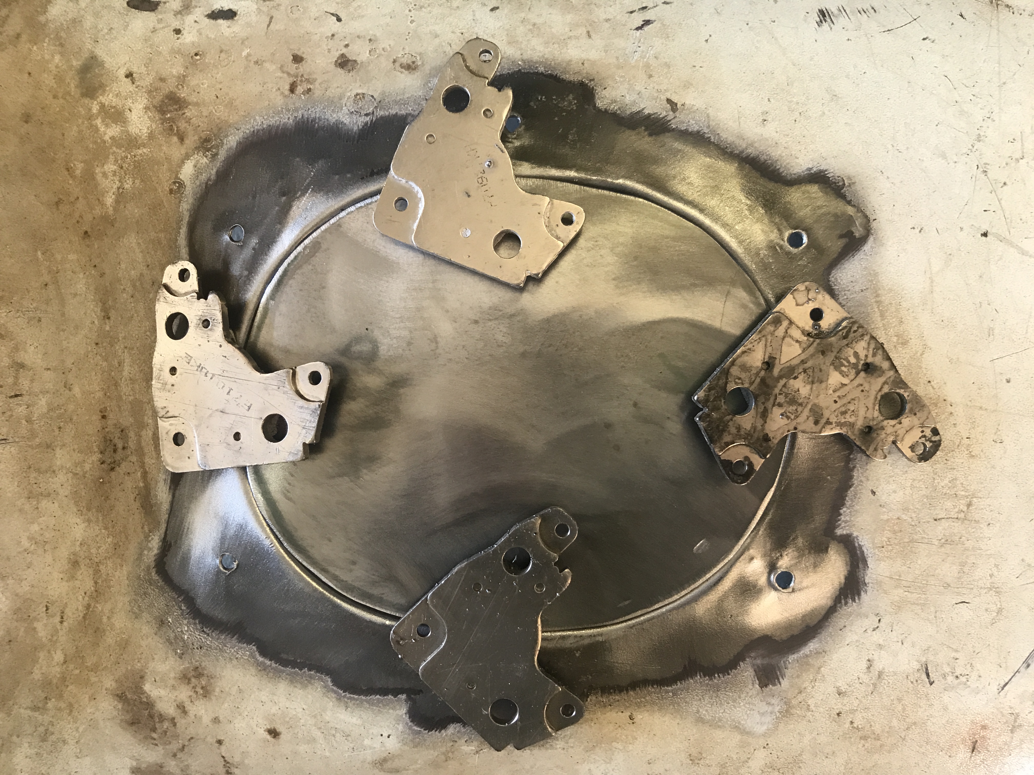

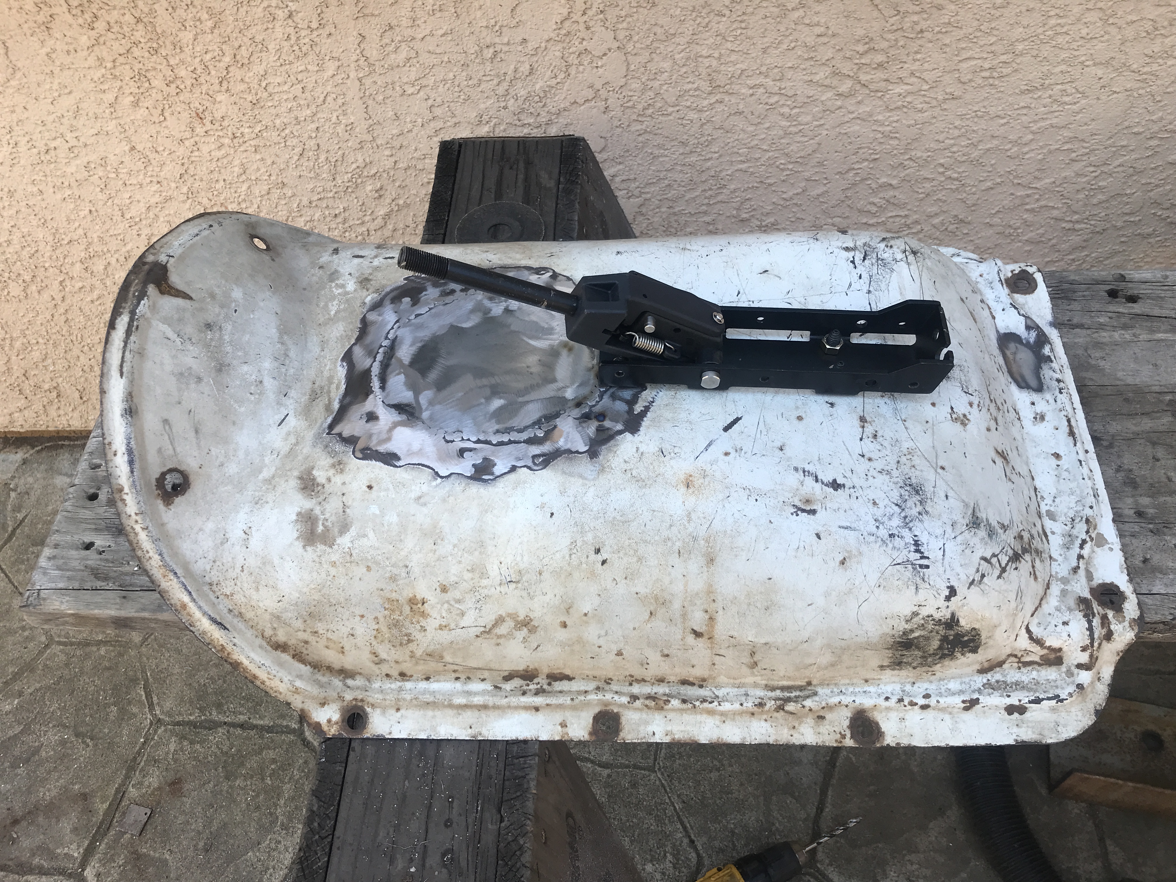

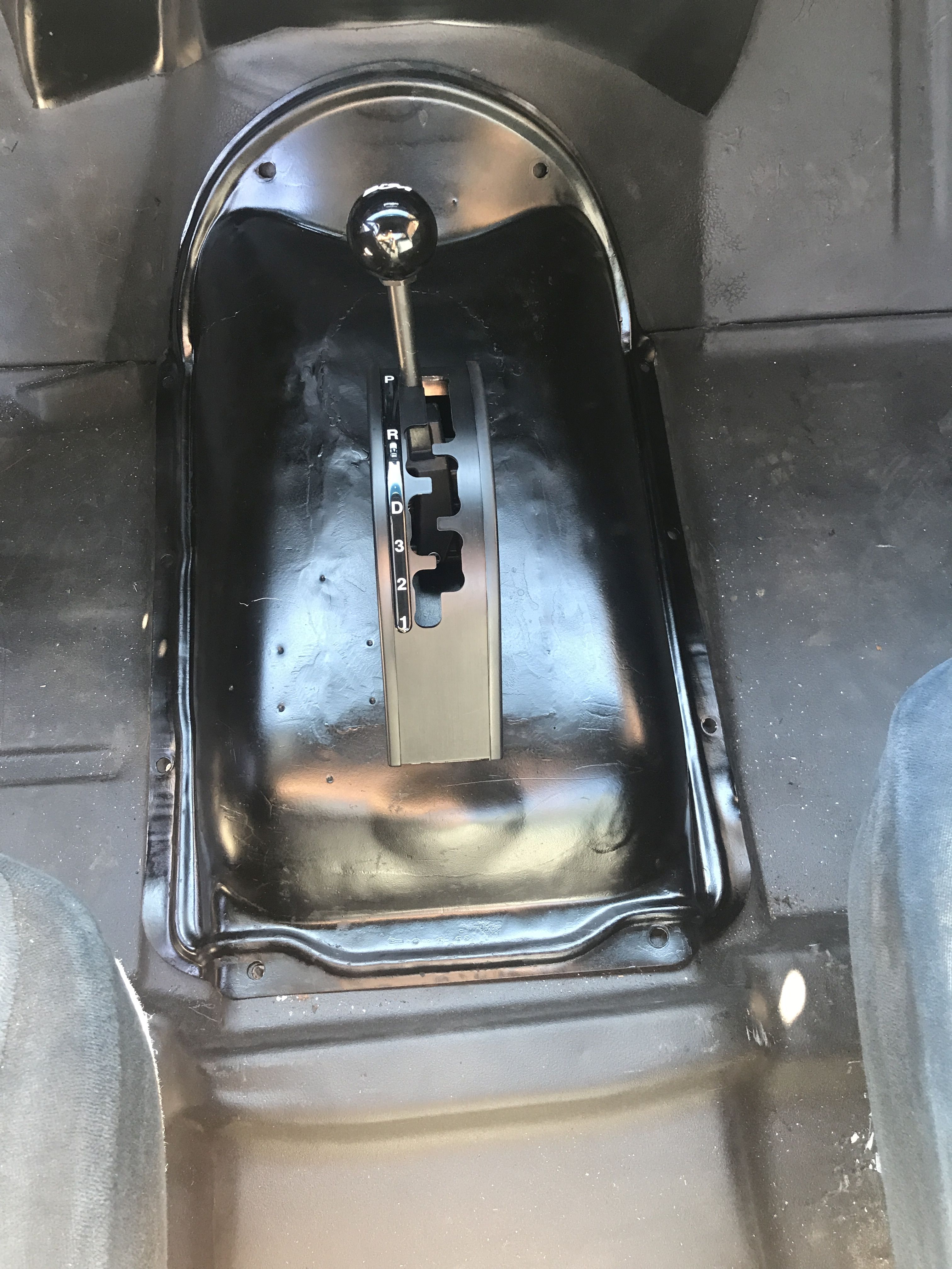

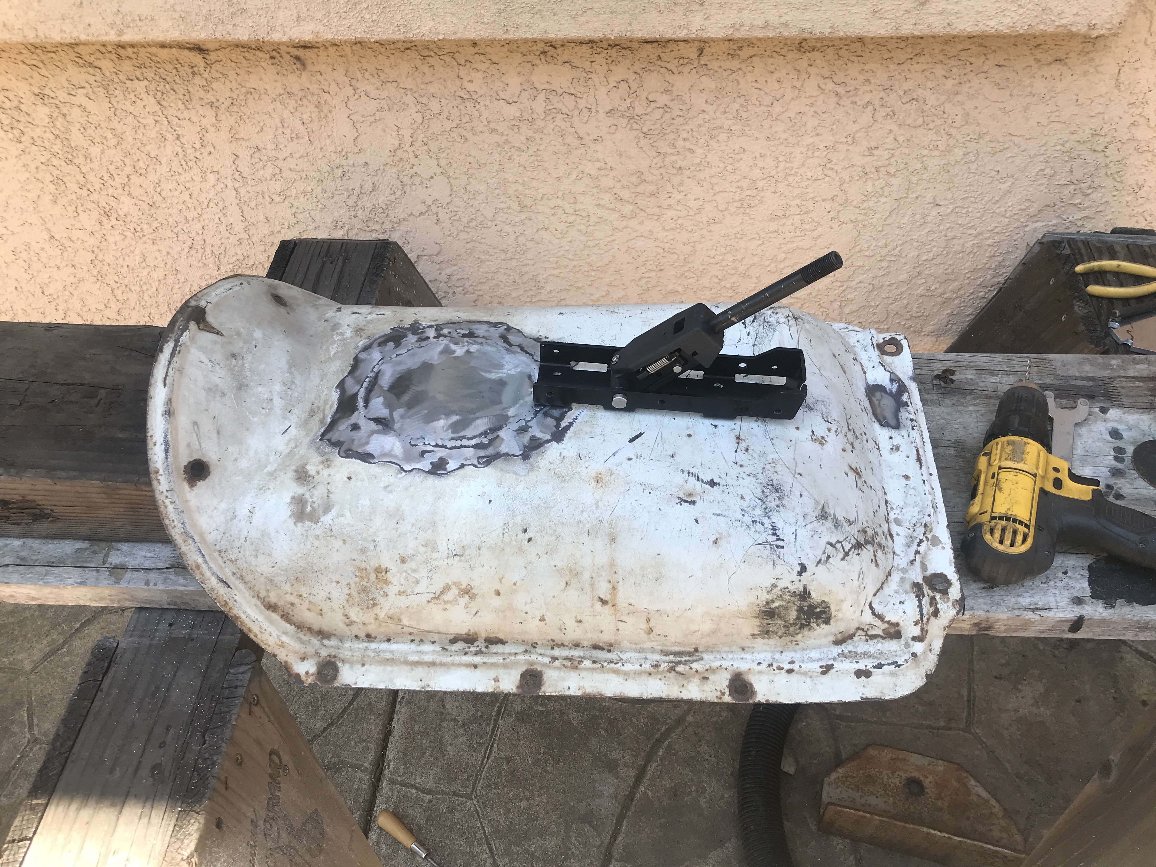

Post by Gregski »
so something like this with a reinforcement place in the back
Gregski
Posts: 3157

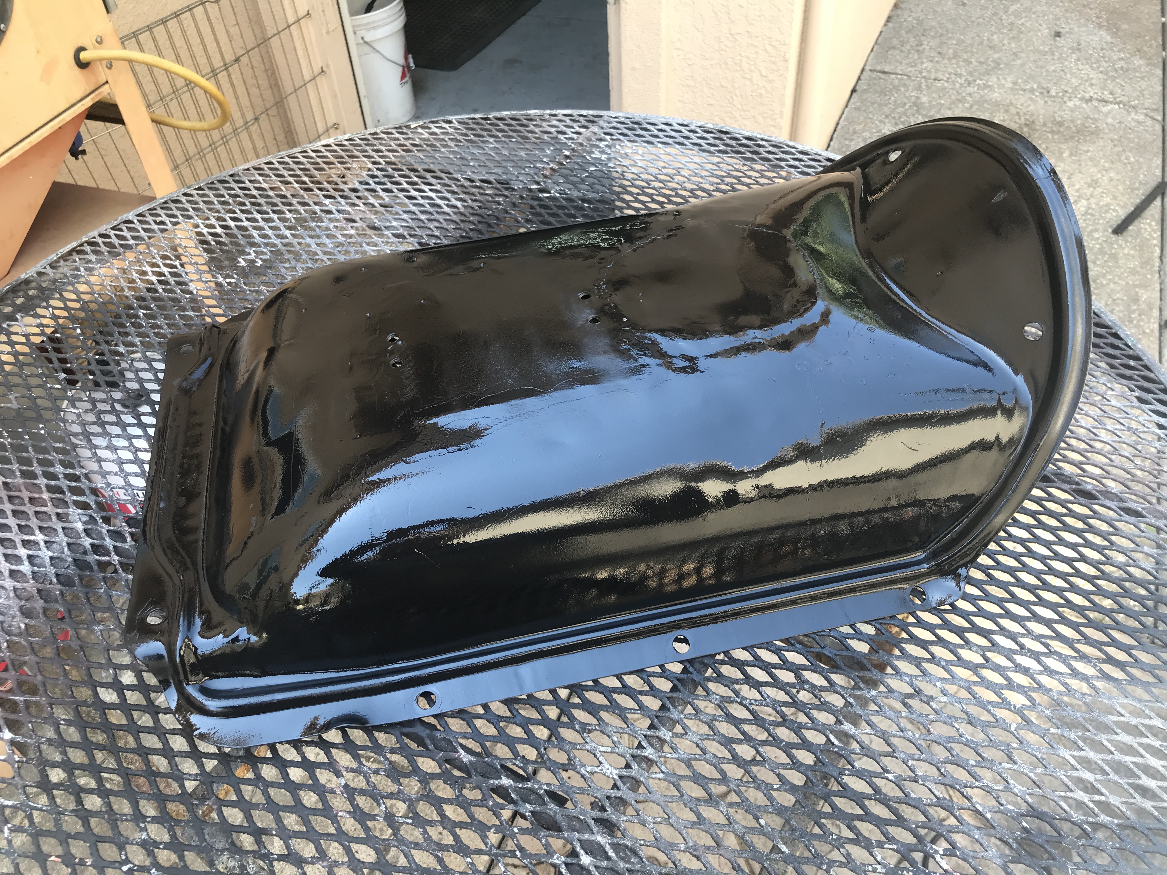

Post by Gregski »
"Paint it black, and put it back"
~ Lucky Costa
I just bombed it with black to get rid of the white, it will get a nice coat of textured rubbarized stuff to match the inside of the cab

Post by Gregski »
a trial fit

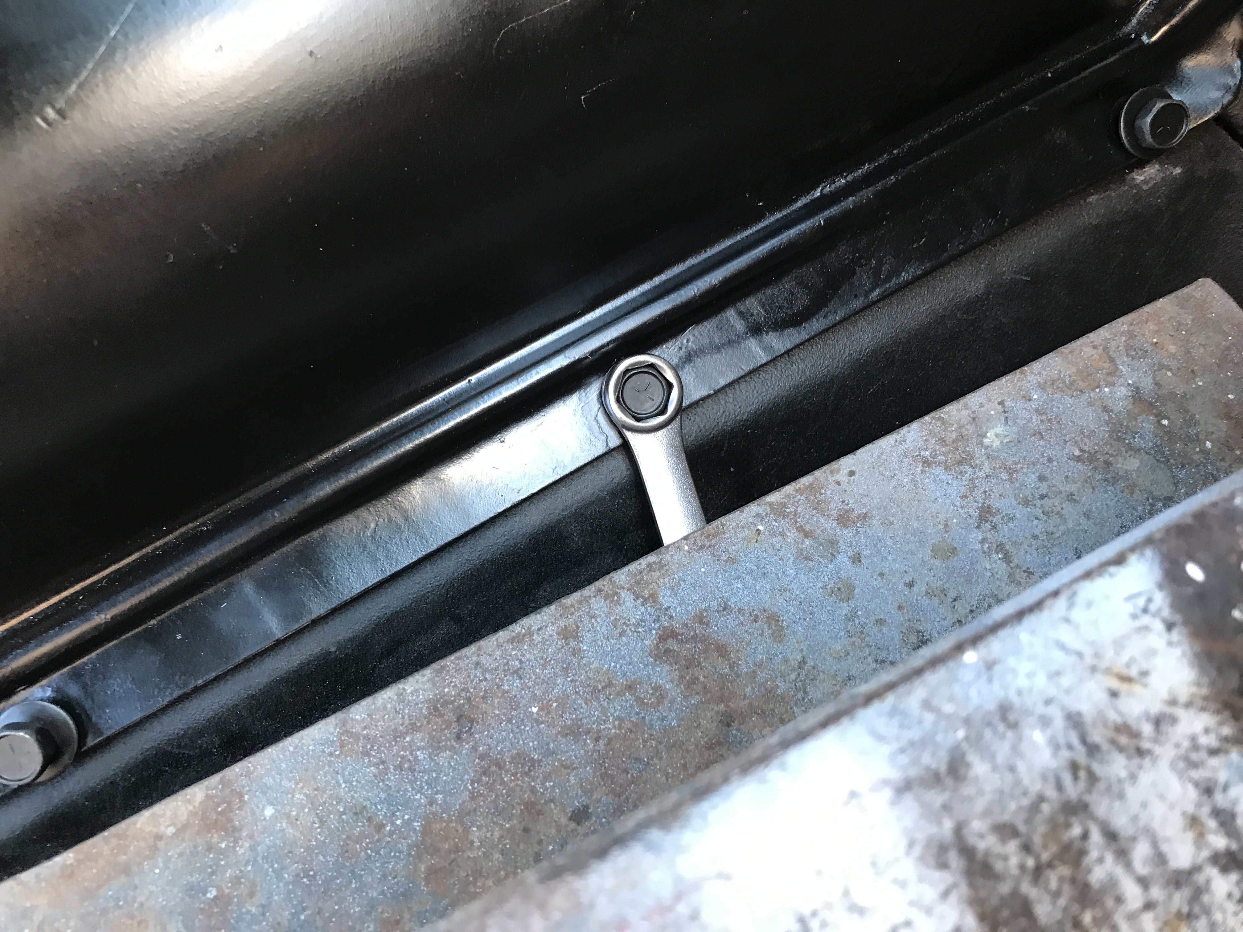

Post by Gregski »

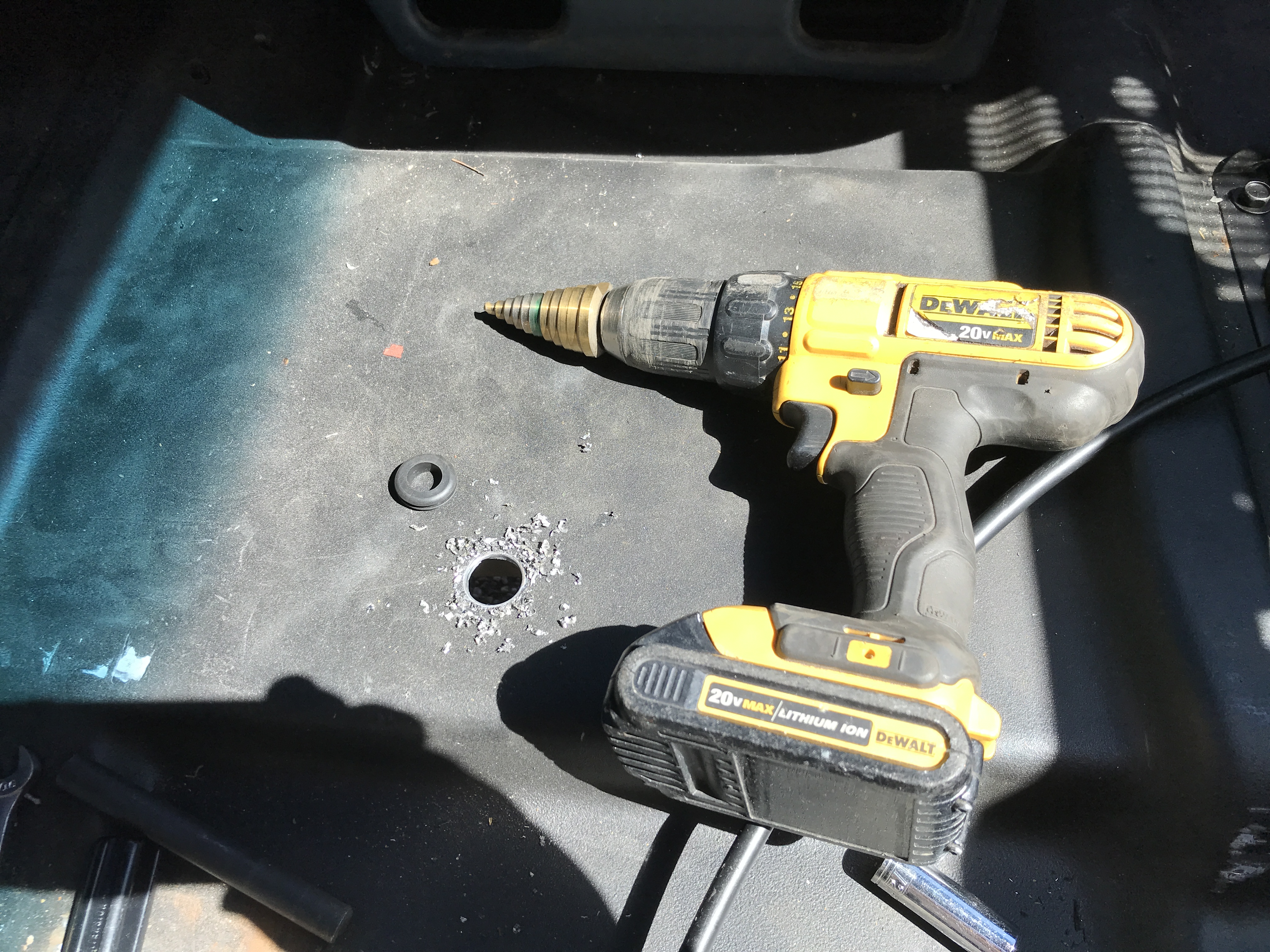

nothing like drilling new holes in the floor you spent days filling holes in

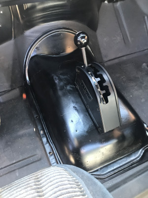

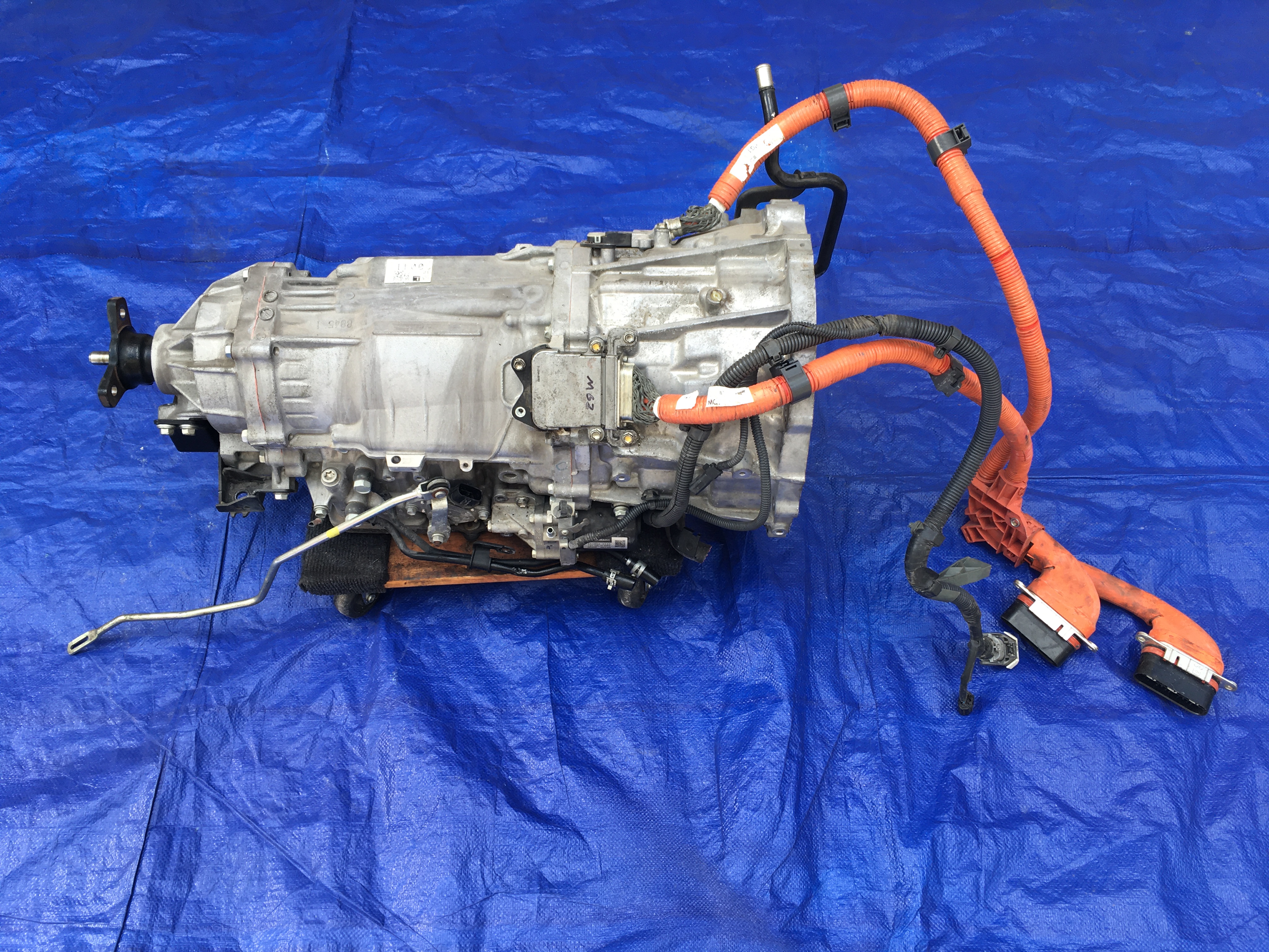

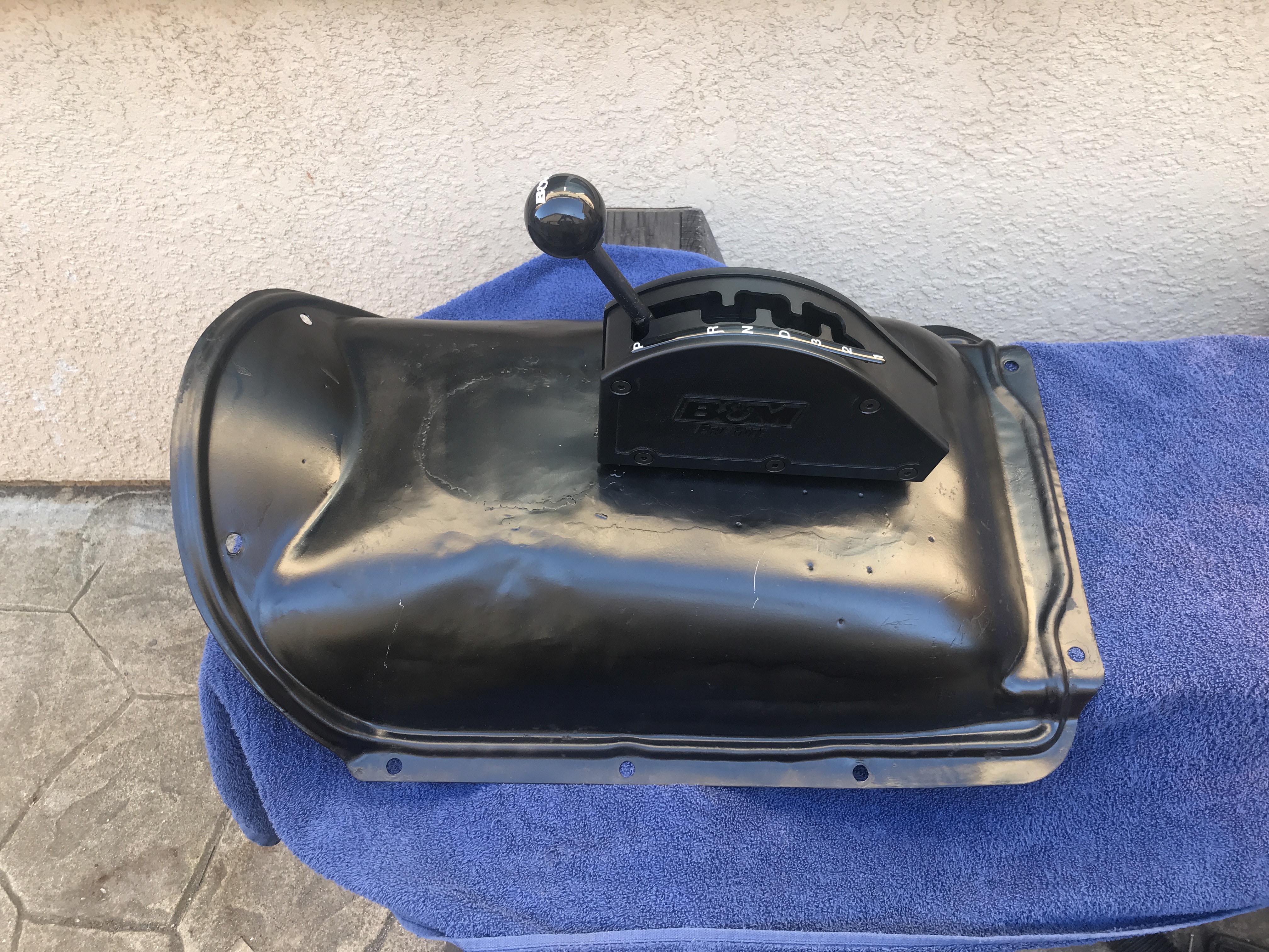

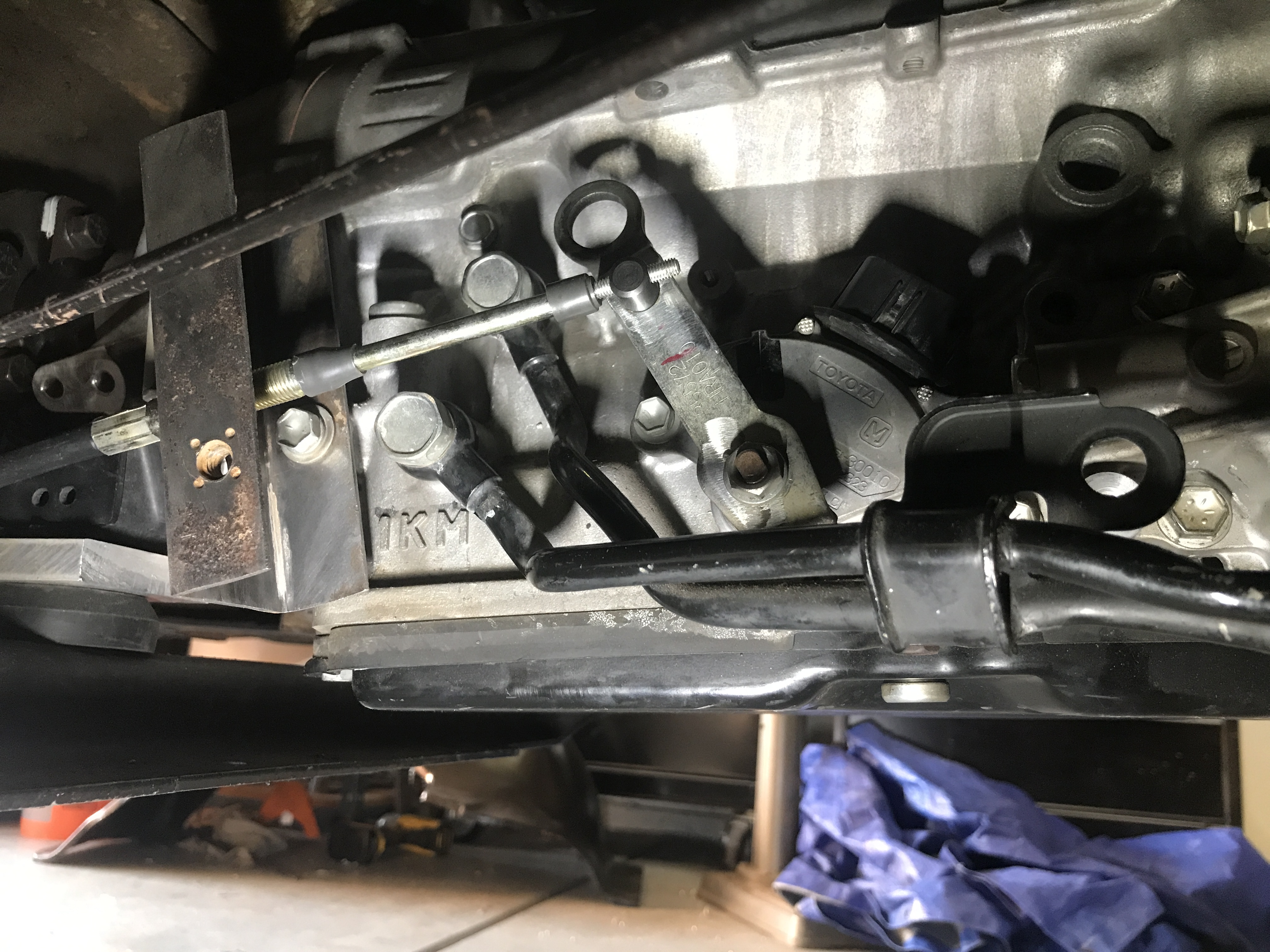

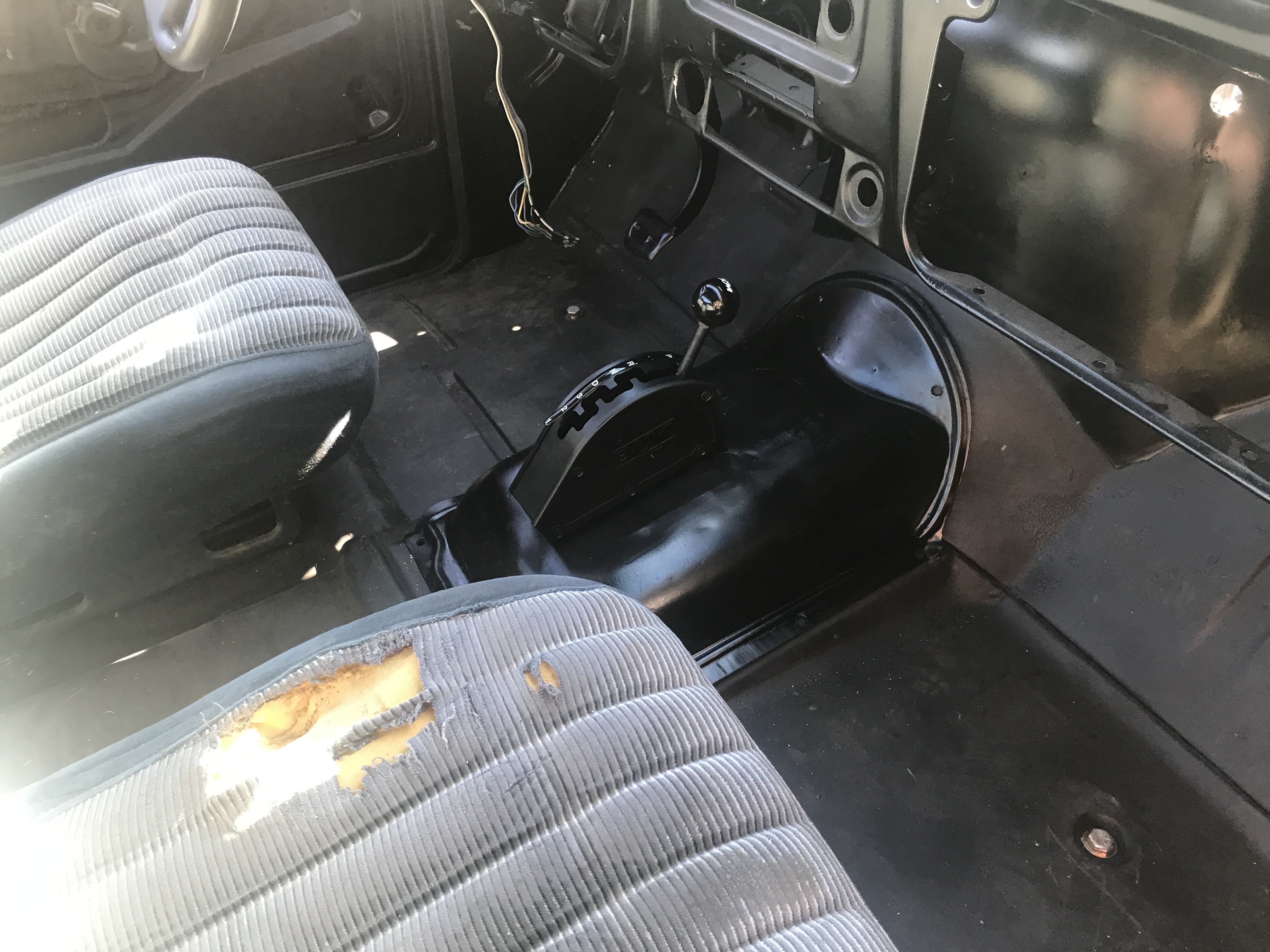

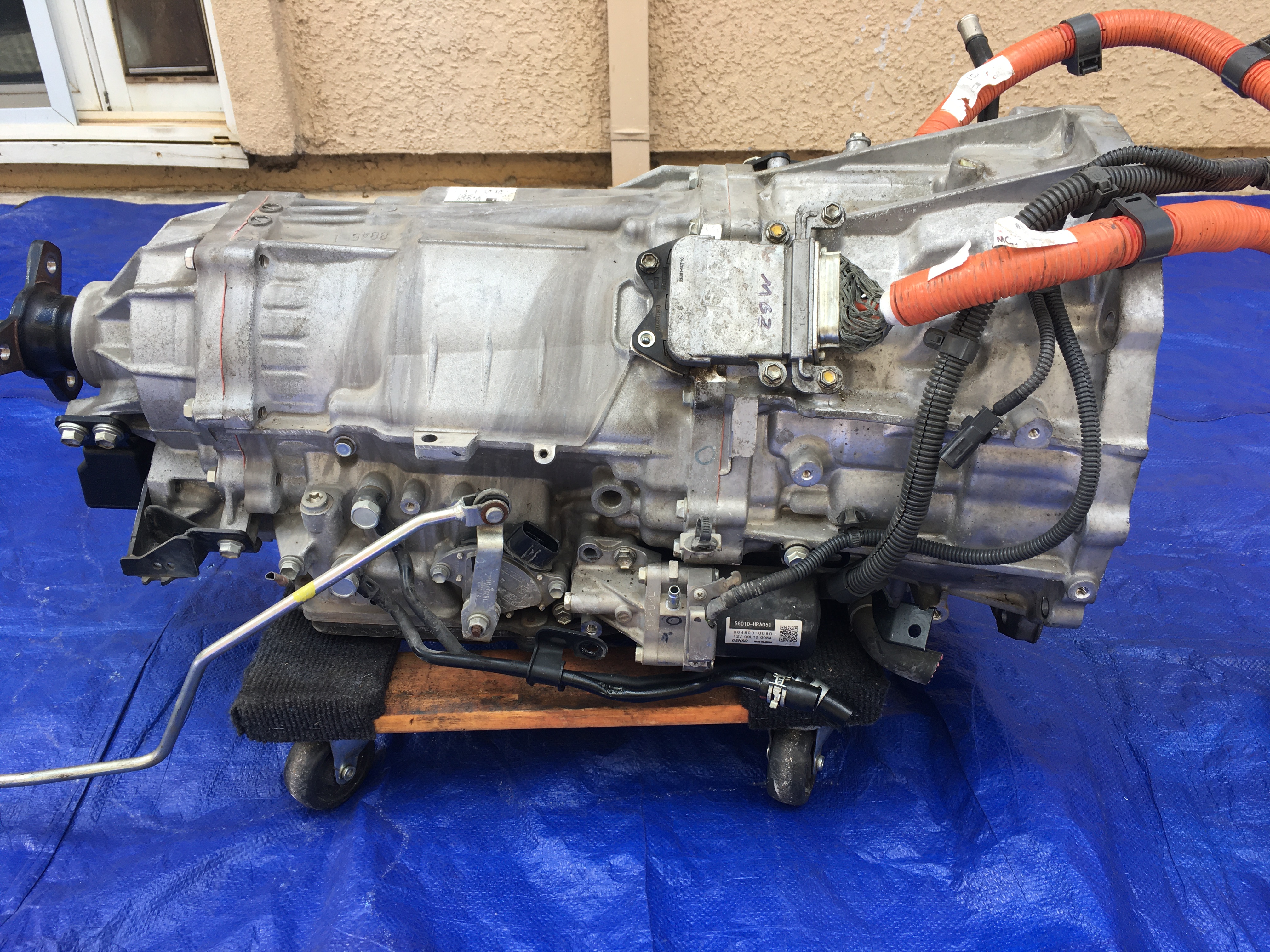

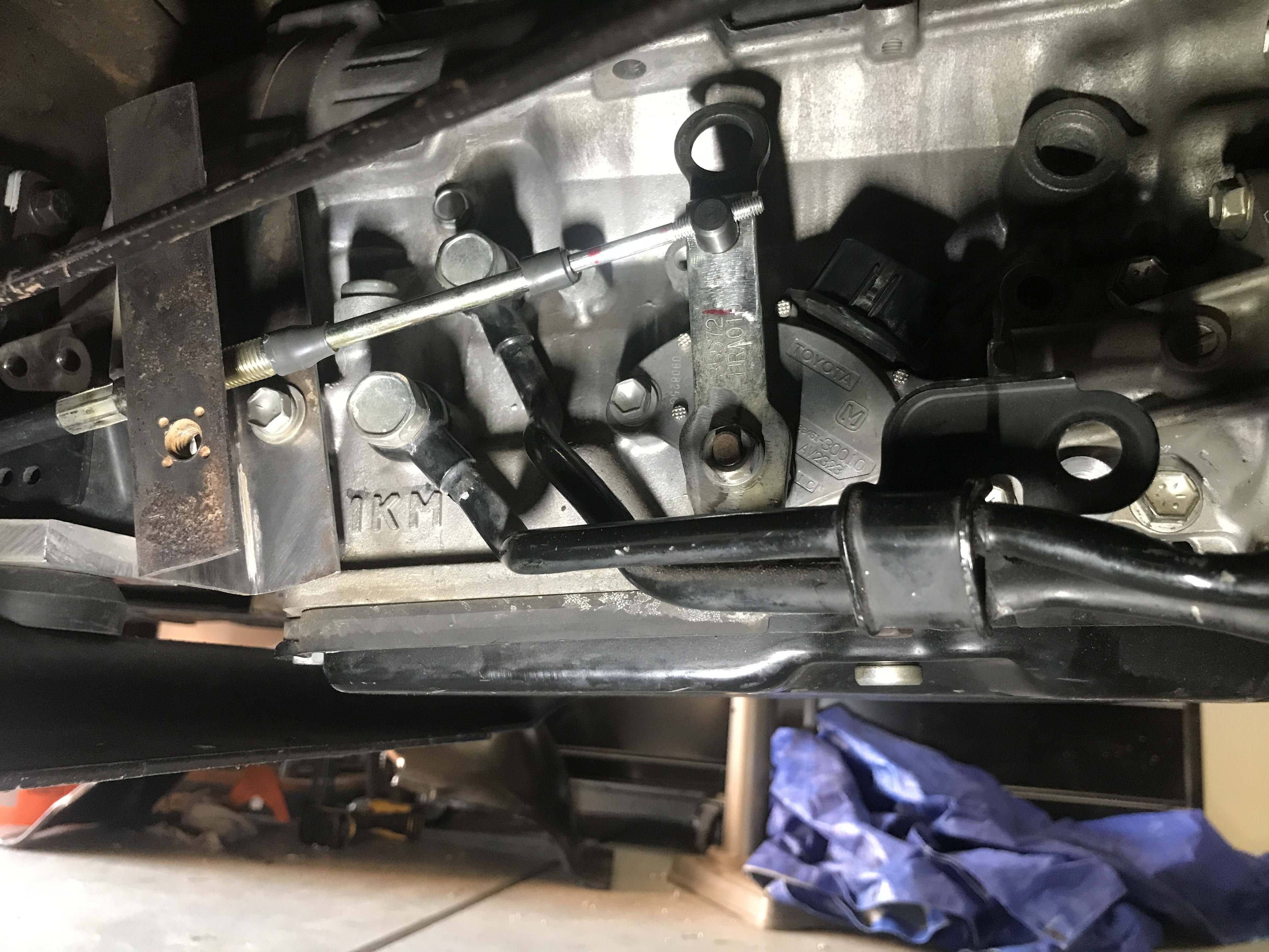

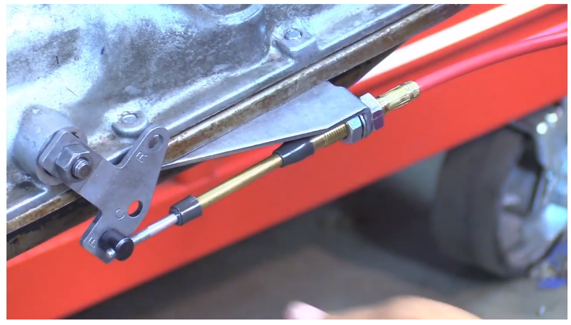

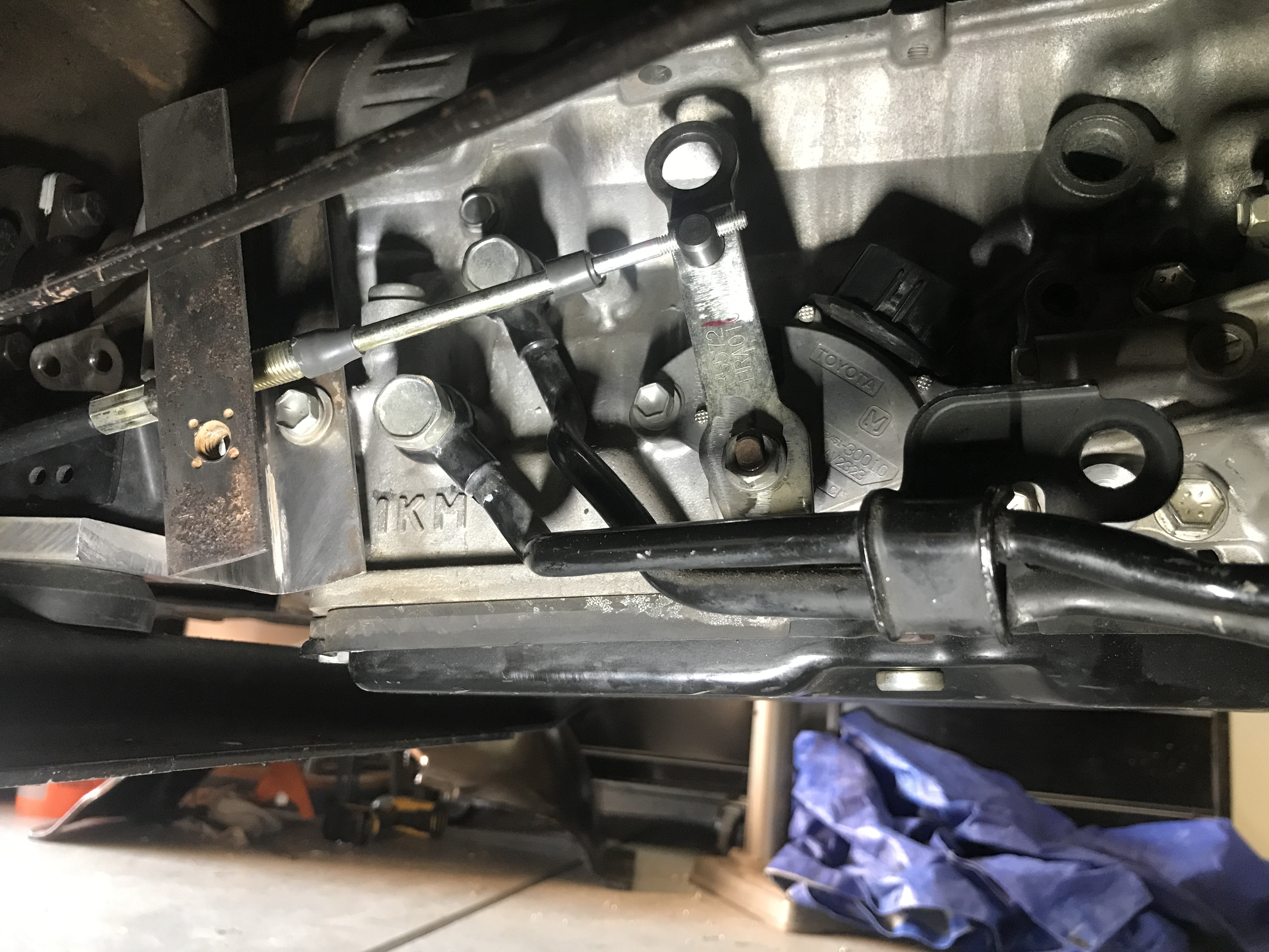

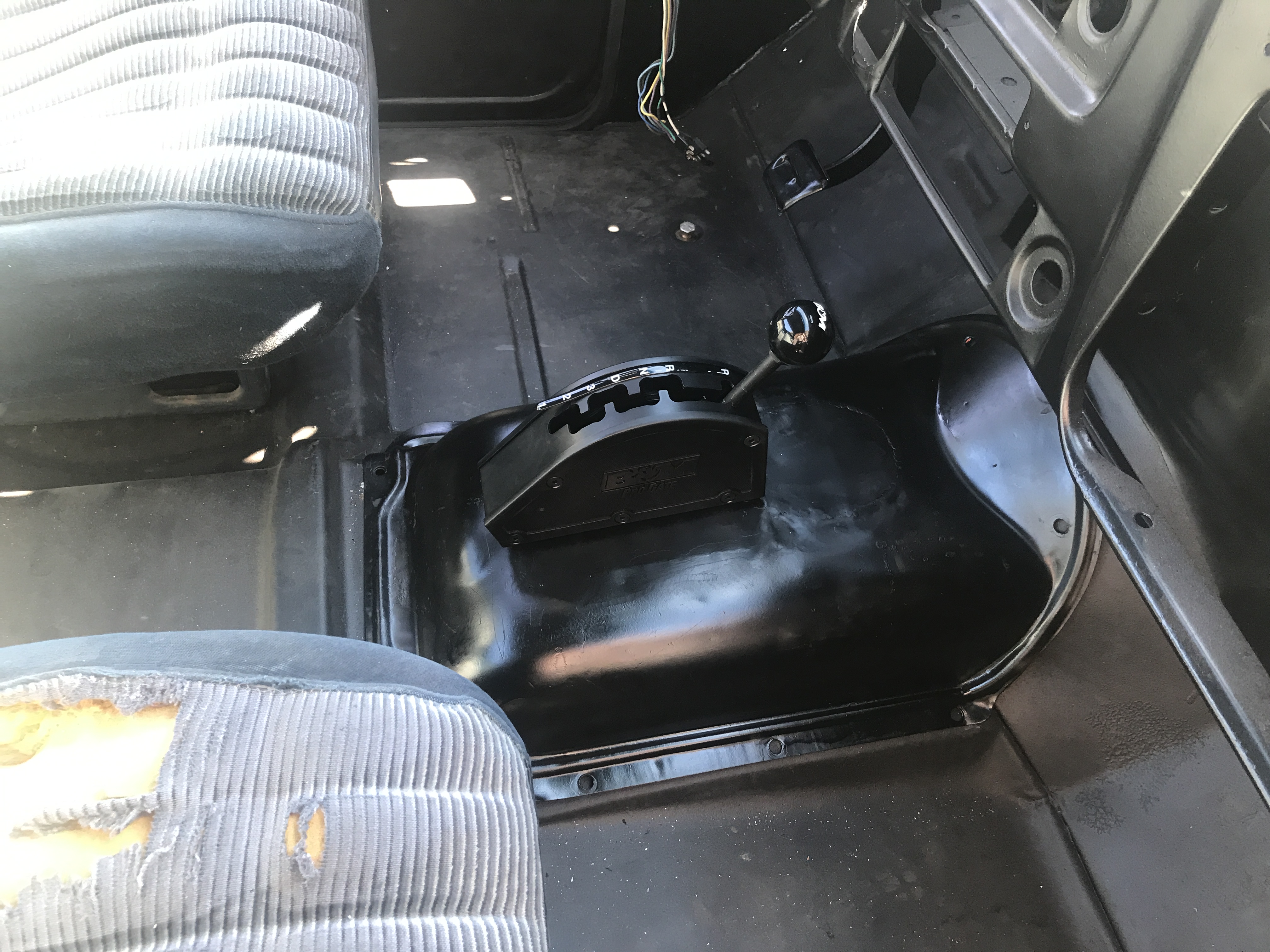

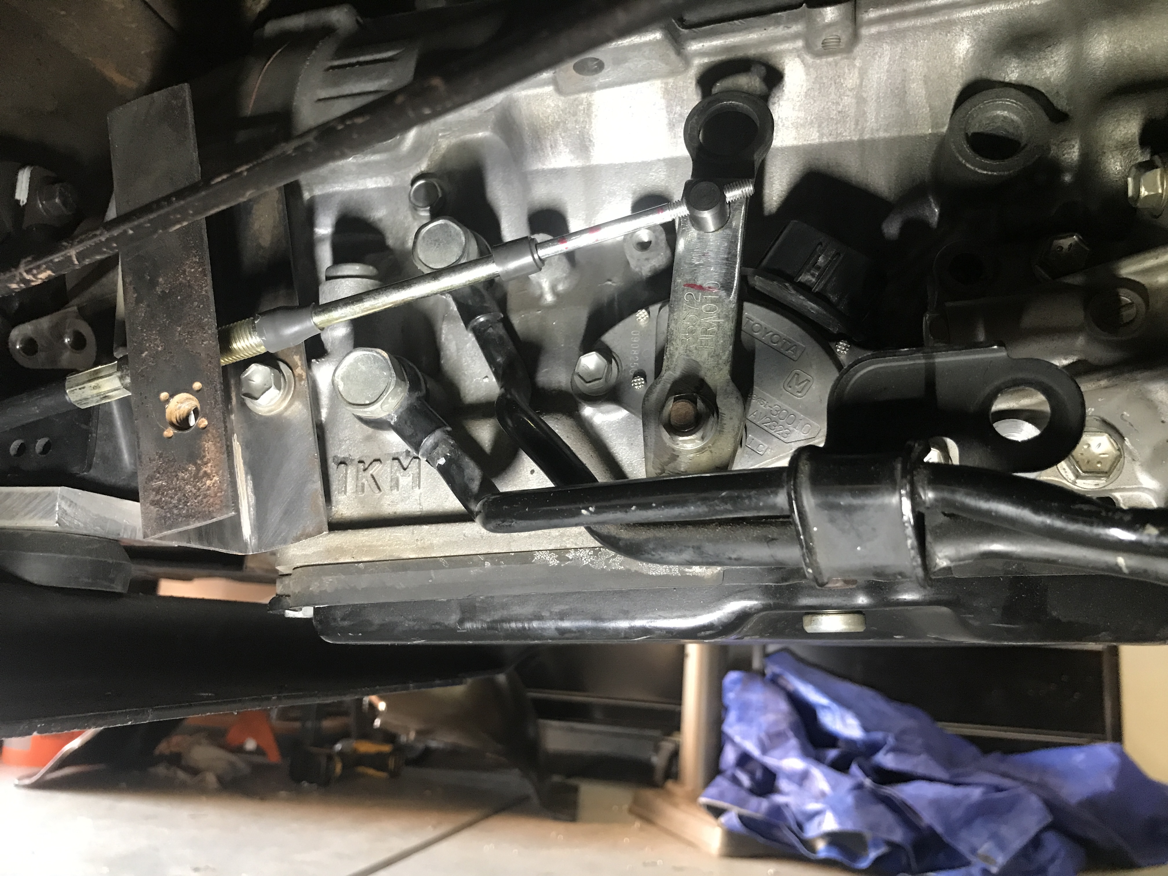

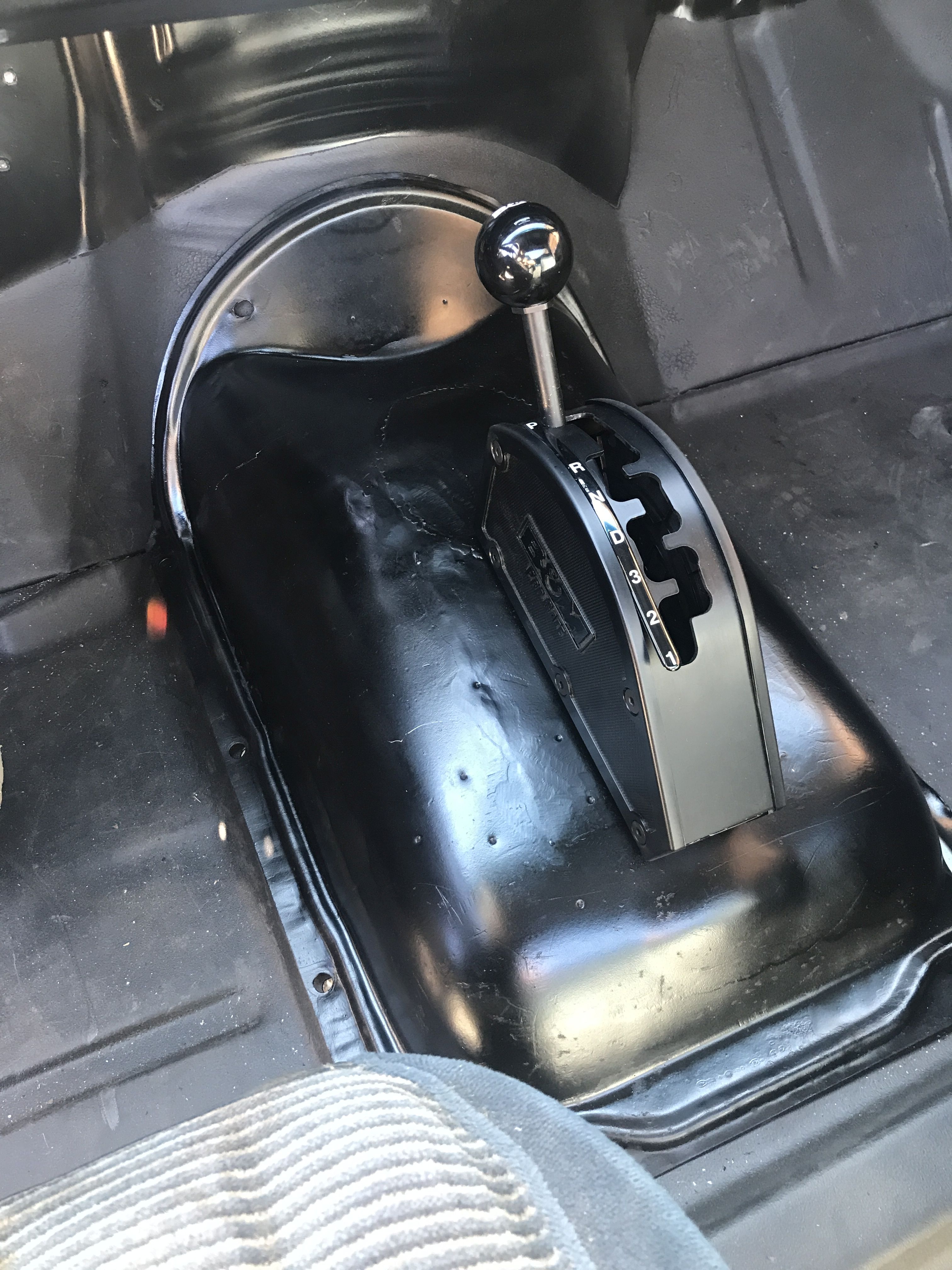

so Our Mission should we choose to accept it: is to take a Lexus GS450h passenger side rod linkage automagical transmission and install it in a Chevy C10 manual transmission cab using a precision made aftermarket driver side cable operated shifter
Gregski
Posts: 3157
Post by Gregski »
reserved for some pics of the finished transmission cable linkage if and when my friends show up to help me, one says he has a cracked rib from working on his friend's GTzero and the other claims to have fallen off his bicycle into some strategically placed poison oak [again]
This is using B&M push pull cable designed for a dime a dozen American GM Turbo TH350 three-speed transmission
PARK
REVERSE
NEUTRAL
DRIVE

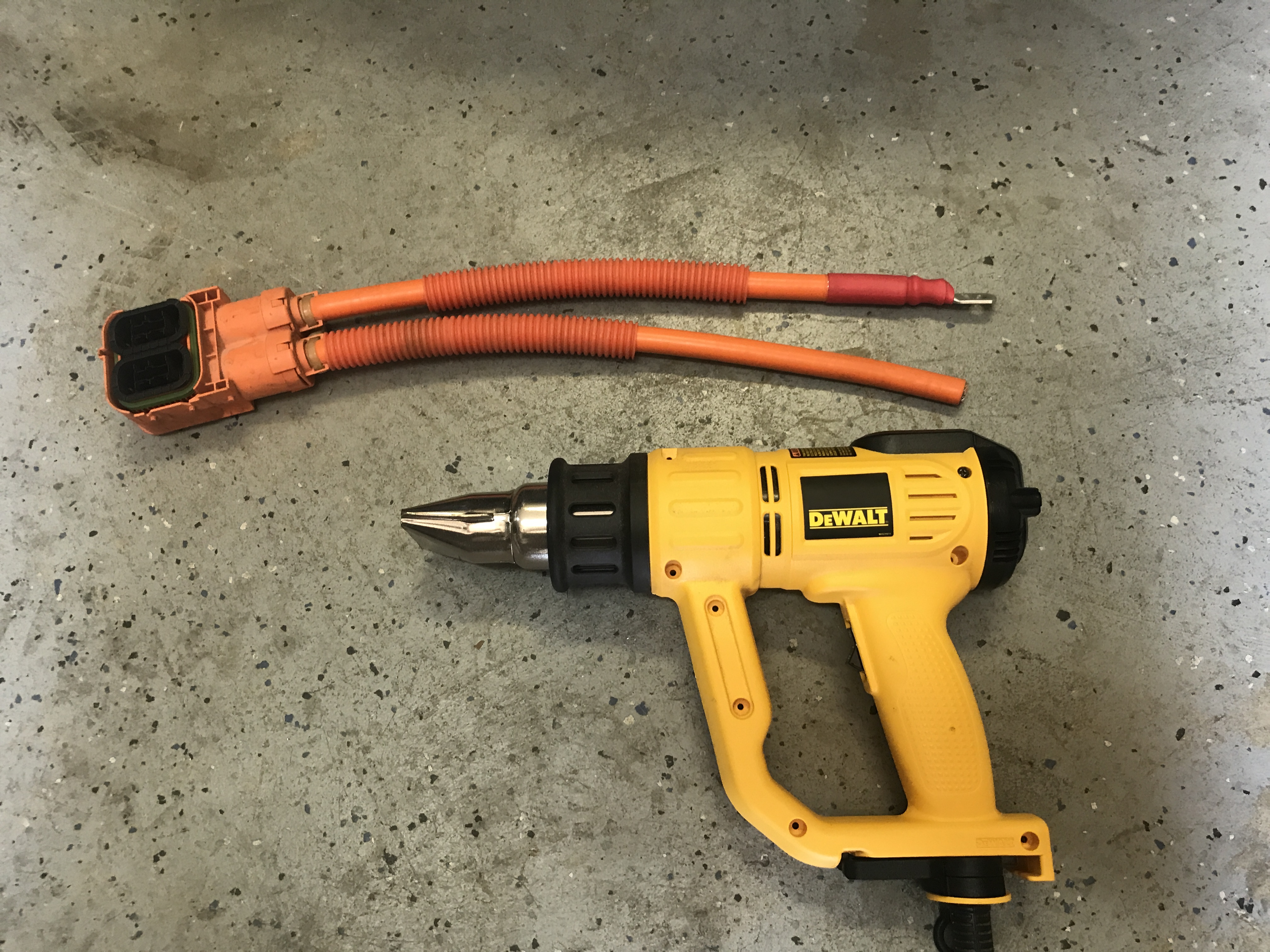

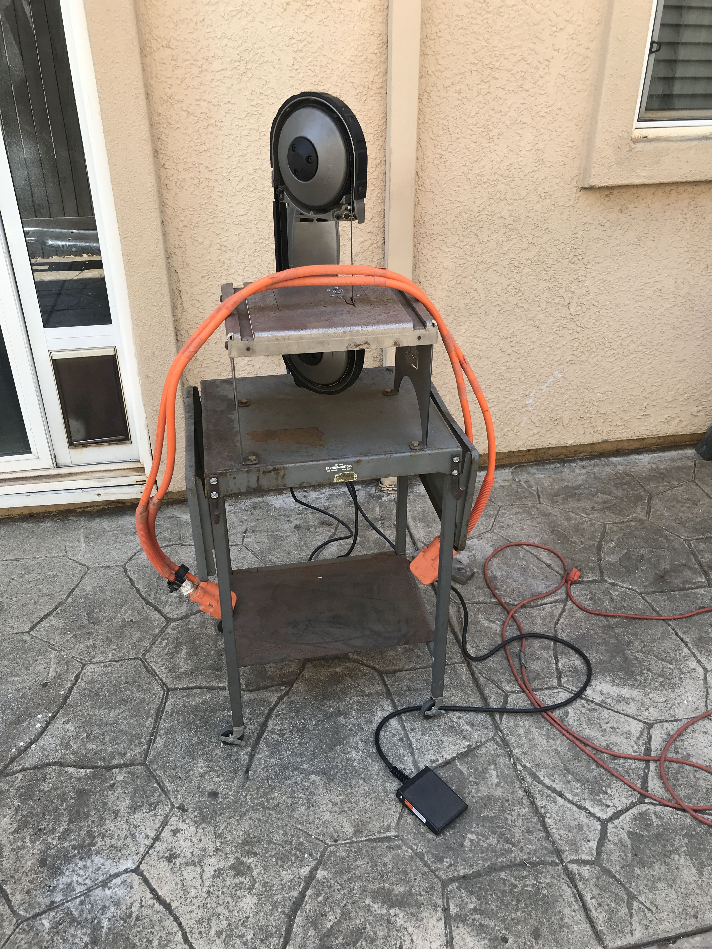

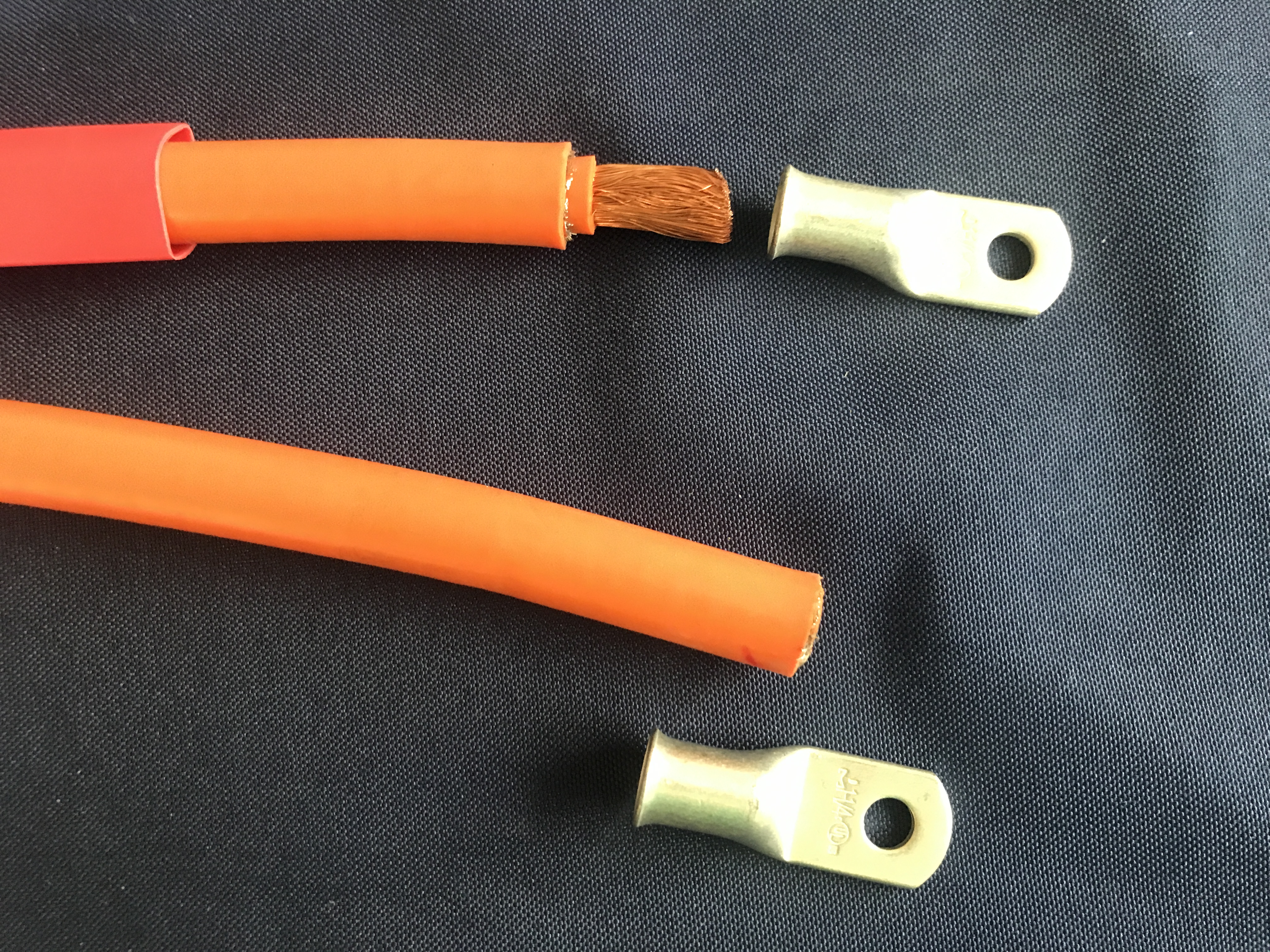

Post by Gregski »

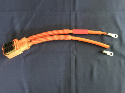

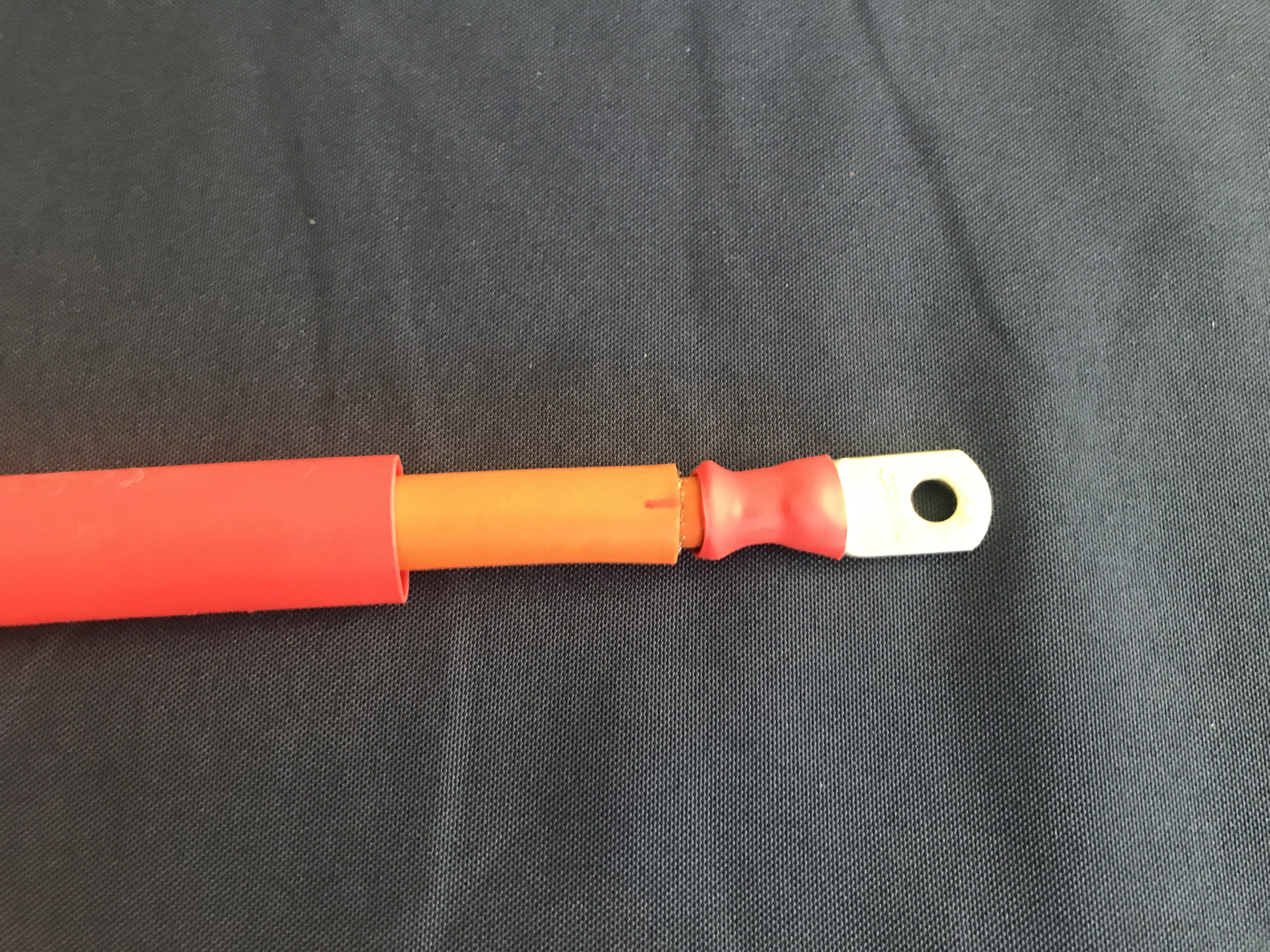

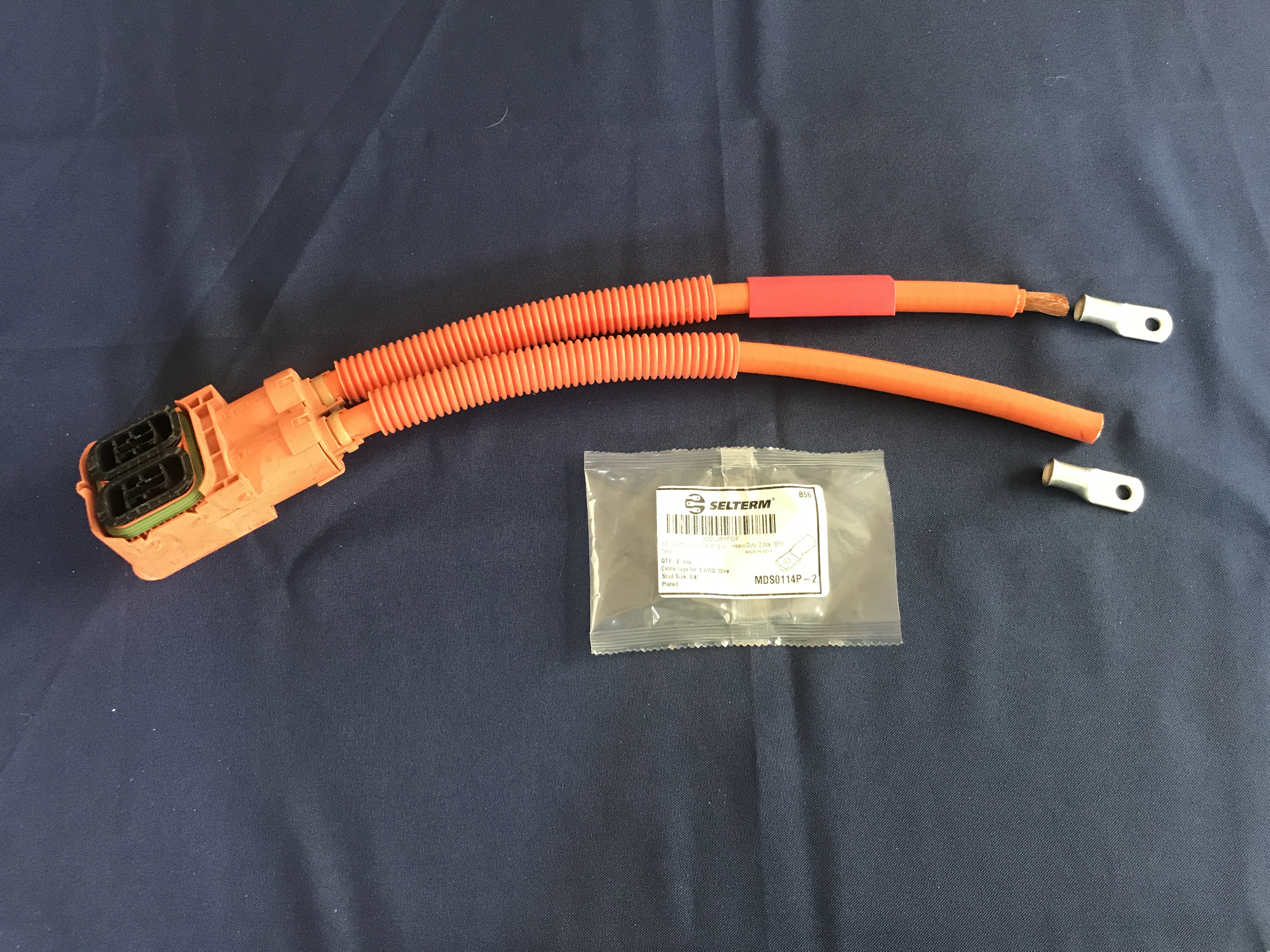

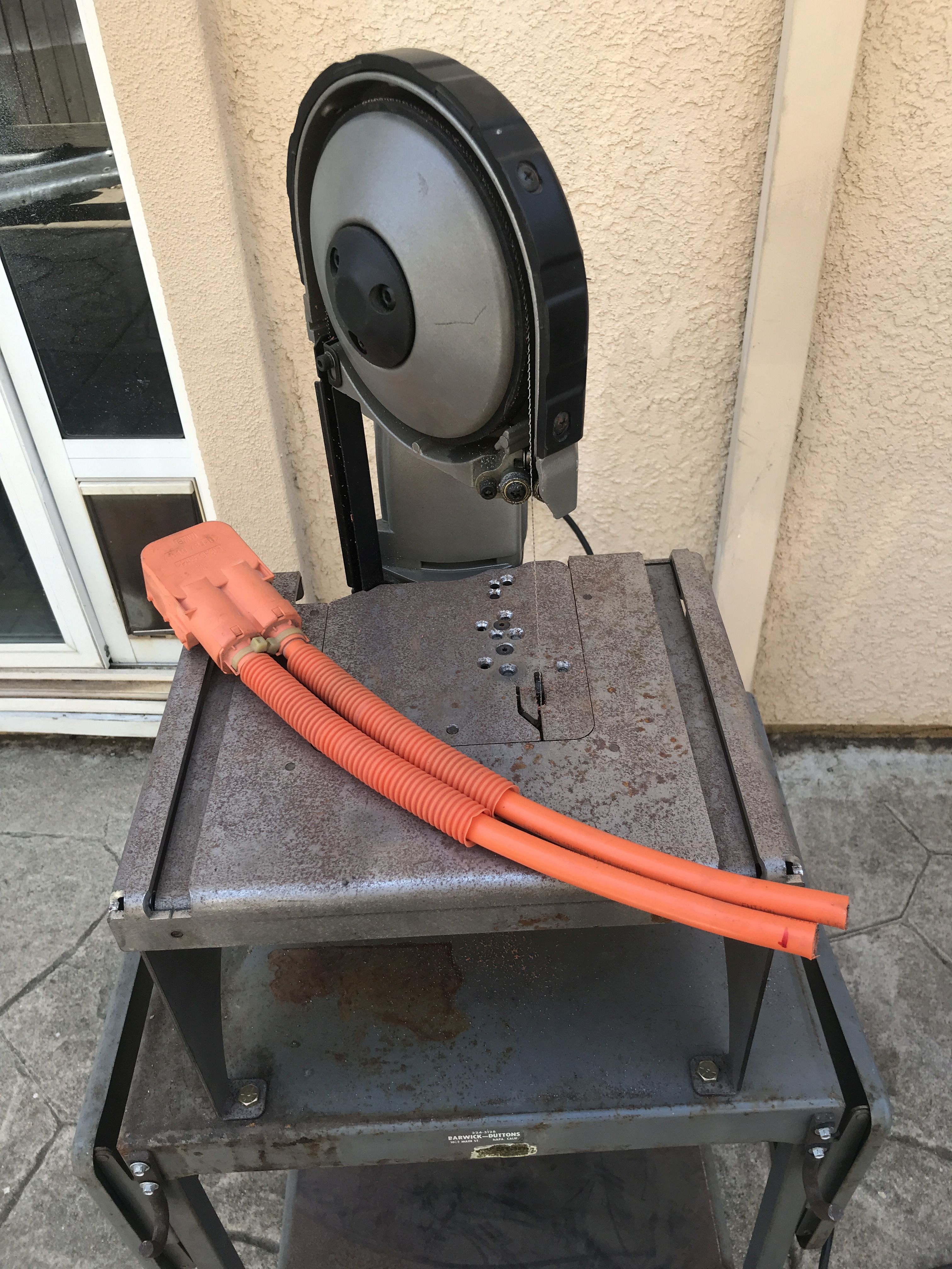

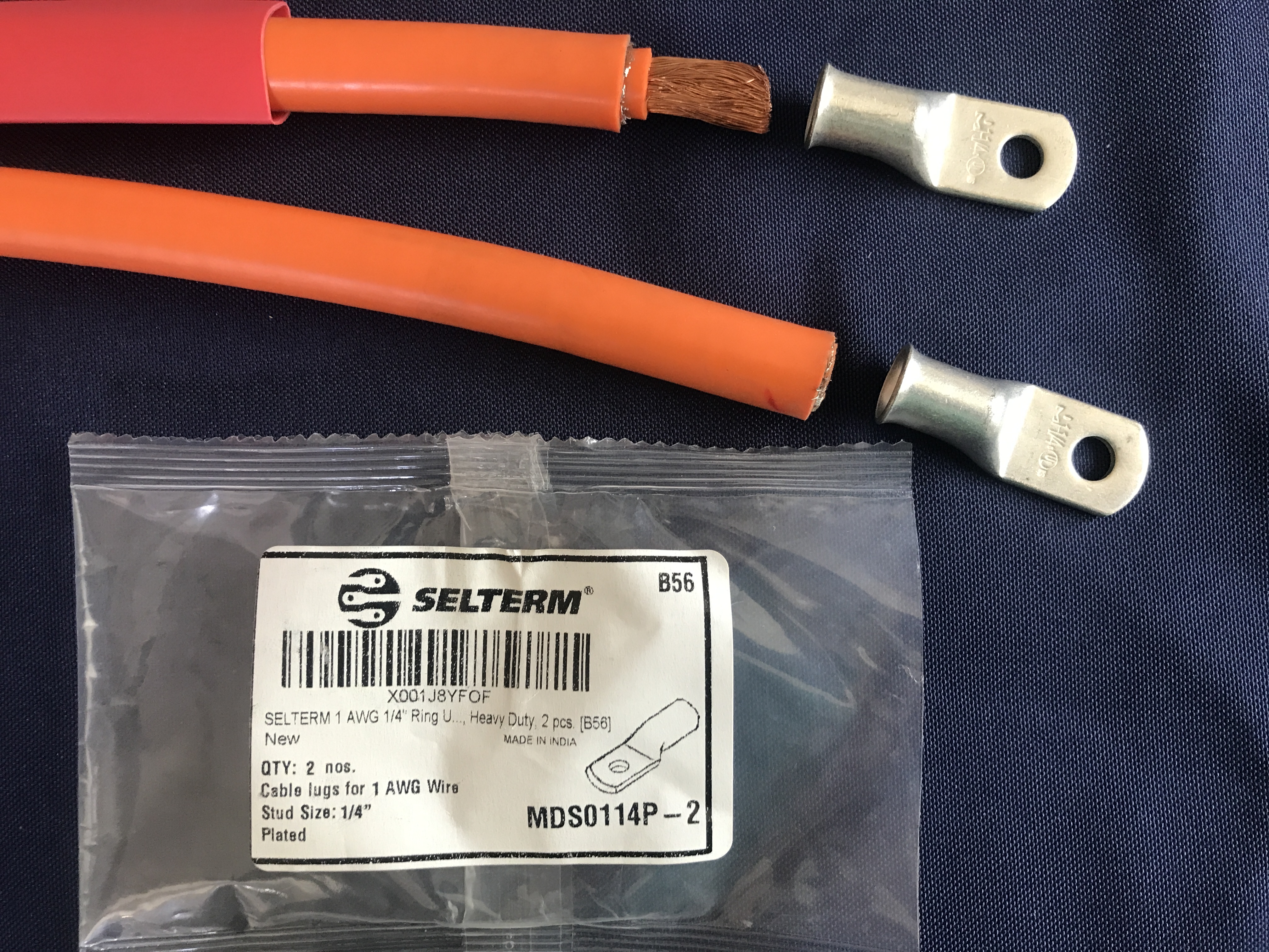

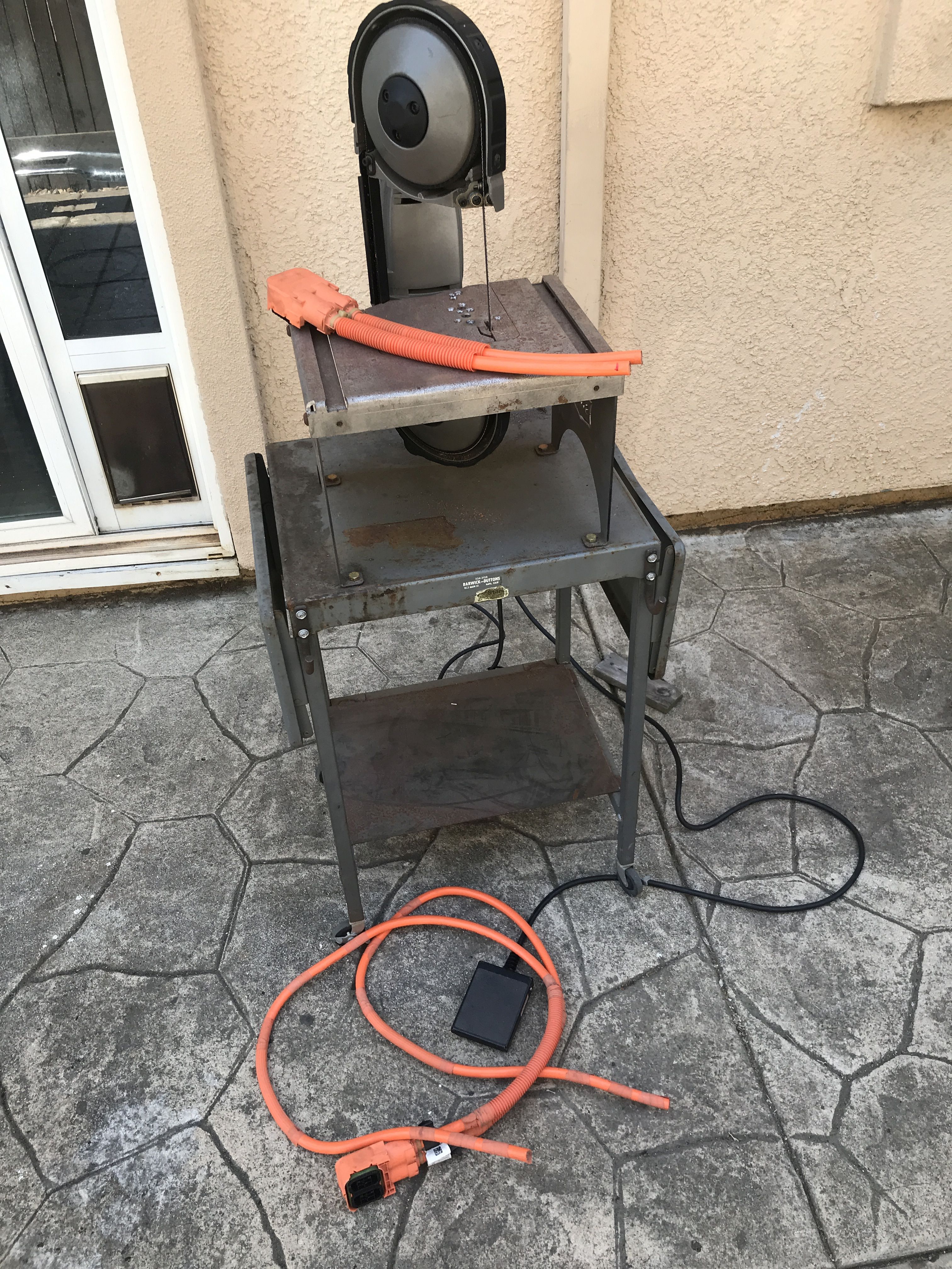

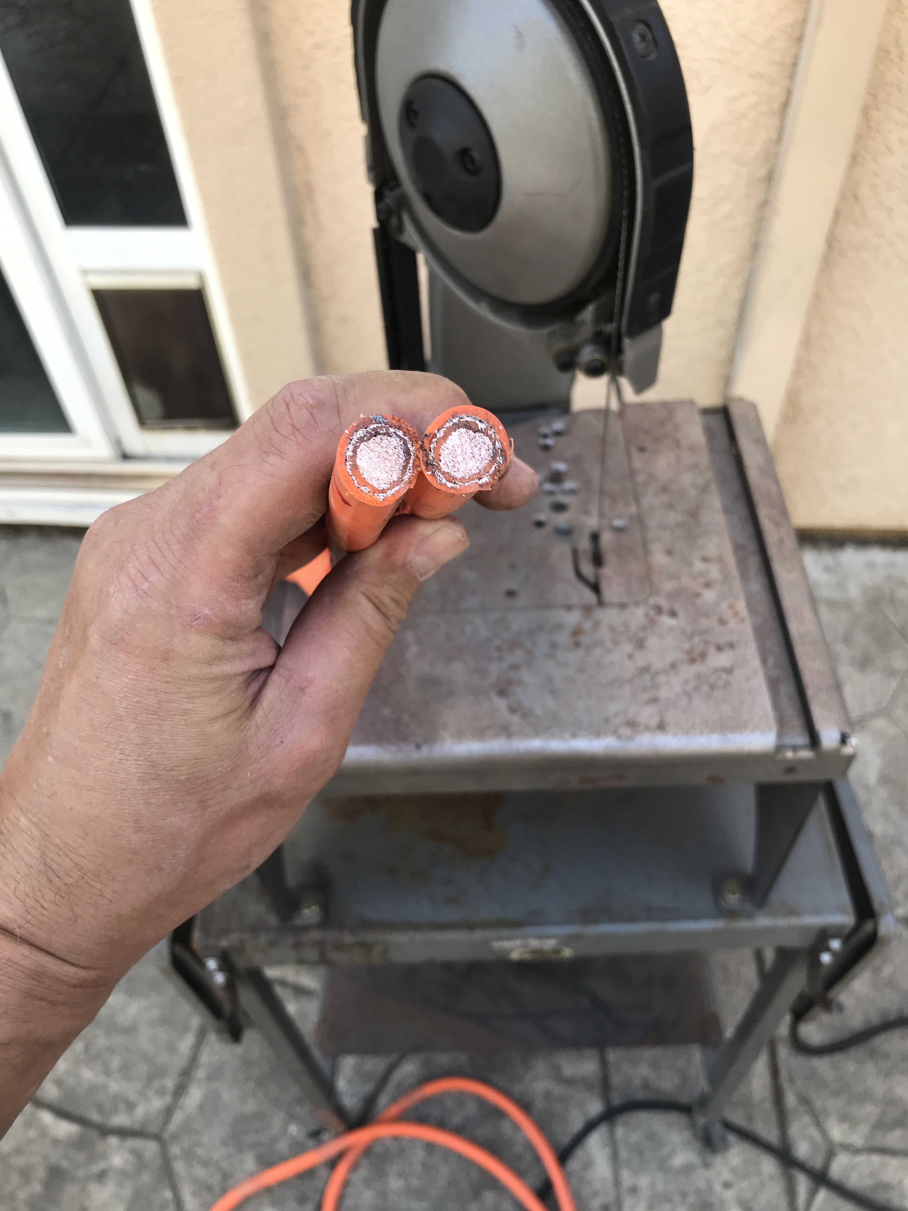

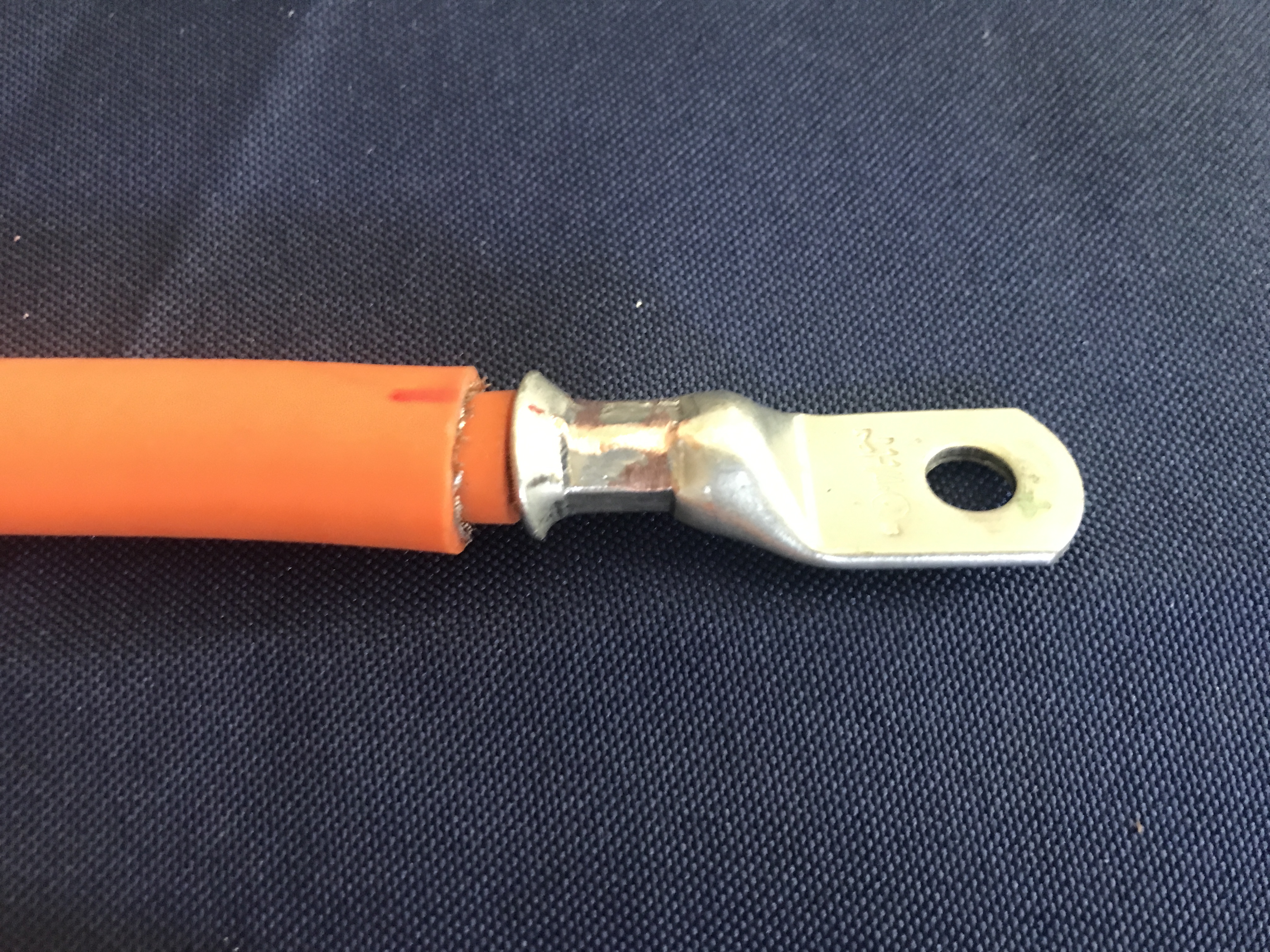

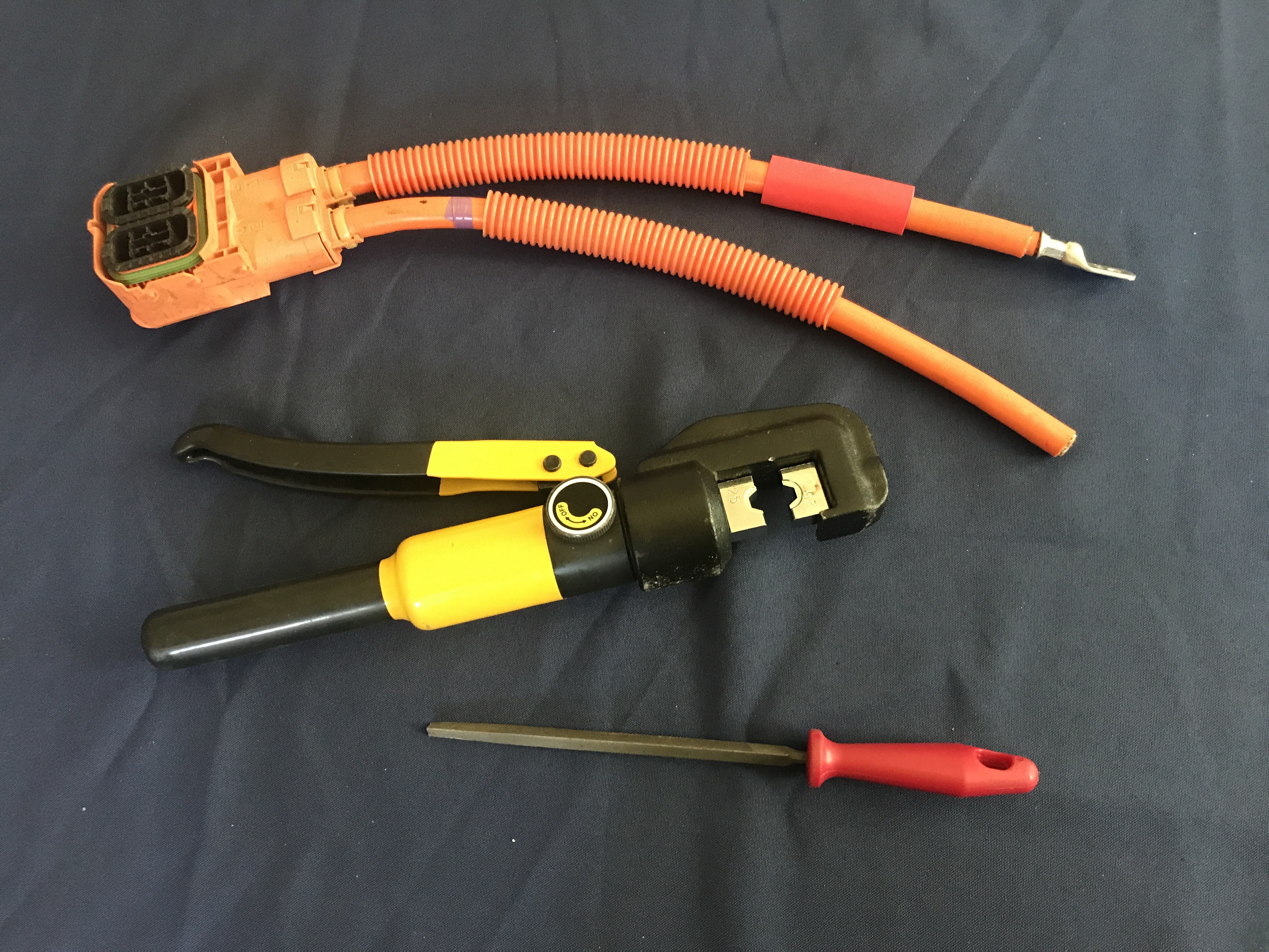

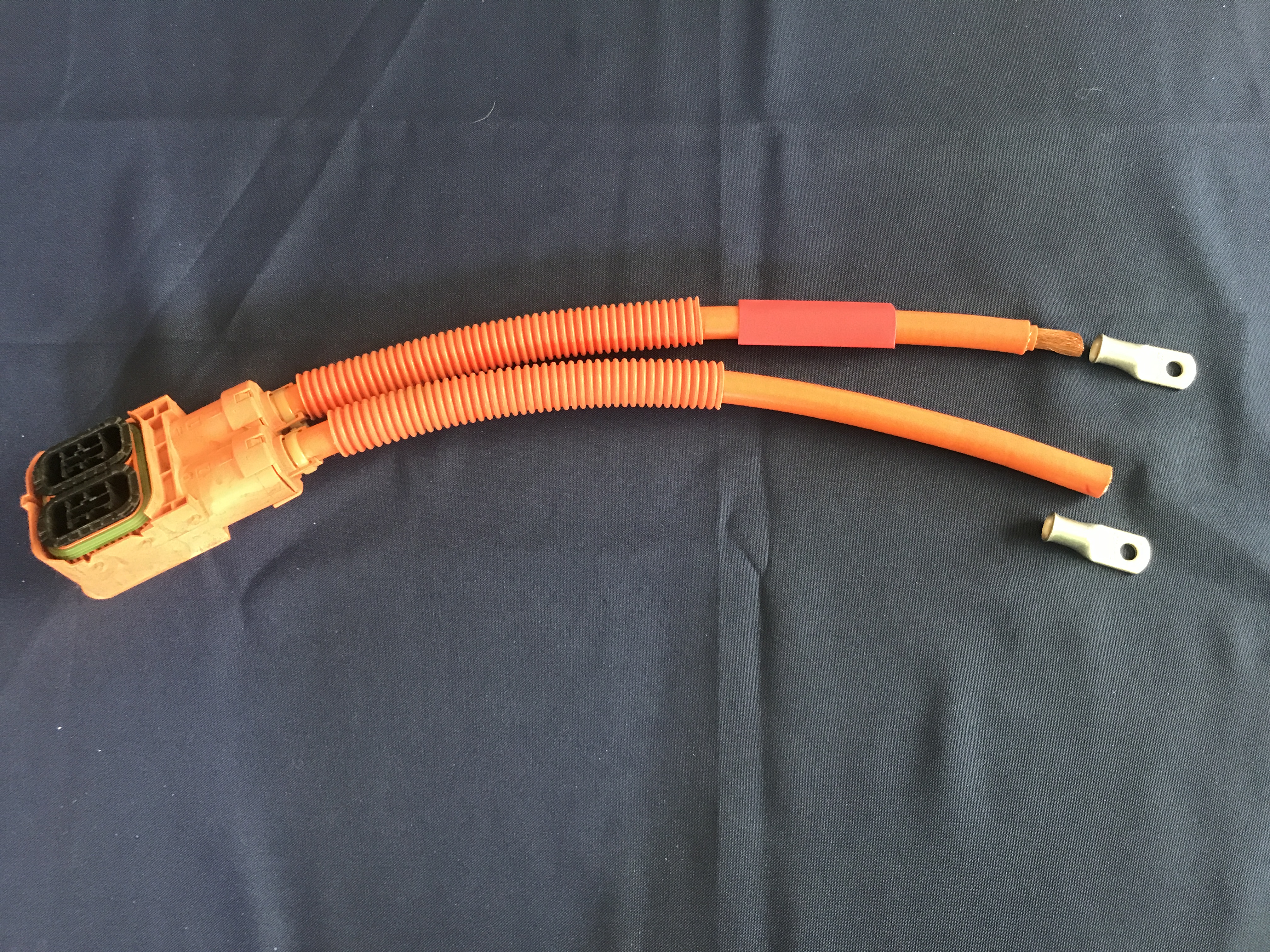

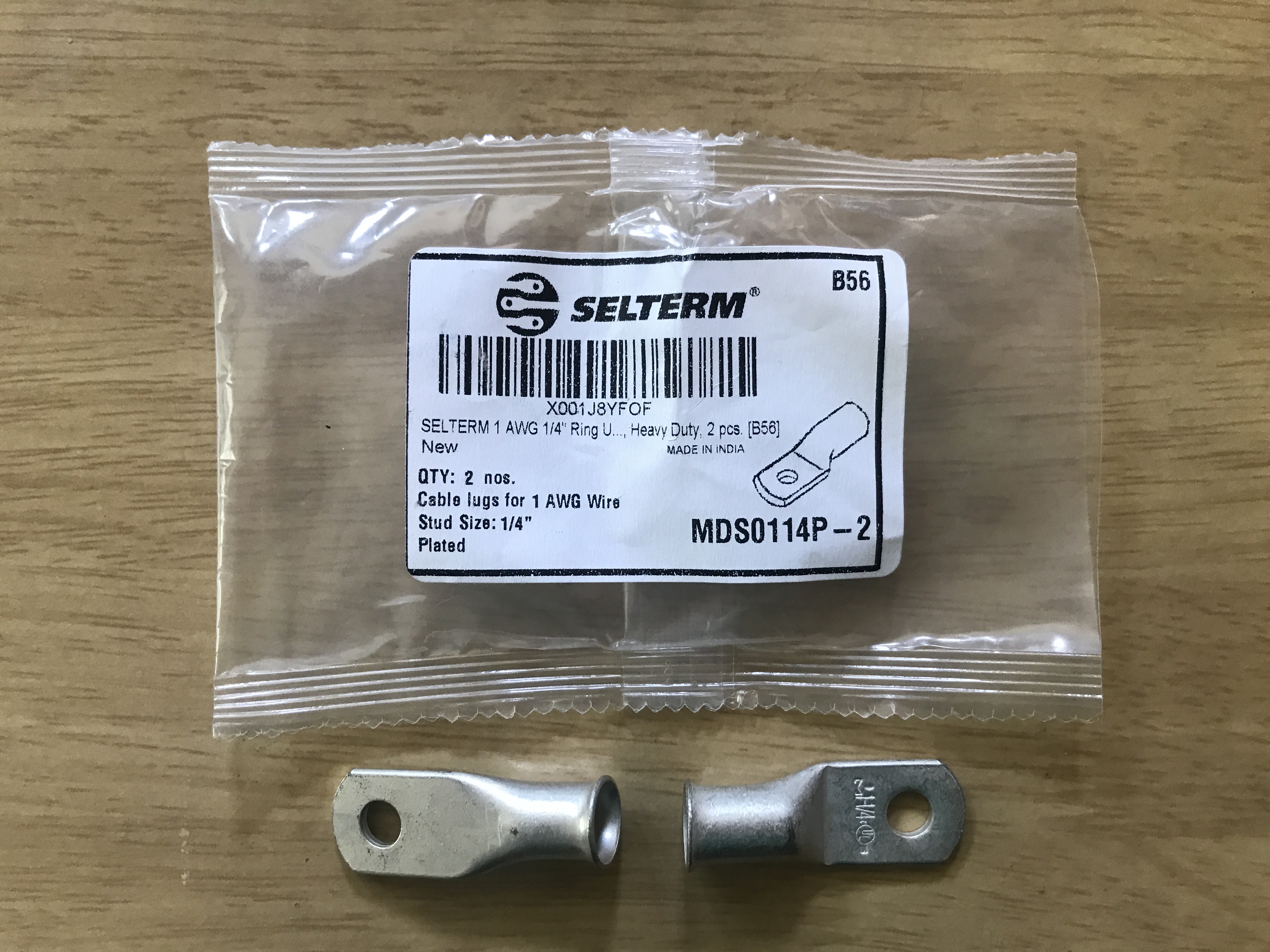

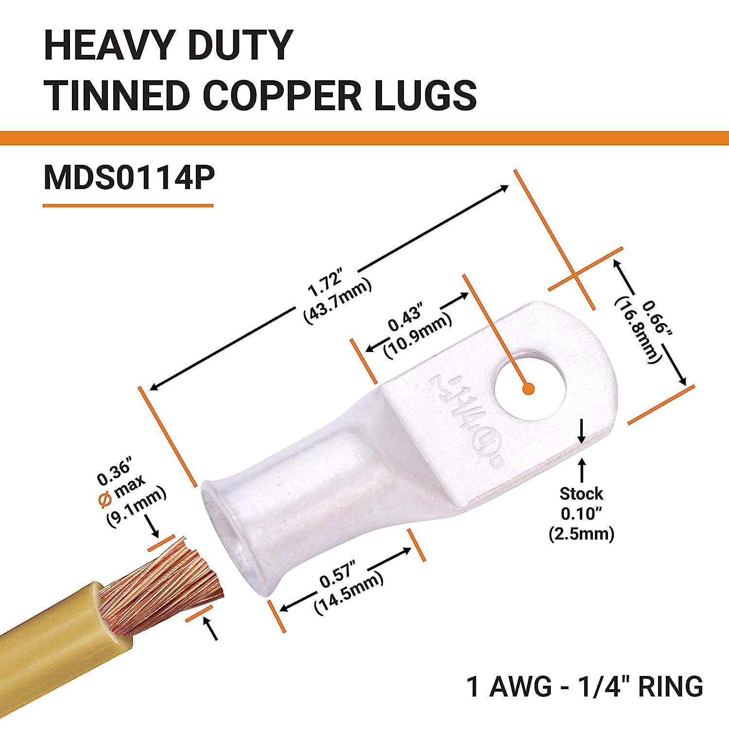

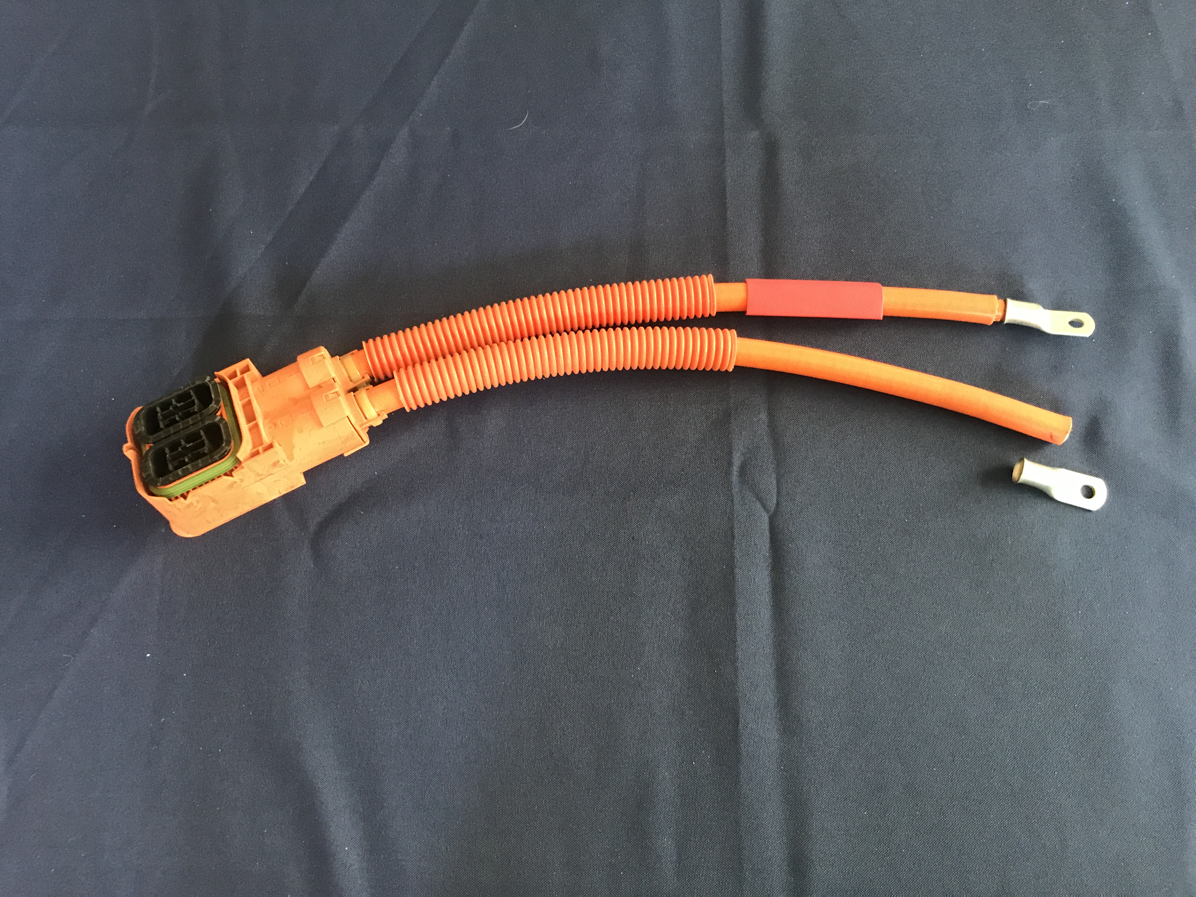

this is not for the faint of heart, lopping off about a foot of the OEM BMW 530e hybrid battery cable
What AWG would you say this is ?
I calipered the diameter of this OEM BMW 530e hybrid battery pack cable at 9 mm

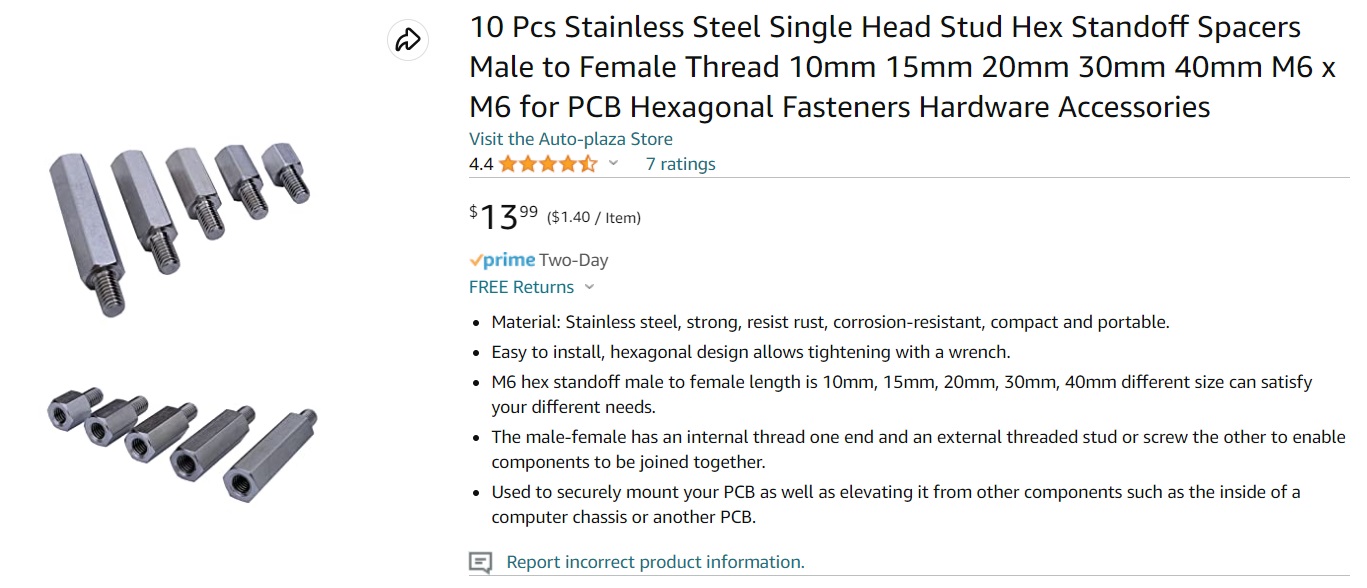

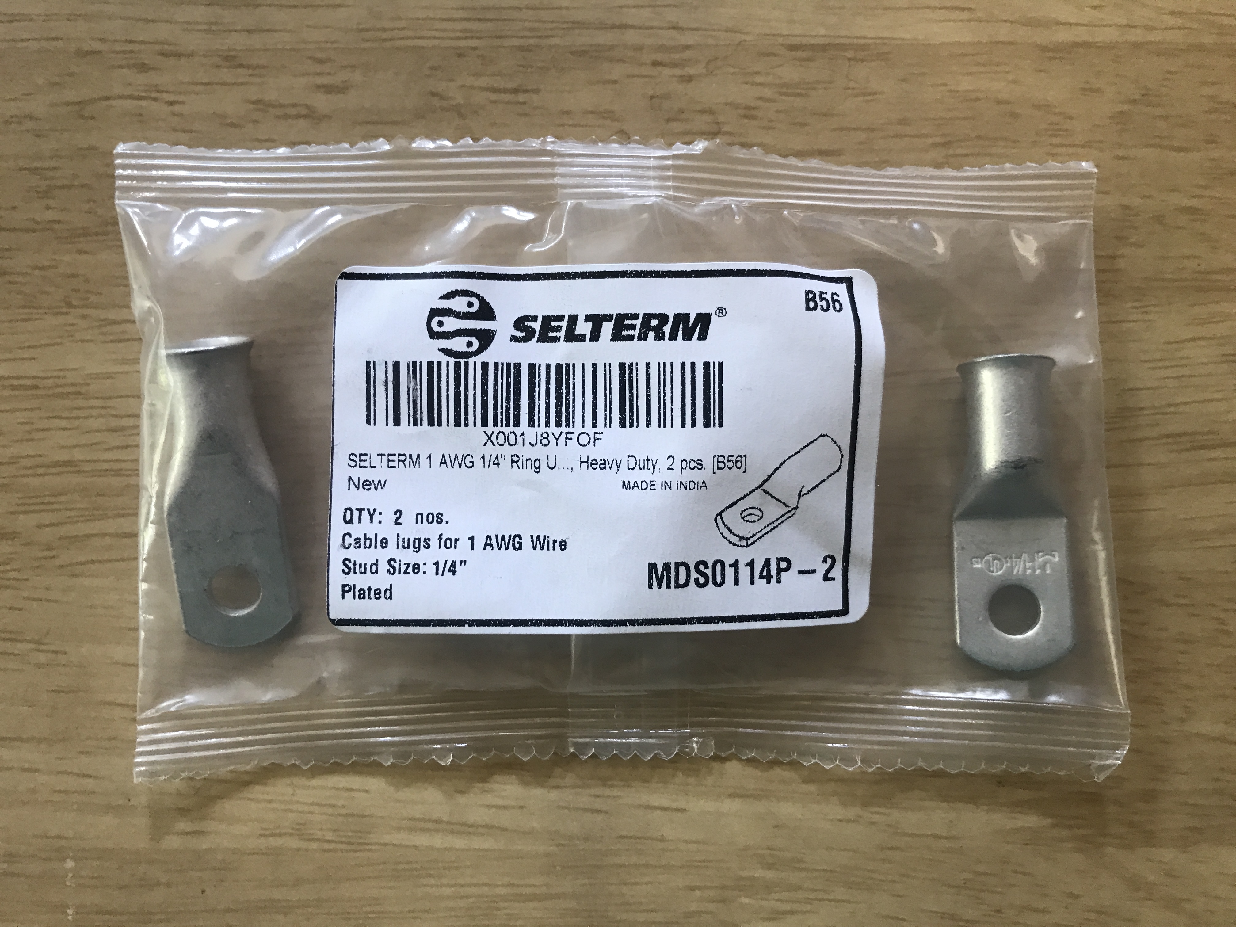

Post by Gregski »

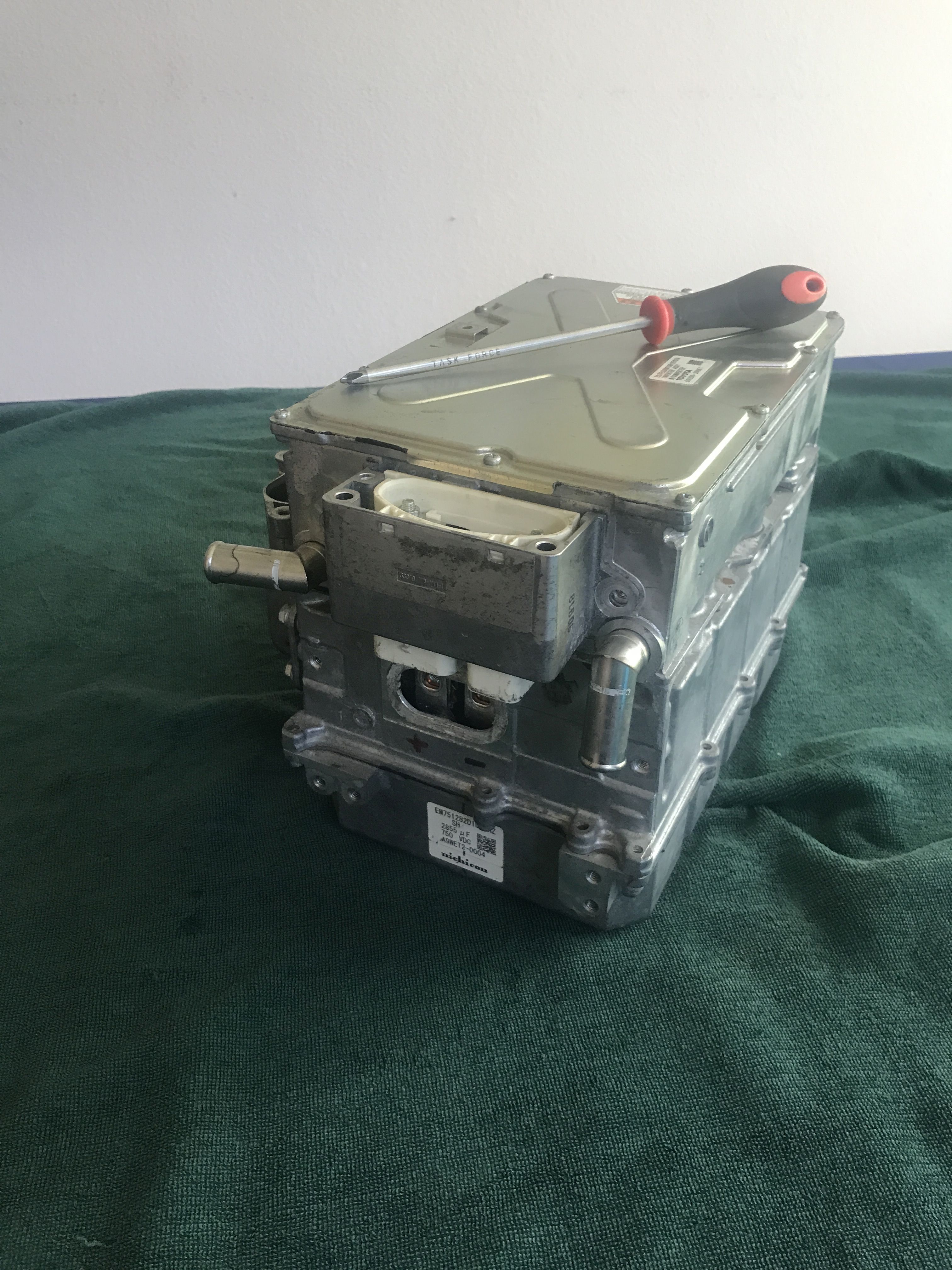

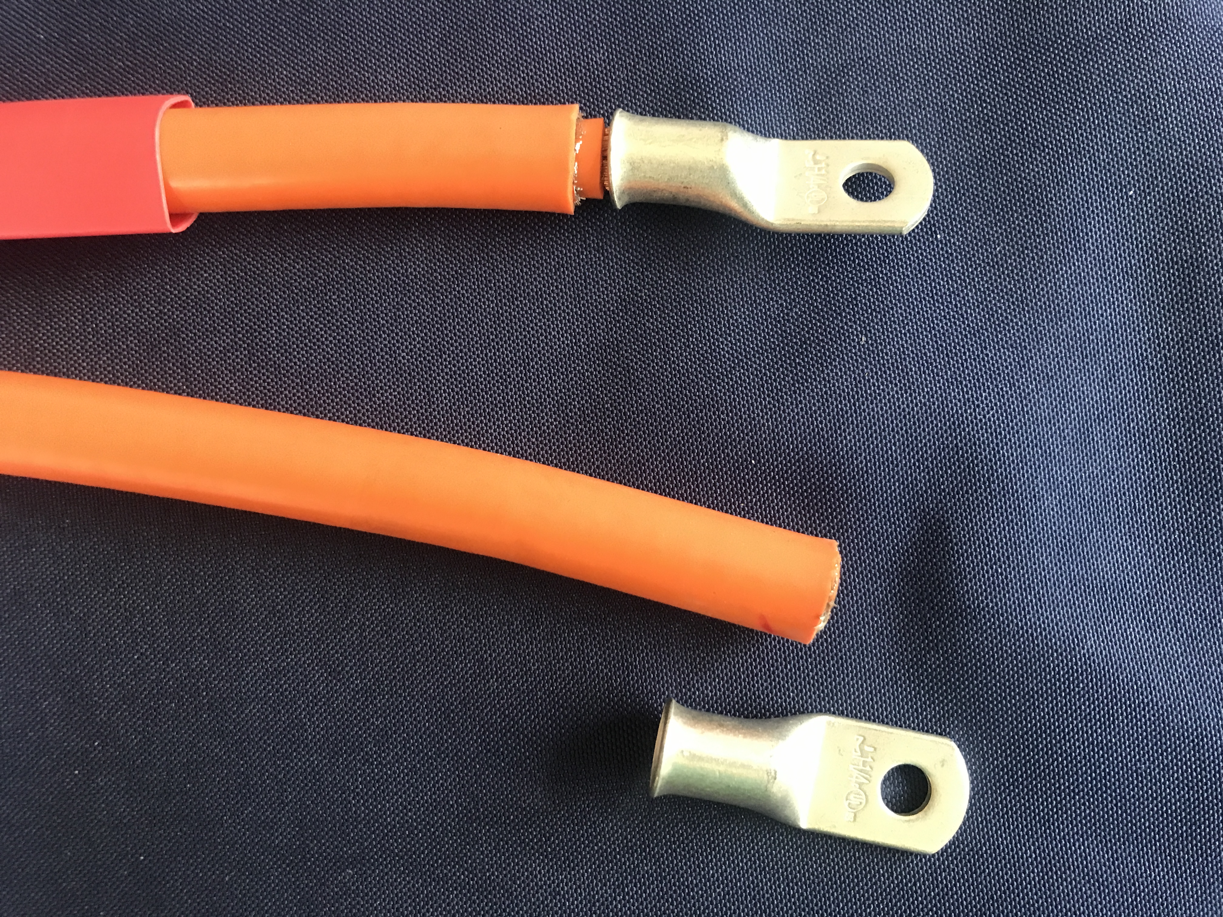

so thinking something like this with some M6 ring terminals crimped on the ends
I also plan on running my DC DC Converter off of the same two studs on the Inverter, please let me know your thoughts on that idea
and now we wait...

Post by marcexec »
Gregski wrote: Fri Jun 23, 2023 1:54 pm so thinking something like this with some M6 ring terminals crimped on the ends
and now we wait...
That kit should come with every heavy-duty crimper! It's always the size/hole diameter that you don't have yet...

Gregski
Posts: 3157
Post by Gregski »
marcexec wrote: Fri Jun 23, 2023 6:20 pm That kit should come with every heavy-duty crimper! It's always the size/hole diameter that you don't have yet...
ha ha probably, I don't even flinch any more

Post by celeron55 »
Wait what are you doing with stainless steel M6 standoffs?
Gregski
Posts: 3157
Post by Gregski »
celeron55 wrote: Fri Jun 23, 2023 9:54 pm Wait what are you doing with stainless steel M6 standoffs?
Well I was going for aluminum first but I heard they snap off so I bought these steel ones, is this a mistake, they are for the inverter positive and negative posts?
crasbe
Posts: 330
Location: Germany
Has thanked: 58 times
Been thanked: 180 times
Post by crasbe »
Gregski wrote: Fri Jun 23, 2023 10:03 pm Well I was going for aluminum first but I heard they snap off so I bought these steel ones, is this a mistake, they are for the inverter positive and negative posts?
Compared to aluminium and copper, stainless steel is a terrible conductor: https://de.wikipedia.org/wiki/Spezifischer_Widerstand (the English wikipedia uses different units..)
We have a specific resistivity of ~0.017 (Ohm * mm²) / m for copper, 0.1-0.2 (Ohm * mm²) / m for steel and 0.72 (Ohm * mm²) / m for V2A stainless steel.
Keep in mind: less is better, which means copper conducts 40x better than stainless steel.

Post by Gregski »
crasbe wrote: Sat Jun 24, 2023 9:54 am Compared to aluminium and copper, stainless steel is a terrible conductor: https://de.wikipedia.org/wiki/Spezifischer_Widerstand (the English wikipedia uses different units..)
message received, I appreciate that, I will use the variety pack just to determine the right length and then order some more better ones
Posts: 1080
Has thanked: 478 times
Been thanked: 308 times
Post by MattsAwesomeStuff »
Yeah, ballpark stainless is 50-100x as bad of a conductor as copper.
Brass is 4x as bad (decent).
Aluminum is 2x as bad (good, but aluminum is the soiled diaper of the materials world).
Big beefy motor terminals are usually brass, since they're close enough to copper and significantly more corrosion resistant.
celeron55
Posts: 805
Has thanked: 39 times
Been thanked: 136 times
Post by celeron55 »
Aluminium is a bad idea due to oxidation. You'd need nickel or tin coated aluminium or a purpose made contact grease and a dry environment.
Copper would be best, but you can't buy ready made copper standoffs. For ready made standoffs, brass is the only option.
Then, what I still would change about this idea:
Don't use threaded standoffs because copper or brass threads can't handle a lot of force. Use spacers with a clean hole through, and then use a steel bolt to tighten it along with the terminal. The bolt doesn't need to conduct. The inverter has a steel nut behind each terminal.

Post by Gregski »
I really hope using a long stand off like a 1.5" will be ok cause I really don't want to redo the Inverter bracket
so this crimper aint the best, it leaves sharp edges, hence the file, now if you crimp in two steps, using something like a 35mm jaws then go down to 25mm ones you can sort of minimize the sharp edges, but if you just use the 25mm jaws you get a razer blade like edge to file away

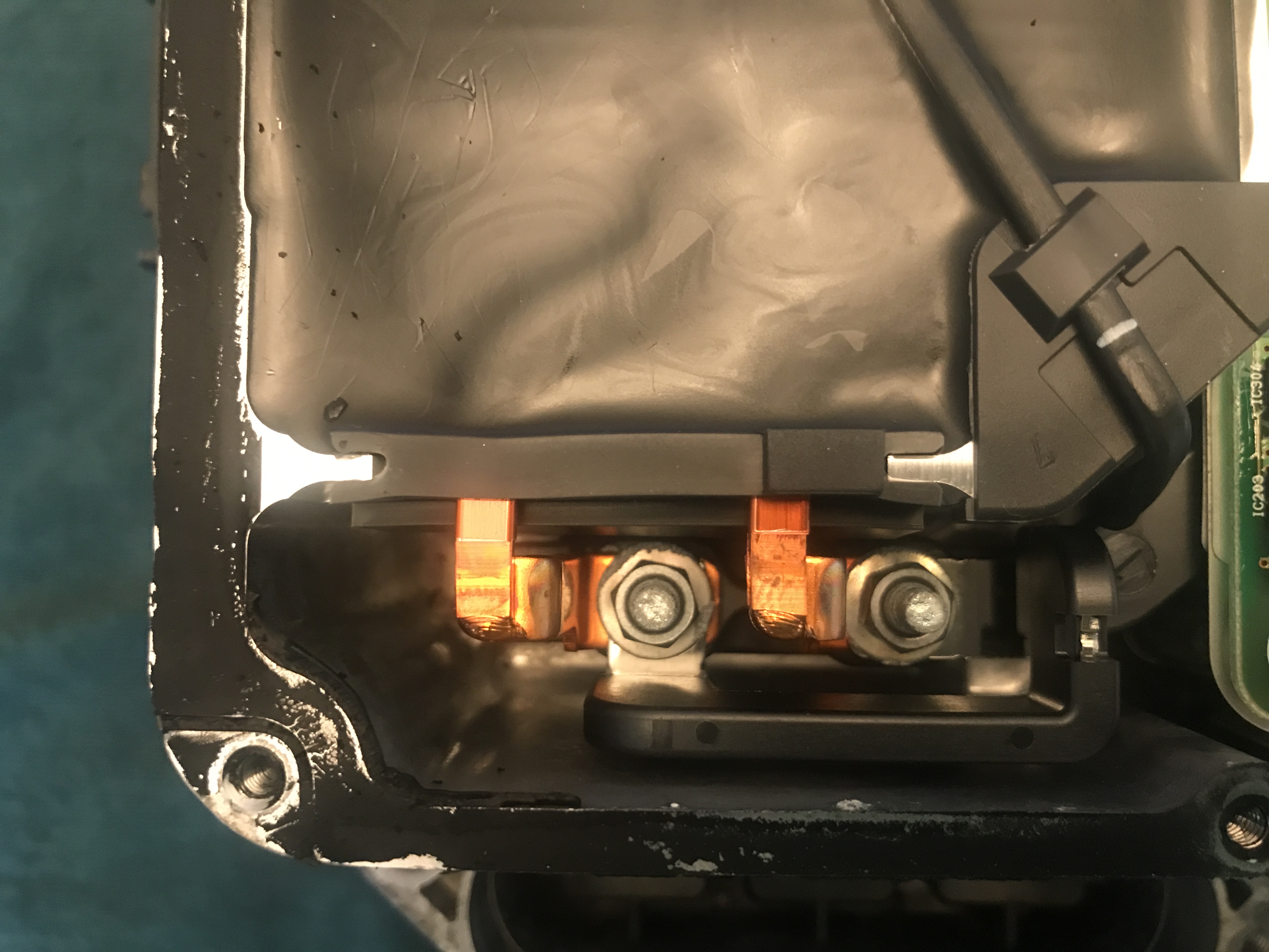

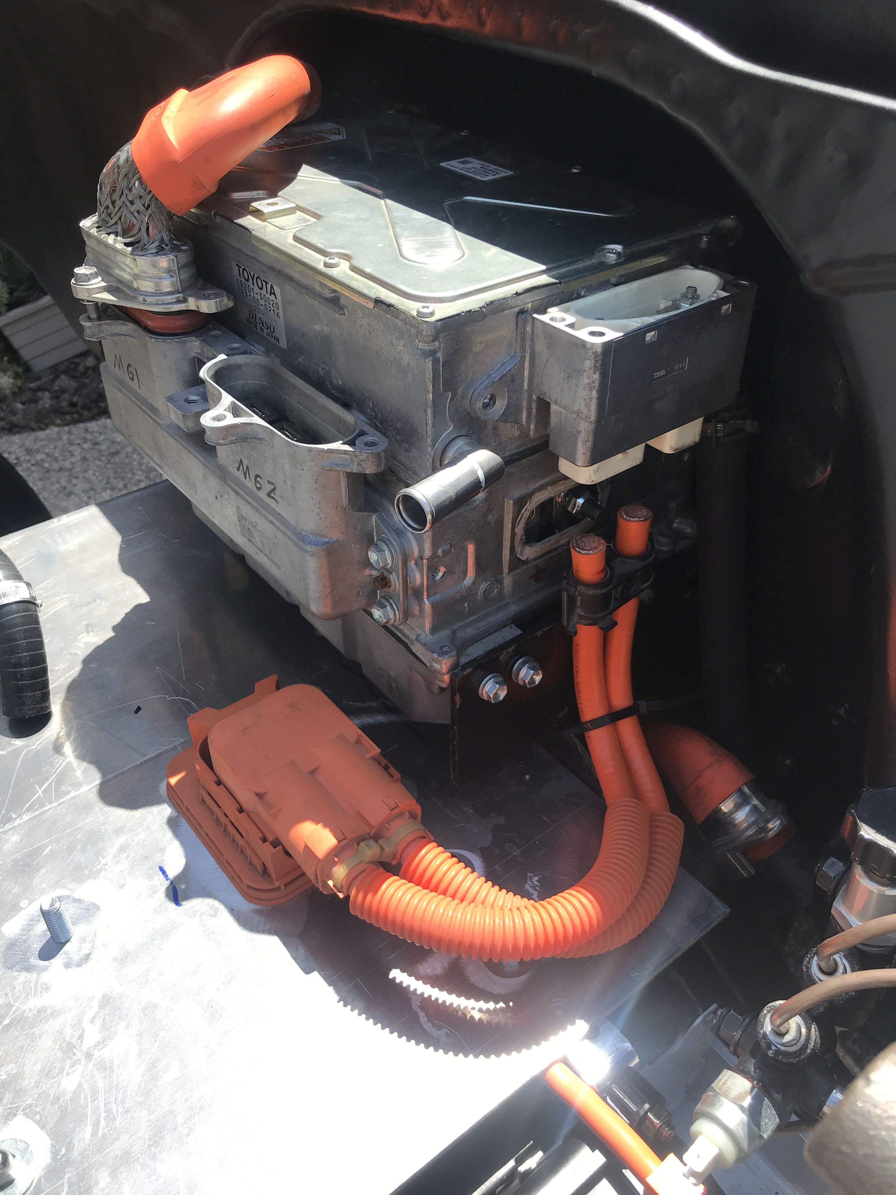

Post by Gregski »

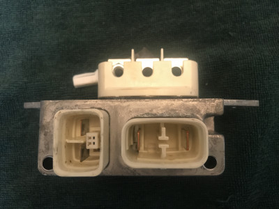

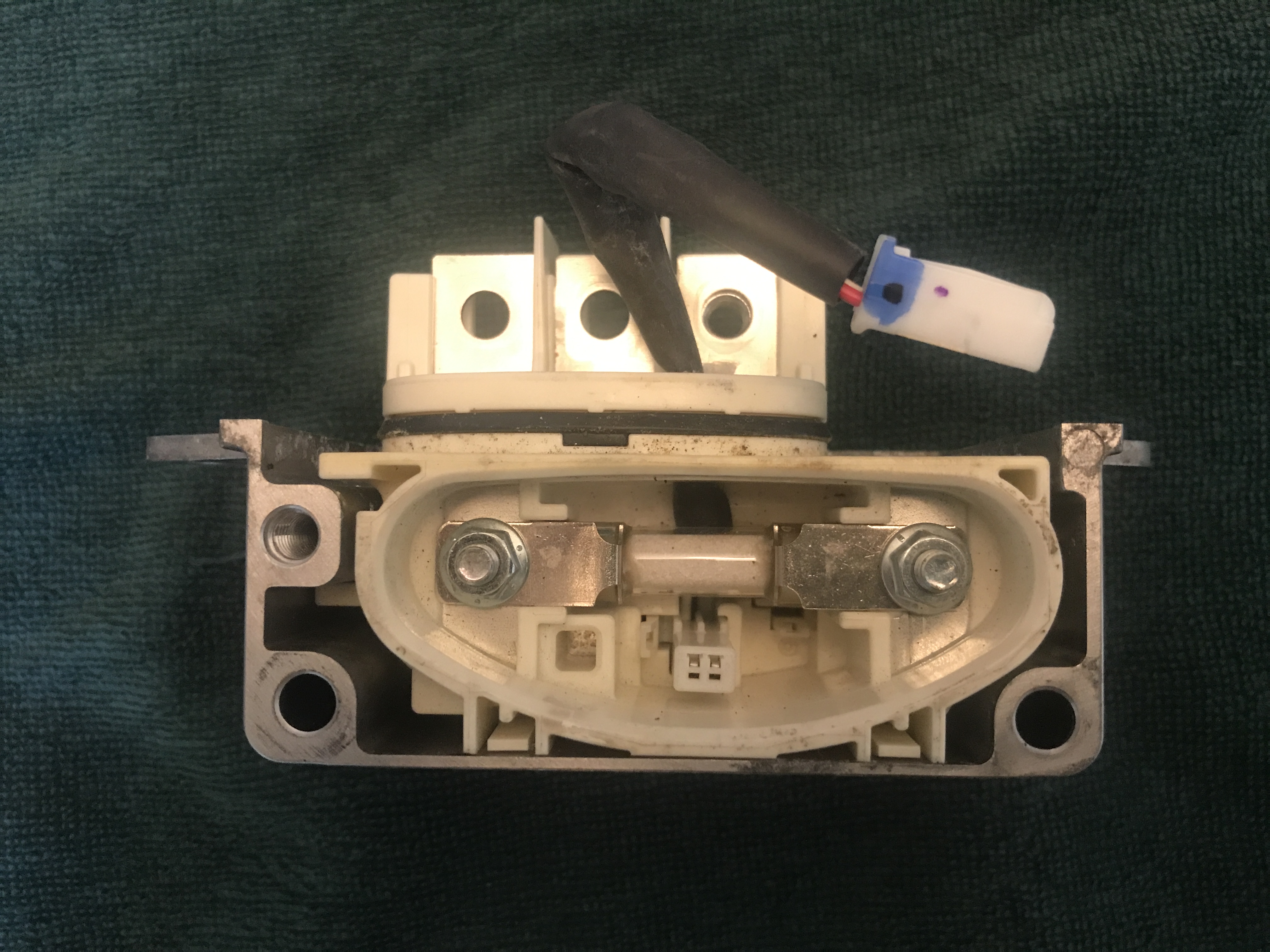

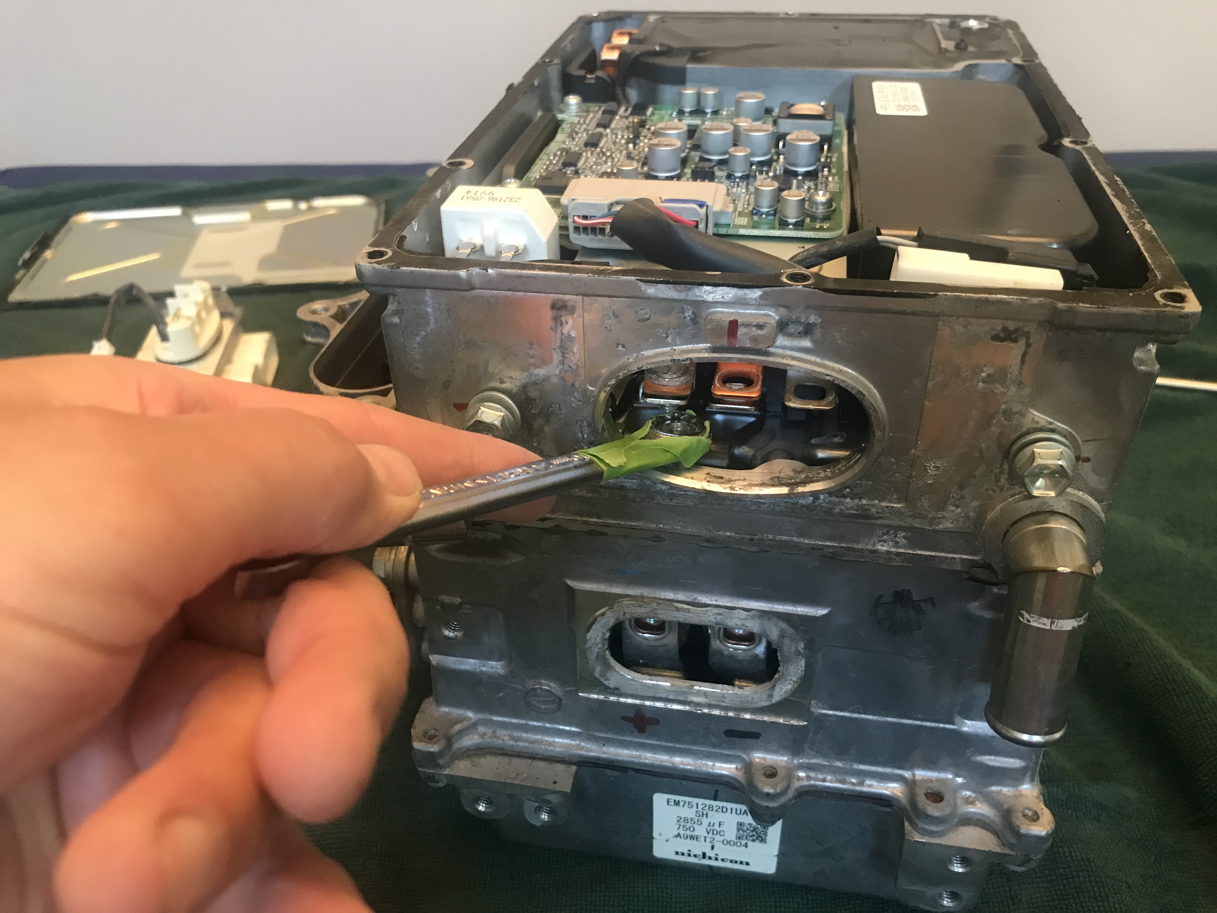

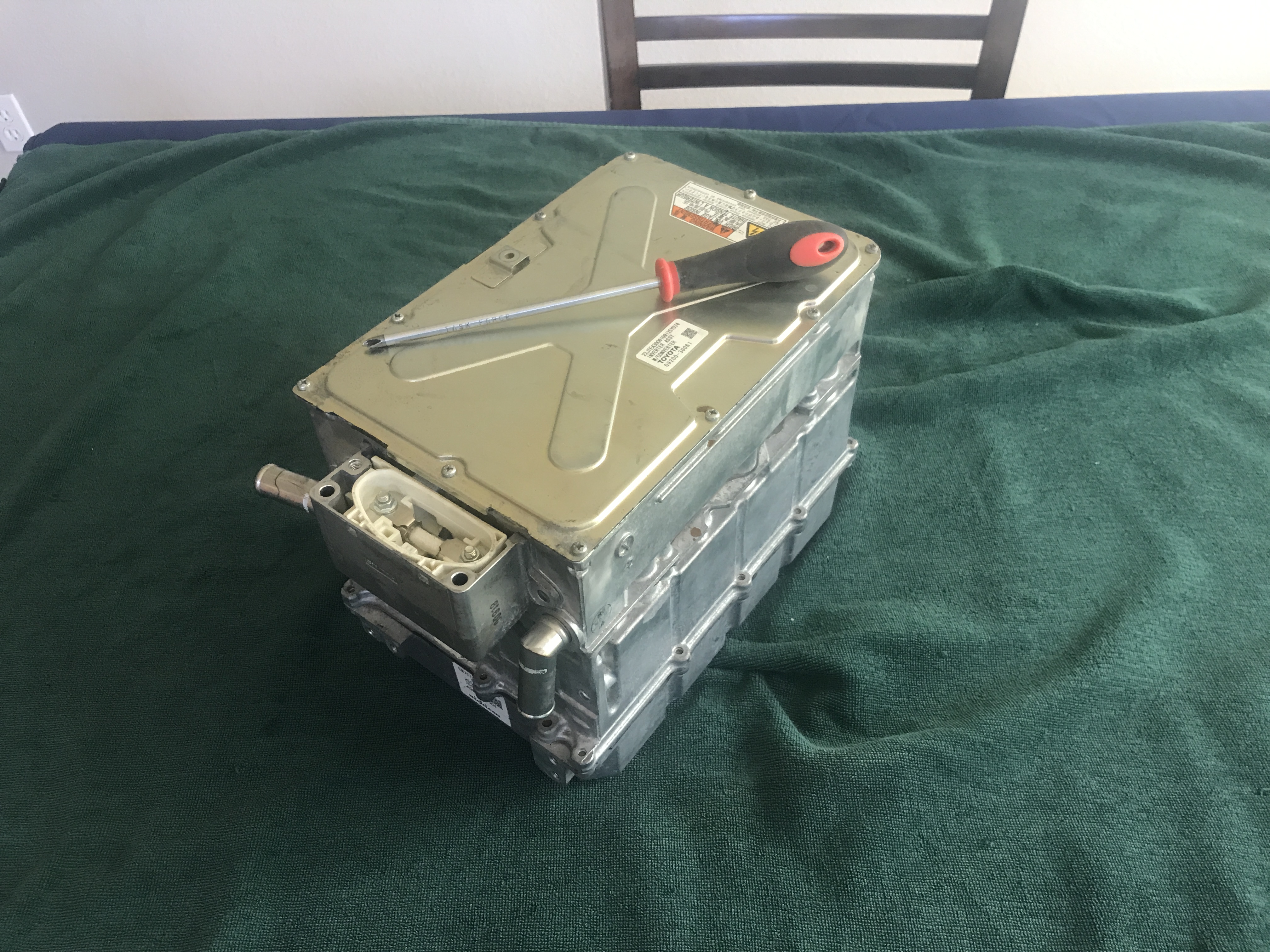

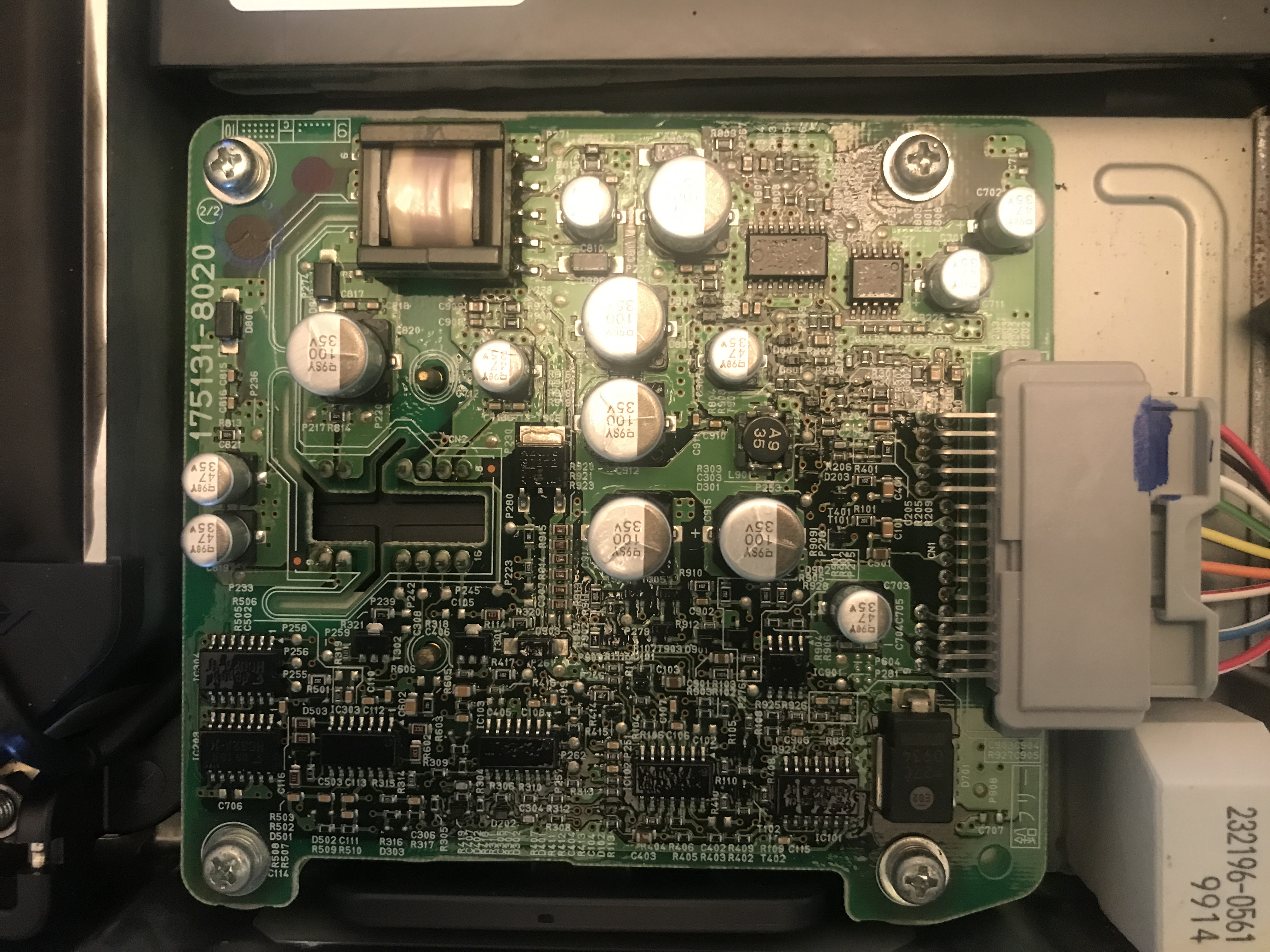

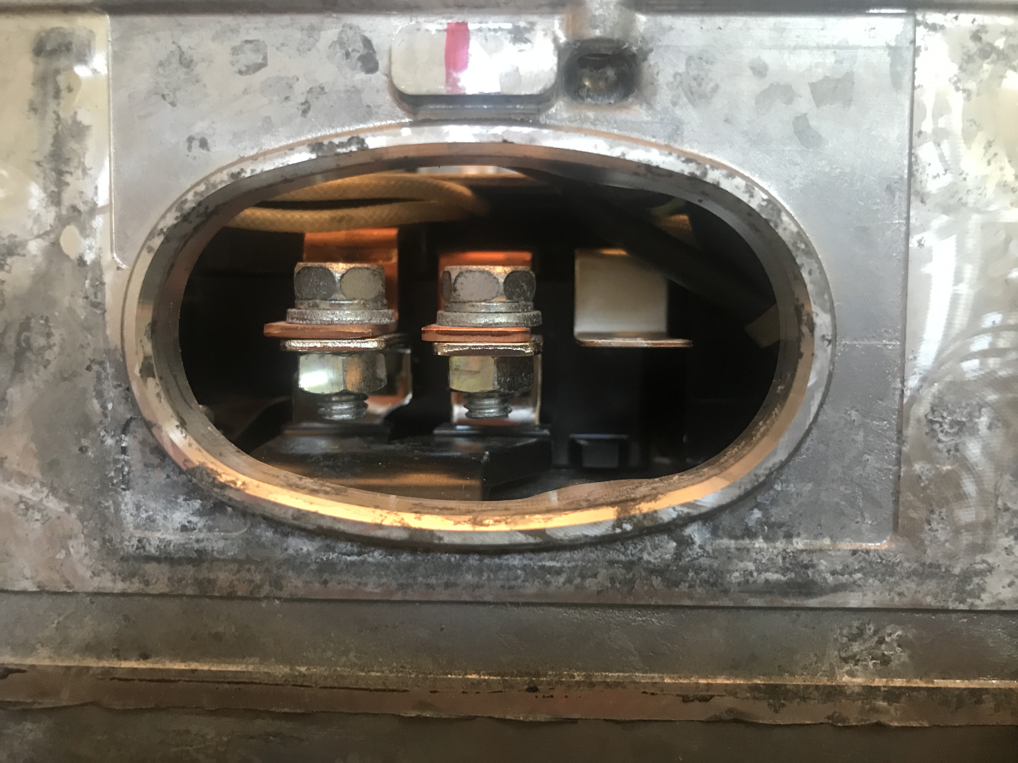

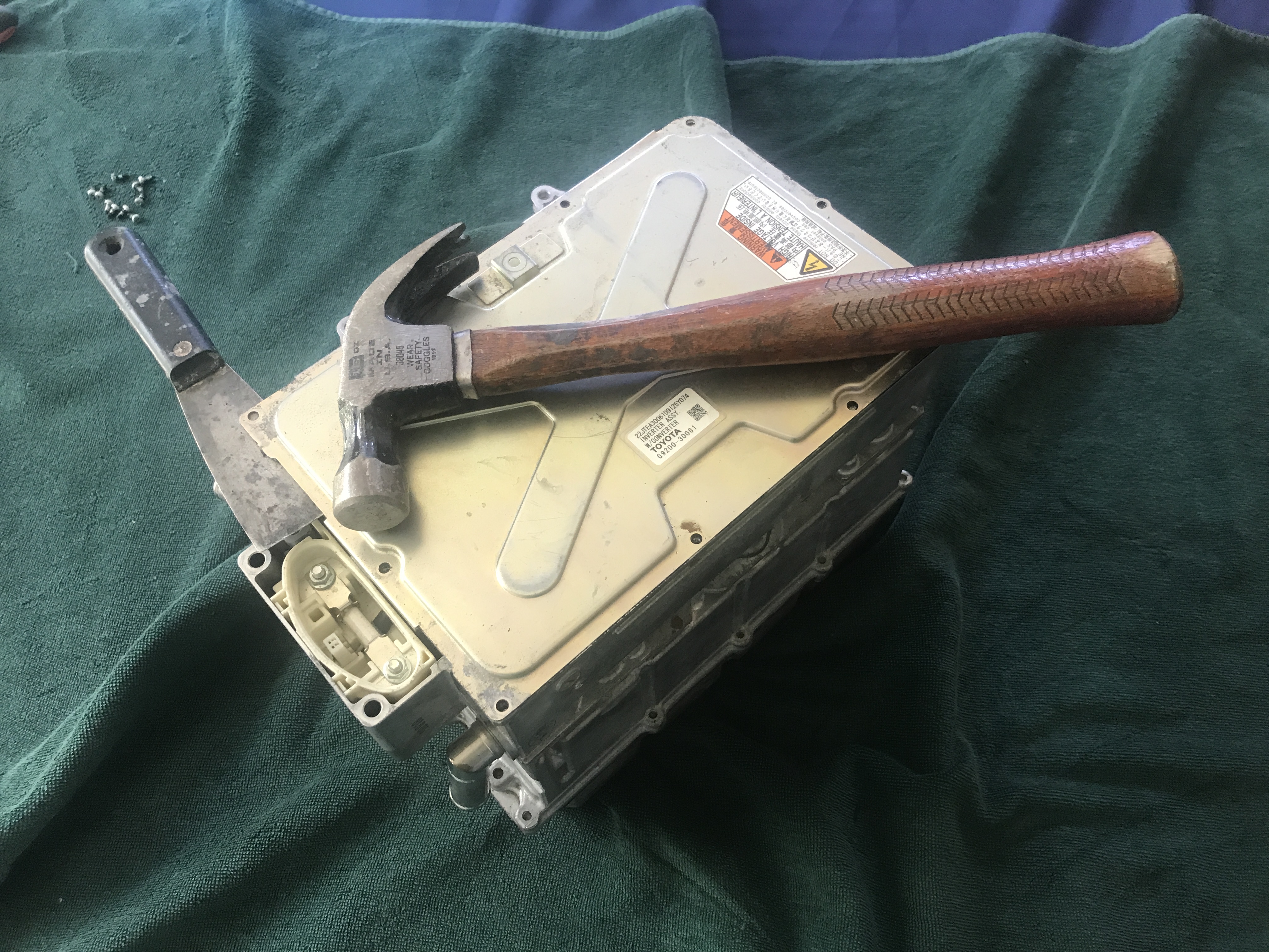

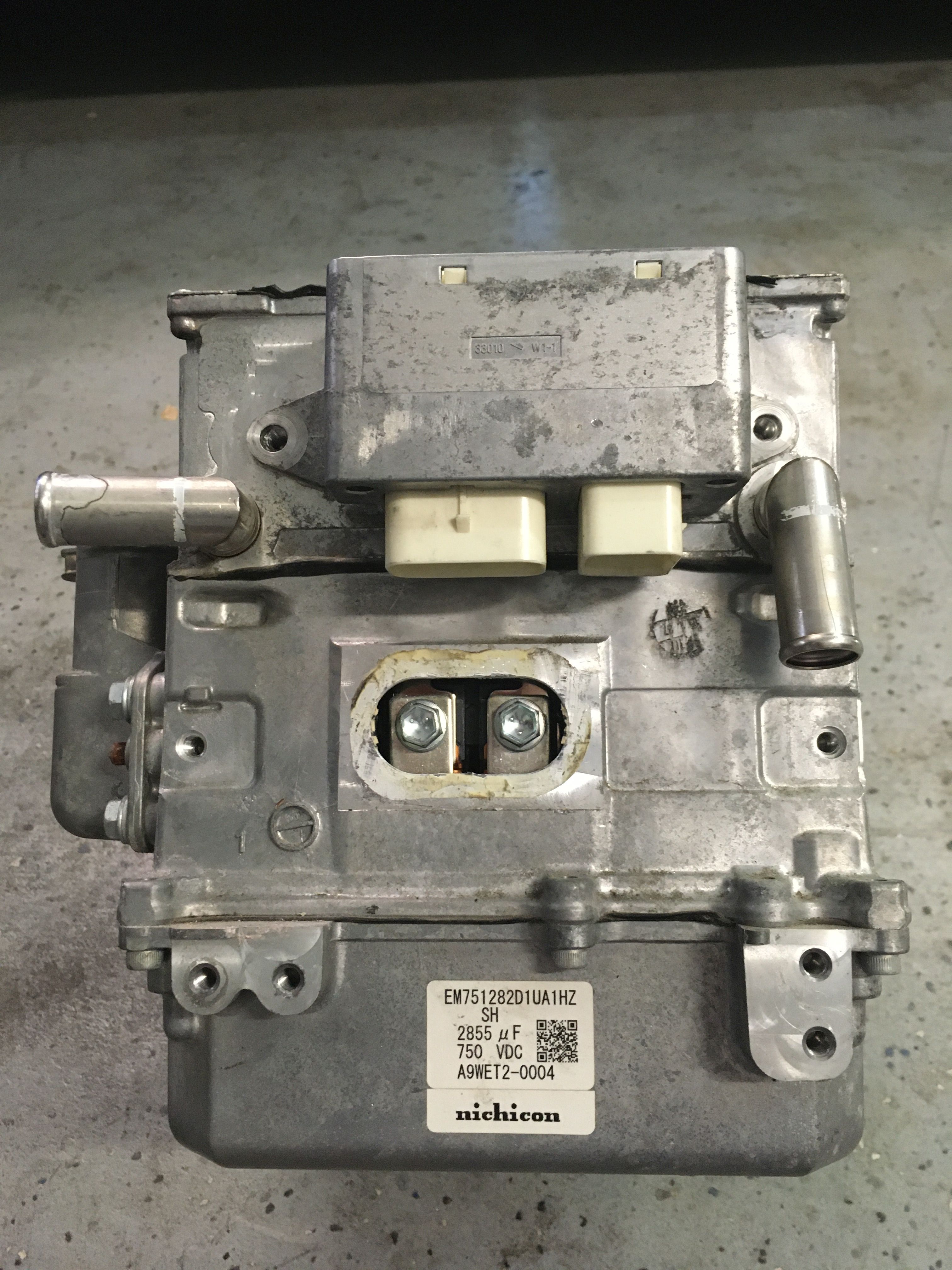

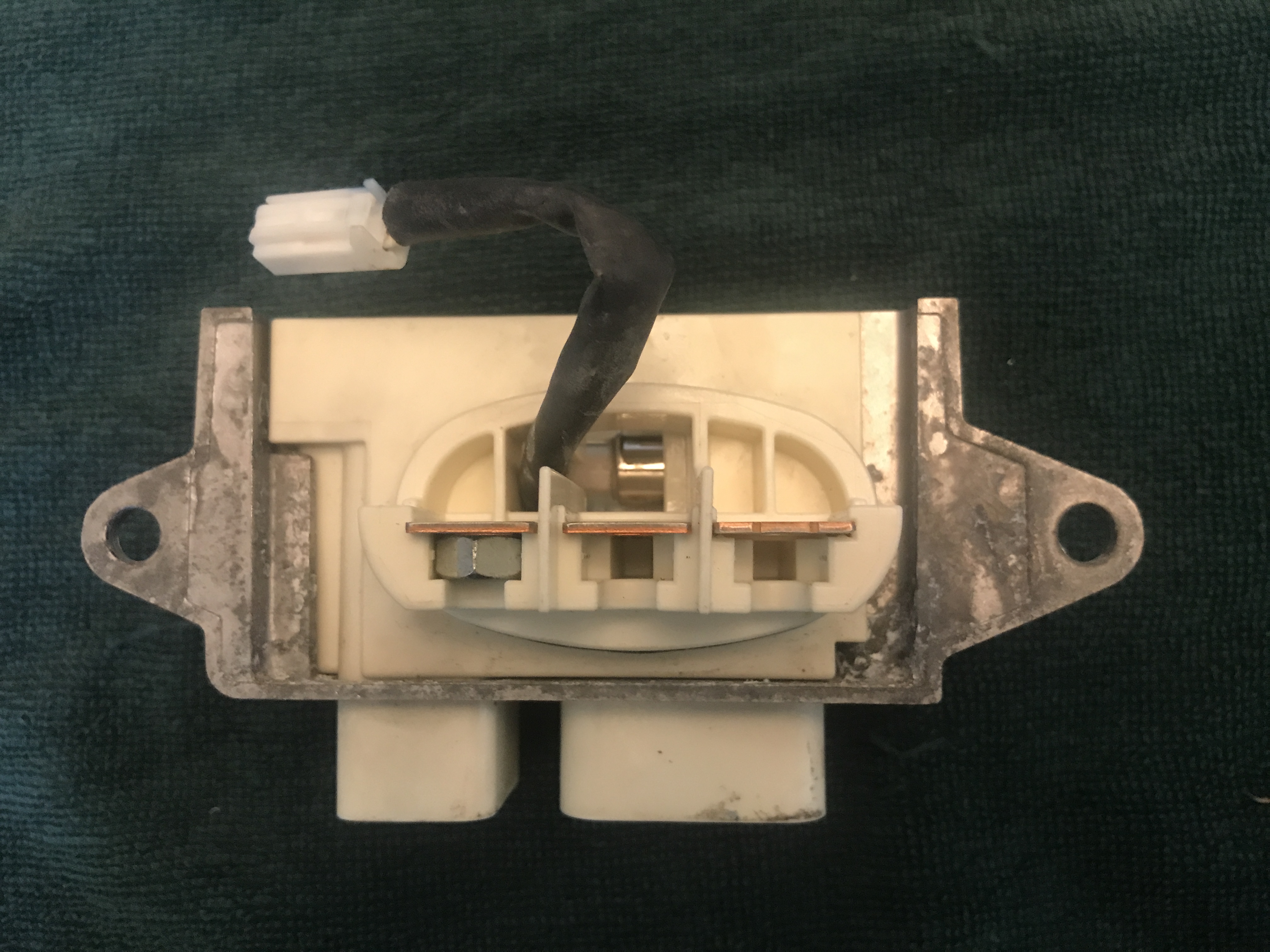

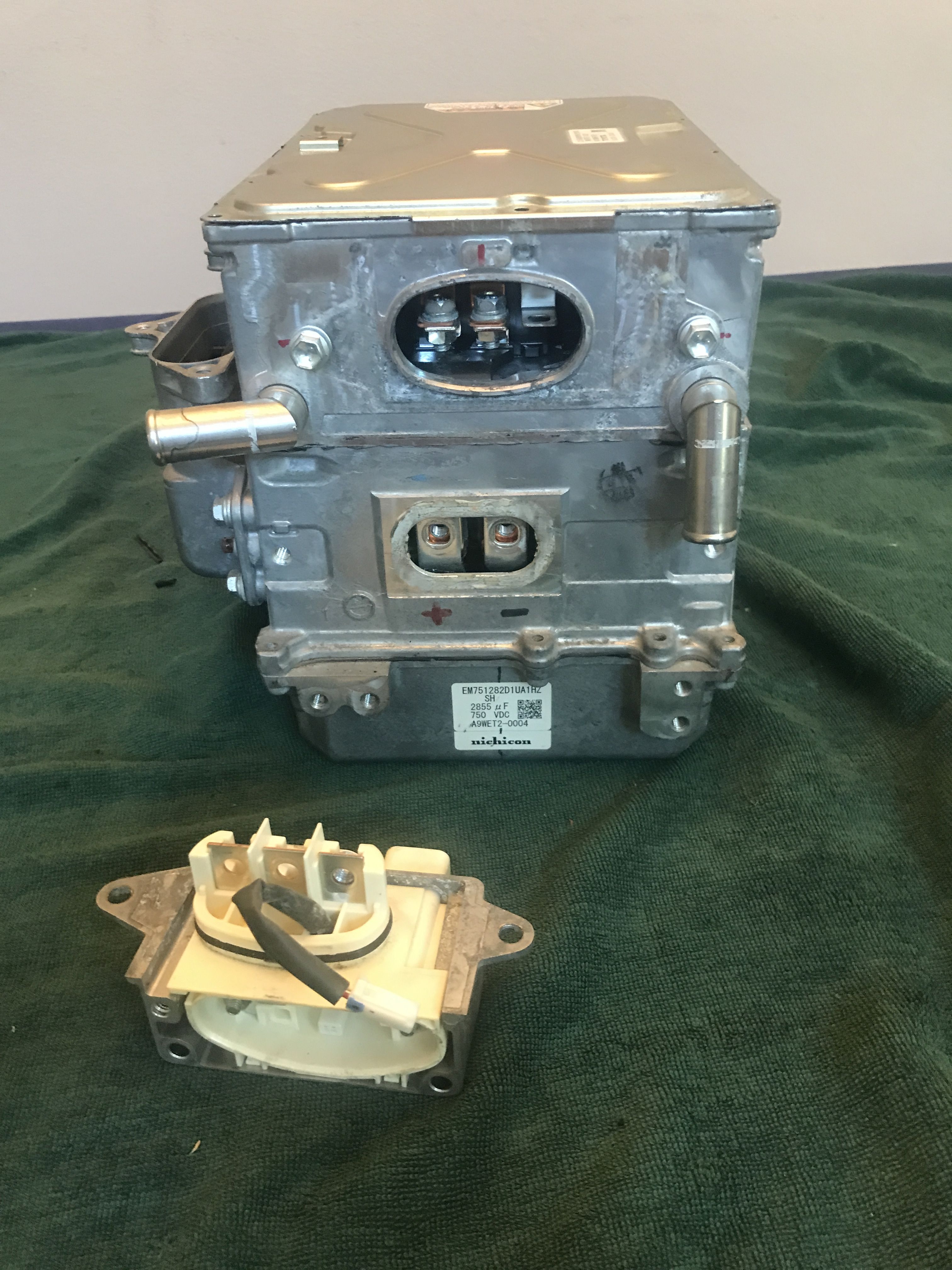

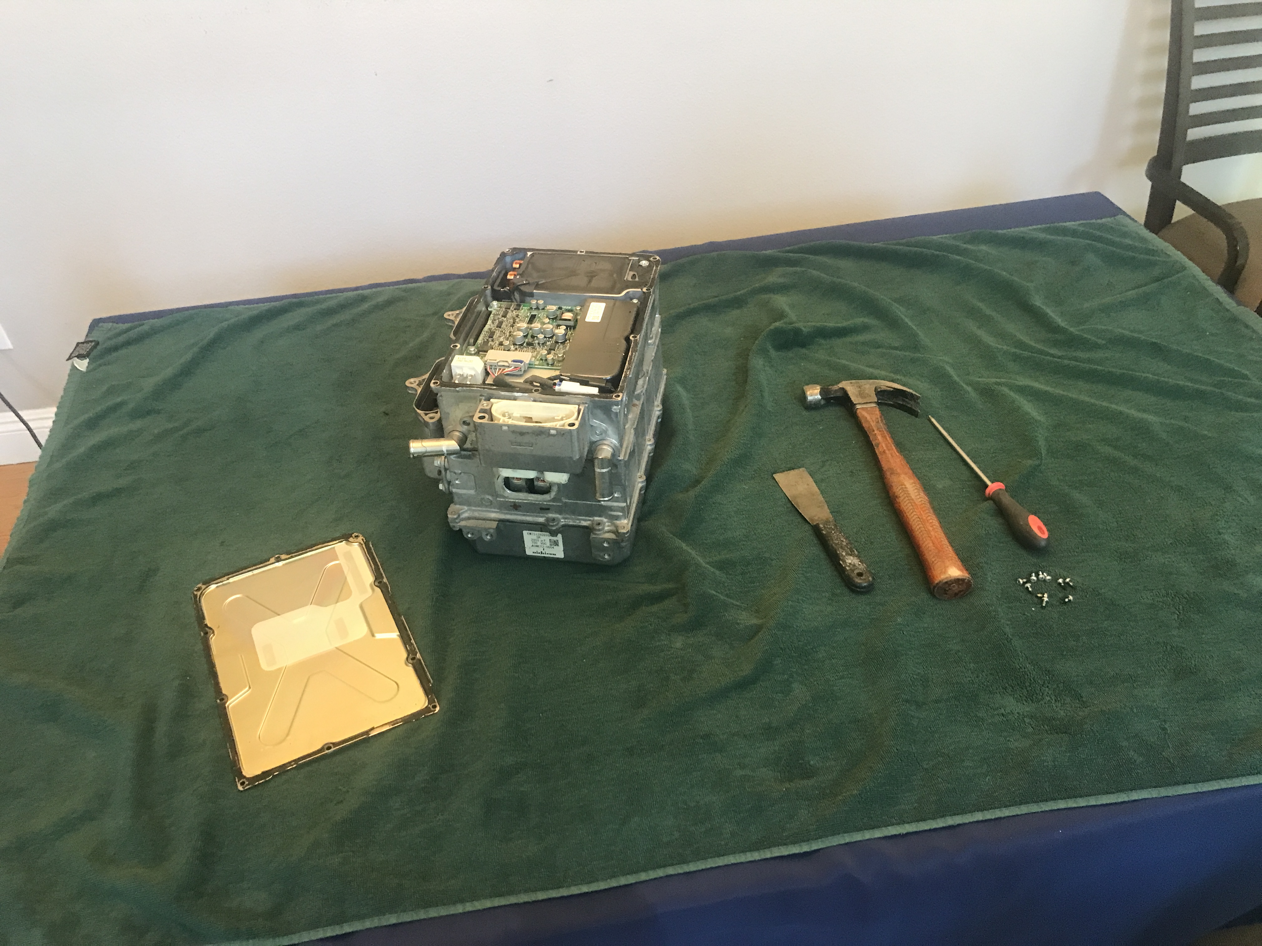

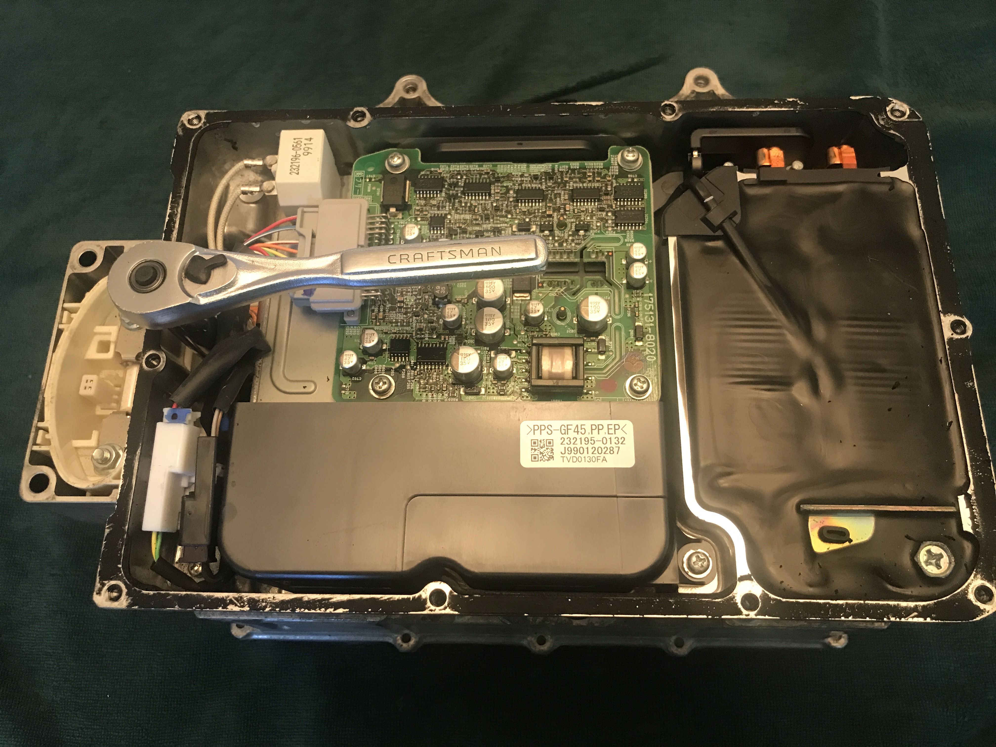

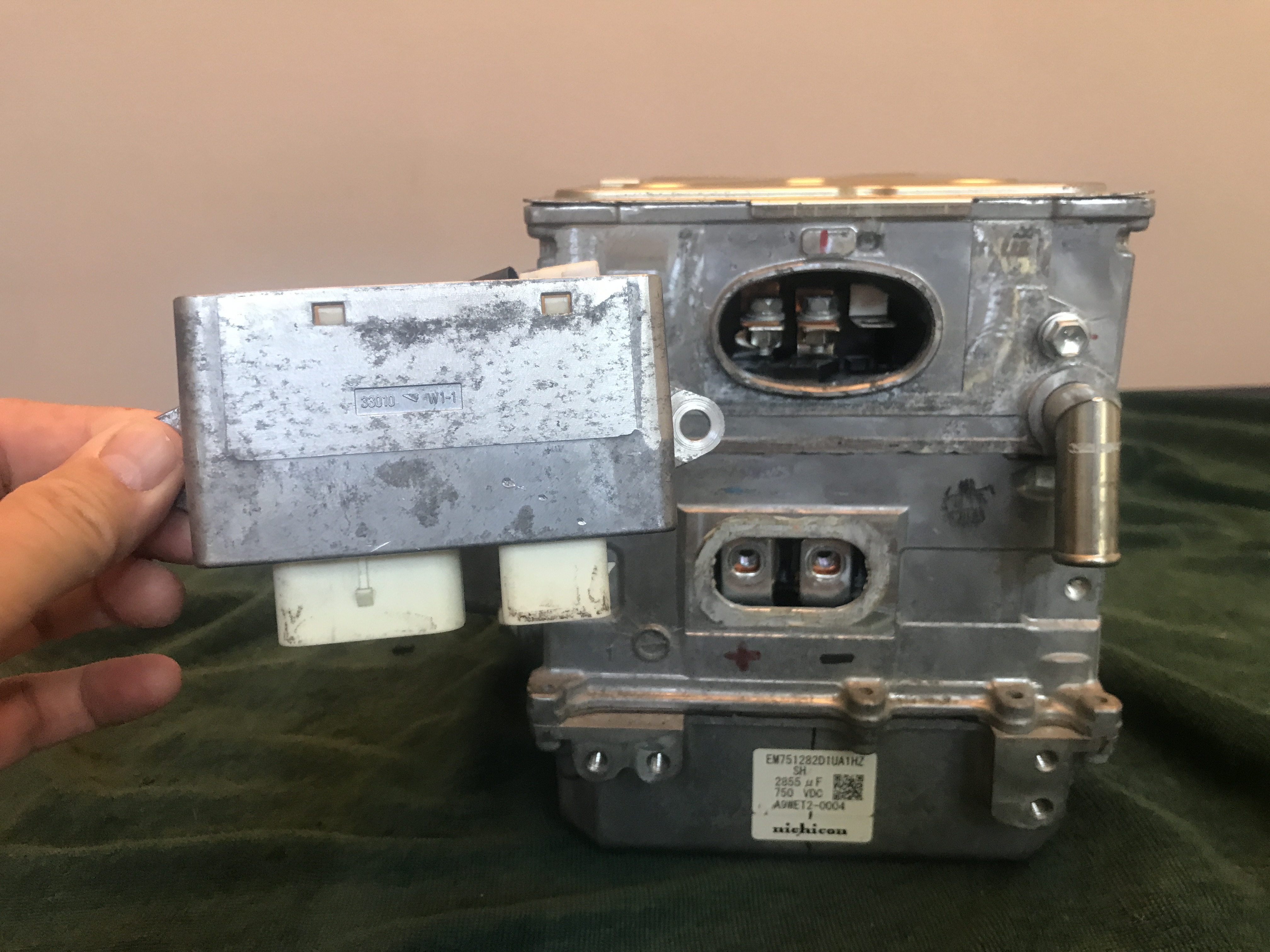

time for a little Inverterectomy
Gregski
Posts: 3157
Post by Gregski »
some gentle persuasion was required

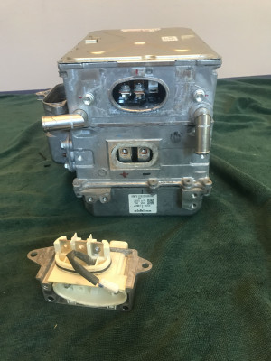

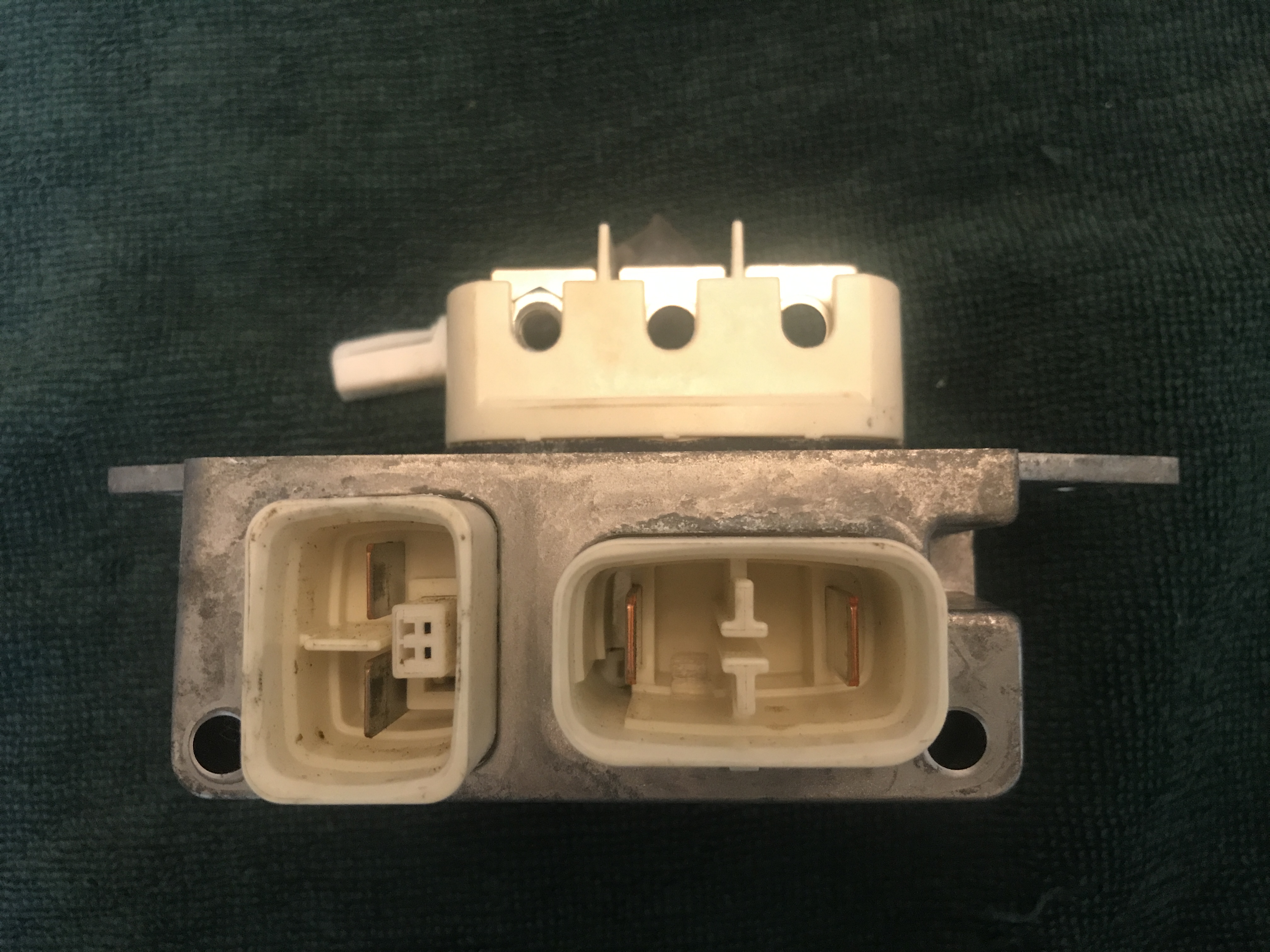

Gregski
Posts: 3157

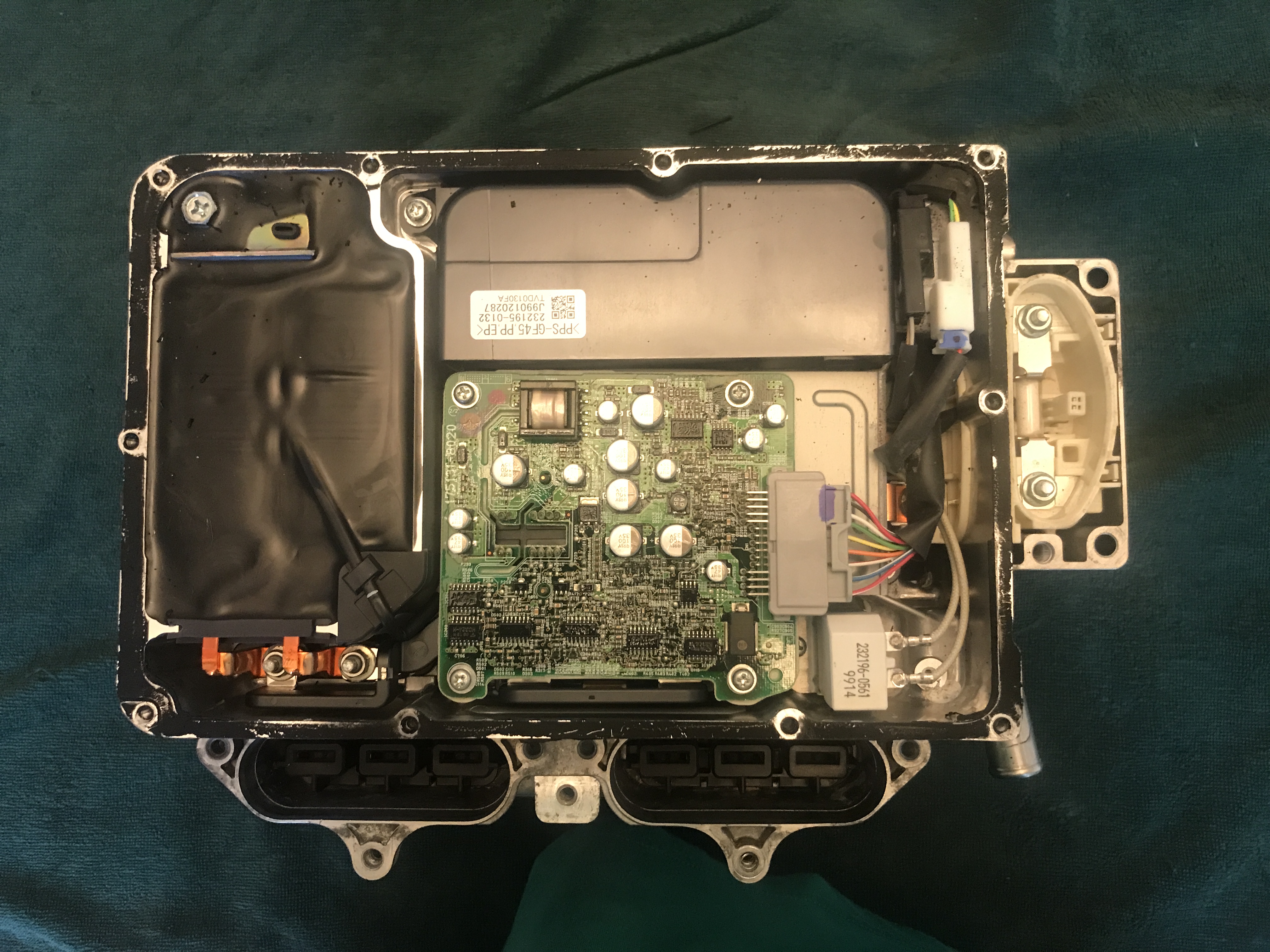

Post by Gregski »
I almost had to use a cheater bar to get the bus bar screws loose

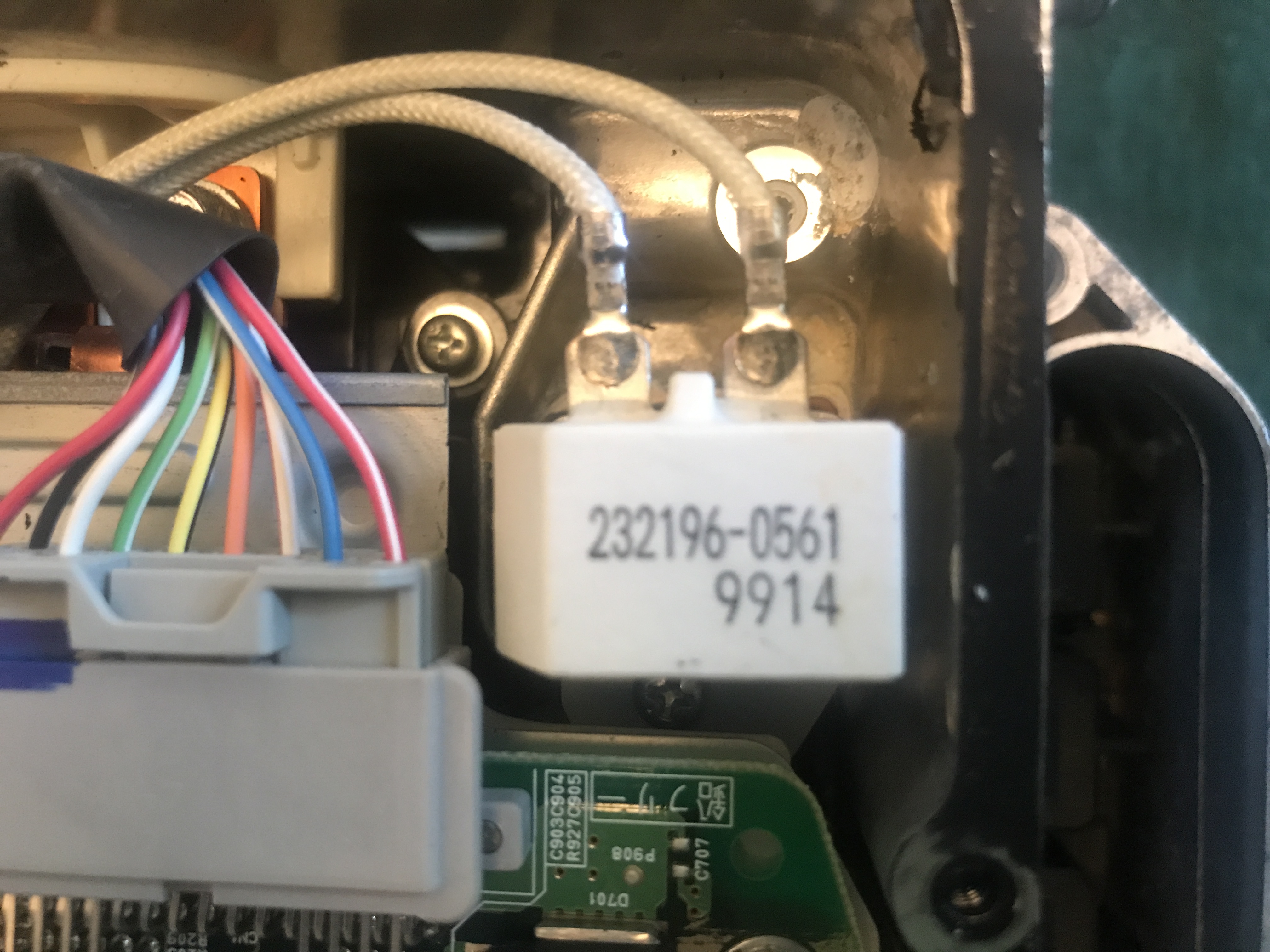

and here is a closer look at the flux capacitor in the wild
Gregski
Posts: 3157
Post by Gregski »

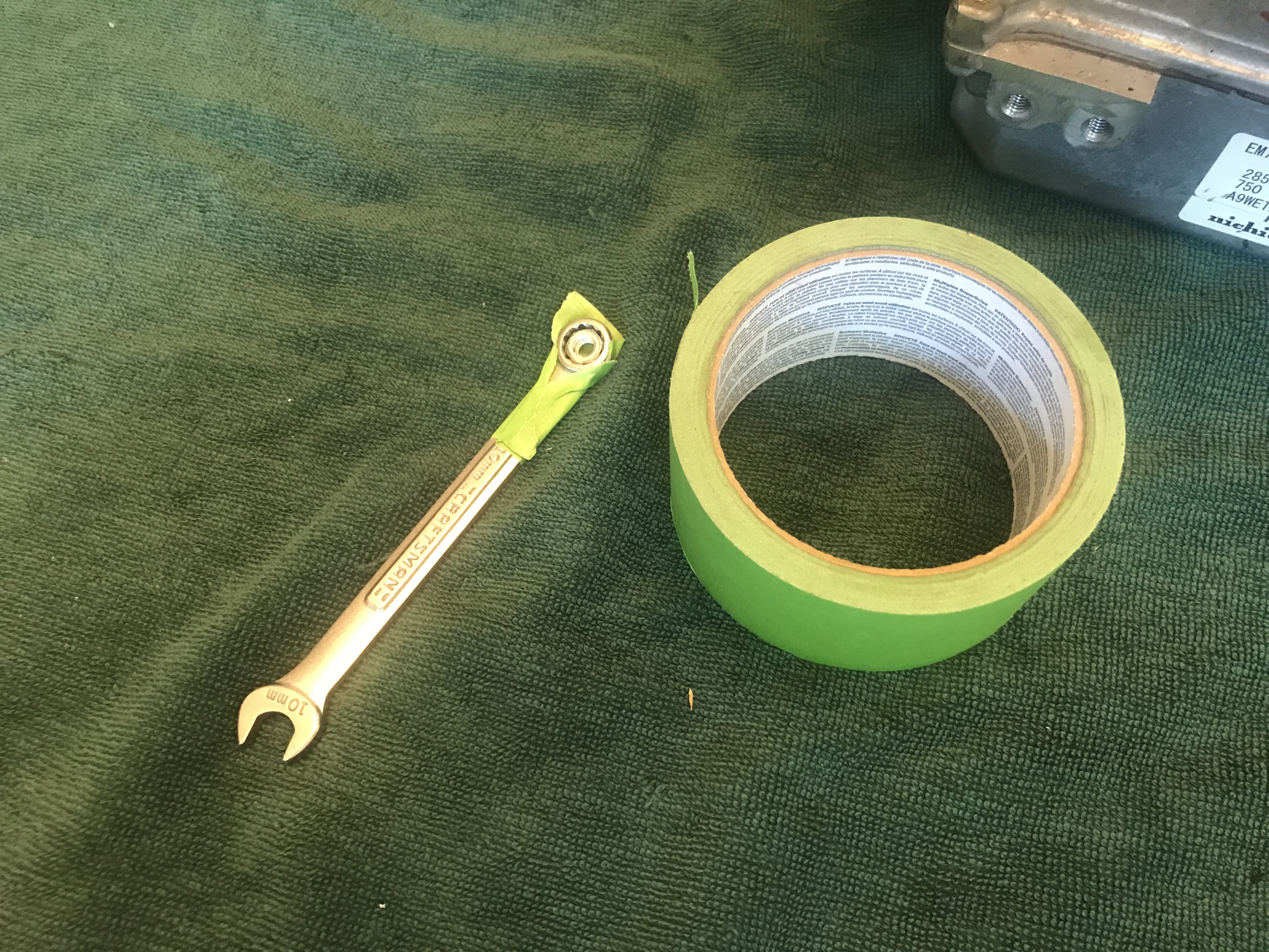

with that connector removed the bus bars need to be rebolted together, I used the old painter tape trick to keep the 10mm nut from falling into the abyss
Note: I'm a green belt painter taper, but you still may be a blue belt, that's ok, work with what you got and don't skip leg day !
you wanna torque these down to as hard as you can plus a quarter turn, jk !
