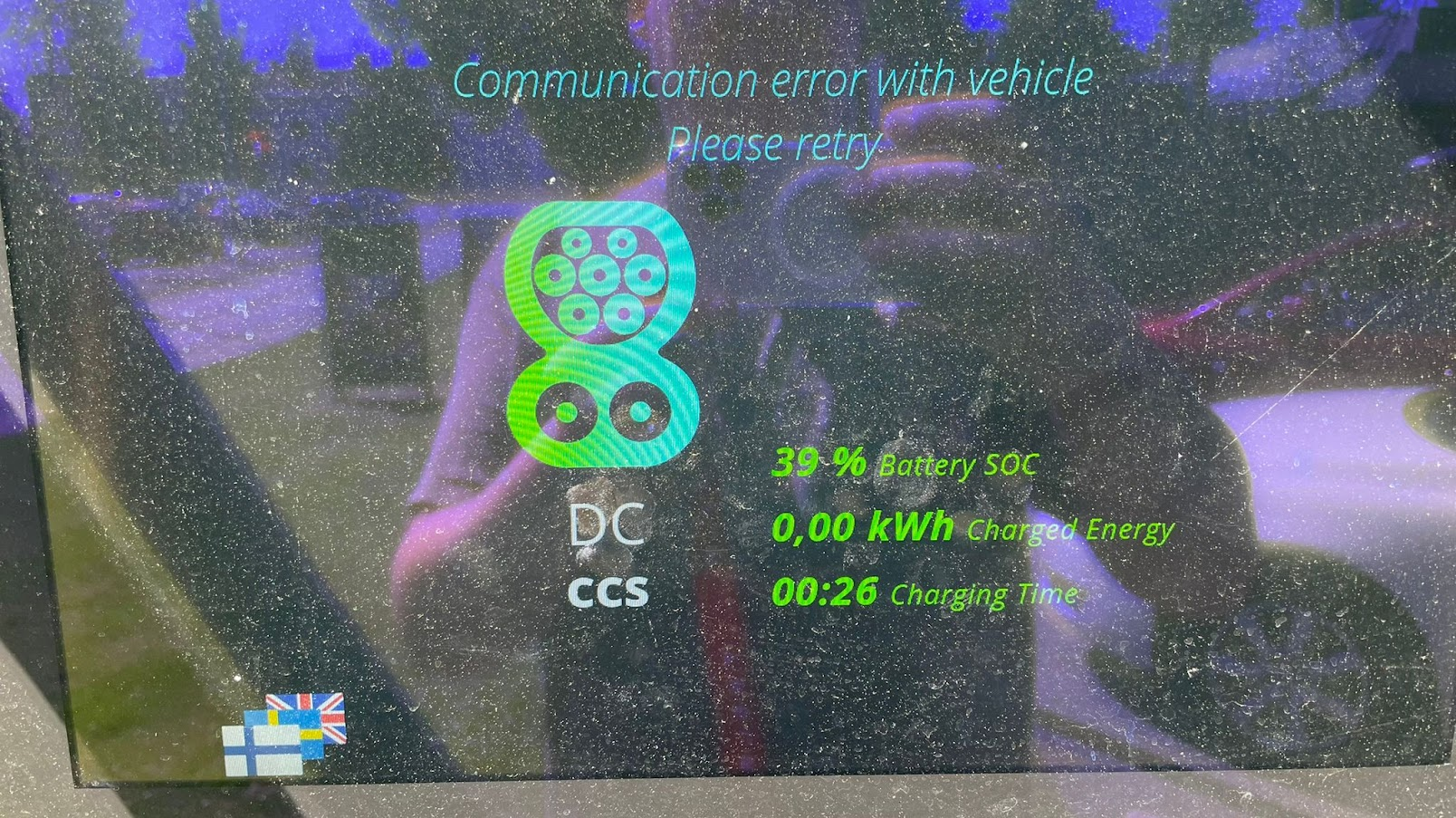

Had an attempt today and no luck.
Reviewing the log: https://github.com/Tom-evnut/BMWI3_LIM_ ... %20Jun.trc
Pilot status drops from 5%_Ready to 5%_NotReady right after requesting to close the contactors. So I believe the LIM itself must be deciding something is wrong.

Charger Shows this on the display:

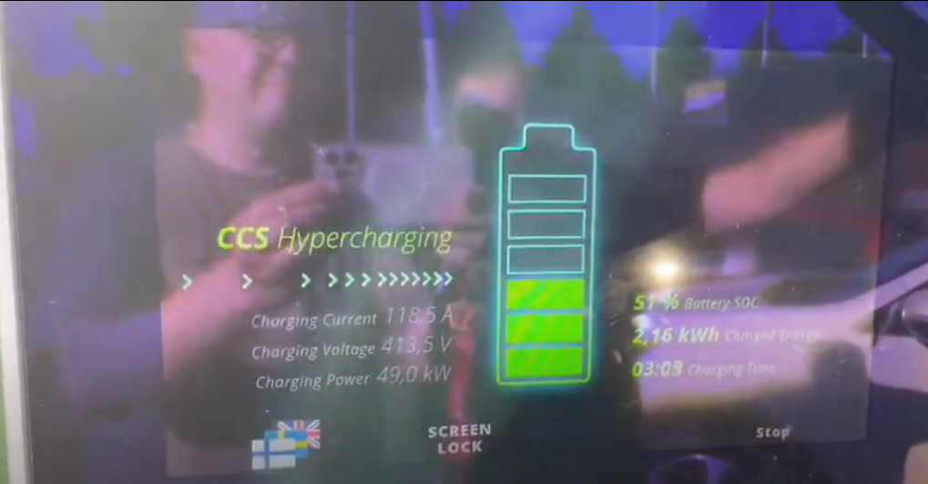

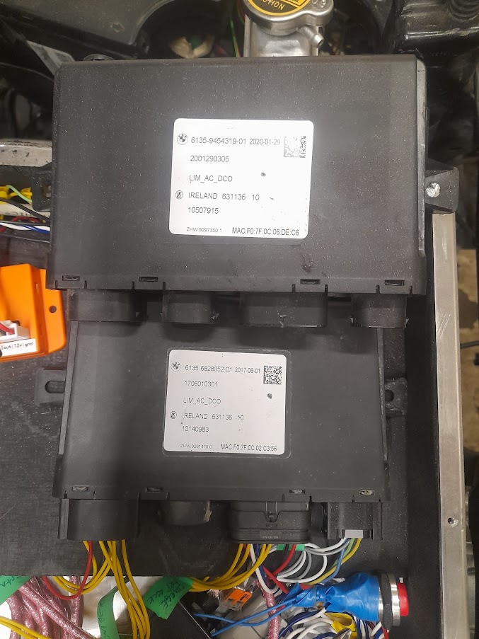

Now comes the biggest thing. Swap the LIM for a 2020 model and she worked.
Thanks Damien and muehlpower for providing feedback.
Here is the working log: https://github.com/Tom-evnut/BMWI3_LIM_ ... 202020.trc
This now means I can clean up my code to start removing fixed values ect.

Would be good to know the precise article number of the LIM.
Or if we ever get that far we extract a firmware revisión.
What year was the non working LIM from?
Posts: 2962
Has thanked: 328 times
Been thanked: 847 times
Here are the two LIMs used the 2017 gave issues and the 2020 worked.

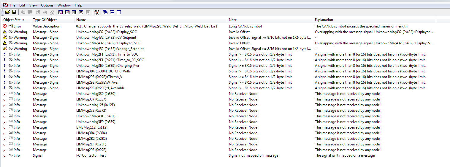

tom91 wrote: Thu Jun 23, 2022 4:48 pm I have been updating the Github DBC so you can find it there.
I have picked this up again; but i get allot of faillures?Not sure how important they are.
Can this be fixed?
It fuzzes me mainly about that weld test?

EV_Builder wrote: Tue Jul 26, 2022 1:53 pm
tom91 wrote: Thu Jun 23, 2022 4:48 pm It fuzzes me mainly about that weld test?
I can have a look at those. But most of those errors are not in any of the sections I touched or even used.

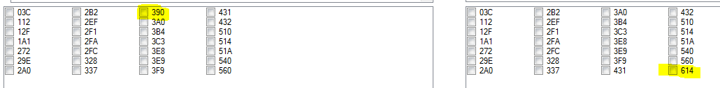

tom91 wrote: Fri Jul 01, 2022 8:56 am Here are the two LIMs used the 2017 gave issues and the 2020 worked.
Will dig into the can captures to see if there are any differences.
Check this out as a start?
Left is working one, right is failing one. 0x390 is unique in the working one.

390h is "Status_Hospitality_Function" and controls whether the plug is automatically released after loading.
EV_Builder
Posts: 1205
Location: The Netherlands
Has thanked: 18 times
Been thanked: 37 times
Post by EV_Builder »
614h is that some kind of warning? Anyway 390h is absent in the non working one. Might be an/the issue?

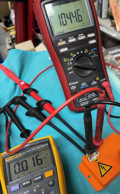

Jackk wrote: Mon Aug 01, 2022 11:34 am Is there a voltage sense board suitable for higher voltage? as on the wiki it suggest max 500v......
Yes, our Voltage sense board for BMW i3 LIM CCS fast charging can do up to 750V.
Even more in terms of isolation, but then some clipping occurs.
See attached photo where it measures 1044V and produces 16 mA.

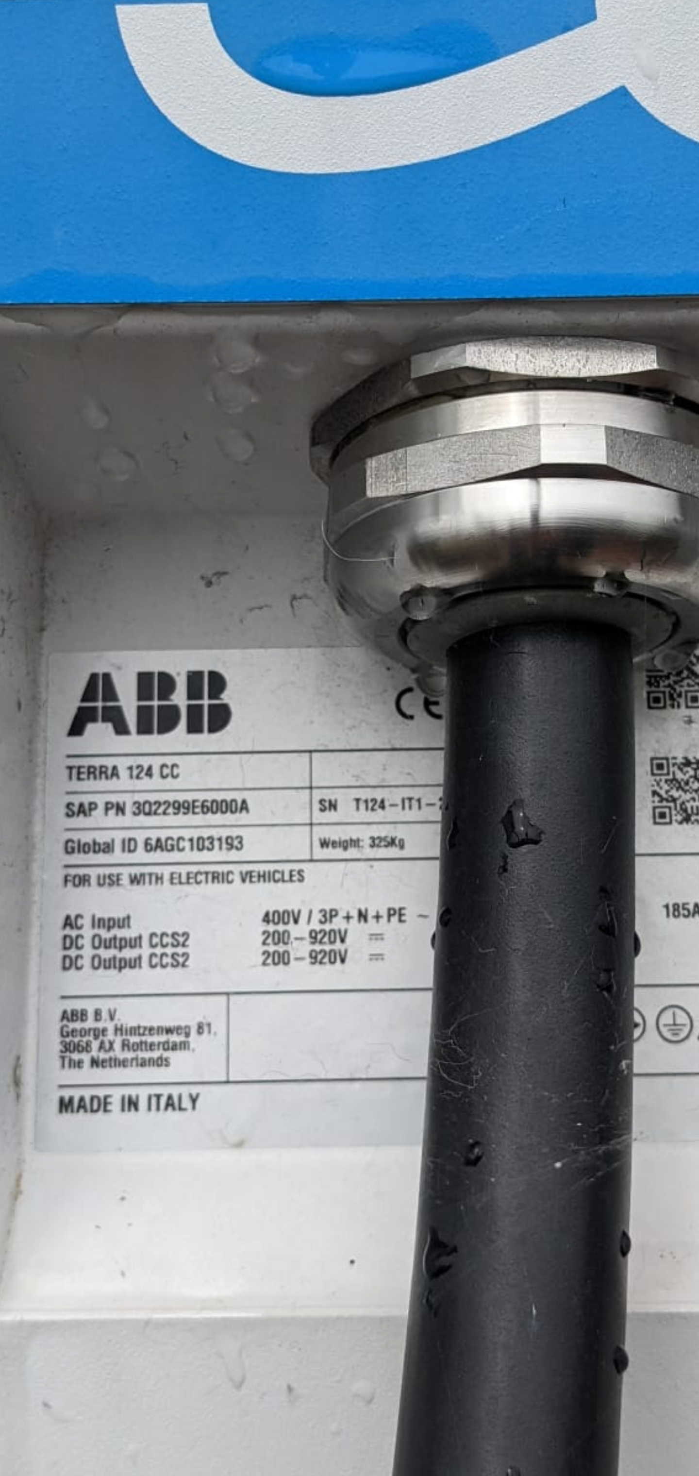

EV_Builder wrote: Mon Aug 01, 2022 11:48 am I'm not sure if even the chargers can reach 650Volts.
Maybe a good check would be how the TayCan charges it's pack I bet it has a internal DC/DC step up converter.
Perhaps although I did see this printed on the side of a CCS charger the other day .... Suggest 900v max

larsrengersen wrote: Mon Aug 01, 2022 7:07 pm
Thanks just ordered one up :)
