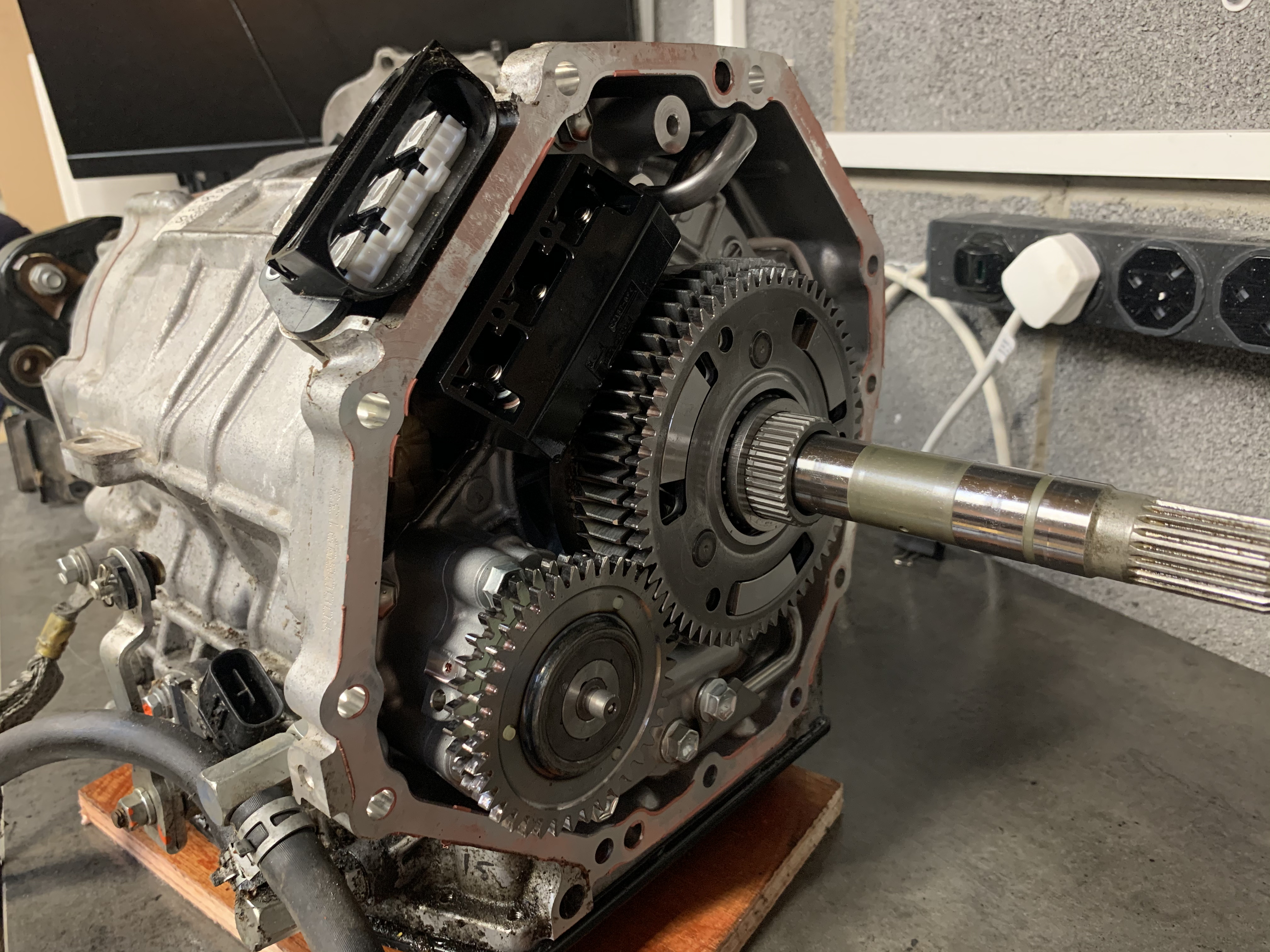

Hi guys , does anyone have a part number for the resolver wiring plugs that fit the sockets on the L210 gearbox ? the socket is 82824-30351 , they are different from the ones on my MG1
thanks

They're the same as the ones on the L110. Sumitomo 6189-1240.thornogson wrote: ↑Tue Feb 02, 2021 9:52 am Hi guys , does anyone have a part number for the resolver wiring plugs that fit the sockets on the L210 gearbox ? the socket is 82824-30351 , they are different from the ones on my MG1

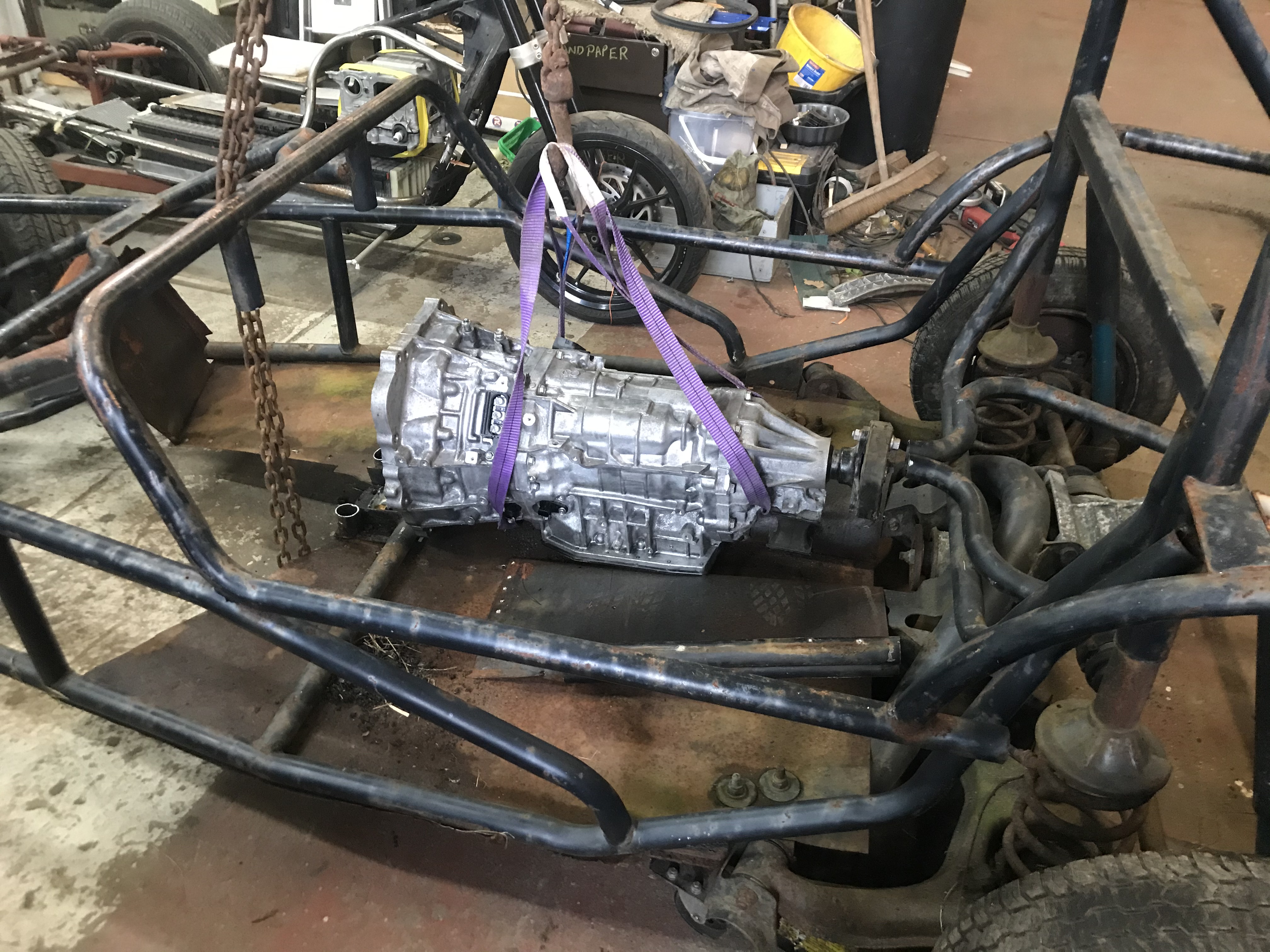

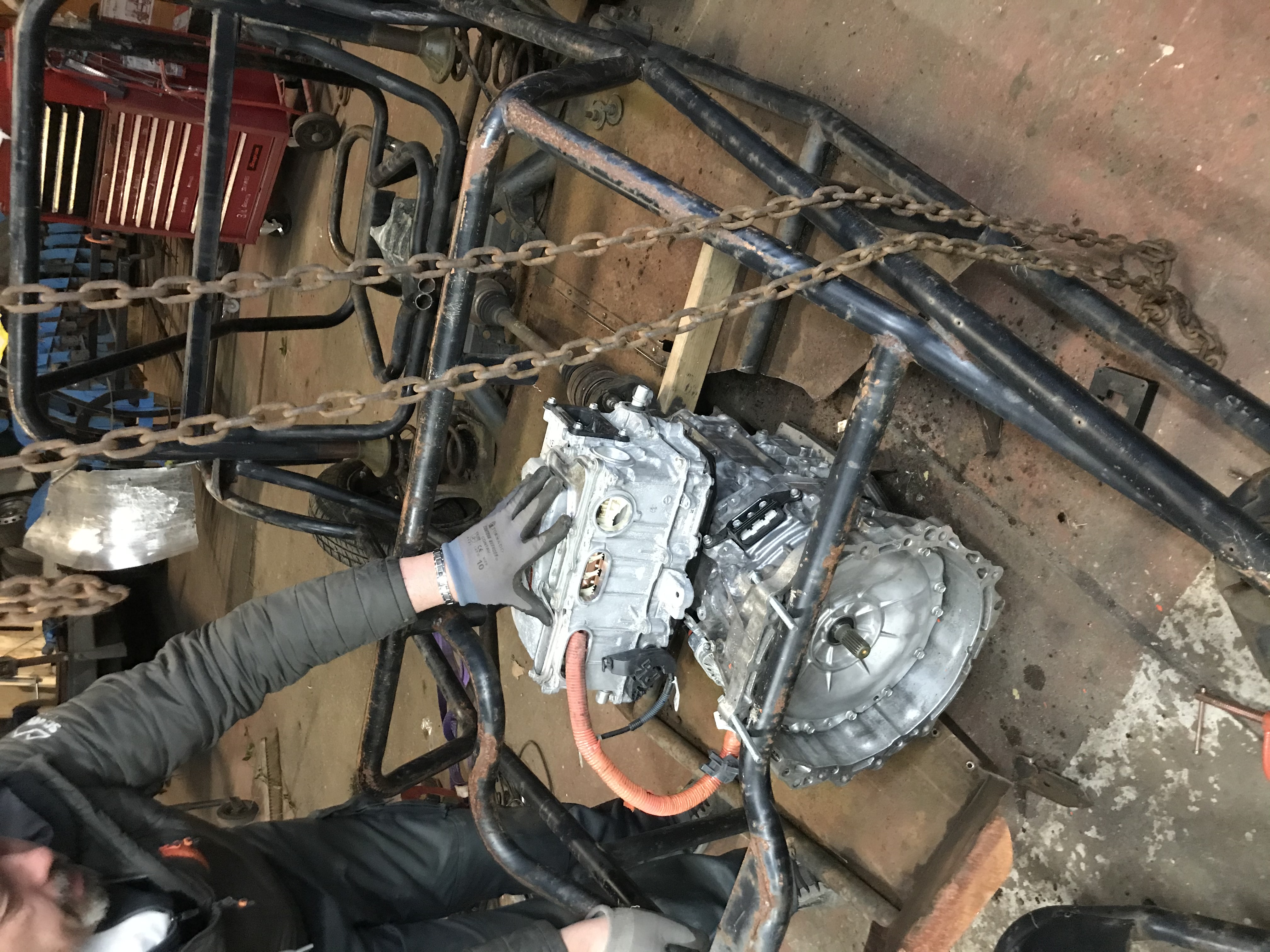

Good couple of hours therapy with an angle grinder and a redundant Robin Hood kit car chassis , tried a few options ...
Attached direct to the sierra diff didn't allow enough hip/leg room
will be easy to build attachment points further forward with a short propshaft and puts the weight dead centre of the car

Sorry if this question has been asked before. I have gone through the threads but not seen this particular question.
I am converting a Morris Minor. I have acquired an IS300H gearbox and inverter. Originally had only 30 bhp. So I don't need the combined power of MG1 and MG2. Looking at the box from the outside there is a split so I was looking at taking the bell housing end off with that motor. Looking at pictures from Chrskly (Great info). I believe the mechanical oil pump would be exposed. If this were replaced with an external pump, would it be feasible to remove that front motor? What issues would occur? I haven't taken my gearbox apart yet to have a look. But if the idea is a non-starter I'll have to figure out how to fit the whole transmission.

Long story short, this is possible, but it would require some non-trivial machining skills. Here's a photo of the part of the CVT you'd need to be covering over. 1. The input shaft/planet carrier piece can go, but you'll still need to keep the big MG2 ring gear. You'd need some sort of carrier or retainer to hold the ring gear in.Shaf1926 wrote: ↑Wed Feb 10, 2021 11:23 am Sorry if this question has been asked before. I have gone through the threads but not seen this particular question.
2. Since you're keeping the ring gear, you may as well keep the oil pump gear. The upside is that the oil pump will keep working. The downside is that the ring gear and oil pump stand out quite a bit. So your cover that you need to make wouldn't just be a flat plate, but a fairly thick, fairly complex-shaped piece of machined metal.
3. Pretty sure at the top you have an oil channel that feeds oil to MG1. It would probably be fine just to pour straight down, but you'd need to be sure to leave clearance.

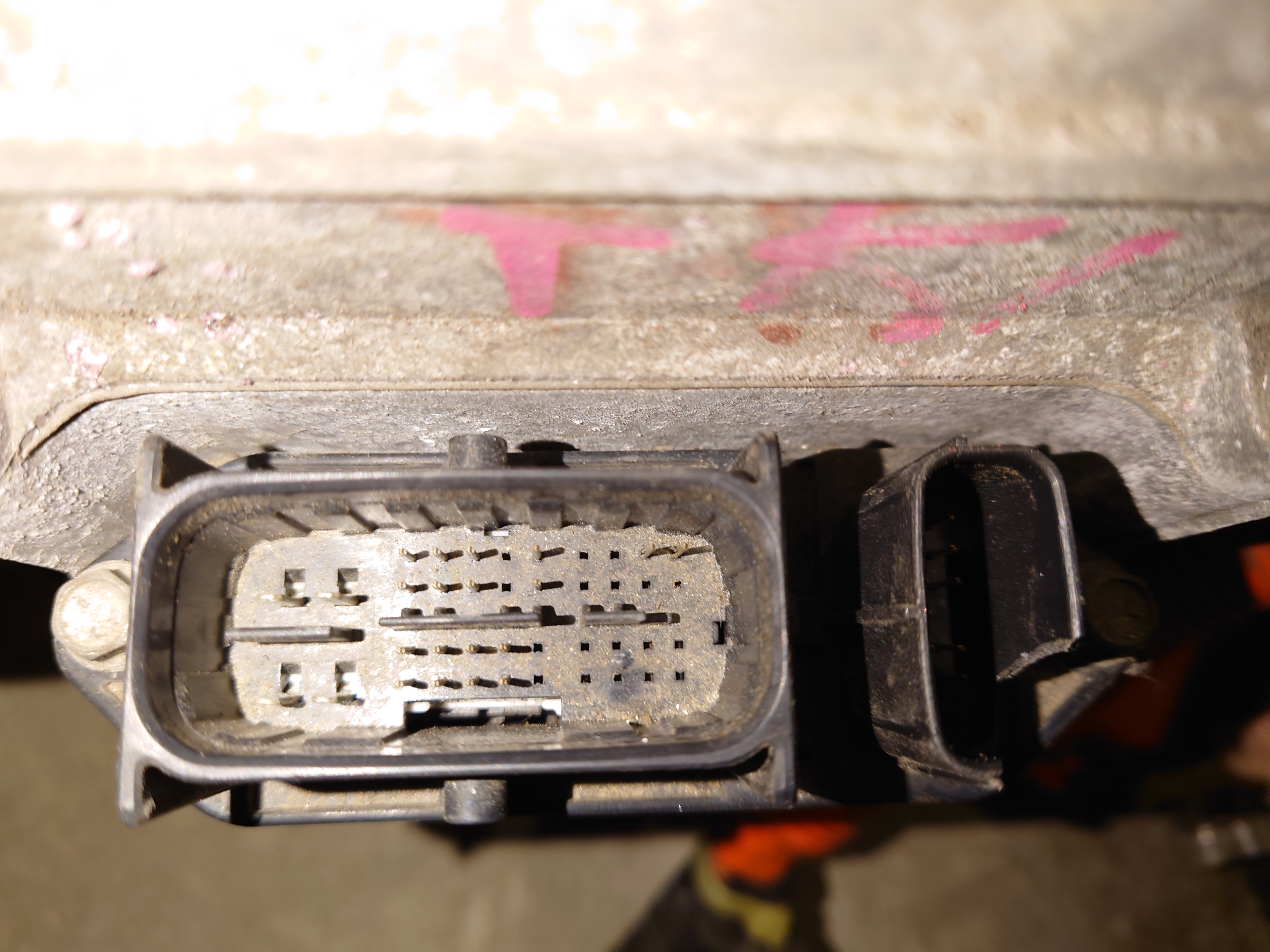

Hi! Have you defined the 3rdGen Camry (AVV50R) connector pinout? I realize that the main connector is different from any described in the wiki.johnspark wrote: ↑Thu Mar 18, 2021 12:35 ami have a Camry AVV50R that works fine except for a noisy ICE sitting on my lawn, with close to a IS300h inverter in it. So can sniff signals. I just need a little bit of help working out how to sniff it. (I have a PICoscope 6000 which can grab serial data, and also CanDuev2.2 converter ). Would like this info to end up in the wonderful ZombieVerter VCU as time permit,s by these great, clever people.
I tried to find out in the service manuals but unsuccessful.

I'm going to pursue the L210 route with matched inverter and Zombie board for my next project. Just picked up an inverter cheap but can't find anywhere on here that the pinout has been mapped. Connector looks just like the one on the Camry inverter above. Has anyone mapped the pinout for this or found connectors? Or are they unobtanium like the Prius ones? Have tried searching the forum for various things, including model number (G9200-30132) but no joy.
Assuming I'll replace it at the moment but be nice if I didn't have to.
