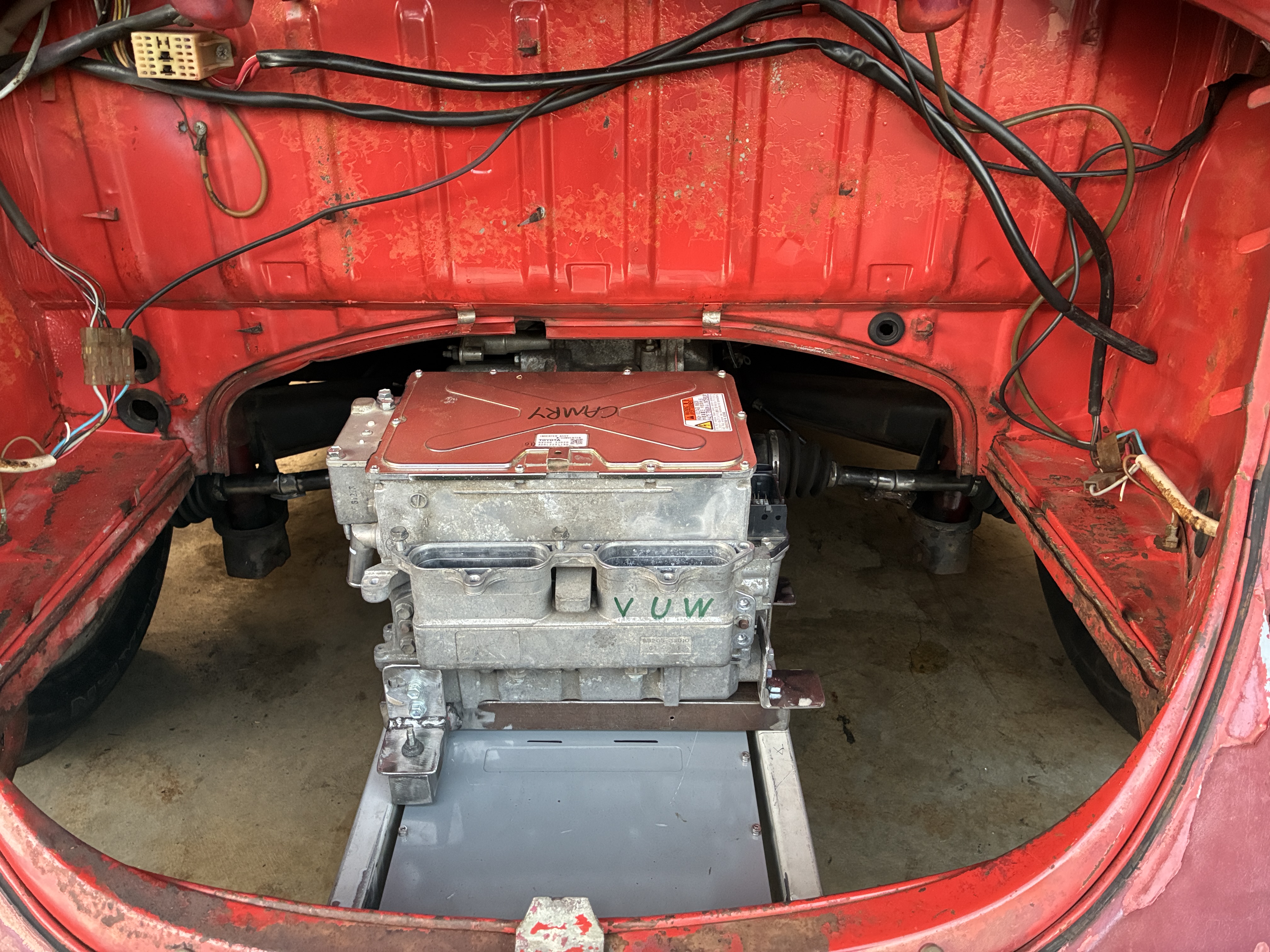

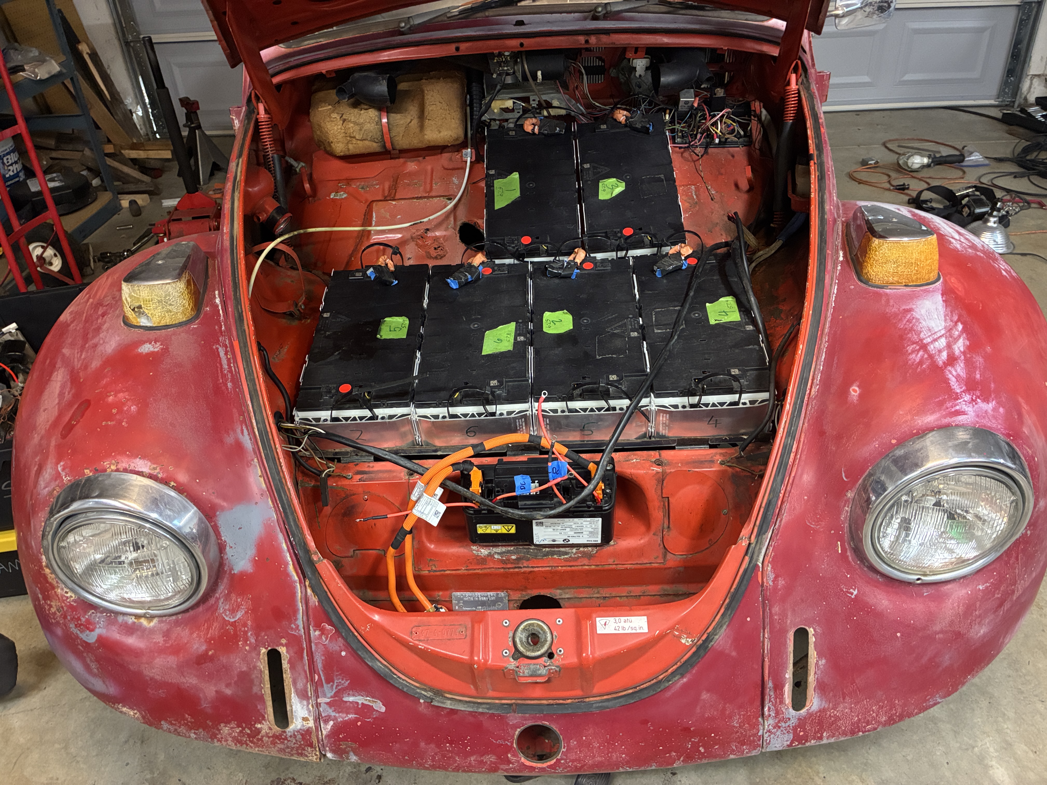

so even with the battery charger and Camry inverter installed that was not enough weight to bring the CV axles to a respectable angle
Gregski
Posts: 3152
Has thanked: 628 times
Been thanked: 1606 times
Re: Bunky the eBug: A 30 Day EV Conversion
Post by Gregski »

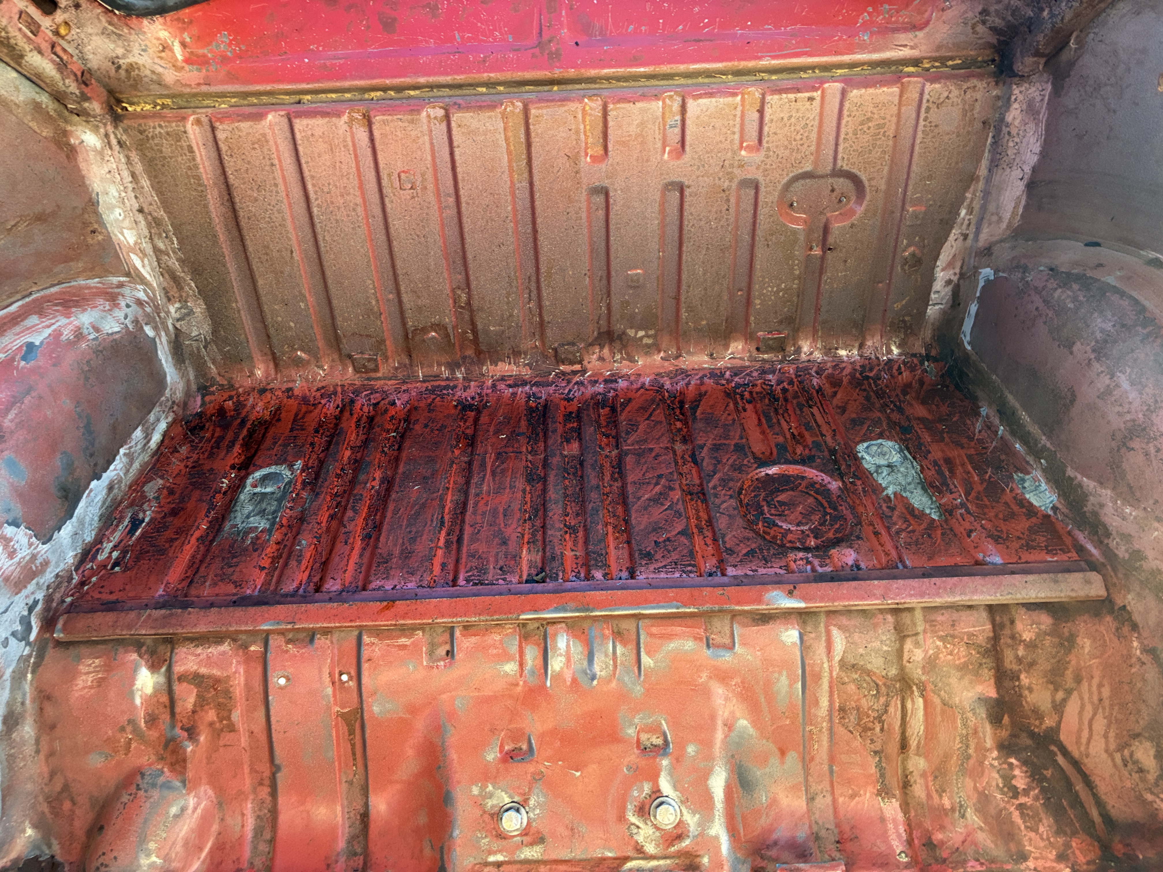

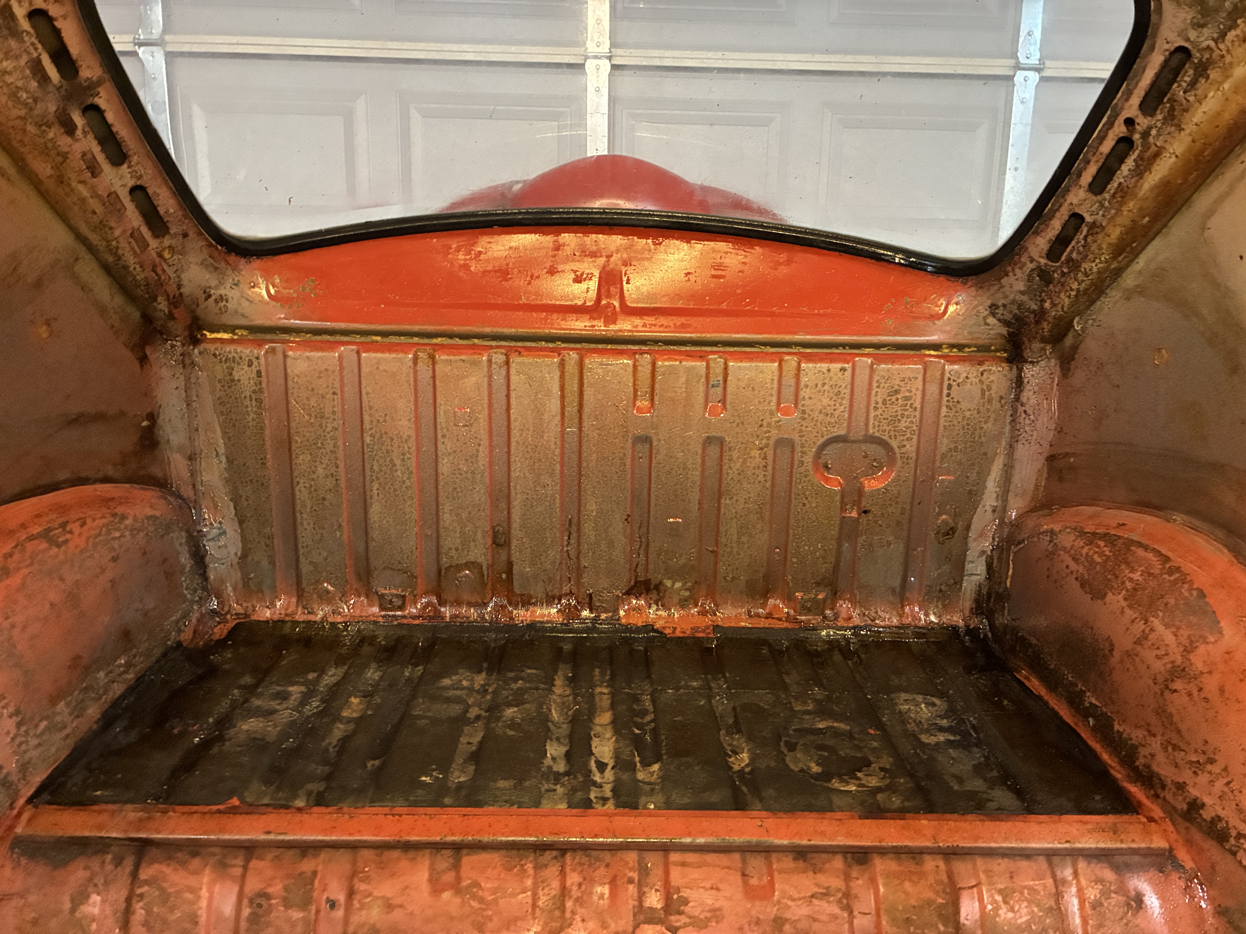

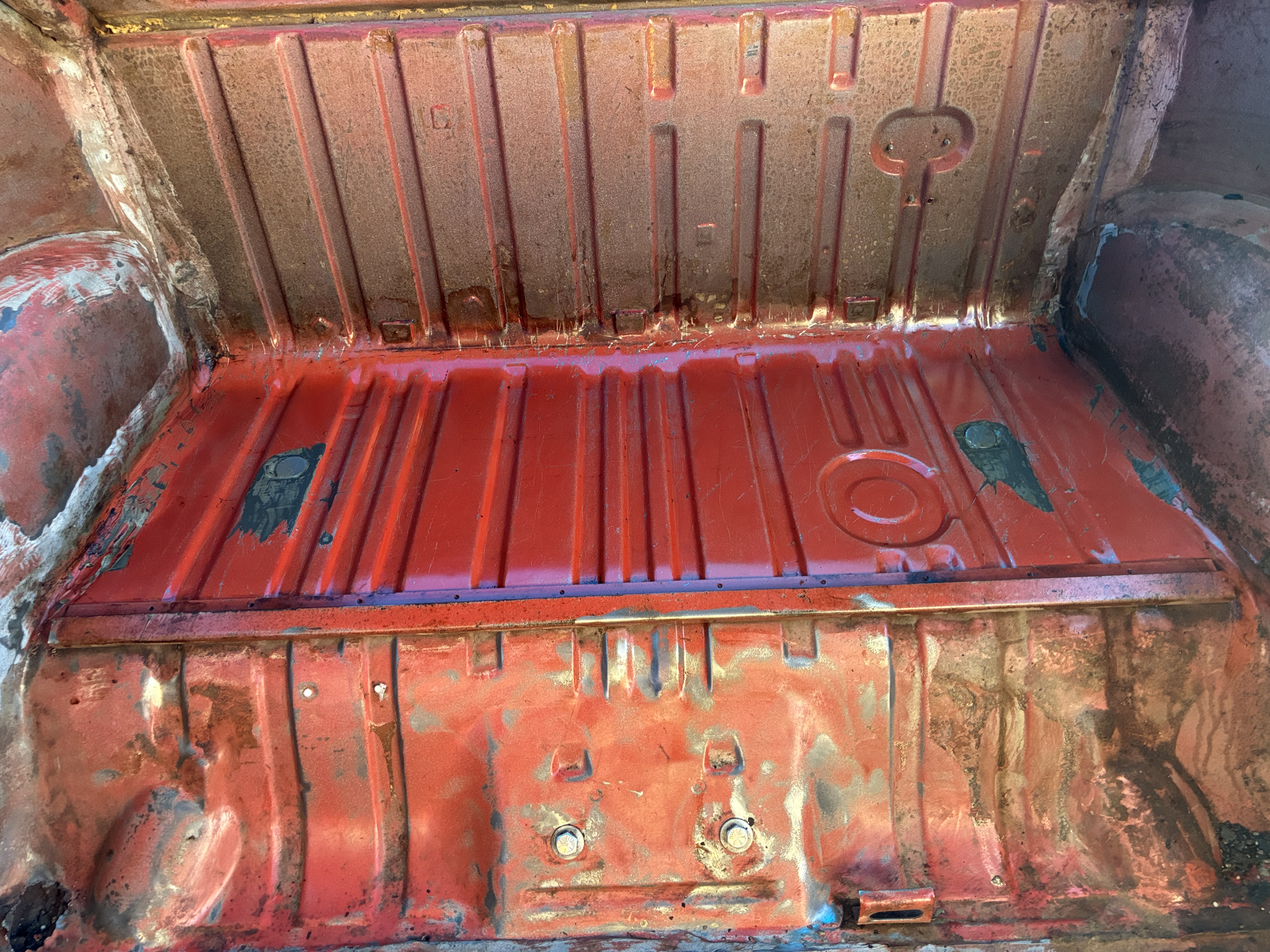

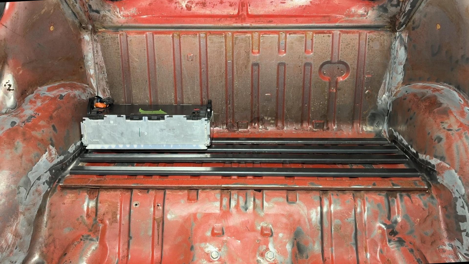

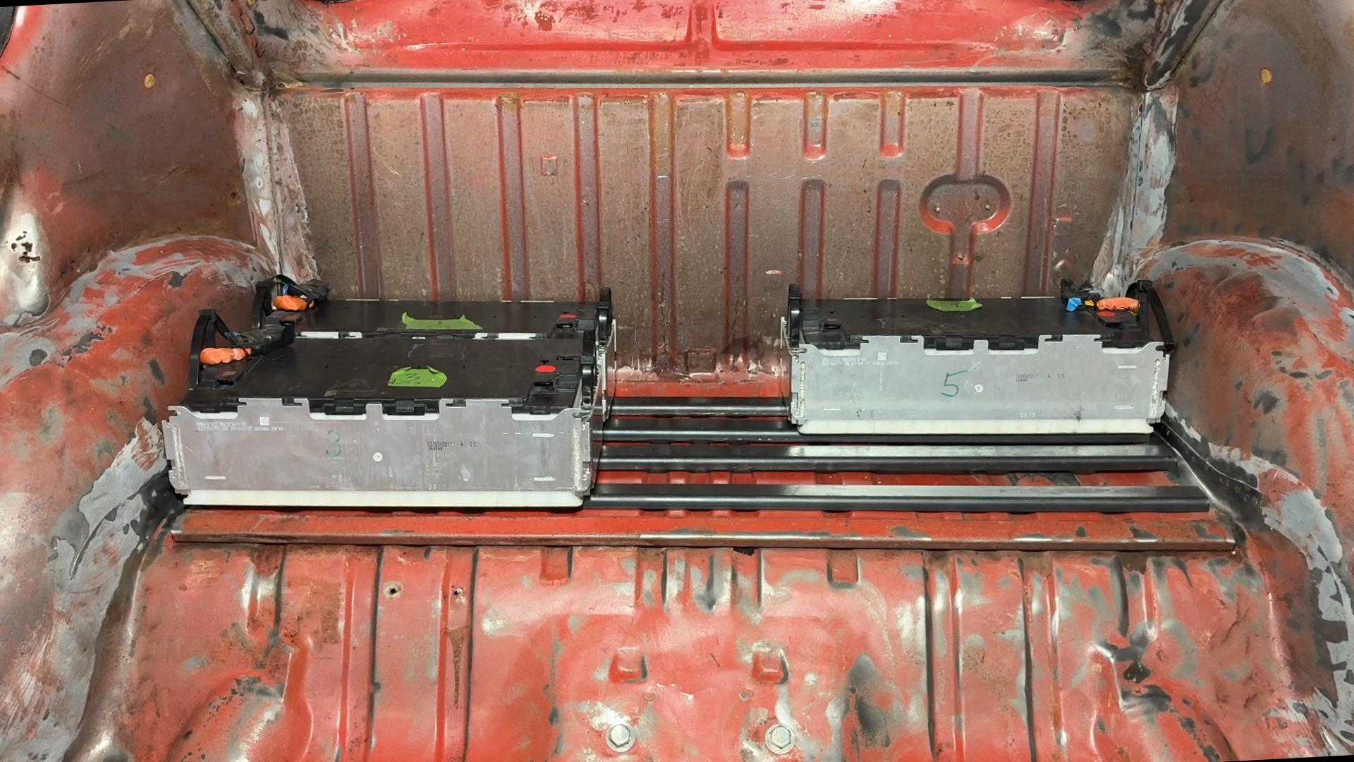

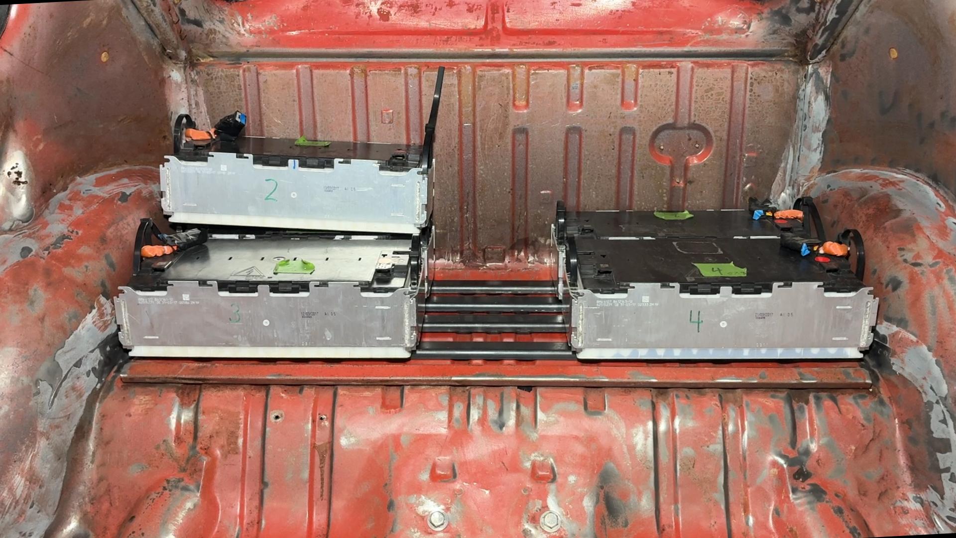

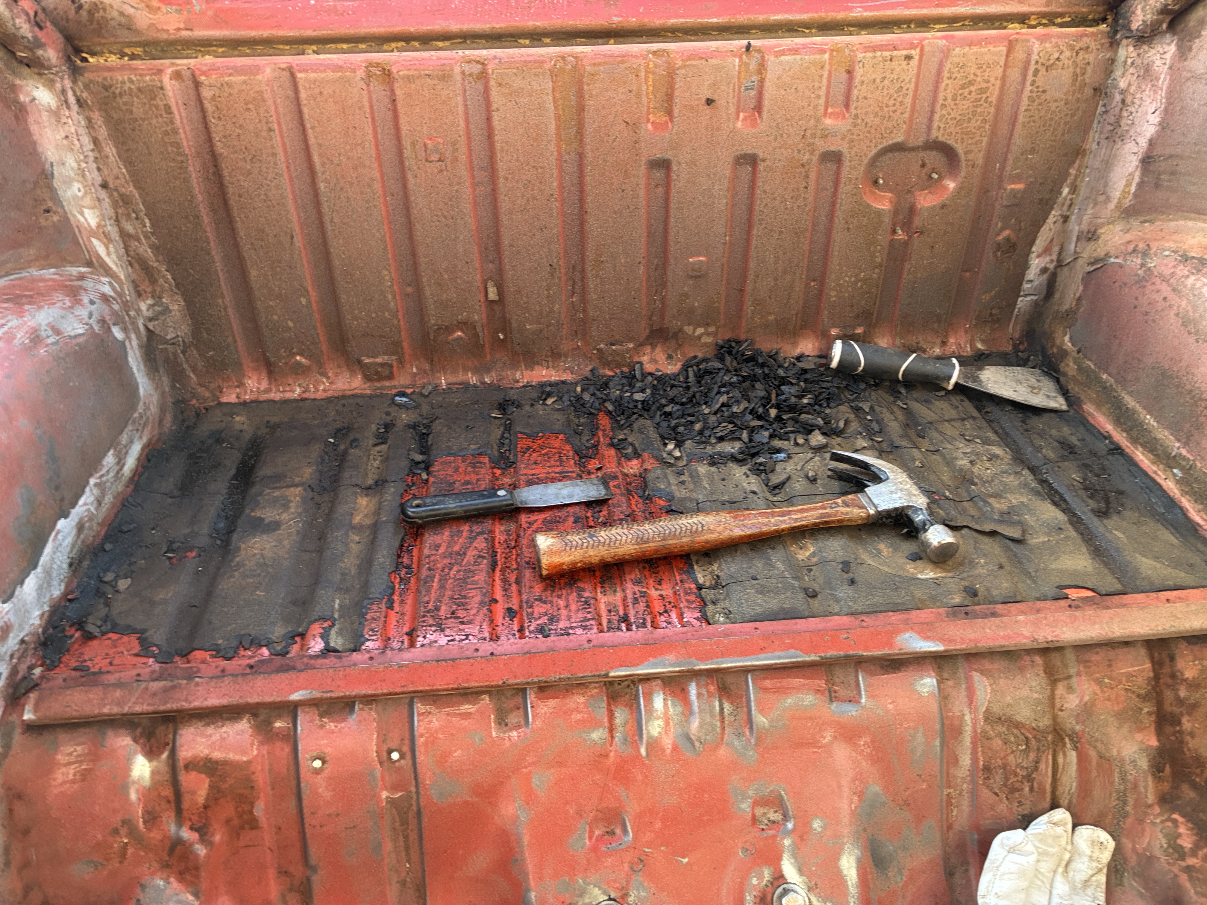

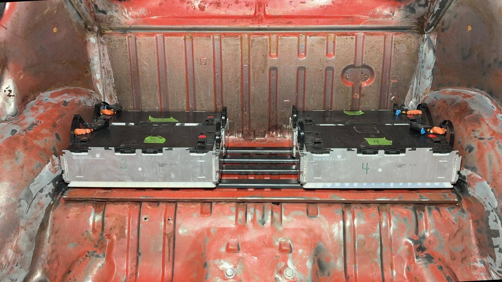

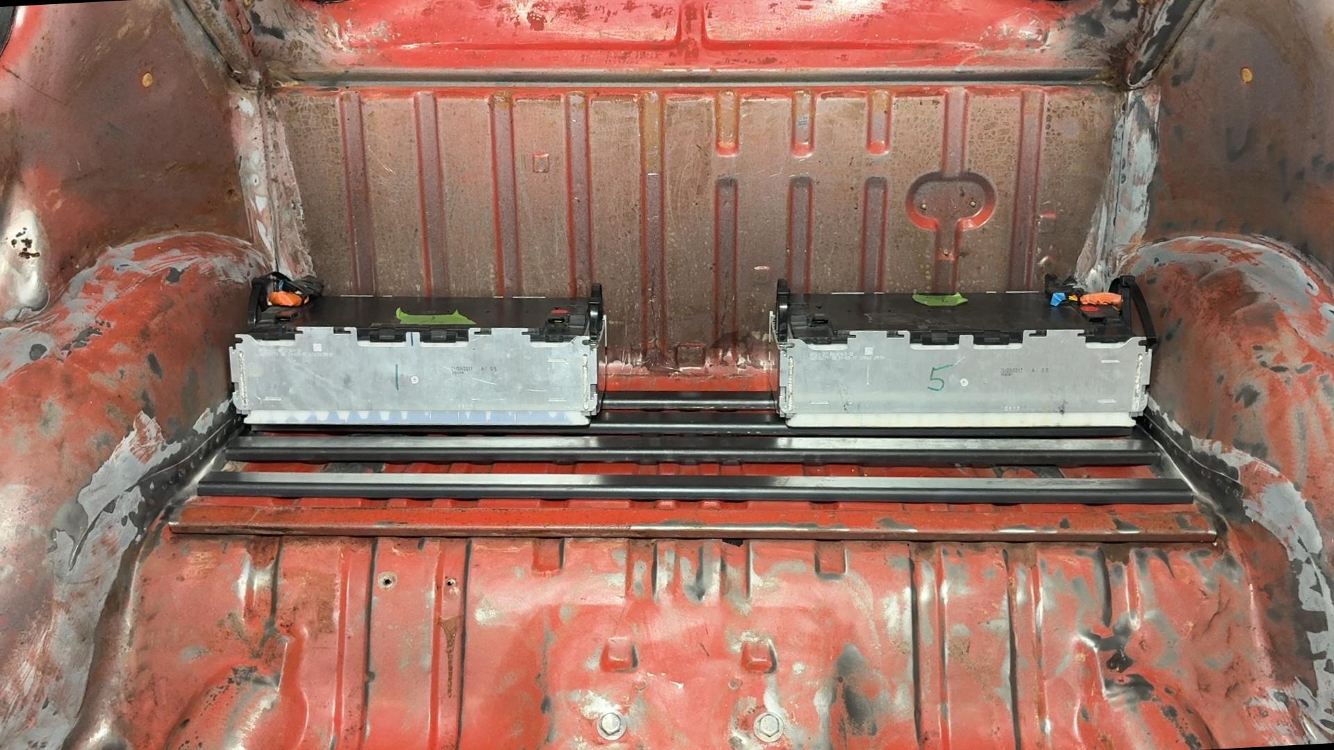

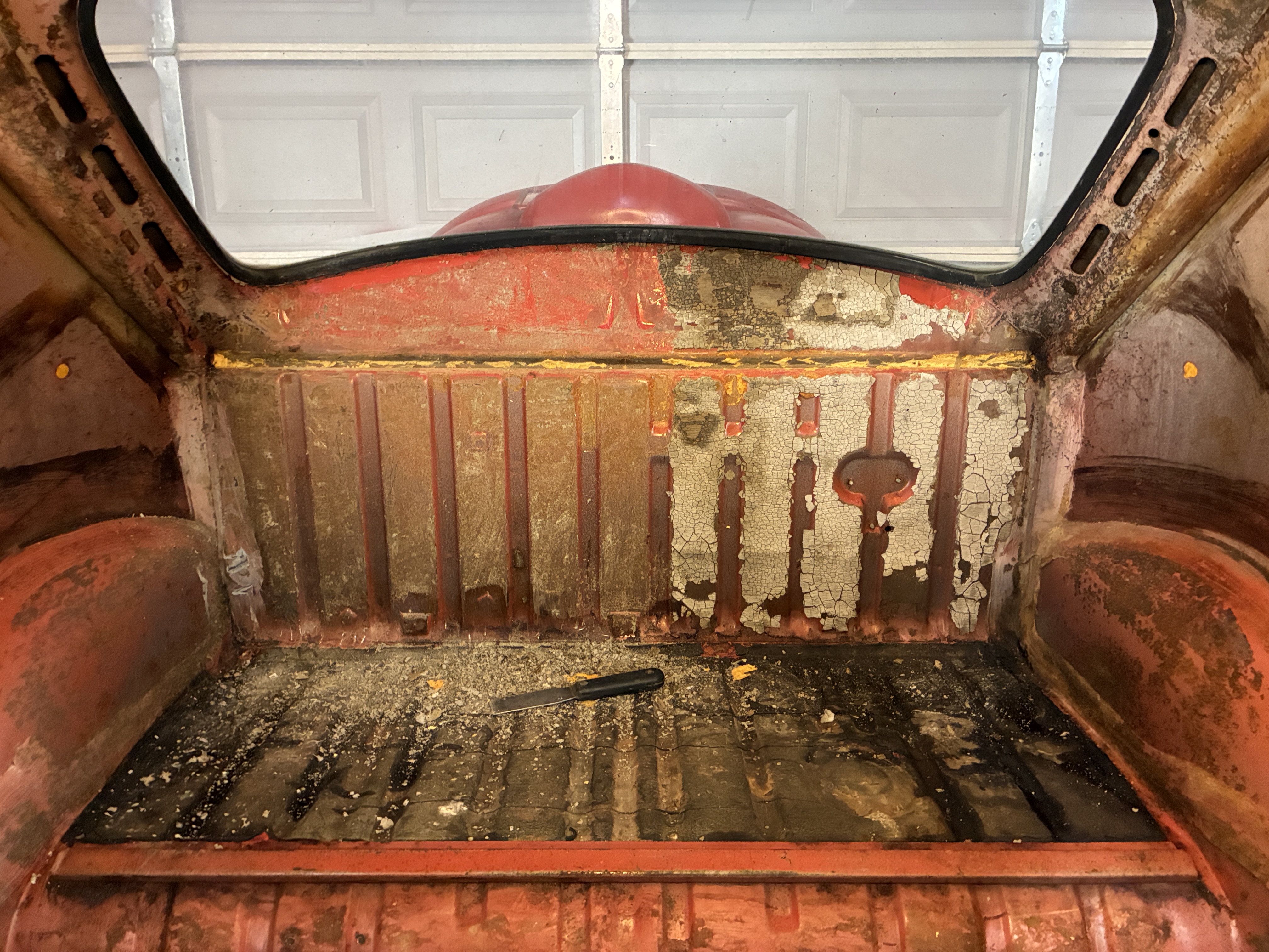

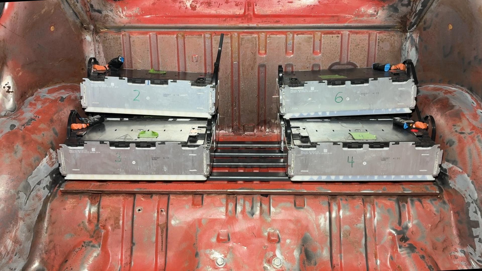

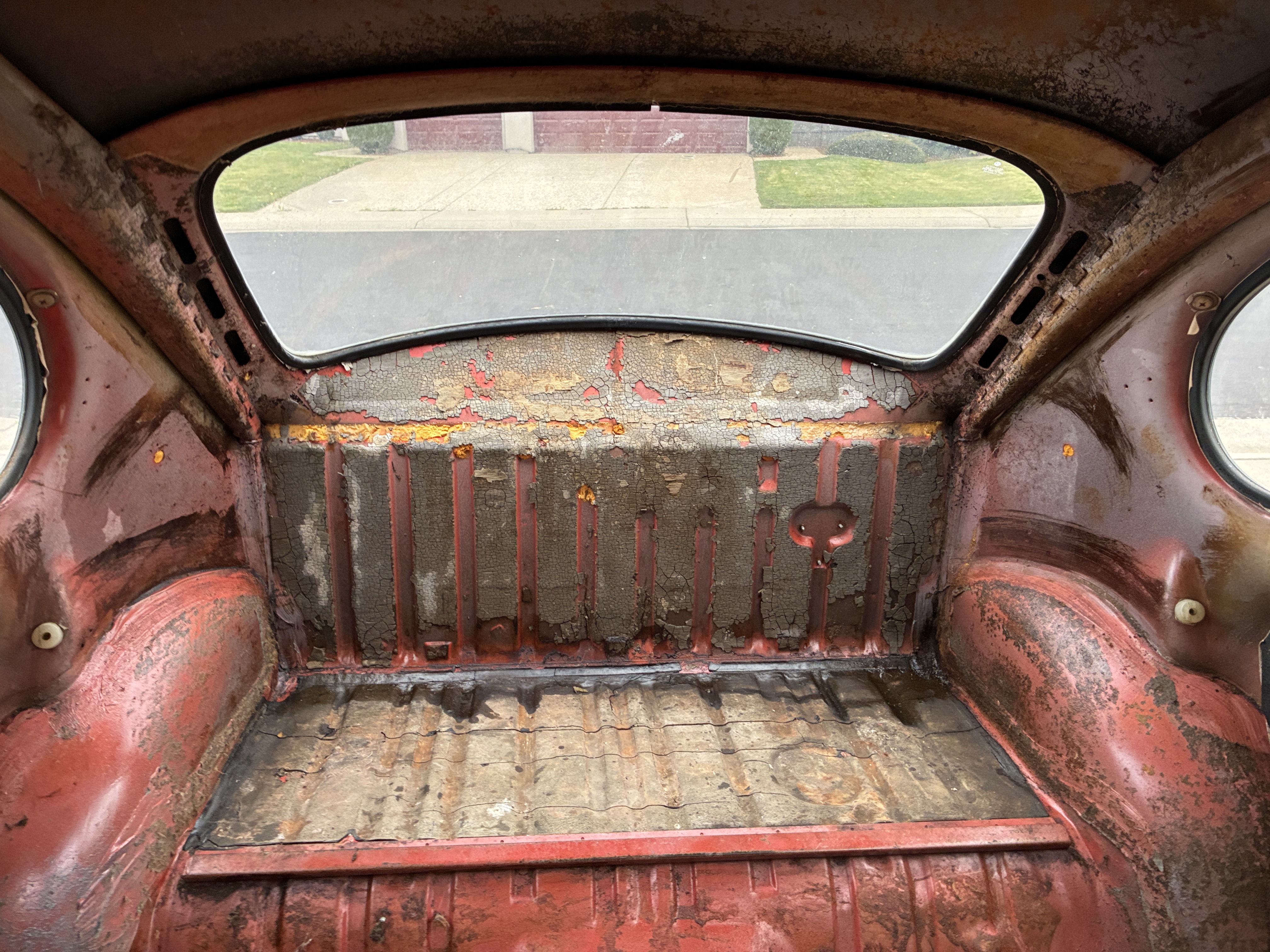

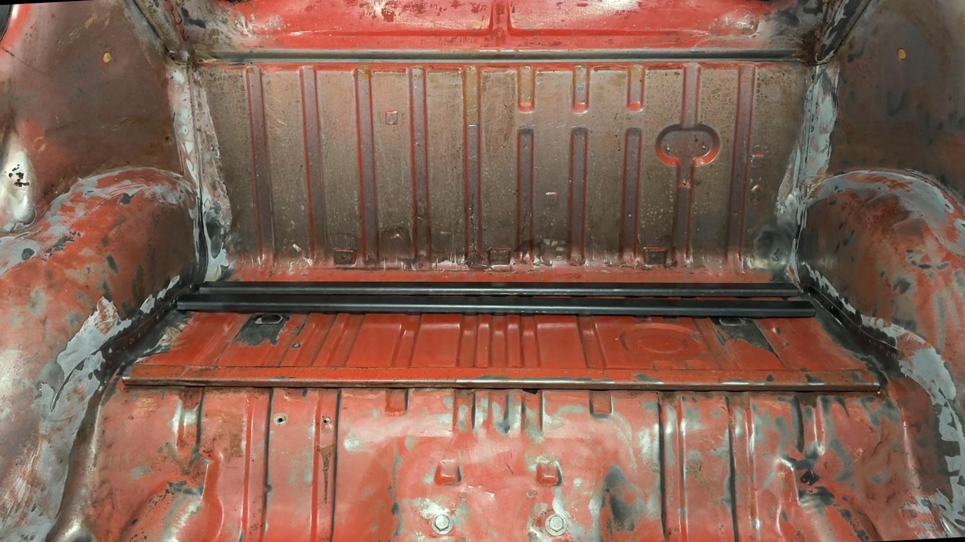

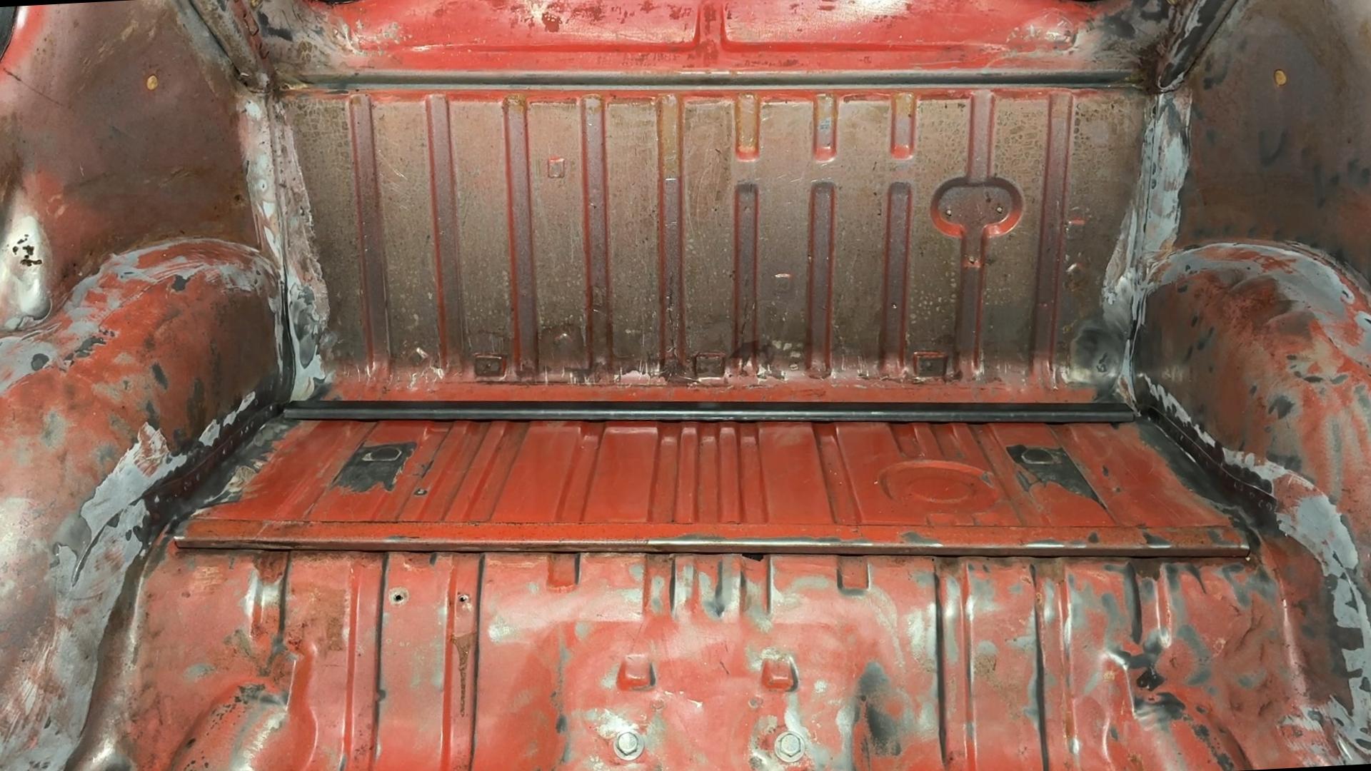

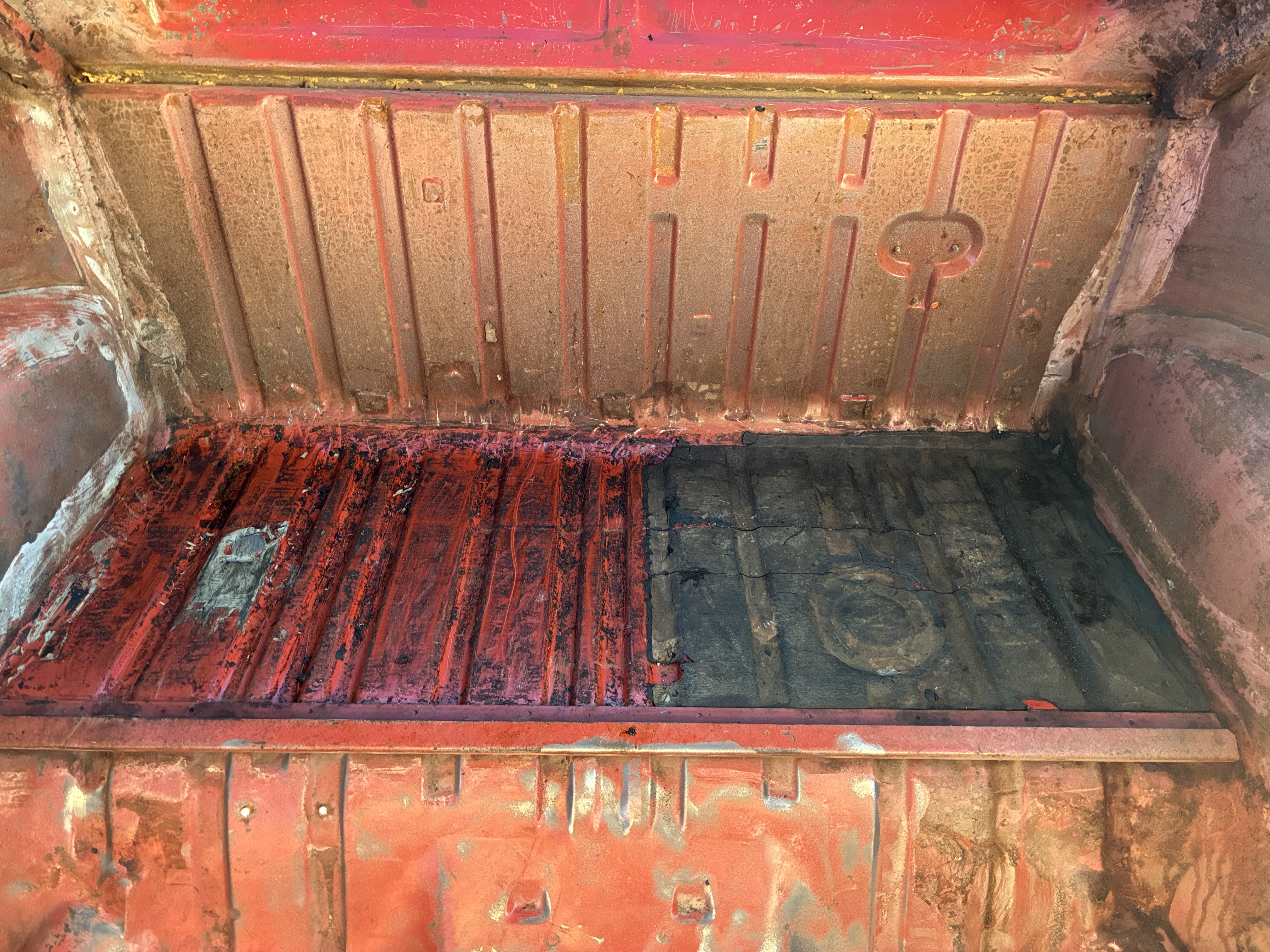

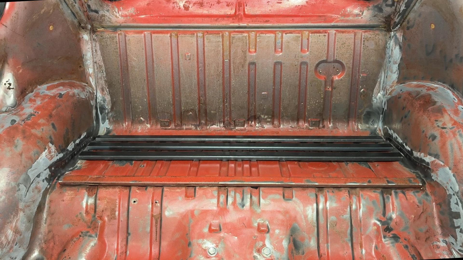

so I decided to load up the luggage shelf with the BMW hybrid batteries, but first we had to breath in some ass pestos
and a couple days later I done did this part
I get best results when I use a 50/50 mixture of ferocious tenacity and quality elbow grease

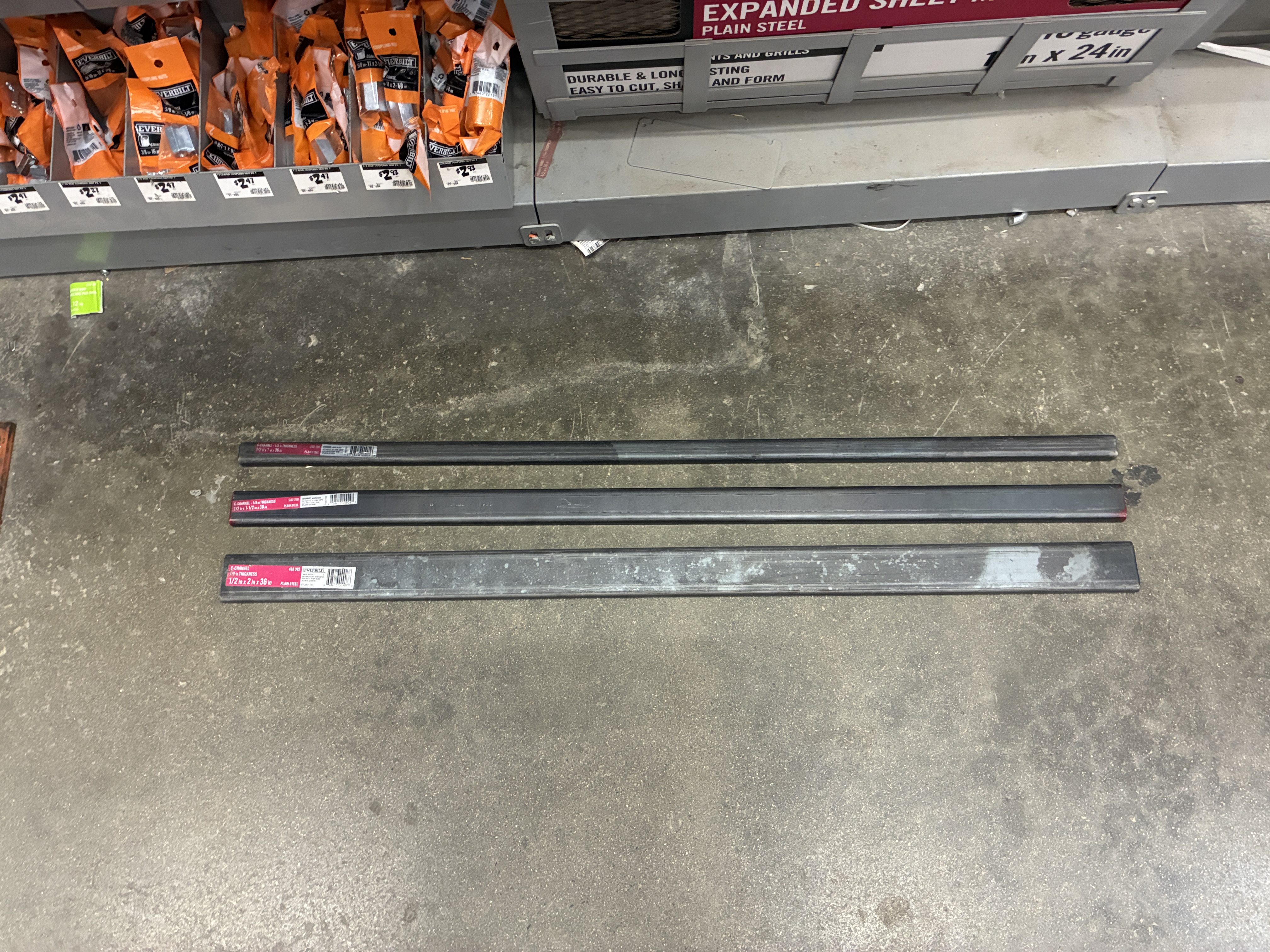

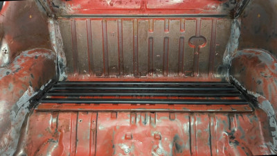

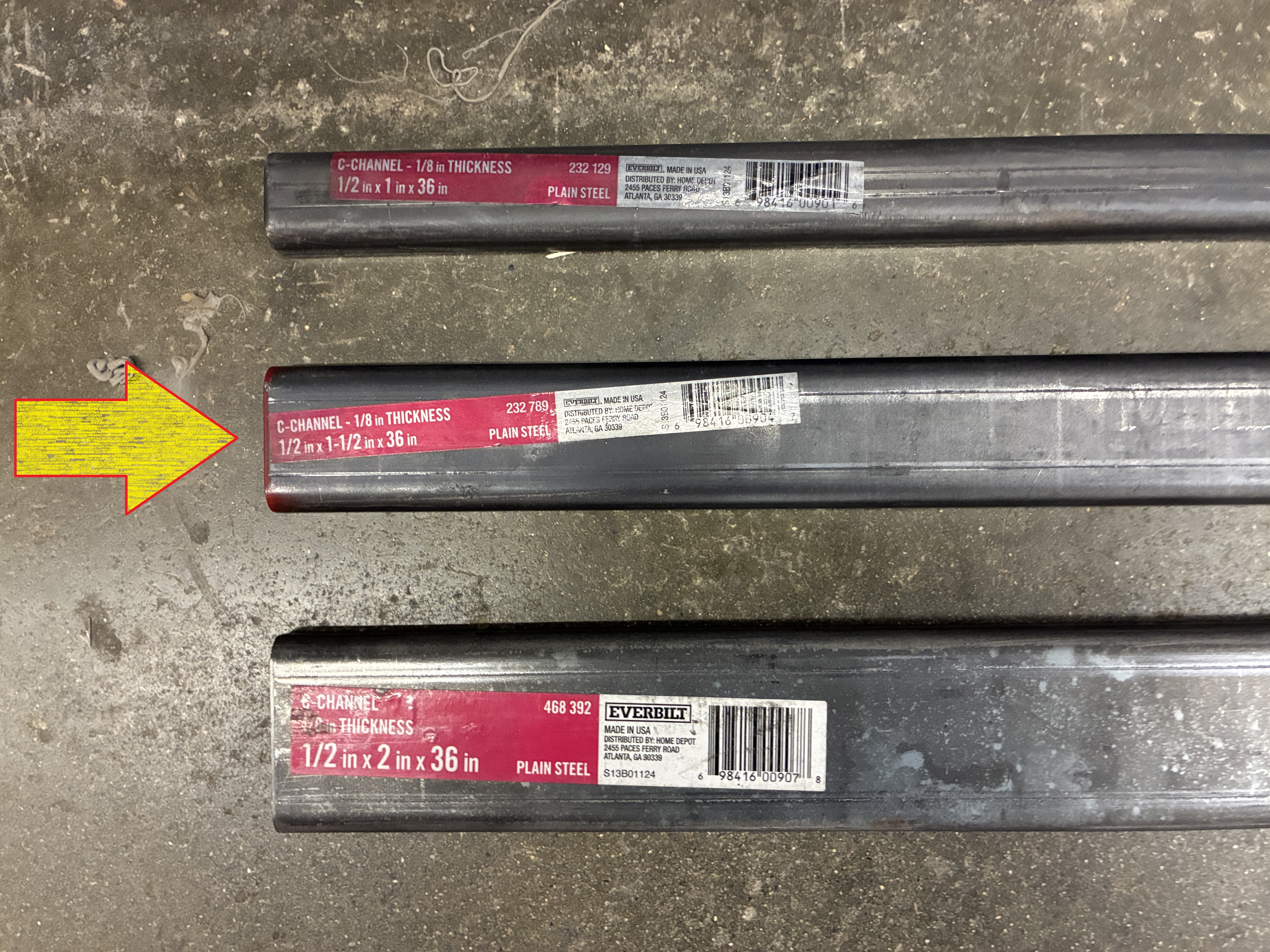

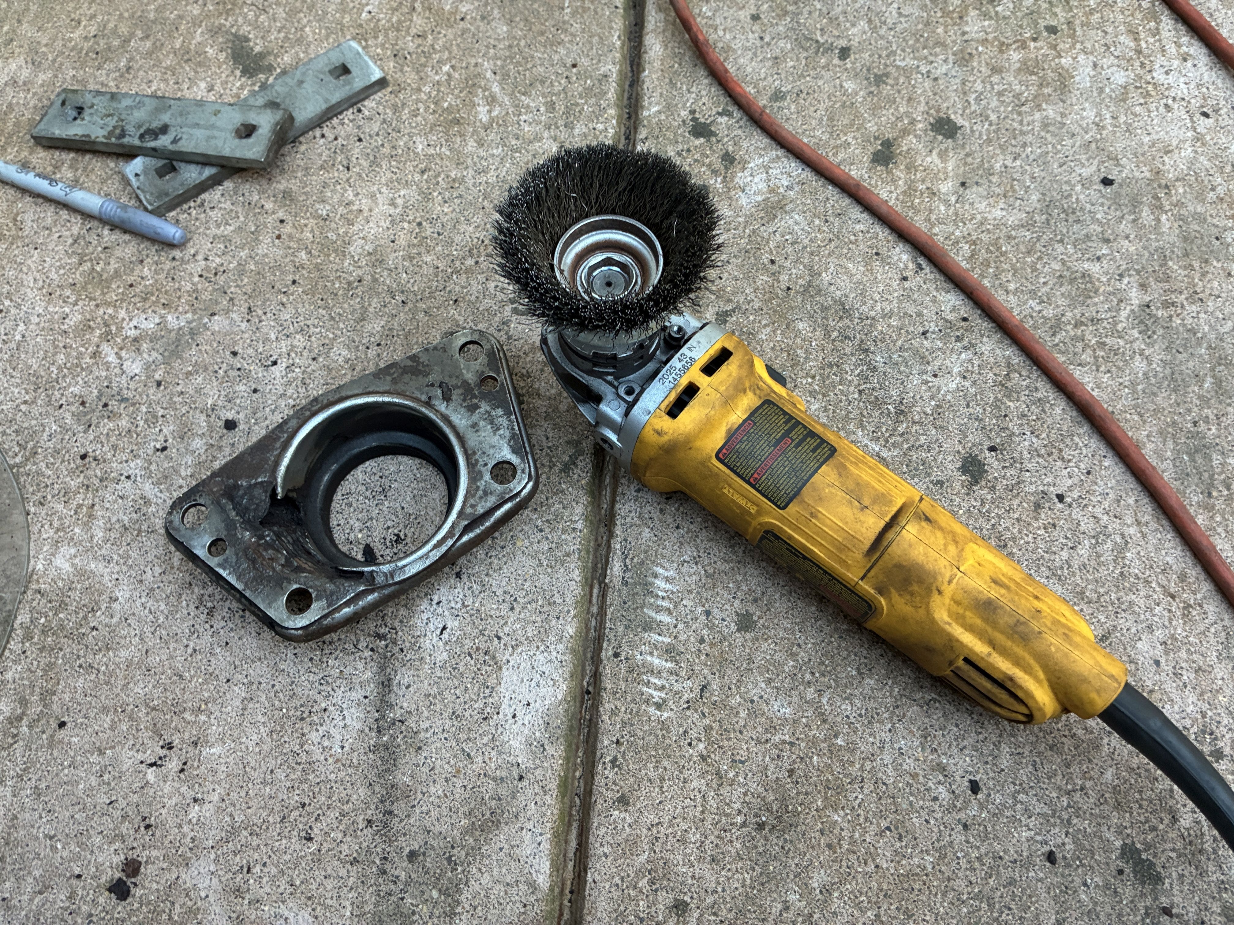

we had three choices
we went with the 1 1/2" wide C channel
for $22 bones each and we needed four
these will eventually get fashioned into some sort of bracket thingie

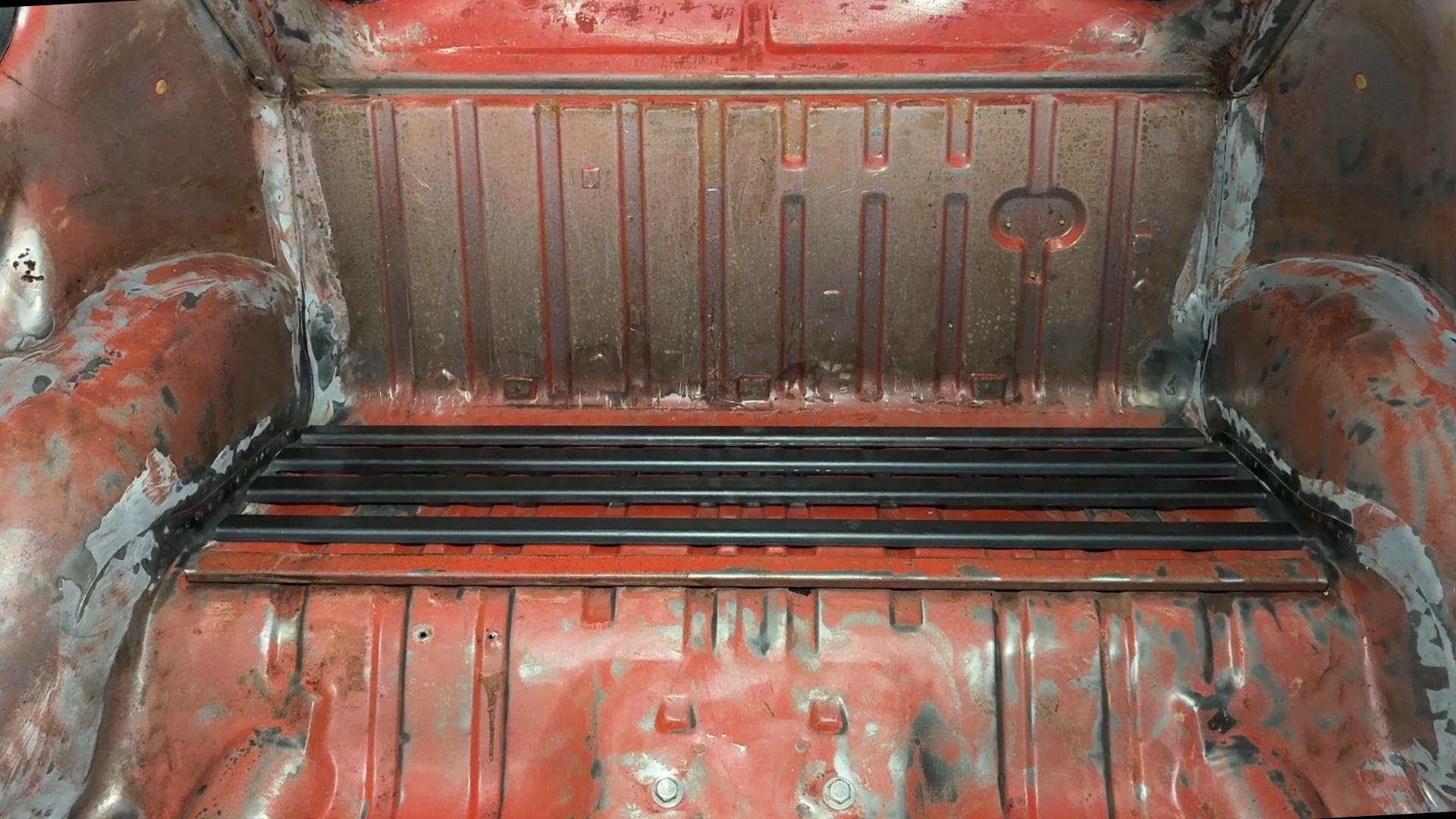

this is literally the perfect place for the BMW 530e hybrid 9 or 12 kWh battery pack, and as a bonus we can keep the modules arranged in their stock OEM configuration, guranteeing cable reachability

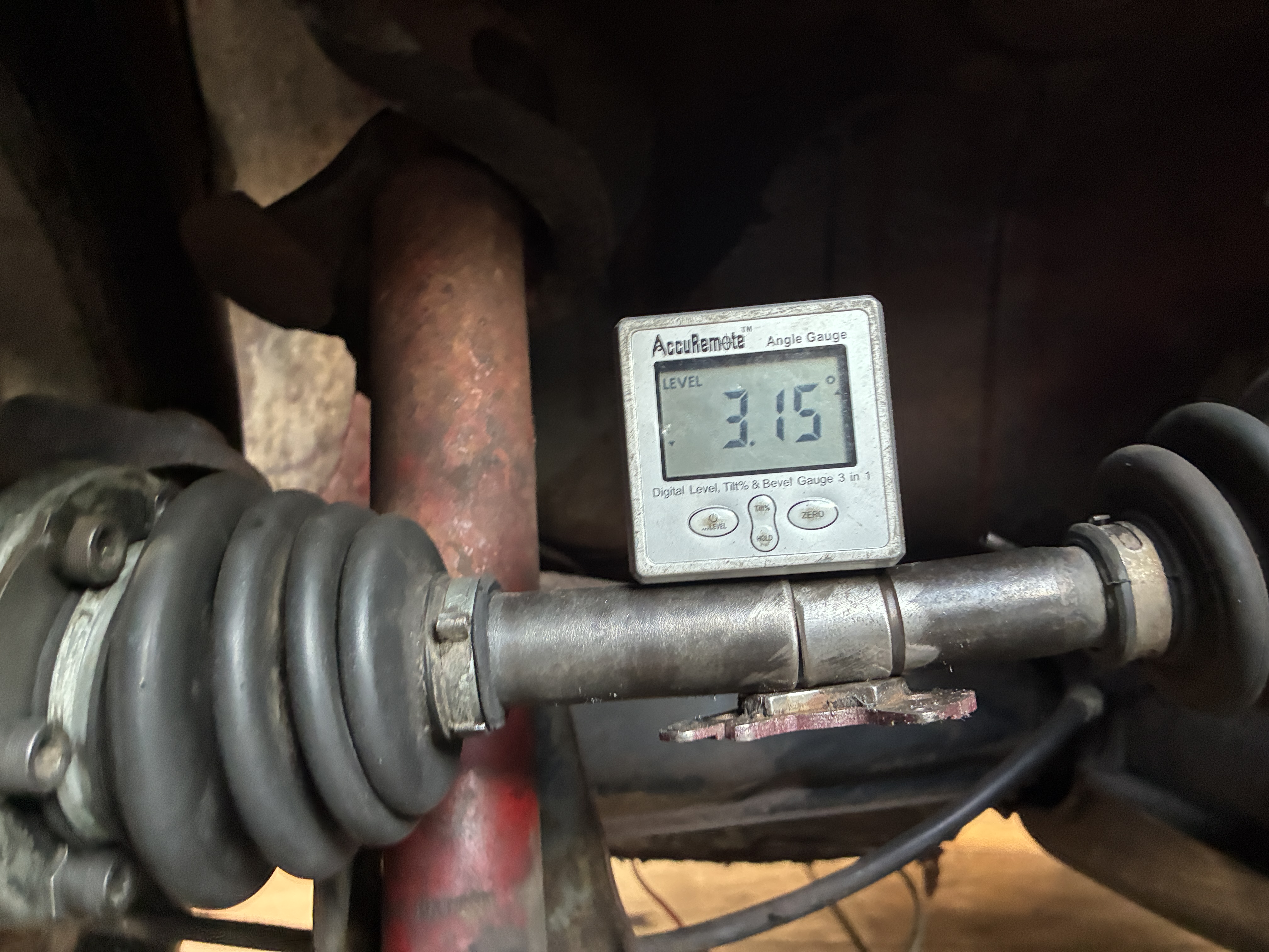

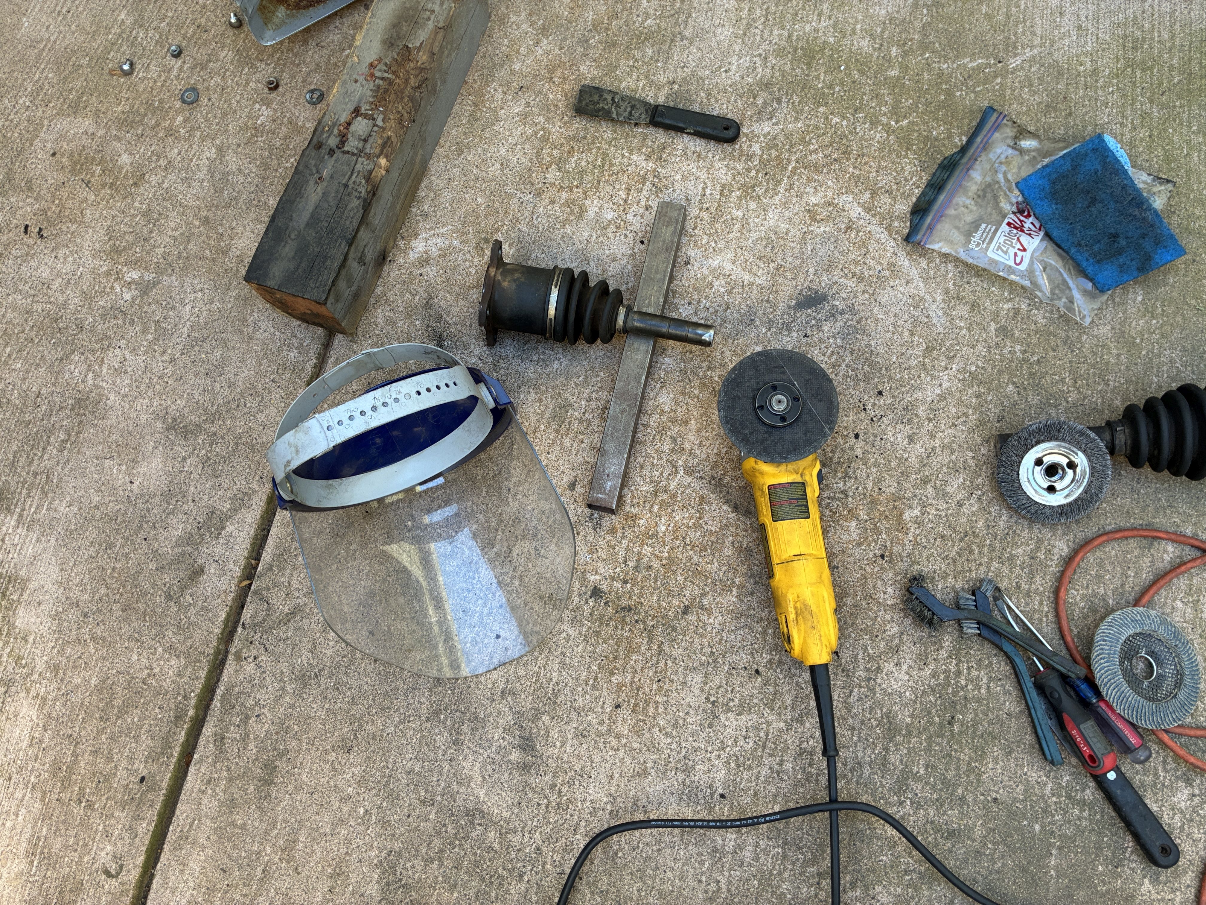

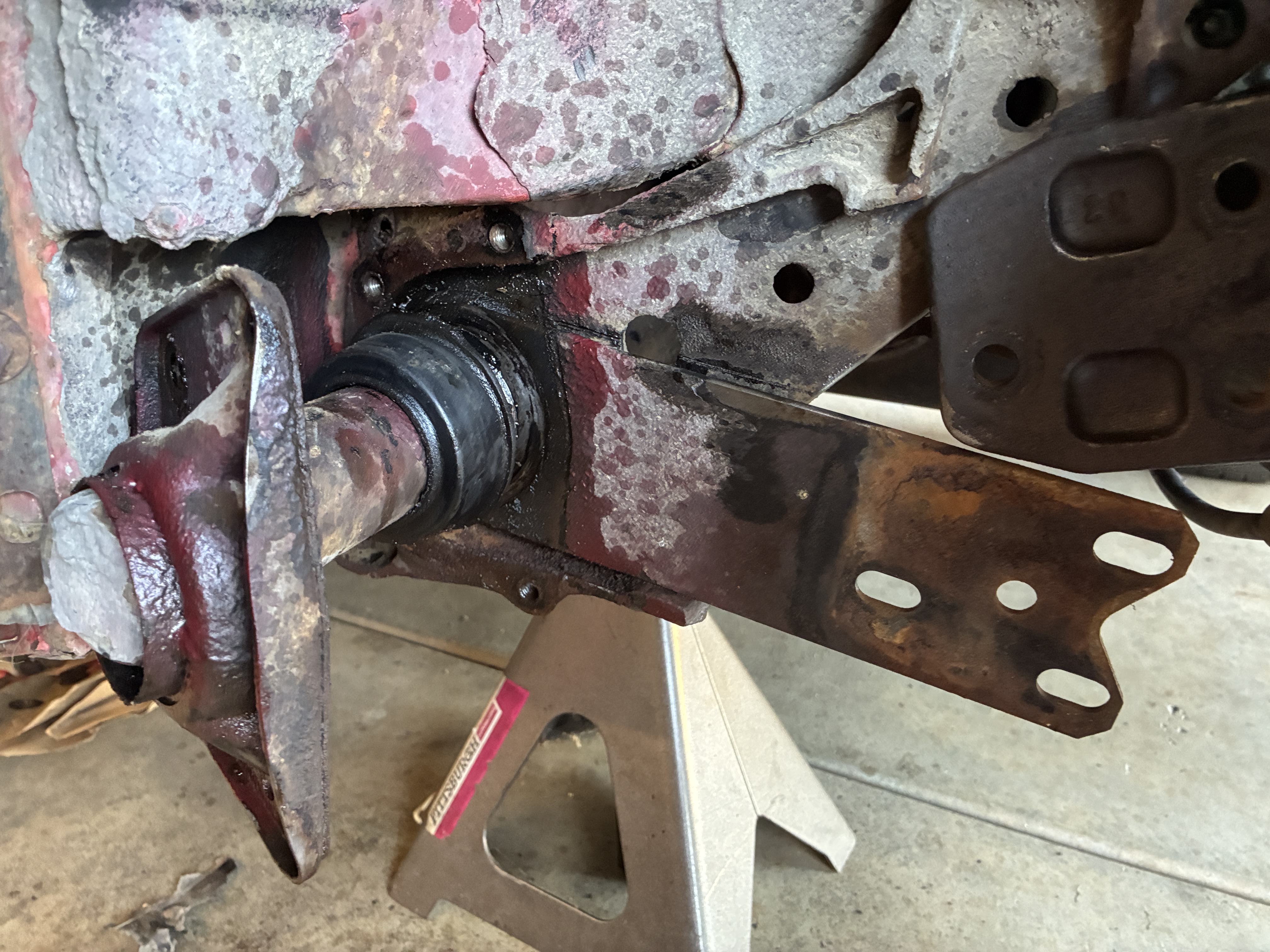

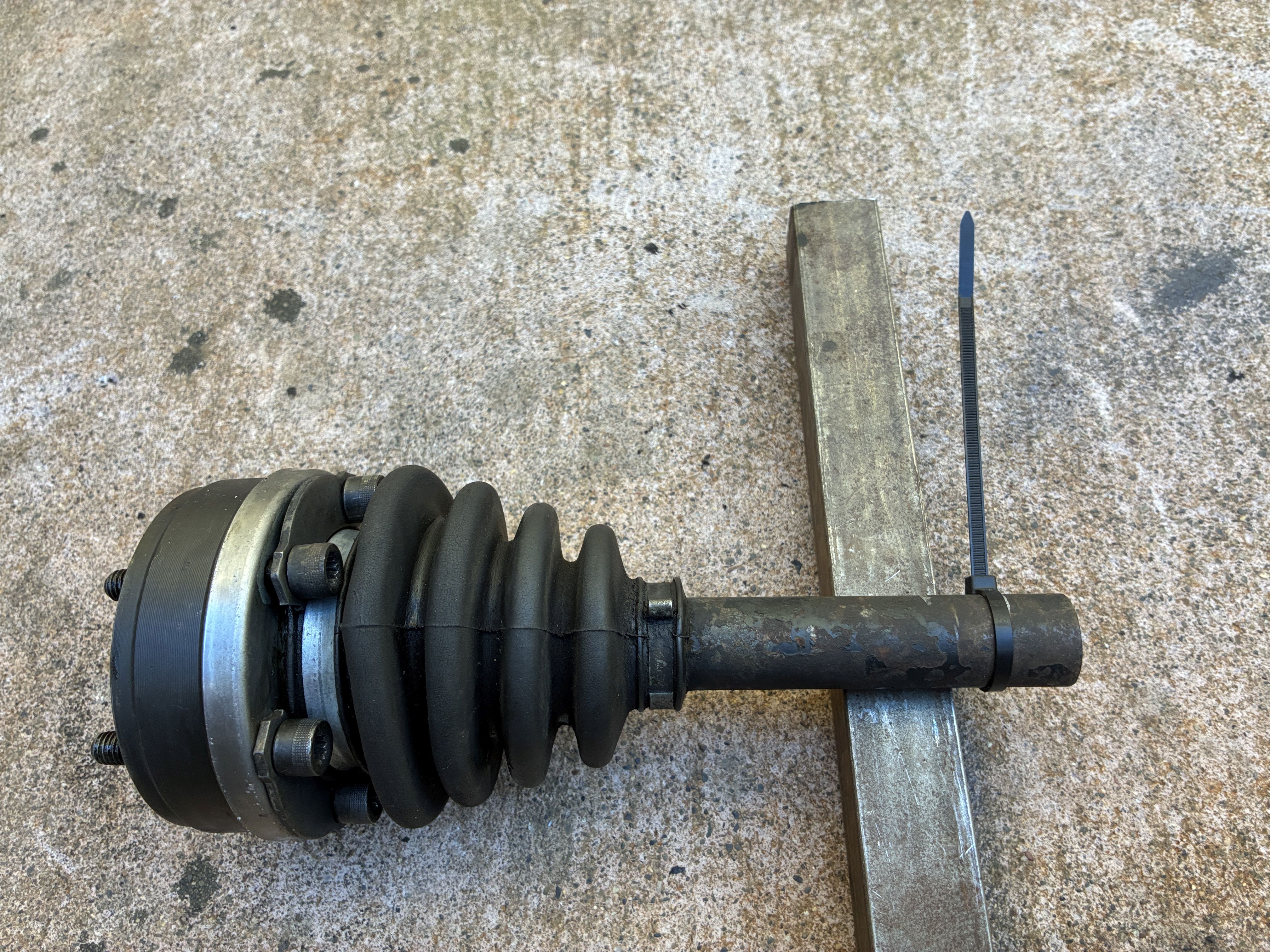

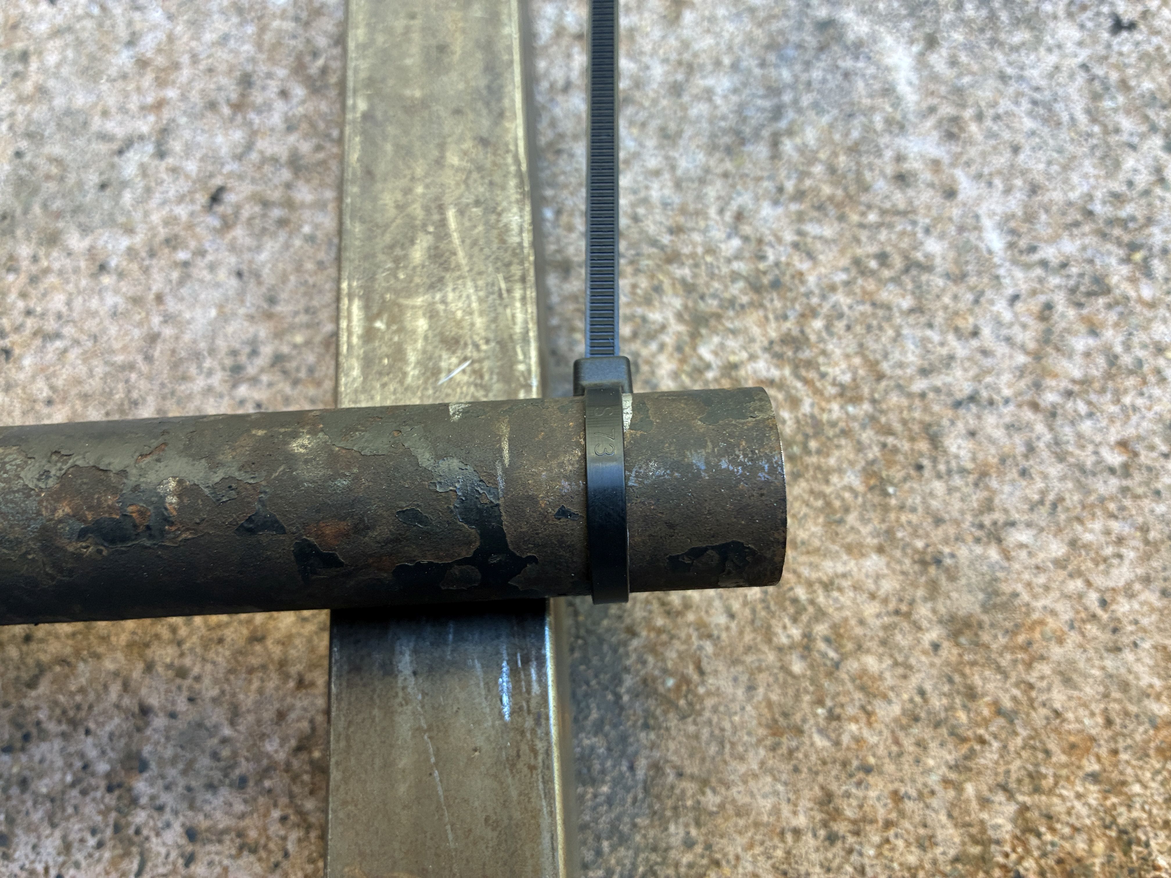

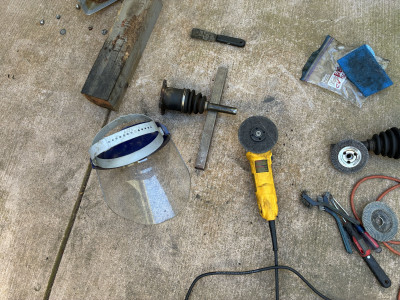

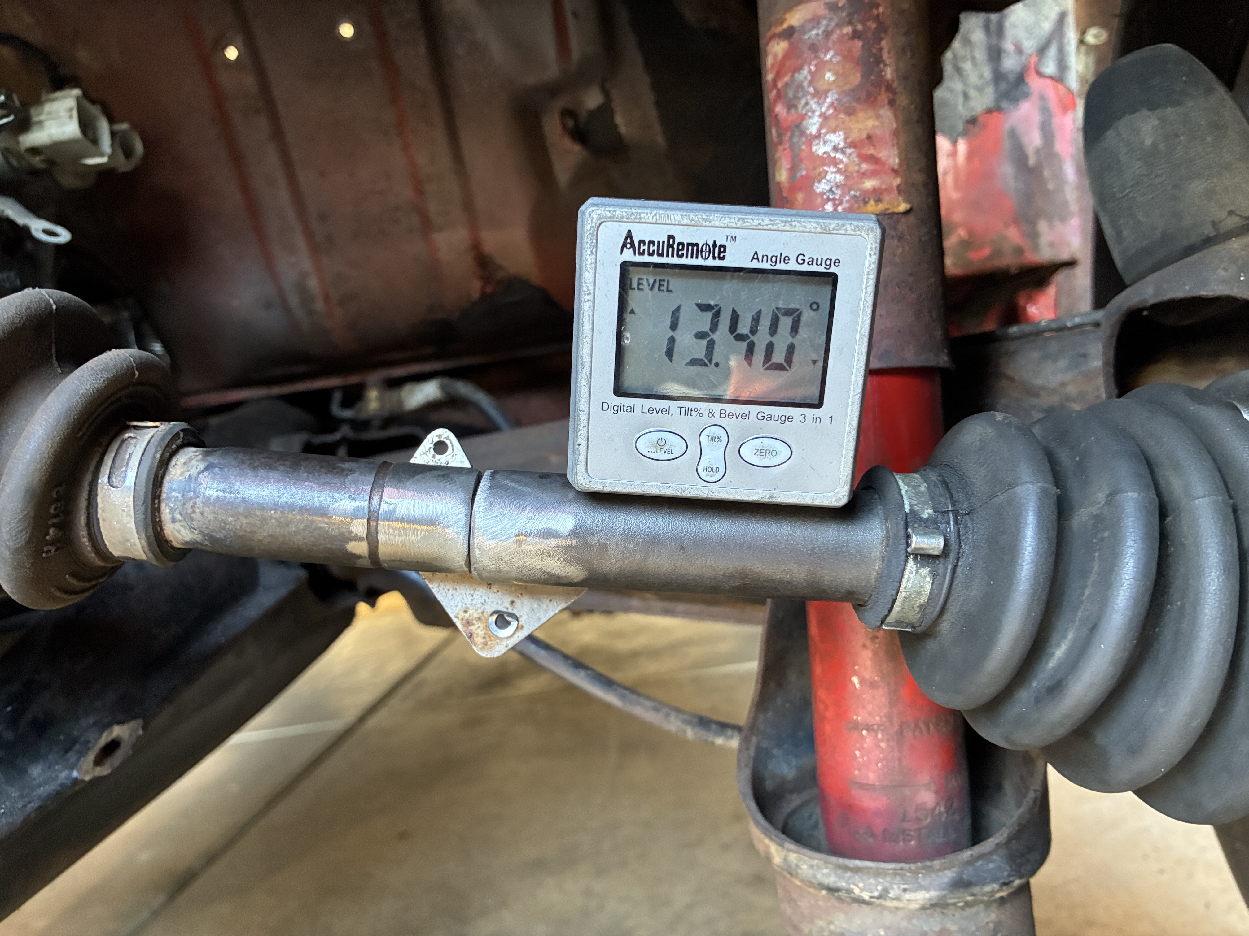

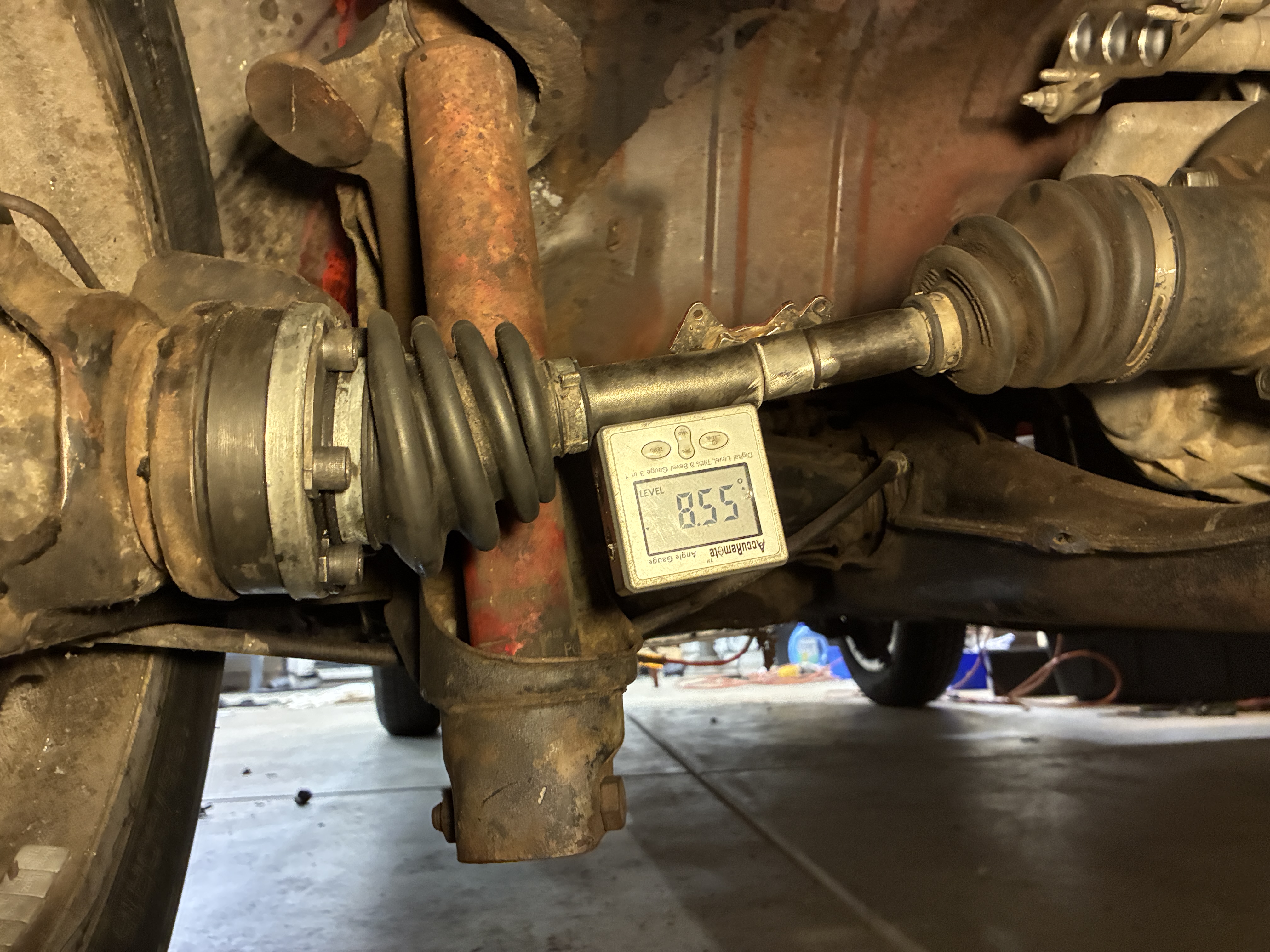

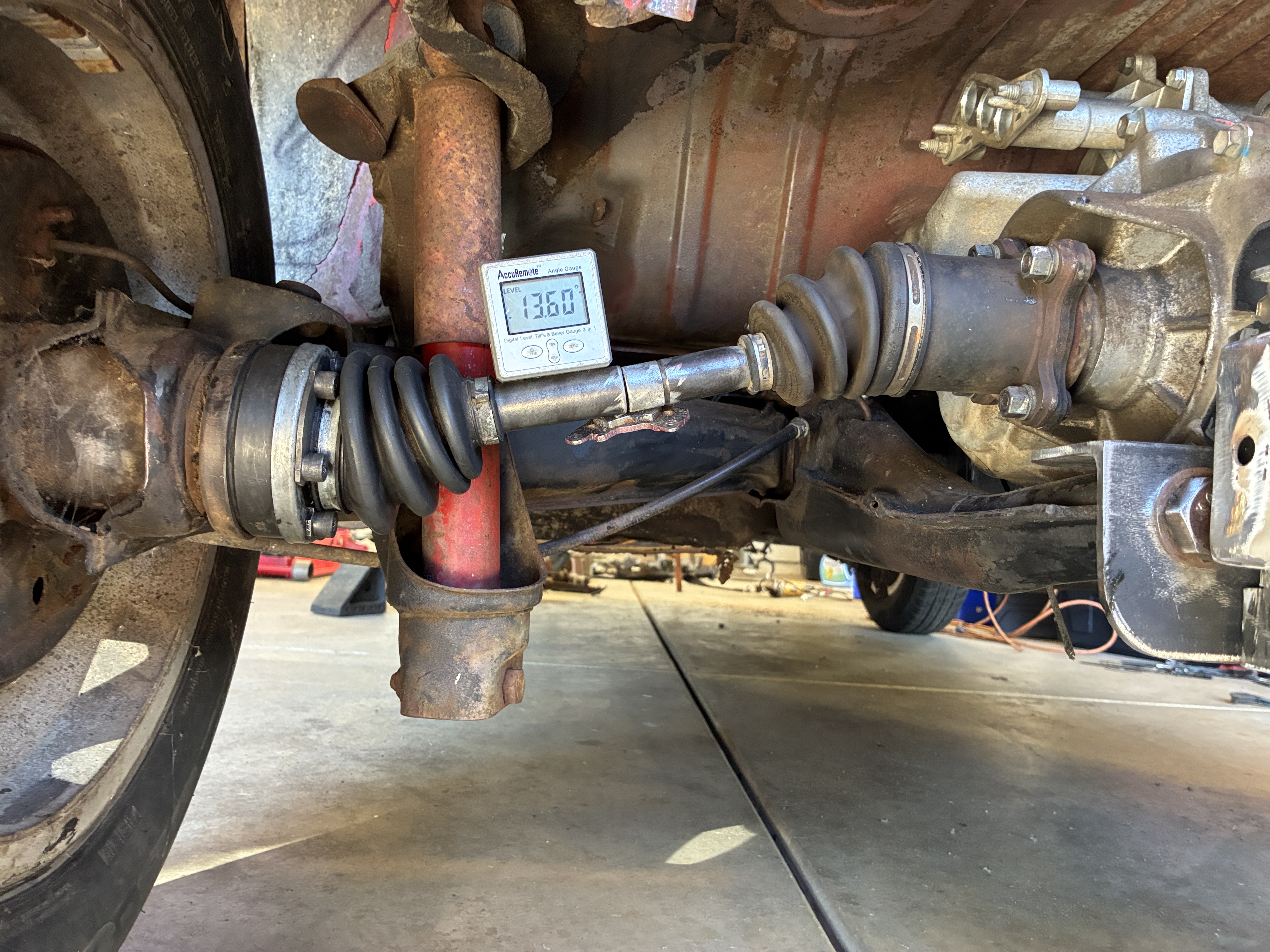

after fattening Bunky up a bit I decided to trim the VW CV axles as well to get a more accurate angle reading
Top Tip: a zip tie can act as a guide on a roundable surface to help you get that straight(ish) cut

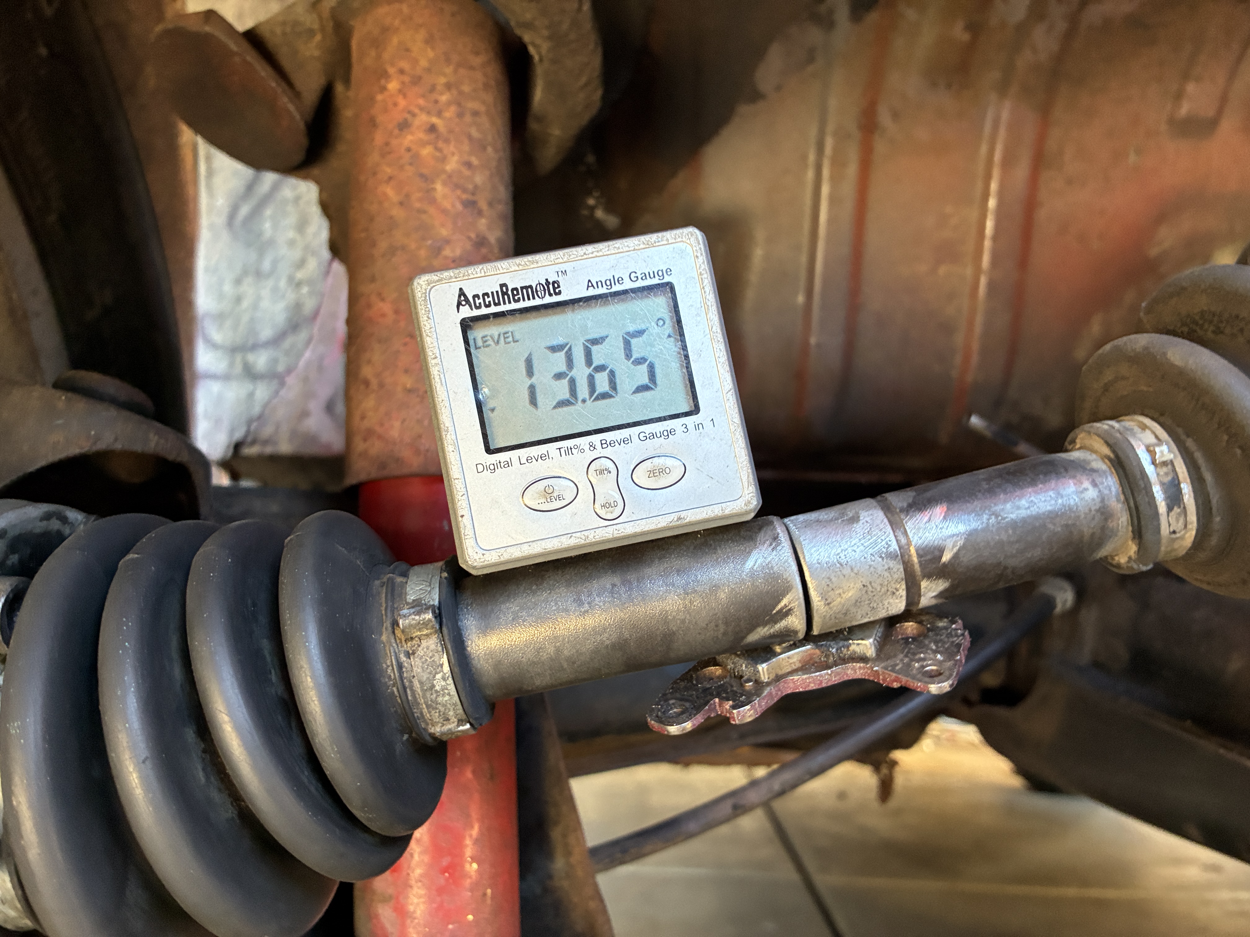

well the battery pack dropped us down to about 13.5° still not Good Enuff

Mythbuster's rules.
If emulating the circumstances cannot replicate the myth, next try manipulating the circumstances until they do. Just how much weight is needed to straighten those axles?
Also, I have heard before, never straight cut axles you intend to seam. Cut them at 45. That way if they snap off in the sleeve, they're still constrained.
Or go overkill and notch them:

MattsAwesomeStuff wrote: Wed Mar 25, 2026 7:40 am Also, I have heard before, never straight cut axles you intend to seam. Cut them at 45. That way if they snap off in the sleeve, they're still constrained.
I will note from experience that even if cut on a 45 and sleeved, you may not realize they have broken until they punch out the wall of the sleeve and leave you stranded anyways. (Then again, that issue may be avoided if you don't go spend an entire morning doing test hits on the newly paved streets of a nearby new development.)

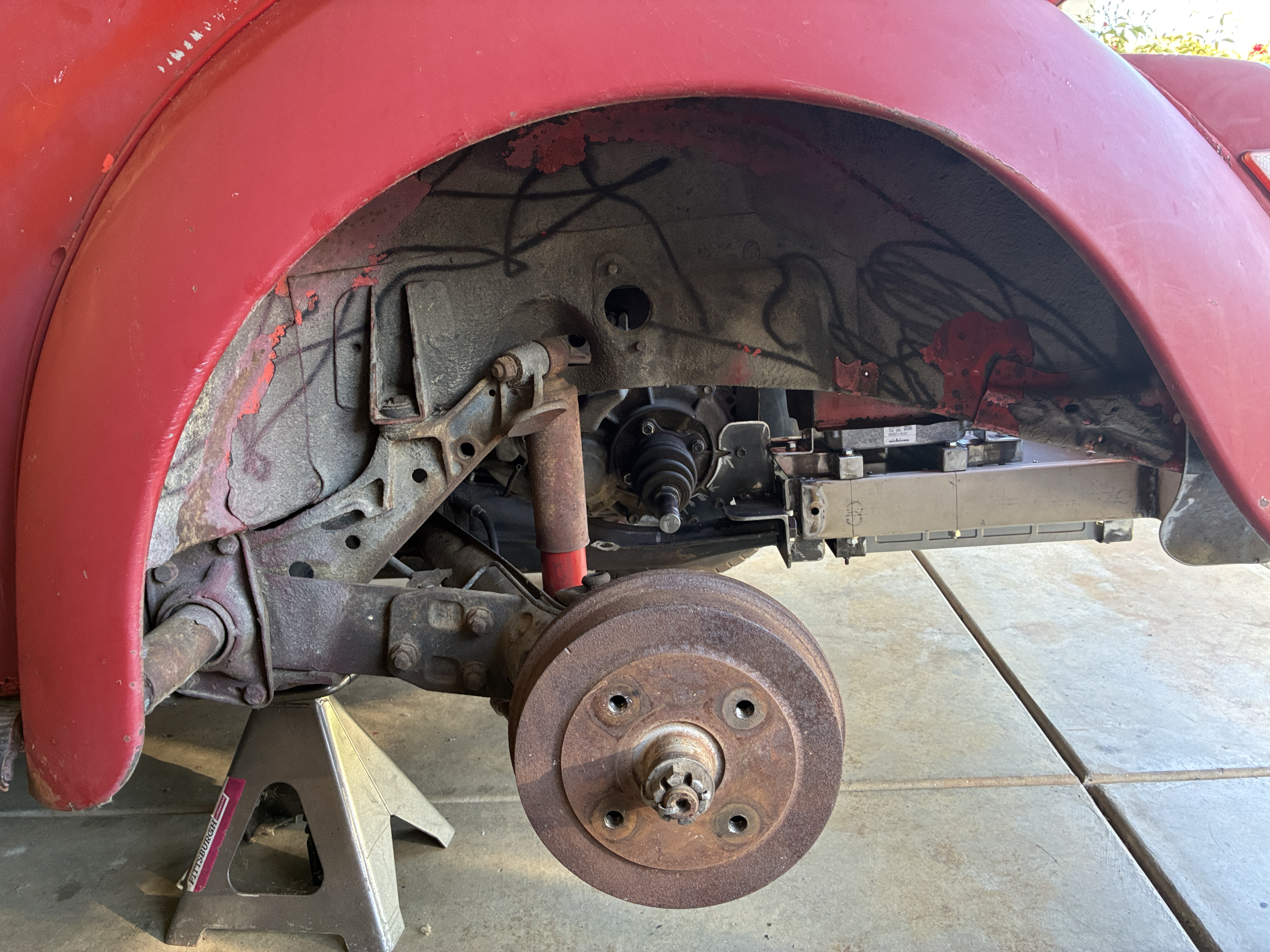

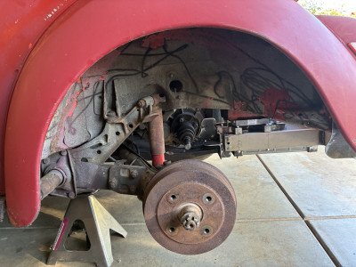

Gregski
Posts: 3152
Post by Gregski »

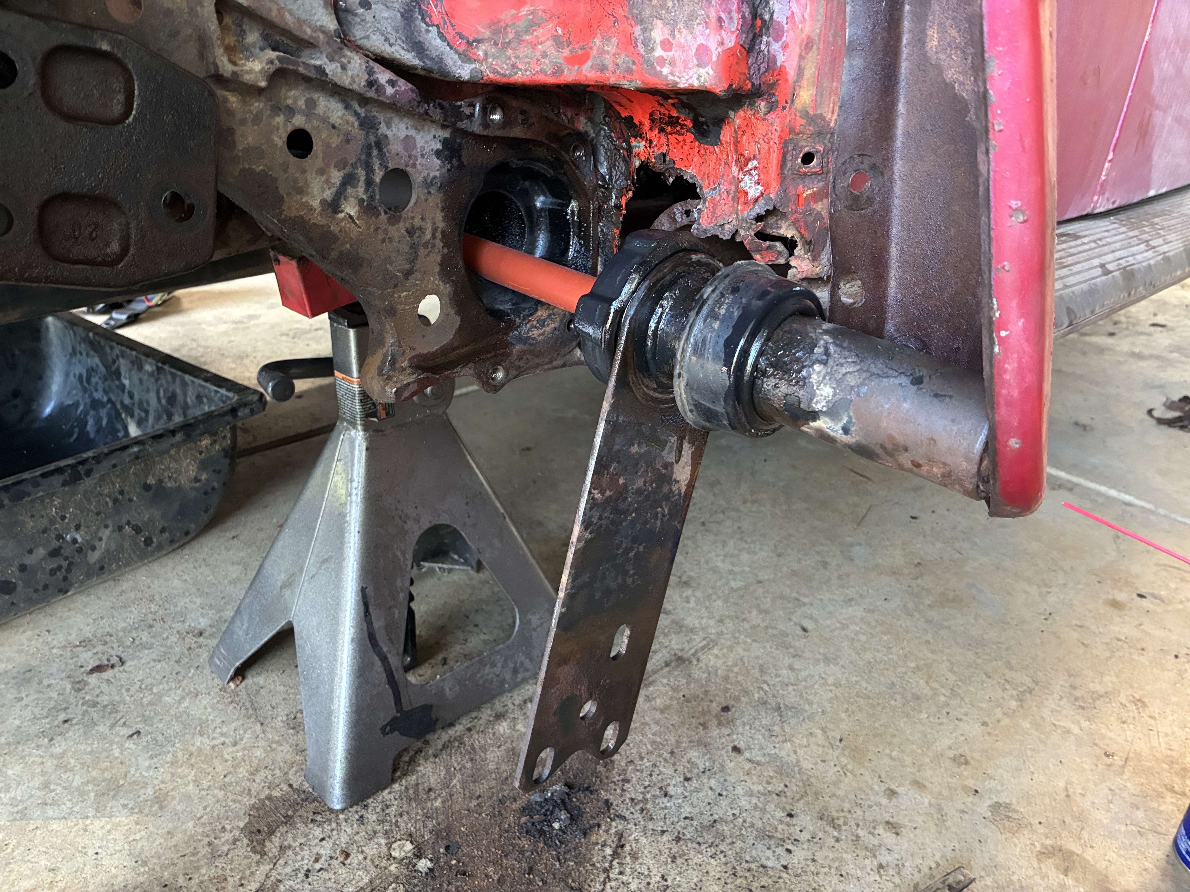

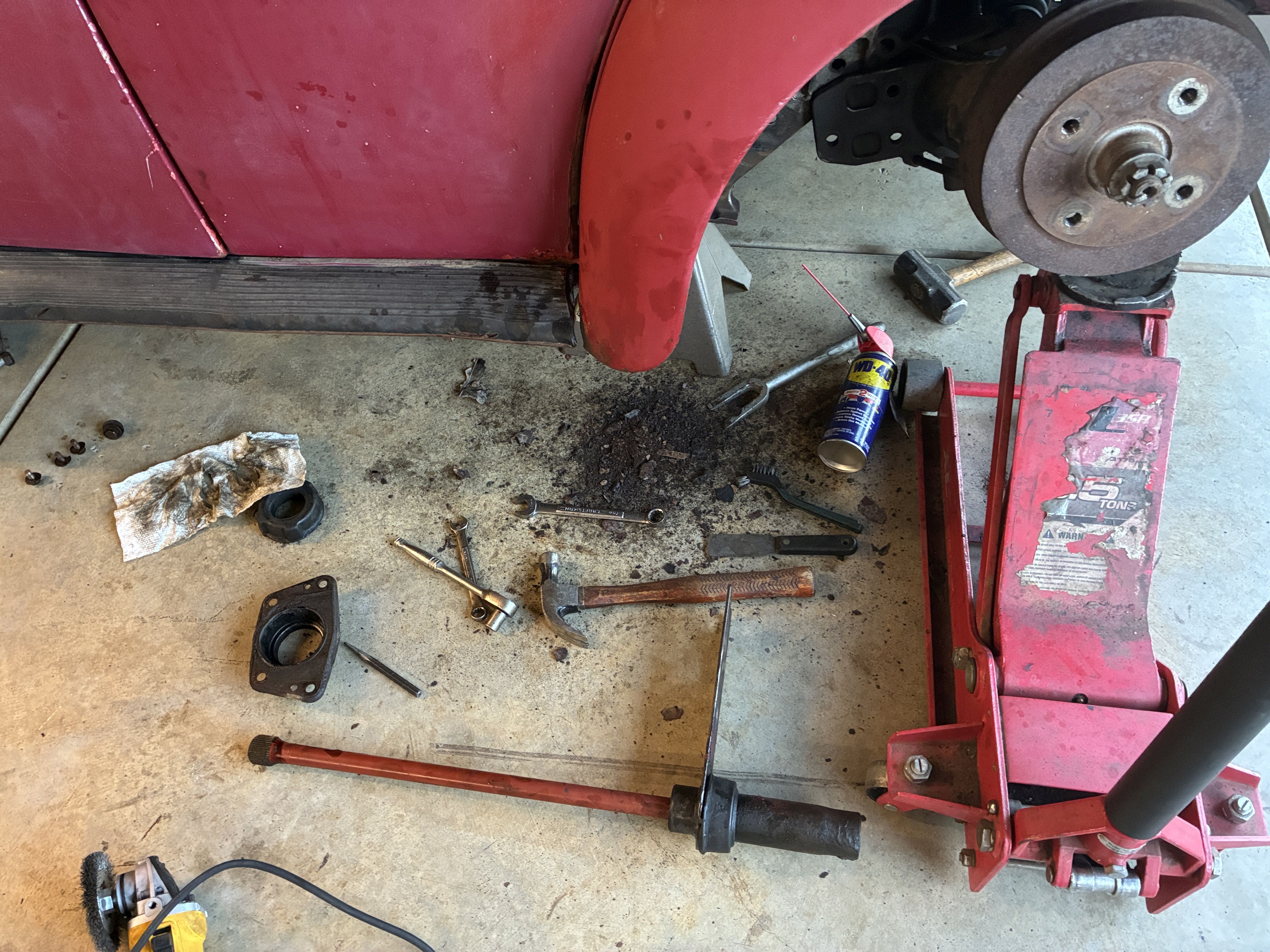

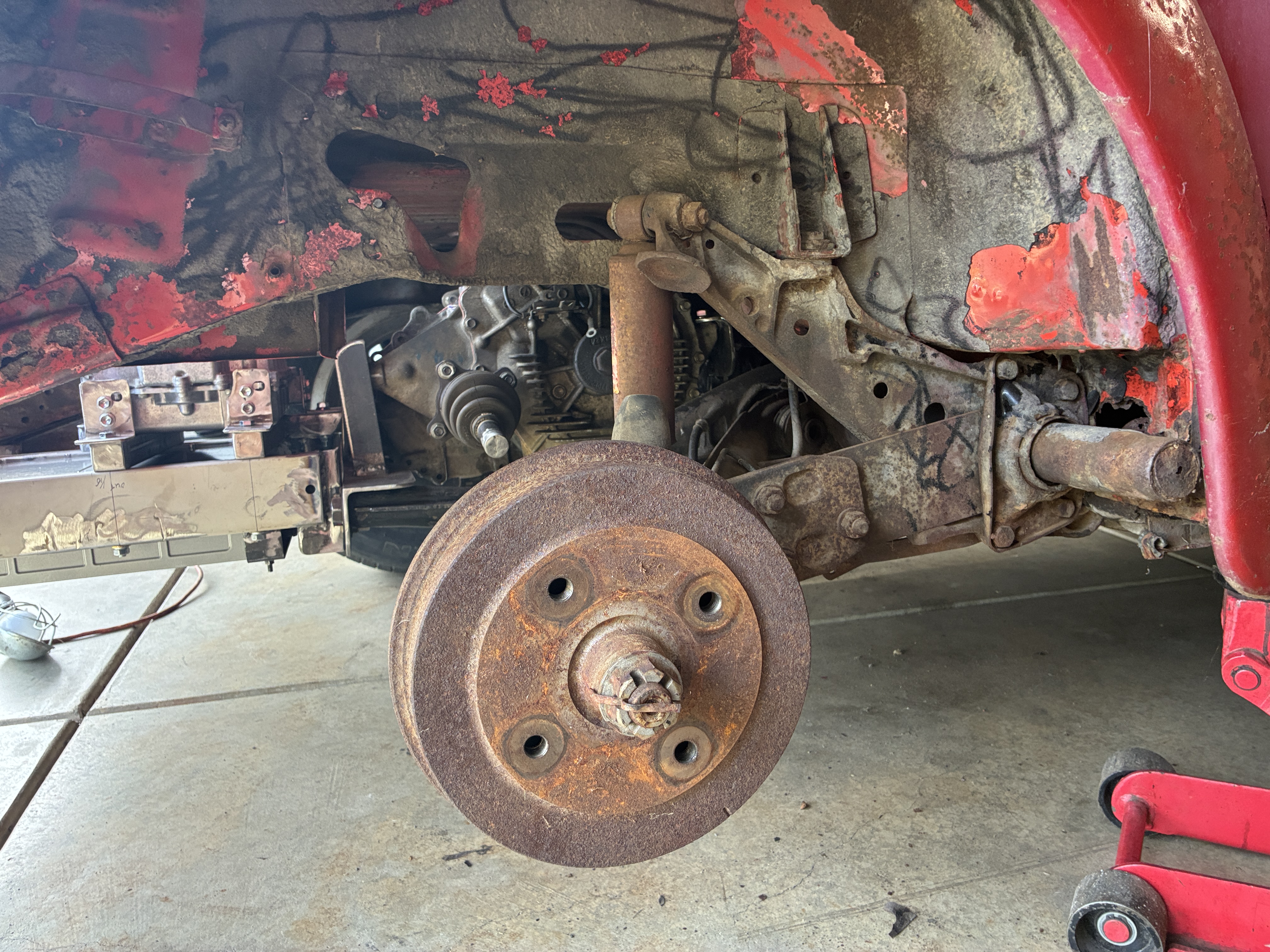

Commencing Operation Carolina Squat
Step 7. Transfer 3 pounds of dirt and grime from the heating tunnel to the garage floor... ✔
HOUSTON, we have a problem (but I won't tell if you don't tell)
and just like that by sheer luck, we got the driver side moving in the right direction and down to 8.5° angle of the dangle
Gregski
Posts: 3152
Post by Gregski »

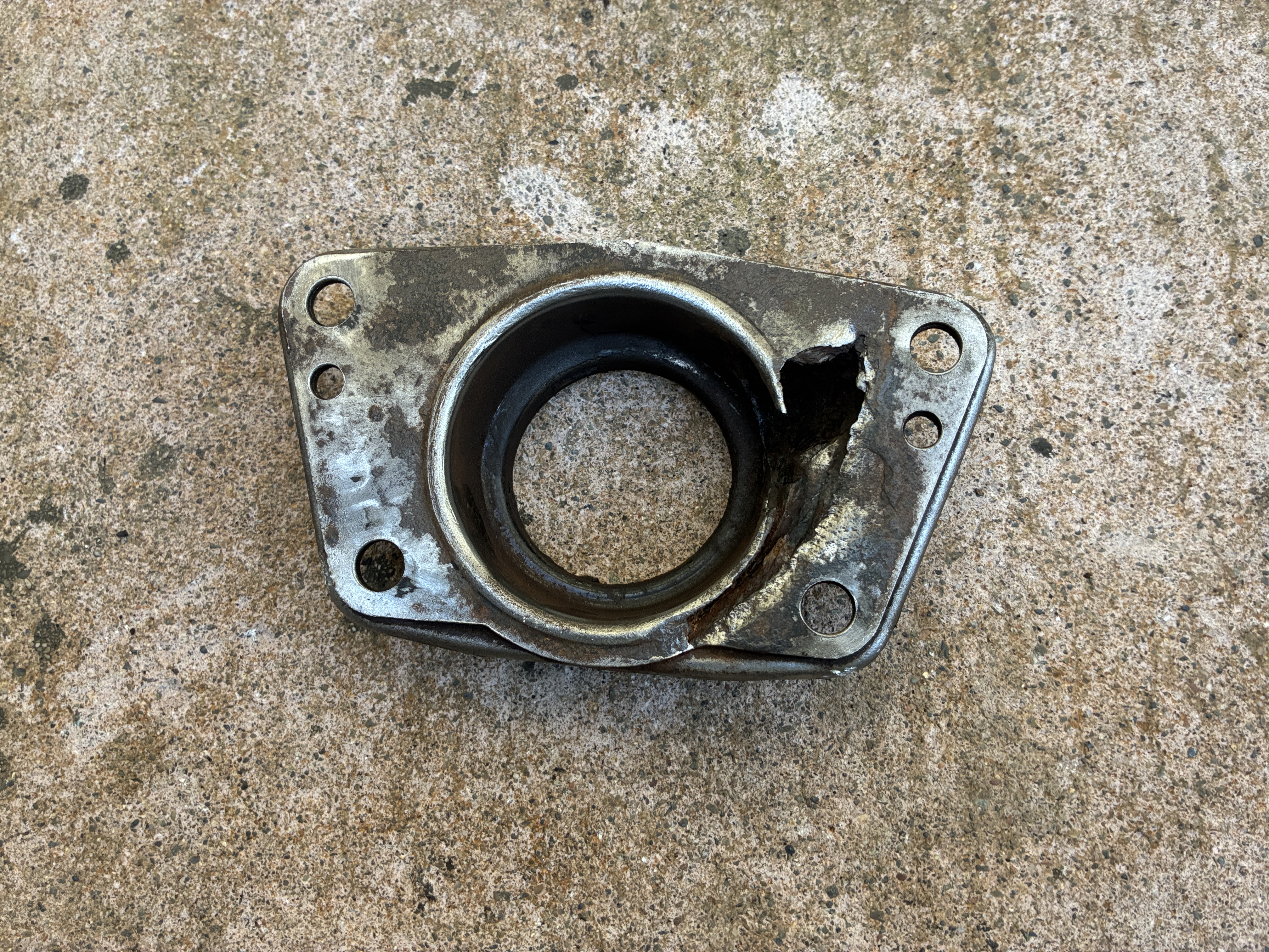

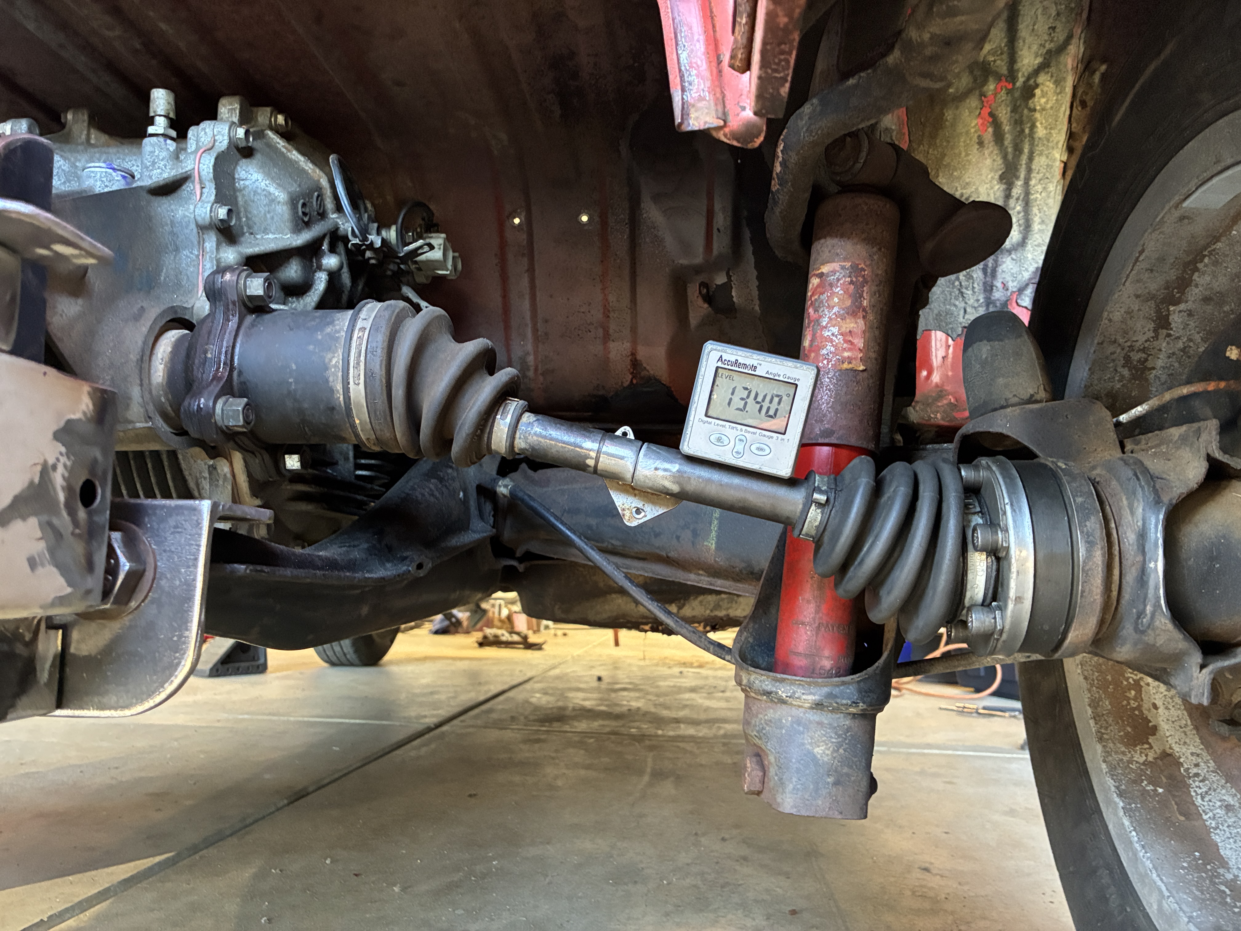

the passenger side was next

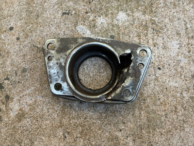

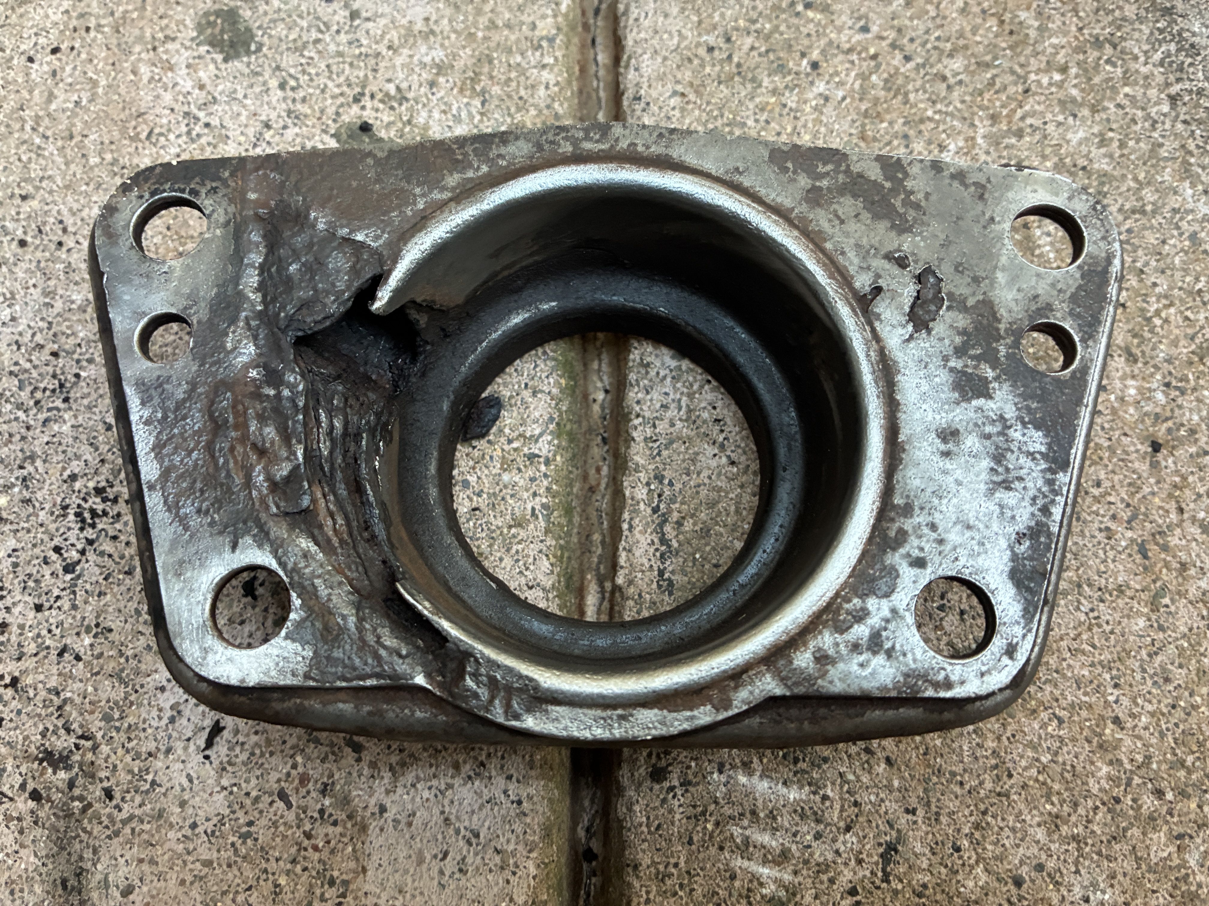

the broom stick also came out of the center spline section rather than the end cap on this side, and worse I just could not get it out of the end piece, so I cleaned it up and put it back
this cover was jacked on this side as well (note to self: order some replacements)

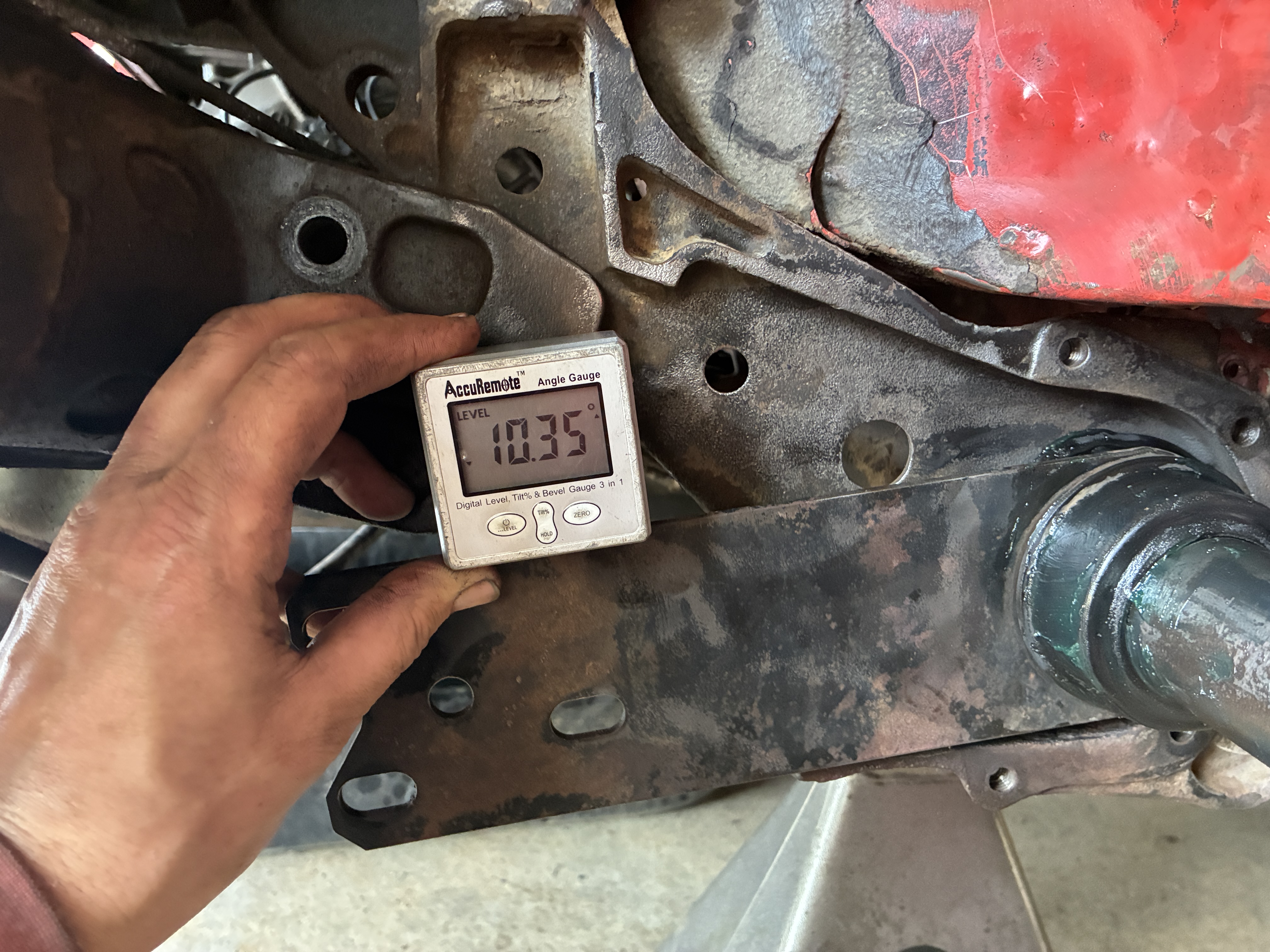

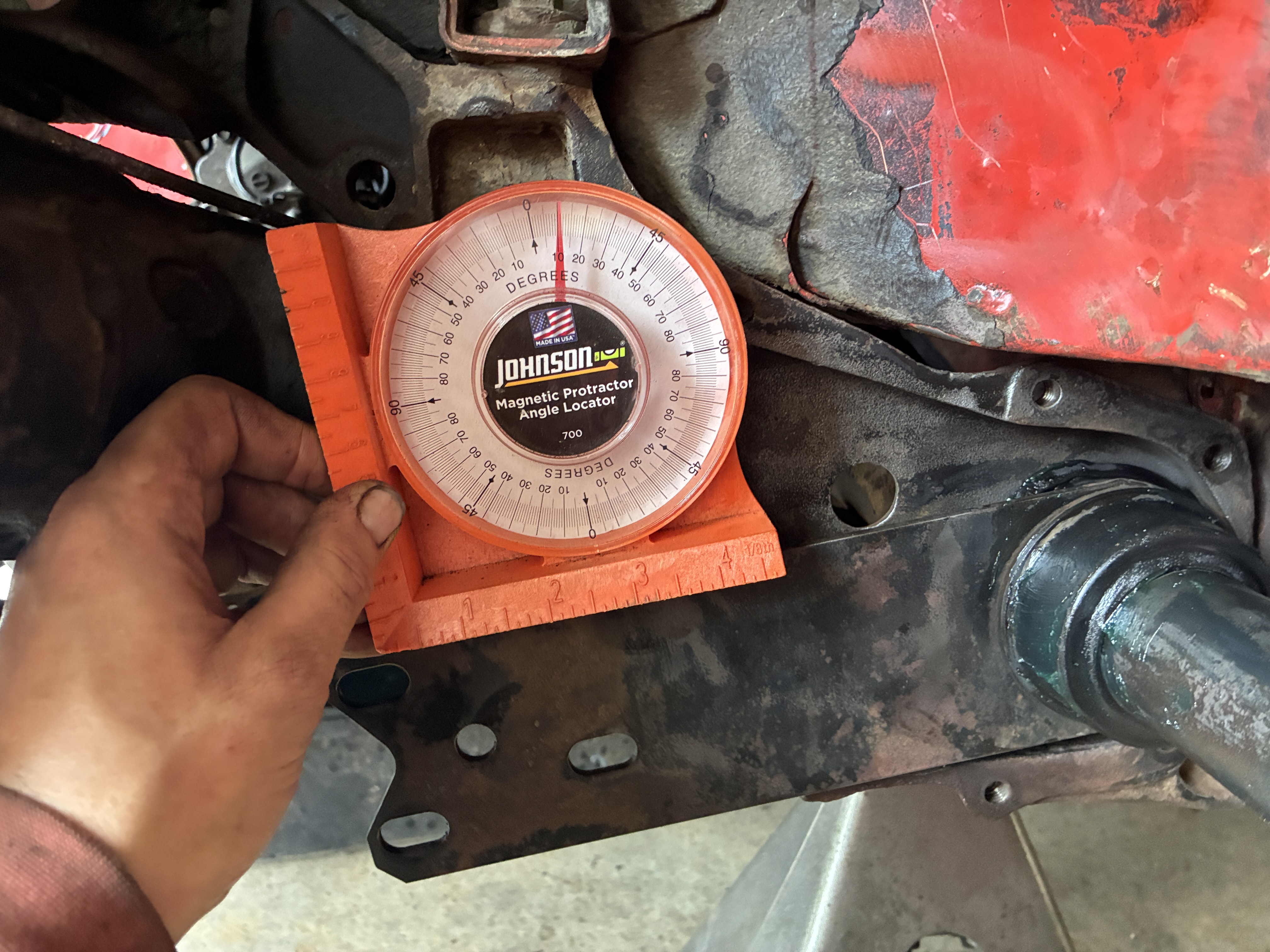

here I am just measuring the drop prior to loading up this spring, looks like 10° this is achieved by turning the inside splines one click clockwise, and zero twists on the outside splines, KISS (Keep It Simple Dummy)
we always check our work with multiple precision instruments here at Good Enuff Garage (cause we don't have any trust issues at all)

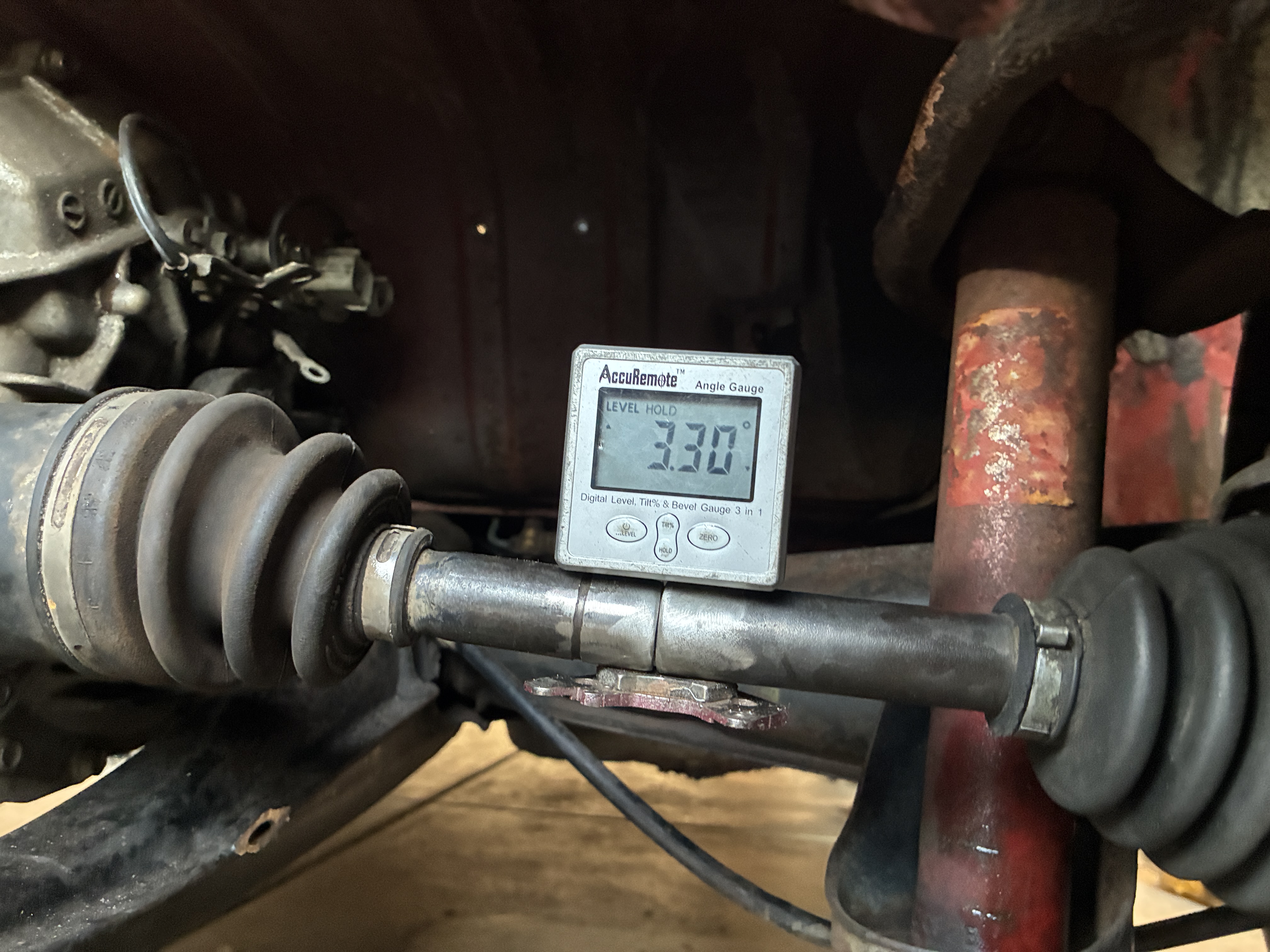

now with both sides DOWN a click, let's take a look at the numbers, and those of you who know me, know I am a modest man, so I will simply call this PERFECTION !

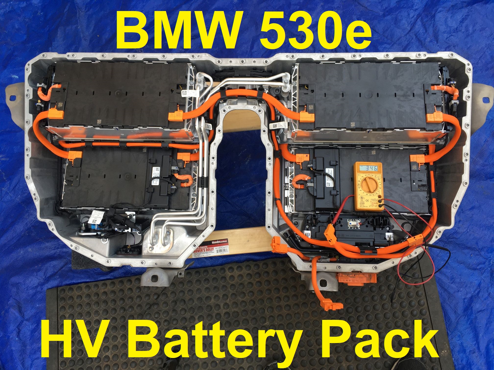

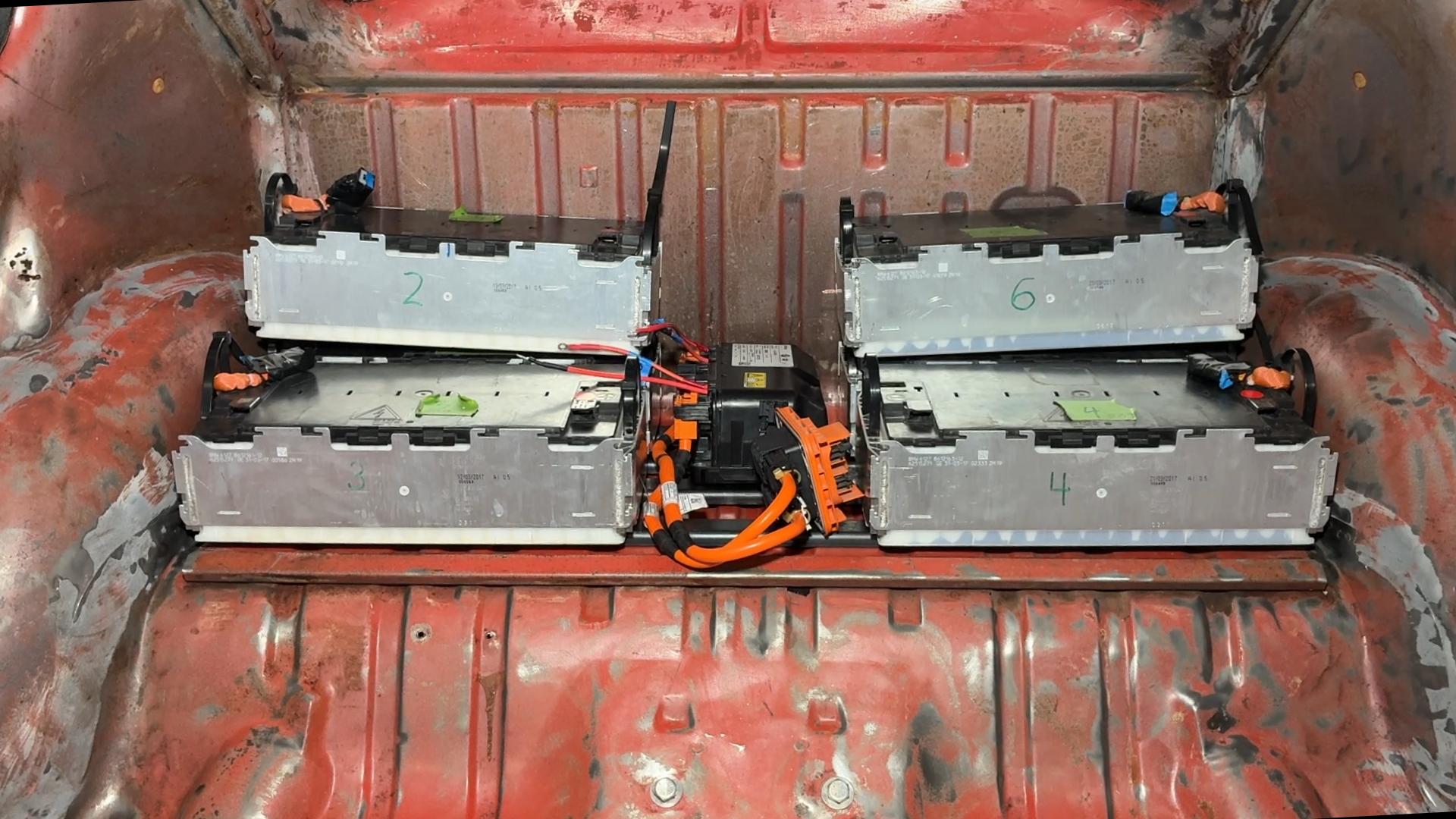

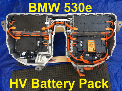

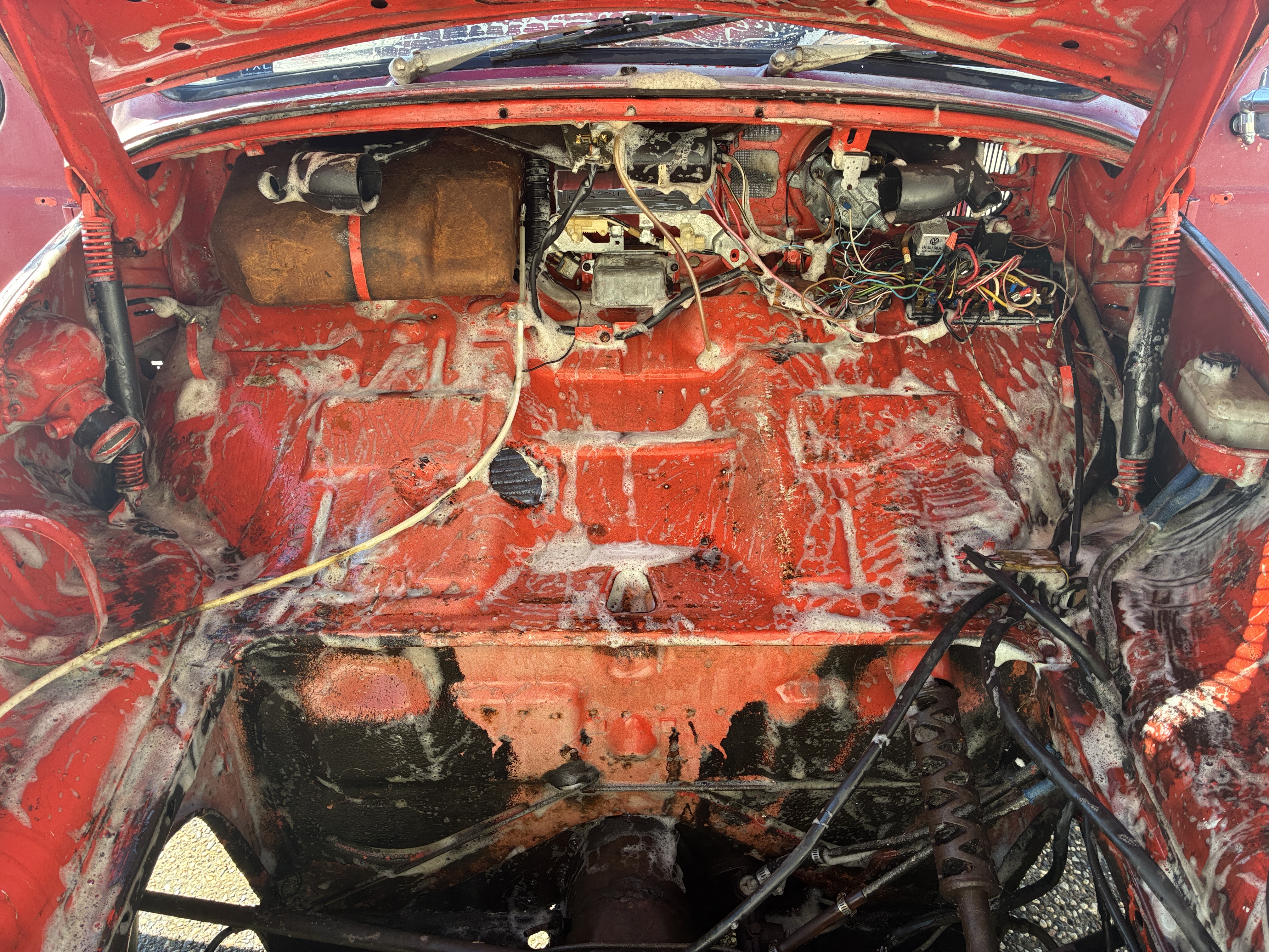

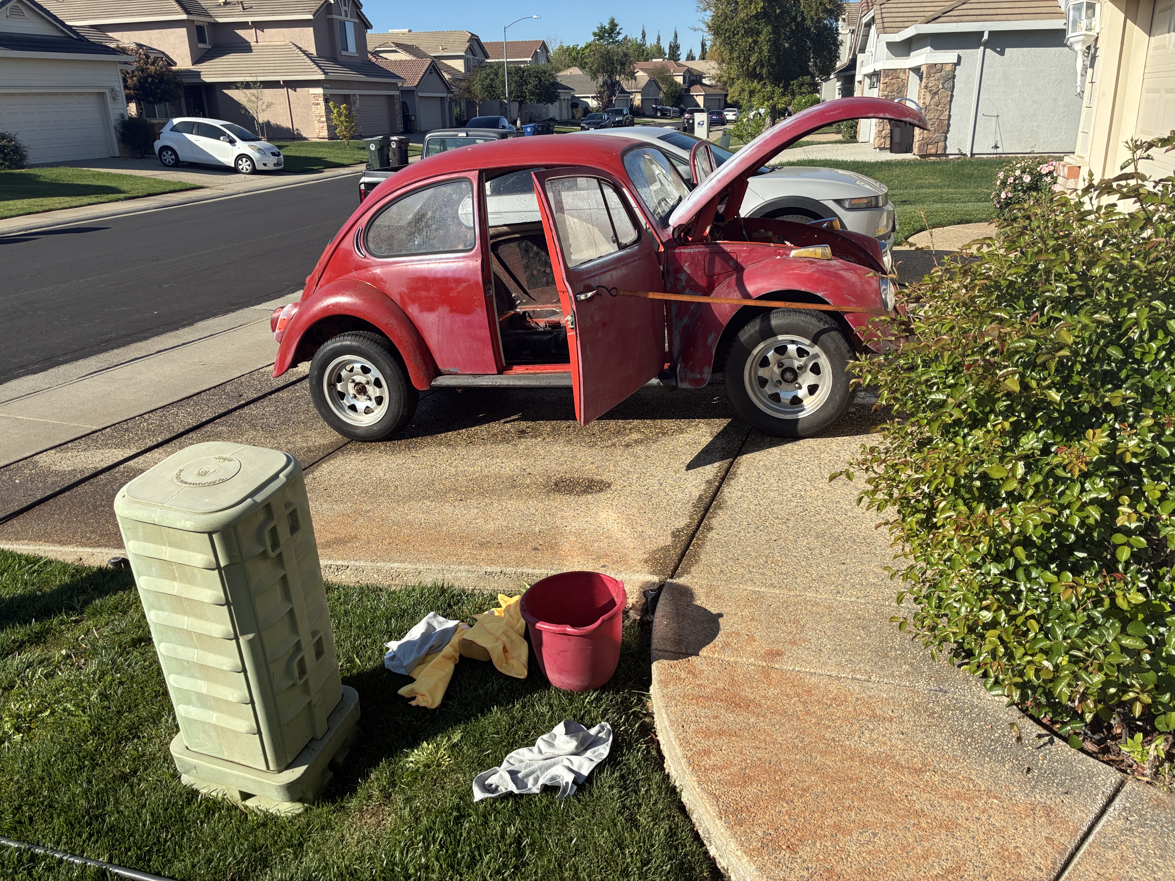

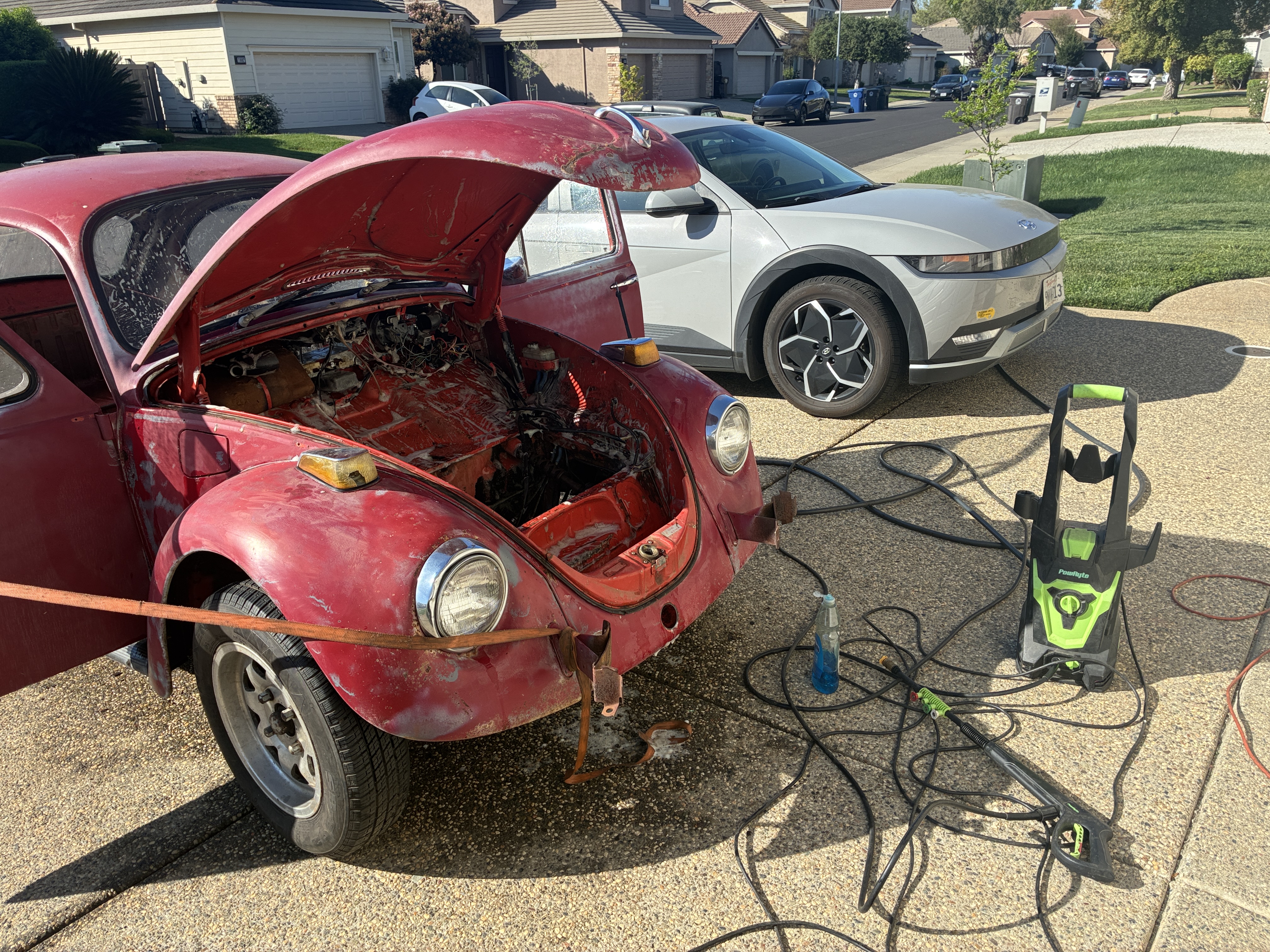

I wasn't a fan of the Carolina Squat so I decided to move the BMW 530e hybrid battery pack to the front of the Bug, I love that we can fit 4 modules across and plan to run 8 modules for 530 vols since my onboard battery charger can handle up to 550
but first she got a little baff (yes I am still doing a lot of "bought another rusty POS stuffs in the background") and I only share it as or if it relates to the EVing
I sure hope I used the right fuse soap
so just another reminder, the contents of this BMW 530e hybrid battery pack is what will power the eBuggie (six of these modules to start, perhaps going with eight eventually)

Gregski wrote: Fri Mar 27, 2026 5:25 am I wasn't a fan of the Carolina Squat so I decided to move the BMW 530e battery pack to the front of the Bug, I love that we can fit 4 modules across and plan to run 8 modules for 530 vols since my onboard battery charger can handle up to 550
Great move! Bunky will reward you with much better handling as Bugs are notoriously light in the front.
Bonus will be the much nicer stance as well. 🙂
