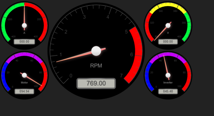

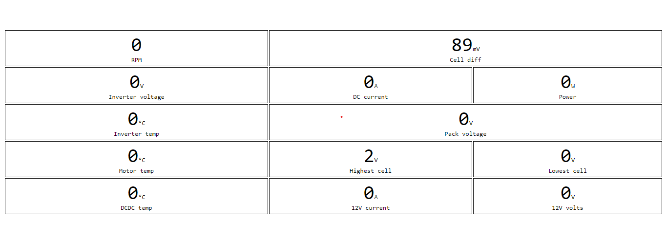

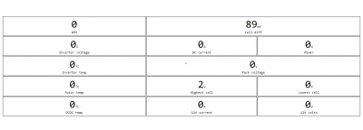

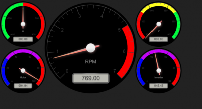

Re: Porsche Boxster with Siemens and DMOC
Went for another drive with my new gauges. They are displayed on a cheap Fire tablet, from a WiFi access point and CAN decoding running on a Raspberry Pi.
The general text information:
And the nicely formatted gauges: I've got code of course if anyone wants it. This can be expanded and modified fairly easily if you have any knowledge of HTML and Python (probably even without it).
-Isaac
