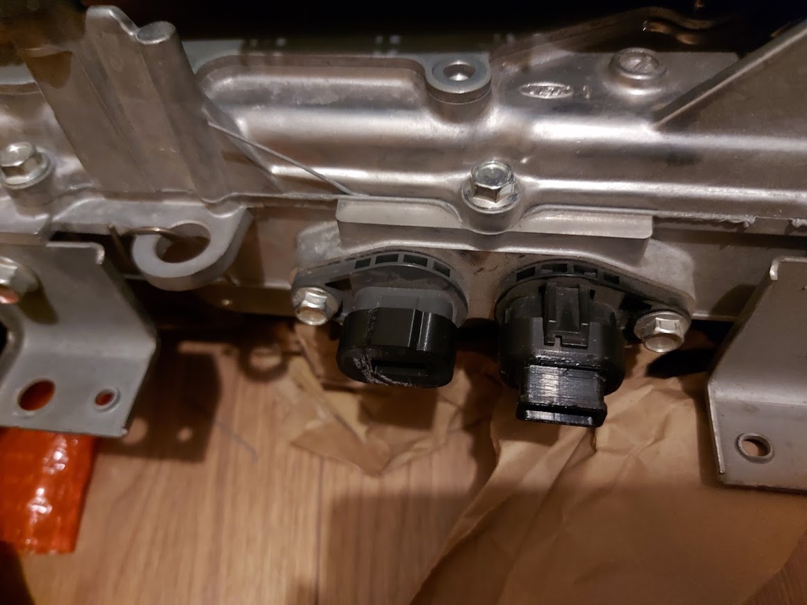

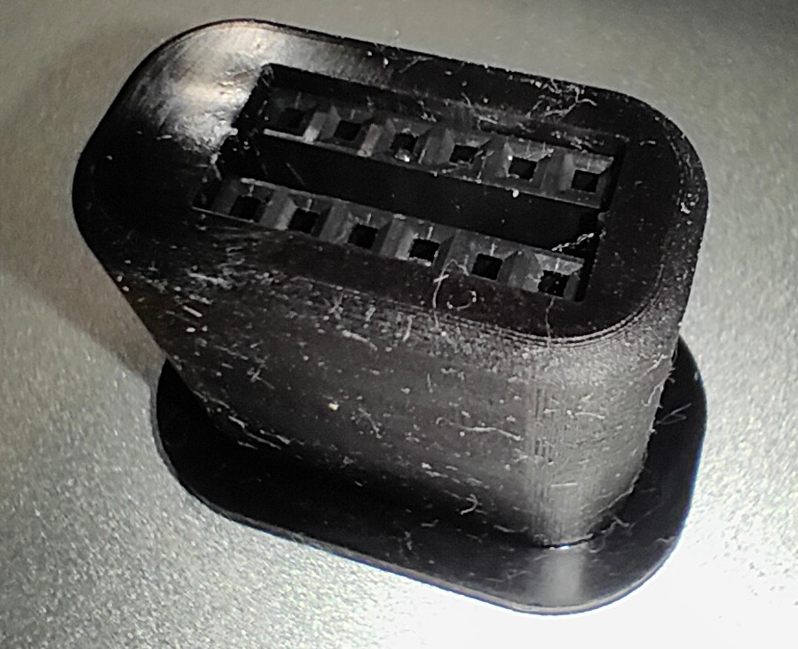

I just got my new Ender 3 S1 setup and wanted to test some small prints.
Have been in the progress of designing ways of reusing the Rear motor and Inverter, the biggest issue is the connectors.
I have now designed a basic connector starting point that use the "dupont" style header connectors.
The attached STL works for both the Vehicle connector and the Motor connector of the rear inverter and thus also on the motor. Will be working on making the print better to eventually include a seal and allow for potting the wires.

Posted: Mon Mar 07, 2022 5:47 pm
by bigdaveakers
tom91 wrote: Tue Mar 01, 2022 9:12 pm The attached STL works for both the Vehicle connector and the Motor connector of the rear inverter and thus also on the motor. Will be working on making the print better to eventually include a seal and allow for potting the wires.
This answers my question about which wire is which on another thread and my resin printer is in print mode as we speak!

Posted: Sat Mar 19, 2022 8:34 pm
by tom91
Attached are two updated models.
Now including a perimeter outside the mating parts, this is so you can really only fit it one way and to add alot of grip onto the OE connector.
It slips on tight and if printed right will be a pain to remove so it means it will stay put.
I have modelled it with the TE AmpModu housing 1-87499-1 in mind as this one has the largest wire size range available officially.
Here is a print with the Chinese Dupont housings
What it looks like with the correct housings
The idea of the extended section is so you can pot the wires and add a boot onto the 3d print.
And how they fit on the OE parts
