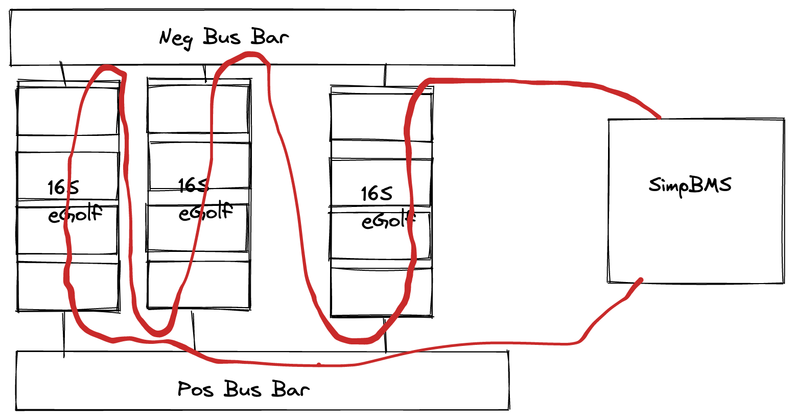

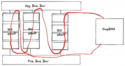

Re: VW eGolf hardware
Ignore me, going to read the manual then wire up and report my results.
So what I mean is this:
I would arrange the modules into 16S blocks (my charger goes to 64V and I can have 4.0V per module with 16S so that is fine me thinks). But happy to do 14S or 12S which would allow me to utilize 4S more for the pack but my charging power would go down slightly.
The module bms boards would be connected similarly as in the car all in series but the power connectors would be in 16S chunks parallel.
It looks like Carel is doing this with the MEB modules I should be able to try this with the eGolf modules too, right?

I'm a bit confused by this. Let's say I have one complete E-Golf pack with all modules present. I can't run it as 88S as Victron is 48V. Can I get a reasonable 48V pack out of it with (one) SimpBMS that would work with Victron? I can do 16S5P or 14S6P or 12S7P.tom91 wrote: ↑Tue Aug 30, 2022 8:34 pm Will not work, if you change the cells connected to the Slaves it will not work. So for an E-Golf as long as you keep the modules "complete" you can wire them up in any way you want as they are isolated.
However there are quite some unique quirks to the packs so watch out.

The e-golf module with BMS/CAN connection will have to be connected to the same amount of non BMS/CAN modules that it was originally, as the BMS/CAN module sees the BMS+nonBMS modules as a ONE large 12S module set.jnsaff wrote: ↑Tue Aug 30, 2022 8:46 pm I'm a bit confused by this. Let's say I have one complete E-Golf pack with all modules present. I can't run it as 88S as Victron is 48V. Can I get a reasonable 48V pack out of it with (one) SimpBMS that would work with Victron? I can do 16S5P or 14S6P or 12S7P.
You will have 8X the 4S module with BMS connector on one side and and TWO interconnect connectors on other side that go to rest of modules, that will have to be connected correctly to the VW BMS module with CAN or the VW BMS board Will give errors.
You can have many separate working 12S packs with VW BMS slave modules.
I have no idea will it work if you have up to 5 of those in parallel.
Maybe a 12S5P would be possible ?
