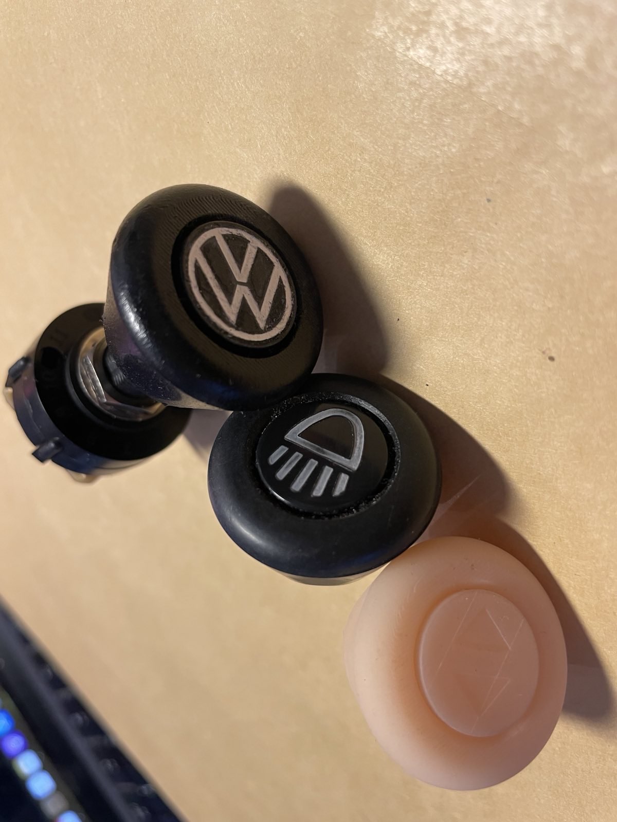

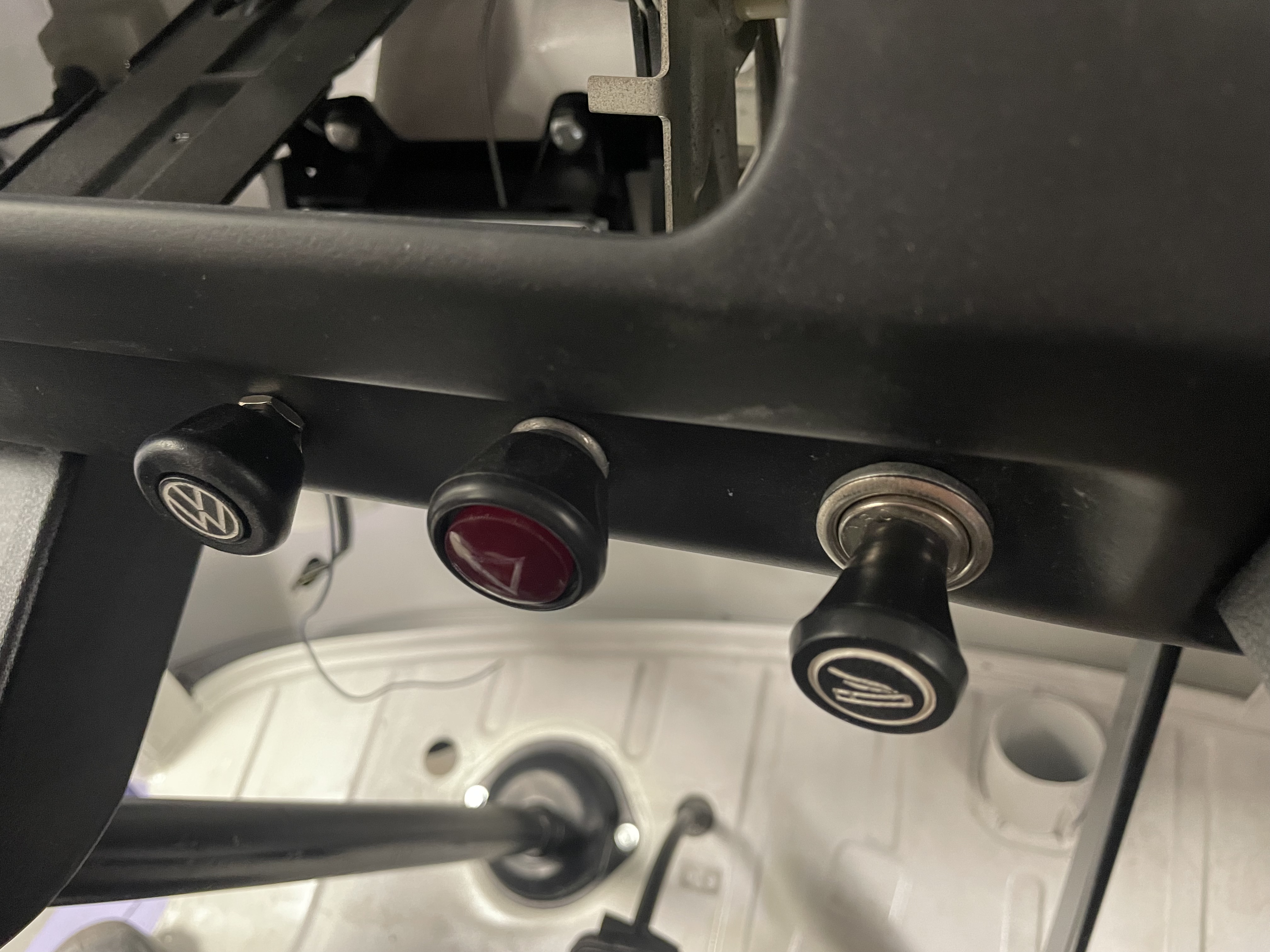

I hope to update both here and DIYelcar "soon" :D but it feels like I'm just doing minor things and procrastinating the engine mounting so it's not felt like there's much to write about. But maybe multiple minor things could make a post too.
I did start in DIYelcar originally, then moved here somewhat. I'm notoriously bad at updating forum threads 😂 but since I had practically no knowledge, no experience and no skills I started looking for info in multiple sites. I also have a thread in Samba for mostly non-EV parts of the build. (https://www.thesamba.com/vw/forum/viewt ... p?t=715039) sometimes it helps to get input from multiple sources. 😂
I've installed Tesla iBooster in the place of the original vacuum booster. See viewtopic.php?p=69524#p69524
Currently wiring 12V electrics anew and made me a new gear shifter 😊 modeled the original high beam switch knob, 3D-printed an copy with VW logo on it, got a 4-pos rotary switch (P-R-N-D) and drilled an extra hole to the dash:

Cera wrote: Thu Feb 20, 2025 12:13 pm Currently wiring 12V electrics anew and made me a new gear shifter 😊 modeled the original high beam switch knob, 3D-printed an copy with VW logo on it, got a 4-pos rotary switch (P-R-N-D) and drilled an extra hole to the dash:
Very good. If this is an example of your small jobs that you haven’t bothered to post, I would suggest you are over due an update! I bet there’s plenty of interesting good stuff you’ve been up to. Well, it’s interesting to other VW T2 converters at least :)
Thanks for the link to your post about brakes.
