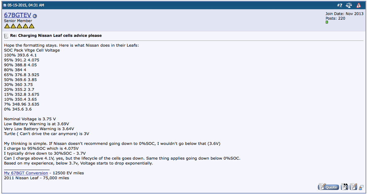

Found this Information on mynissanleaf.com, what do you guys think about that state of discharge and the percentage?
Any opinions on that?
So 3.6 Volts is the lowest i should go? Does this mean under load or open cell voltage?On the Leaf 3.6V (345v) is pretty low SOC.. somewhere between LBC and VLBC? maybe 20% SOC? The differences between 3.6V and 3.8V in regard to battery longevity is probably not that big of a deal.. more important (by far) seems to be to keep it cool.

Here's a useful guide from DIY Electric which AFAIK is accurate for both Gen 1 and Gen 2 Leaf batteries. I would assume these are measured under minimal load.
