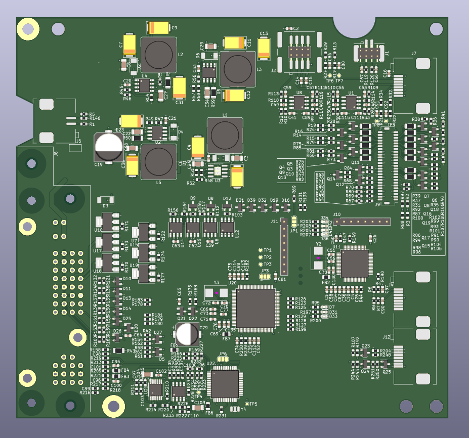

Ages ago I started designing a PCB (see
viewtopic.php?p=39624#p39624 for details). It never got finished because I ended up going down the simulator rabbit hole to prove to myself that the FOC control with OpenInverter was the right way to go. Well I'm now happy that it is and so I can now get back to the hardware. Here is version 2 of the PCB:
It's essentially a slimmed down version of the last one but modified to reflect the stuff that I've learned on the simulator and logging threads. So what's changed and what's still there?
First the unchanged bits, it still uses reclaimed Toyota connectors for the interface. It also uses the resolver interface IC off the Toyota board.
Pretty much everything else has changed:
- The STM32L496 has gone, at some point in the future it will reappear as part of a climate control and charg controller. This change has also simplified the power supplies as the permanent 3V3 rail is no longer needed.
- It no longer uses the STM32F103 for motor control. Instead it uses a STM32F405 (actually a 407 as I've managed to get hold of a eval board with one on).
- Both CAN interfaces on the F4 are routed out, one will be for the BMS bus and one to interface to the Roadster CAN bus.
- Both advanced PWM timers on the F4 are used, one to drive MG1 and one for MG2. Not planning on using this feature but it seemed sensible to track it out that way. If both were used, and separate resolver interfaces needed, a second resolver daughter board would be needed connected to a header. There are also links to allow both to be driven from timer1 which is the way I plan on using it.
- I'm a little concerned about current sampling on low L motors so have added anti-aliasing filters (2nd order sallen-key) on the current input lines to make things a little easier.
- The ESP8266 module and SD card that were on the board have been removed. Instead a remote ESP32 with an SD card (as per the logging thread) will be connected via a RS485 link. This removes the wifi from inside the screened metal inverter housing which should both remove the noise it induces and improve signal strength, hopefully to the point where it can connect to the house wifi from the parking spot around 20m away. It also makes it much easier to modify if needed and the card can be removed to read the logged files.
- It now has a STM32F103 driving the DC/DC converter and buck/boost converter. Probably overkill but I have a few and it means that the CAN interface can be used to control it.
- It has an interface for a HLSR current transducer, intended for measuring the current in the buck/boost converter, connected to the F1 processor.
It's not finished yet (the signal tracking was supposed to be this afternoons job but I got sidetracked onto the final simulator release) but hope to get it done and out for manufacture in the not too distant future.
Moving to the F4 will be a bit of a pain but I think it will be worth it. While the fixed point math works well on the F1 the floating point coprocessor on the F4 will eliminate all the potential for overflows, improve performance and should make the code simpler and easier to maintain. I was planning to change the way the peripherals were configured to reduce latencies anyway so combining the move to a different processor at the same time makes sense.

Given the latest experience with Prius transmissions it seems sensible to run both motors and put the second resolver IC on there (despite not being a huge fan of dedicated resolver chips)
Maybe this helps to get you started on an F4 implementation:
https://github.com/jsphuebner/libopeninv/tree/stm32f4

Thanks, have seen that but not had a proper look at it yet.
With the resolver I've run out of pins on the connector, and partly space on the board. The thought was that if the gears are welded up in the Prius transmission then one resolver would do, if not a second resolver could be added using the SPI pins that happen to be available on the JTAG programming connector.
With the resolver chips I wouldn't buy one to use (as they are not cheap!) but given that they are essentially free with the Prius inverter it seems a waste not too. If it works then getting the angle just becomes a read from the FSMC interface. If it doesn't then I feel a bit silly and have to respin the board!

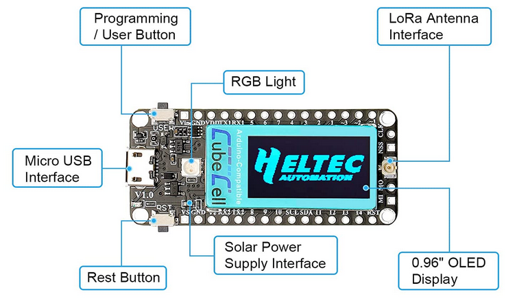

Talking of non-essential creature comforts the one thing that I have always wanted to add to a car is a way to remotely enable the heater/AC to either warm or cool the car ready to go (and the recent UK weather has focused my mind on the heating/defrosting side!). Now I could do this with the existing remote plip, the trouble is it is very limited in range and there is no confirmation if you can't see the car. An alternative would be to use a mobile SIM, but I'm not keen on this for a number of reasons (SIM costs, complexity, don't like smartphones, power consumption, need static IP address, poor local coverage, etc). Instead I've ordered one of these:
It's a LoRa wireless transciever with a M0 48MHz micro, oled display, couple of buttons and battery management circuits. The LoRa wireless transceivers can supposedly give a range of >5km line of sight (been tested to 14km!) or ~1km in built up areas, only uses uA in standby mode (and the car end 6mA in receive mode or 2mA @ 12V via a switch mode supply) and is supported by numerous code libraries. The plan is to make a fob sized remote out of it, have it show the car status (SOC, range, voltages,temps) on the display on a single button press and on an additional long press start the car climate control.

Hi Peter, what talks to the "LoRa" at the vehicle side? Looks like an awesome thing.

On the LoRa the plan is to build one of these
https://www.fanstel.com/lr1262 into the VCU. Will probably add another into the house BMS (Building not Battery!) to allow it to monitor the car's state too (could do that with WiFi but don't like having the constant power drain associated with WiFi and the car will also be parked a little too far away for WiFi to be reliable).

Quick update, most of the big firmware changes are done, not tested as don't have hardware yet but it compiles OK. Essentially removed all the legacy bits that don't make sense on this board and changed the interrupts so that the spare channel on the main PWM timer is used to trigger the angle measurement from the resolver (via a DMA FSMC read) and ADC conversions for the motor currents (using ADC2 and 3). The timing should give measurement to PWM update latency of around 40us (down from 180us). Still need to change the main control loop from fixed point to floating point math (think I'll probably leave all the parameter stuff using fixed point).
All the bits I need have been removed from the ST eval boards (STM32F103 and STM32F407 ICs) and Toyota logic board (resolver ICs, crystals, connectors) ready to build up the new logic board. All the ICs and most of the connectors came off without any trouble.
Only problem is the 50way header that connects to the Toyota IGBT driver board didn't want to come off and got a little too hot when de-soldering (silly mistake - should have put a kapton heat shield round it). It's probably OK to reuse but a little borderline so if anyone has a spare JST BM50B-SHLDS-Q-TFT (as used on the Toyota logic boards) please let me know!
Edit - One other question - I'm inclined to try and increase the PWM frequency a bit due to the low Outlander motor inductance. Does anyone have a view on what frequency the Prius Gen3 can run at or what the Outlander rear inverter normally runs at?
