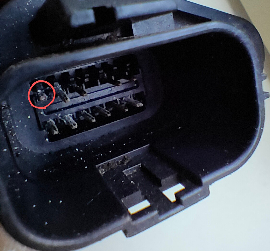

bigdaveakers wrote: Thu Mar 24, 2022 4:36 pm I plugged the CAN in to the inverter and got some inverter temps.......I guess it is working. Need to connect the motor to the inverter now and see if I can get some motor temps less than 215 and motor rpm less than 45000 :o (0 would be good)
So, turns out that when a pin is broken off you get no connection to the resolver :o
Fortunately I had a spare pin so I have fixed it, but need to get the broken pin out of the connector......
